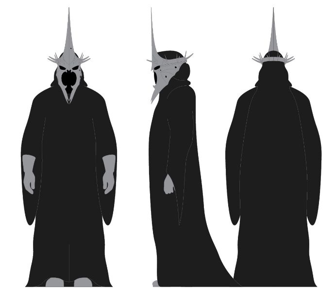

I begun with a vector drawing to my scale and size.

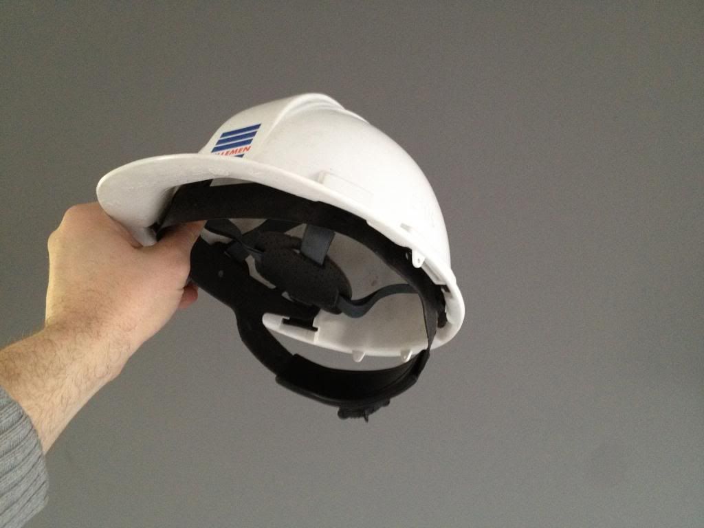

I used an adjustable headband from a safety work helmet to hold the helm in place on my head.

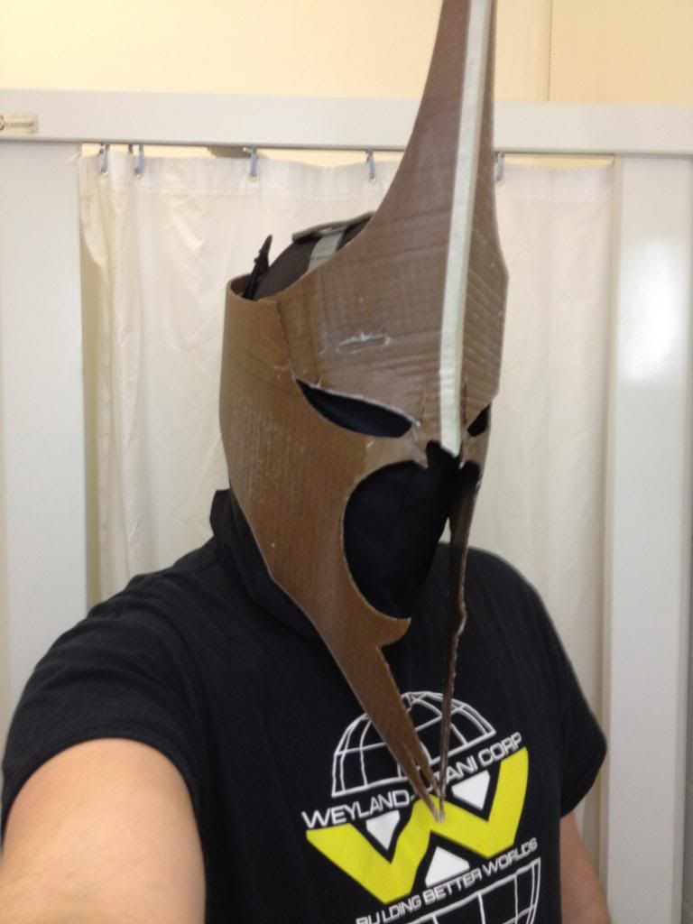

First test of the assembled cardboard with the hood, the black face mask, and the headband underneath everything. All is ok:

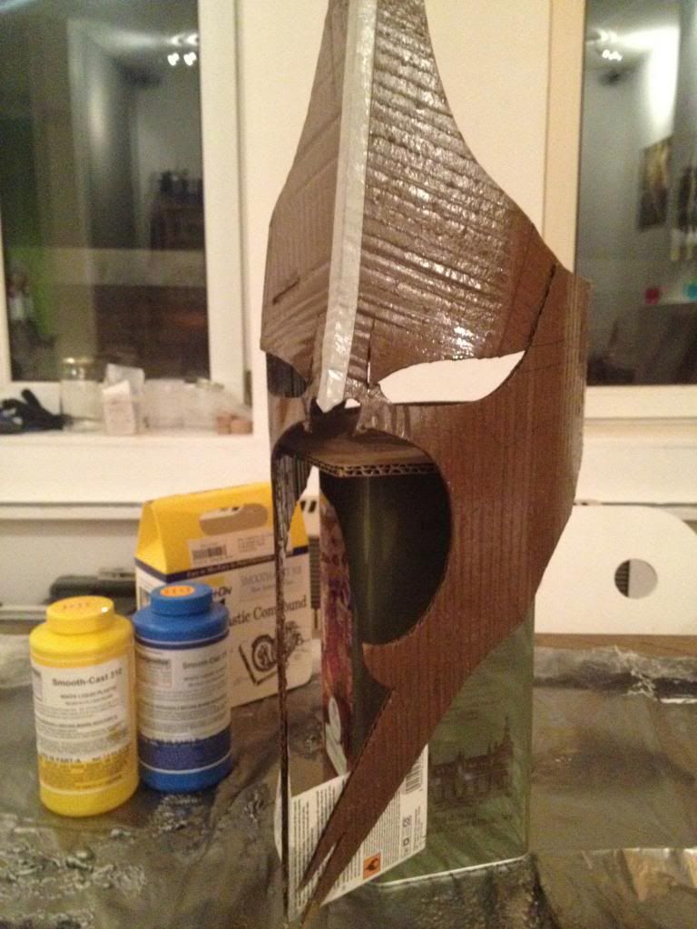

Next I placed two oval shapes inside to keep the needed shape:
And applied a two part liquid casting resin with a brush all over the helm to strengthen it:

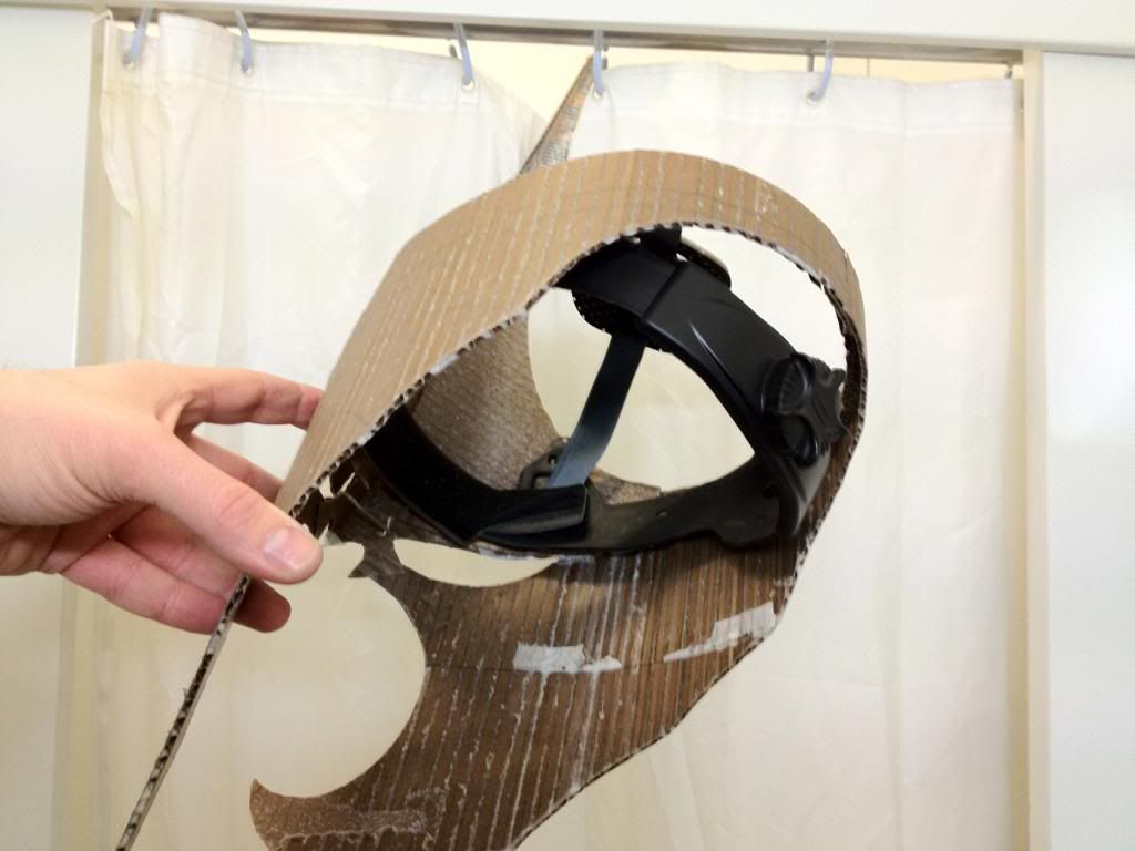

Placing the headband:
Testing the helm with the headband and the black face mask. (you can see here what it looks like without the fake hood):

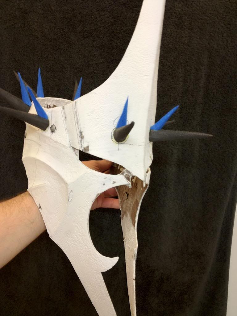

For the pikes around the helm I wanted a flexible material for obvious safety concerns. So I used neoprene board I had previously collected.
You can see the cutting steps below:

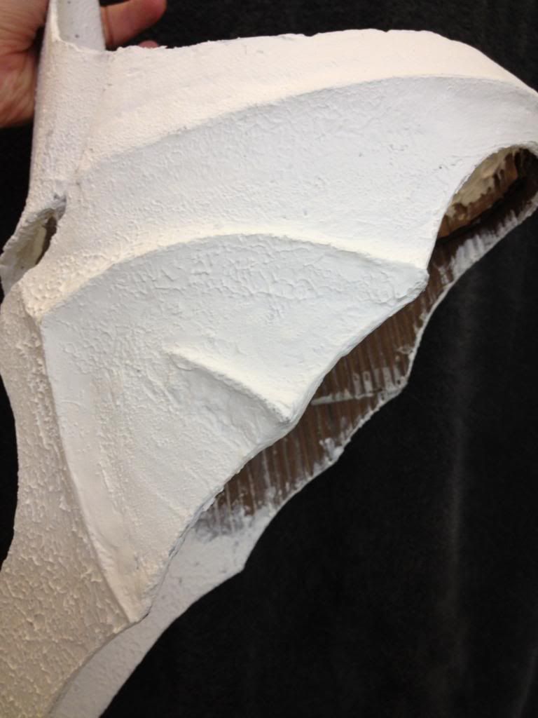

I used plaster based spackle to make the embossing because it can be easily smoothed with water (the exact name is "perfax reboucheur instant" from "Henkel" it's an instant repair filler like Polyfilla). I used it all over and did not smooth it completely to keep an uneven aspect. And I created a rough effect by stamping absorbent paper on the sticky wet surface:
Smoothing the rough texture on the edges by sanding. Placing all the pikes and the 4 rivets:

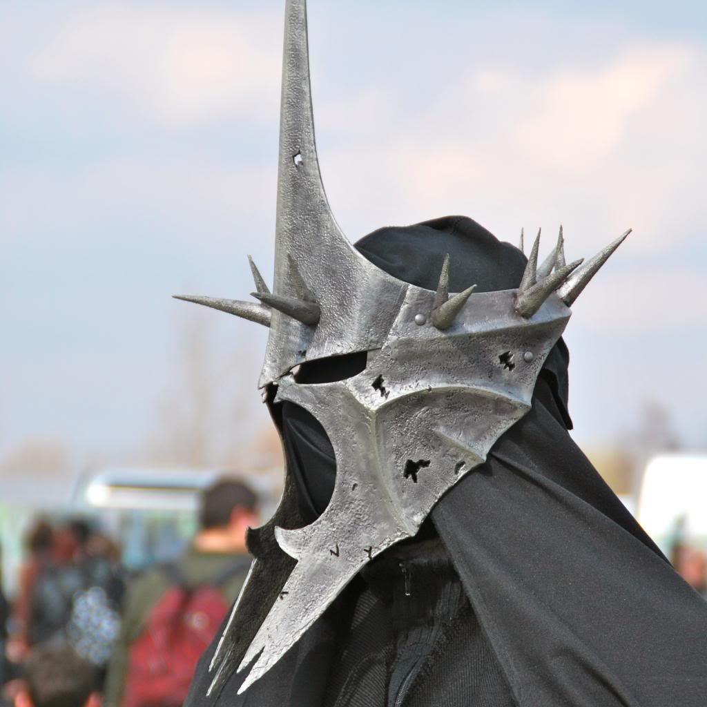

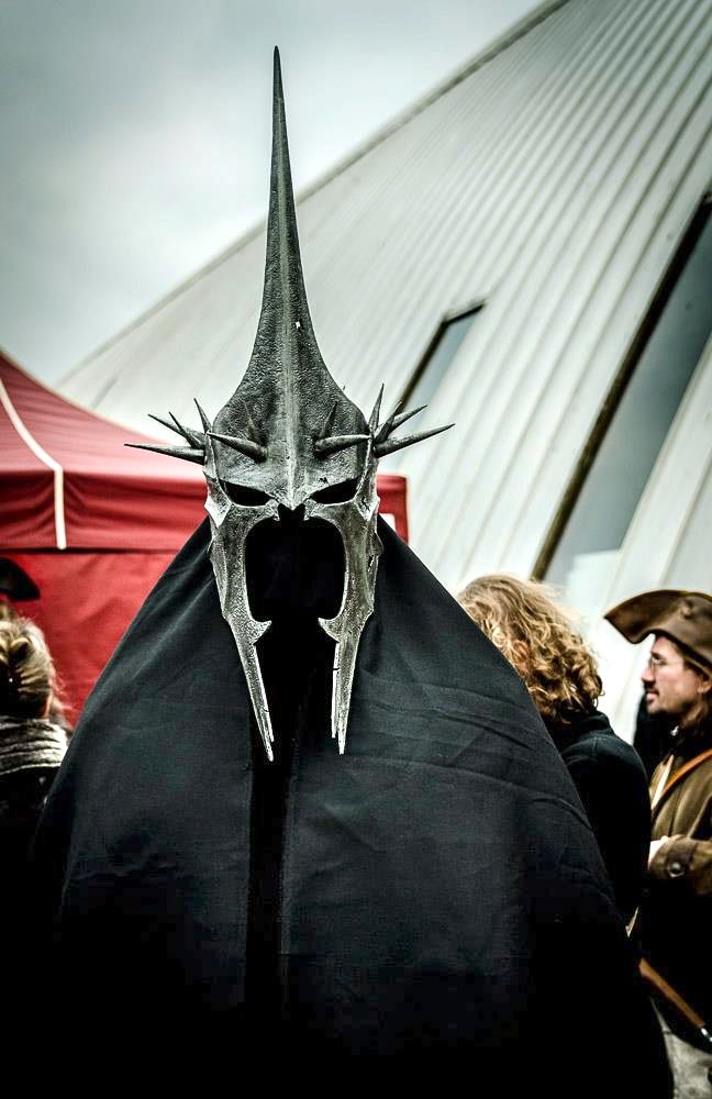

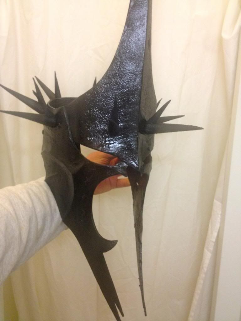

Here's some pics of the first outing with the finished helm and a black robe I quickly putted together with some fabric I had on hand.

It weights 600gr, don't know if it is light for a cosplay but I found it very comfortable compare to other costumes I have. I've spent 5 or 6 hours wearing it, I only took it of a few times to eat & drink and for some girls that requested to see my real face
The resin treated cardboard is still a bit flexible but the spackle is not (being made of plaster), should the helm fall over I think the spackle embossing would suffer greatly. I have to try some other similar product next time, I know there is "flexible" spackles…

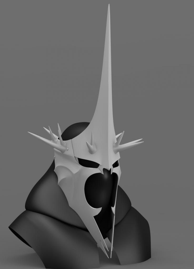

Then I made a 3D model for better accuracy.

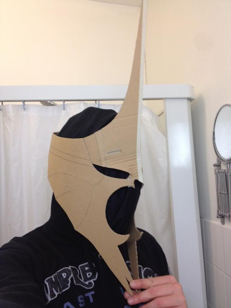

I then redrew the basic shapes I would need to create the helm. And cut them out in 2mm corrugated cardboard.
If I had simply put the helm on my head covered with a hood, the headband would have been visible. So I placed the hood of a sweat shirt and cut it below the headband. That fake hood is to be permanently attached to the helm.
To hide my face I used a deep black woman's half-slip I could see trough (throw your jokes away guys

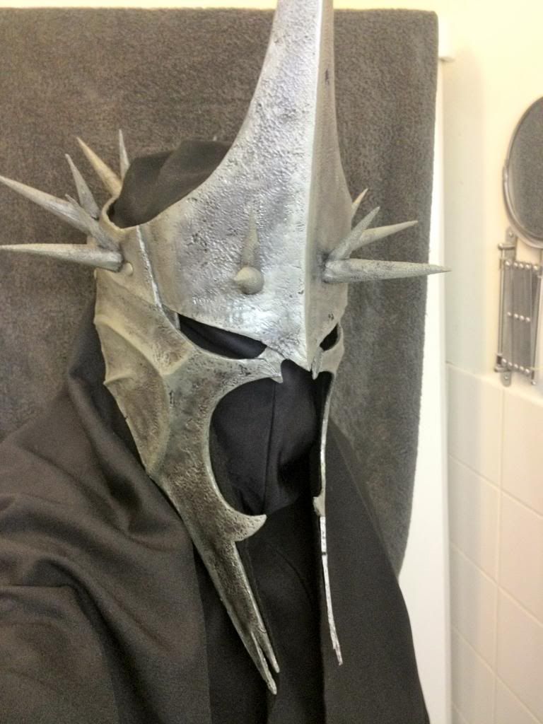

Dremellization (as I call it) of the holes and surface details:
A base coat of black:
A two shades dry brushing, one dark gray metal all over then a light gray metal only on the protruding edges:
