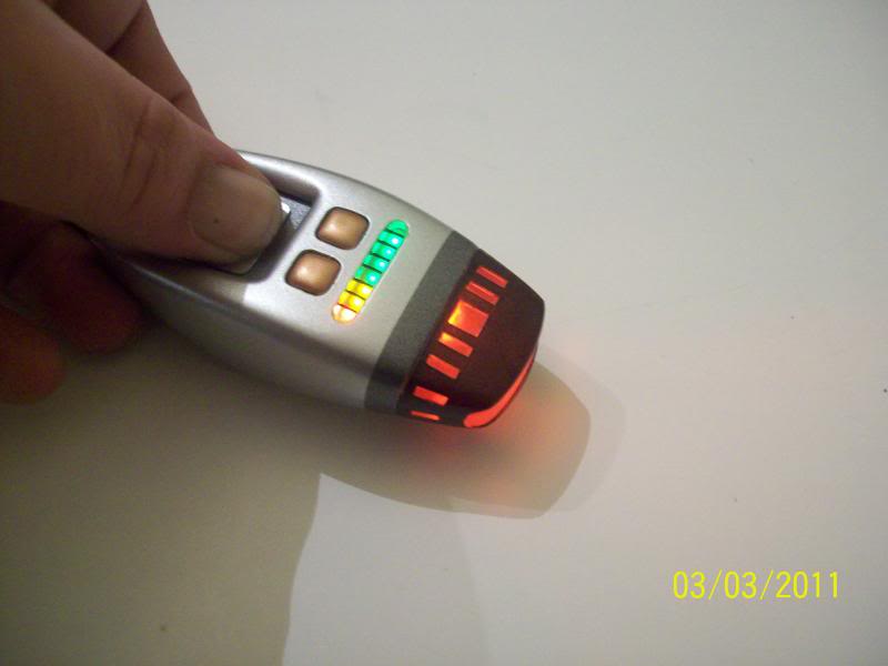

Well, for a little insperation, here is one of the two I did.

Your moving along well on this. I used automotive DupliColor brand paints on mine. They gave me a nice hard finish that holds up to handling quite well. Trust me, when you get this done, your going to play with it a lot!
Your build is motivating me to finish my rebuild of my second Cricket with scooped out emitter!
When I get home from work today I'll post the names of the colors I used.
O.K. I dont have the cap for the silver, but I think it was called "Bright Silver" and was listed as a GM color. For the band and the thumb pad I used DupliColor "BGM0536 Gunmetal Metalic (83 WA8915) Replaces T177". I know the band is supposed to be a bronze color but I couldn't find anything suitable.

I am using a different silver, but it still GM one. I like the look of it.
