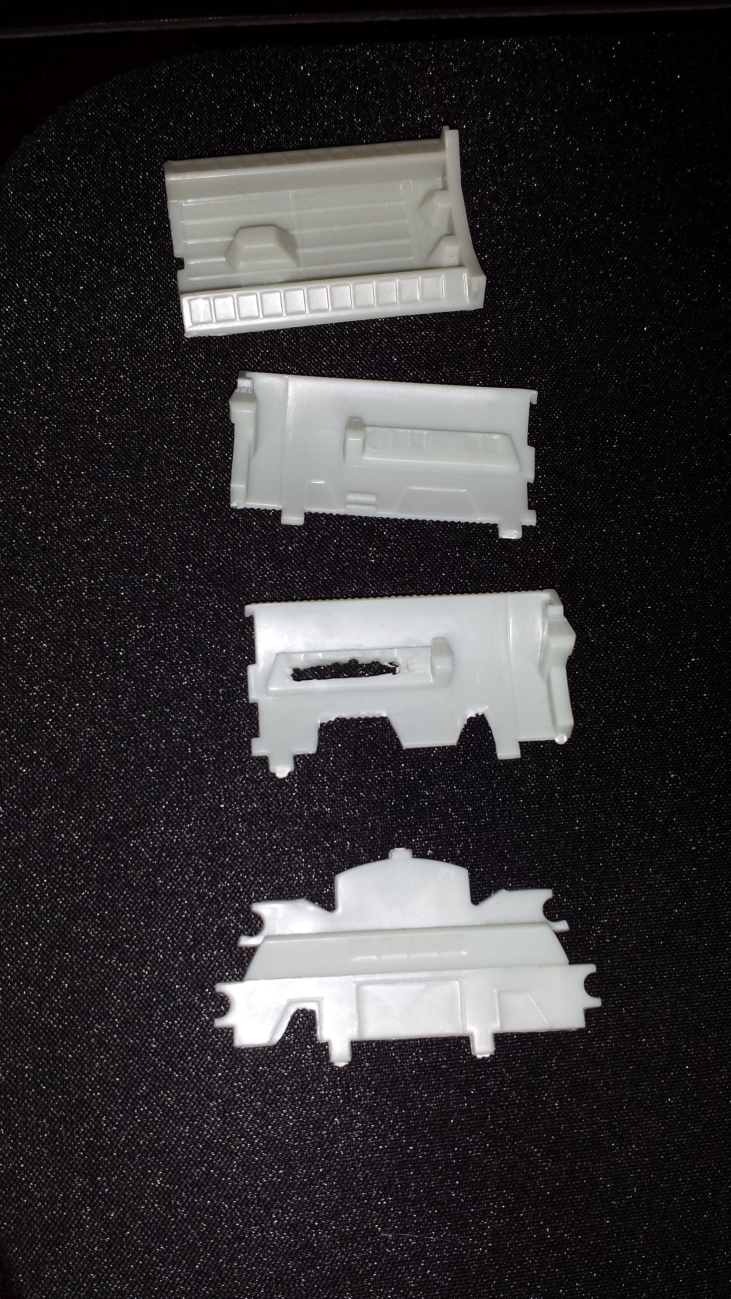

first pic.jpgSo here's the plan, I figured I would start with the interior. The shuttle will go in last pending my final colour choice for the exterioras they should obviously match. I was going to cast these in clear so the little control room windows would be lit but decided it wasn't worth it and will leave these windows dark as the doors are supposed to be closed anyway and just open so you can see inside and there would not be anyone in them unless you are launchinchin a shuttle anyway.
I've got the Paragrafix PE set so I decided to cut out the windows and then use the PE for the frames. I also decided to cut out the alcoves around the bay and will file them all and add styrene walls. Also I plan on putting the USS Enterprise decal on the wall above the door rather than on it so I can have the door partially open and add some detail behind it.
For the ceiling I am just going to cut out the lighted portion again using the PE frames and replace it with clear or white, whatever looks better.

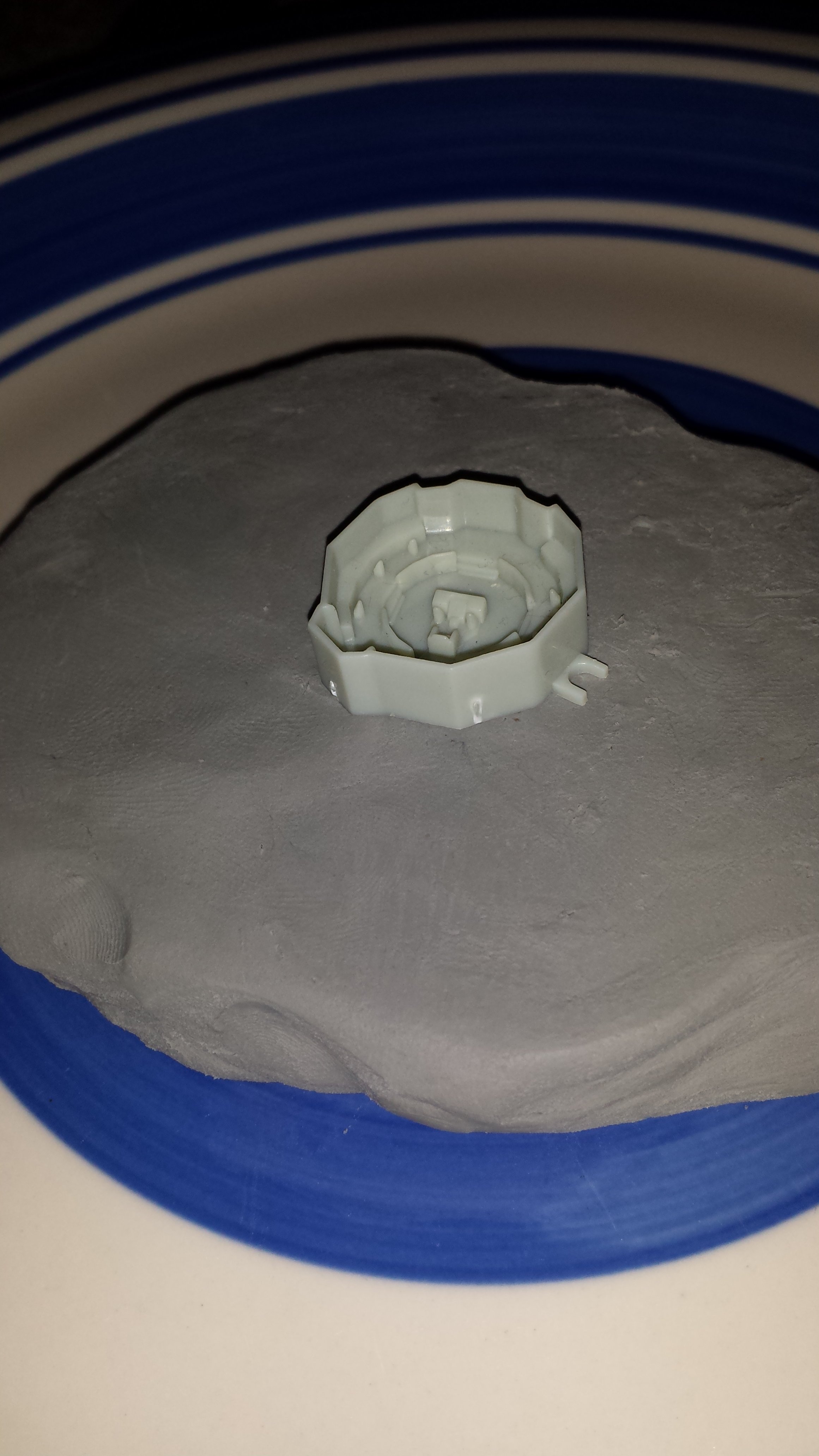

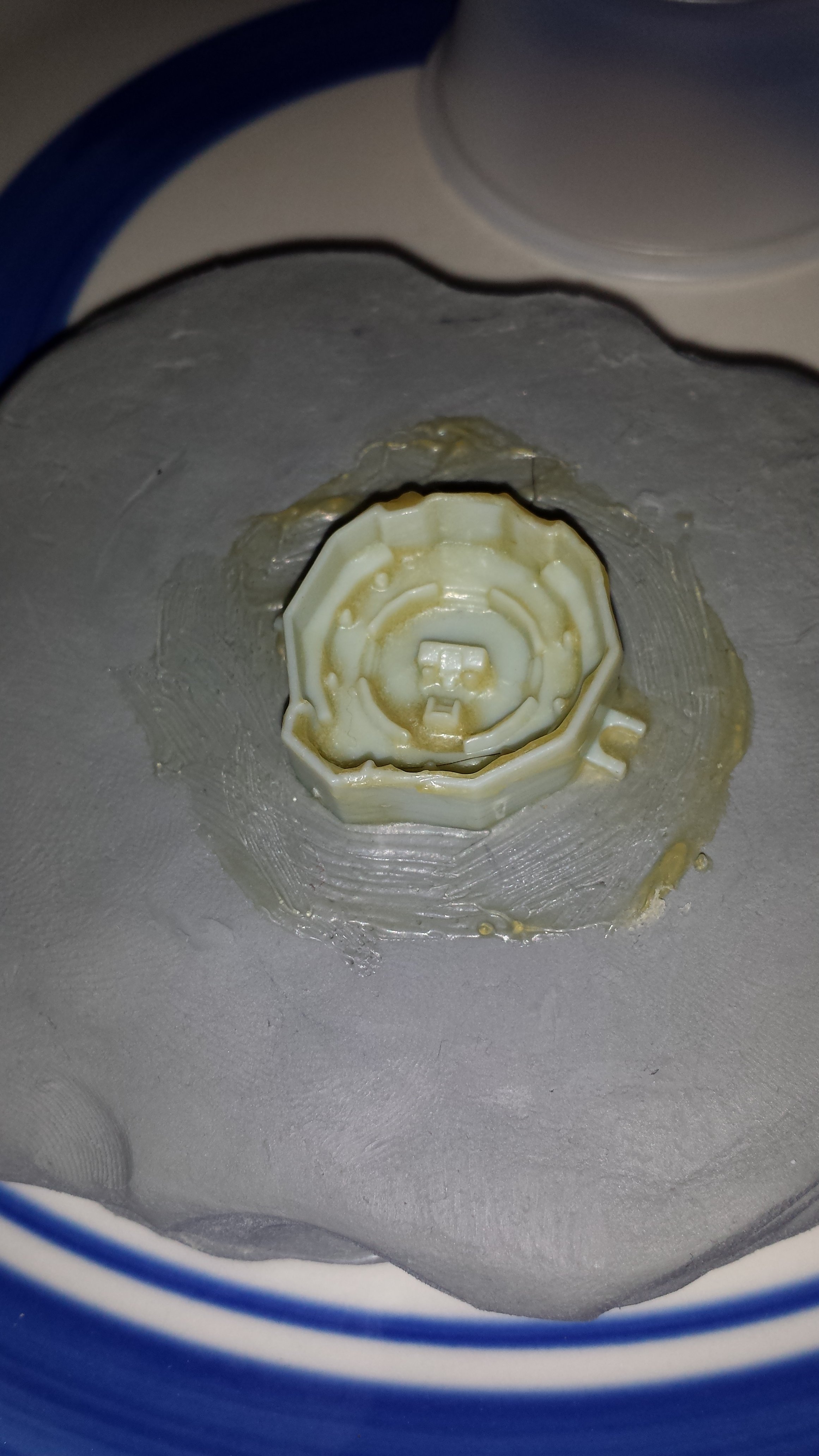

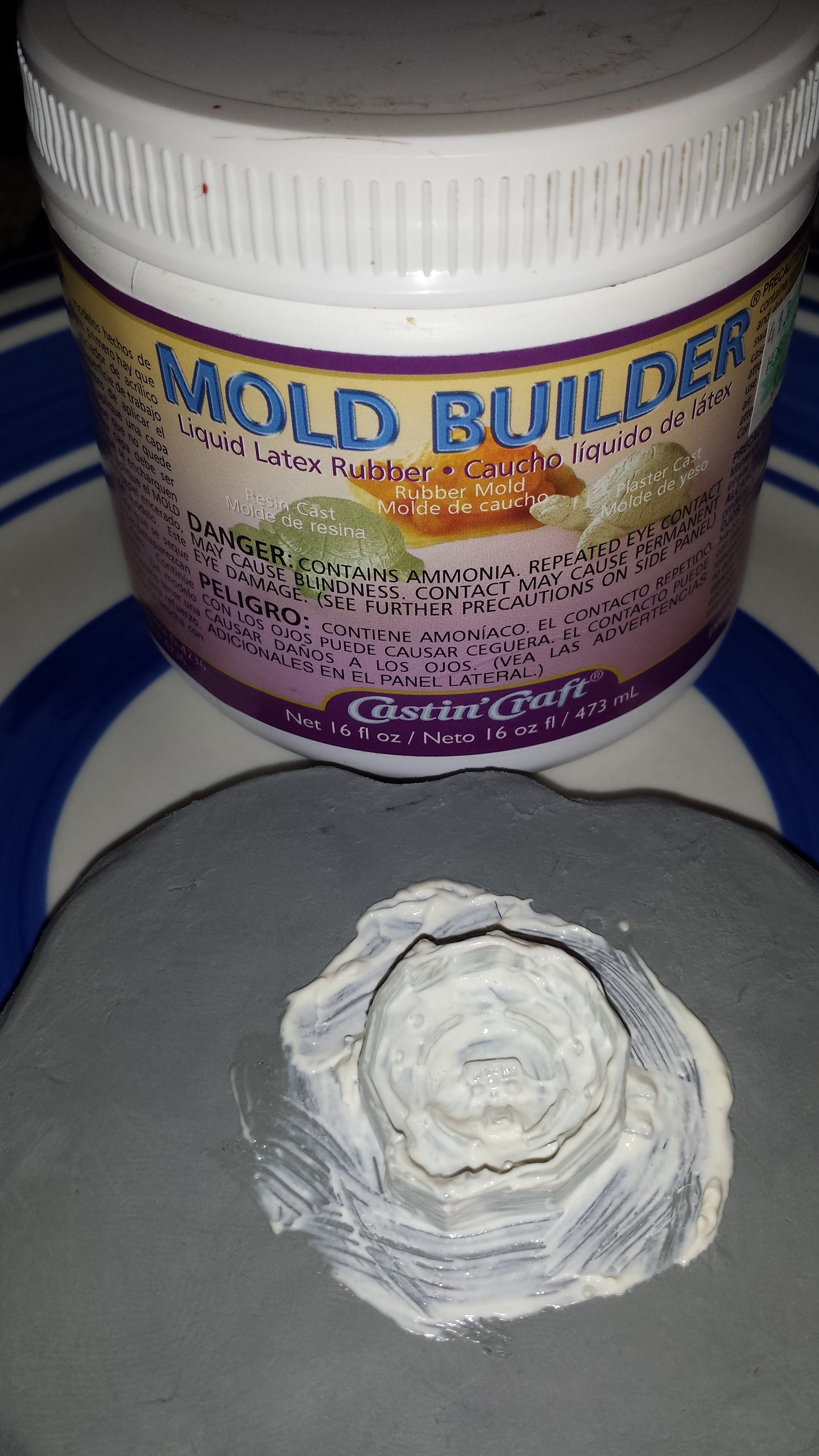

Well, since I am too cheap to buy the lighting set I bought clear casting resin and rubber from A C Moore to cast the bridge in clear resin.
Here is the bridge sitting on plasticine and a shot with the first coat applied by brush so that there will be no air bubbles in the mold. I will apply 3 layers and then pour the rest of the mold.

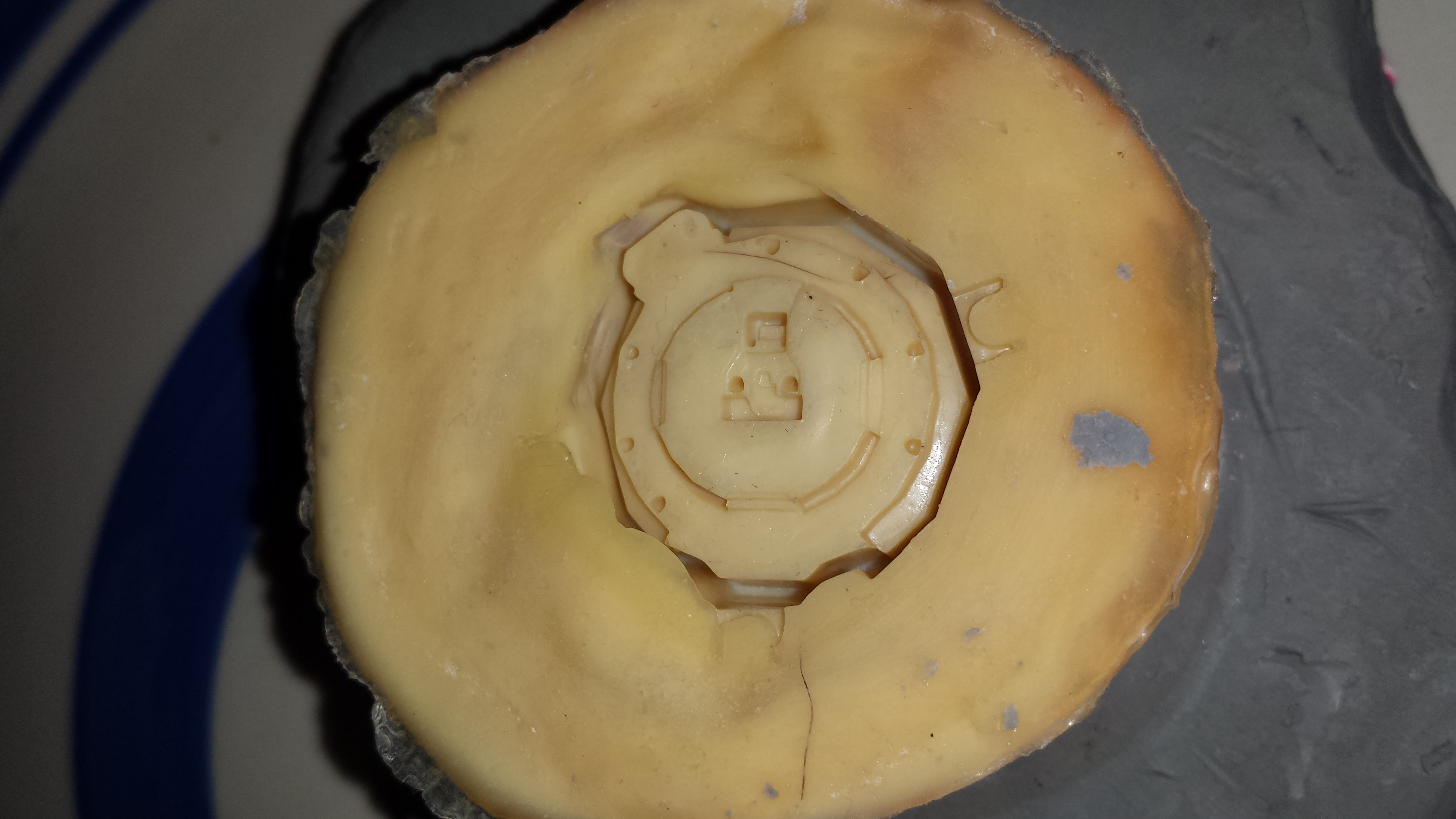

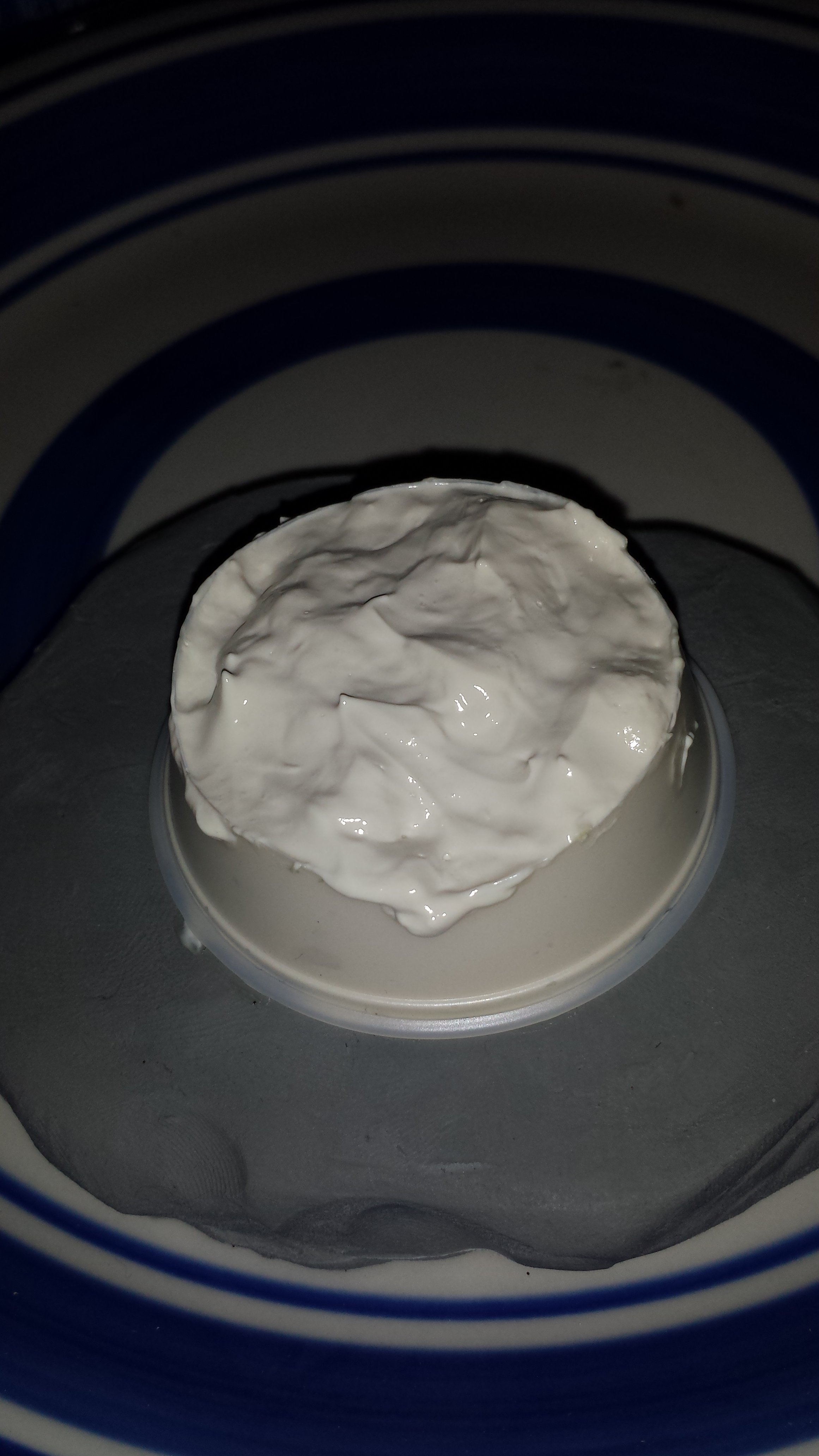

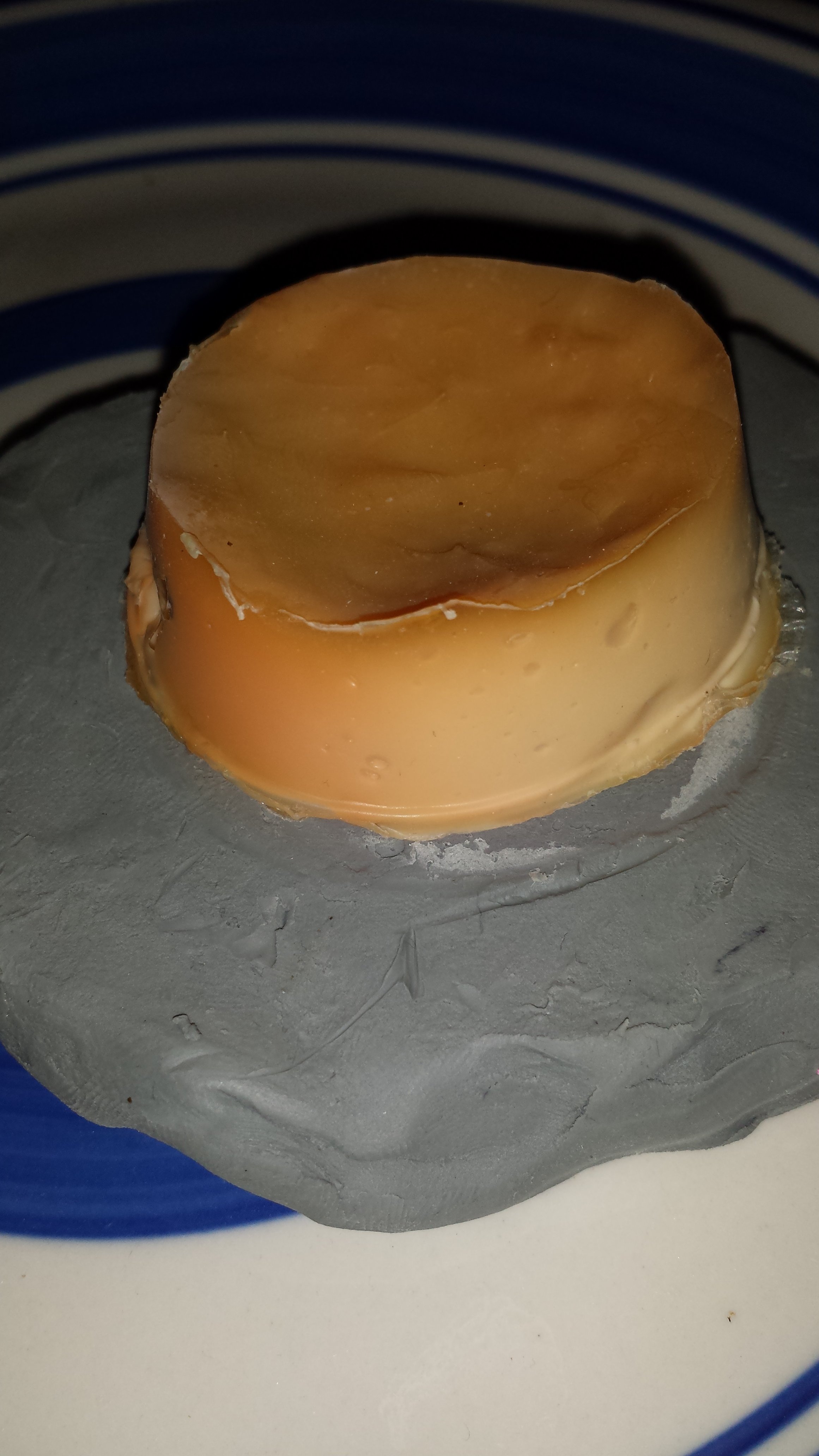

I became impatient with painting on the silicone and now I am forced to wait for it to dry because I applied it in one thick coat!20150308_181923.jpg20150310_190527.jpg
Well, I finally de molded the bridge!
I had to wait so long because the mold didn't look dry in one half but I could wait no longer! luckily enough it seems to have worked and I have poured the resin which just as the name implies is crystal clear. I will take that out of the mold tonigh and post a picture of the results tomorrow.20150408_202937.jpg20150408_203019.jpg

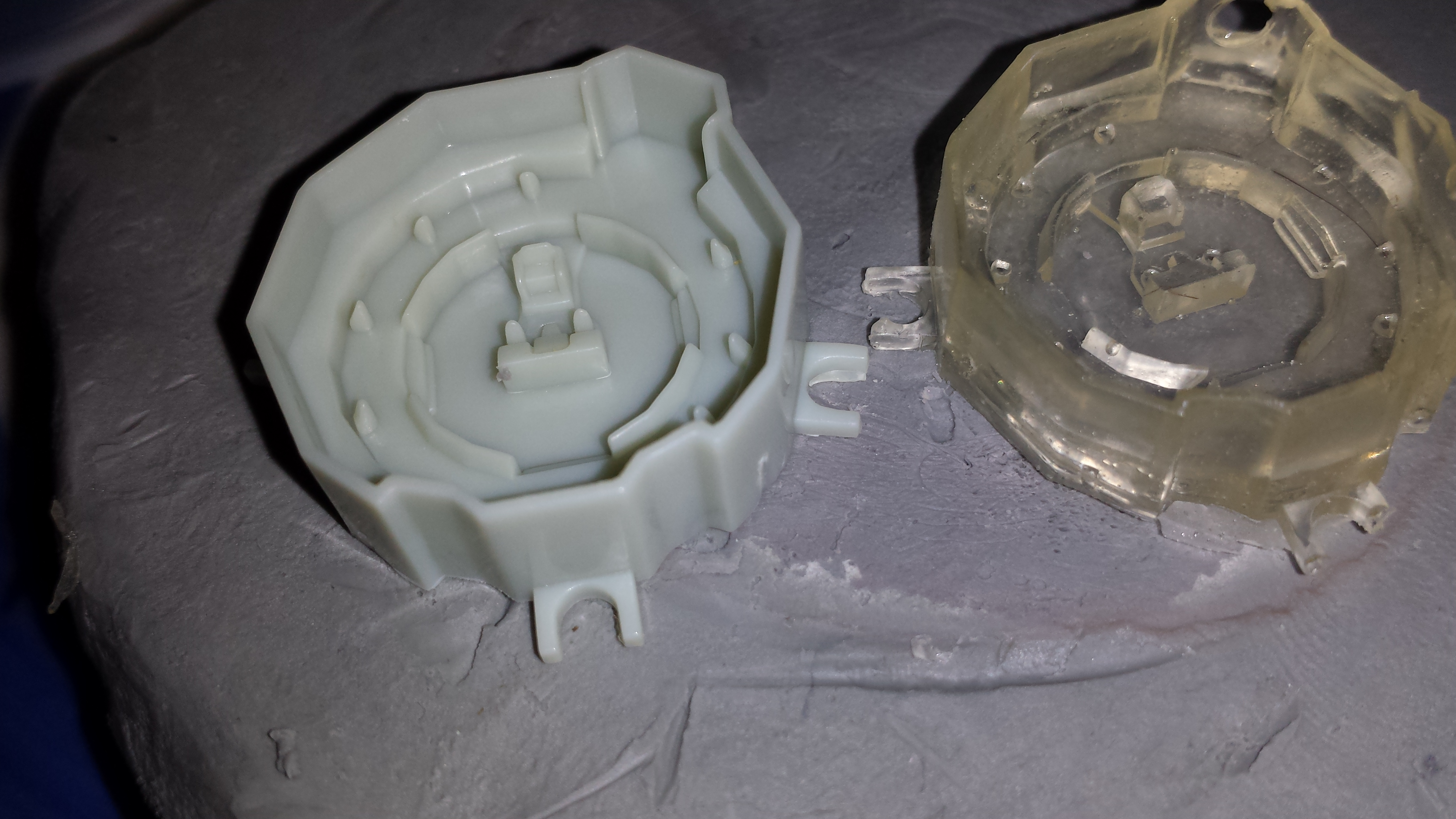

Well, after carefully working the bridge out of the mould because I didn't want to risk a mould release agent reacting with the resin I have my first clear bridge!
it was still somewhat soft and I had to work it by hand to retain it's shape but it has since hardened nicely!
as you can see though, the problem is the chairs did not come out eventhough I pushed resin into them with an old 000 brush!
Also there is a large circular void where the torbolift doors are.
I could just fill this hole but not sure if I should just remake new chairs or try a second moulding?
