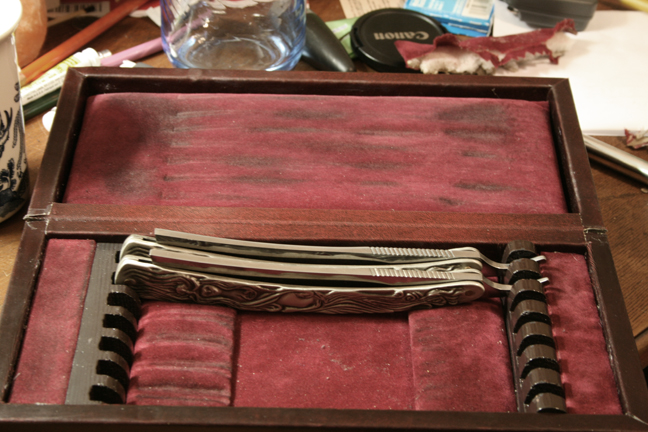

the replica in this thread is the 2008 NECA replica. No. 353(not sure) of 500. The replica came with one razor and I purchased the second razor some time later. I plan on filling the last five spaces with the cheaper- but identical- knockoffs from ebay(saves me 130 dollars).
This is a very well done replica. It was originally advertised as a wooden box but the product is actually a soft, faux leather. The leather texture is actually accurate as the screen used prop was a leather covered box, not just wood. The only few inaccuracies are as follows:
-The velvet "brackets" on each side sat lower on original prop. On some of the NECA boxes they sit too high and some even sit just above the edge of the box. (As shown in the first picture.)
-The original box had hardware. A brass nob, a stationary- I think- latch, and a small catch on the lid for the latch. I think the latch held the lid by tension.
-Obviously the original prop had some weathering.
So far I have addressed the first and third issue a bit. Of course there is more work to be done.
The razors do not close as fully as the original props did so the replicas have a very different look when they are closed. I will work on this as I have time to and will post progress here.
The first picture is before working on the bracket. As you can see, it sits too far up and the wood underneath the velvet is exposed.
To lower it, I first removed the bracket(image 2). It was glued in there pretty well but I wasn't worried about pulling the lining up as I could glue it back down later.
The problem was that the stuffing in the lining was pushing the bracket up(image 3). The lining is stuffed with foam attached to a bit of cardboard. I cut out the foam and cardboard out from the area that the bracket rested on(image 4).
After you do that, the bracket should sit at rock bottom, save for the bit of space that the lining takes up.
Note, I did not cut the lining out- it can be seen through the slats. I simply removed the stuffing from it so the lining sits flush with the bottom of the box.
That's all for now. You can see some of the weathering I did on the lid, but it needs more work.
Thanks for looking!

Just finished working on the right side of the box.
First, I removed the block. The bracket is attached to the holder slats. In picture 3 you can see that it is actually nailed on. I pried that apart because on the original prop, it appears that the bracket is lower than the slatted holder.
Instead of removing the nails, I simply rested the slatted piece on top of them(making sure everything was even) and glued it in place. This puts the holder up a bit and the bracket lower.
I then removed the stuffing from the area so that the bracket would sit flush with the bottom.
Then I glued it all in and VIOLA!
I really prefer how this looks, it looks a bit more real and antique with just a tiny modification.
I also worked on the weathering a little more. The original prop appeared to have black tarnish stains wherever the razors rested so I used the "Making of" book as a reference for the lid weathering.
Next up should be more weathering, getting the rest of the razors, and modifying those to be more SA.
Thanks.
