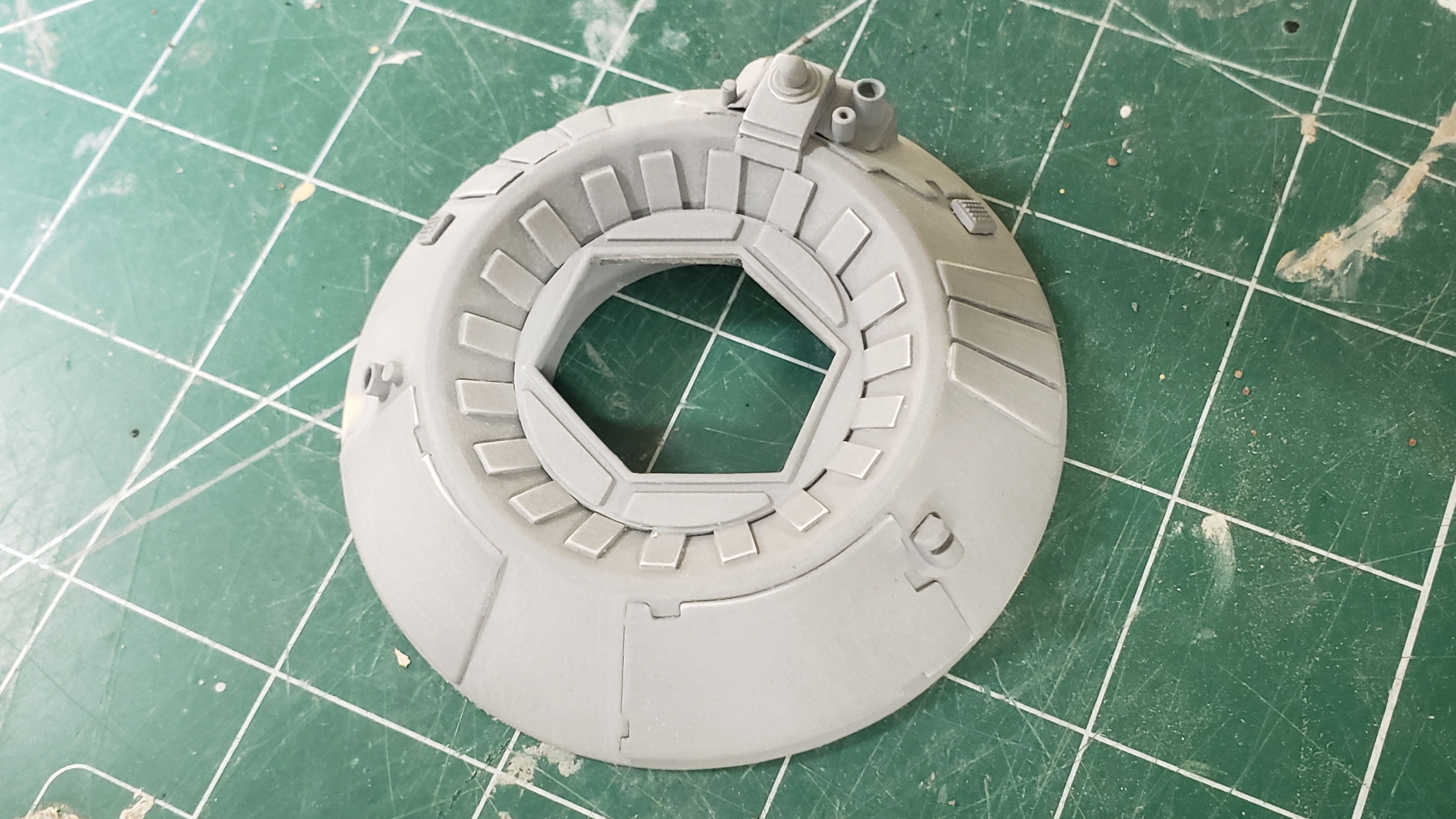

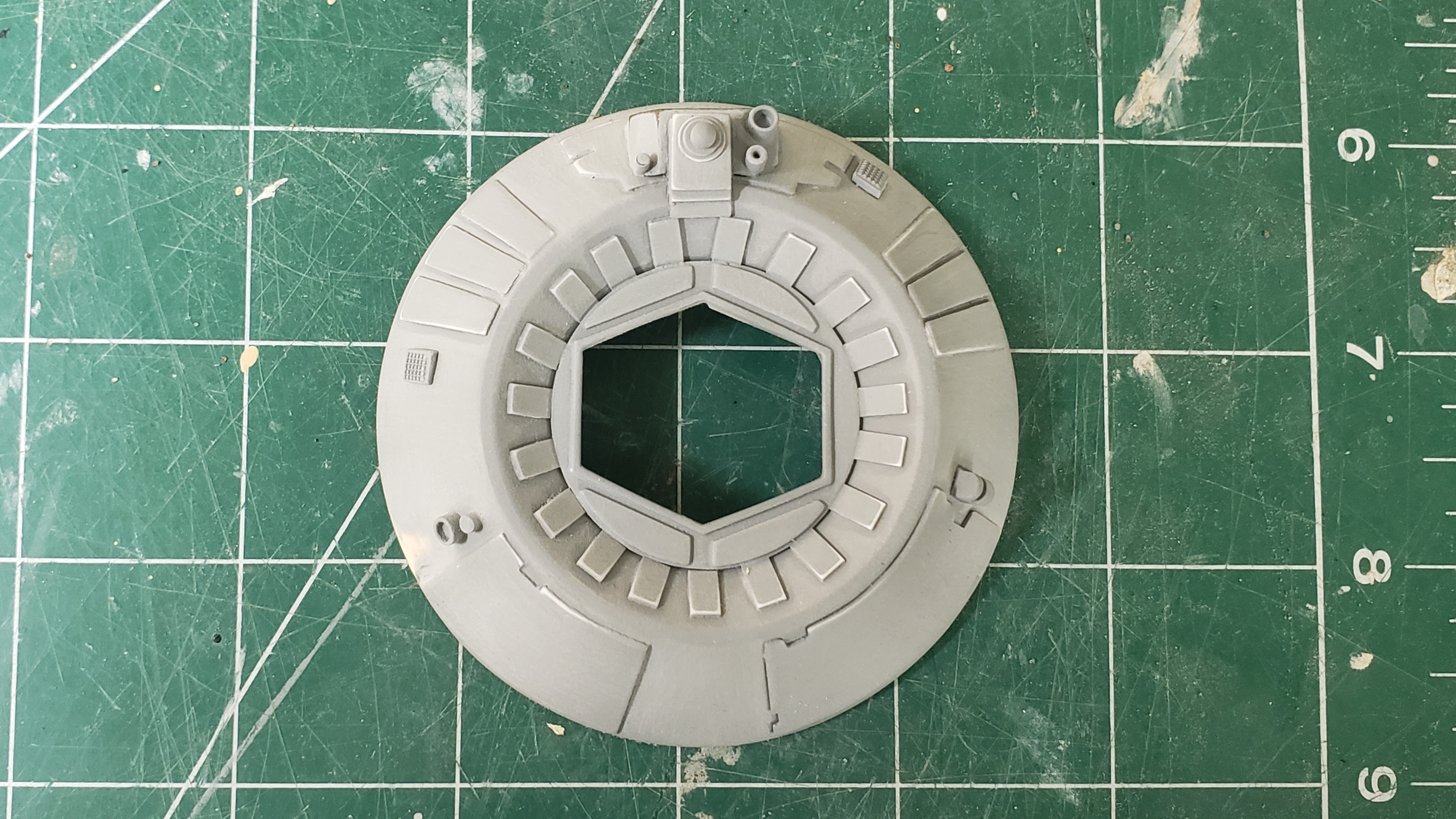

I've finally made some more progress on the TIE Fighter. Finished up the tail end master pattern.

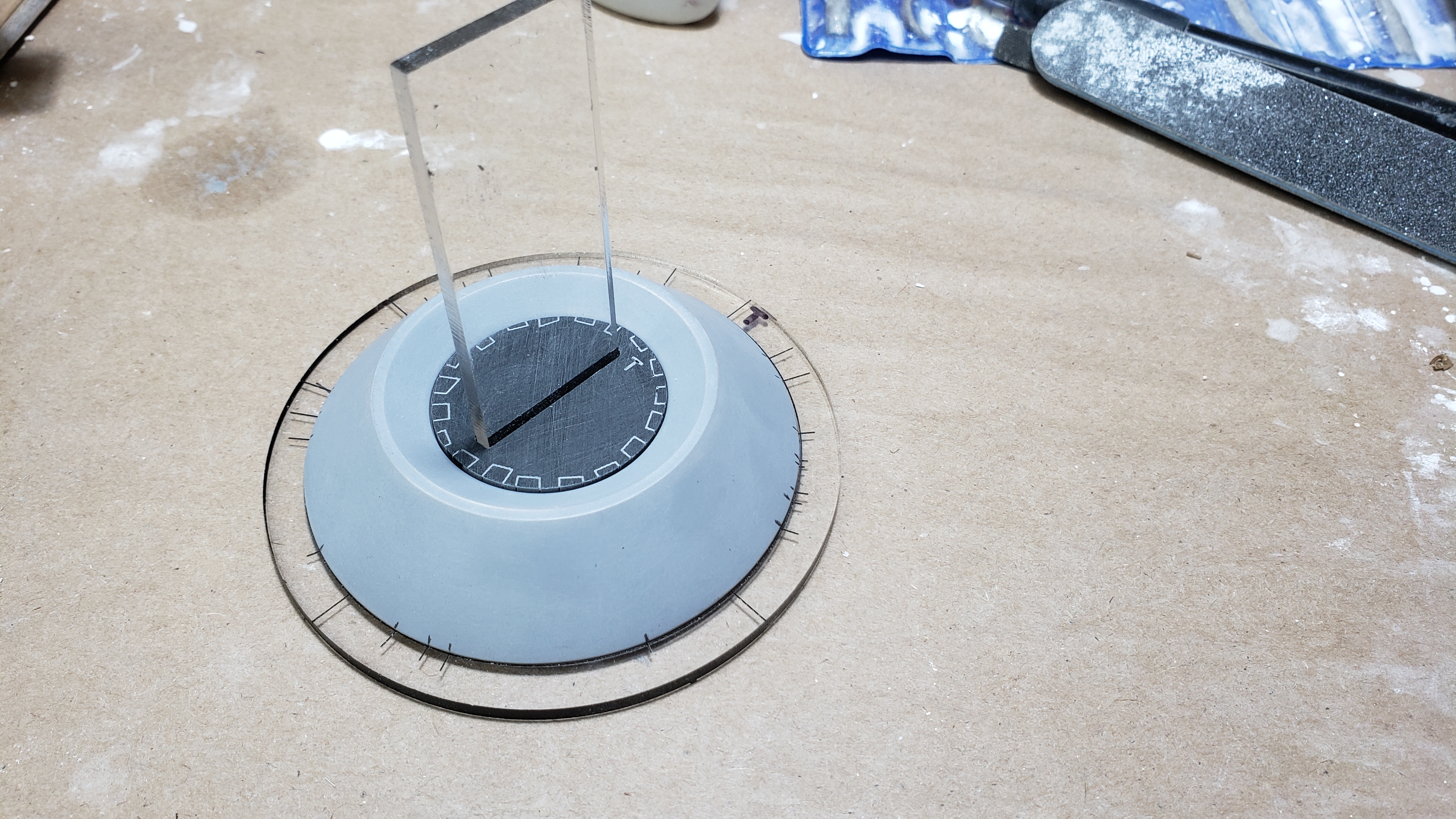

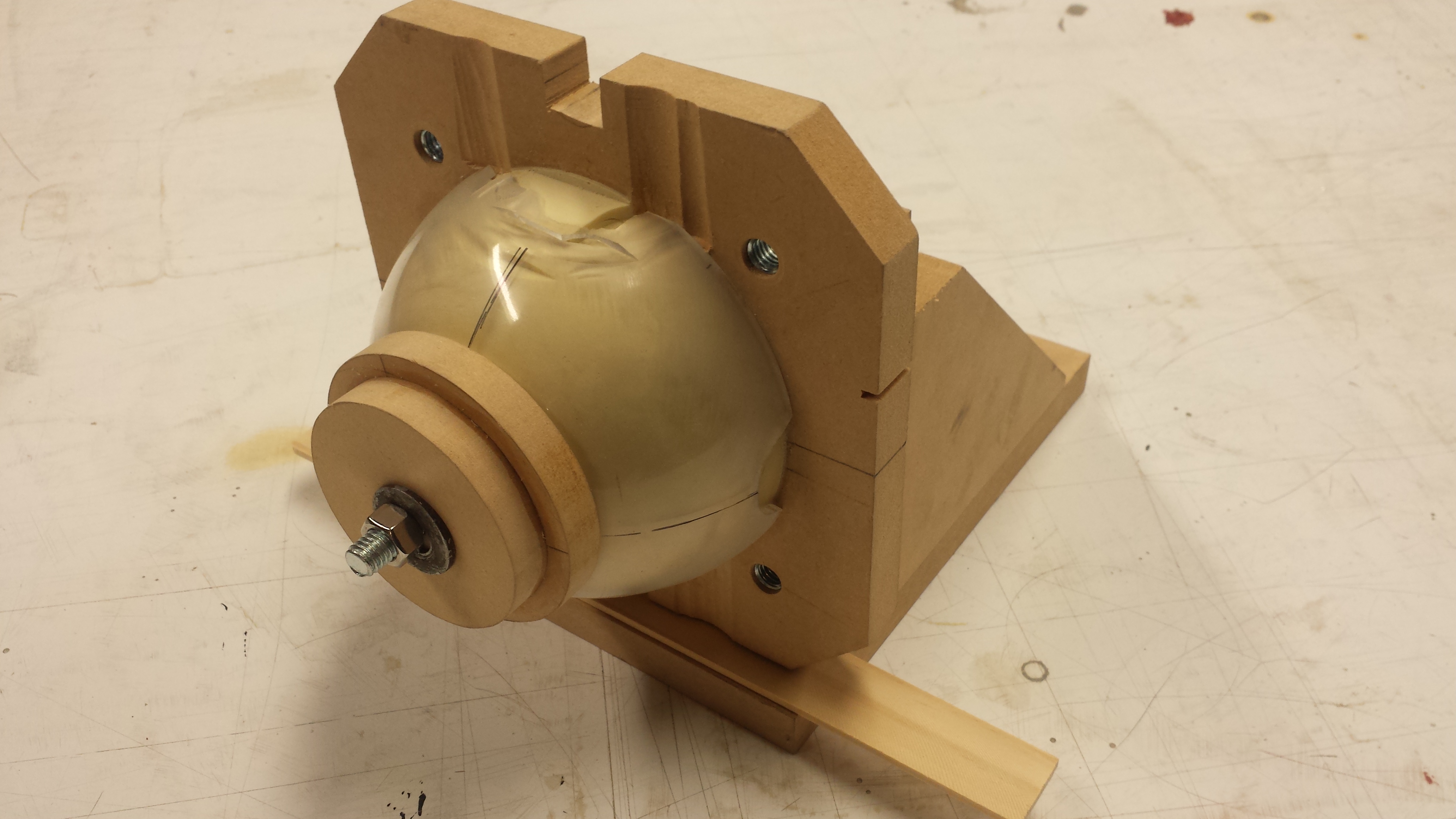

I have another question about how you cut your spheres. I understand how you cut you the openings on the top of the 2-5.25 balls, but how did you cut away the openings along the balls seam, where the 2 mate together? Did you cut them one at a time, or mount it into your gig again (that gig only held 1 half of a sphere)?
Also, how did you plot out and cut the armatures holes? By hand with a Demel, or on your mill/lathe? Thanks so much. And again, great build.
-emojo5
swgeek
Well to answer your question it's both. I did reuse the jig, but I altered it to mount vertically. I did use a dremel for the small holes where the pylon passes through. I knew those holes would eventually be covered up so they didn't have to be perfect. The bigger holes I did on the mill (which isn't my mill, I wish I had one, I have access to a few mills and lathes at work) one at a time.
The one thing I didn't include in the picture is the sacrificial brace I used on the right side. I found out the hard way that if I didn't brace the acrylic it would vibrate, catch and explode.
emojo5
Yes. That’s what I was thinking. Thanks so much for sharing this shot. Very, very helpful. Not sure what you mean about “the sacrificial brace I used on the right side”, but I can use this photo to help with my sphere cutting. Awesome work SWGeek. Thanks so much again. Be well.
-emojo5/Ed
Thank you.
I just mean I clamped a piece of mdf against the right side of the acrylic where I was cutting so it wouldn't vibrate. I used mdf so that if and when I hit it with the milling bit it wouldn't damage anything.

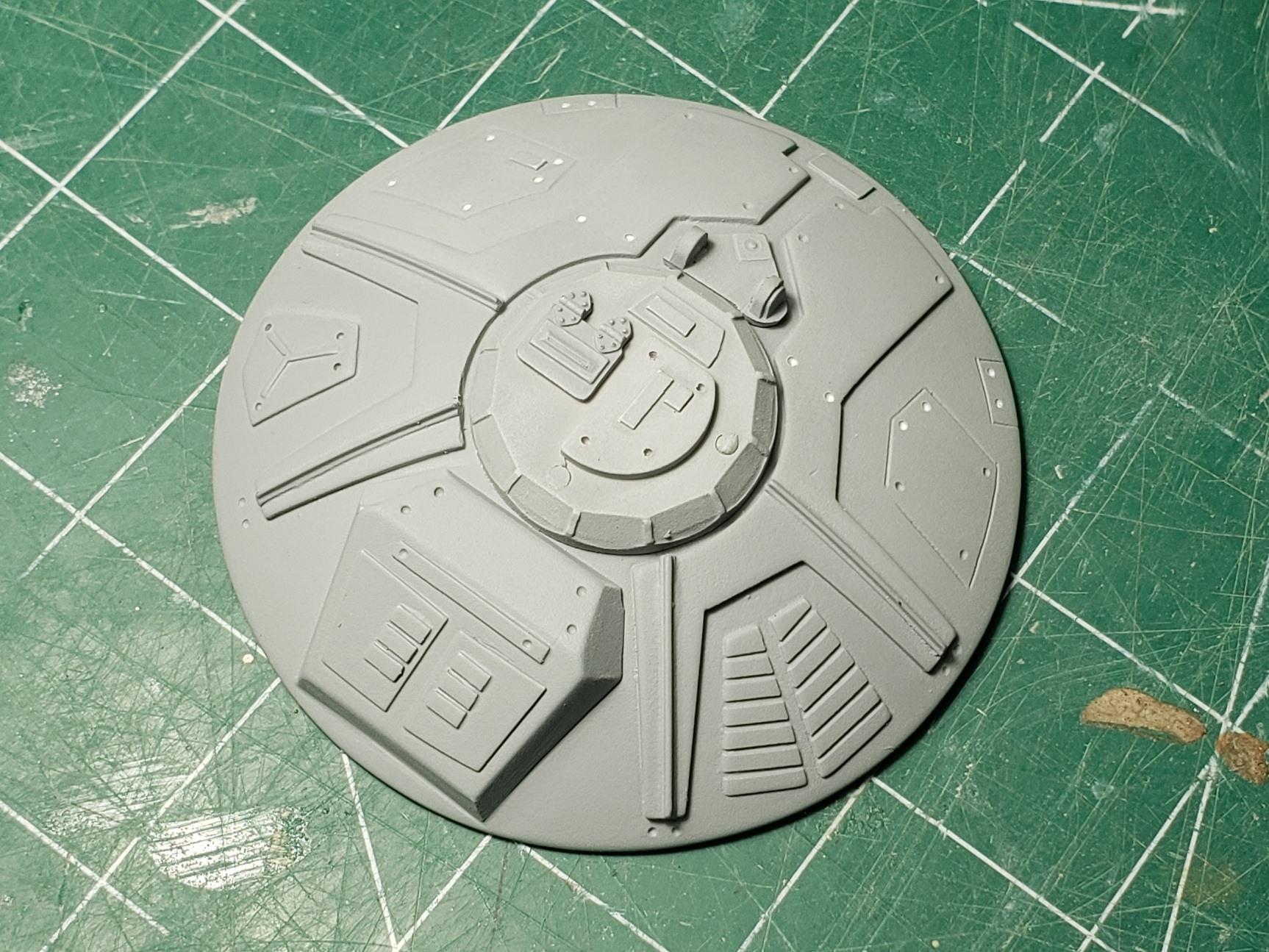

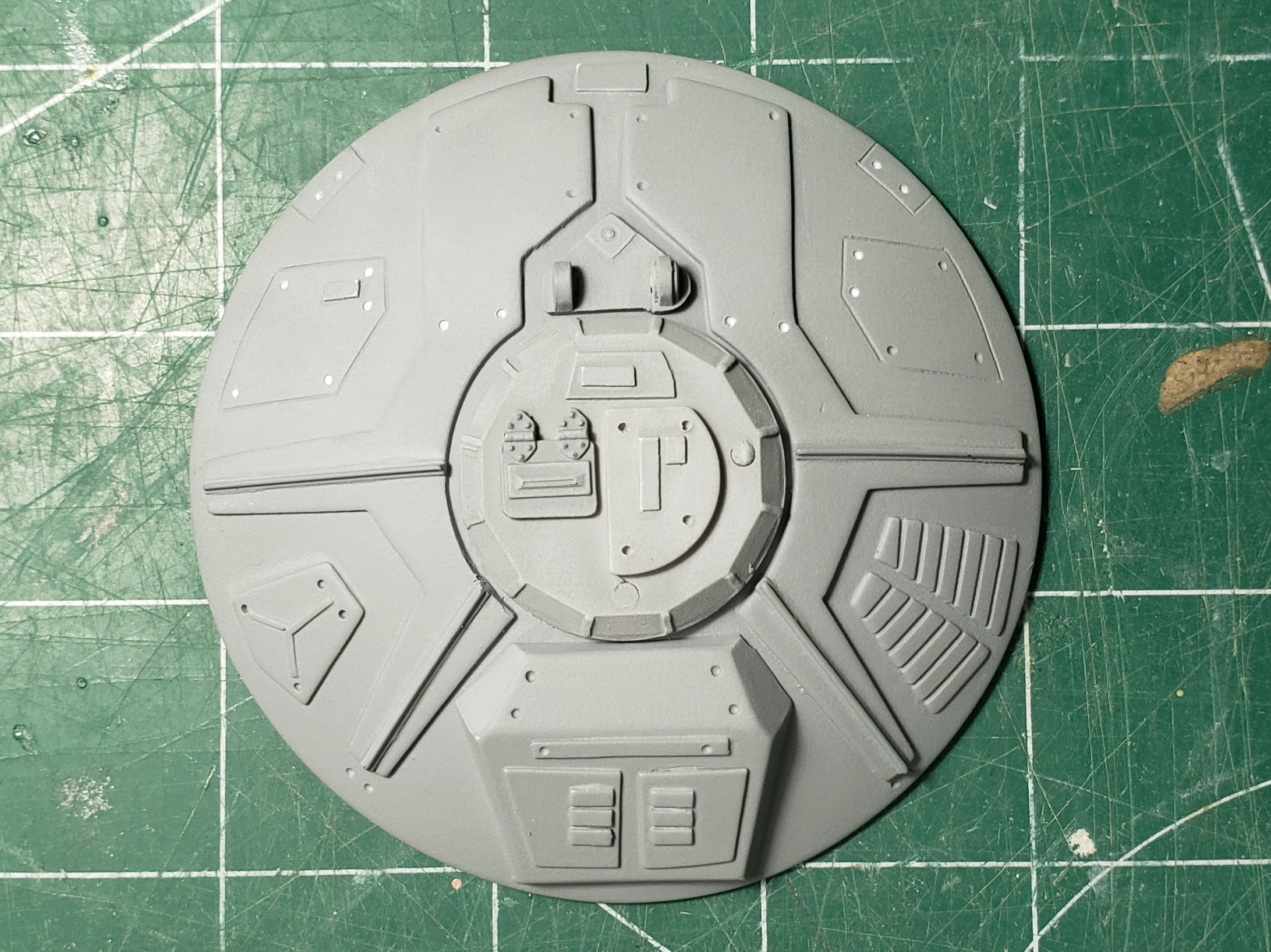

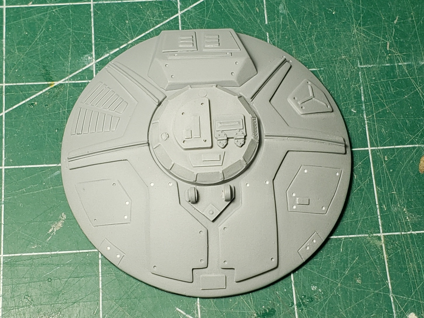

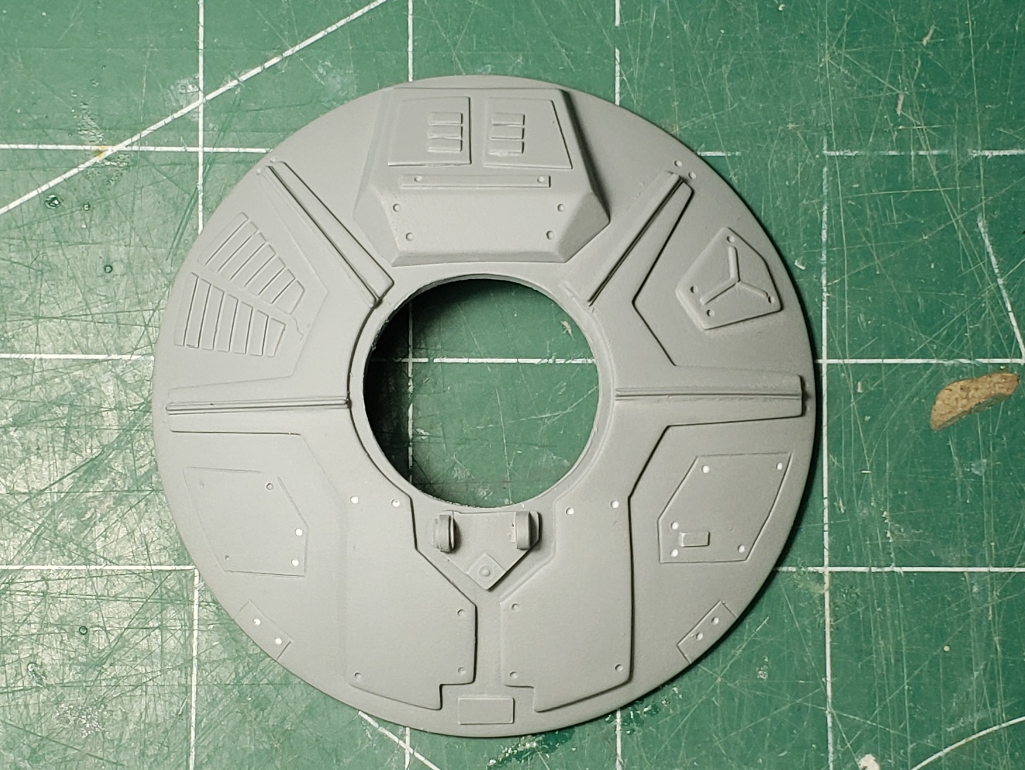

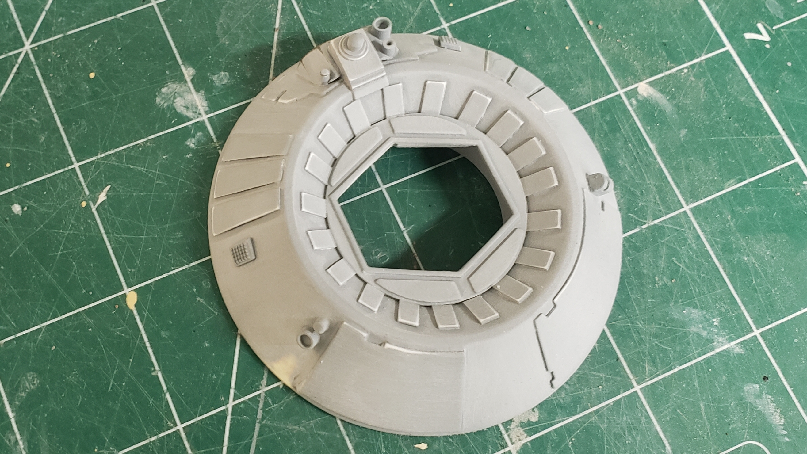

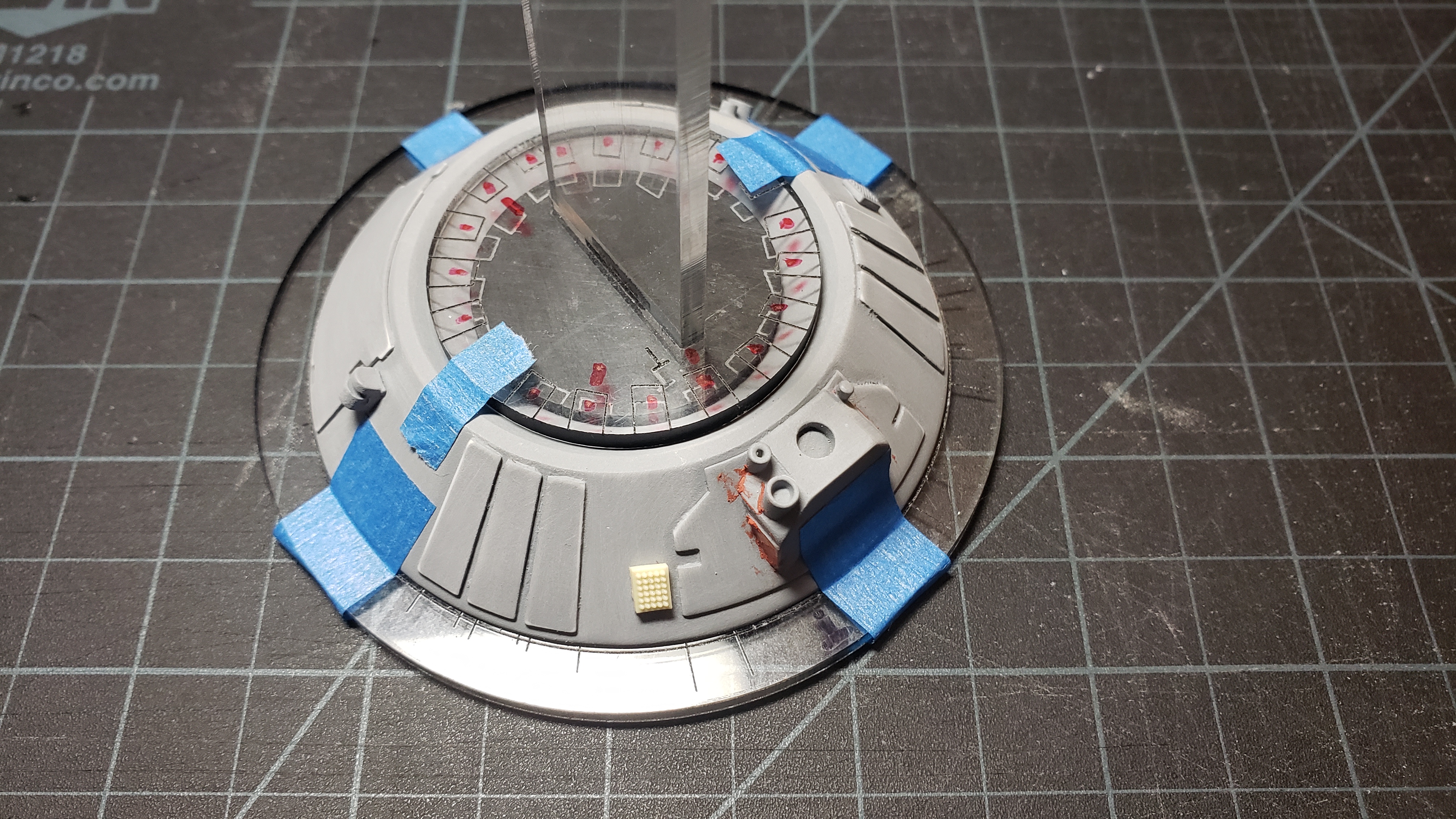

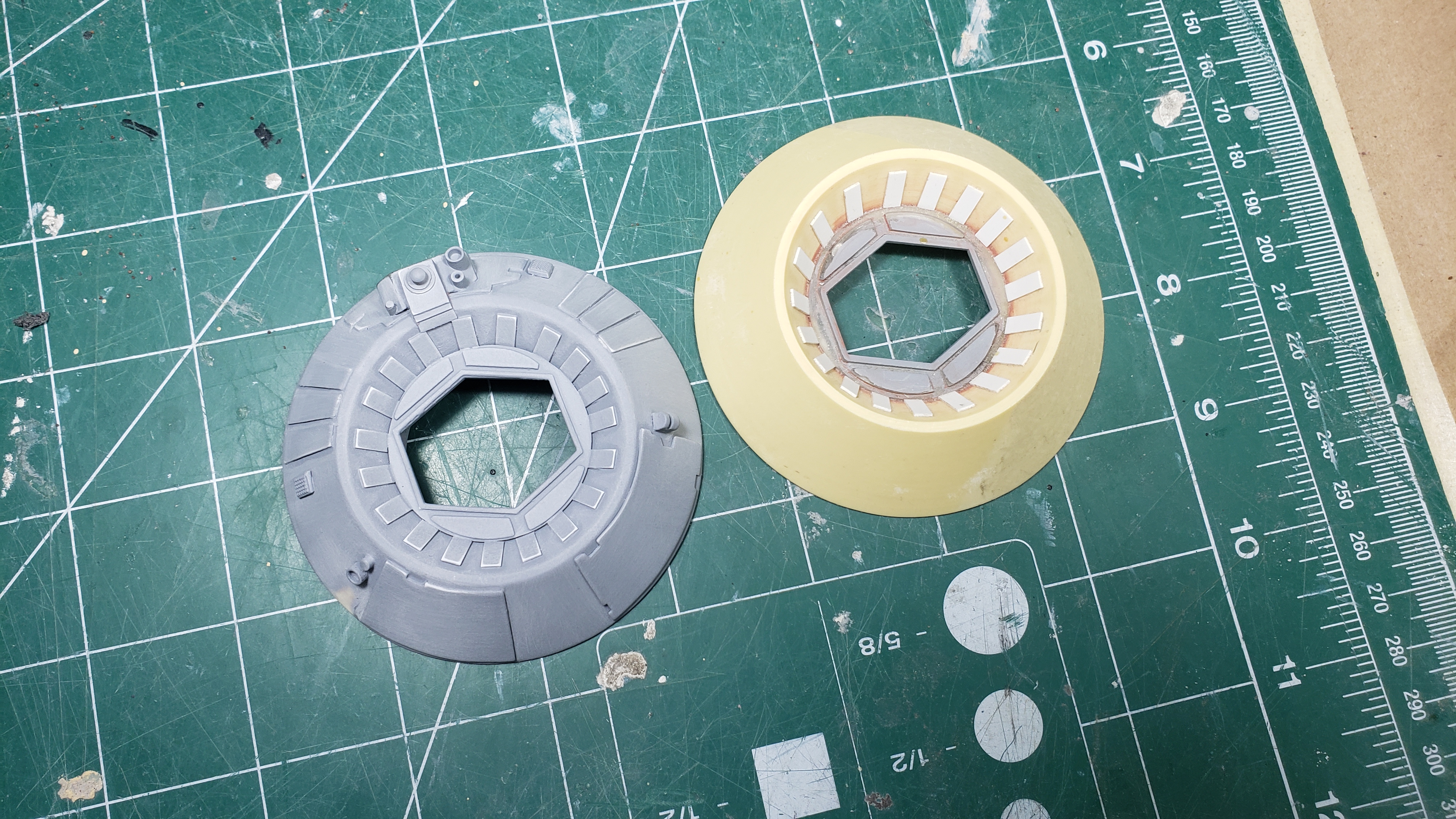

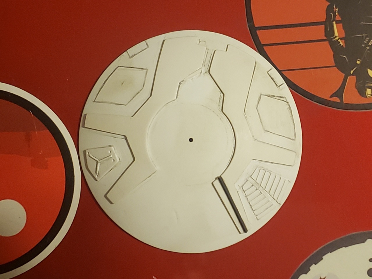

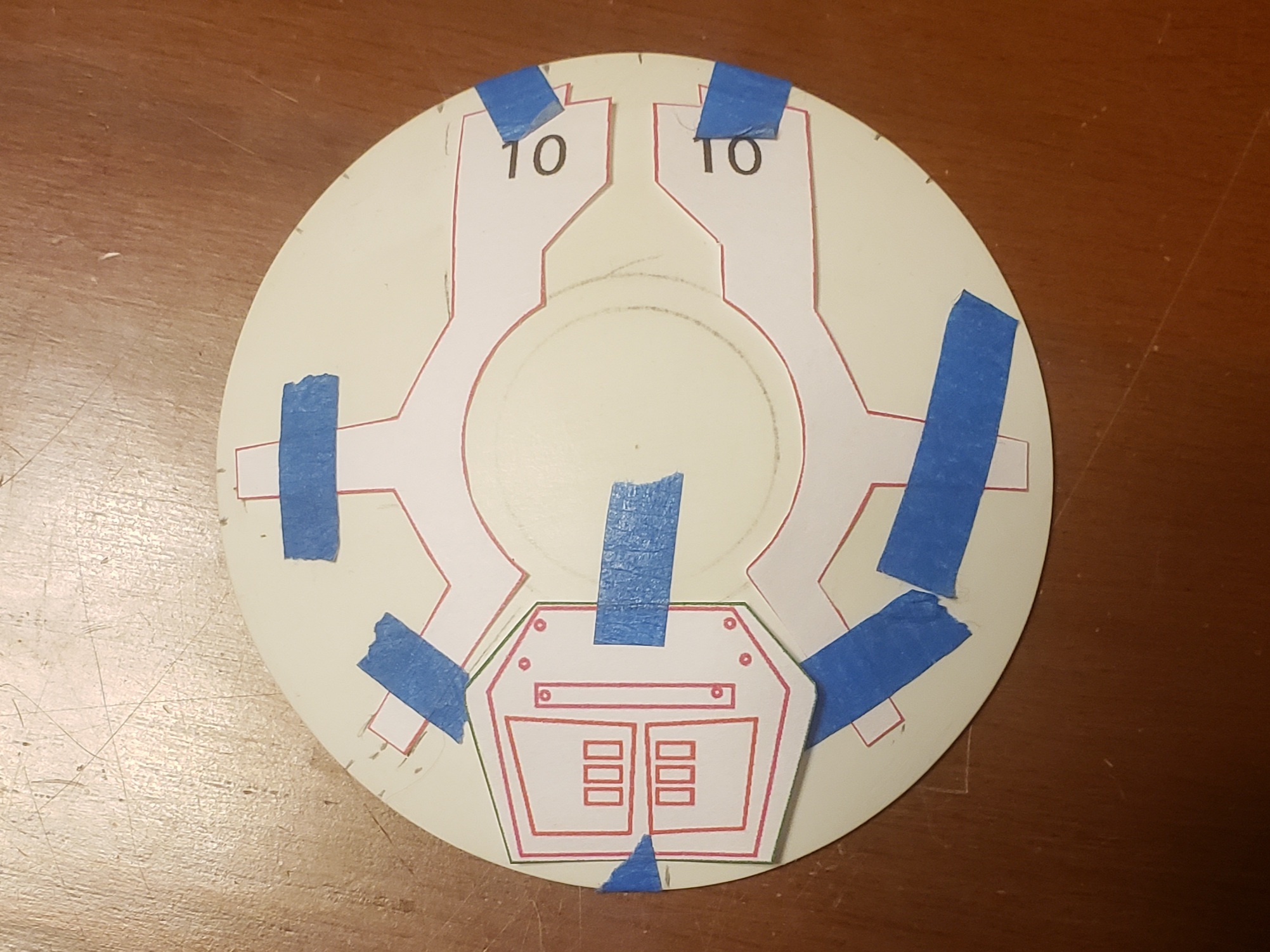

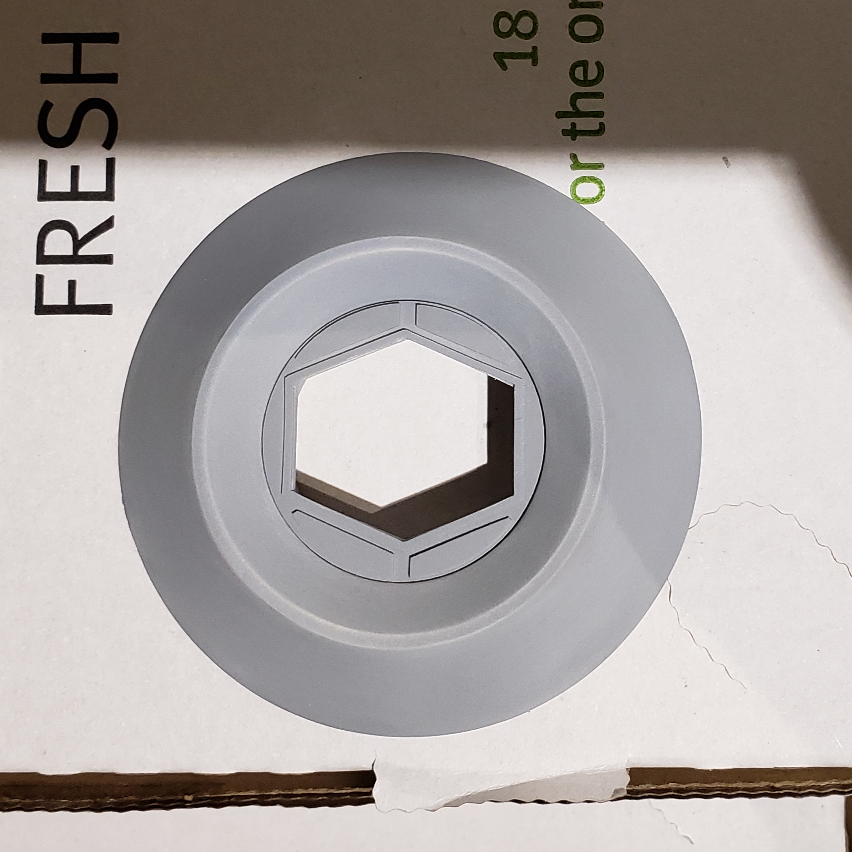

So finally more progress.
I got the bottom hatch/pylon cover done today.
This is the cover under construction.
I design/scale my parts in Adobe Illustrator and then print them out on paper to check scale and alignment. You'll see a number 10 on the top of the two plating pieces, that's attempt number 10 at getting the right shape and size. Things always shift a bit going from 2D to the 3D real world. It took me 16 attempts to get the plates "right". Lots of little adjustments and still more fine tuning when I got the actual parts cut out.
Next is more construction, this time with the real parts.
And finally the finished product. The little white spots are where the paint built up in the drill spots, so I redrilled them after the primer.
