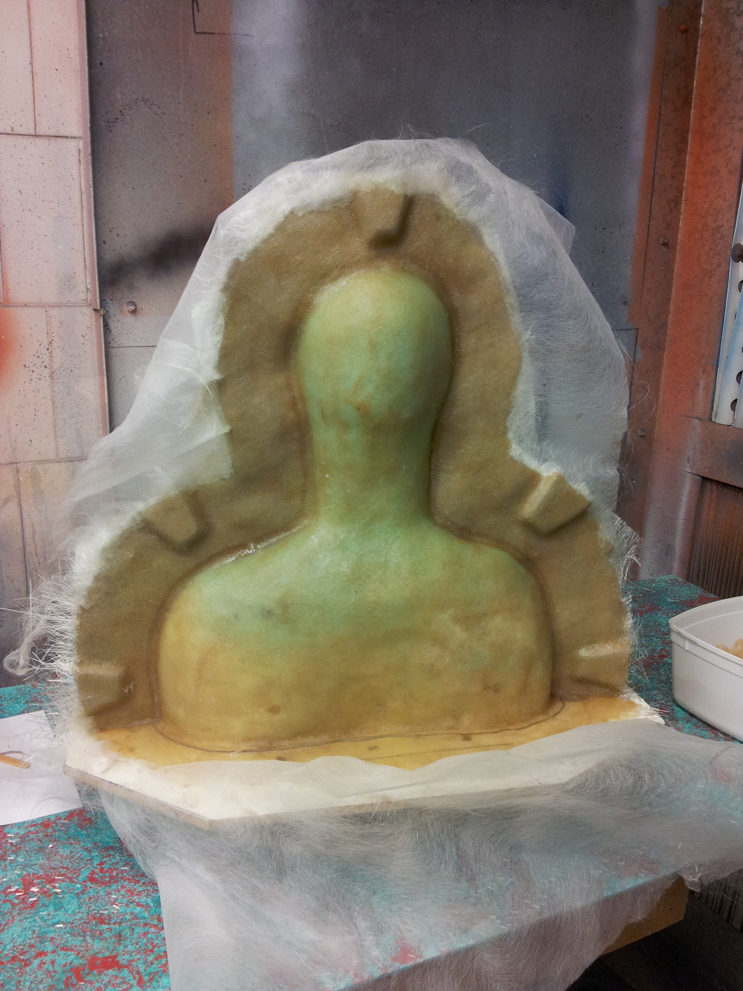

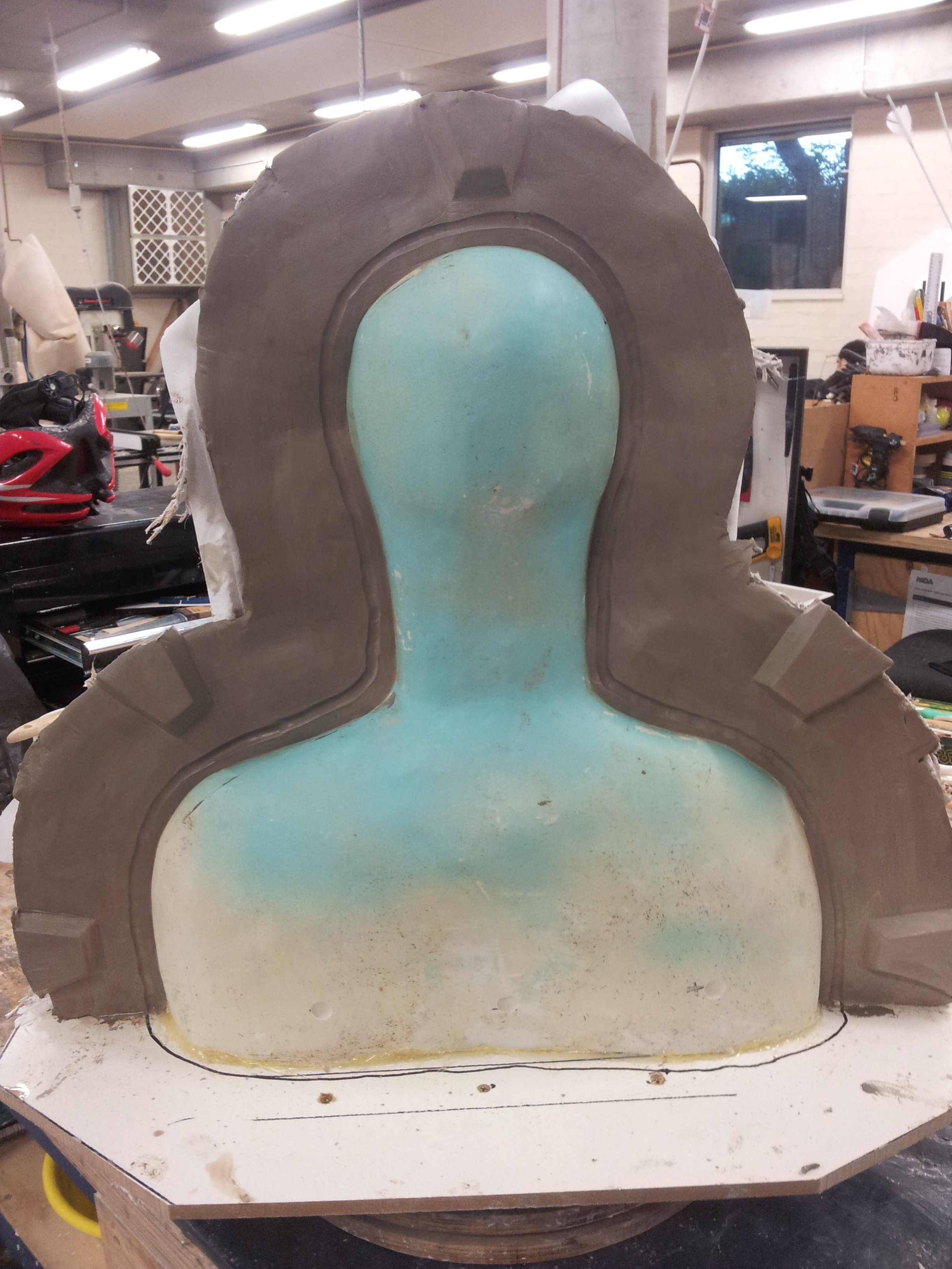

From my reference images and research it seemed that the lack of shoulders on this bust was going to be a problem so I filled in the space with WED clay, readying it for molding.
I cast the piece in soft plaster and began reducing the form. George Frangadakis mentions this in a Tested.com video on the subject. See: https://www.youtube.com/watch?v=NVws0ryS3-E
When it had the right shape I began smoothing with topping coat material and sanding back for a smooth finish.
Finally i gave the whole thing a layer of spray putty and a sanding with 1200 grit paper. Silky!
