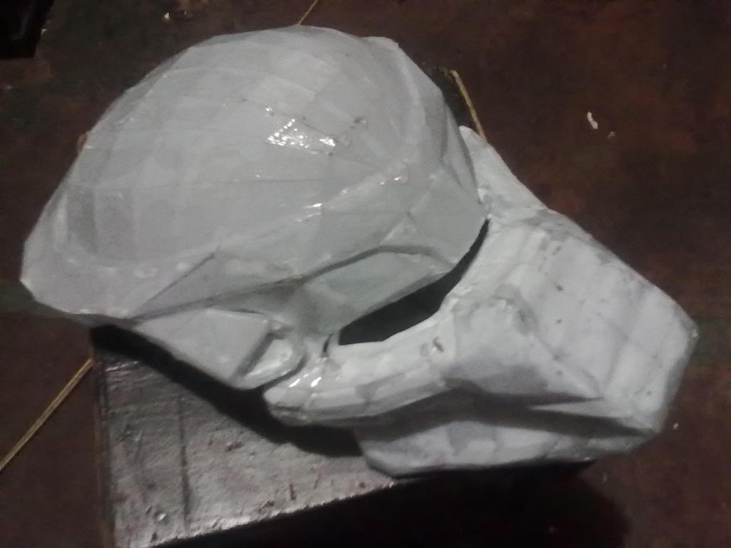

I started to re-build my predator suit and decided to do the classic one from P1

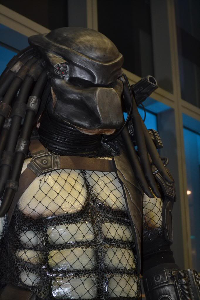

from pepakura patern, this time I did my bio-helmet from fiberglass, did a little research (finally tracked down) on where to buy the materials needed, then just attached it to the helmet with the dreads from my previous bio-mask.

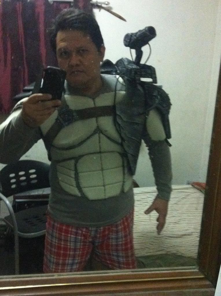

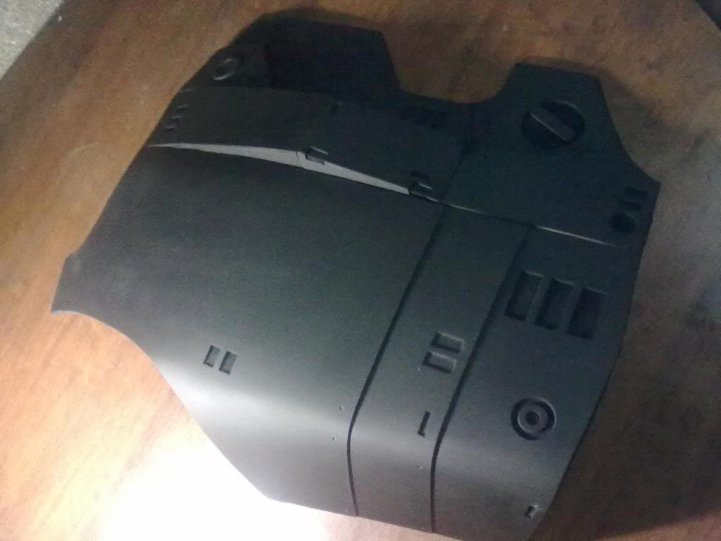

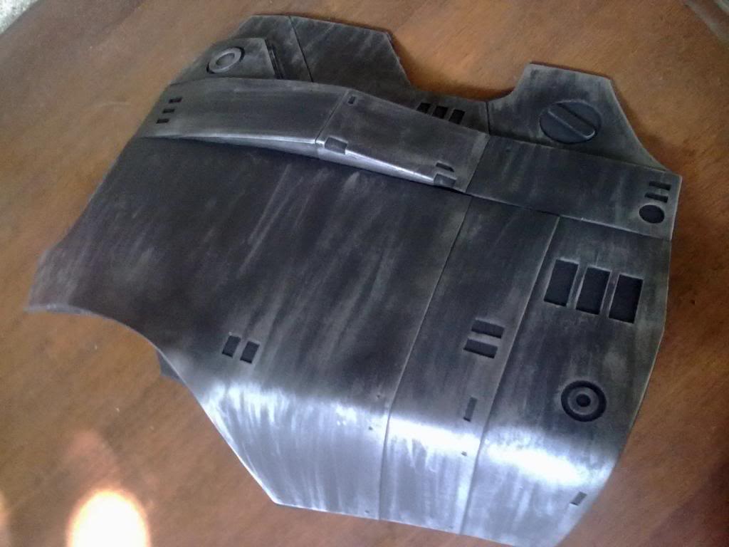

the front chest armor and the left shoulder armor

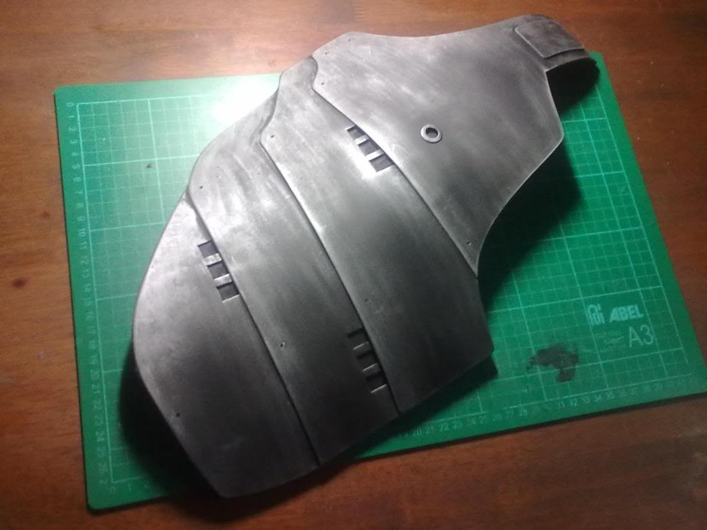

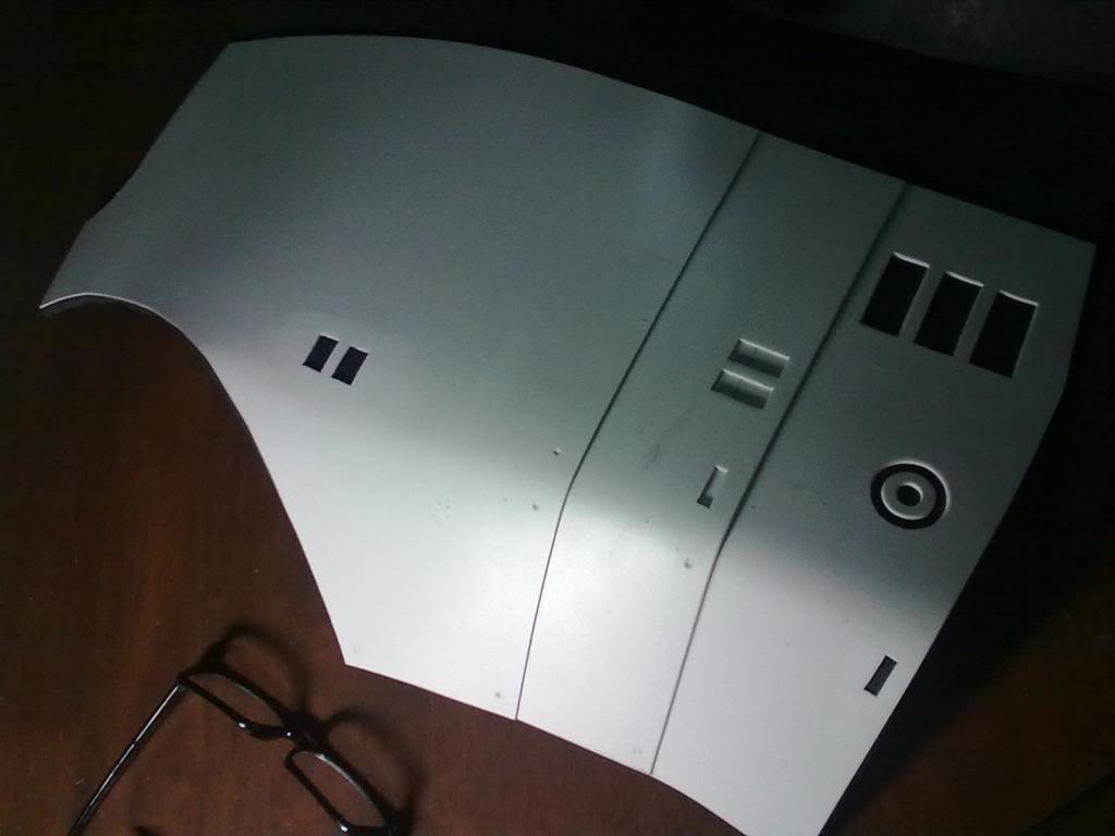

back of armor

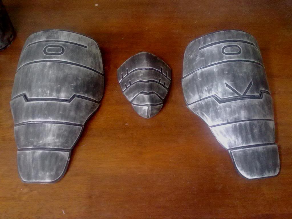

thigh and groin armor
shin guard armor

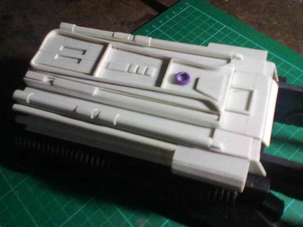

backpack and canon

* Most of my armor were made from rubber sheet (foamies) with plastic card/sheet (sintra)

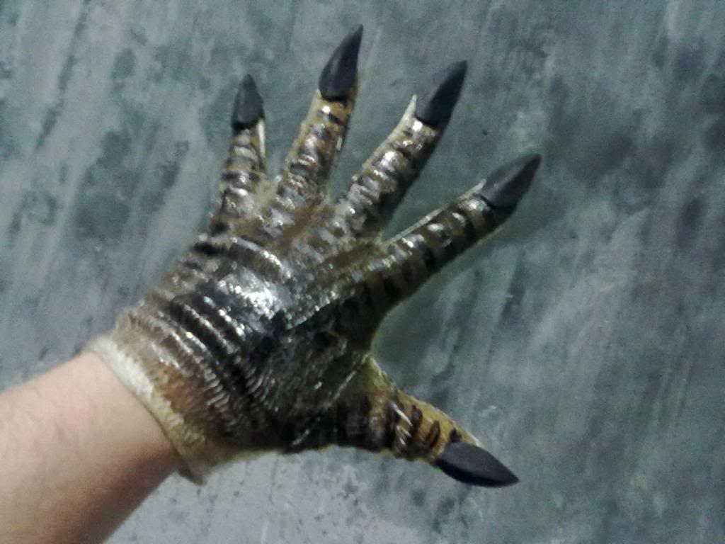

applied the same technique for the hand, used white pair of gloves then used a bit thinner rubber sheet (foamies) for the nails (applied black nail polish to make the nails rigid)

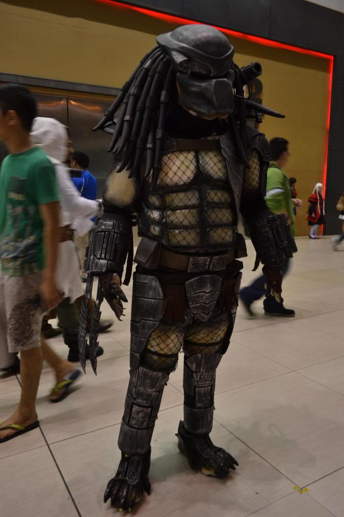

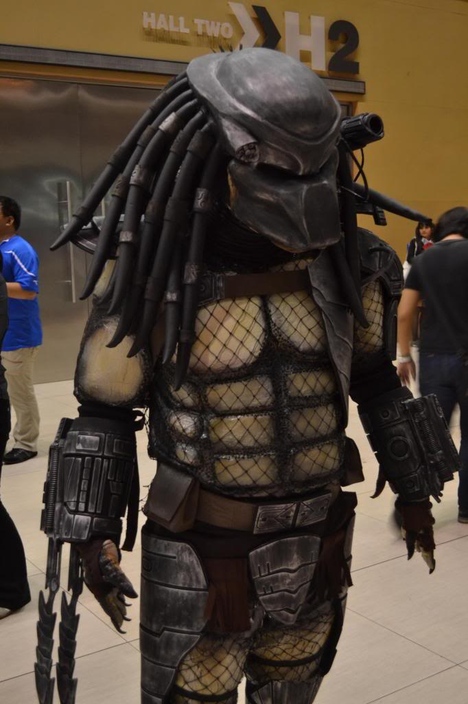

attended cosmania here (October 6, 2013) and was so overwhelmed to how people were amazed with the costume I made, but for me... "making the predator suit was fun part"! :D
me with my son.

under the bio-mask I attached/glued foam and shaped it using just a sharp scissor that would look like the lower jaw of a predator then applied acrylic sealant to make it appear organic/skin then spray painted it. also applied acrylic sealant at the front of the bonnet that I wore.
