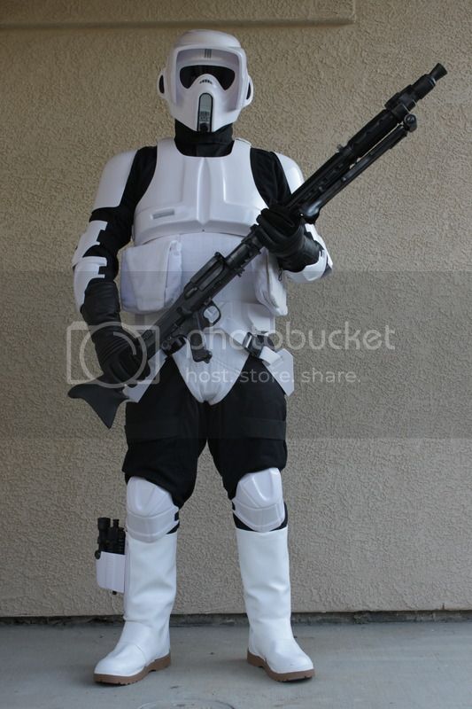

I've been cataloguing my Scout (TB) build for 501st entry for the past few months and today, finally submitted my application shots. I'll be adding my photos and wip shortly to the thread but would like to begin it with my submission photos along with photos "just for fun" with my DLT-19. Please excuse the wampa wear tag on my glove, gotta photoshop that out! All sewing work was done by myself and my wife.
Breakdown of items:
Armor: Studiocreations (SC)
Helmet: SC
Gloves: Wampawear
Body Suit: Redkap with mods
Flak Vest: T-shirt stitched up
Boots: Target workboots with marine vinyl
Weapons: HFX (Hyperfirm)
I will be providing details shortly as to how items were made and basic cost soon for those interested.

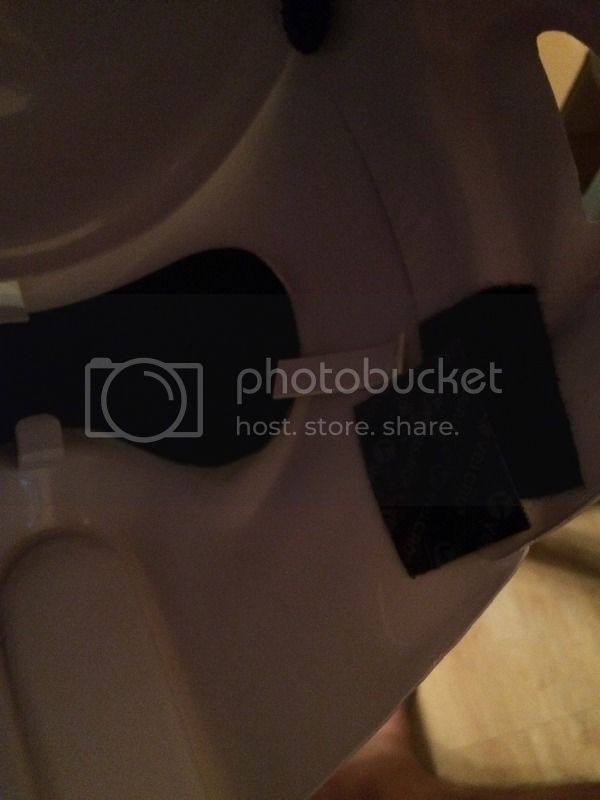

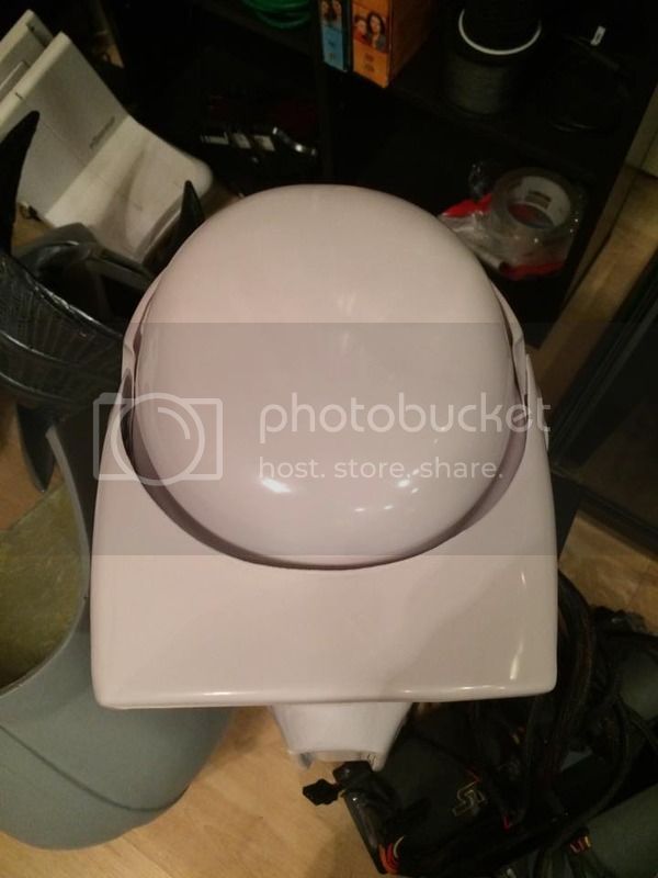

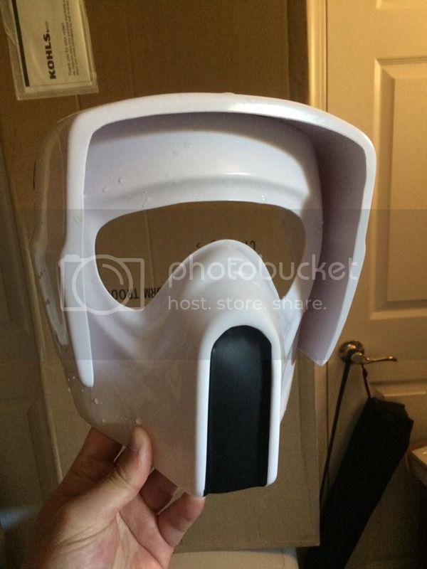

Most of the armor pieces and helmet pieces come trimmed from SC, a fantastic service and not one many other armor makers offer as a standard. The helmet needed some smoothing on the edges but went together pretty easily, using e6000, I attached the visor piece to the facemask.
Masked off the nozzle and painted the center portion flat black and detailed the nose piece:

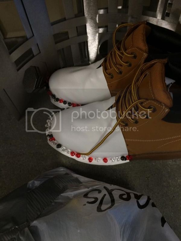

Moving onto the boots, base boots from target and white marine vinyl from Joann's. Pretty basic work, stretched the vinyl onto the boots and pinned it down with pushpins. Using the templates on the bikerscout.net, measured for fitment and cut out the calf section and the overlaying strap. All adhesives used on the boots were shoe goo and stitched on the calf section with heavy duty thread. Added the stitch details on the overlaying flap.

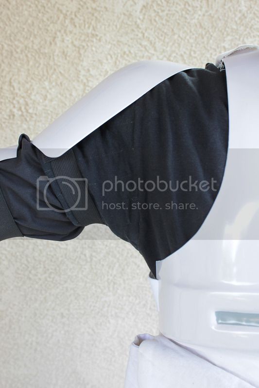

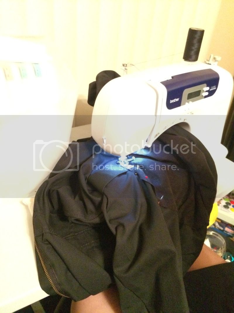

Moving onto the flight suit. The base suit is the widely used redkap suit. The pockets have been sewn closed with 2 front pockets removed and turned into the neck flap. Faux suede was used on the crotch area and the butt flap was measured out and added on with a velcro strip to allow for easy removal when washing. Thigh side straps were sewn in cleanly and added straps to the thigh areas.
Flak Vest was made from a black T-shirt from michaels, one size larger than I normally wear. Using the instructions found on the bikerscout.net forum, I stitched up my own custom fit flak vest. Very simple and easy to do while keeping costs down.

Congrats :) Nice job on all of it, I didn't realise there was so much work in one of these costumes.
Is the helmet screen accurate? Is it a original sculpt?
Thanks! Its a studio creation helmet (the maker). I actually left a lot more detail/work left out on this, some of these are just catalogued photos I had taken throughout the past year. The helmet is ok...I actually plan to replace it in the near future with a more accurate one, its a good fit for me but it does need to be revamped. I'd say its about 80% or so accurate, still enough to clear standards though and definitely very troopable. The scout trooper, while not as much hard armor, requires a lot of sewing or work with the soft parts. Things like making the velcro straps for the armor, riveting various pieces on the belt and boots, I left out as I kind of pushed through my build without photos of those. Used to be pretty easy to get in with the scouts since most folks would just buy a black flightsuit and put the armor on, but with the detailed photos we have now and the stricter policies/standards, you really need to invest in the soft parts or know how to sew.

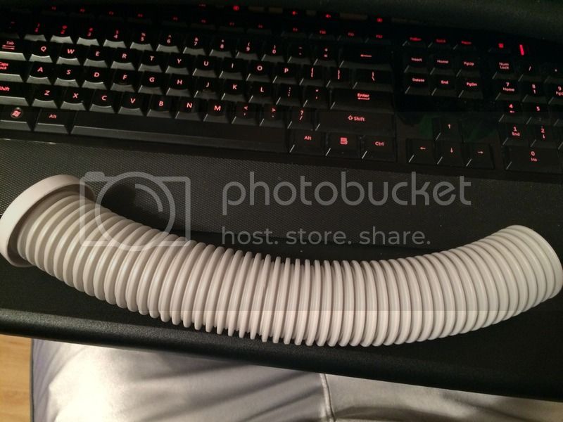

I am currently planning another Star Wars build. And I plan on going with a soft-cod.
Would you be willing to share where you got it or how you made it, and how you attach it to the undersuit?
