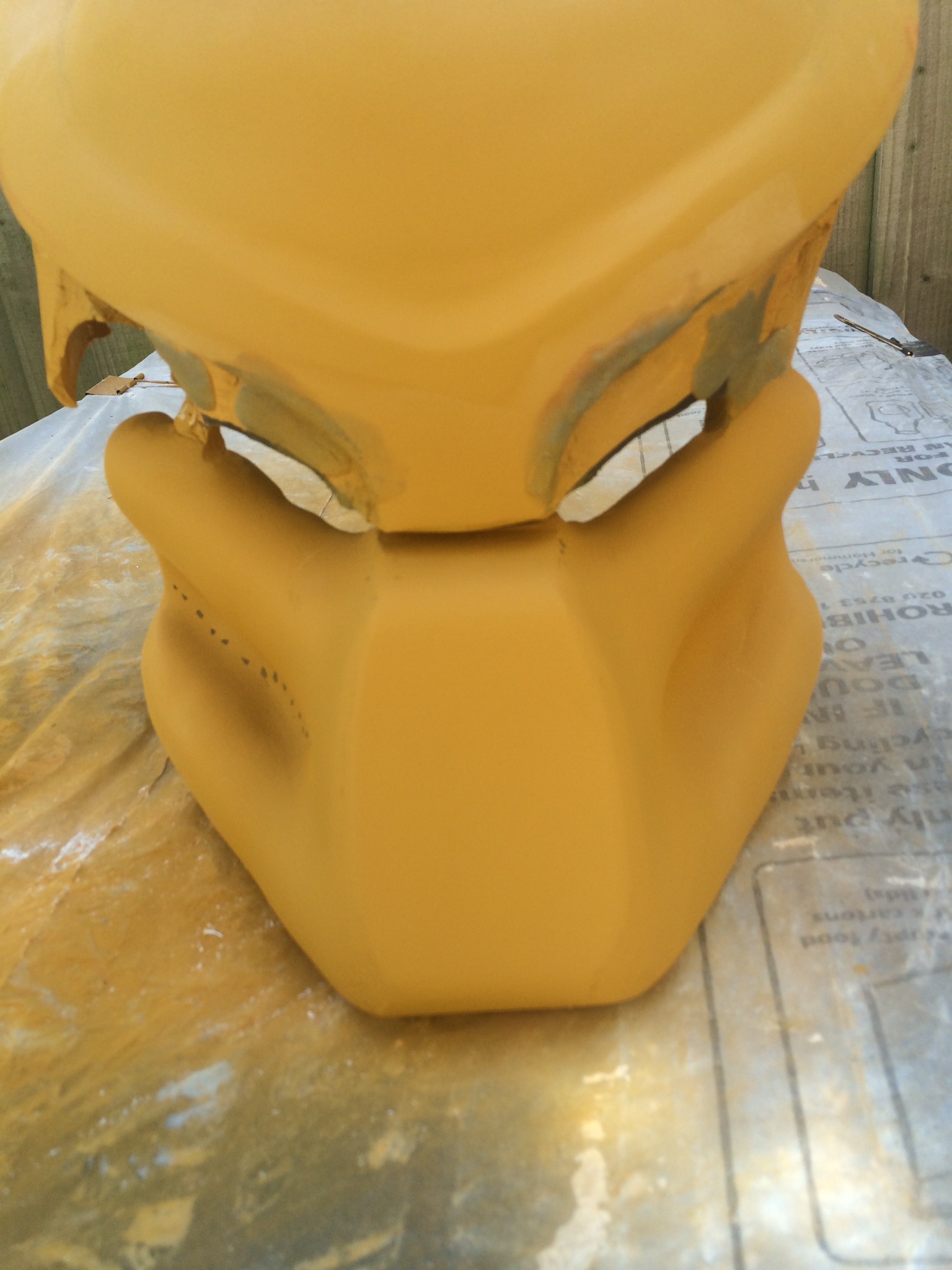

1) Pepping the helmet. This was the best P1 I was able to find but as you will see, still way off from accurate.
2) The dome was not wide enough so I had to add a piece of card stock to widened it a bit.
3) After coating the outside with resin.
4) Rondo coat on the inside.

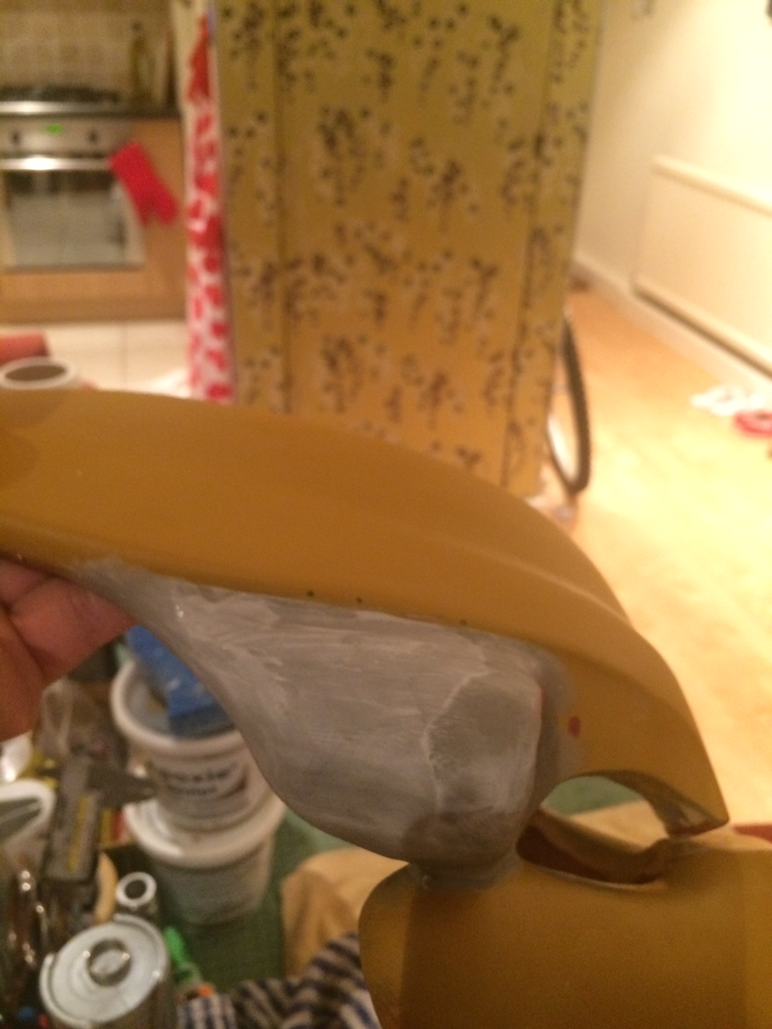

5) I sprayed a guide coat of black paint to help highlight the high and low spots when sanding.
6) Used some apoxie sculpt to close the gap between the back fins of the dome. Applied spot putty for minor pinholes and imperfections.

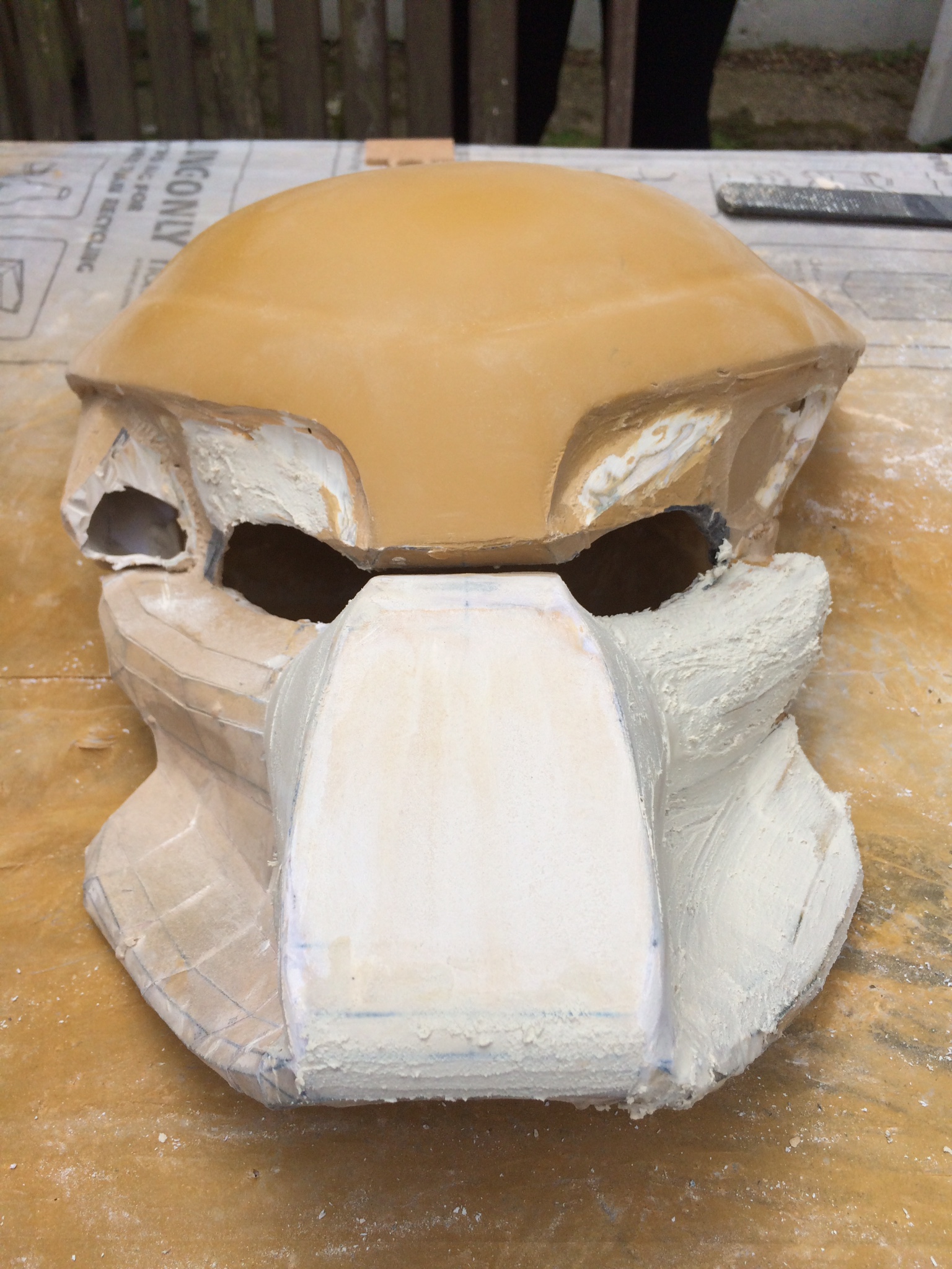

7) Started to smooth out the bondo on the face.
8) Used a piece of tape to help me identify the center when creating the widows peak area.
9) The nose just seemed way too wide for my liking so this was my first attempt to narrow it down a bit.
10) His cheeks looks way too thin for me, almost as if he was starving, ha.
11) Apoxie sculpt to help even it out a bit and make the divots more gradual.
12) Continuing to shape the face with apoxie sculpt (this is where I started to think why didn't I just make this from clay initially)
13) Side provide shot to show the curves of the face. I felt pretty happy at this point.

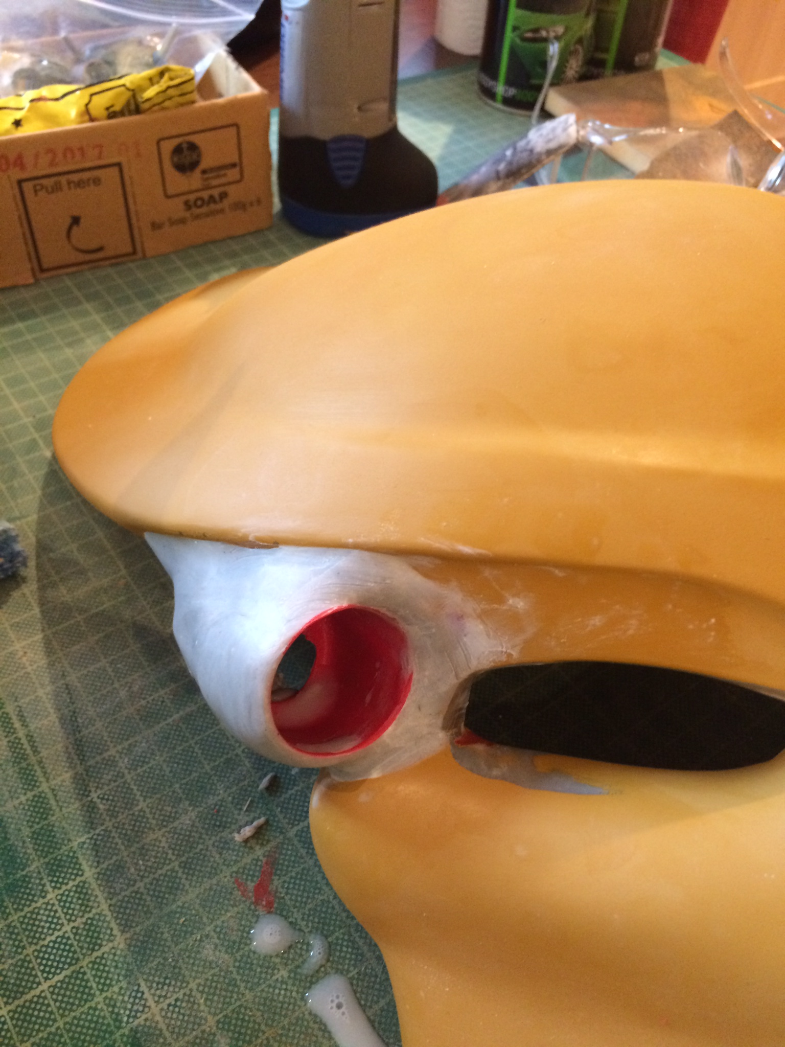

15) Used a dremel and opened up a hole for the breathing filter thingy (sorry not sure of all the technical names)
16) Cut a piece of styrene as a backing plate.
17) Made a mold of my super glue to help with the breathing filter part.
18) Used apoxie sculpt to make the center piece. I drilled the 3 holes after it hardened.

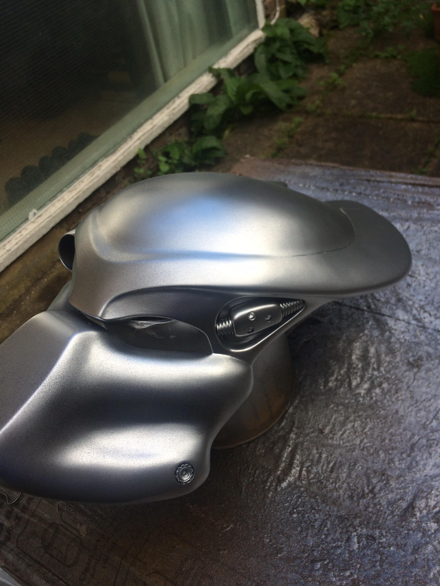

23) Started with a matte coat of black followed by silver.
