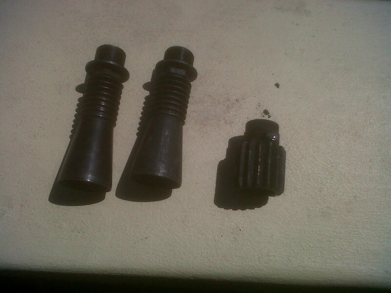

Dude there's one for sale right now by andymac
Like on these
Sorry to bring this up after the thread has been closed for a year ago but how are people connecting the balance pipe to the grenade? Do we need two bearings from an ANM2?
Most people use replica booster cones to connect the balance pipes because it's the easiest way. However, I know that at least two or three members have used a real bearing for the cone. In addition, Andymac and a few others have used the brass connecting piece from the grenade rod to improvise a fit.
