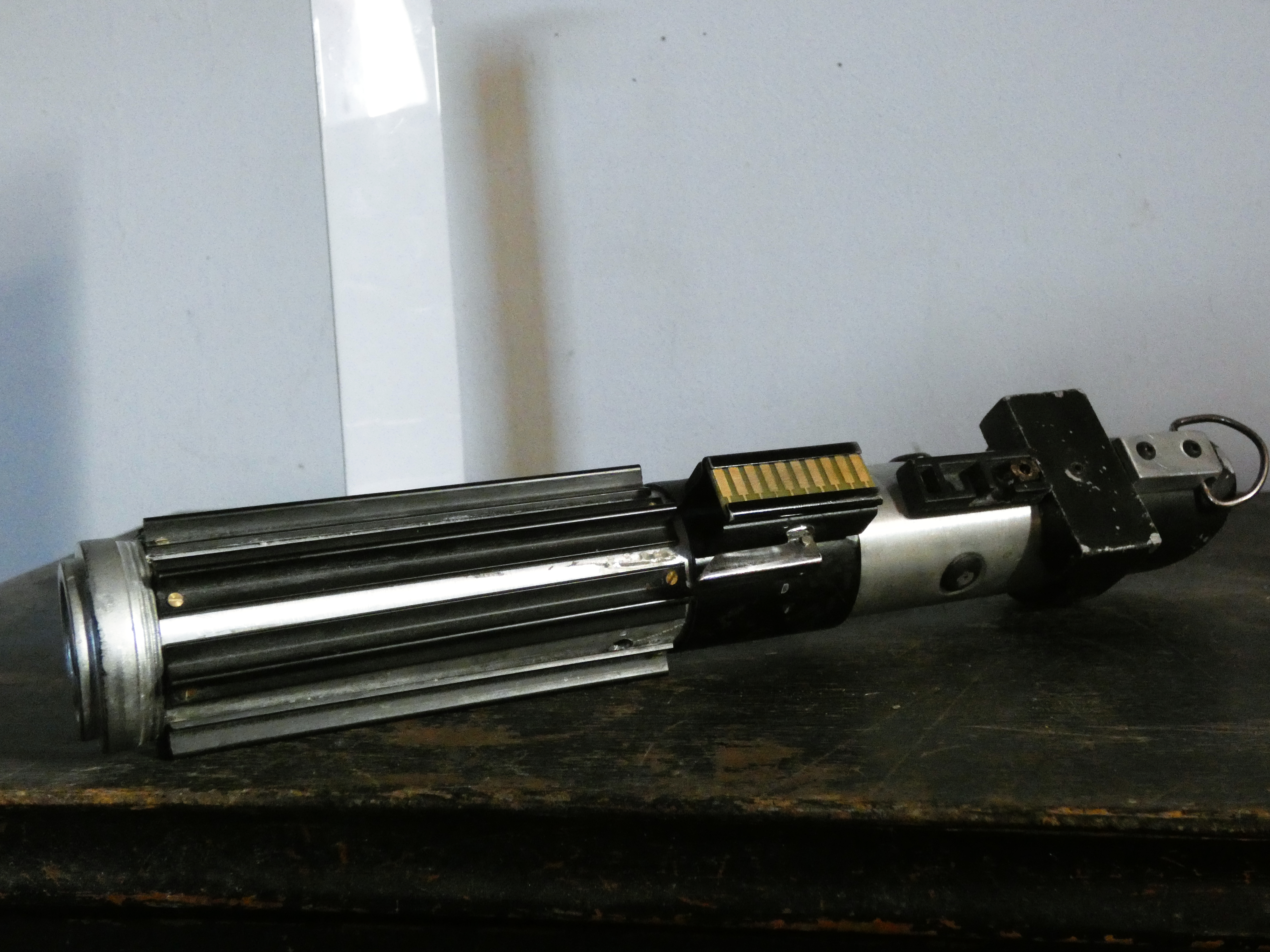

Barbican lightsaber, Aluminium tubing, MPP clamp replica, WannaWanga grips, 3d printed and scratch made greeblies. I think the design is great, but the job is awful. I used to hate that version until the ROTS hilt came around. We know the barbican was the ANH square shroud Vader stunt, used in ESB dueling sequence, modified then cast in resin for the severed hand scene in ROTJ. I don't really know when it's been modified to look that way but it seems like it was during or after ROTJ.

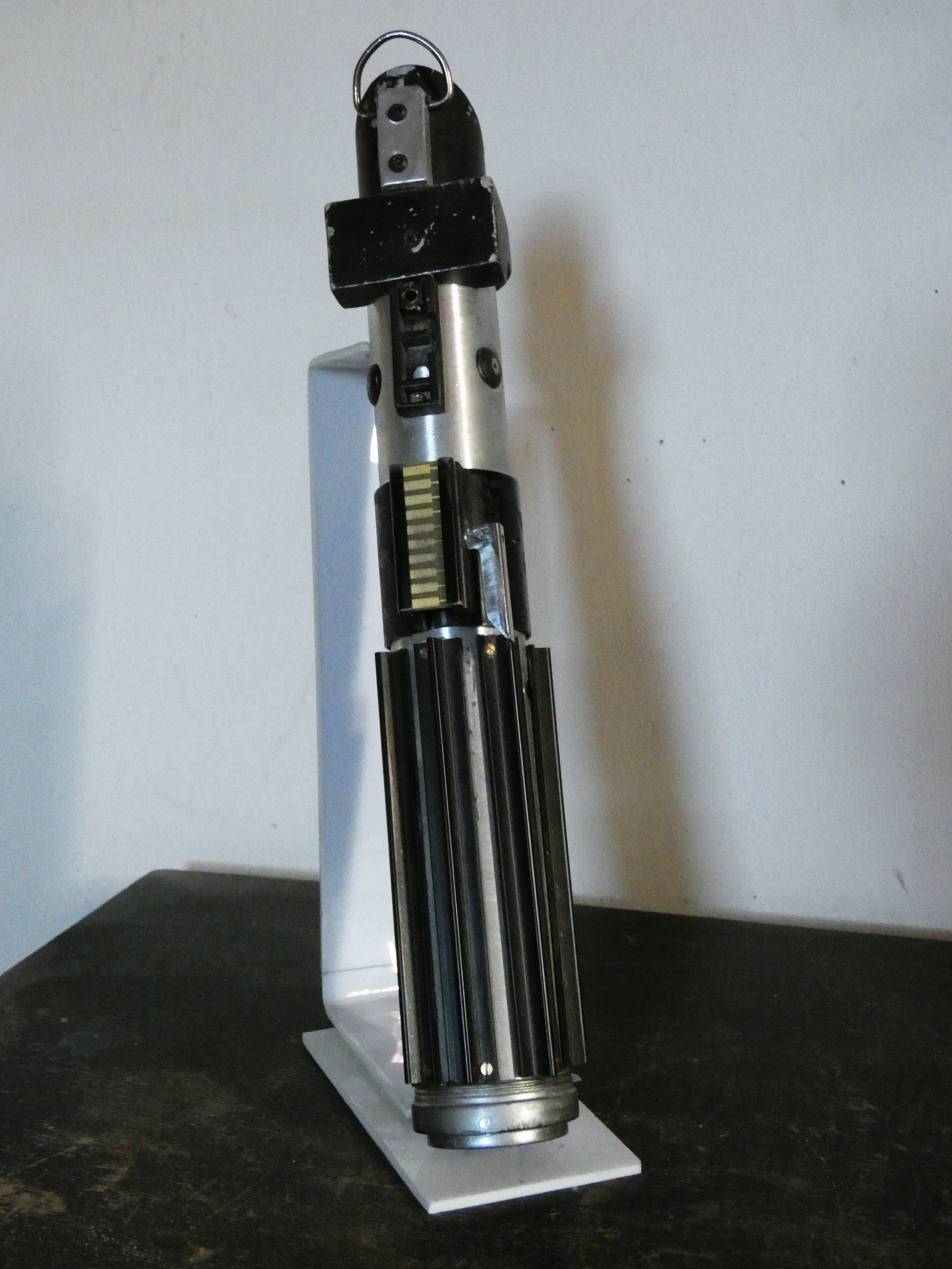

Gary Kurts version, made on a Heiland Strobonar with crudely made greeblies. Pretty small, but I really love that iteration. I think It's been done post ROTJ due to the grips section appearance.

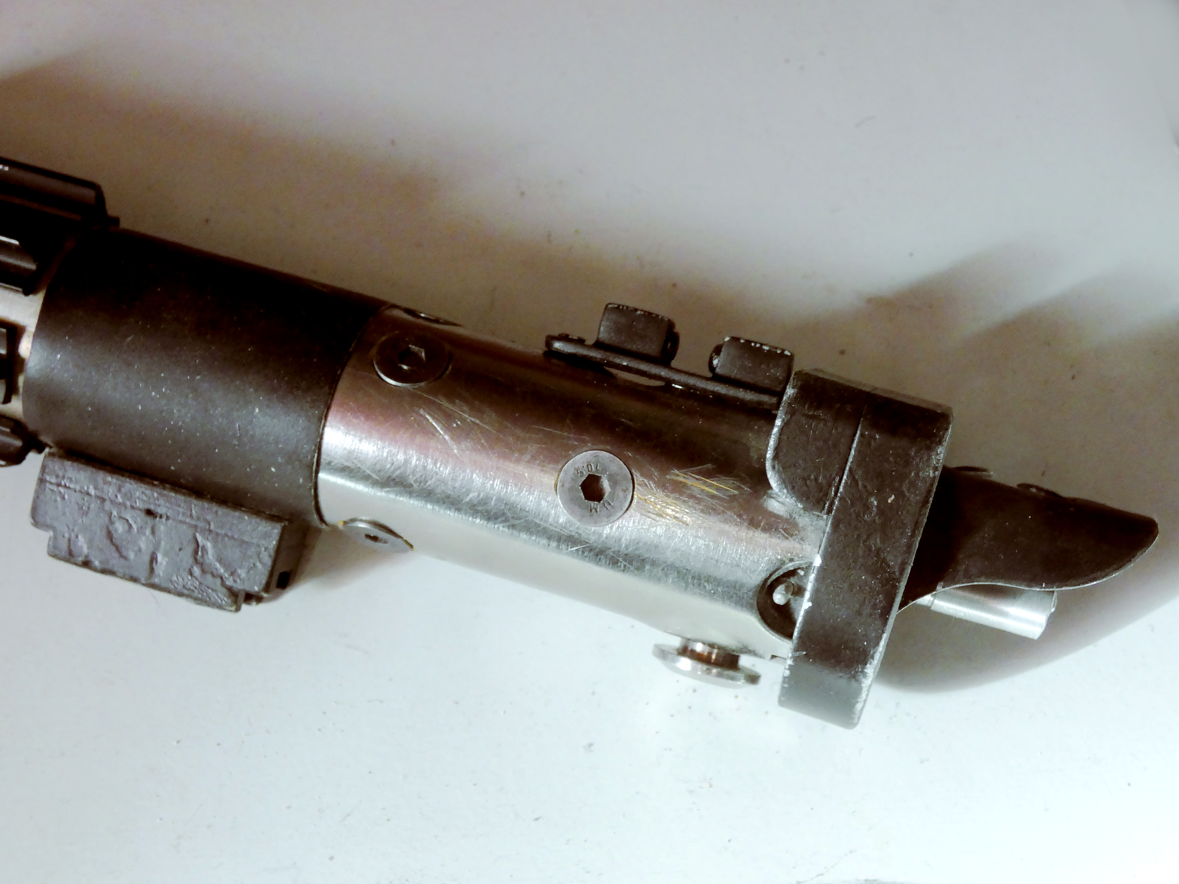

The Barbican fitting is fairly simple. I can insert the tube directly into the shroud
The emiter is stepped, there's a half wich goes directly into the beveled section, and the other half, slightly larger, wich goes into the tube
The tiny allen Screw holds the parts together
Concerning the MOM, I have hard times to find a good way to hold it together. It was used as a bladed stunt, so I assume there was a sort of aluminium core, held by allen screws, went through the entire tube.

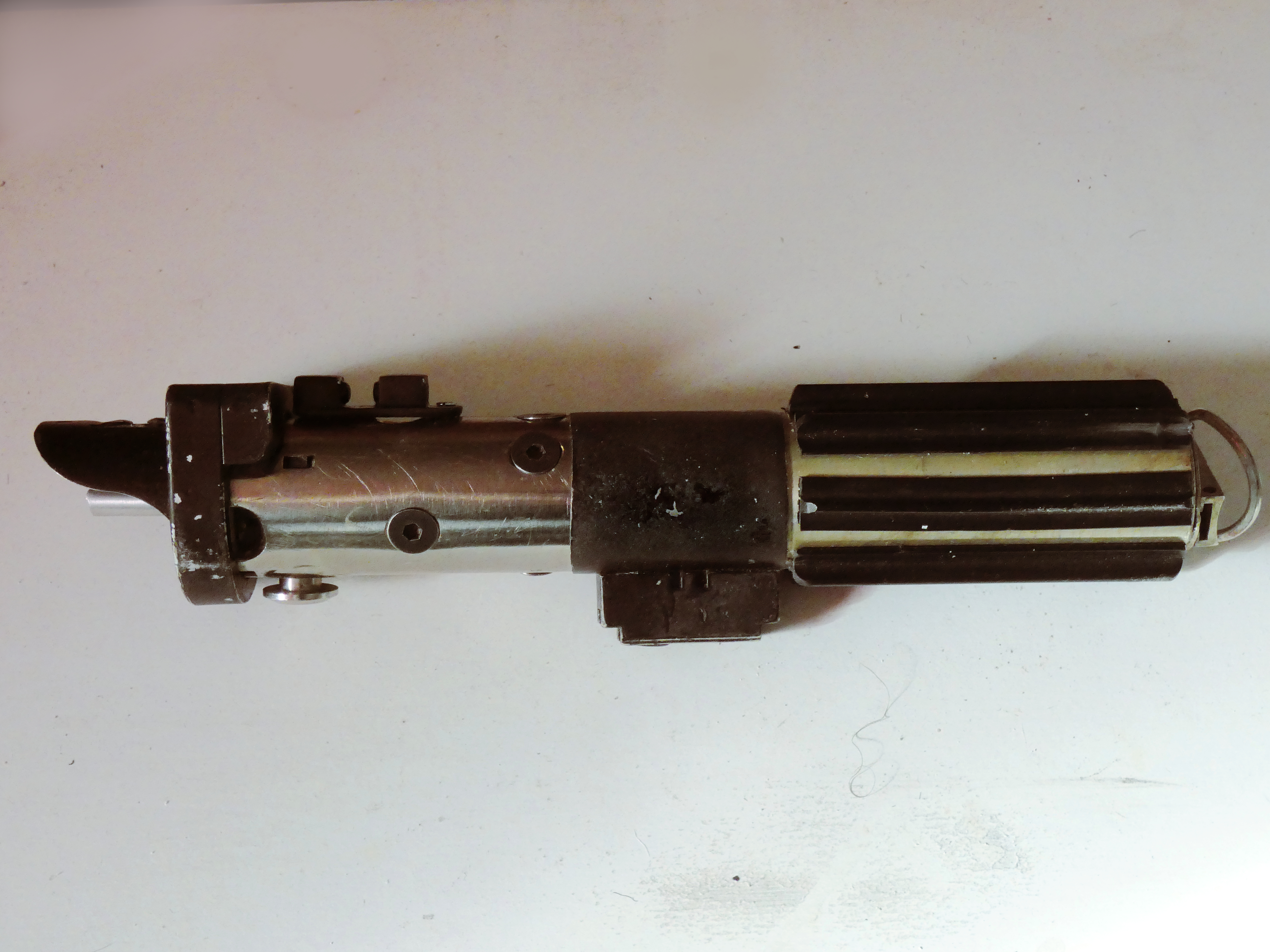

Hi there,

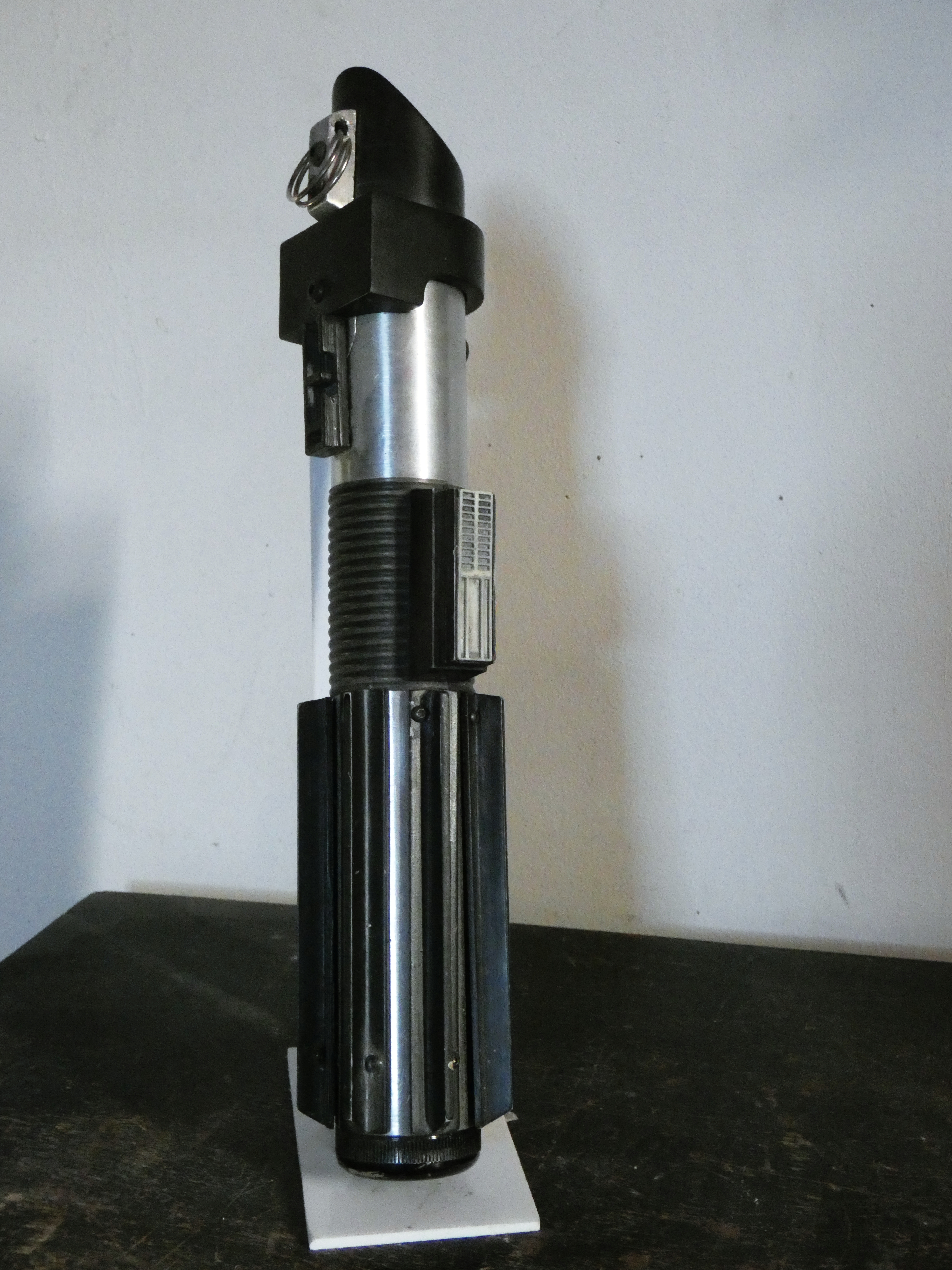

I wanted to show my unfinished Vader MOM lightsaber. I wasn't looking for perfect accuracy, I very much prefered to focus on the craptastic features that make that prop so authentic. I've learnt yesterday the 2002 pattern was about to be updated :(, considering many of my parts were gathered around 2006/2007, my replica is definitely out of date .
The thing is I cannot find all the parts to complete that replica. I miss the thumb screw and the D-Ring cylinder. I've heard Elvis Trooper wasn't producing any more of his products, does anyone know where to find MOM parts please?

Hey Benjo ... I love your Vader ROTJ stunt, it looks fantastic yet your missing 1 screw/bolt under the double ball catch, yes?
Also I know that obi1kenny did another run of parts in 2020 so you should still be able to order that D-ring part from the top and the missing thumbscrew.
Yet with your scratchbuilding qualities and 3D printed or even plastic greeblie parts you could try to recreat the D-ring part, yes?
I'll attach some pictures.
Also that D-ring itself is quite wonkey ... here's the shape, just disregard this set-up it's wrong.
Sym-Cha Thx a lot for ypur words ;).
I know about the bold under the Double ball catch, I just lost it and need to find a new one to fill the hole :).
I'll try to contact Ob1Kenny, at least to get a Thumbscrew. I can build the D-ring cylinder from scratch, I'm just not sure about its dimensions.
Thx a lot for the pictures and precisions about the D-ring. I honestly didn't pay much attention to it and didn't know that thing was totally wonky :).
Sym-Cha
Benjo I have that part here, don't know if it was originally obi1kenny ... it's dimensions are :
Big cylinder 12 mm in diameter, about 9.5 mm high. Small cylinder or screw part is 6 mm in diameter and about 2.5 mm high ... total height of the part should be 12 mm. and then there's a washer and bolt on the underside which is 8 mm in width.
That D-ring of mine is from a 2.5 mm wire, 37 mm at the widest and 20 mm high in the center.
Hope that helps to create your own :)
