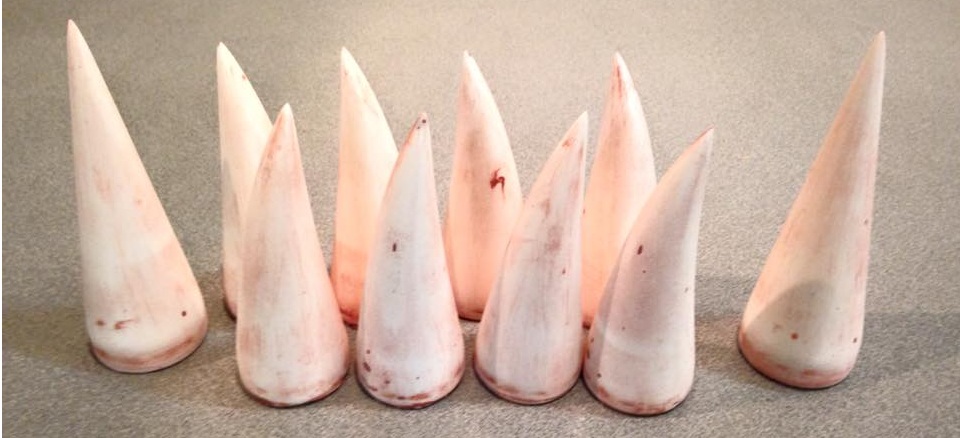

The horns were cast, primed and wet sanded up to 1000 grit so the gloss enamel base coat would have a nice even sheen to it.

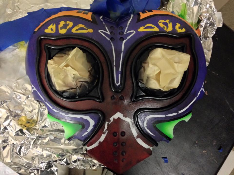

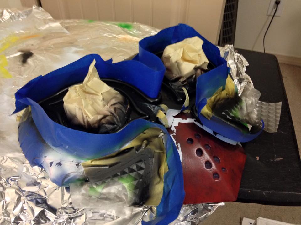

The mask was masked off with masking tape so that different portions could be cut out and painted. The detail of this mask mean that mistakes would compound on each other so I had to be very careful with the order I did the details in.
Globs of liquid latex were also added prior to coloring the masked off details. After the acrylic cured slightly the latex could be pulled off for realistically chipped paint.
The mask was then given an light wash of browns and blacks along the recesses to make it look like Skull Kid might have dragged it through some Kokiri mud a few times.
My paint station was set up for Testors enamel paints. Each one has to be thinned and cleaned just right or applying it in a nice smooth gradient can be a nightmare. Contact paper made it easier to cut stencils and paint the colors of the eyes without ripping any paint underneath in the process.

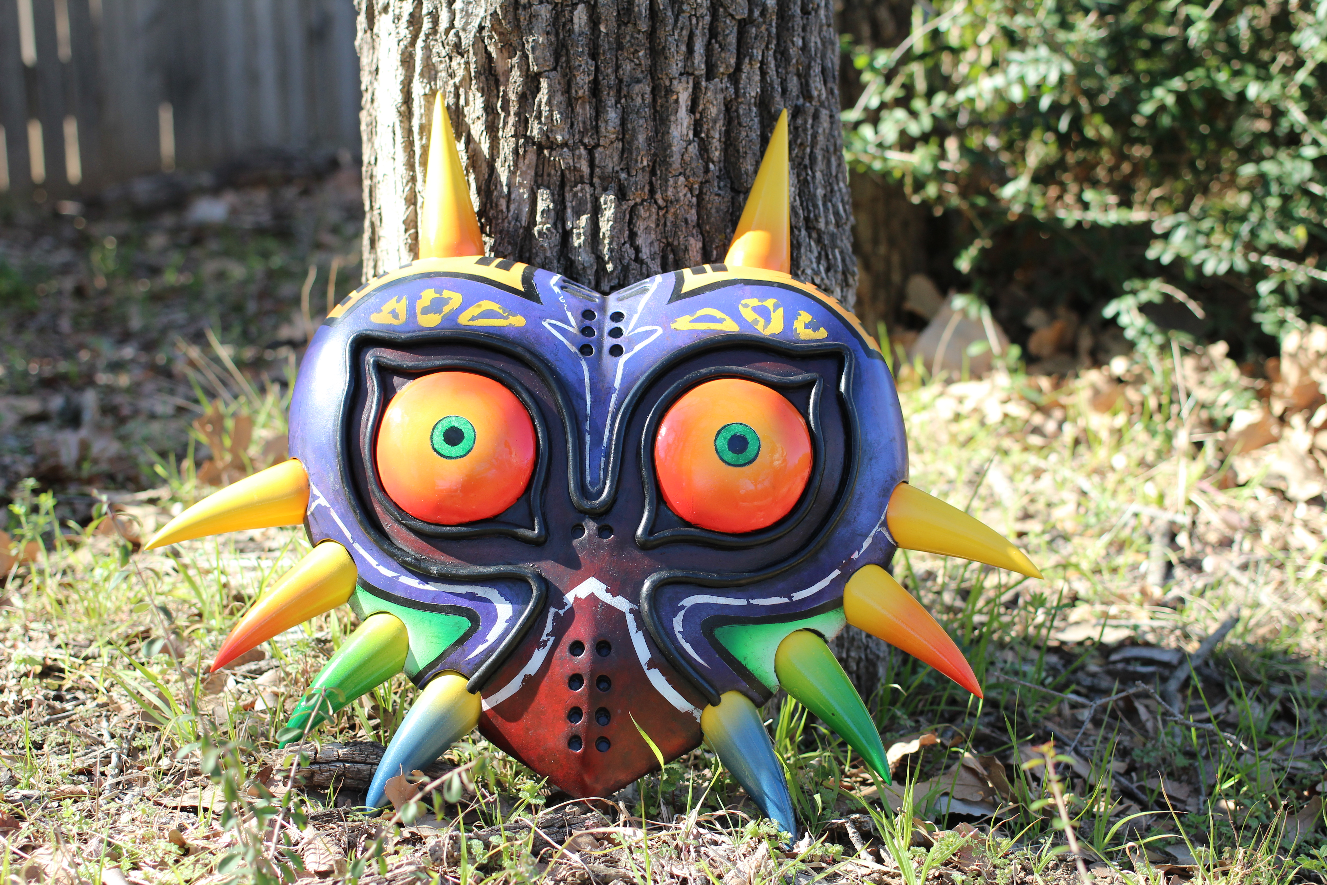

And it's done! With over well over 50 hours of work this is the most ambitious prop I have ever made but I hope it shows. Hopefully I will be able to make more in the future. I definitely learned alot about patience and while there are things I wish to improve on for the next prop, I am very happy with the results.
Amazing work! How good is the visibility?
My personal copy is just a wall decoration, I wanted to keep it as pristine as possible.
The eye corners still line up at eye level so it would cut off your peripheral somewhat and a mesh cover for the slits would dim the room slightly. Overall you could probably navigate a convention lobby just fine.
