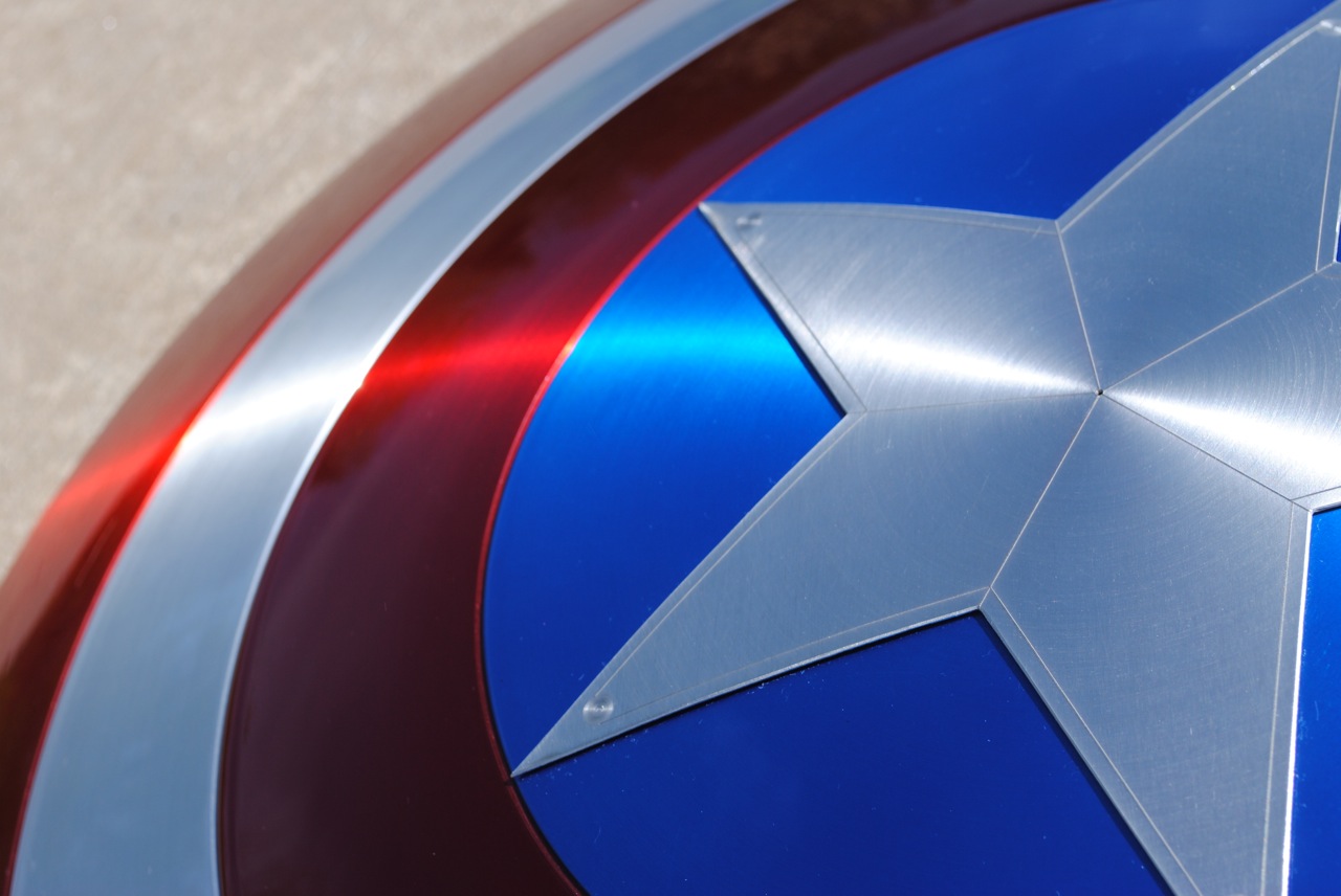

    This is my just completed movie Captain America shield. The build and paint process is similar to my previous threads, but I used some upgrades.
    I used the Duplicolor Metalcast paints for the colors. But this time I took the shield to a professional auto painter who shot a coat of acrylic polyurethane auto clearcoat on it. And WOW what a difference. The rattlecan clears I had use on my previous shields were VERY fragile and didn't take much to scratch or nick them. This clear coat feels bulletproof and is smooth as a babies butt. Totally worth the extra $70 the guy charged me.
    This version also has my waterjet cut brackets and color accurate straps. Now having done three of these, I'm pretty burned out on Cap shields. I think I'm going to keep this one around.

    As usual Valor great work. Did you have the auto paint shop clear coat the star seperately before attaching or did you stick the star on first? Did you ever figure out that fingerprint residue problem you were having?
  11. Valor
    Valor Sr Member RPF PREMIUM MEMBER
    Trophy Points:
    1,881
    Yes, and I'm glad I did. THe star look much more finished when attached. I'm pretty sure the fingerprint issue of my previous shield was either due to using crappy acetone, or that the clear I was using was laquer clear coat – which never really "dries".

    Honestly, and I swear this isn't going to lead me to making ANOTHER shield, the only nagging though I have with this, is it might be TOOOOOO good looking. Like TOOOO glossy. I know the real shield was more of a matte finish at times. But ... I must push those thoughts out of my mind :)

    Give it a nice even wet sand with 2000 grit if you find it too glossy. Just watch your eges as they will break though about 4x faster than the flate surface. If that doesn't look the way you want you can polish it back up in a few minutes. Just a suggestion though. :)

    I can't stress enough though the difference in durability that a pro clearcoat gives. It's a catalyzed finish that is INFINITELY tougher than any rattlecan clear. WELL worth doing in my book. It's possible an auto painter could spray a more matte finish clear. Or, as Finhead suggested, you can knockdown the gloss on your own.

    And on that note yes you can spray any variance of gloss to matte you like, you just add more or less matting agent to the clear coat. I used it all the time mostly a few years ago when the satin black was all the rage on the Harleys etc. You could wet sand it down with some 1000 grit and get the same guy to give it a few coats with a little satin clear. That is the nice thing about 2K anything it fully dries so there is zero chance of issues to go back in a paint or touch up blend in or spot.

    Valor and anyone that can help. Do you have any tips on how to remove fingerprints from the aluminium before you spray it as I have touched mine and can't seem to get the prints off it
    Thanks chris
    But valor superb paint job
  24. Finhead
    Finhead Sr Member
    Trophy Points:
    1,307
    Wax and grease remover then Acetone.

    Valor, did you attach the brackets on this version with strong adhesive tape like before, or did you use JB weld?
  30. Valor
    Trophy Points:
    1,881
    I used the 3M Scotch outdoor tape. Ridiculously strong. :)

    Valor, I'm getting a little frustrated painting the shield. I know you have stated before that one should apply several thins coats, but should we try to get up a little close and do a "wet" coat, or should it just be several thin coats applied while holding the can 8-10 inches away?
    It's just hard to tell from some of the pictures of successful builds to judge exactly how the color looks. In some the color has a matte look while in others it appears very shiny and glossy.
    Thoughts?
    Louis
  37. Valor
    Trophy Points:
    1,881
    Louis, for the color coats don't worry about the surface finish of the paint. Your clearcoat will set the gloss. And it doesn't even matter if one part of the shield is flat looking and one part is shiny. You are not trying to get a nice sheen with the color. You are just getting color down nice and even. For example, you could have one half of the blue circle look flat, and the other half shiny. When you put on your clear, it'll all even out. Trust me. Your main goal is nice even tone.

    Is it normal for the paint to be "gritty"? I painted my blue circle and the paint was on pretty evenly, but it seemed to come out so gritty that I stripped it to do it again. Should the paint go on smooth or does the clear coat gloss it up and smooth it out?

    Paint get's dusty or gritty for a couple reasons. You might be waiting too long between coats. Recoat within 10 minutes. All 3-4 of your coats should be done within 30-40 minutes. Or, you could be spraying too far from the surface, meaning the paint is drying before it lands. Don't get too close, but 10-12" away should do.

    Success! Incorporating Valor's suggestions, this is what I did:
    I opted to start with the blue center so as not to waste paint on failed attempts. This was my third attempt as I too found my first attempts to be course, grainy, rough, uneven, etc.
    This time I:
    1. Took the shield outside and allowed the shield to acclimate to the outside temperature. Living in Florida I wanted to avoid any condensation forming on the surface.
    2. I propped the shield up on an old chair so that it was standing up almost vertically. The first two attempts at it I had the shield lying flat on the ground. I just knew that was a mistake and went ahead and did it anyway. With the shield upright, the paint flowed out of the can much, much smoother.
    3. Shake the can for at least 2 minutes.
    4. Make sure the blue masking tape, or whatever you used and cut into the shield's grooves, are properly adhered to the surface. I almost blew my third attempt when I noticed tape inside the grooves had apparently lifted up in some spots over night. I was able to quickly lay it back down with a tiny flathead screwdriver.
    5. Keep an xacto knife nearby in case a bug or large particle of dust or dirt lands on the paint. I acted quickly and was able to remove two foreign particles with no problems.
    6. Again, with the spray cans upright, the paint flowed so much nicer and smoother onto the surface. I used quick back and forth overlapping strokes about 8-10 inches from the shield. If you hesitate for an instant too long on one spot, you'll get a buildup of paint that will result in a "wet" spot. Of course if you lay down too much, it will run.
    7. I waited about 5 minutes between coats. Shaking the can each time.
    8. I followed Valor's advice and aimed for a nice even color throughout. I think I nailed it.
    Good luck to all.

    Hey Valor, finished painting my shield, and it's looking pretty good. Not perfect, but I am happy with the results. Did I understand the above correctly, that you had the shield and star clear coated separately, AND THEN you attached the star? If so, just so I understand the reasoning, why? What do you mean by the star looked much more finished when attached?
    Thanks.
    Louis
  48. Valor
    Trophy Points:
    1,881
    Yes I did. I'm a fan of painting THEN assembling. It allows you to control each item. With the star, I was also worried about the fact that there might be a bit of a gap in some spots between the star and shield that might make a bad paint transition. Meaning, the paint light go over a joint between the star and shield that wasn't solid and crack later. Glueing it on after finishing meant everything looked stronger. I'm kinda picky about details :)

    Thanks. I see what you're saying. I'm gonna treat the star like a car's emblems which are attached after the car has been painted and clear coated. Now to find a local body shop that doesn't think I'm crazy bringing in a Captain America shield.

    What adhesive do you use to attach the star?
