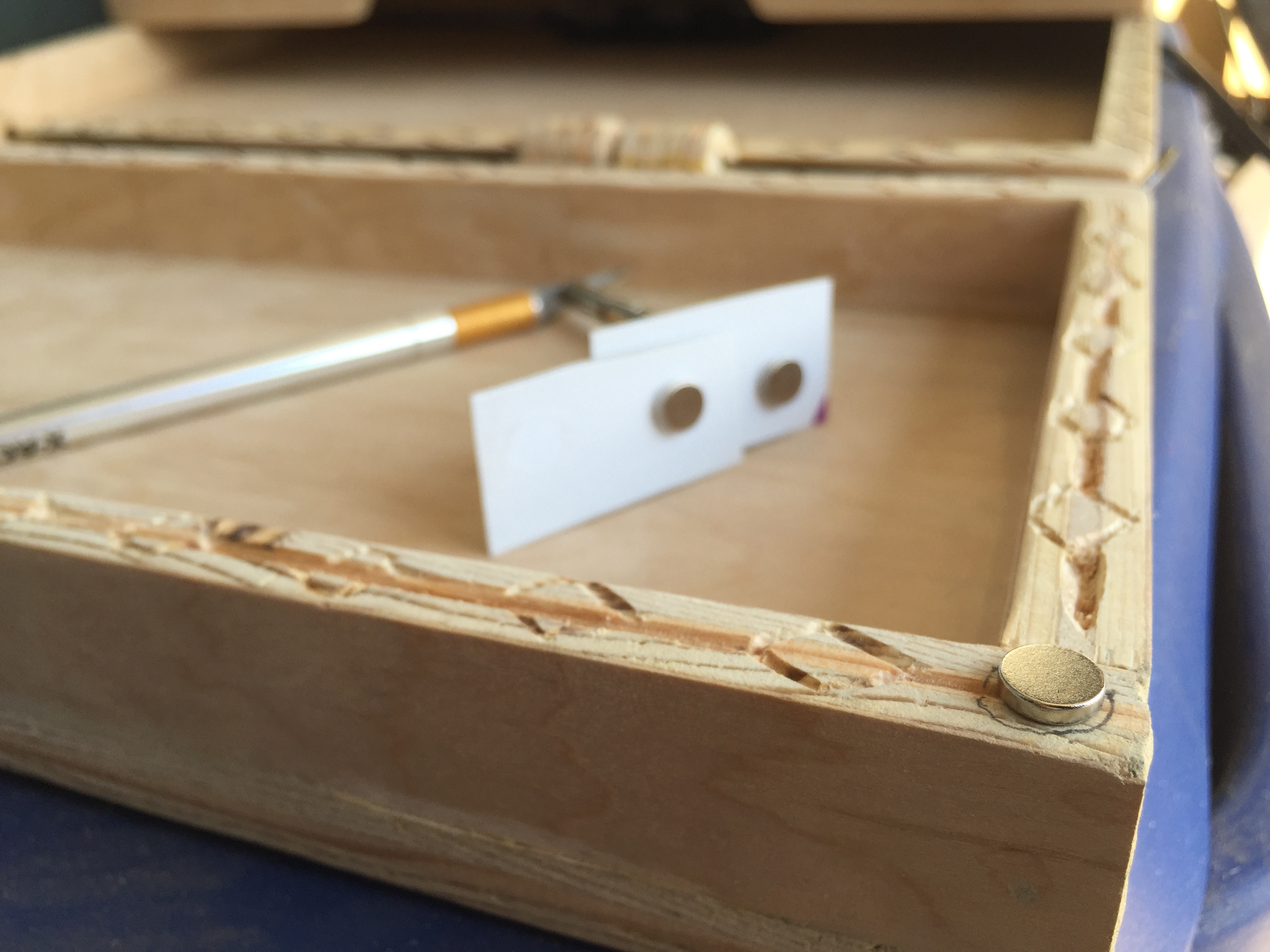

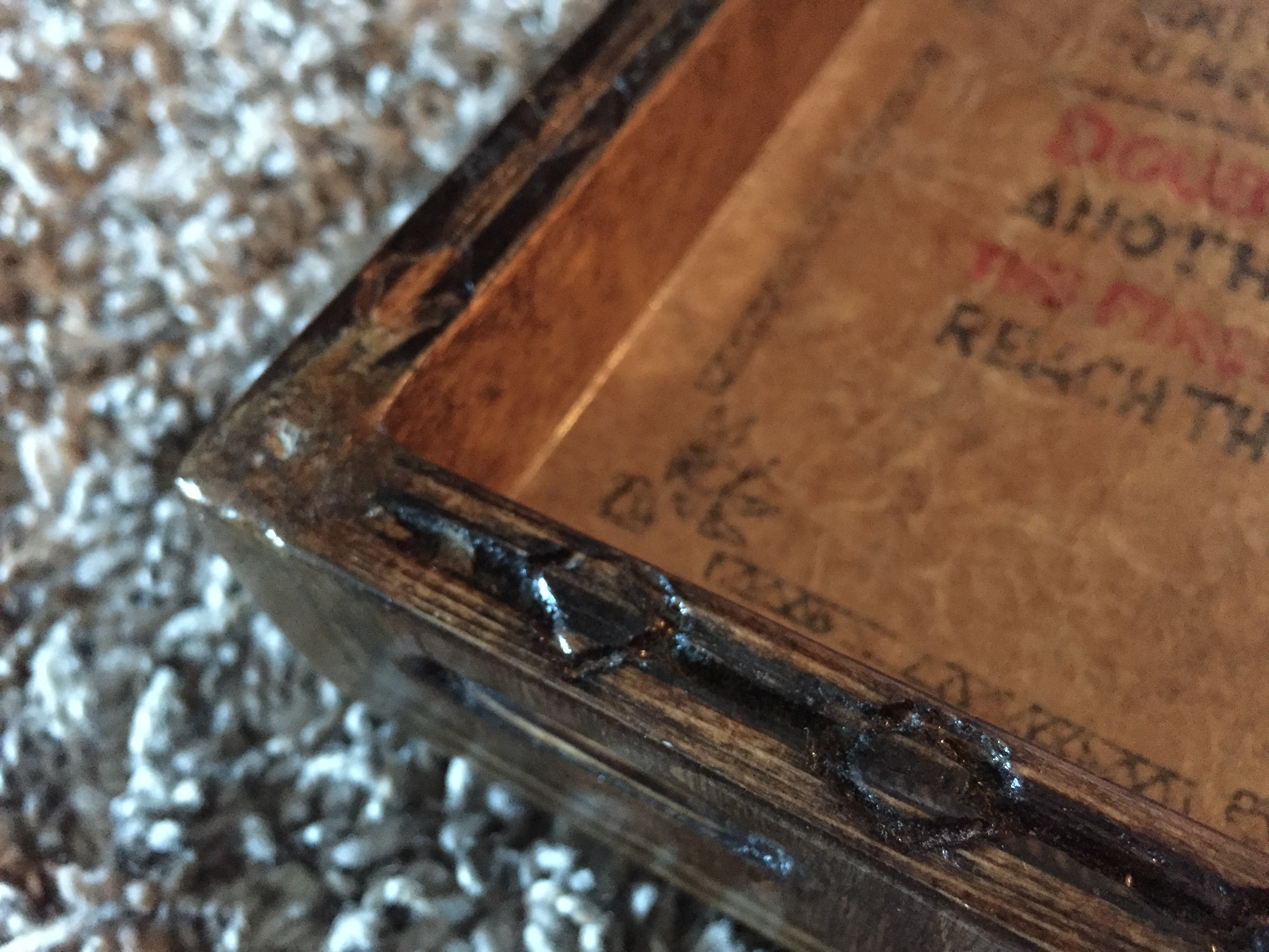

The most time consuming part was carving out little diamonds along the inner edges. It's not screen accurate but gave some needed detail without a whole lot of skill involved. Just patience.

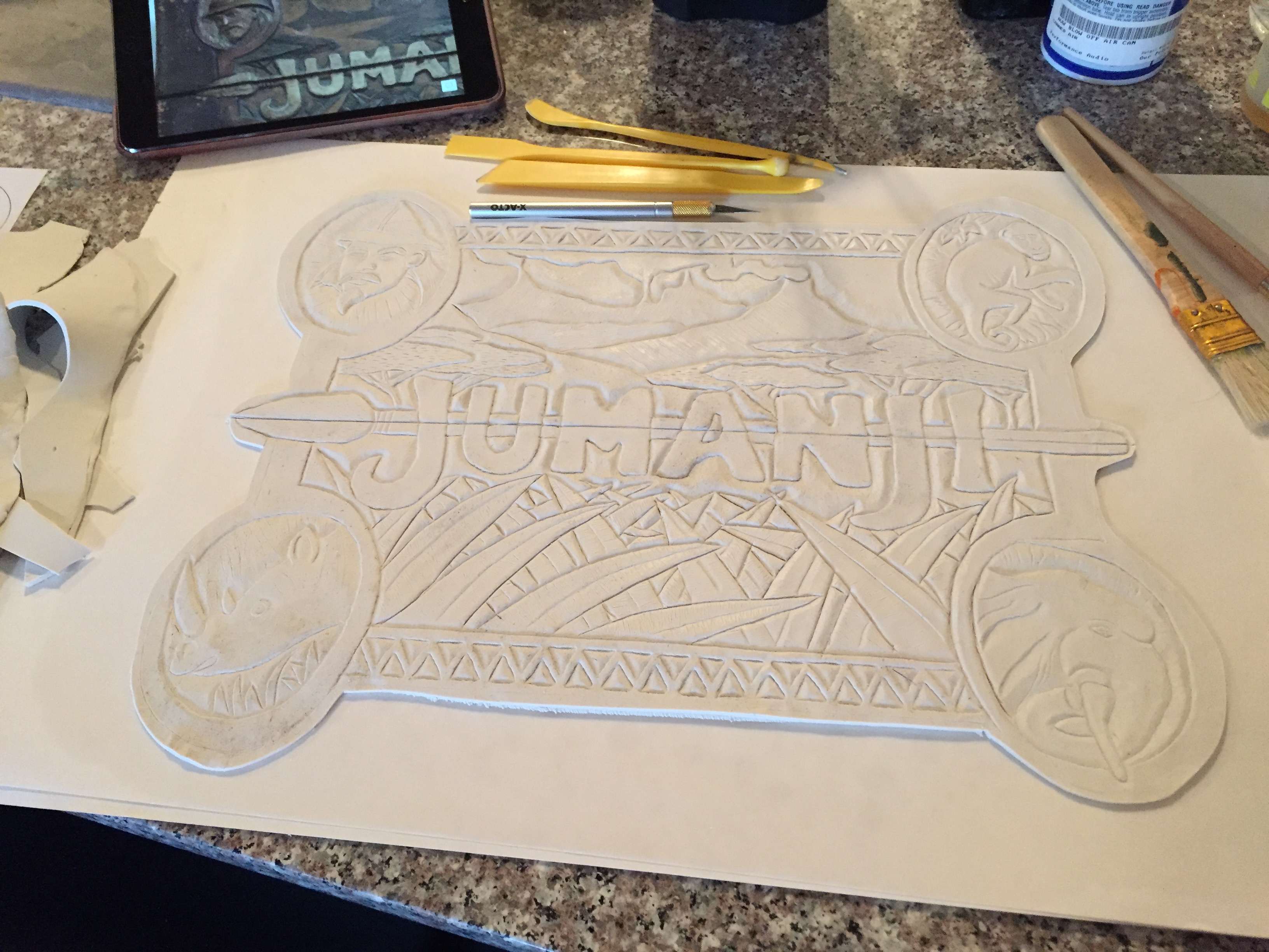

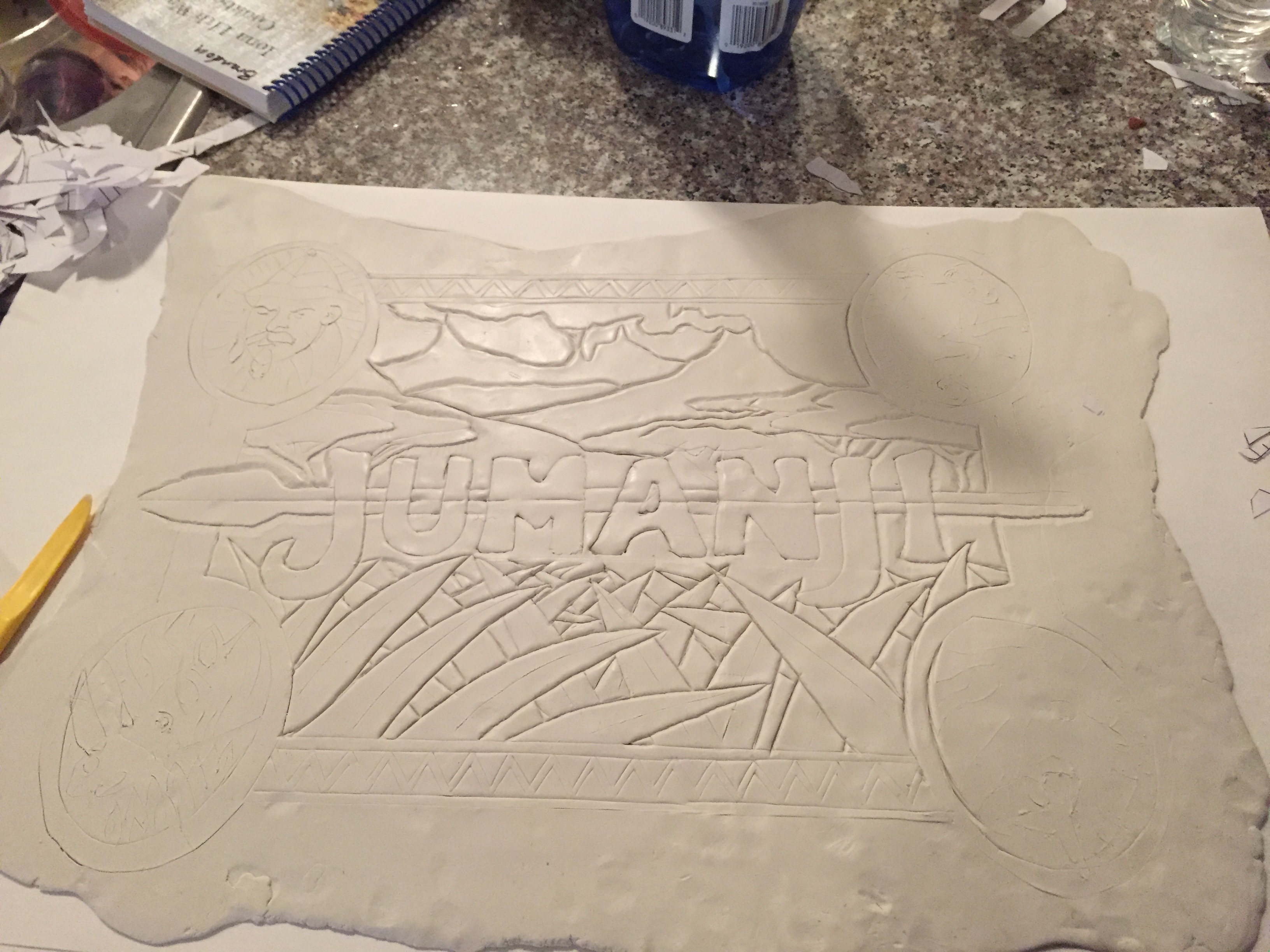

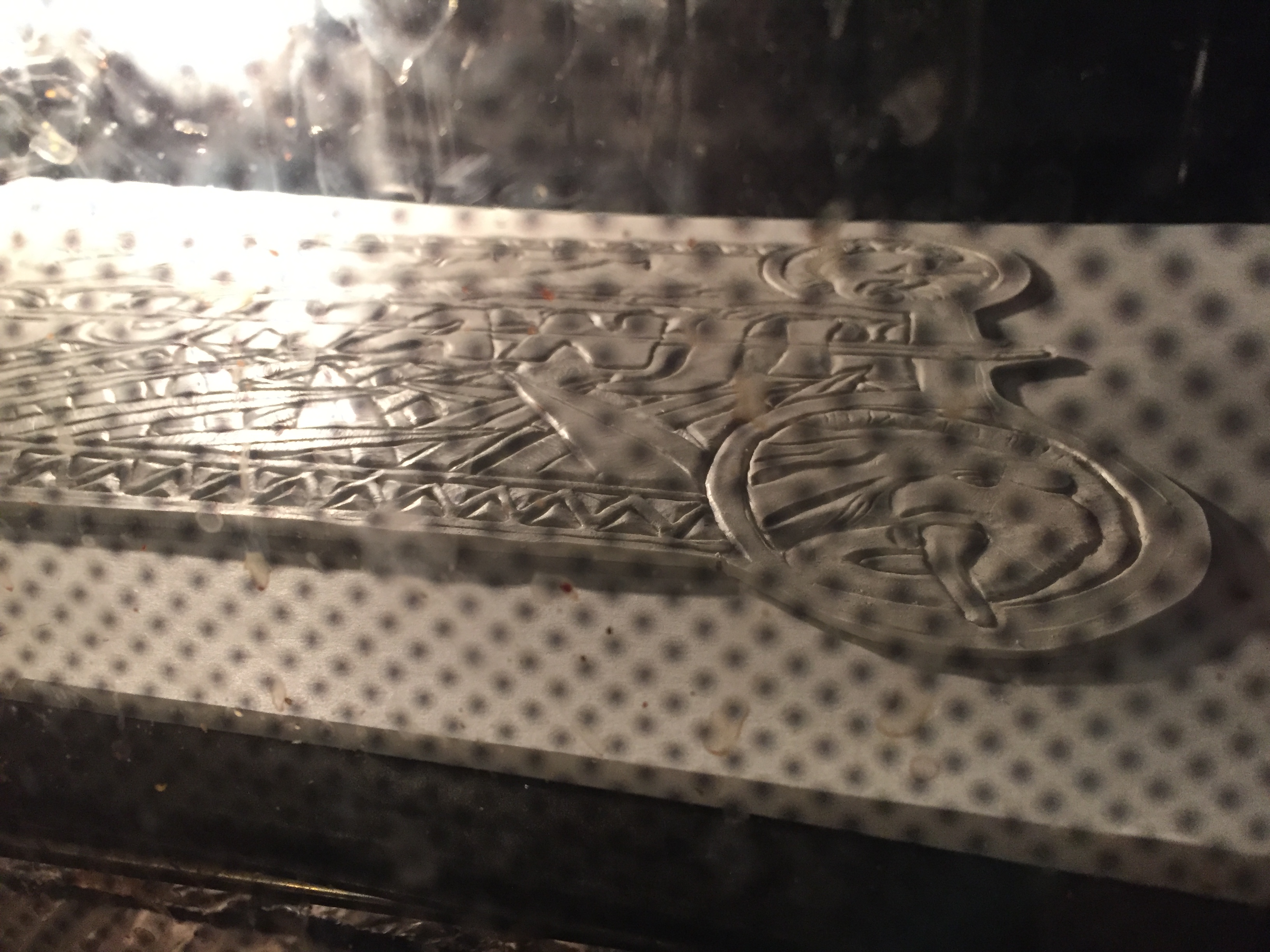

After toying with the idea of using foam for the top artwork, which was promptly abandoned as it shrank too much, I decided to do it in Sculpey.
2016-08-12 18.46.16.jpg2016-08-13 10.10.47.jpg2016-08-13 17.17.54.jpg2016-08-19 18.33.39.jpg

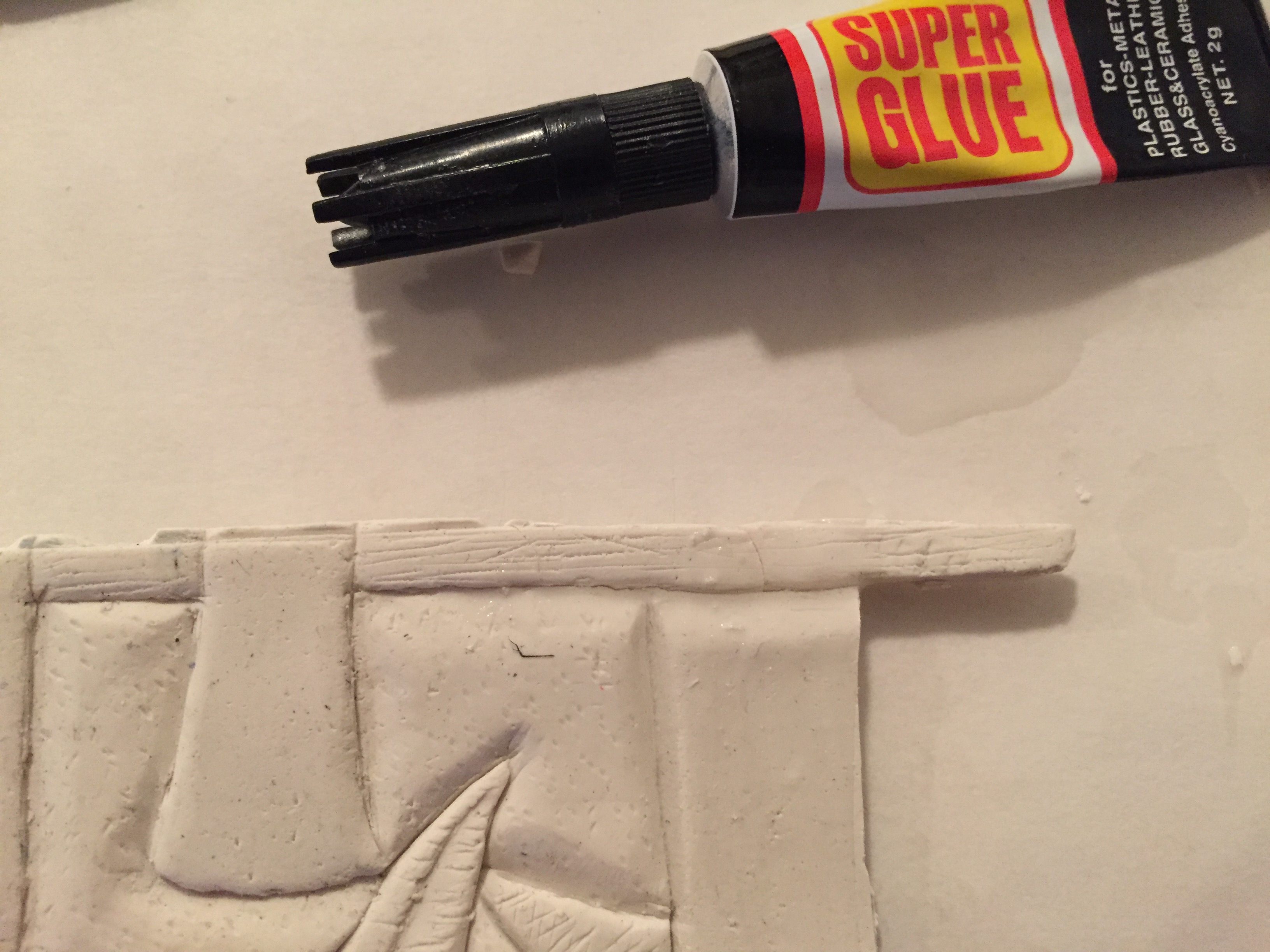

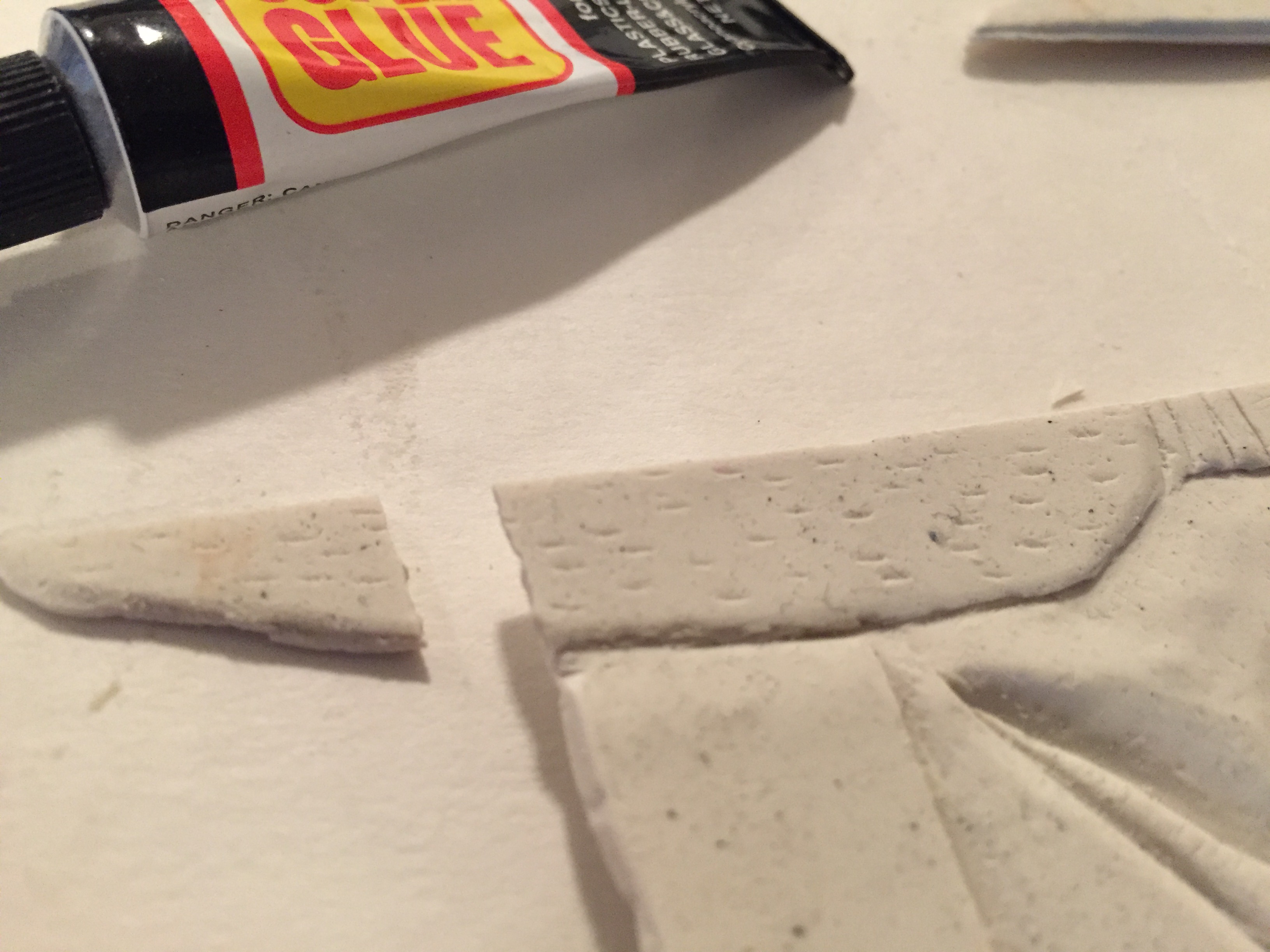

This was fun to do, as well as new; I'm not too familiar working with clay. I found out that after baking it was more brittle than I'd hoped for. I'm not sure if it was an incorrect baking time or if I'd rolled it too think to start with. Or both. Either way, with a bit of glue I was able to put Humpty together again. There were plenty more breaks that weren't photographed.
2016-08-19 18.35.26.jpg2016-08-19 18.35.00.jpg2016-08-19 19.46.24.jpg2016-08-19 19.43.53.jpg2016-08-19 19.44.02.jpg
To give some much needed stability I glued the whole thing to some poster board with spray adhesive and trimmed the extra paper off. This helped a ton with the fragility. Next, to paint the thing.

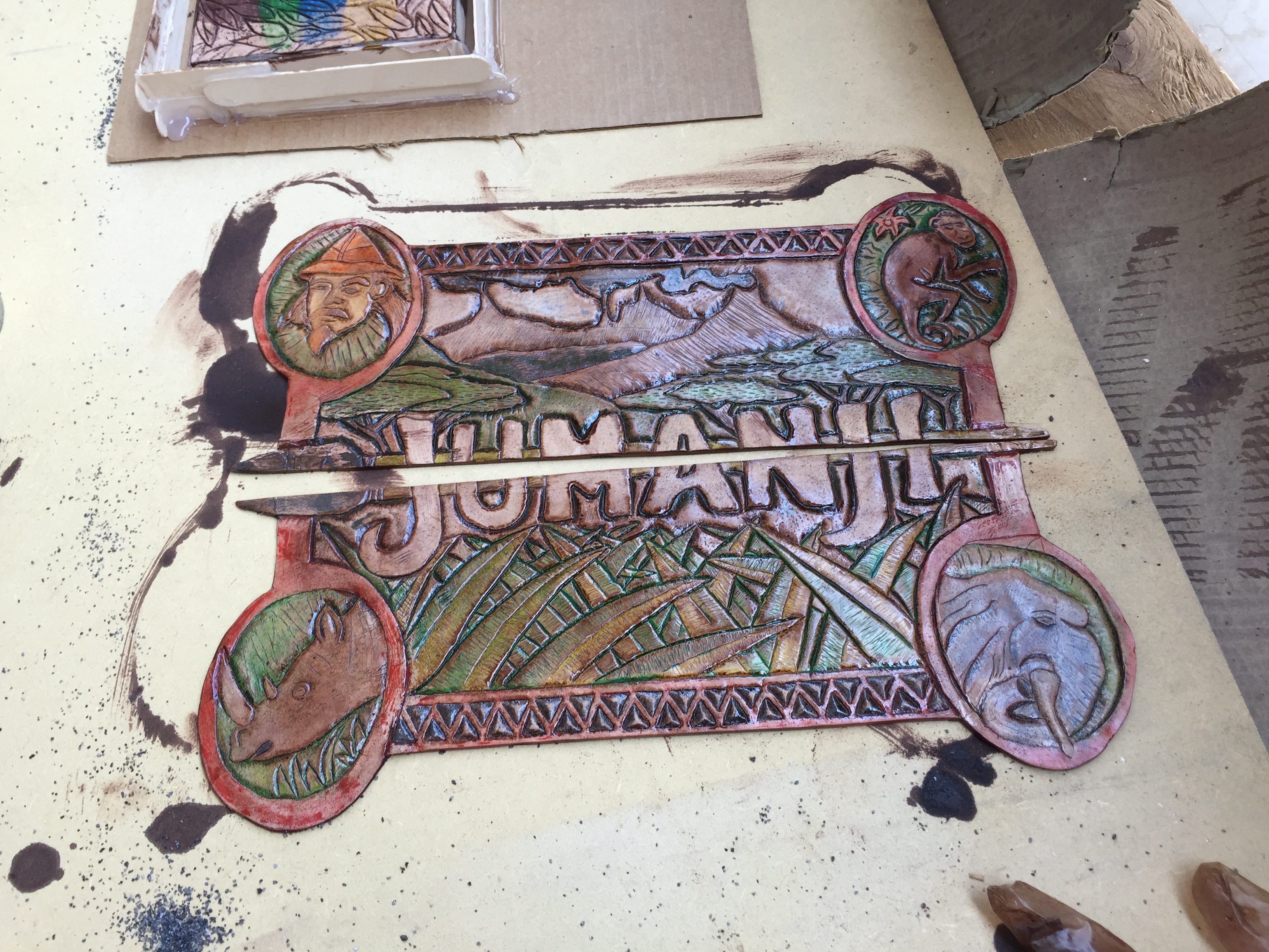

Once the base colors dried, I re-wet them and wiped a little paint off (I used cheap acrylics) to get them more faded looking.
Next, after some tests, I slathered it with the same wood stain I used on the rest of the box. And wiped it off.
2016-08-20 18.11.07.jpg2016-08-20 18.11.30.jpg2016-08-20 18.10.55.jpg2016-08-20 14.46.45.jpg
And after drying, sanding, and sealing it with some urethane, I did another coat.

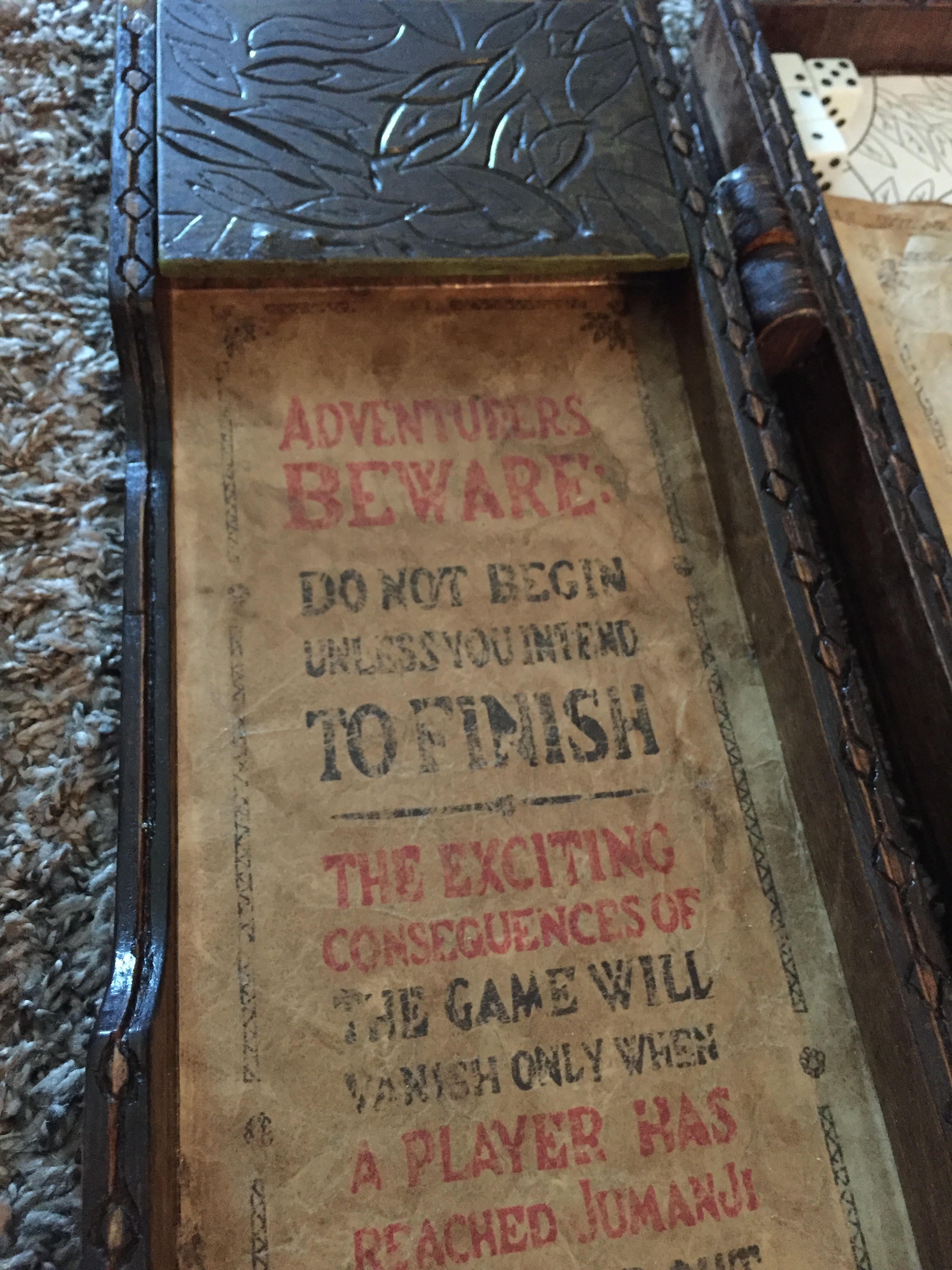

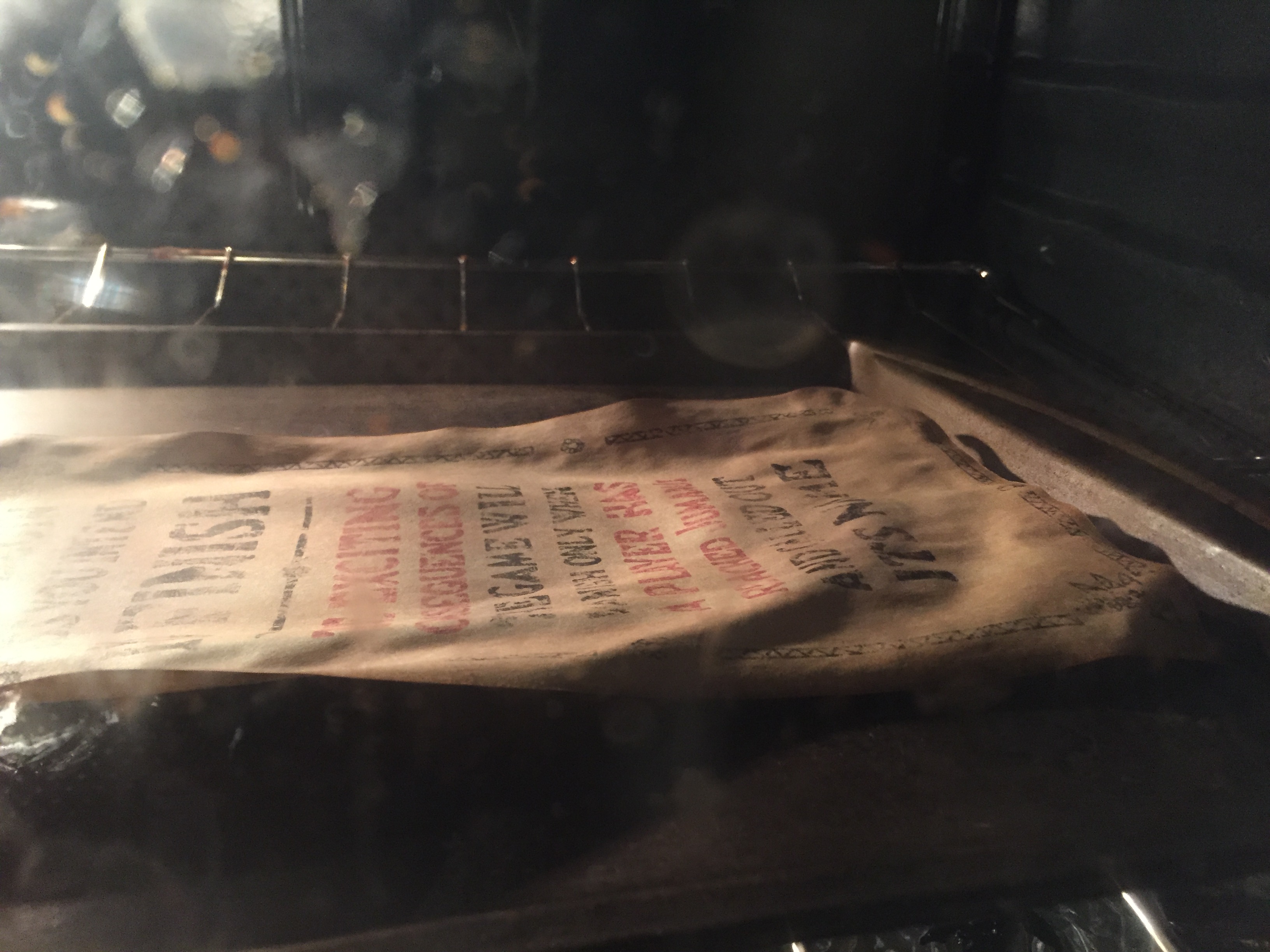

With a bit of Photoshop to distress and add a slight wood texture, I then printed the rules out on Legal paper and cut them to size. I soaked them in tea then baked for a bit. I used a clothes iron to smooth them back out afterward.
One thing I didn't take into account was how much the aging process would shrink. So they were a tad small once finished. As the color also didn't quite feel right this gave me an excuse to try again. I did a couple more versions varying the recipe and process just to see what happens. I ended up using one piece from the second batch and the other from the third. I glued them into place with Mod Podge, smoothing with a credit card. After drying, a couple coats of the same clear semi-gloss polyurethane as the box.

I enjoy returning to projects that have sat for a while, it helps to look at it from a slightly different eye. For me, it is a bunch of fun:) Here is the build as of now:

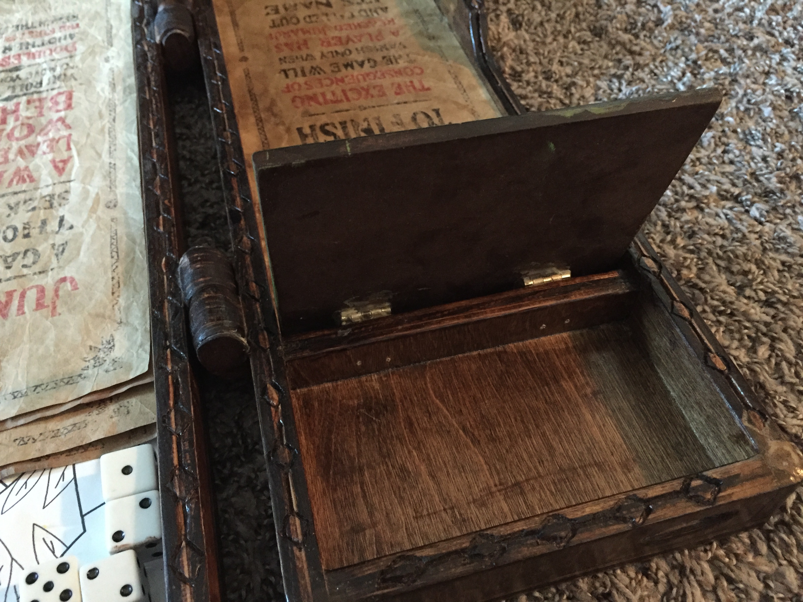

Also pictured above but not properly documented are the small compartment lids and recessed magnets to hold the main lids shut. The lids are just MDF boards (left over from my time machine last summer) with the leaves carved with a Dremel, painted and stained the same way as the outside Jumanji lid pieces. I found some small inexpensive hinges at the Lowes. I still need to add some magnets or something to keep the little lids closed.

Hi,mybest compliments for your work, it's fantastic ! I have a question about the material that you used to make the game ground...What have you used? Dash? Has it restricted when you put it in the oven? For how long and at what temperature?
Thank a lot :)
There has restricted where you put it in the oven? For how long and at what temperature?There has restricted where you put it in the oven? For how long and at what temperature?There has restricted where you put it in the oven? For how long and at what temperature?
Thank a lot :)
It’s just Sculpey oven bake clay. I don’t remember how long I baked it for, possibly 15-20 mins maybe? Sculpey usually has directions for baking times based on how thick it is, although I don’t remember off the top of my head.
However you used a common house oven at a temperature of around 200°C, right?
Beacuse i like your choice to make the game board camp, it's very nice!
Only a thing...i have read that the clay never become hard..so the clay that you used is a particular clay that after time become hard or however it remain a little soft?
