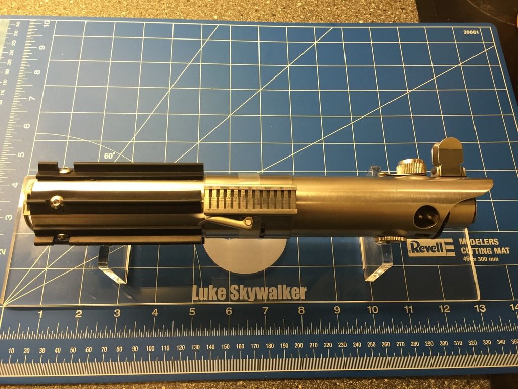

    This is my first build. I recently bought a Graflex flash handle with bubblestrips, d-ring and grips from eBay. I knew early on that I wanted to convert it to a TFA inspired saber. Given the few reference photos, I'm not sure how accurate I can get it, but word on the street is that it's basicly a ESB without the second red button, and no textured mylar tape.

    I ordered a ESB conversion kit from TFX right after I bought the Graflex. The grips came with pre-drilled holes and adhesives. What's sad is that the adhesive was really bad, but I went on with it anyway. The kit came with a Kobold style d-ring, which I find ok. The circut board is more grey than orange, so I'm not so sure how accurate it is.

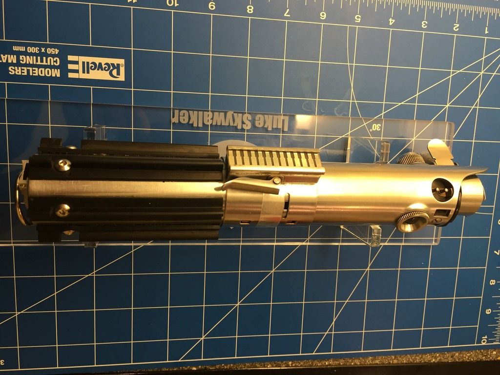

    You can see that the adhesive doesn't hold down the grips enough to hold it in place. The hex screws is not even tightened that much. The grips is really soft, so it was hard to get them straight.
    I chose hex screws instead of philips head and pop-rivets since I think they look better :)
    Finished!
    [​IMG]
    Need to clean up some glue and try to straighten the grips a bit.
    [​IMG]
    [​IMG]
    [​IMG]

  2. OBI WAN KEN0B1
    OBI WAN KEN0B1 Sr Member RPF PREMIUM MEMBER
    Trophy Points:
    1,036
    Looks nice.
  3. russellsch
    russellsch Sr Member
    Trophy Points:
    1,891
    Wow, that looks good! Thanks for the photos showing the build process.
