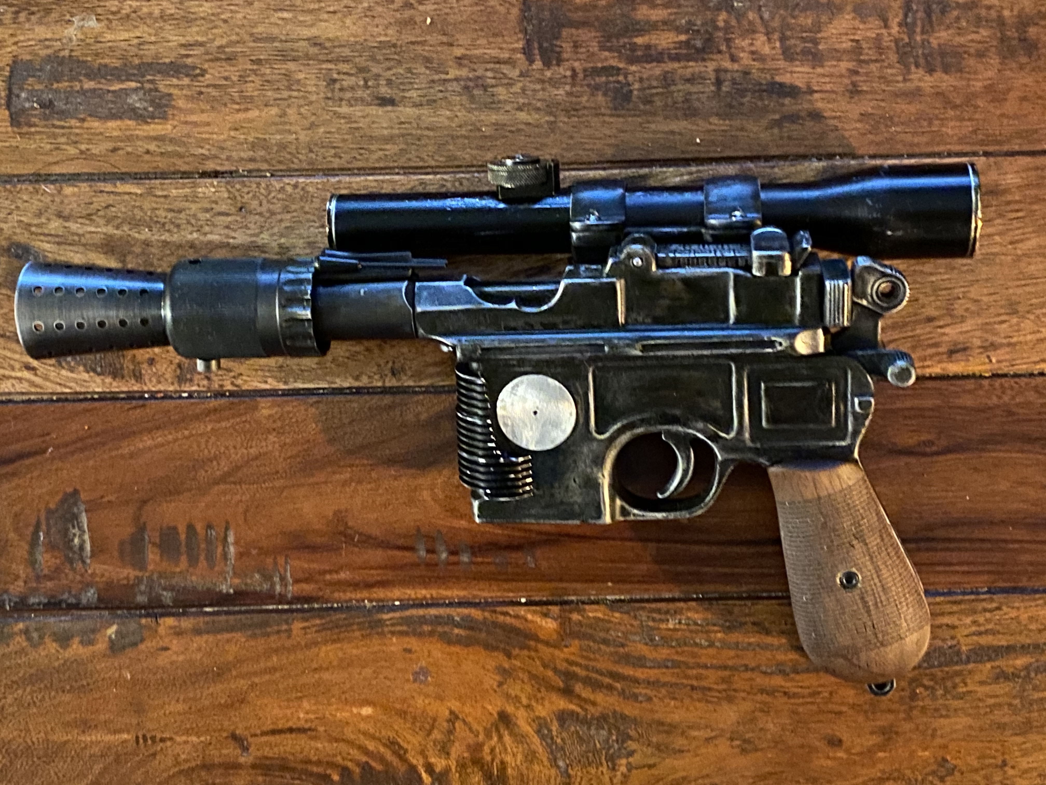

Thanks! I’m new to this community. My second blaster is here: Luke Skywalker’s Dagobah DL-44
War Machine claims that the grips are based on scans & measurements from a real Mauser. That’s probably true. They look great. The basic shape fits the Denix (I think they adjusted them) but you still need to modify the handle a bit. There is also a gap that needs to be filled with wood filler. Overall, these wooden grips are wider than the plastic or wood grips from Denix.
They are from scan but they had to be cheated a little to fit denix frame....
Scope looks great !!!!!

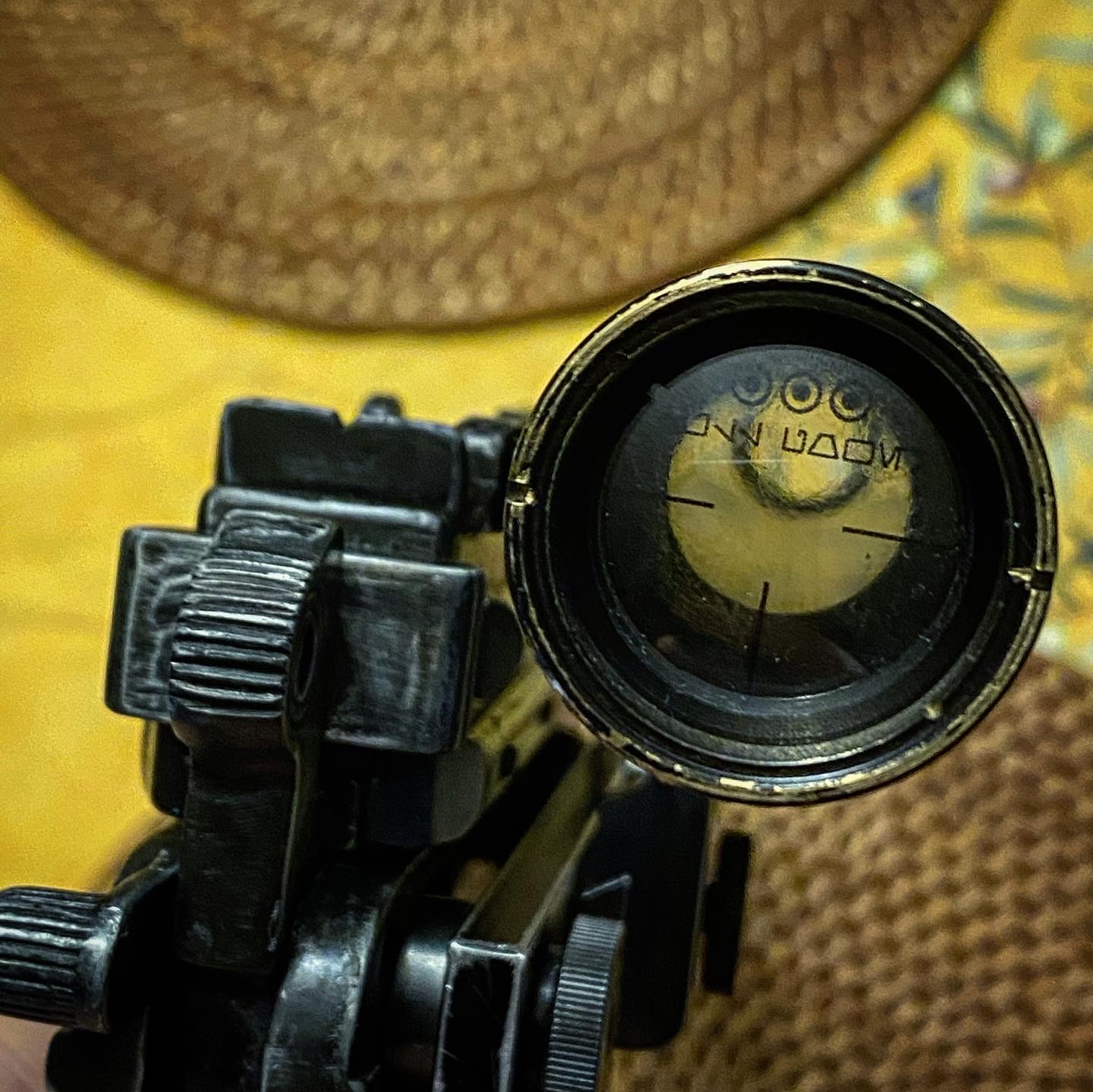

Dude thanks! I got the scope replica from a company called War Machine. The main body is cast aluminum alloy (I think). I toned the metal with layers transparent orange, yellow & “smoke” paint to get it looking like the tarnished brass reference photos I found. I applied black texture paint over that. That way, chipping/sanding revealed fairly realistic brass in a believable way. I think I could improve on the technique. The scope replica had detailed markings on the brass eyepiece rings that were well done & easy to fill with white paint.
I used very little paint. Just dry brushed Tamiya X1 over the JBWeld filler I used to hide the stamped markings. I also ground down/filled the pins & covered them the same way. My steel parts took a few applications of bluing. The new aluminum parts took even more al. black to build up a dark finish. Cleaning, light (fine) sanding & lots of heat helps. At least for me, I’m not an expert with this stuff. A finish coating of gun oil or wax also helps. The only place I used an airbrush was over the filled made in Spain stamp. On the second one I built I just dry brushed that too.
Just remembered... I did airbrush the brass parts with X1. I then sanded them back with 400 & 2000 grit to make them look well worn. I covered all this with satin clear.
I made very thin decals (clear inkjet decal paper) for the sight & extractor. I blended the extractor decal with paint & clear coat.

Aluminum black will darken the Denix metal almost immediately. It’ll look 100 years old in 5 minutes. :)
Dude thanks! I got the scope replica from a company called War Machine. The man body is cast aluminum alloy (I think). I toned the metal with layers transparent orange, yellow & “smoke” paint to get it looking like the tarnished brass reference photos I found. I applied black texture paint over that. That way, chipping/sanding revealed fairly realistic brass in a believable way. I think I could improve on the technique. The scope replica had detailed markings on the brass eyepiece rings that were well done & easy to fill with white paint.
