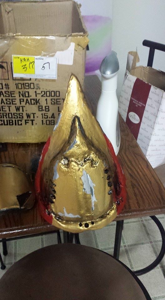

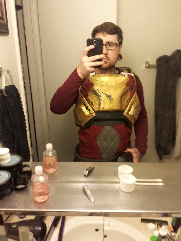

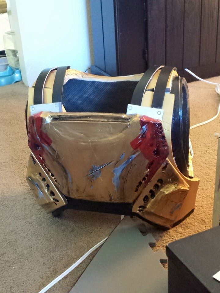

Here's the chest/back armor along with the shoulder bells I made out of the foam, glue and acrylic caulking.
I used a dremel and some heavy grit sandpaper to grind out the organic looking textures.
The chest plate was really tough to do and i ended up remaking it because i got a little too crazy with the hot glue and ended up making a huge mess and the second attempt was better.
.11138584_854733644568494_1005196403666514769_n.jpg10407460_854733611235164_2757076335889259058_n.jpg

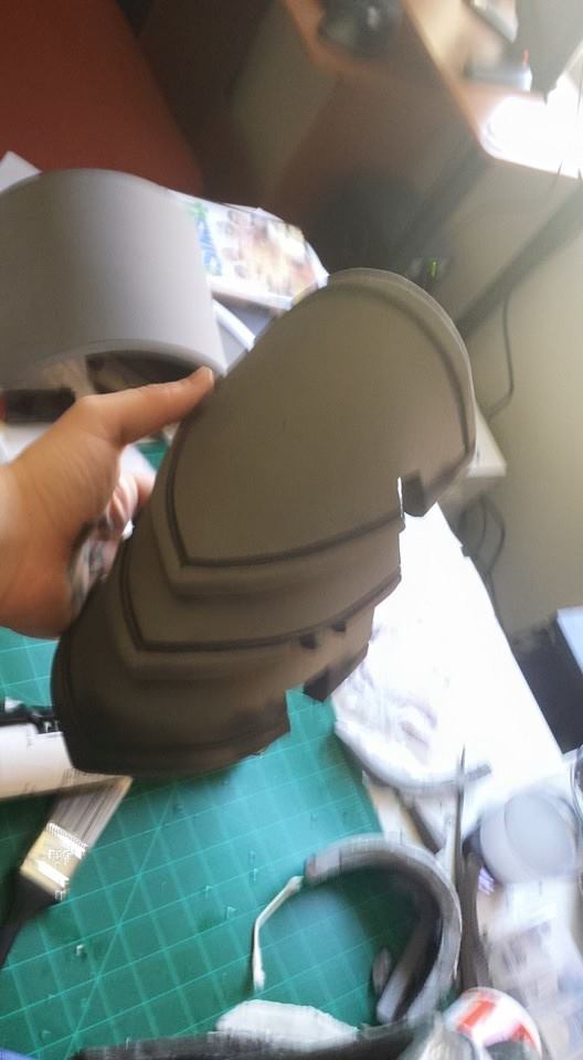

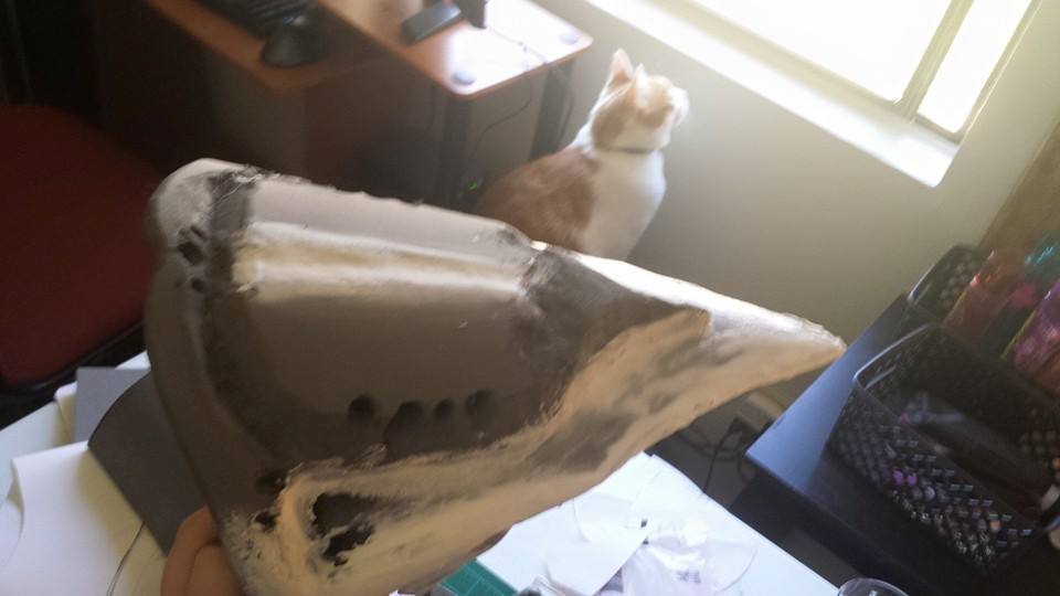

I knew the shoulder bell was going to be hard to make, but 6 hours of cutting, shaping, shooing my cat awayand some filler, i was finally able to get the shape i wanted.
11159496_854733681235157_5962232369373809131_n.jpg11146305_854733754568483_3324004417500569232_n.jpg11156410_854733701235155_7200232461521927233_n.jpg
The left shoulder pad was a little easier compared to the other one, but it took a second for me to figure out how i was going to get clean lines around the shapes, so i found a video on youtube and i cut into the foam with an x-acto knife about halway through and i used my heat gun to open up the cuts i made and i was super pleased with it.

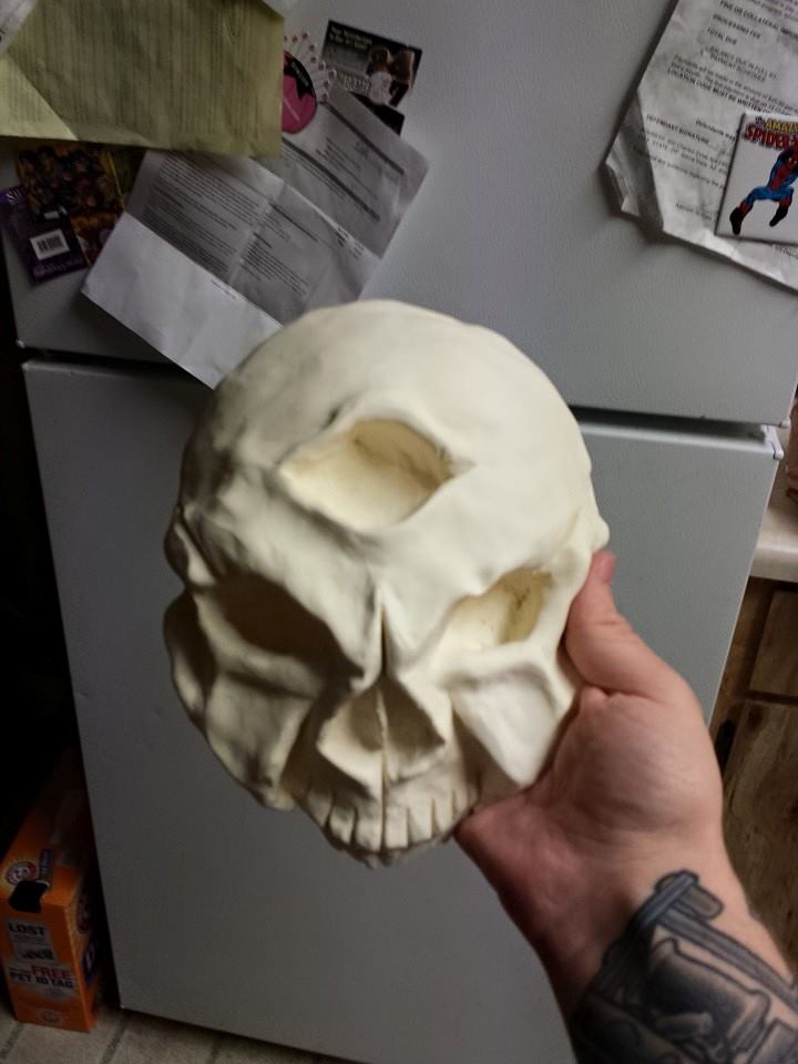

So once i got all the weathering done on it, I started working on the thrall skull, claws and the knife on the leg.
unfortunately, i cannot find any pictures of the molding of the knife, but once i finish it, i'll post it. In the mean time, here's my first attempt at scupting and molding anything.
I asked my father-in-law to help with the mold process since he's experienced in such matters so we made a silicone mold and strengthened the mold with plaster of paris and some gauze strips. Then we pulled the clay out and casted the skull in resin!
First pull was a success!

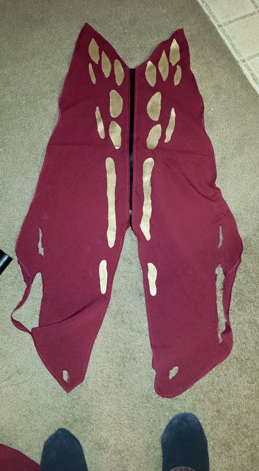

I took a break on the hard parts for the meantime and began to work on the clothing portion of the suit.
I've never used a sewing machine before, so this was a hard beast to tame and i still barely know what i'm doing.

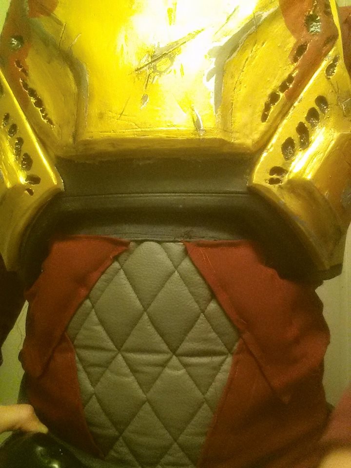

I basically made a vest with the stomach pattern on it to pull over a long sleeved excersize shirt.
The pattern was hard to try and replicate, but i did the best i could with what i had and knew.
i ended up throwing away the first attempt because it was crooked when i finished and i couldn't fix it. But the second run was way more successful. I used an old t-shirt that fit me comfortably as my template and cut out the vest accordingly.
Test fit. so happy it worked.
if anyone has seen the Relentless Harness' stomach pattern, you'll know it's an insane looking design, so i just found some quilted vinyl fabric and used that.
close enough.. haha

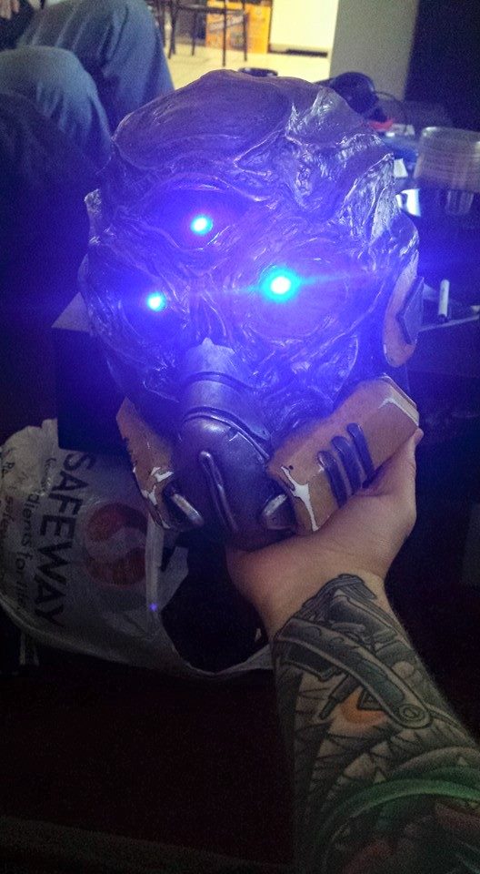

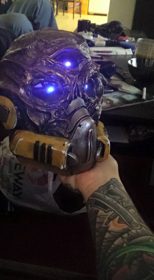

SO I ordered a mask from the talented Steven K. Smith and i could not be anymore pleased with it. It looks and fits great.
(decided to do a little test fit with the mask on)

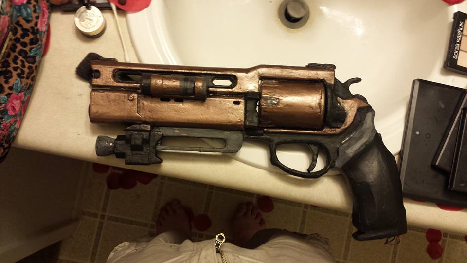

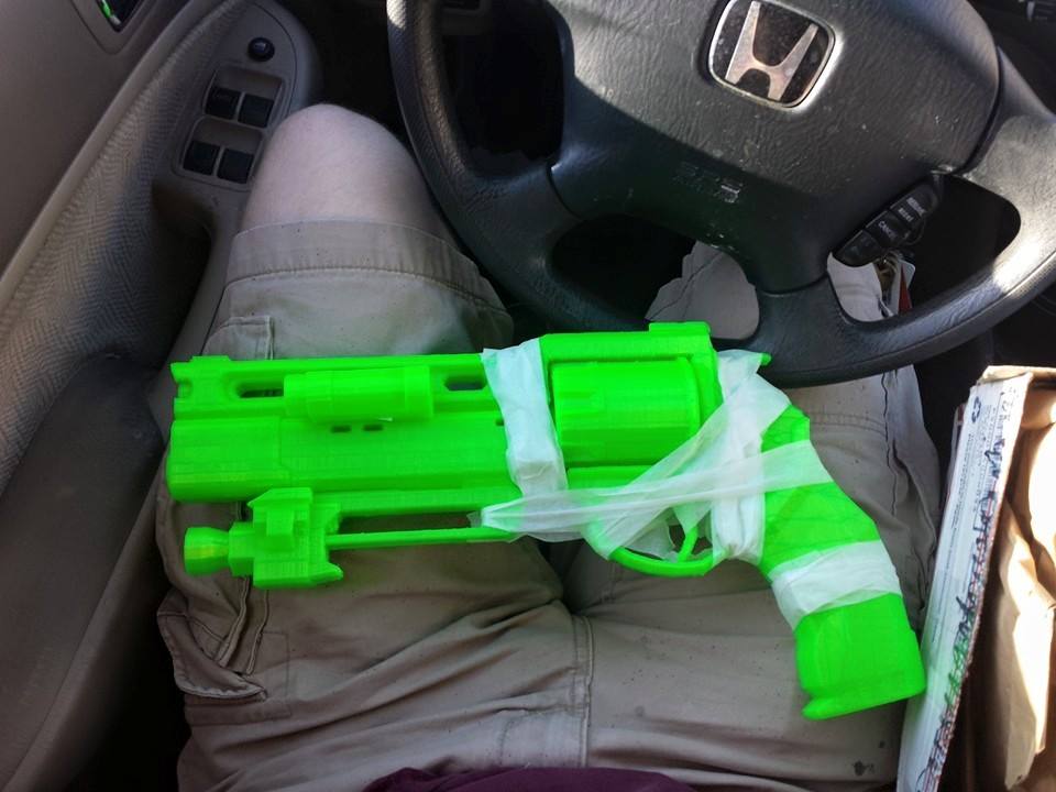

I wanted a sweet gun for my hunter and i went with the Fatebringer.
I got the 3d print off of etsy and i'm stoked. going to fill, sand and add LEDs hopefully next week.

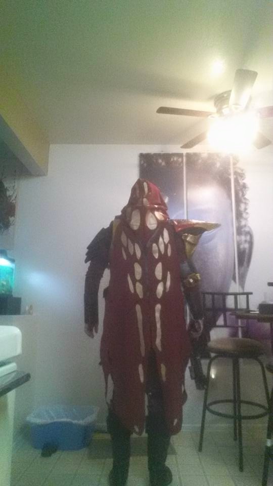

So i was suprised with myself and i was able to get the cloak done in 2 days. A little uneven, but still proud of it.
I used a gold fabric paint i also got at the local hobby lobby. I live in a very small town, so it's hard to get anything anywhere else without online ordering.
11203086_860632713978587_1597260747358787074_n.jpg10394623_860632760645249_8819240719869585886_n.jpg11159541_860632690645256_3553936891629514928_n.jpg11182229_860765243965334_5476899962178231831_n.jpg
I just have to make it so the front pointy part of the hood doesn't droop down over the eye :/ so any suggestions would be great!

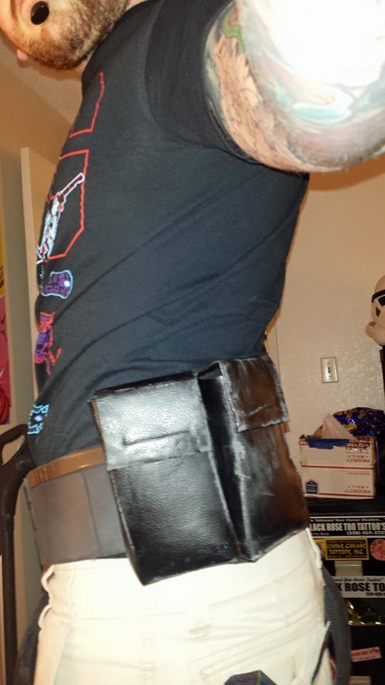

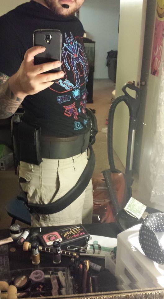

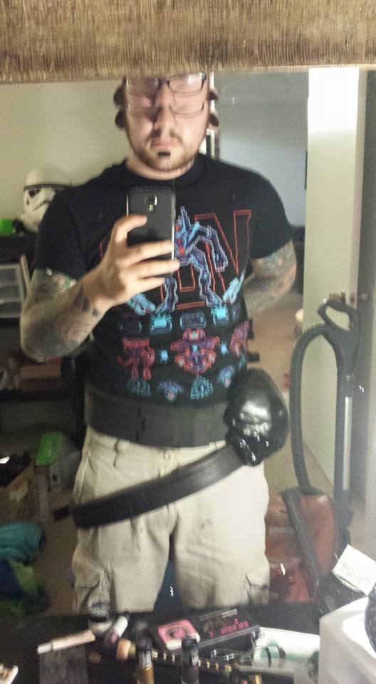

Okay, so it's been a hectic week and I haven't been able to get much done and it's coming down to crunch time and I'm so close to finishing this thing.
I was only able to start and finish the belts this past week, but that only leaves me with the boots, my Fatebringer and the knee armor.
I'm pretty happy with the way the belts came out,
11182119_865664630142062_1771973848808477380_n.jpg11145195_865664650142060_6189199172099222568_n.jpg10407082_865664603475398_1931917901783774766_n.jpg
And the pouches are fully functioning so I can carry my phone, wallet and strange coins in case Xur is around. ;)
10444350_865664513475407_8048147773424249643_n.jpg11219320_865664540142071_7526275122350988630_n.jpg11206022_865664586808733_3098588605826706535_n.jpg

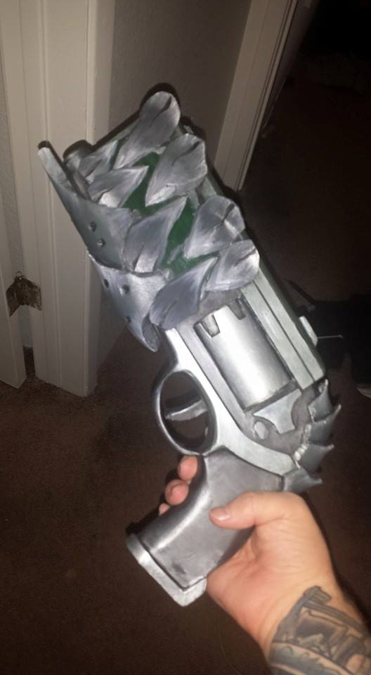

And just in case I wasn't able to finish my Fatebringer in time, I purchased this Word of Crota from Fred Props. Pretty happy with the way he did it. Going to wire a 9v battery to it though so the LED's he installed will be substantially brighter and last longer.

It's been a busy few days and i was able to cram in a whole bunch of work on my Fatebringer. I had some trouble with the wood filler to make the 3d print an even surface since it's not that strong and will flake off and chip off if you're not careful. I should have used something like bondo or something tougher, but it'll be alright for now and it should hold for con.
I'm pretty happy with it, although the only thing that i cannot figure out is why the 9 volts keep getting really hot. If anyone knows why, i'd love to hear any troubleshooting advice!
Should be all finished by next week!

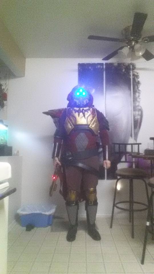

I was able to get to about 95% completion this week and I'm pretty happy with the results. Going to get better pictures of everything when I'm not by myself and using my toaster oven to prop my phone up.

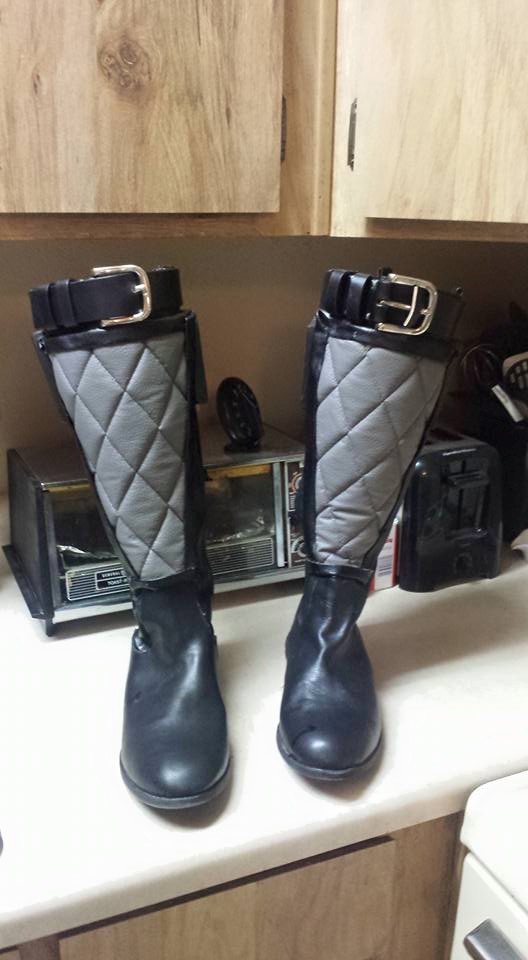

These were once women's boots I got at Walmart for 10 bucks on clearance. Stoked with the way they turned out.
The angles on these pictures make everything look so stumpy and husky but i will get better photos i promise!
The knife on the thigh is the only thing that's left to finish. Thanks to anyone who took the time to check out/comment on my first build. It was super fun and I learned a lot. I'll be at Phoenix Comicon next week. Friday and Saturday. If anyone sees me, come and say hi to my wife and me!
