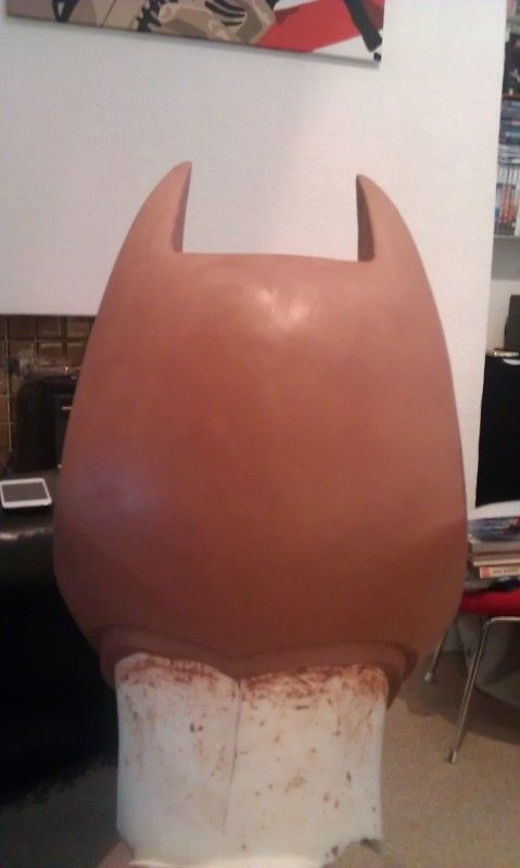

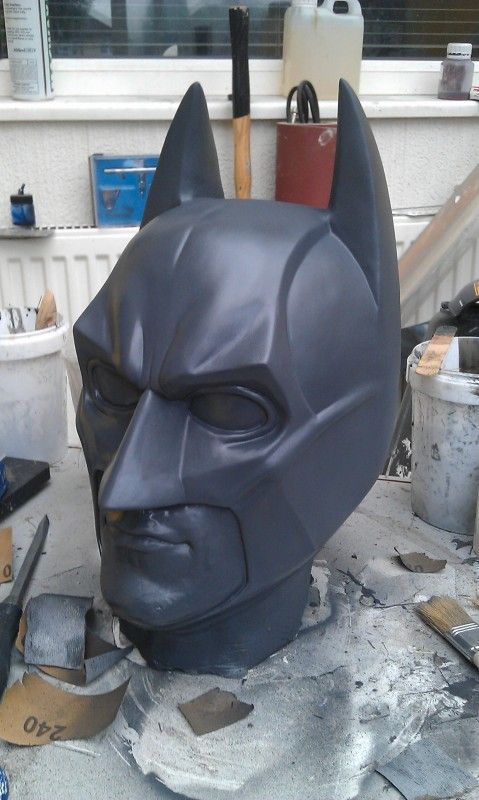

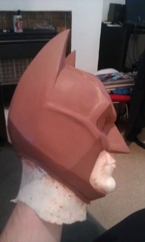

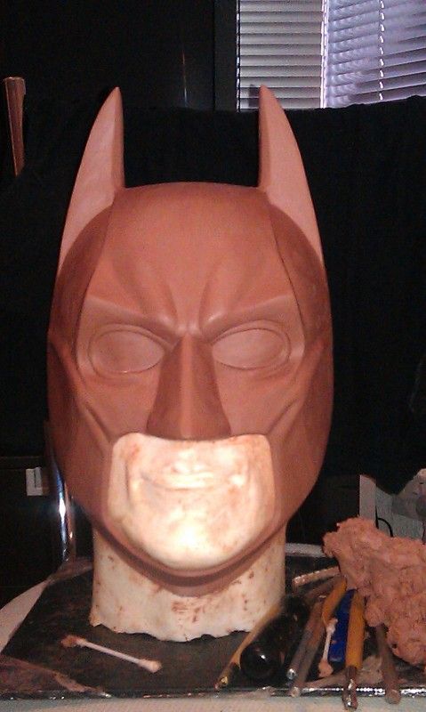

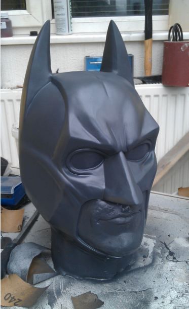

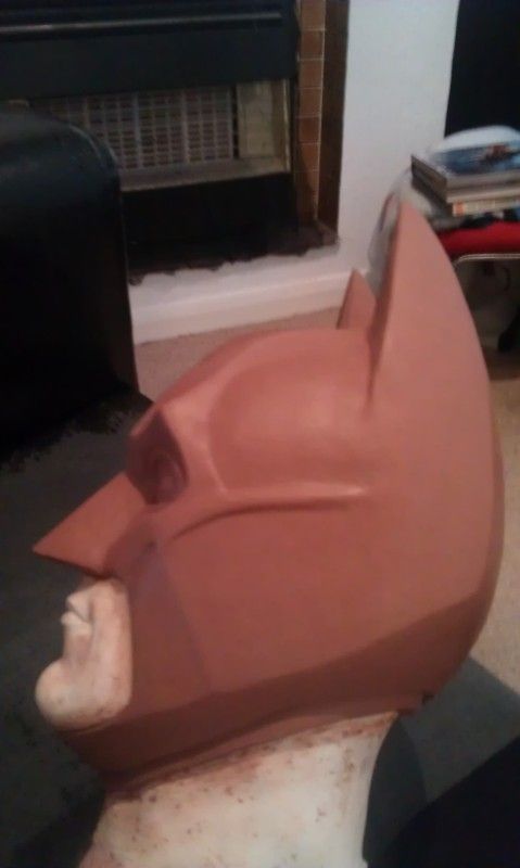

Posting this here for the first time. Been working on this on and off for a while now but the movie being out soon is pushing me to finish it.
These pics are all of the sculpt. My black paint is coming tomorrow so I used primer to see how it looks with a matt finish. Hopefully molding this weekend.
Hope you like it (cuz I aint changing it now :lol )
Nat.
And sealed:
Thanks Nate. Initial castings will be standard urethane rubber, followed by cored urethane castings and eventually foam latex.
I'll be posting many photos of the molding process as I go. I'm using the same techniques they used on the movies and have spoken with the mold designer Brian. It will be lots of fun :)
Its chavant LBT clay. The primer was sprayed on to get a better look at the smoothness and to give it a matt finish that will transfer to the silicone mold later. It doesn't really make the clay hard, just puts a layer over it.

looks like you might have missed the little shelve thats between the nose and lip
other than that, if you sand the hell out of a resin master you could end up with something looks really really close~
I didnt miss it, I just didnt add it lol I don't like the addition to the cowl so I left it off.
I sprayed it a matt black and believe me, no more sanding needed :)

Thanks for the kind words folks. The lines on this weren't easy to capture but I think I have it pretty close based on the photos I had.
