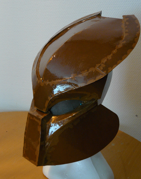

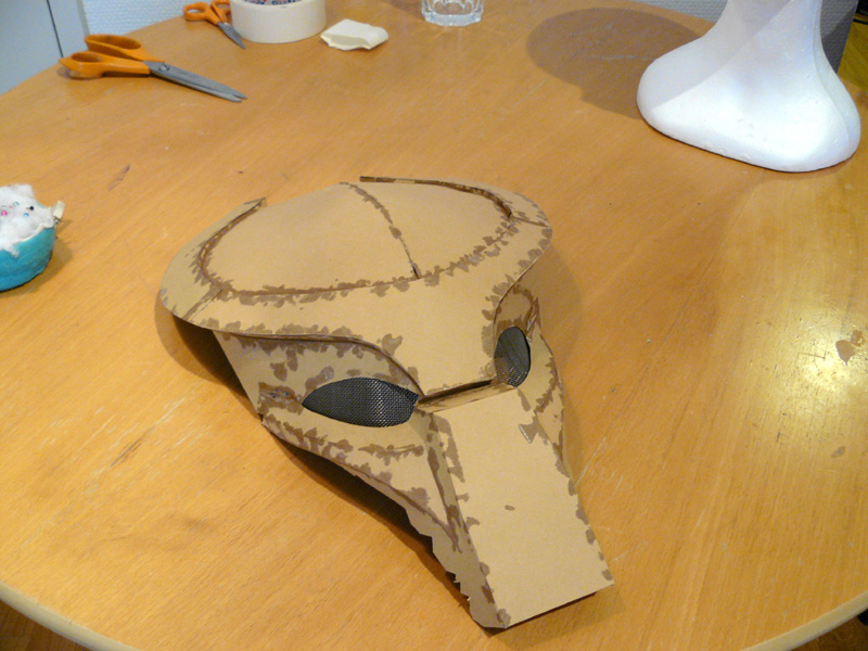

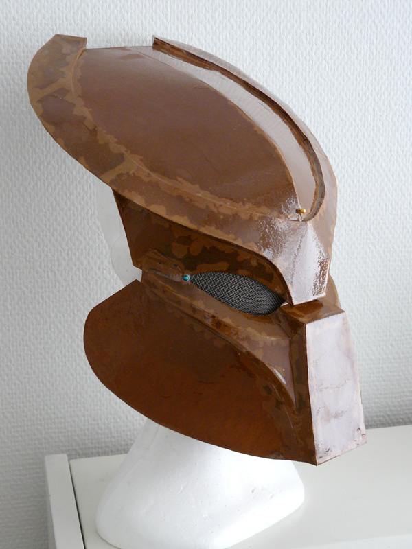

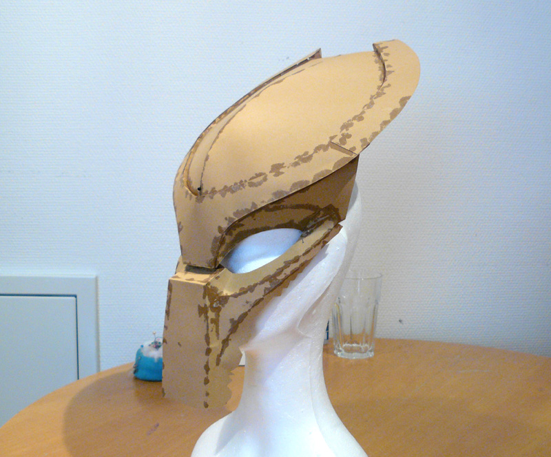

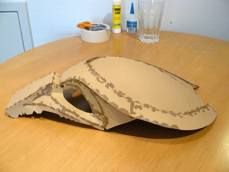

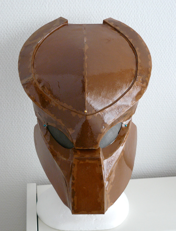

I've been wanting to try my hands on predator costuming, but never quite find the time to do so. Last week I stumbled on pepakura bio helmet while surfing and I had to give it a shot. I'm familiar with fiberglassing and fiberglass mold making so I thought that this pep could give excelent base for custom bio build.
I quickly threw cardboard helmet together and I wasn't too worried about the overall aesthetics, I focused on symmetry but cardboard just gives the internal core thats going to be glassed from outside and inside. I used cyano to glue cardboard because I feared that pritt paper glue might give up under resin.
Here are first pictures from the cardboard folding nightmare :)
kanji

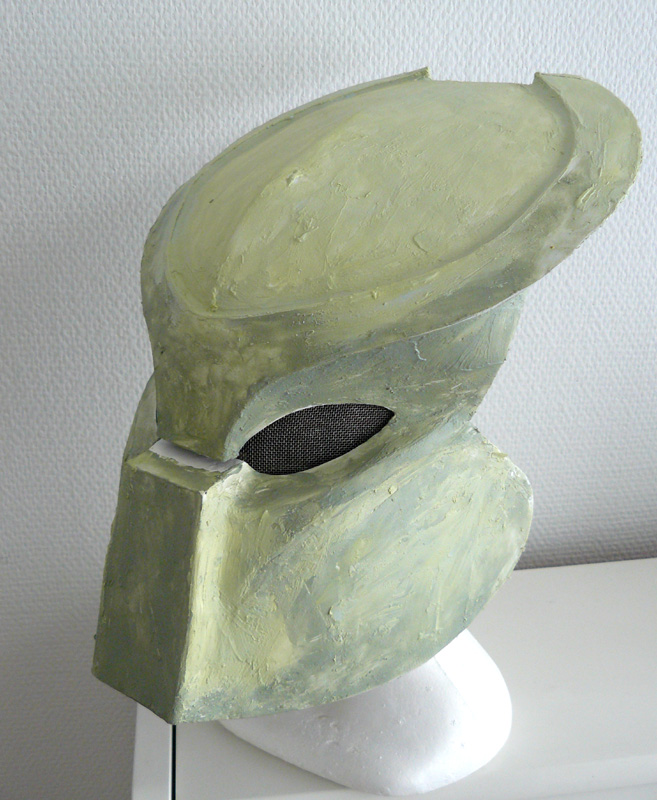

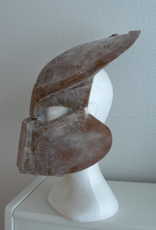

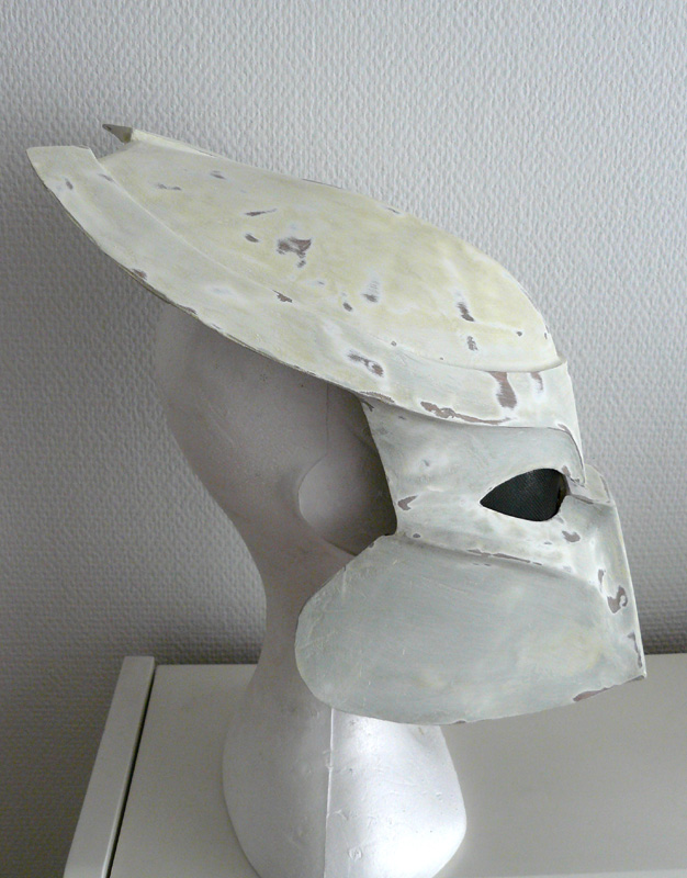

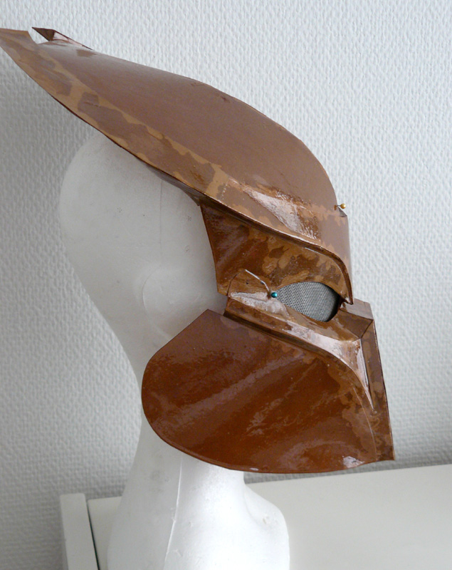

Here is where I got yesterday. I soaked whole helmet with 30minute finishing epoxy resin and let it set for 6 hours before I started to laminate pretty heavy 100g/m2 fiberglass rowing over it.
kanji

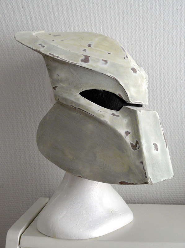

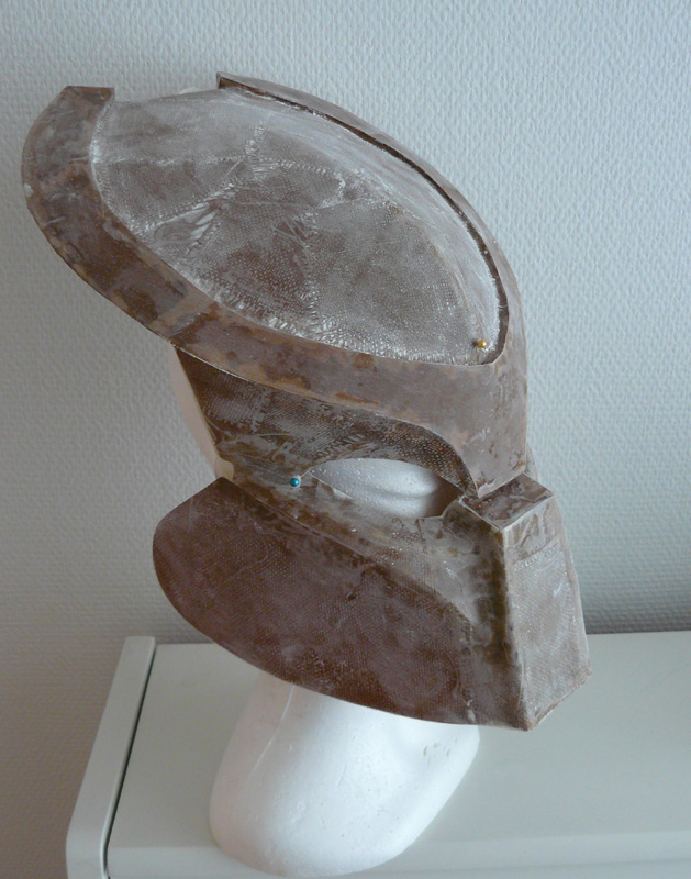

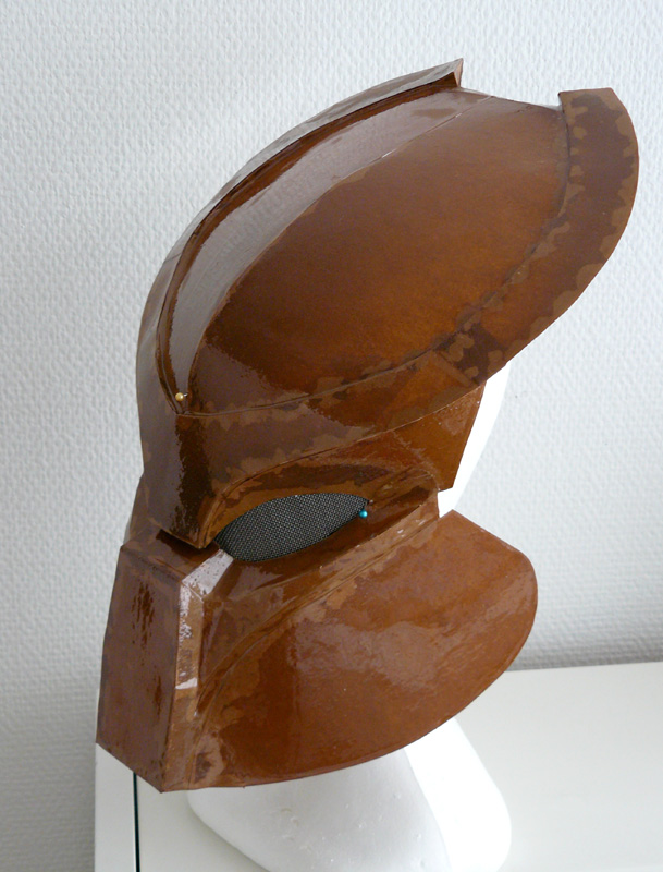

Ok, and here is where I'm at today. I roughly sanded fiberglass weaving and took couple quick photos. This evening I'm going to glass the halo's upper and lower lip and fix the symmetry issue on left cheek.
Area between eyes is also going to be cut open, I just need to lay couple 50g/m2 fabrics in there to give rigid construction.
Other than that I'm quite happy how this is turning out. After I've glassed whole bio, I plan to spread filler/bondo all over it and sand it smooth. Then I start to lay more contours and details with bondo. I'm still strugling, should I make this as sleak and polished I can, or try to go for that hand forged metal look that suits P1 bio. :)
Thanks for looking and I will post more updates propably tomorrow.

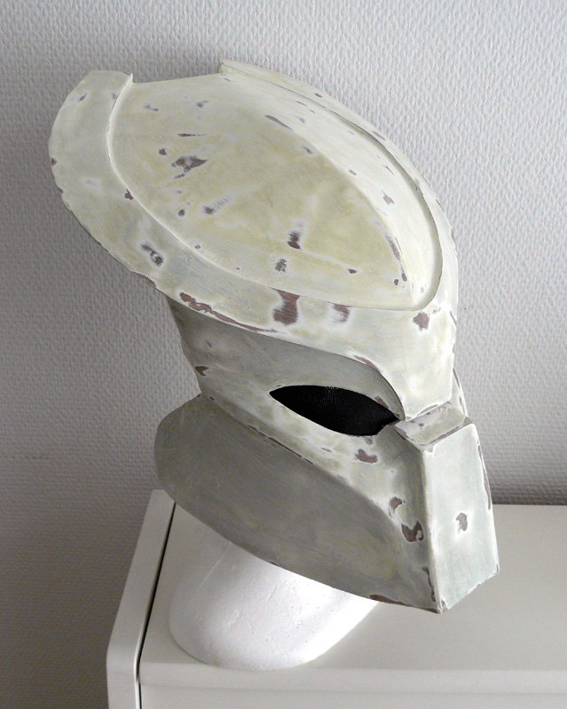

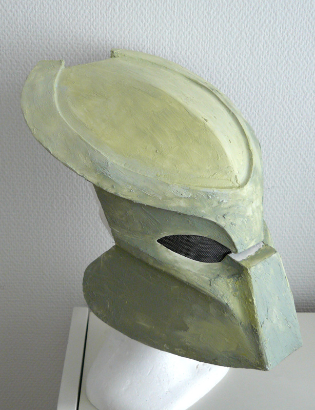

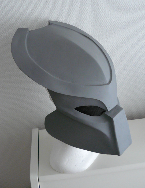

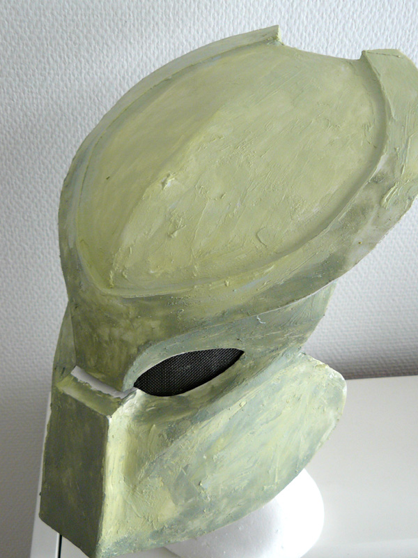

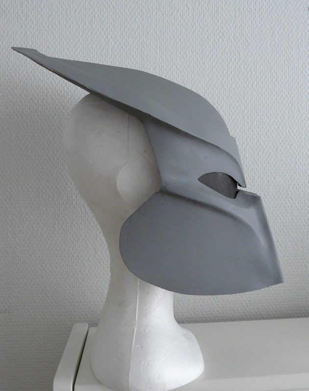

This morning started with 2 hours of nonstop sanding action. When I finally got helmet relatively smooth and even I sprayed fast drying white primer to show imperfections on glassing. After primer dried I threw healthy amount of 2 composite putty/bondo on top. On most areas there are at least 1mm think layer of bondo, but on areas like the halo and mouth there is quite a lot of to give more room for sanding contours. I let bondo to set at least 10 hours so that its fully cured and dont block sanding paper before I continue. I have to let my elbow rest too, that resin sanding this morning was quite a undertaking :popcorn:
I will show you guys the good, the bad and the ugly
After I've got the basic shape clean I add targeting housing and other smaller details.
btw, I'm not an expert on different size bios, this one measures 10,5 inches widht on halo, is this on smaller side or...? :)

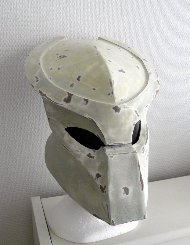

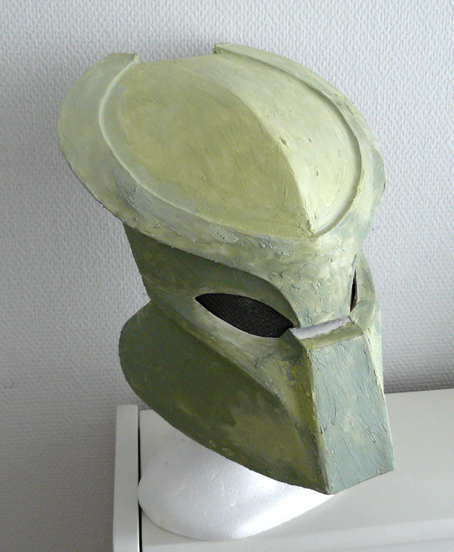

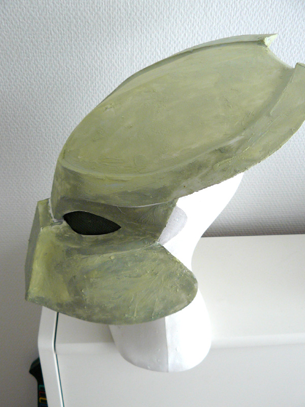

Two composite putty took almost 24 hours to fully cure, and yesterday evening I sanded most of it off. Here is couple of pics from the bio after rough sanding. I'm still thinking, should I sand this as smooth as I can and add another layer of bondo after primer coat, or leave it as it is. Now there is couple longer "scars" and dents and some smaller imperfections that would gather weathering nicely after final paintcoat :)
kanji

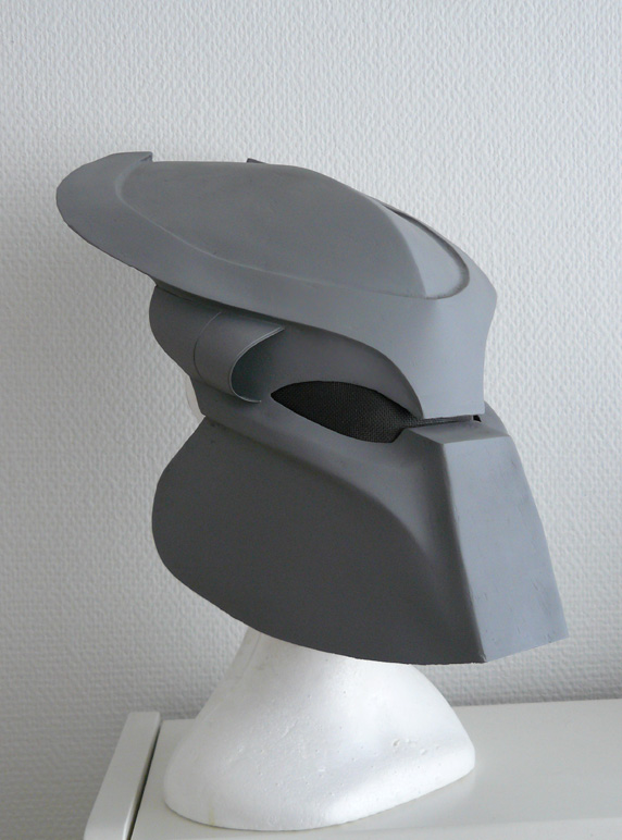

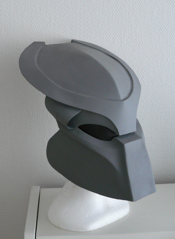

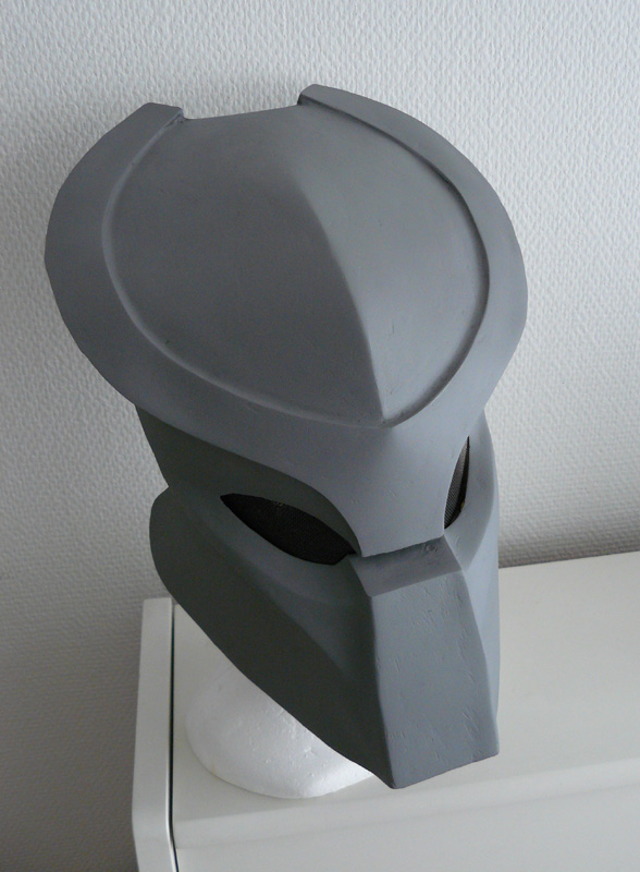

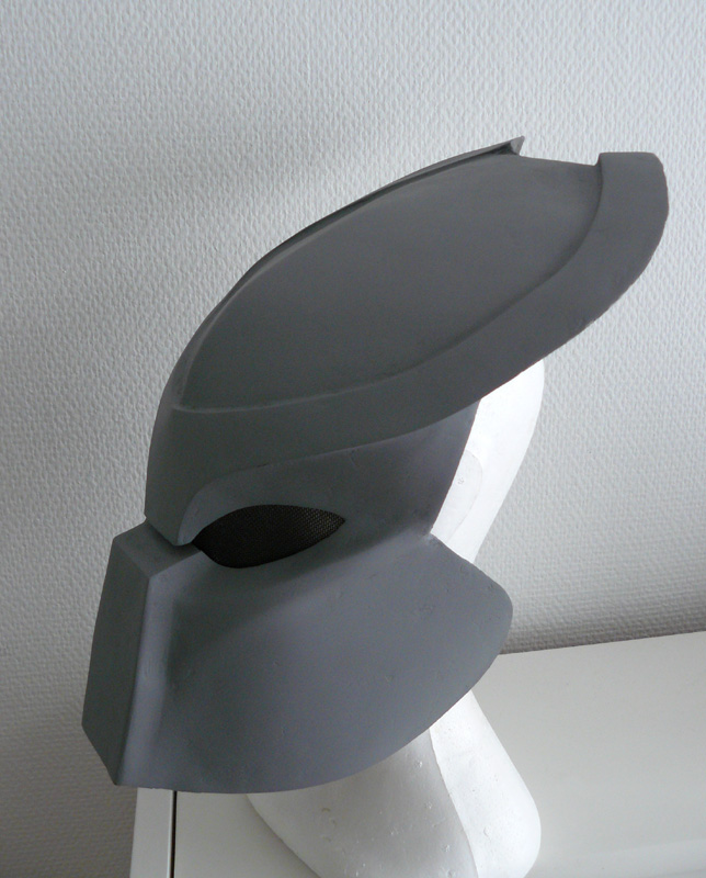

And here are some shots after first coat of building spray primer. Now I'm going to let that primer to set and then start filling that outer seam on halo. I might threw some filler on those couple bigger dents on the mouth and right cheek are too.
[edit : I added couple pics after adding laser housing.. rough skecth but I make it work :) ]

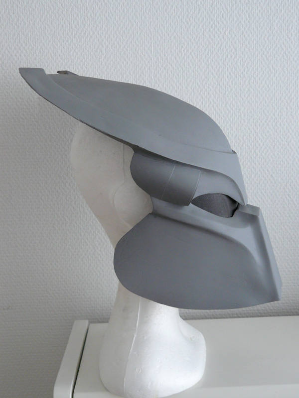

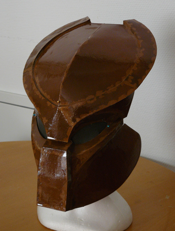

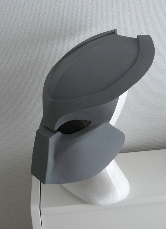

Oki, got some work done.. helmet now sanded and put another coat of filler, and sanded, and primed and... I wanted this to be sleak and polished bio. I ended up on my second idea, more hi-tech predator, without traditional dread beads and tribal feel. I just threw some thin and some 12mm diameter rubber insulation on the foam head to show where I'm going with this. I'm going to make some 30mm diameter dreads from latex to give back side of the head more volume.
I will paint helmet with pearlsheen antrasith gray and give it good polish. These insulation "dreads" are going to be dipped in black latex so smooth those out and give even colour. I want to use that black plastic installation piping as beads, those are going to be gunmetal grey and some basic shiny black.
Thanks for looking. I'm quite happy how I got that cardboard helmet turned to fiberglass one and now its origins are quite hidden.

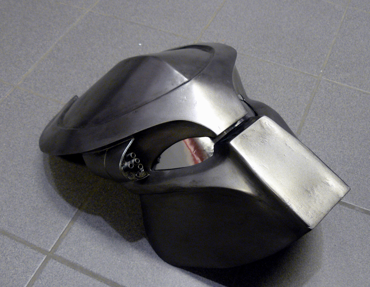

Let me say that the metallic pearlsheen paint coat is unforgiving.. Every single scratch shows.. so it would be back to filling and sanding, or just flow with the punches. Now I have first pearlsheen grey coat on and tomorrow I'm going to shoot another pearlsheen mist coat over, but really lightly and with bit darker grey to add depth. Then I planned to weather this with bit darker gray thats on the bio itself to add some depth to those scratches and dents, but I dont want to do that with black, that would accent those too much. Well, I will post more pics how this works out. Pics dont give justice to shade of that paint, its wierd almost cameleont kinda paint that changes from almost chrome to darker antasinth grey and it has really fine metallic grain, not similar with cheaper spray silver/aluminium paints

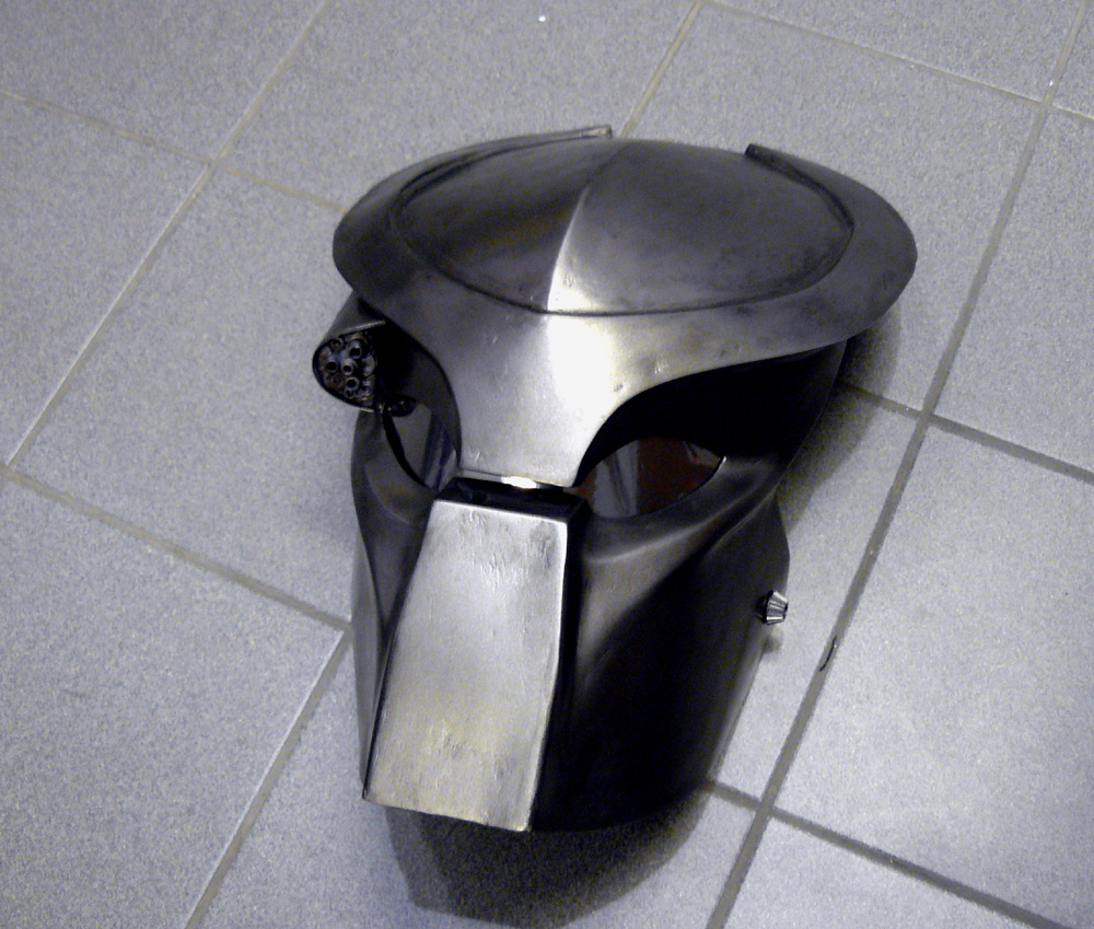

I added first details before I shoot first final paintcoat. I added plastic gear on left cheek that resembles one on P1 bio. I got gear from RC cars differential spareparts, now when I look it after paint, I propably should have sanded some height off from that gear :lol: I also throw together really quick mockup from laser targeting, it also has some misc parts, like 3mm led, some wires, small gear from servo etc..
Oh, and you can see that I also added mockup P1 styled visor.. I have to get bigger and unfold piece of that plastic, so I can make final and tidy visor.
kanji

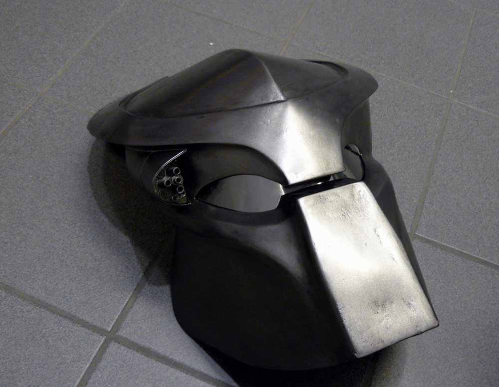

Ok, added some light gunmetal/black weathering wash and smeared lightly over whole bio, it looked to tidy in all chrome paintjob.
I will sleep over night and take good look tomorrow, if I will weather it more or seal this with final clear coat.
Sorry about that dented visor, I have to get clean film so I can make final visor.
