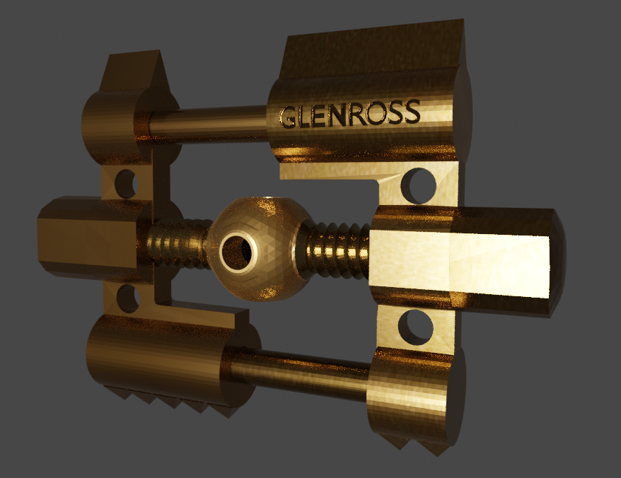

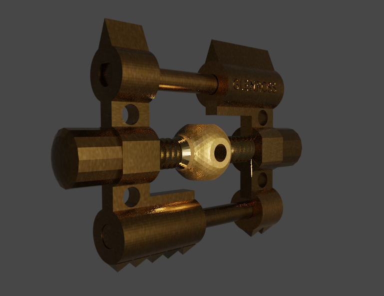

Sorry 'bout that! Still a bit of a work in progress. that text was mostly a test. I'll work on that!I will get some real ones out tomorrow and compare.

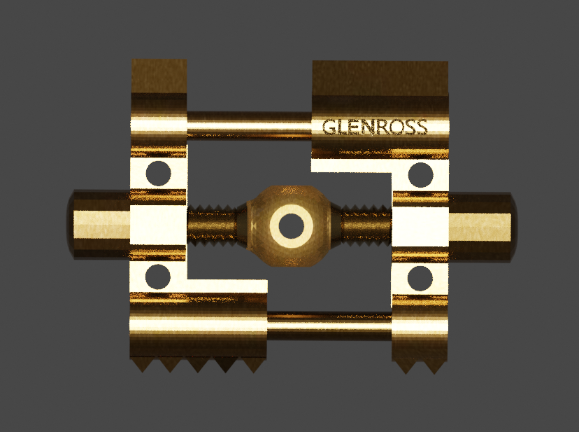

But in the meantime I can tell you without any shadow of a doubt that Glenross most certainly did not use the horrible Arial font.
Thank you! That would help so much!I'll see if I can identify the font for you.

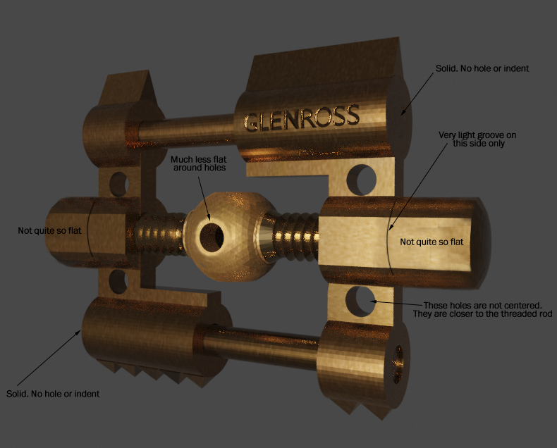

Excellent model in general. Here are a few minor changes.
Thank you!! I will adjust accordingly!I better get a good magnifying glass out for the font.

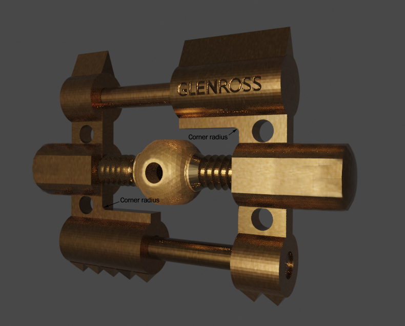

Another minor change.

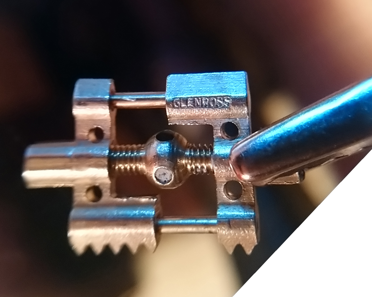

looks really close to me! There are minor differences between what's on the dental screw and Franklin gothic, but it's also engraved on metal and it's tiny!For the font maybe something like Franklin Gothic but without the tail on the G?
Oh well.Yeah, forget the Franklin Gothic. It would need to much altering.
Wow, this is hard! There are a bunch that look pretty similar to what's used on the dental screw. But it's hard figuring out which is the closestHave a look at some of these:
Similar Fonts for this image
Similar free fonts and alternative for Korolev Rough Medium - Crakos, FlamanteRoundBook, Keyes, Hussar Pisanka, Rounded Mplus 1c Medium, Nunito-Regular, Averiwww.whatfontis.com

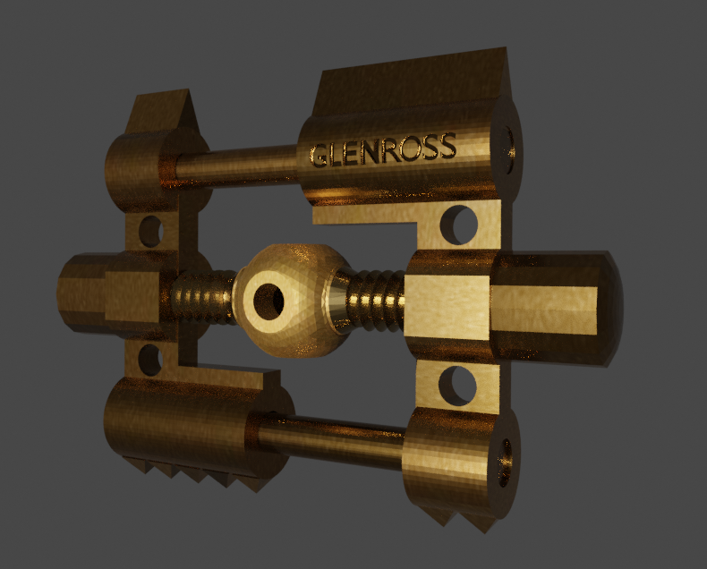

Got it! Just need some more time to work on it.A few more tweaks.

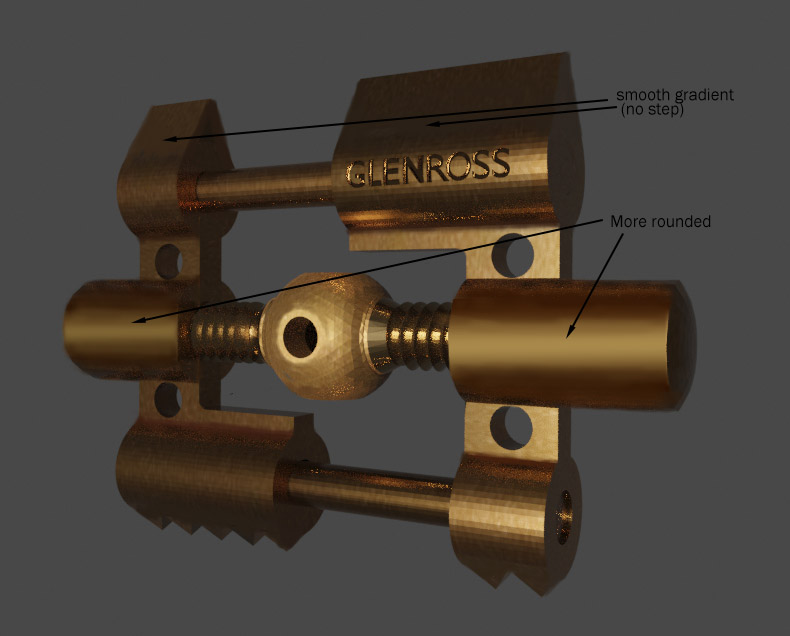

And in general, get rid of the sharp edges, The spikes are slightly rounded as well as the spaces between them. Although a lot of the fine detail might be lost depending on the manufacturing process you use.
