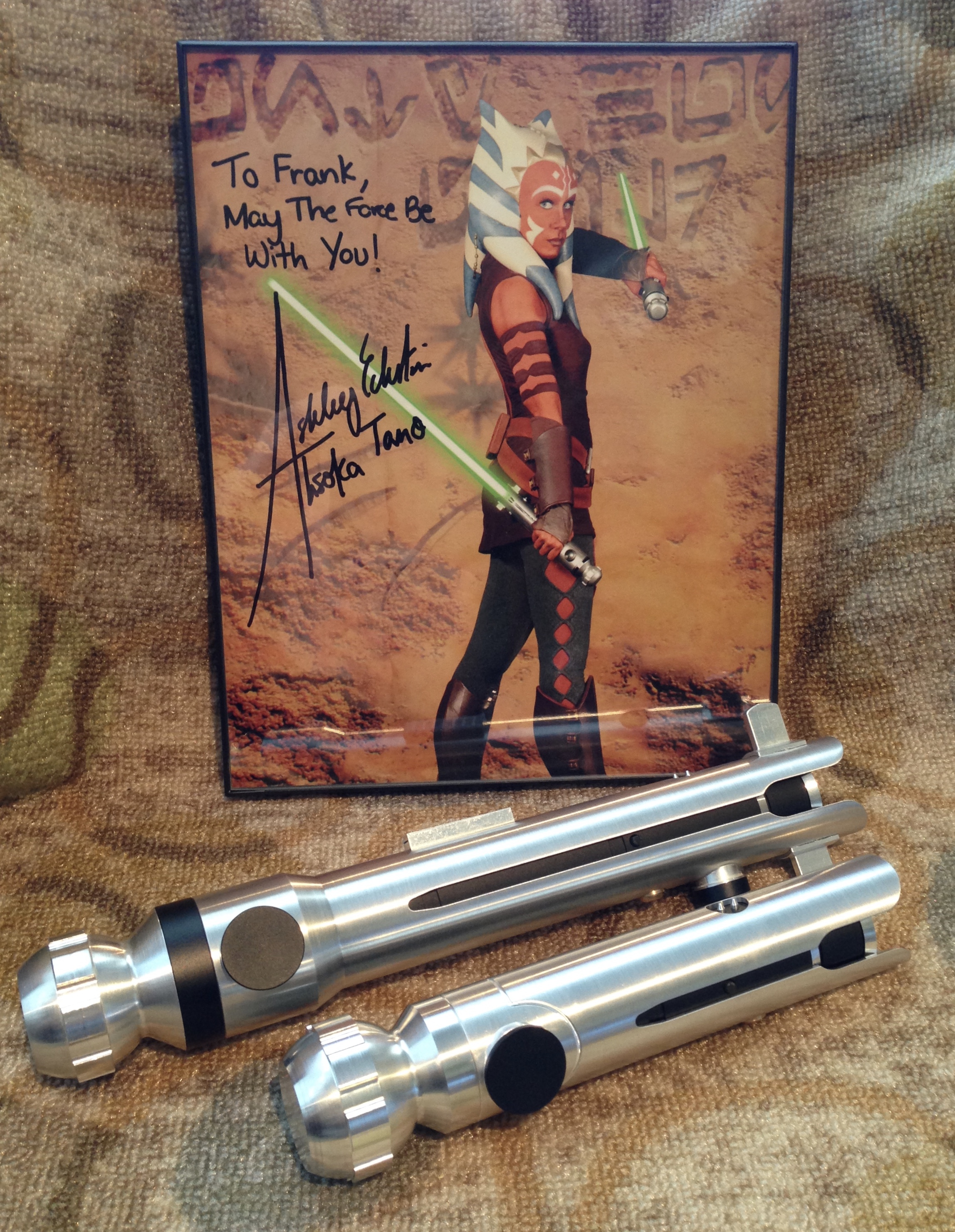

Finished the Ahsoka dual hilts. Not much too it. I did a little extra like putting Aluminum Black on the the aluminum switches on the side in order to hide them. I would still like to get some blade plugs for them.

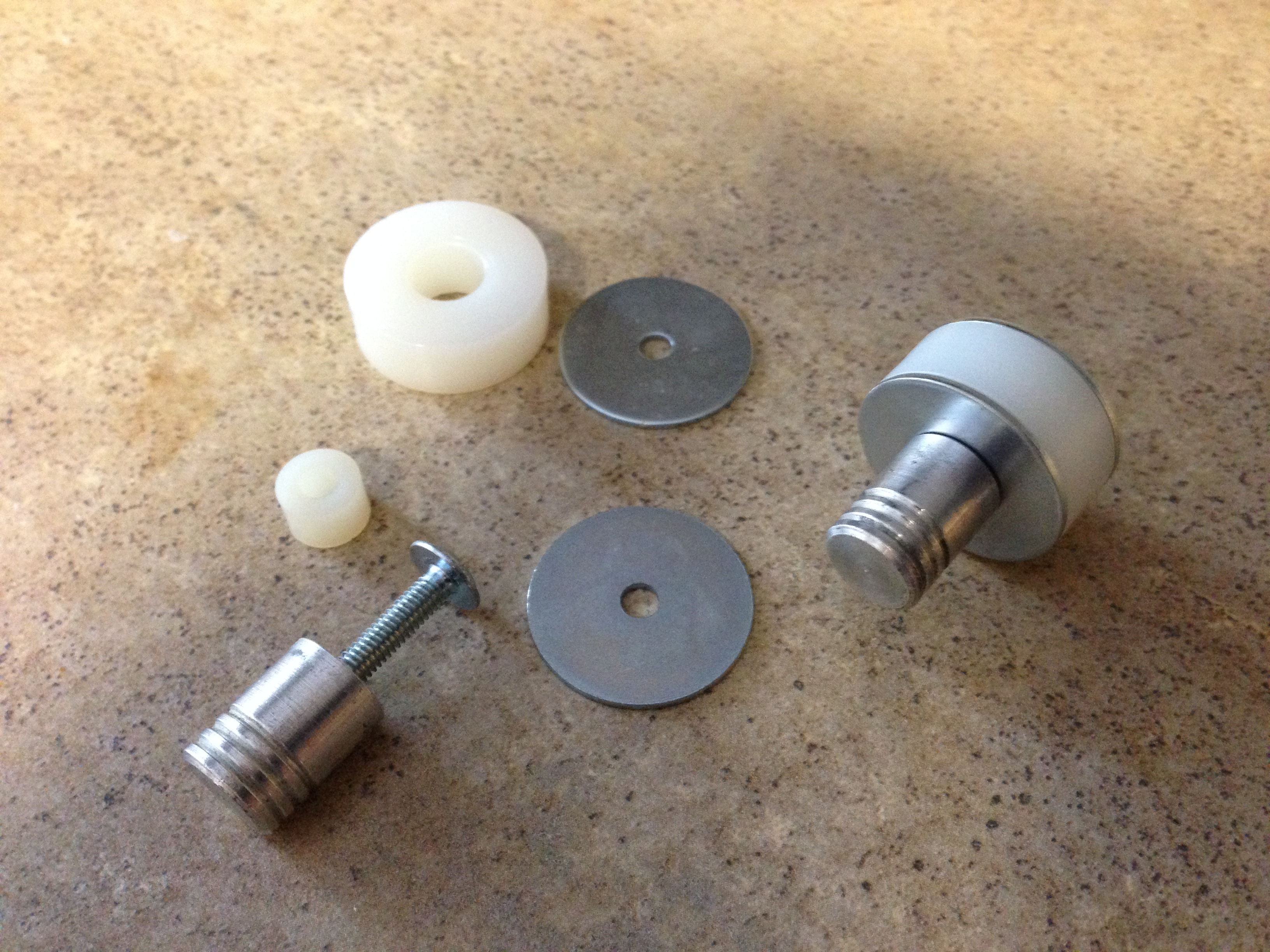

I was looking into getting blade plugs for the Ahsoka hilts. The ones made for the project would cost me $74 ($35+$35+$4 shipping). They are super nice but they are made so that internal lighting makes them glow. Since mine is going to be a static hilt, I felt that the expense would be wasted on features i would never utilize,
So with the cost of under $3 for some spacers and fender washers from the hardware store, some flat black paint and some old Ikea cabinet knobs i had laying around, I made my own blade plugs.

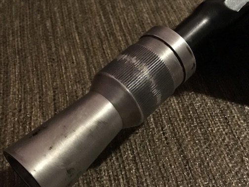

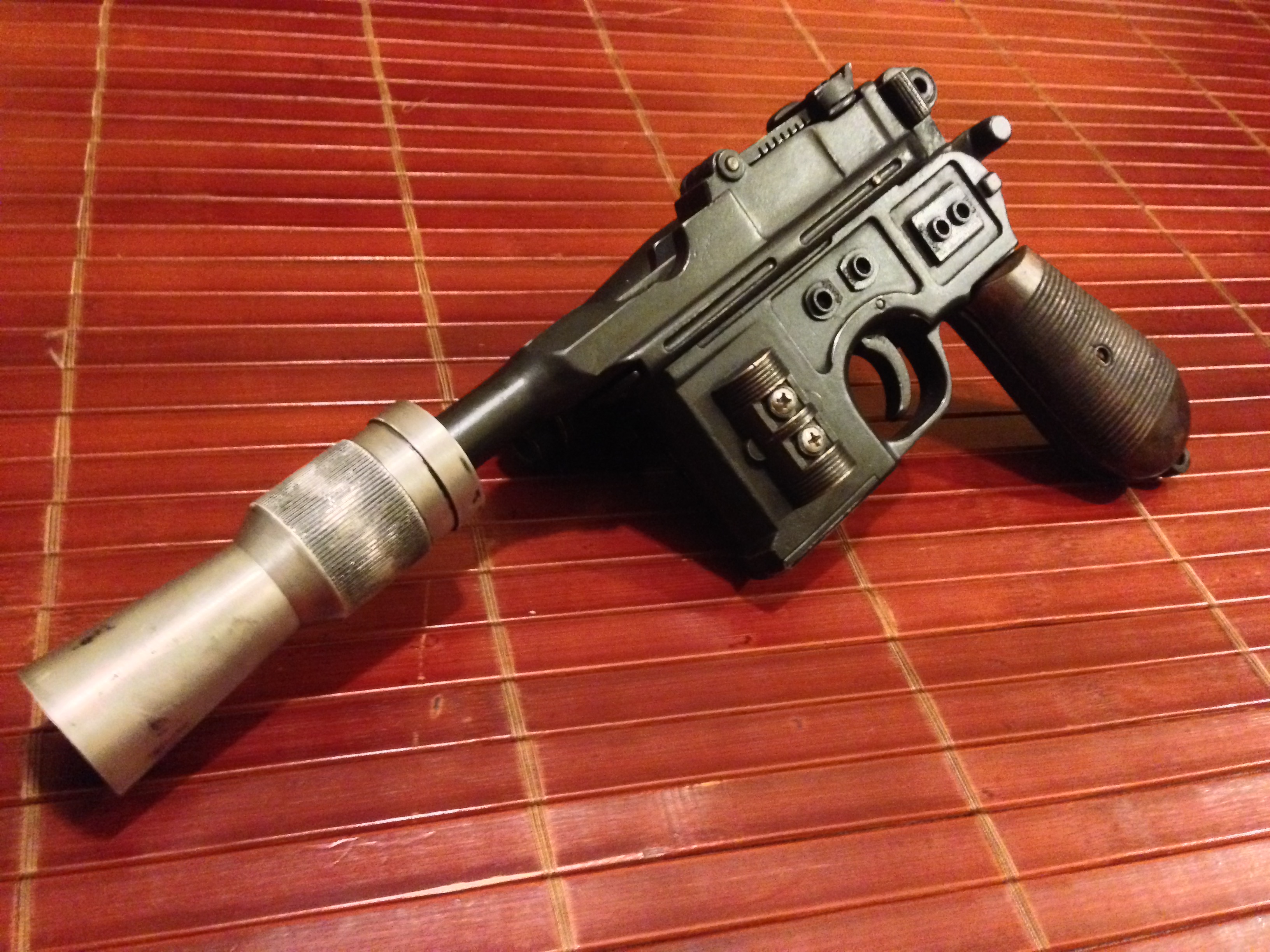

Started working on the Solo Hoth Blaster.
First thing I wanted to work on was the muzzle to see if i could achieve the look I wanted.
I think a lot of people on this project went one of two ways. They either went with accurate (prevailing theory) and no knurling and drew on the knurling. Or they went total idealized with double row knurling. I instead went with a third option... single row knurling. Not sure who else chose this option on a Solo Hoth blaster.
Like I stated before, I am not going for an accurate prop look but instead an idealized look.
The challenge for me was how do I capture prop details of the muzzle without cheapening the look of the blaster with painted silver muzzle and and draw on knurling and translate it into an idealized look.
First thing I did was wet sand the muzzle with 600 grit paper. This did two things: It dulled the finish as to give it a matte appearance closer to that of painted resin (which is also the prevailing theory of what the real prop part might be) and prepped the base for the application of Aluminum Black (love that stiff).
The next thing I did was coat the entire muzzle with Aluminum Black until the whole thing was solid black. I then used the wetland paper to to remove the AB until I was happy with what remained to replicate weathering and carbon scoring. I removed all the AB from the raised knurling leaving nice straight and spaced black lines around the diameter. I then used a wooden toothpick to scrape out AB in the recessed area of the knurling. I scraped around the diameter in the middle of the knurled row in an uneven manner to convey the look of the uneven lines on the real prop.
I'm happy with how it looks. I am afraid to keep fiddling with it. I am considering using a matte craft spray on sealer.

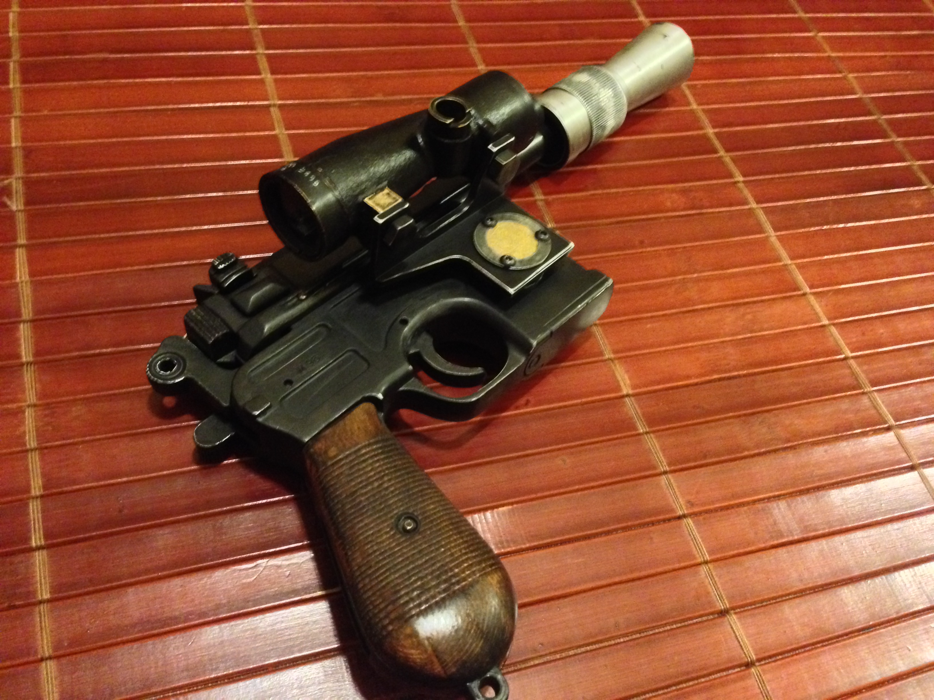

Finished the Solo Hoth Blaster
Here are some photos. I may try to take more tomorrow in the sunlight as to better capture the graphite power affect on the Denix and some of the other details.
attachment.php
attachment.php
attachment.php
There is limited use of paint on the blaster as the main body and muzzle is the combination of Aluminum Black and powered graphite.
The scope was painted with what appears to be a satin black (by Boba Debt). The resin greeblies was painted with flat black and then coated with graphite powder. The scope mount was painted flat black. I lightly wetsanded the grips and then rubbed them with black acrylic paint to age them. I used Aluminum Black and gold acrylic paint on the three holed disk. Anything that was graphite powder coated and the muzzle was sprayed with a clear matte craft sealer.
I used silicon cement to help reinforce the position of the the adjustable sight, wood grips, and scope mount attach point.

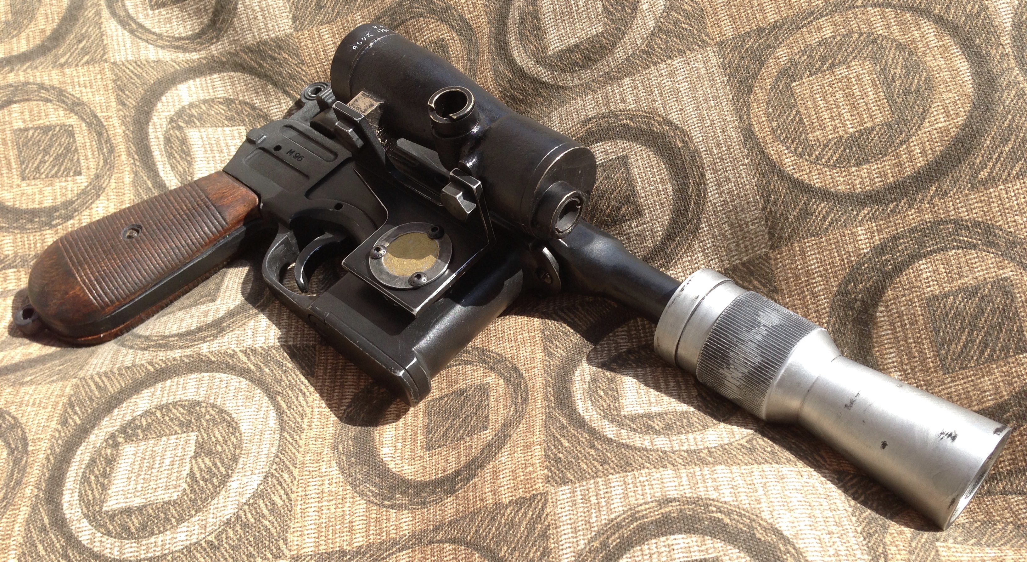

UPDATE...
Picture in the sunlight...
attachment.php
UPDATE: Closed up the gap o the knurling...
attachment.php

Re: My Builds: Hoth Blaster, Ahsoka Hilts, Rey Staff, Hilts, Medal, Necklace, Dice, e
Hoth Blaster looks great,
my parts just arrived in the U.K. so after a long prop building hiatus I'm thinking how I'm going to do mine :lol
I also went for the single band Hoth Flash Hider & I'd been wondering if that was the right move until I saw yours which looks awesome

looks great MJF!! what black paint did you use for the denix?!
Thank you.
None on the Denix itself.
I had Bobadebt strip it and then apply Aluminum Black. I then brushed on powdered graphite to give it more of a gunmetal sheen and then sprayed it with a coat of clear matte craft sealer.
All the other uses of paints and other finishes are listed in my post: http://www.therpf.com/showthread.php?t=210211&page=10&p=4111229&viewfull=1#post4111229

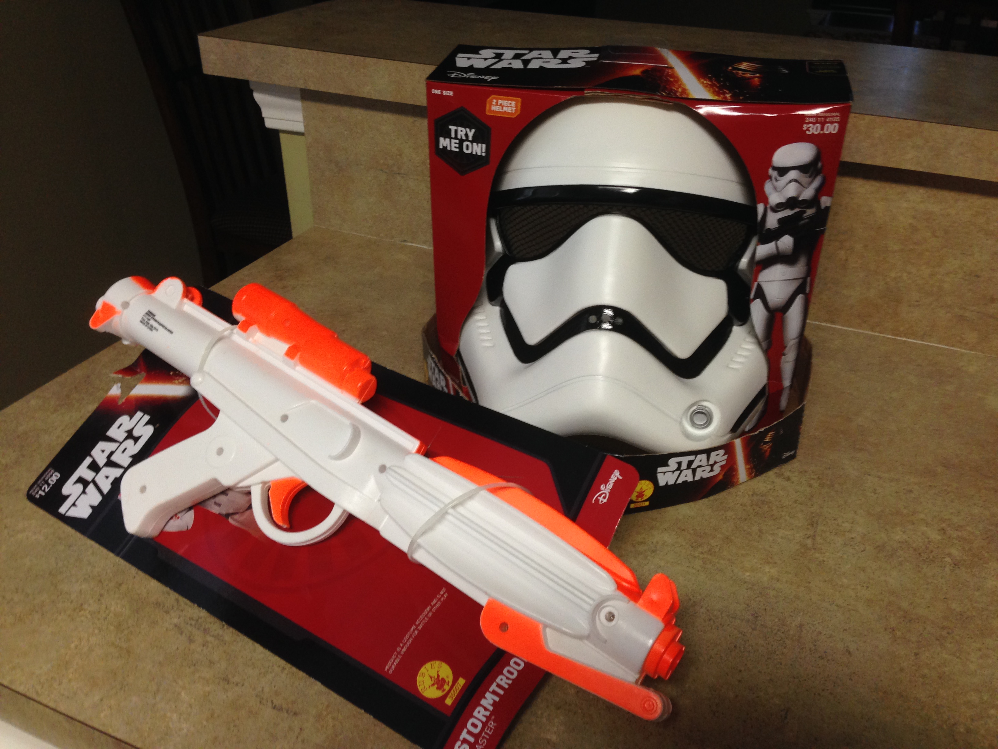

Picked up these items at Target for the after Halloween 50% sale. With the sale, tax and another 5% off using the Red Card, total was under $22.
For the helmet, I'd like to seal up the seam, replace the lens, and repaint to the bloody finger streaked and weathered Finn version.
The blaster will be a Rebels variant. I am aware the the E-11s in the show are suppose to be the same as those used in the movies but if people can male a Holiday Special Luke Lightsaber, I can do this. I might keep it simple and just clean up the seams, fill screw holes, paint, and weather. I am also considering removing the faux sling ring and holder on the rear and replace it with real ring. I am also considering removing the scope for a better replica. Nothing too fancy, maybe resin. Just something with a touch more detail.

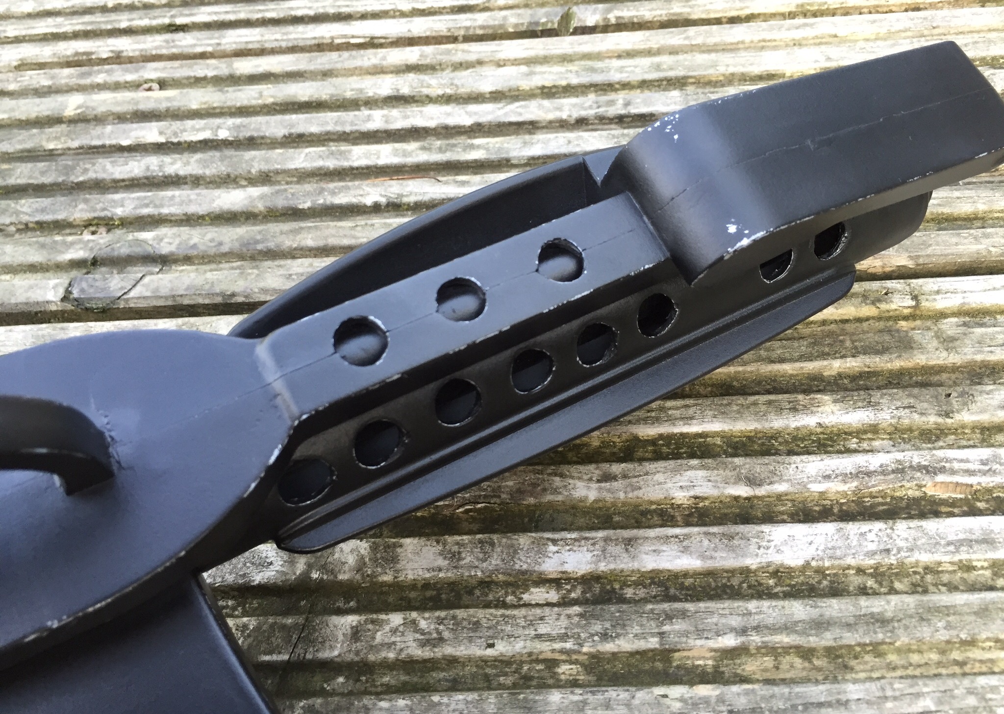

Awesome, I love those Rebels E-11's but I seem to me in a minority around here on this, I know they're a little undersized but they're pretty accurate to how they look in the series,
when I did mine I pretty much did what you described, I cut out the infill around the scope rail & scope (the scope is actually a nice shape) I also drilled out the holes in the barrel & folding stock
really looking forward to seeing what you do with yours,
That turned out very nice. You always have great paint work.
I also like your scope rail.
The only problem with cutting out the scope rail is that once you cut it out there is a slight gap underneath where the 2 parts of the Blaster don't quite join because of how it's molded, I just left if because I was too lazy to fill it & it isn't really noticeable under the rail :lol
