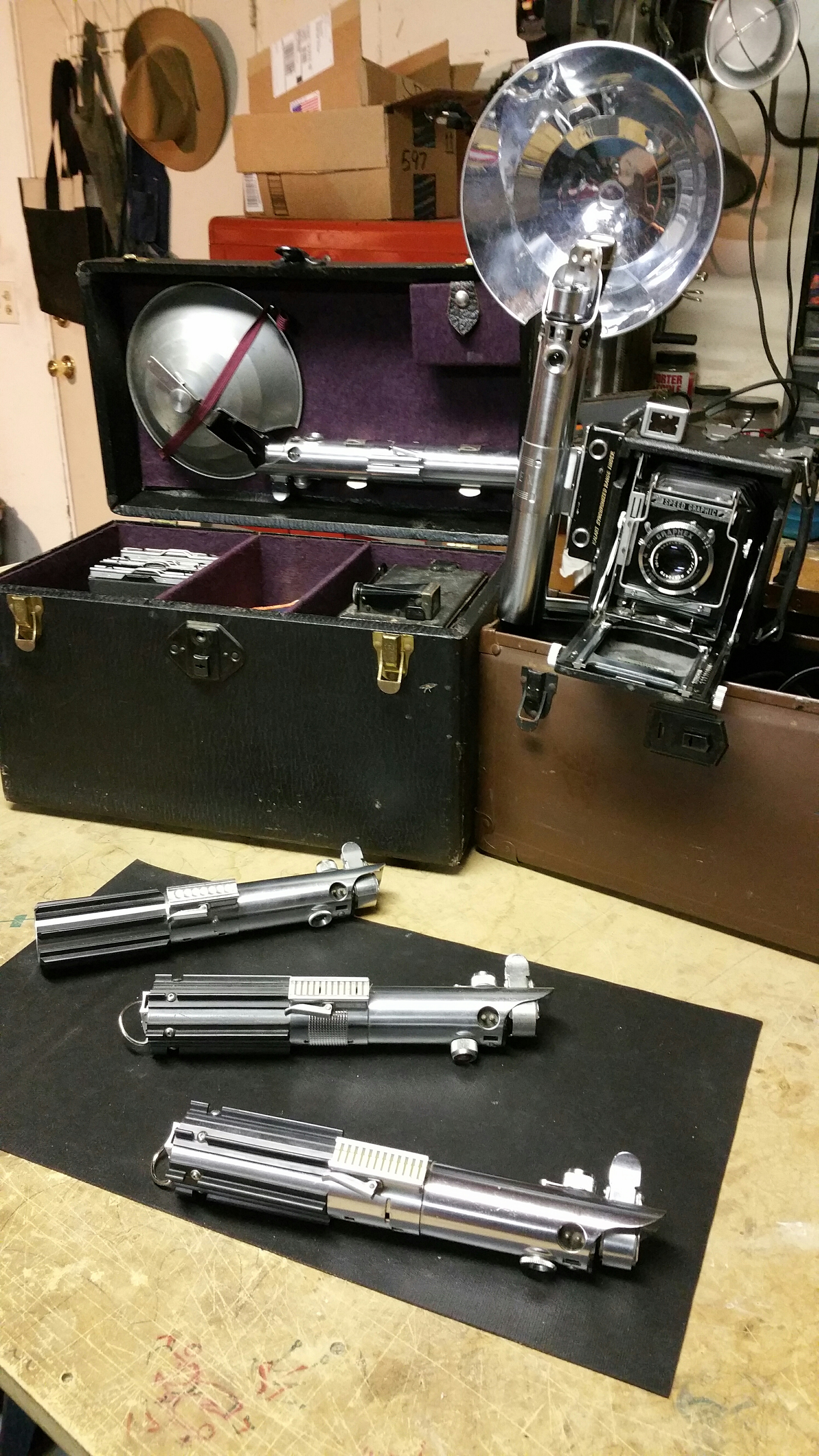

I did put together a tfa graflex. I saw the first showing at midnight here in CA. Ran home grabbed a beer and opened my graflex box at 3am! I wanted to visualize what i just saw in the movie. Once again i didn't put too much time into it. Cuz i only do ot props but i had the parts. It was an instant gratification thing for me. Its now a bespin version. But here it is. The only picture i ever took of it.

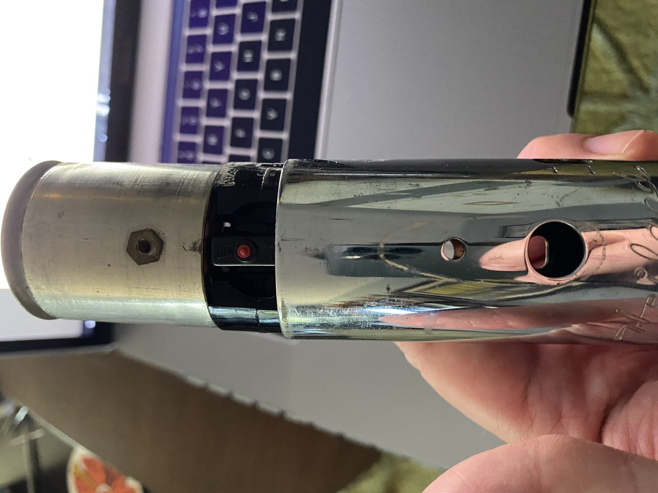

Because an MPP is not foreseeable as a possibility currently I decided to pick up some bits and bobs in the Heiland family to build an idealized Vader hilt with features from a bunch that I like.

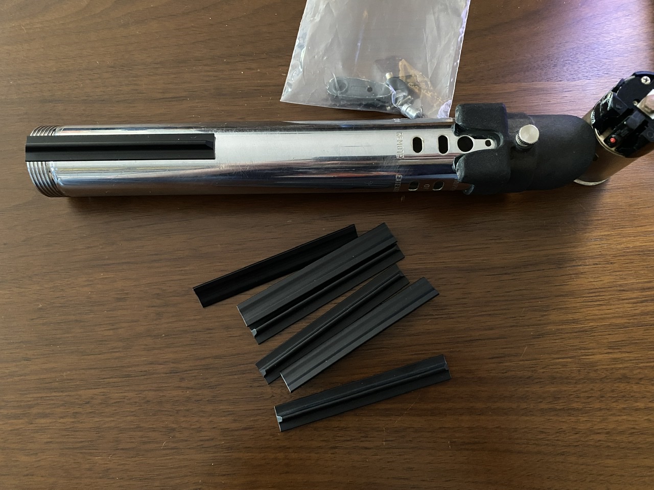

These are the vintage pieces I’ve compiled:
Right now the plan is to use a Heiland shroud, the 3-cell tube, vintage Exactra green PCB, repro Exactra bubble from eBay, a repro bulb switch (Wannawanga), Wannawanga wires, Romans black side clamp, and the pre-cut slopes tracks (x7) that I ordered from Wannawanga.
Definitely a mish-mash.
I’m not sure if I’ll stick with the matching chromed 3-cell base or swap in the 2-cell knurled base with a different more matte finish. That’s easy enough to see after installing the tracks though I may run into a height issue as the chromed out bottom screws in further than the matte knurled bottom.
I’ll test the length of both and post my findings next.

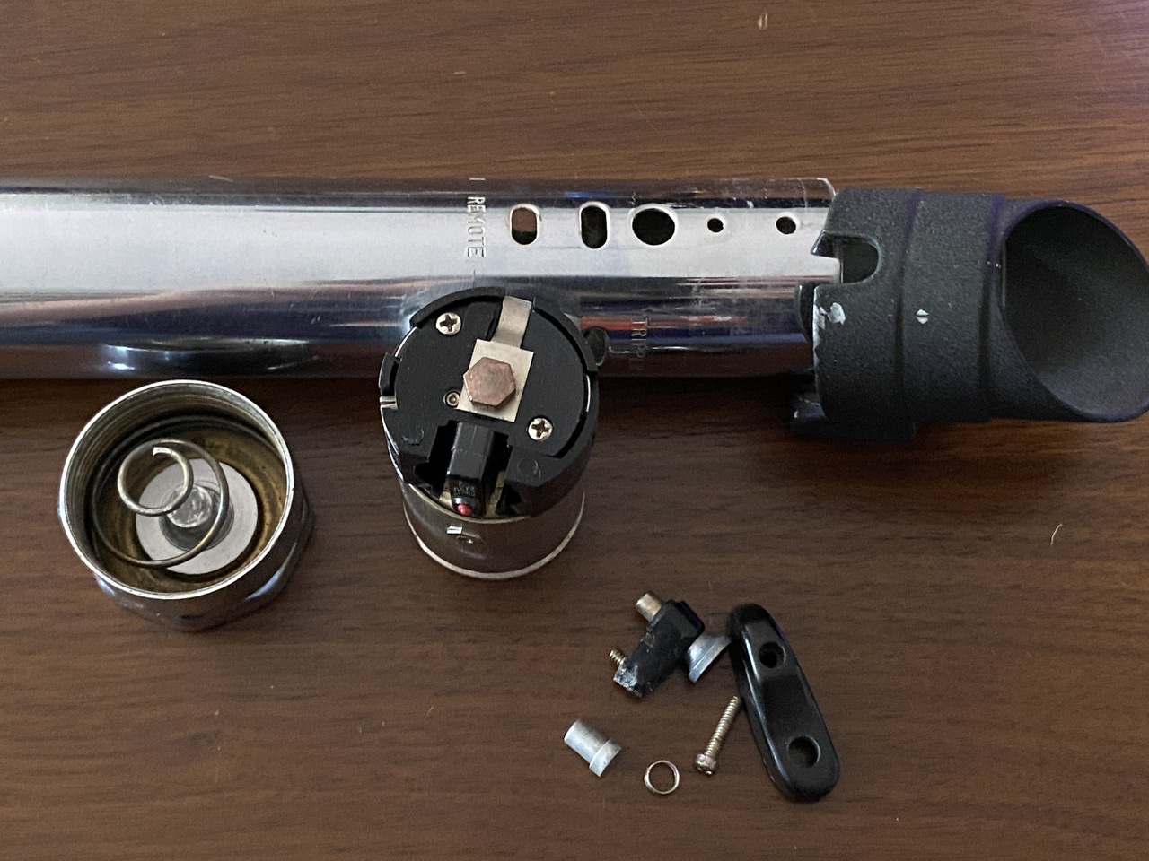

Started the conversion of the Heiland.
I took apart the emitter section in prep for installation of the switches etc.
I had no idea the whole bulb company would come out! Interesting.

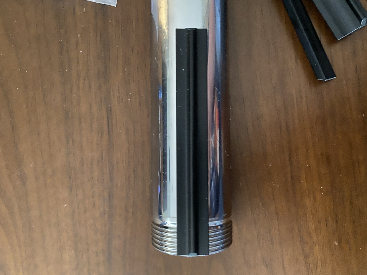

After those were dealt with I opted to just install 1 of the 7 pre-cut t-tracks.
I wanted to align one with the shroud and then I’ll hand place each one after but I wanted to give the one time to cure and act as a solid baseline for the rest.
I opted for E-6000 though I usually use two part epoxy for projects I’d never used this before.
It’s a nifty little adhesive and I realized after gluing the track down, I should’ve kept minimal glue from the edges and centered in the glue track. But a toothpicks worth of edging after some drying removed the glue that had seeped out the sides and left a clean look. Good to know going forward and so easy to deal with in regards to the E-6000.
