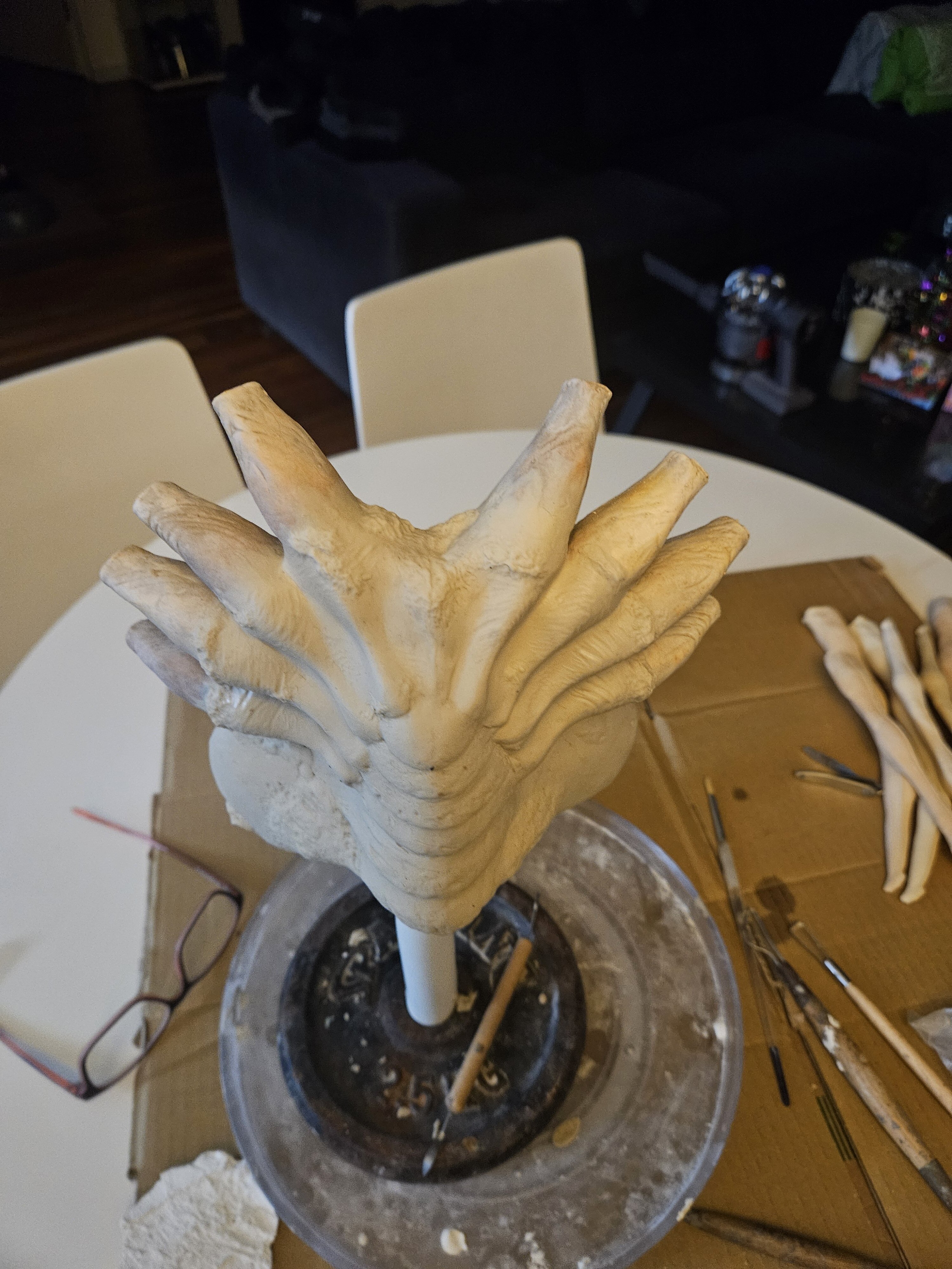

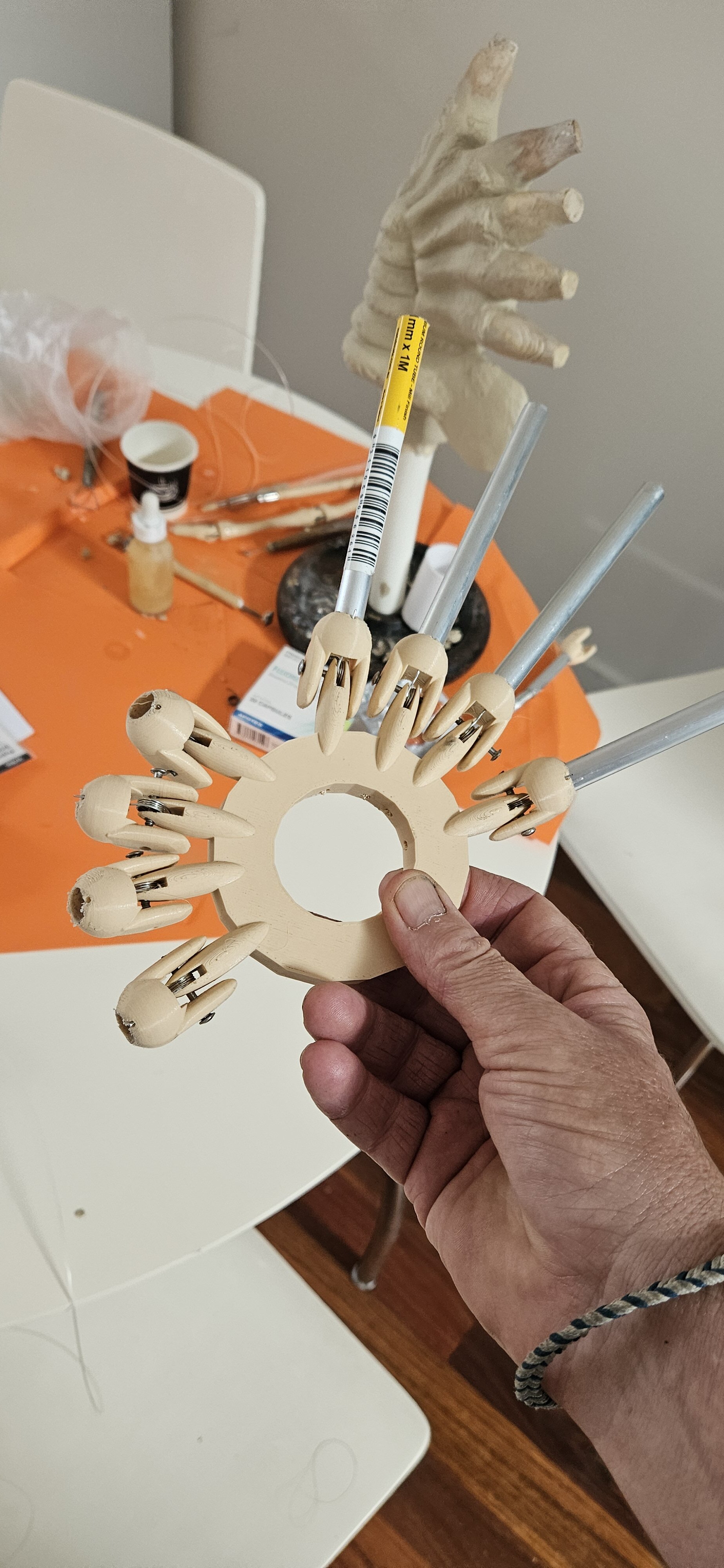

Hope this is right place to post, mods feel free to move if not :) just started making this face hugger animatronic, plan is to have it as a specimen with motion sensor so legs will spasm (try to grab) when people get up close to have a look.

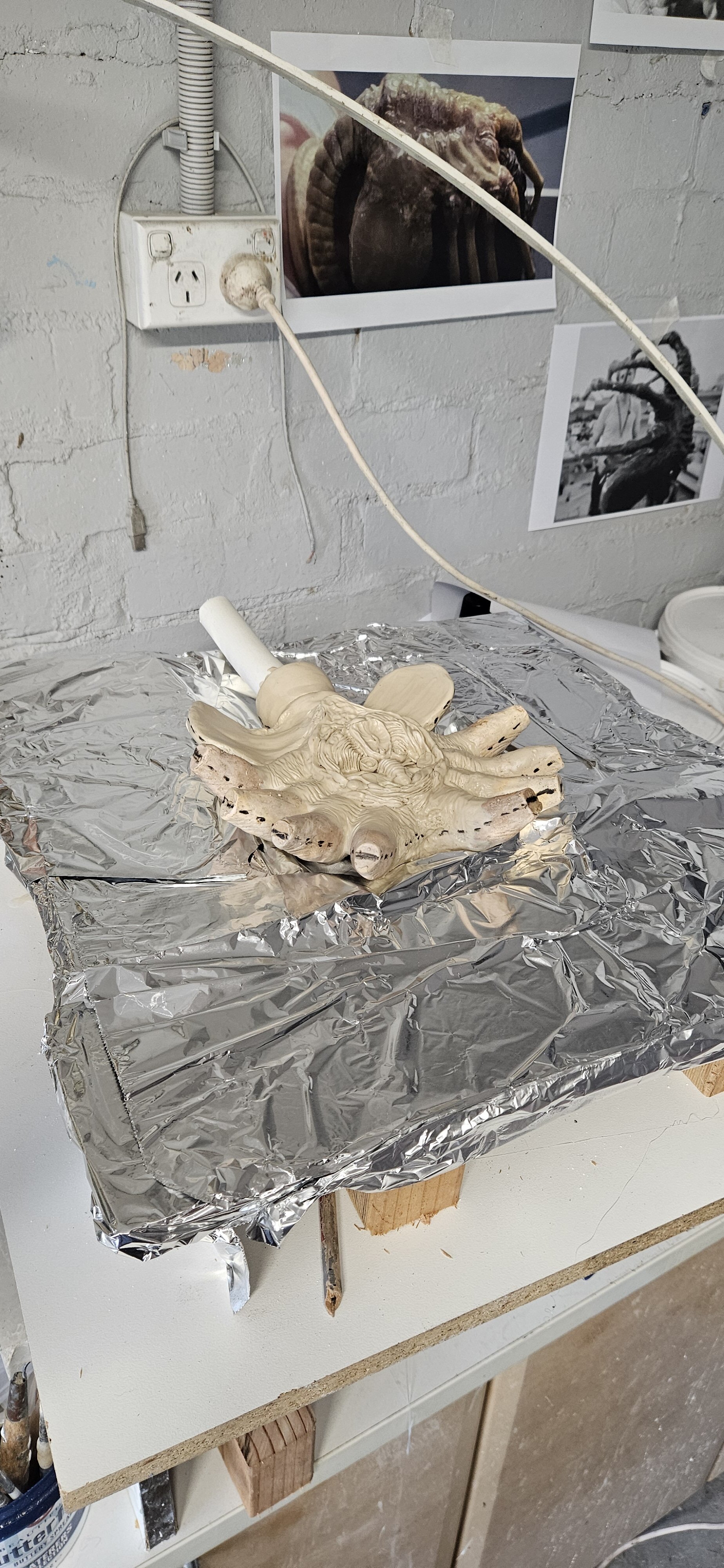

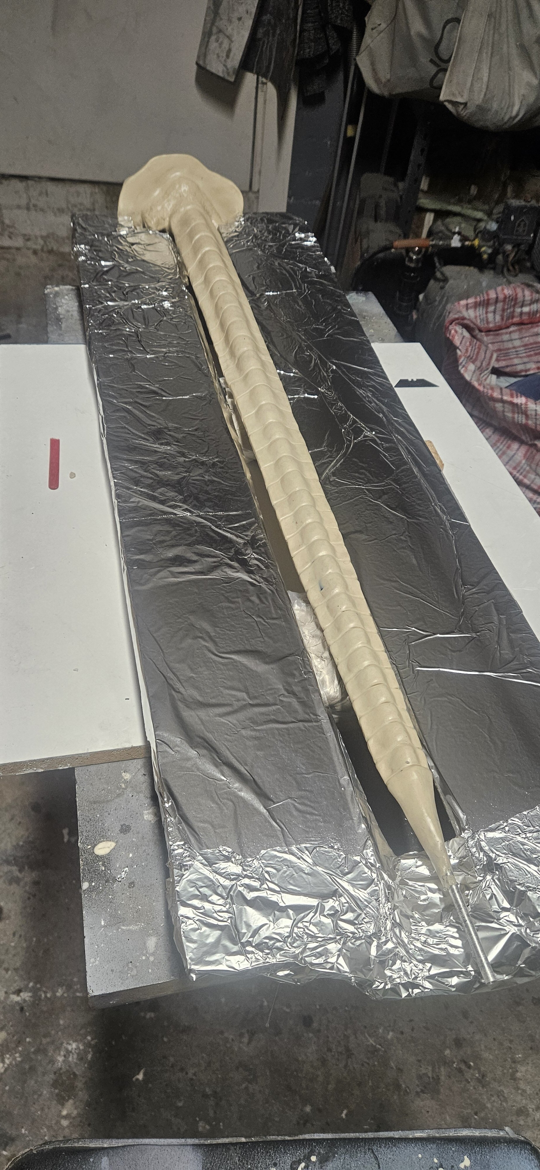

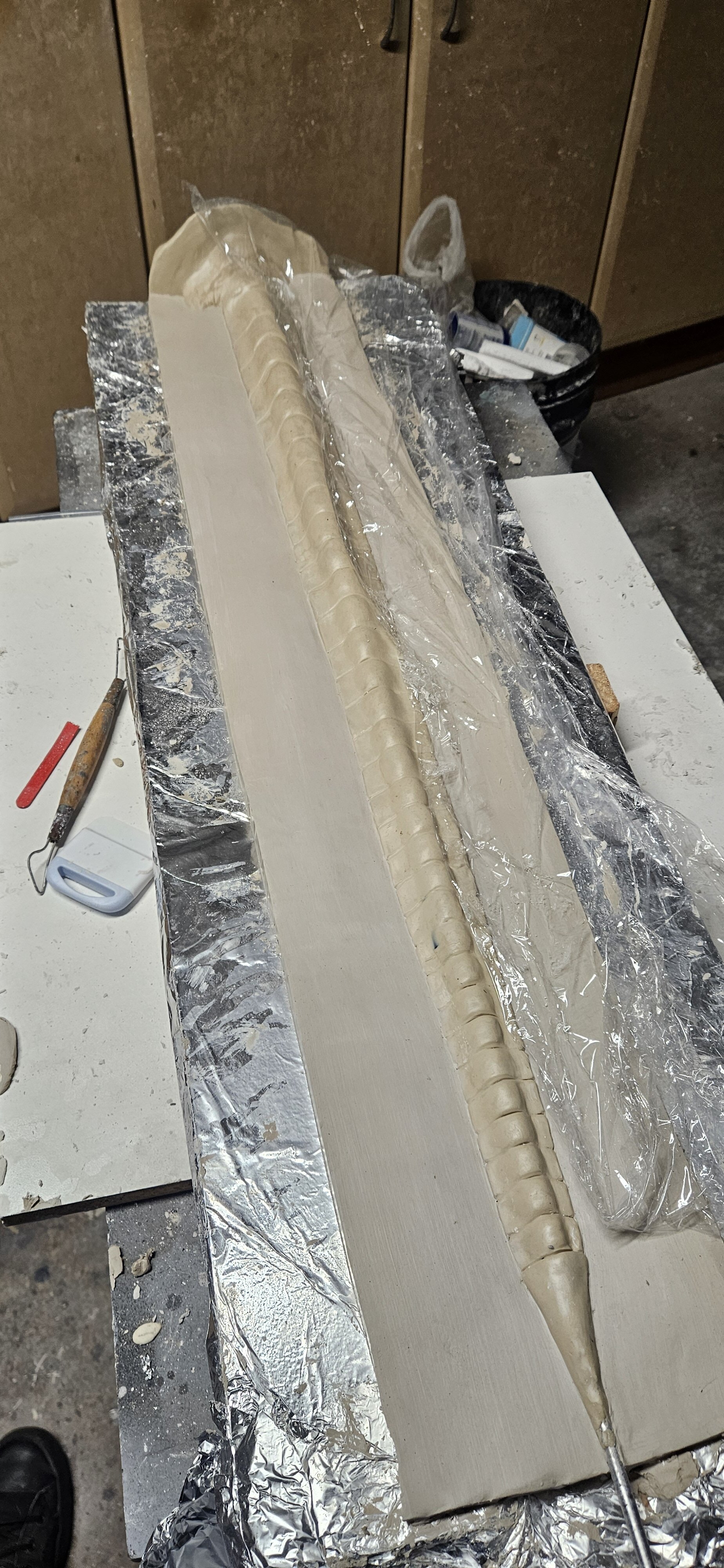

Well, just got some time to start setting up for 1st part of the mold, am doing in hydrocal stone pic is just base pine, dry wall strip's hot glue on top then because im using water base clay for the wall partition I used aluminium foil to seal that so doesn't dry out the clay wall. More to come.

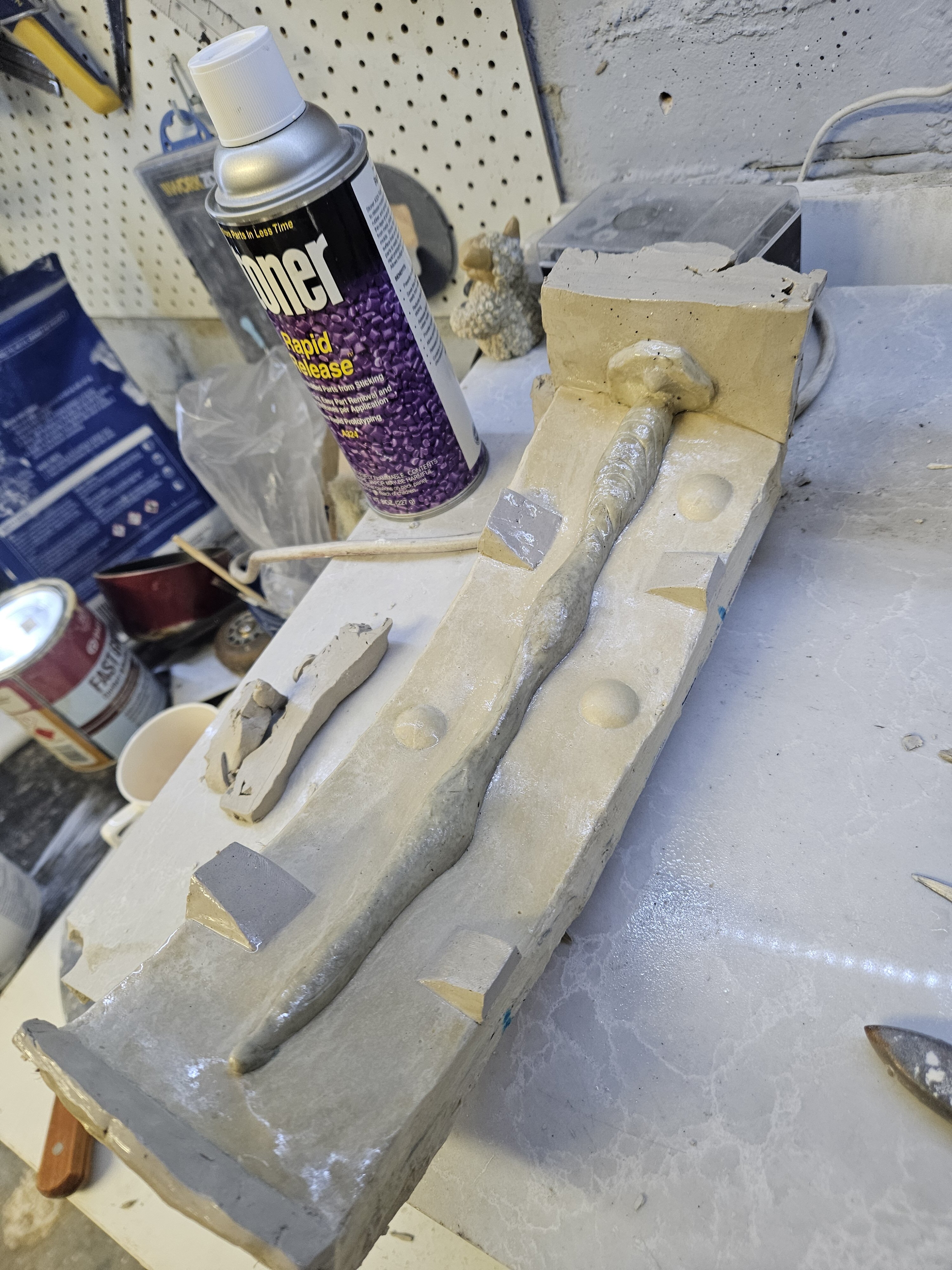

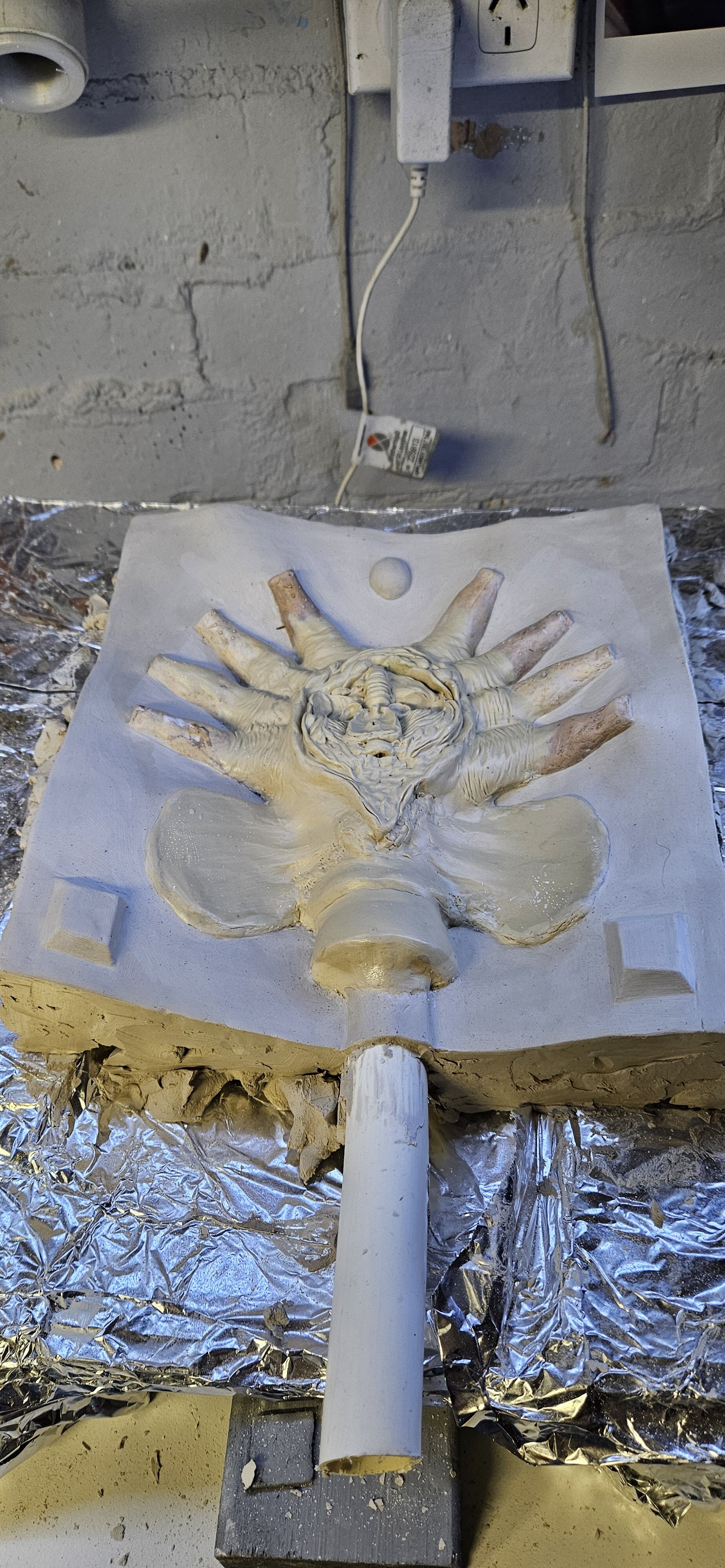

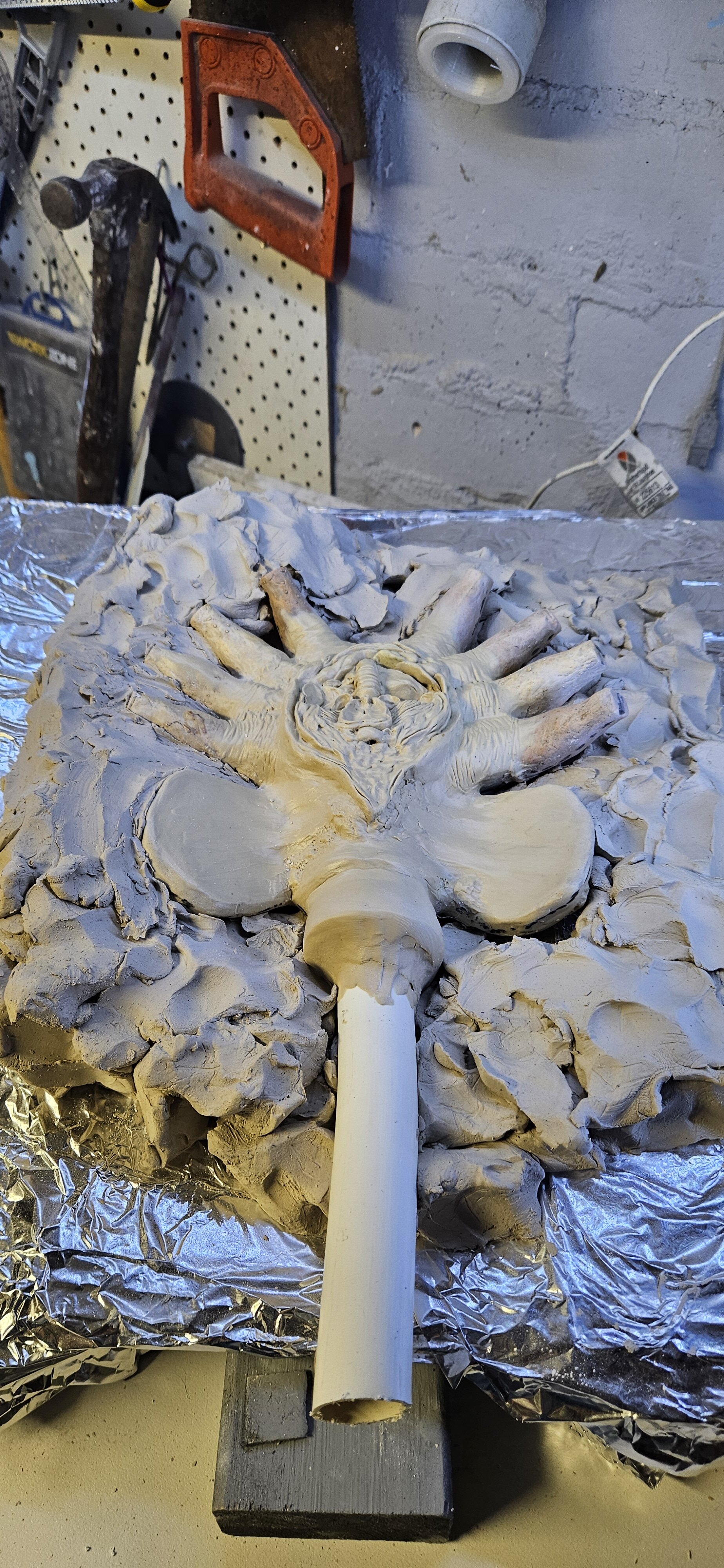

1st part of mold done now just gonna lay up the other half, is always exciting getting to this stage and a bit scary as have to get the thing out without damaging the mold. Fingers crossed.

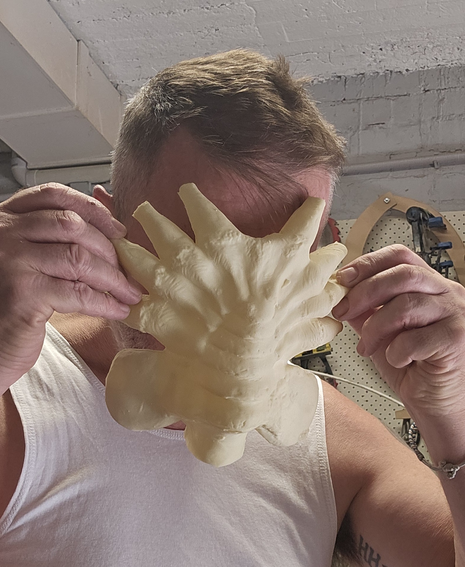

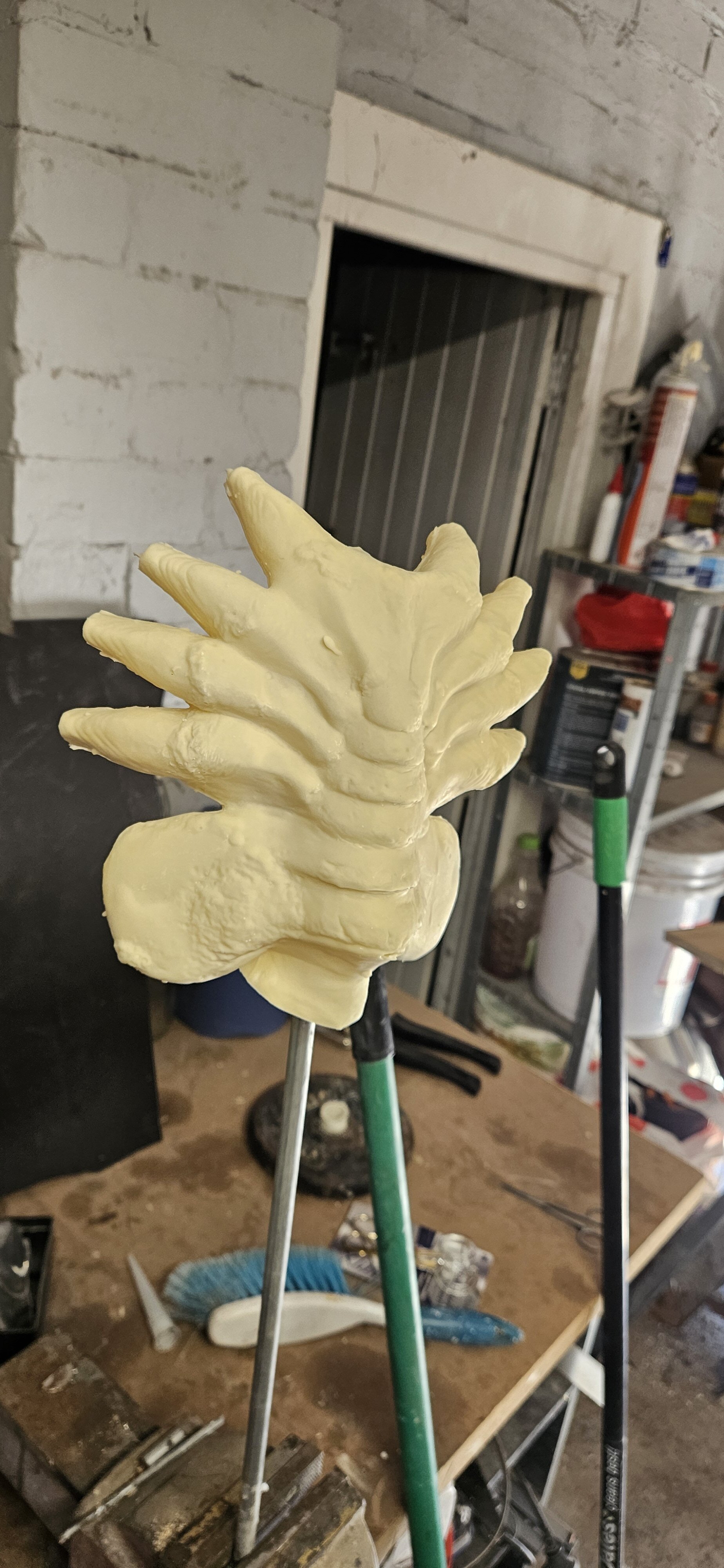

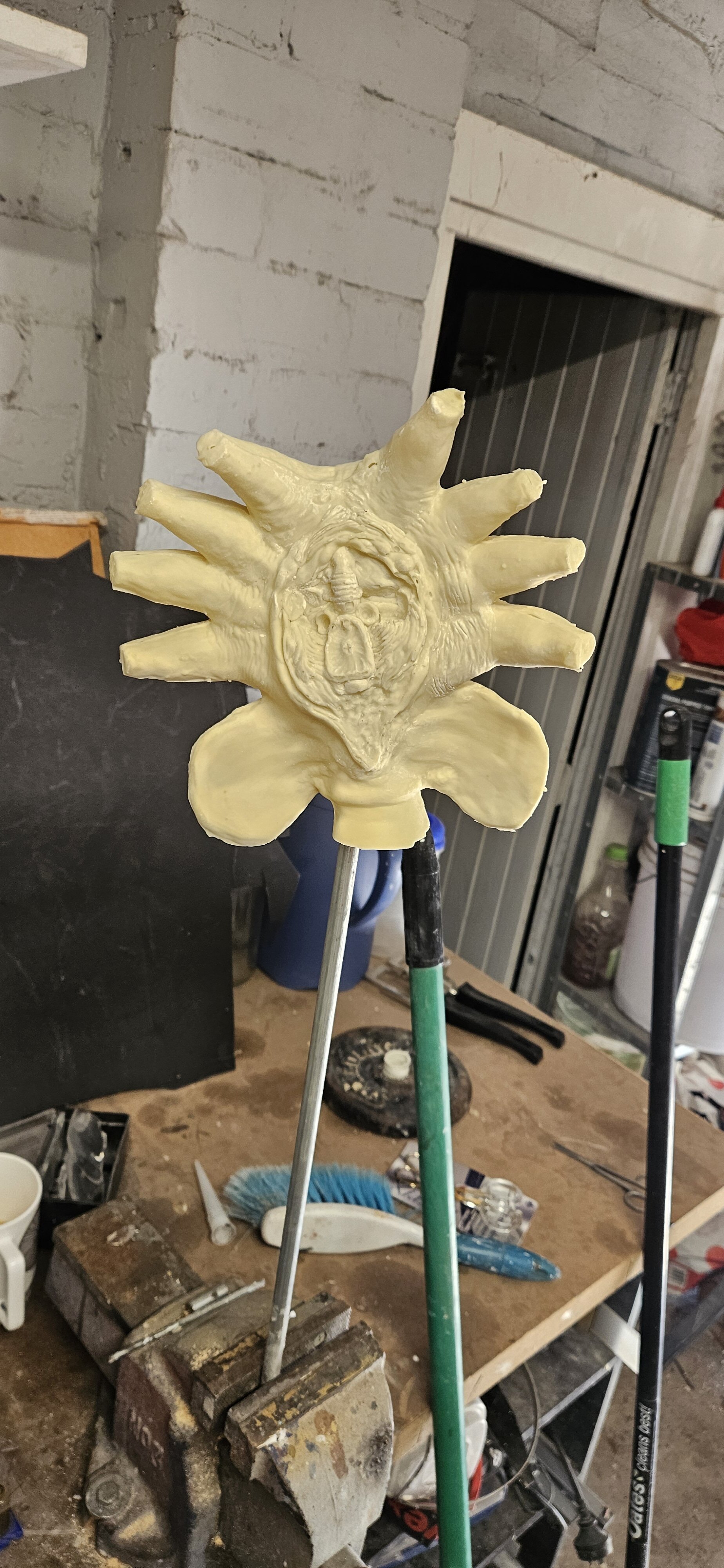

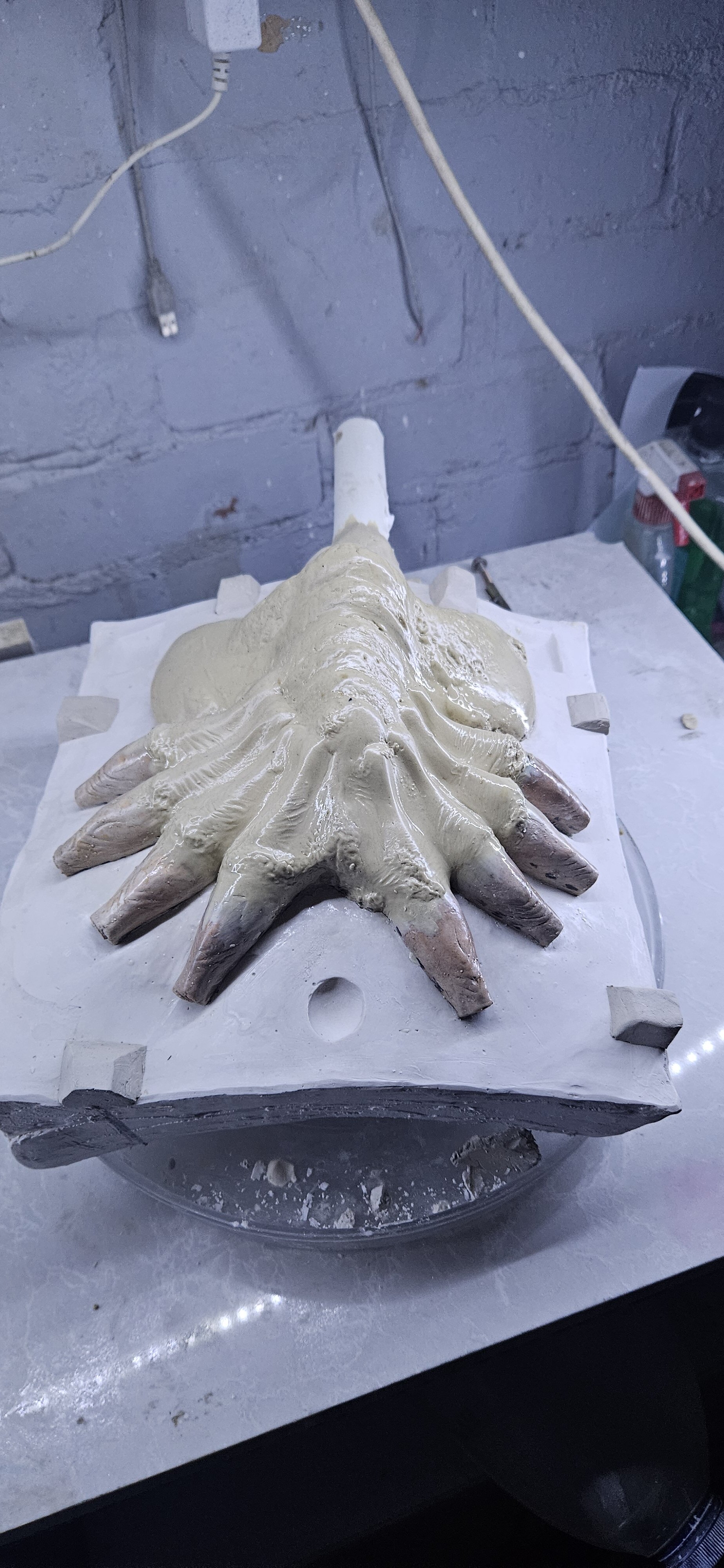

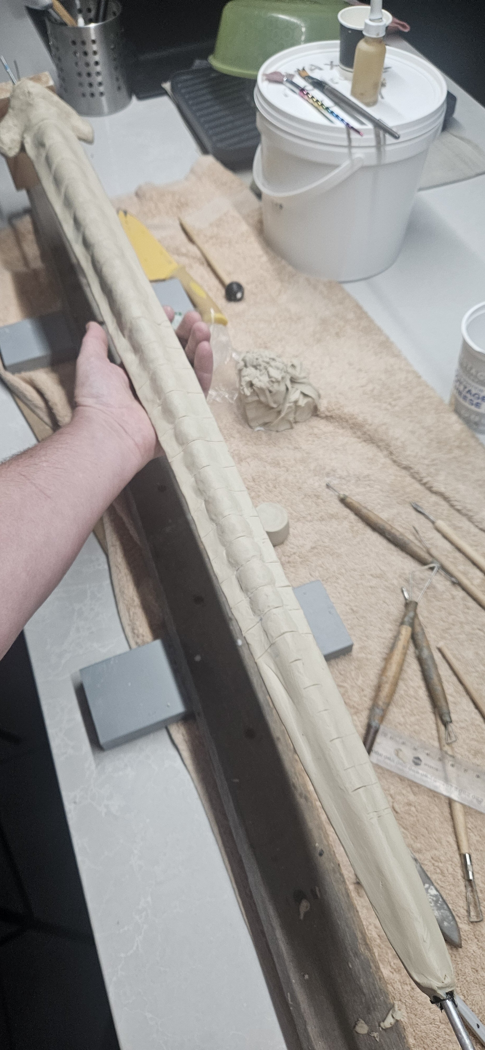

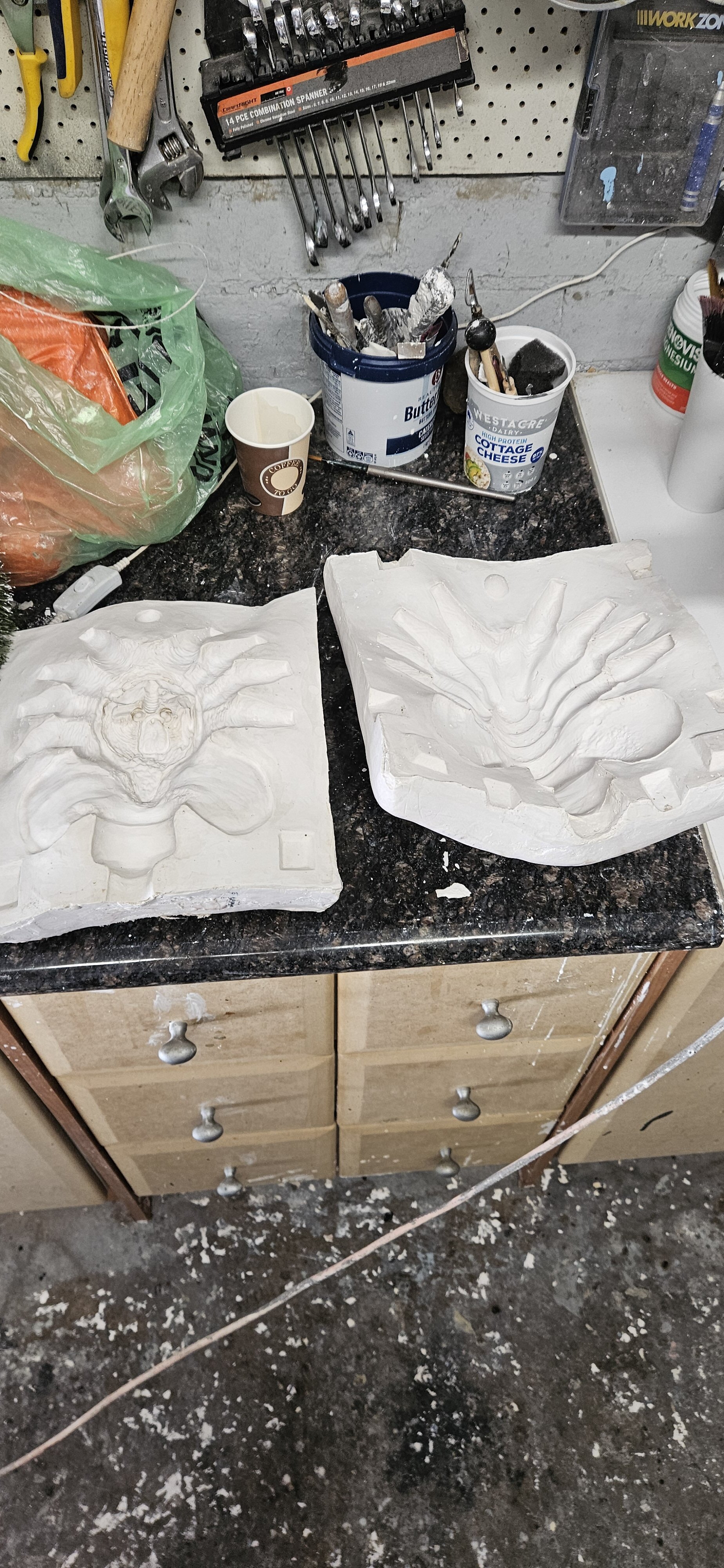

Stone mold worked a treat, very happy, just put a bit of latex in to see how it looks, next up will be sculpting the tail, mold and cast that as well, more to come soon.
