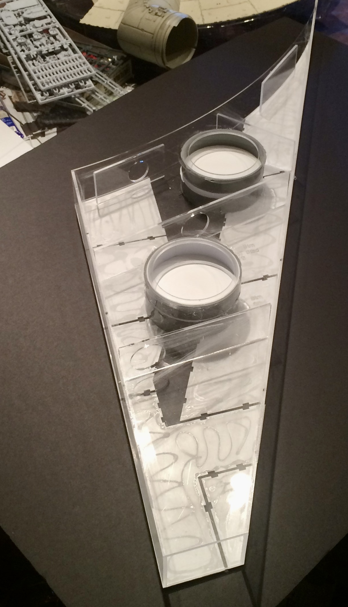

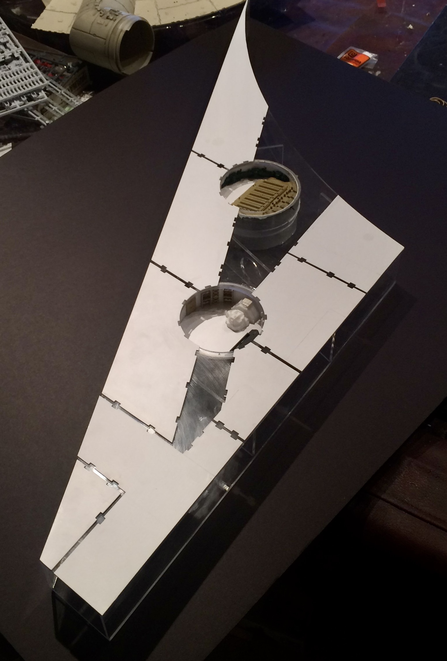

Yup - best way to go about it IMO.
Acrylic is base and styrene is just the plating after some fun nibbling.
Bjorn
Acrylic is a pain in the tookus, IMHO. But that is the Studio Model way. If you have a laser cutter it's a piece of cake. Any other way and I'd have to join hair club for Men , ; )
If it's on a CNC router, try to limit the rpm and keep the feed up. You want nice small chips coming off the cutter.
Fine snowflakes usually means the RPM is too fast. And will soon weld itself to the router bit.
RPM too slow and your about to break something. Either the cutter, or the acrylic, or both.
That said it's better to start with slower rpm and medium feed than high rpm and a molten mess around the cutter.
If it's a manual router, may the force be with you!

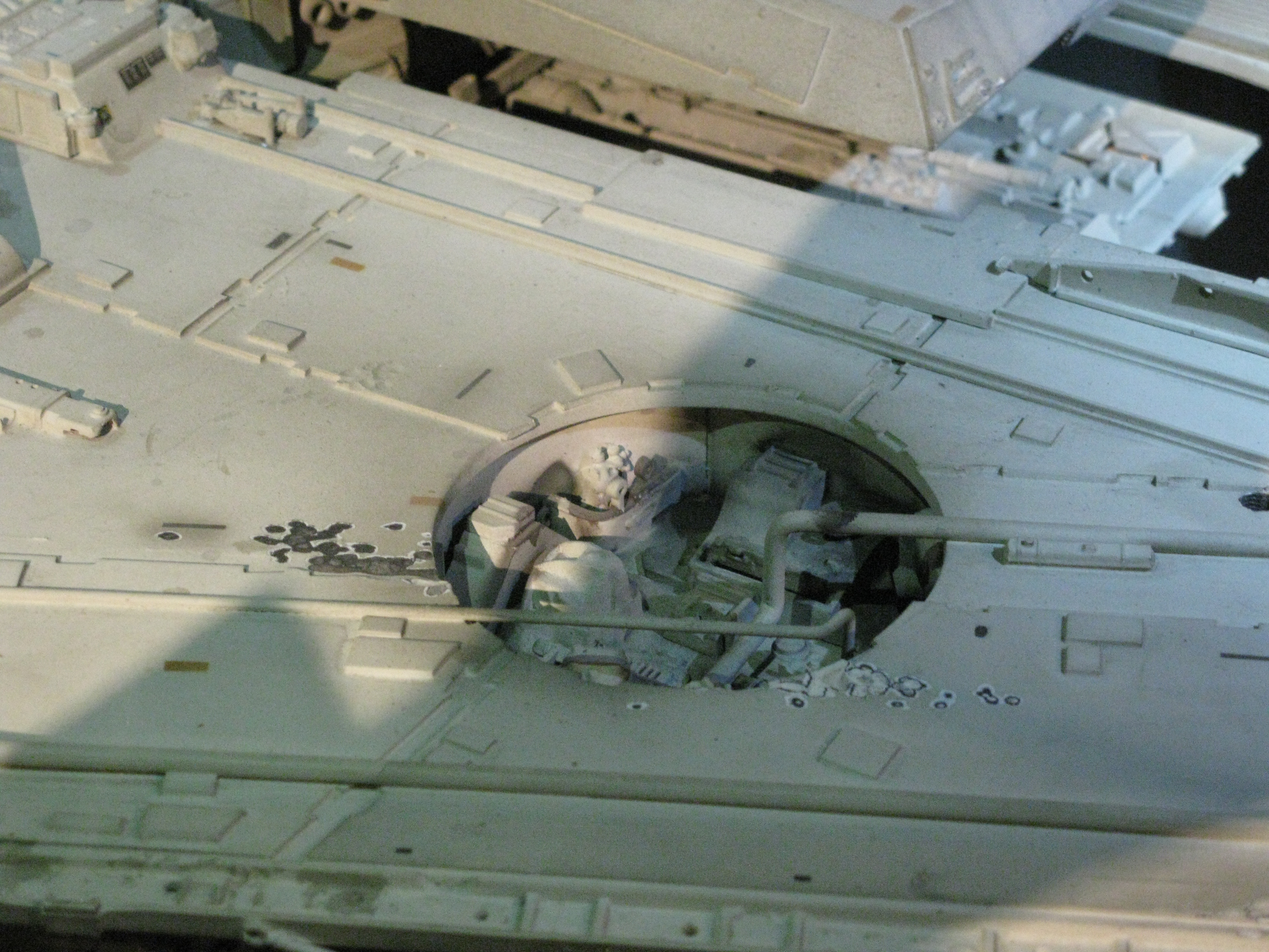

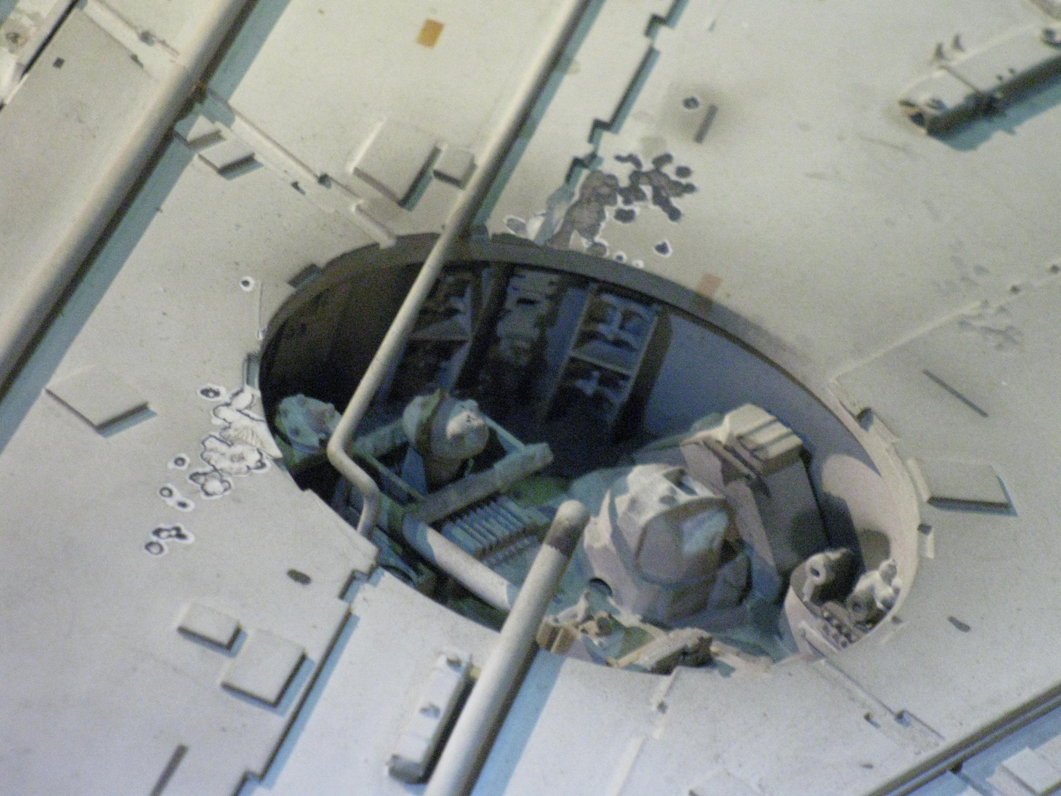

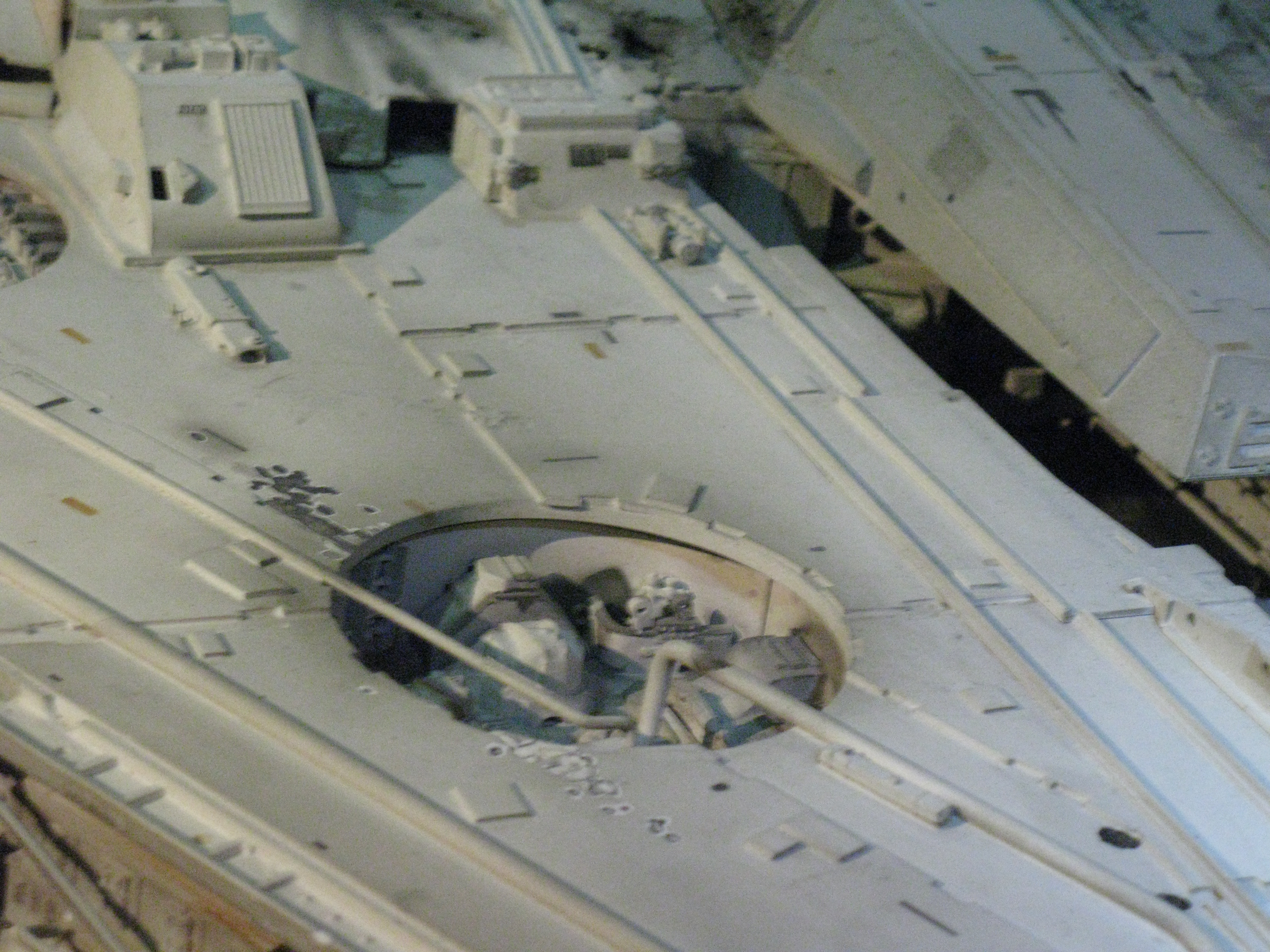

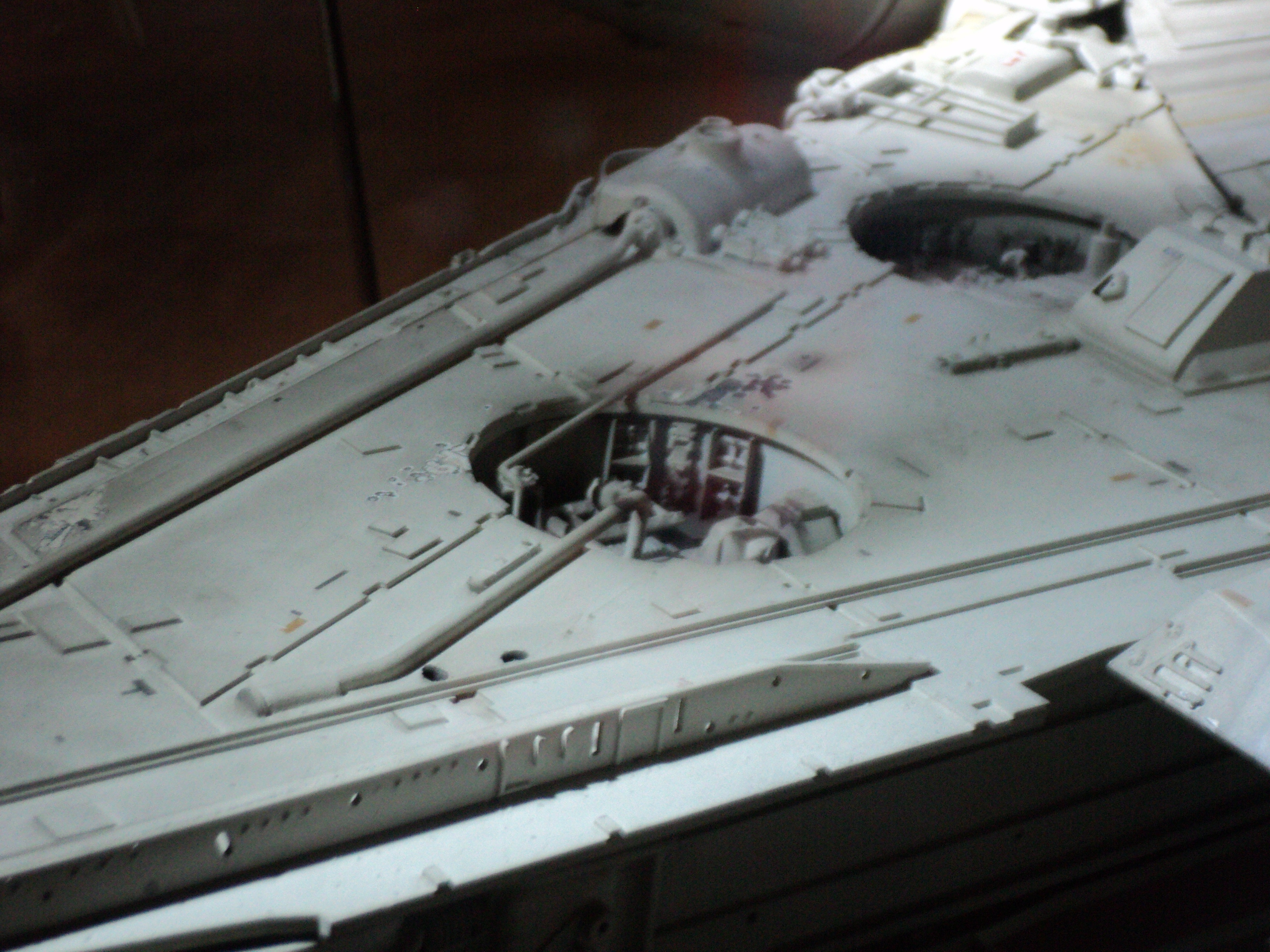

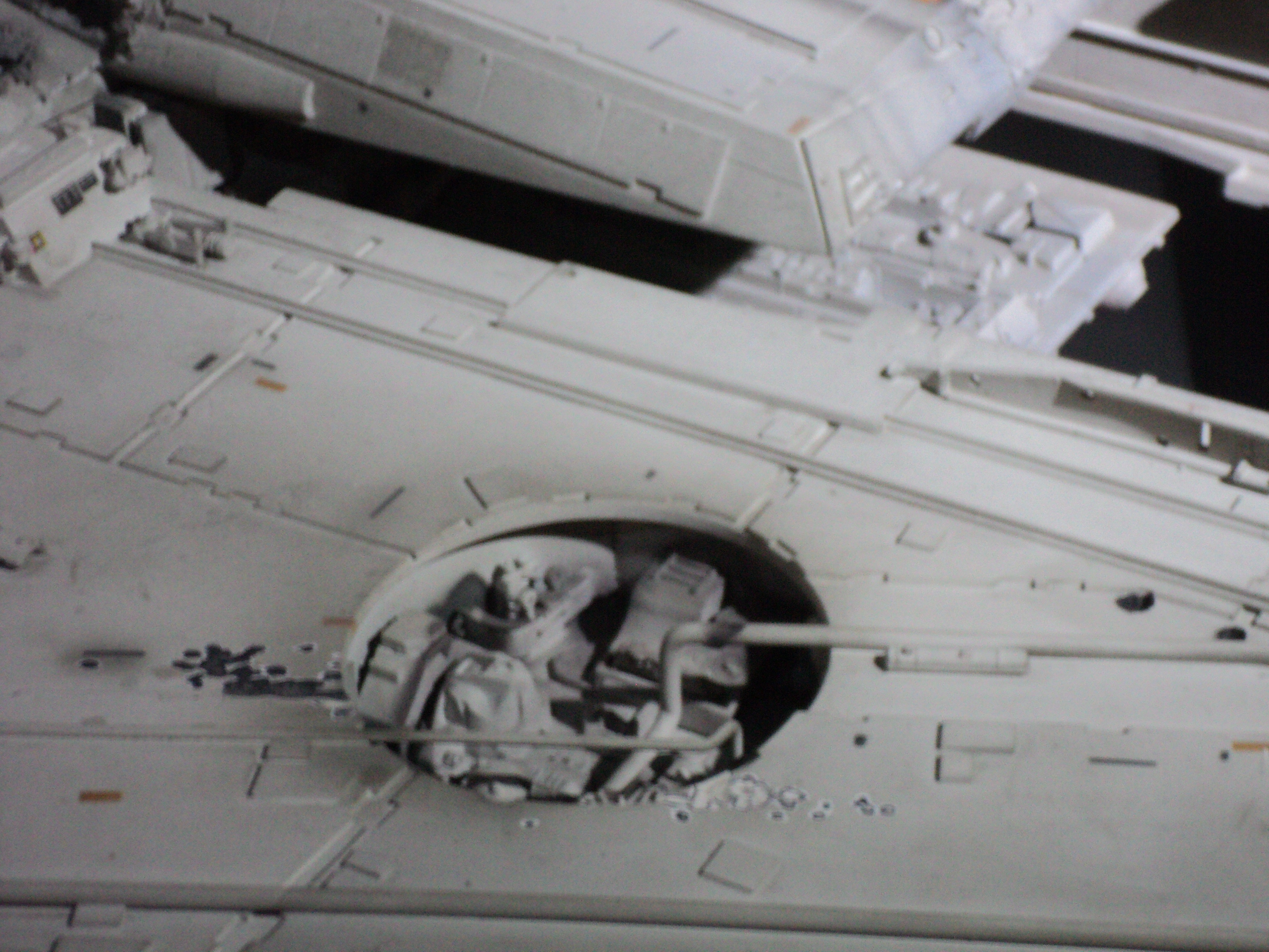

Anyone have any good shots of the starboard pit with the moon lander in it? Maybe multiple angles to get a 360 view?
Thanks,
John
