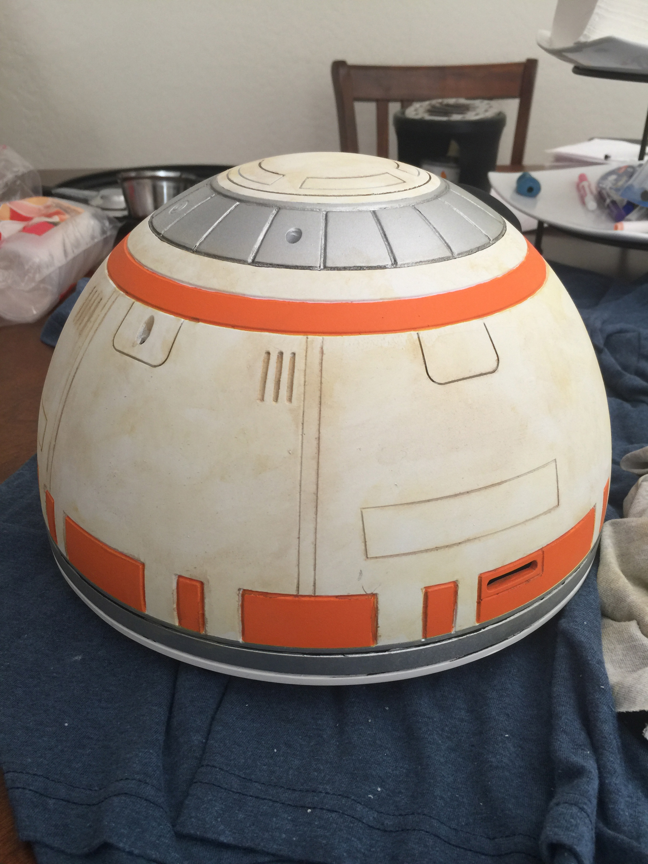

A little more progress, all the orange and silver is down, need to paint the main eye black and around the holographic projector and then do a wash to start dirtying it up.

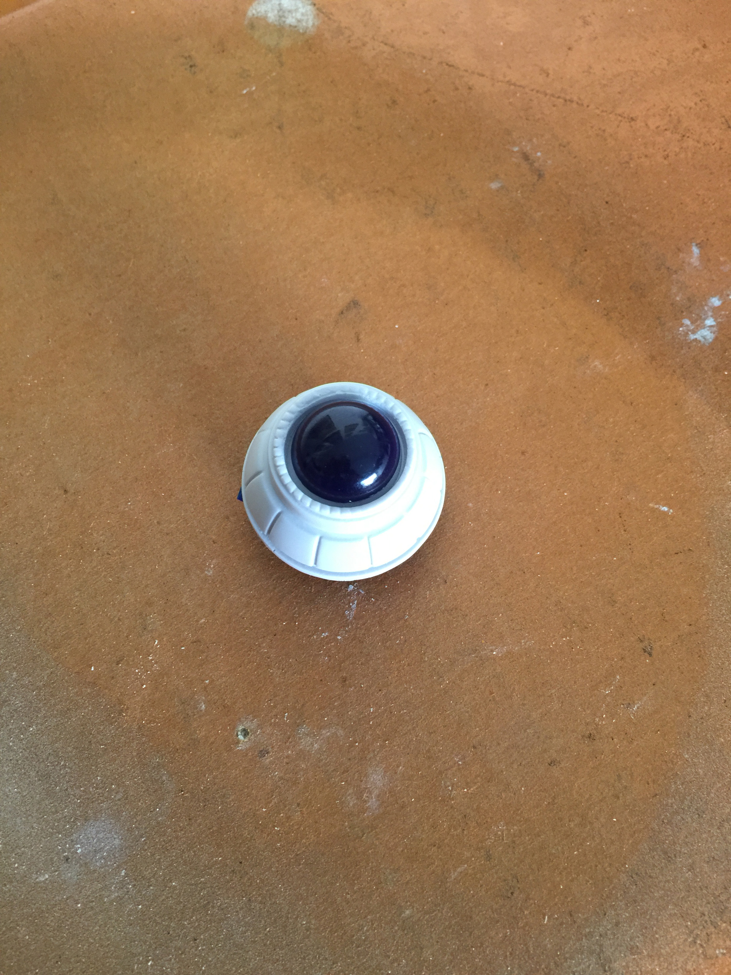

I wanted to use the holographic projector that came with the head, but I needed to alter it so I could light it up. I shaved down the molded lens and drilled a hole through the top.
Quick test fit of the jewel from the craft store.
Coat of matte black.
Then a test run with a blue LED and the jewel in place.
Not exactly screen accurate, but it will do. Hope to get more work done tomorrow.

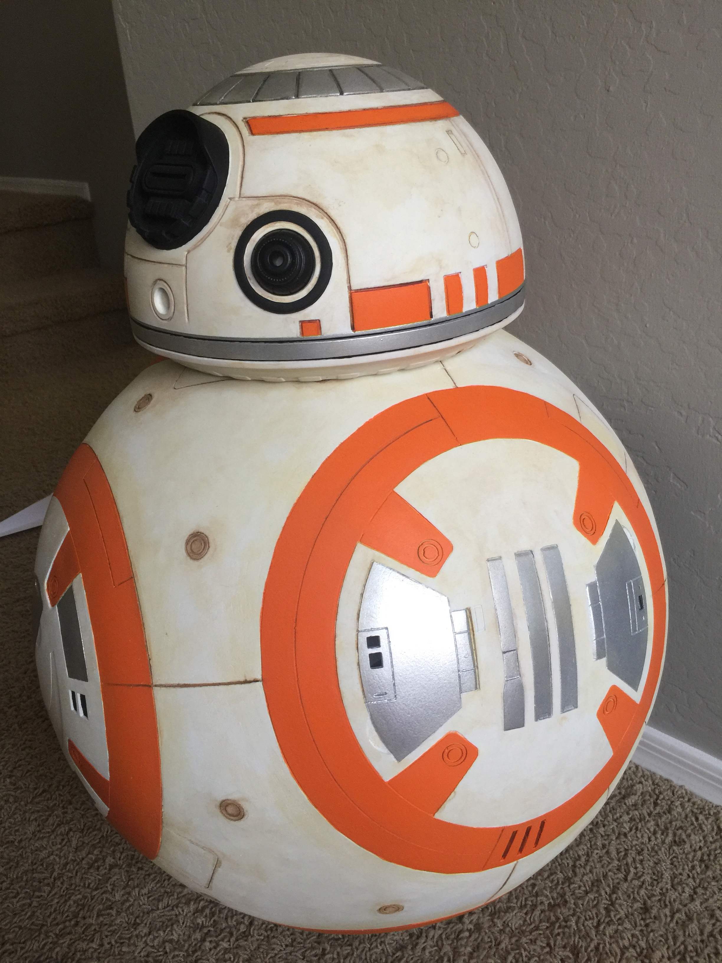

Last night I hit all the orange with two coats of matte clear coat. I really like how it looks, it knocked that orange down a lot. I temporarily affixed the holo-projector just to see how it looks. I'm going to try and clean up some of the paint lines today and start dirtying him up, then onto LEDs for lighting.

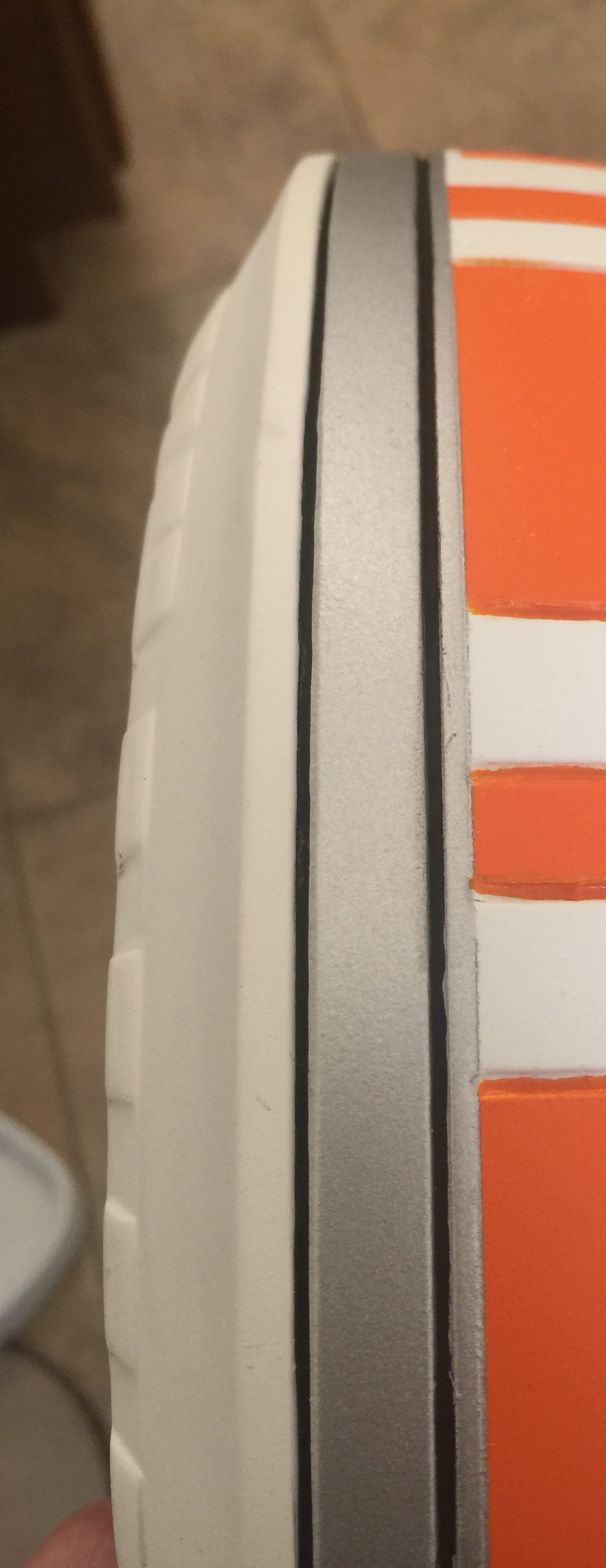

I picked up these Fineline Applicators so I could use them for the black in the grooves around the base and the top of the head.
Had some trial and error and a few missed spots, but they were easily corrected on the second pass.

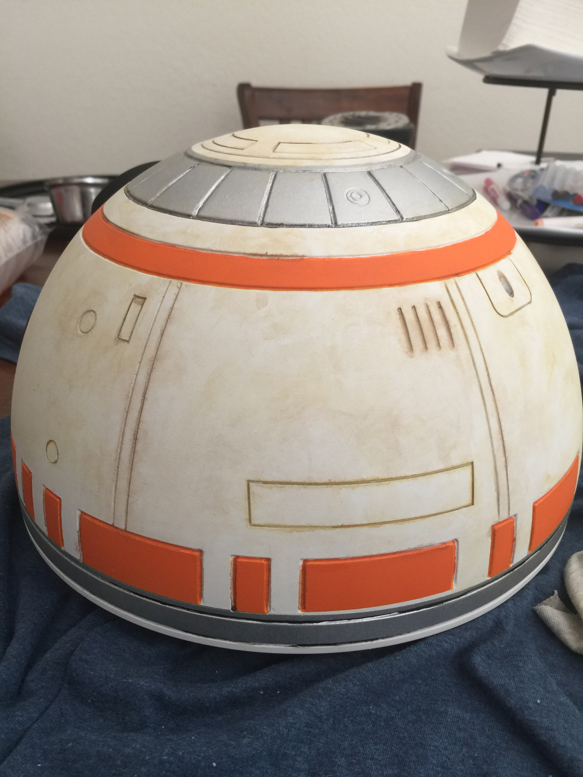

Then I completed the first two base coats of weathering.
I'll let this dry and start on the body.
Went a little heavy in some spots, was able to darken a lot of the lines, it's coming along. Going to step away from weathering for a few and work on the electronics.

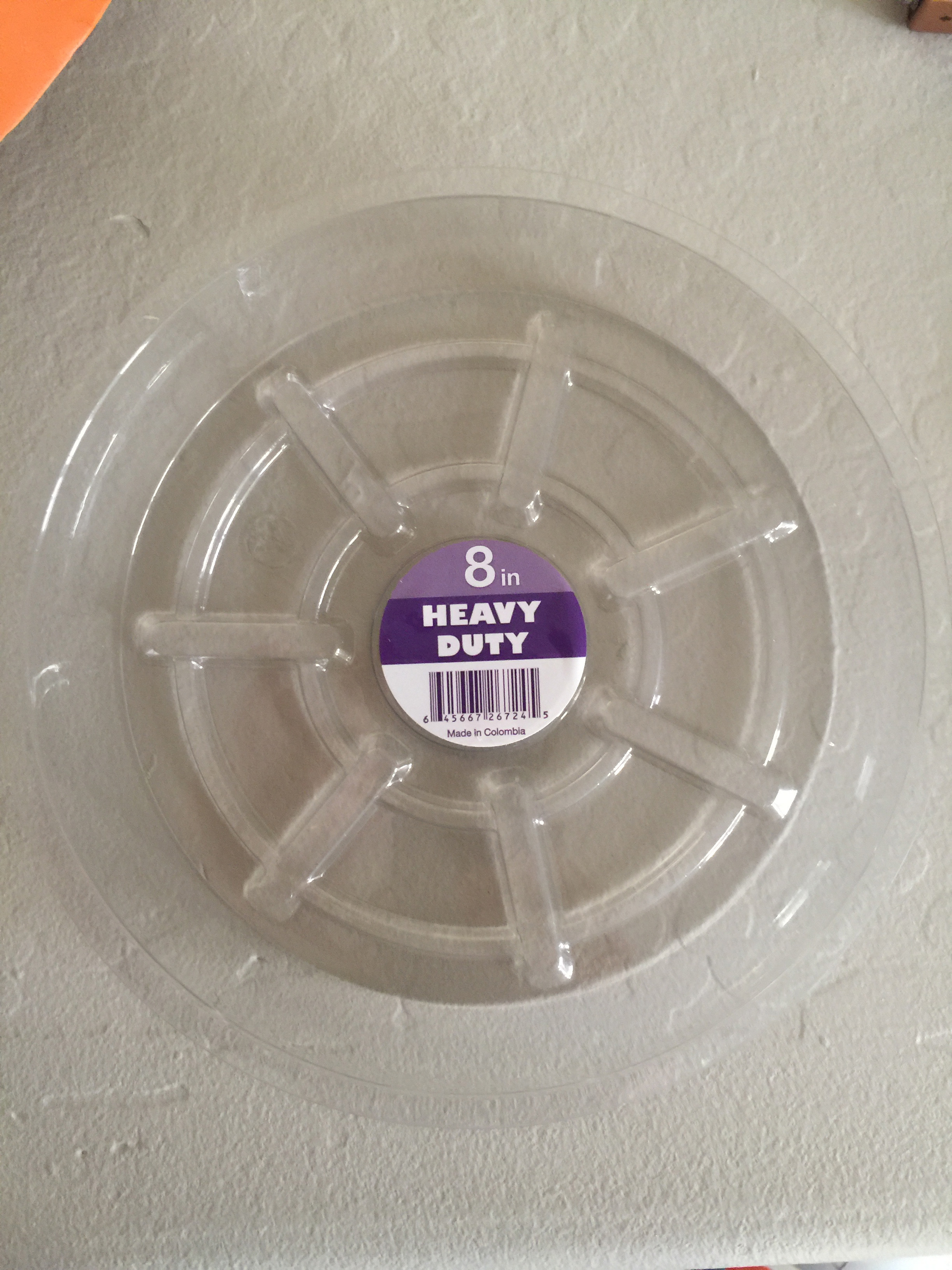

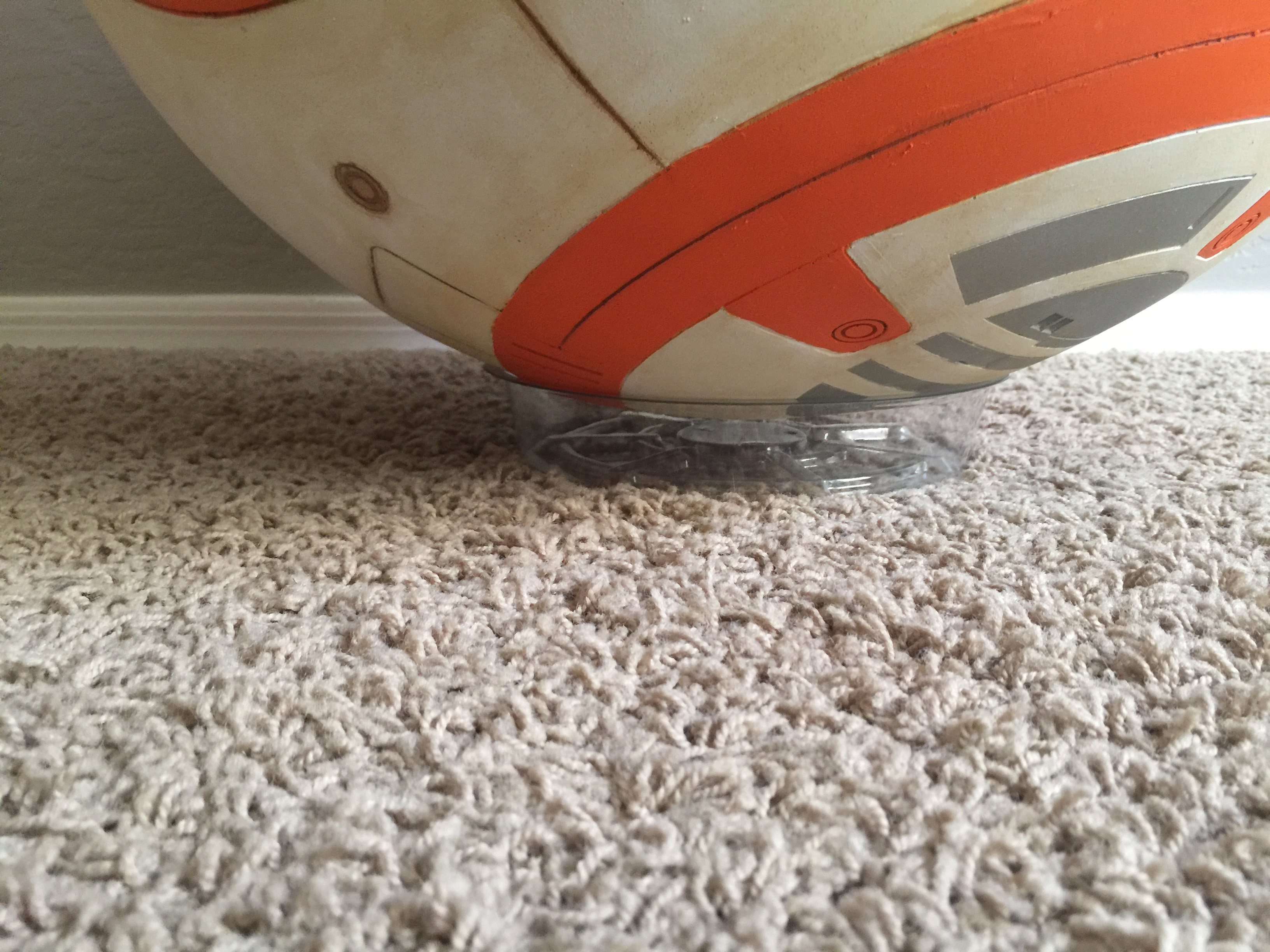

Quick update, found a great option for a BB-8 base, and only $2.00. It's a plastic planting pot tray from Lowes.

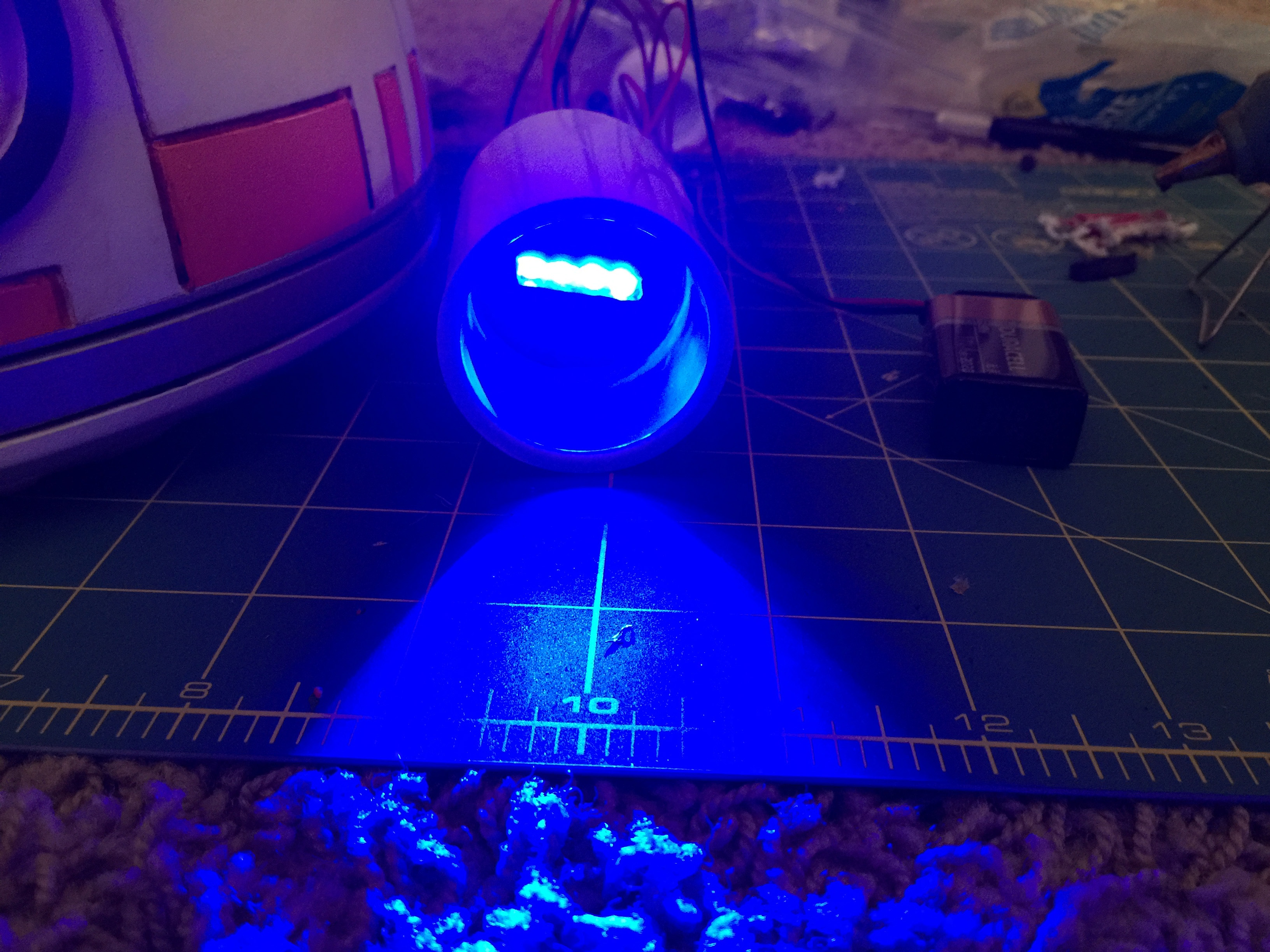

I'm using my Schedule 40 pipe method for mounting the lights. I got a few small pipe caps (1/2") for the single lights and a few larger couplers (1") for the others.
Drilled a hole in the end of the cap and hot glued in the LED.

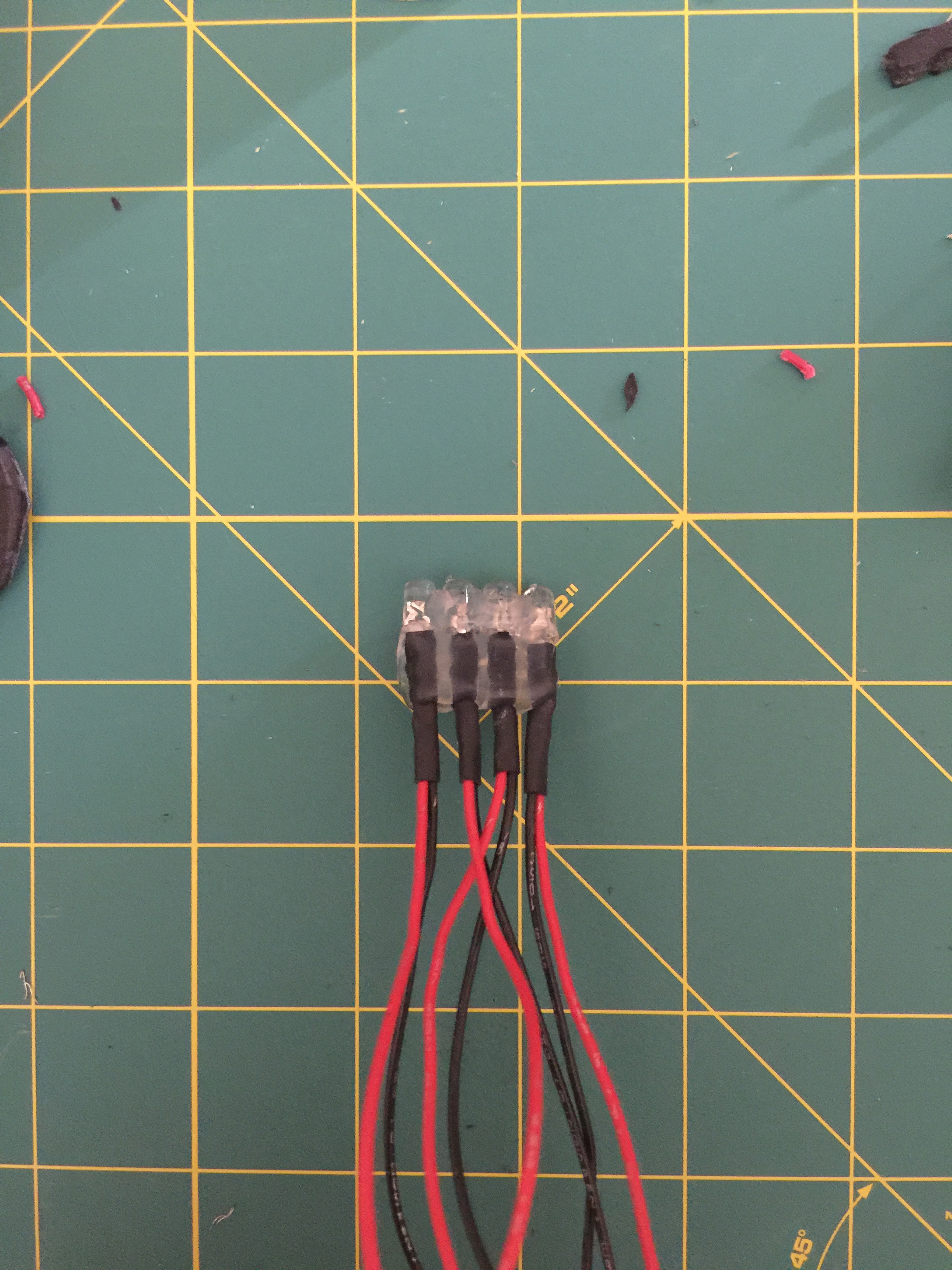

For the larger areas I hot glued 4 LEDs together.

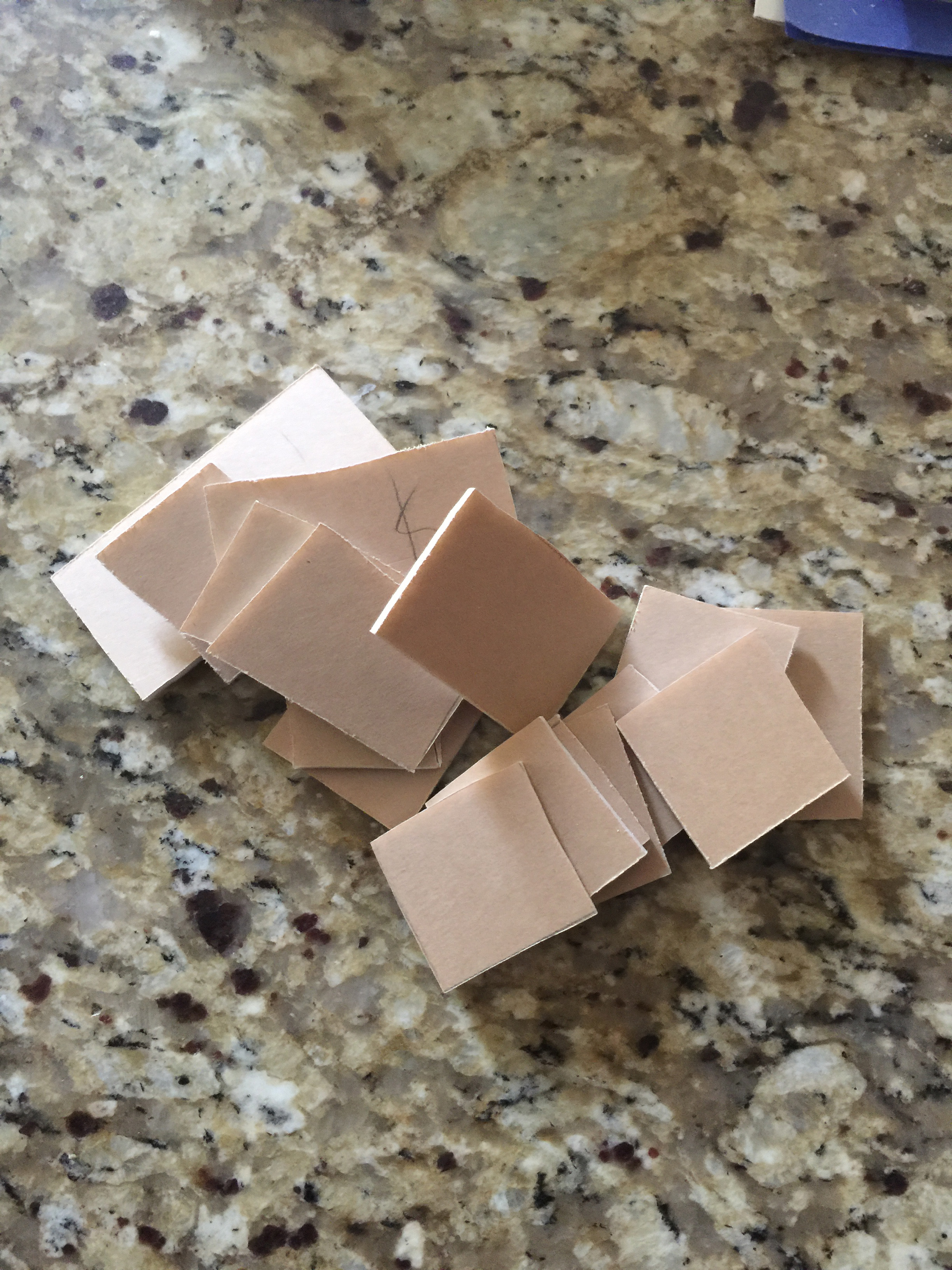

I took some foam board, cut it to the inside diameter of the pipe, cut a slit in the center, hot glued the LEDs into the board, then placed the foam board into the pipe. These are super bright LEDs so having them a little ways away from the opening helps disperse the light.
I used four blue LEDs for the lower left front slot, four white for the one behind that, one red in the center eye, one blue in the holo projector, and one flashing blue for the lower eye. I'm going to make a circuit board for the little flashing blue eye so it will blink a little more randomly.
I'm going to run all 25 or so of these lights off one 9V battery. I'll start working on the body lights next.
