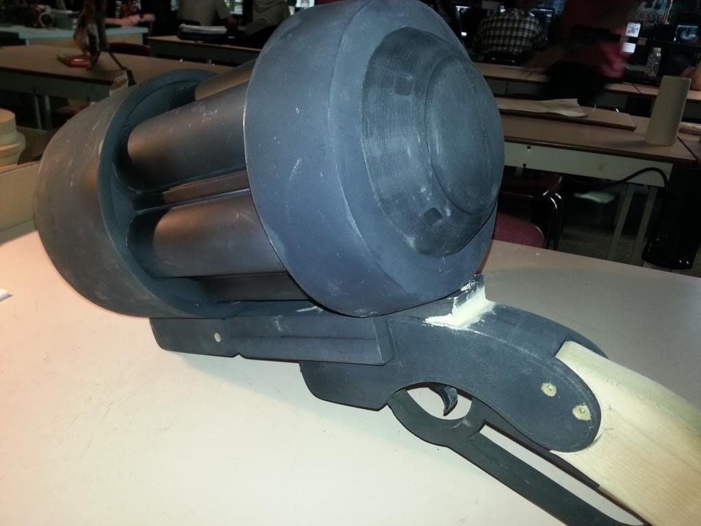

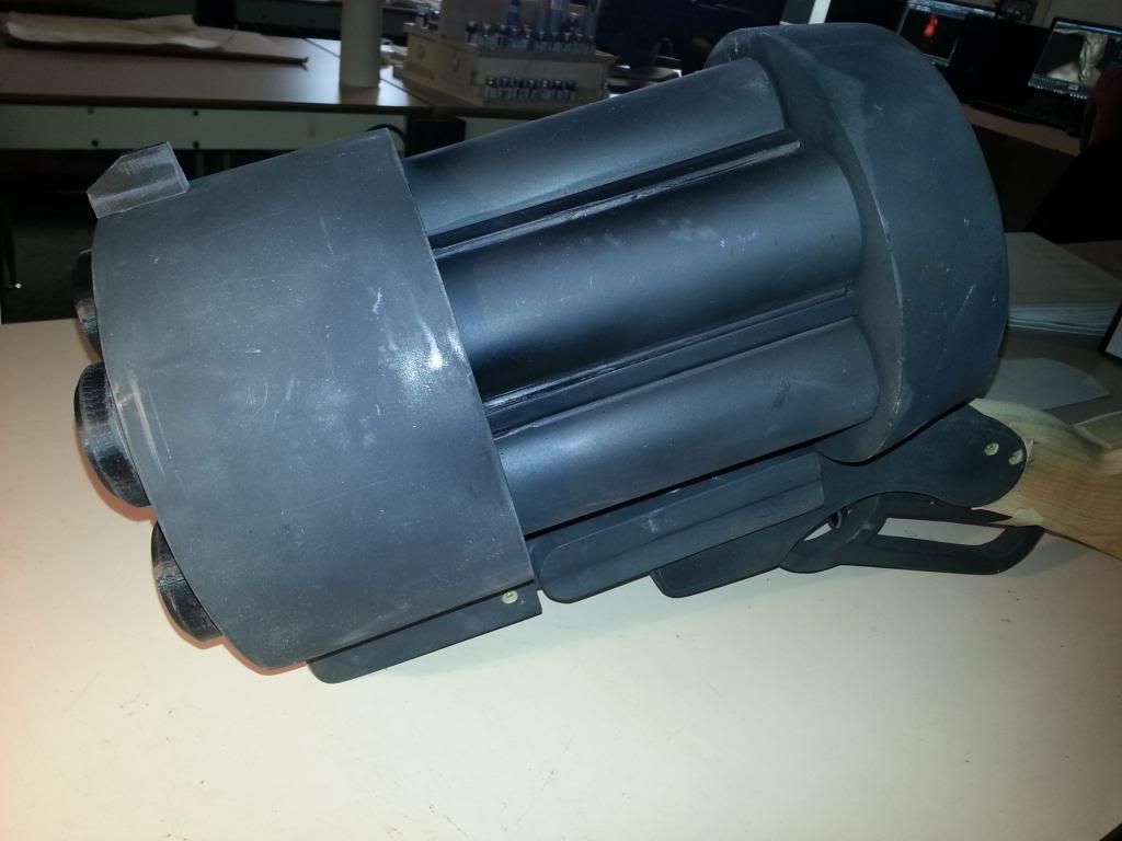

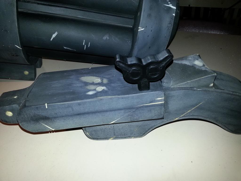

Here's a couple more WIP pics, trigger and sight have been modeled and 3D printed, caulk (which I can't say without thinking of Beevis & Butthead) has been painted. Ignore the wood-filler and other misc unpainted patches

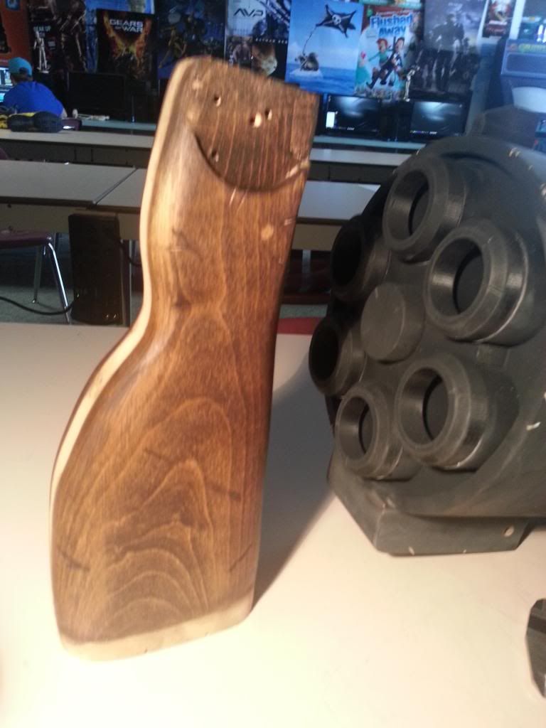

But it is awesome.. may I asked how the butt was machined or made?

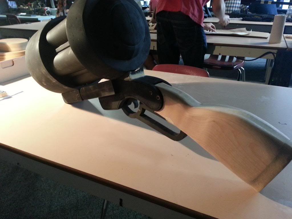

The butt (which isn't quite shaped perfect yet) was done by laminating a piece of MDF between 2 pieces of Alder (I think, maybe Oak), then roughcut on a bandsaw. Then I used a spindle sander for some more rough shaping. Then I used this cool new tool we had in our woodshop, not even sure what it's called, but It's basically like hooking up a rolling pin (wrapped in sandpaper) to an airline and going to town. It really allowed me to shape the piece, reminded me of a surf board maker shaping his board. Hope that makes sense.
Once the alder is stained, I'll paint the MDF core black and age it to make it look metal.

Do you plan on painting the Big Baby on the buttstock?
Well, I was planning to laserprint it onto a clear sticker, then vinyl cut the letters. It's been suggested to use a water transfer, although I'm not sure the benefits that would provide over the clear sticker...
But yes, one way of the other, big baby will be on there. I'm actually staining the stock as we speak...

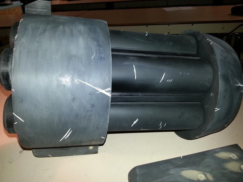

Here's a few more WIP shots. Most aging (via a hacksaw) is done, ready for more paint. The stock has a coat of stain on it, probably 1 more needed.

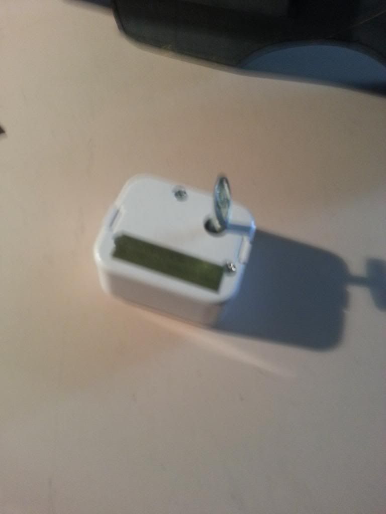

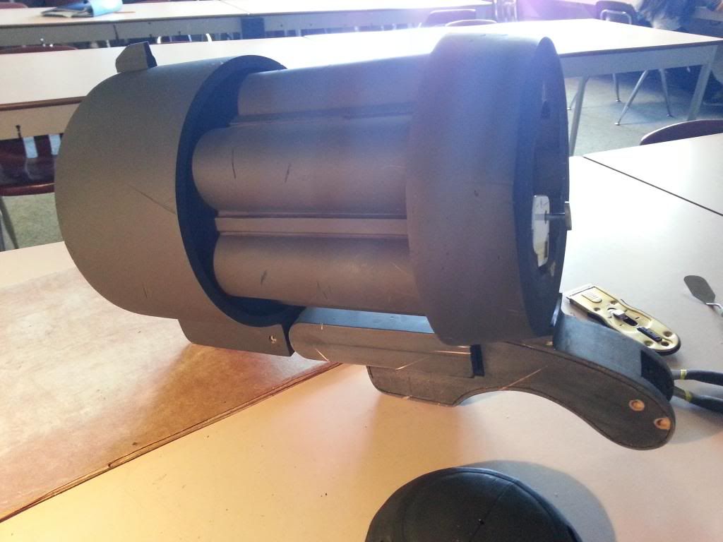

Here's the "musicbox" that will go into the back and will connect (somehow) with the winder (seen 2 pics above)

Here's some more WIP showing the music box in rough place. Also we've got the BPRD plaque modeled (thanks Kenzo) and printed, it looks awesome
A few more pics, I'm getting close to being done I think. From what I can see, and feel free to tell me differently, I've got the following things to finish:
- order clear labels, print color big baby, place over white mask
- make twisty music thingy work
- fill last few screw holes and paint
- find (or model and print) some big chrome flat head screws for the butt stock
- paint age layer
