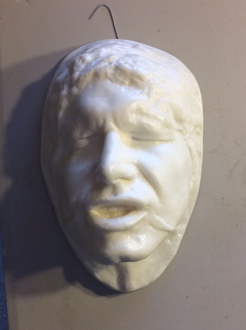

Anyway, my first step was to get a model, preferably in 3D, and I found this cast of Han's face from HauntedStudios.com. They claim it is pulled from a mold taken from the original screen-used prop. Okay, which one, Empire or Jedi? In my research I have also read that there are even touring HIC's, so this may not be the most accurate model from which to begin.
Oh well, gotta start somewhere. Here is the Han Solo face from carbonite freezing:
Looks pretty good. Harrison Ford apparently has a small face/head.
HauntedStudios informs you once you receive the cast, that the cast is resin, but then they also spray the outside with a few layers of some sort of clear coat. This makes it difficult to view super delicate details like pores (if there are any).
However, overall, I am impressed with the cast.

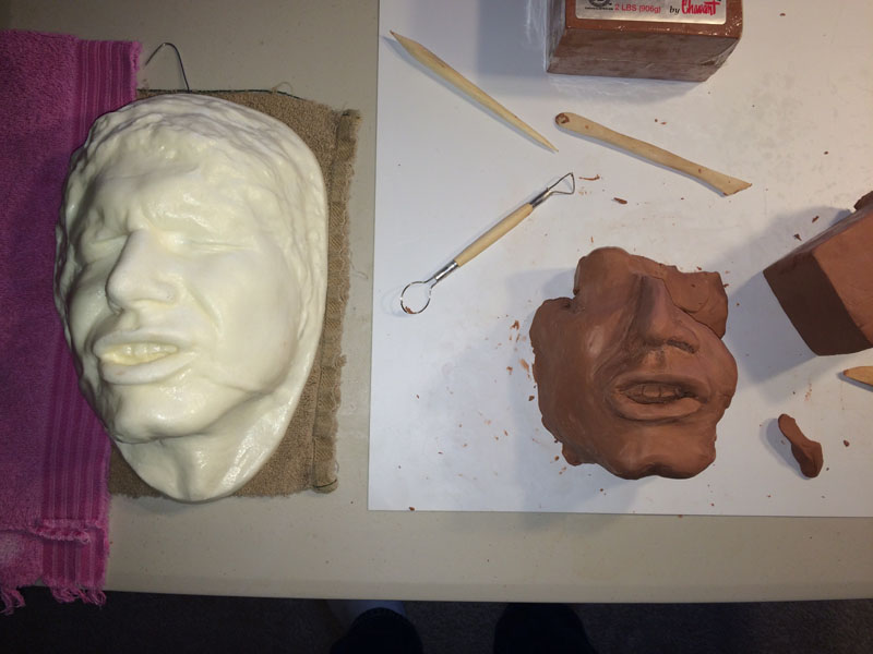

Here are the cheapo tools I ordered from China for $1.50. The quality of the tools is apparent also, especially that one with the wires coming out the ends. And by "quality" I mean "complete lack of quality".
This first sculpt will not be a final piece, but is more about getting me back in the swing of exercising dormant parts of my brain, and seeing how well I can handle this type of clay and/or sculpting at all.
I figured at first I would start with something simple and go against everything I've ever heard about scuplting and start focusing in on one area:
Again, this is only going to be a test run, testing my own skills, and not testing the final piece.
At first I did not like using the NSP because it is very hard at room temperature.
Also, wooden tools tend to hold onto the NSP leaving crumbs and sometimes even pulling away areas that I don't want pulled away. Fortunately, I ended up not using the tools very often and have found, at least at this stage, that using my fingers and pressure tends to push the NSP where I need it to go. This is definitely a patient or persistent person's medium.
Also, I really need to get one of those clay cutting wires.

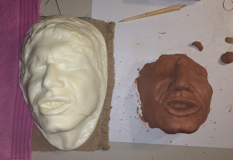

Here I am still building up the face.
I have read that first, it is smartest (for proportion's sake) to get the basic general shape of the head before doing what I am doing. I certainly can see the benefit of doing that and will do so on the final real piece.
And of course, always comparing back to my model for reference:
Well, that's it for now. I think on this practice sculpt, I will go up to the hair (from the nose) and just work on the side of the face (on our left), to further try out sculpting/blending techniques.

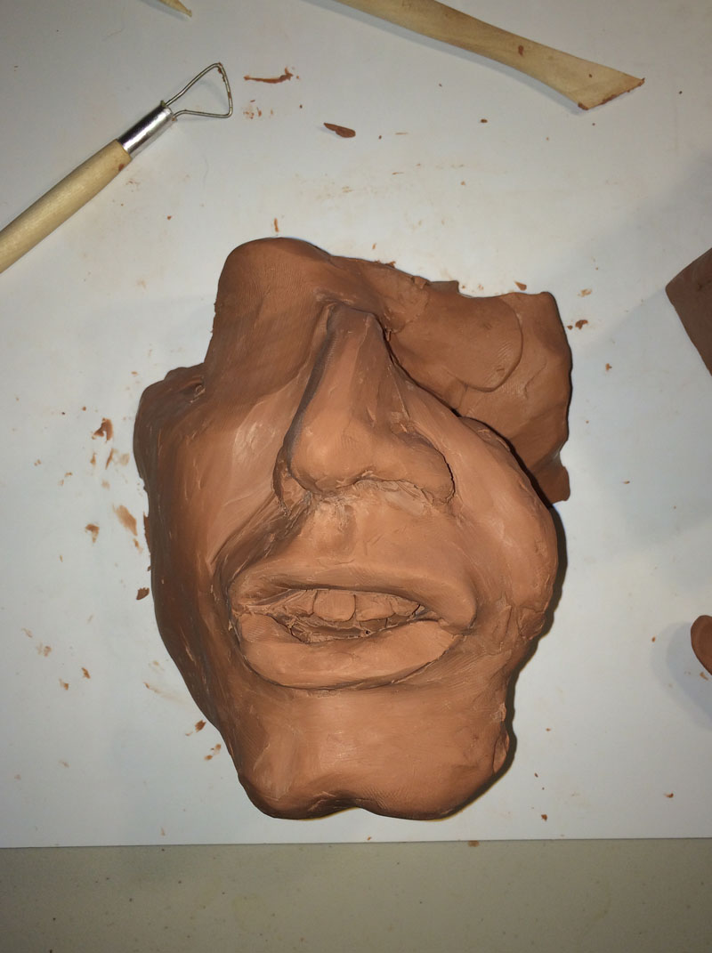

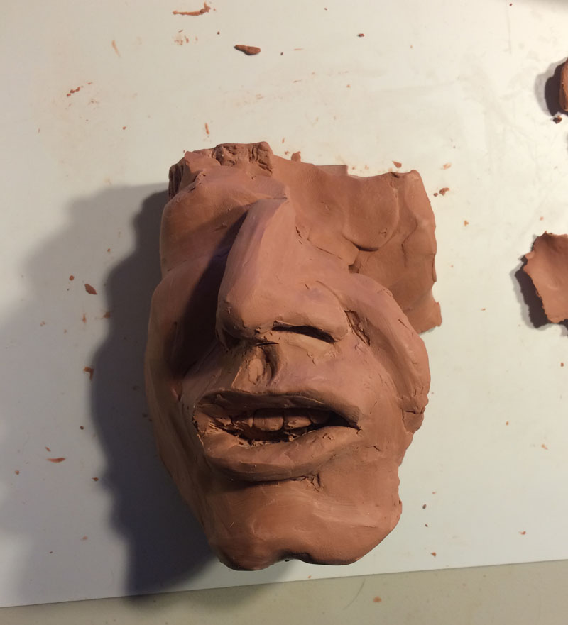

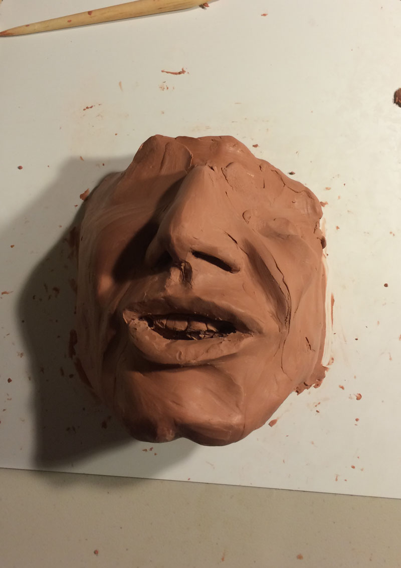

A little slow progress now. Still pushing around the clay... 10 P-leftSIDEbuildUP1.JPG 11 P-leftSIDEbuildUP2.JPG As I was working along, I decided it would be easier to picture the entire form by building up the left side of Han's face (his left). Although Harrison does have some asymmetry going on, his jaw (not including his chin) is fairly symmetrical.I believe my method of adding small pieces of clay is probably not good and may trap air bubbles in the piece... but it's working for me at this particular moment. 12 P-comp4.JPG Another quick comparison to keep the ball rolling. 25 P-aboveDOWN2.JPG 24 P-leftCHEEKbuildUP1.JPG 22 P-leftSIDEbuildUP3.JPG 23 P-aboveDOWN1.JPG More minor additions to Han's left side jowls. 21 P-widenFACE1.JPG 20 P-raiseCHEEK1.JPG 17 P-eyeBUILDup1.JPG 15 P-comp5.JPG Here I noticed that on the cast, Han's face really widens out/mine so far is a very gaunt Han. I am widening his right cheek here.Also, building up the eye area just a tad, and a comparison shot from above. 19 P-lowVIEWclay.JPG 18 P-lowVIEWhan.JPG Even though his lower face is appearing more evened out, when comparing the clay side-by-side with the resin Haunted Studios Han, it becomes obvious that there are some areas needing a major overhaul. The view from dead-on, looking down, is okay. I'm getting the basic forms, but the view from below (like from Han's belly looking up his nose) reveals major issues with the height f certain features. Notice Han's right cheek. Much higher in relation to his left cheek (nearly equal height) on the real piece/very low on mine.I do believe this is that old, get the basic general shapes and proportions in place first before moving on the the details. I will do it that way from now on.Also, I think everyone can agree that the part of HIC that will sink or sail this thing is the mouth. His mouth even got that close-up during the thawing scene in Jedi. The comparison shows that the upper lips is way wrong. I fear I will have to extract that section and rebuild. 27 P-aboveDOWNhan.JPG 28 P-aboveDOWN2.JPG After trying to build up low areas, here are a couple final shots until next time (with a flash!). Damn, I can see so much more now that I am reviewing these images. I guess I need to get brighter lights at my work table! Believe it or not, this angle shows the mouth looking about the worst that it has since I started, but it is actually a lot closer in shape (generally speaking) than what I had previously had on this piece.And a final comp. A lot of work to redo here. 26 P-comp6.JPG Any suggestions or tips about not leaving fingernail marks everytime I breathe in the same room as this thing would be greatly appreciated!Thanks for looking.
Sym-Cha
Sometimes it also helps to shoot a picture in black and white ... the grey reveals more that's off ... the same as spraypainting a grey matt basecoat on a real 3D model :) ... just cut your fingernails as short as you can bare or wear latex 'surgeons' gloves ;)
Chaim

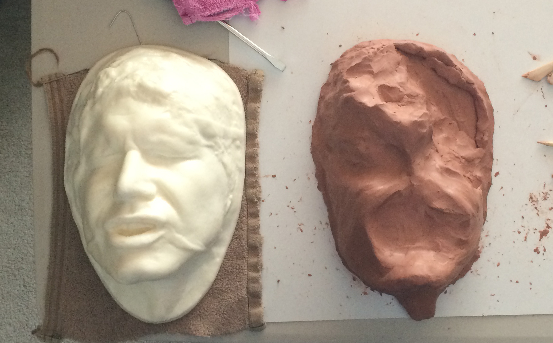

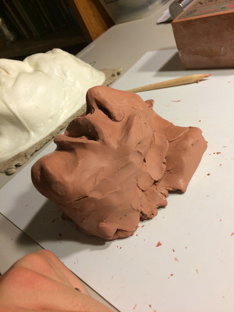

Alrighty, I am back. I couldn't really progress any further due to running out of clay. It took about a week, but I finally have it.
Before I ran out of clay, I began extending the lower clay level of the forehead. I decided that it would be best to get a rough shape for the whole head. I have also decided that next time, an armature of some sort would be extremely beneficial as the following image shows a full 6 pounds of Chavant NSP clay:
Half a head. That's it. An armature (or bowl or a wadded up rag or anything not clay) would have saved a lot of clay. Oh well, this is all a learning experience.

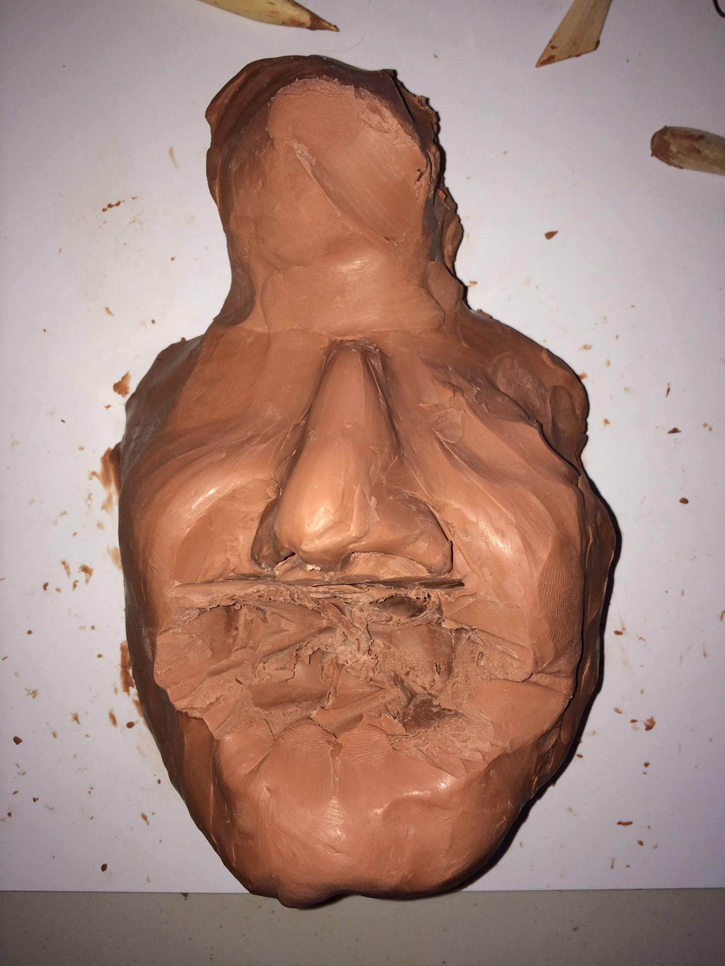

With my new plan of forming the basic shapes as much as possible first, before hitting any details, I decided that some things just needed to go and be redone. So I took out the mouth:
Then, once the new NSP arrived, I began filling out the outline of Han's head, and also while viewing the piece from different vantage points, I could tell that my proportions, although seeming to be heading in an alright direction when viewed straight on, were way out of wack from any other perspective. So I took the nose too:

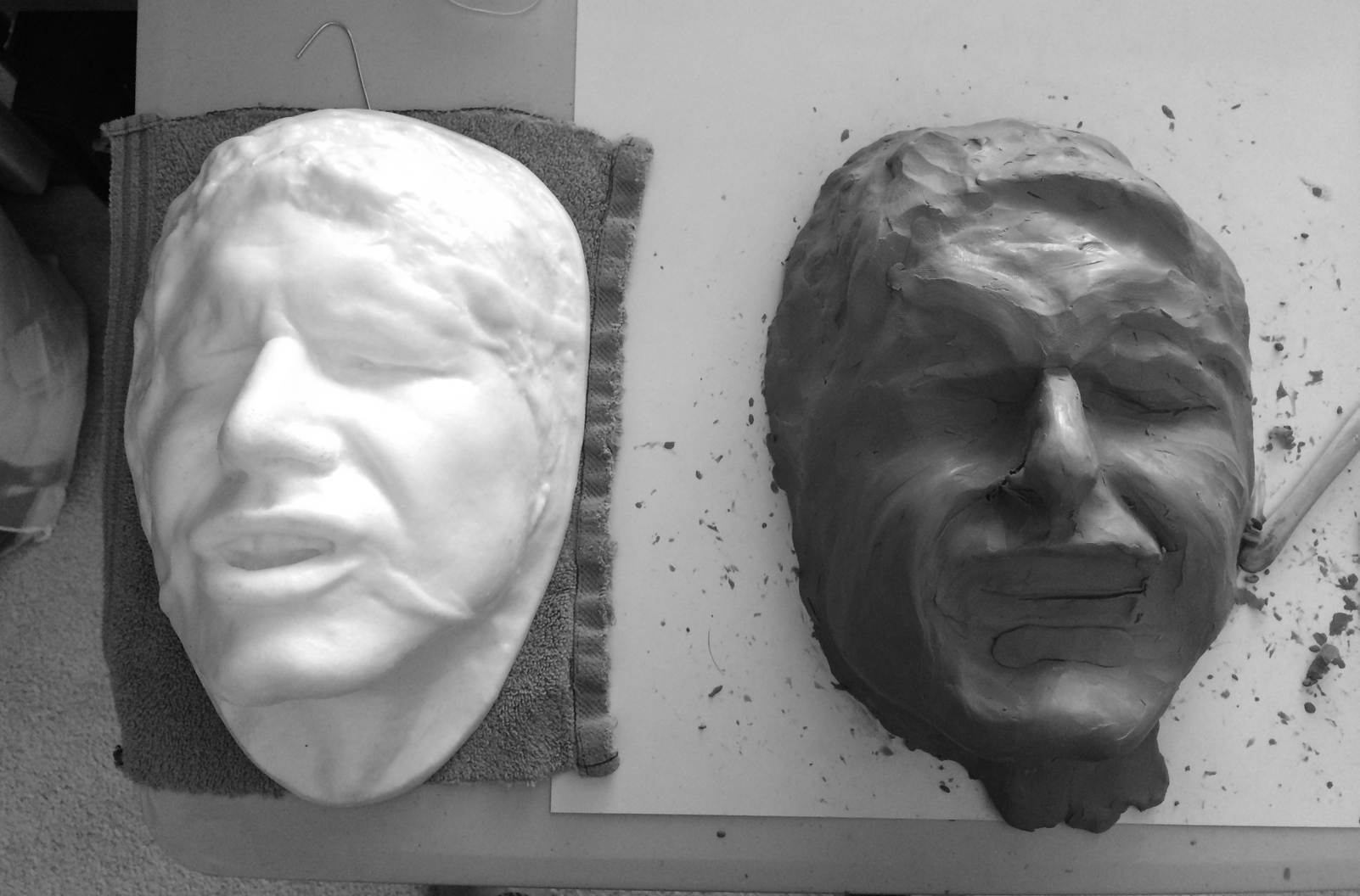

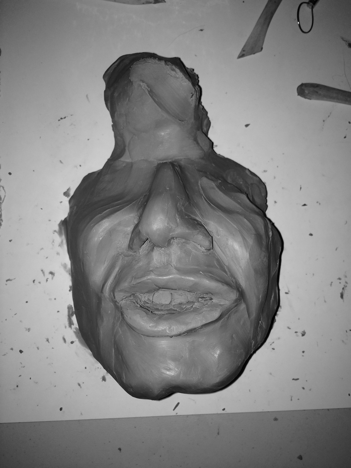

Adding more clay to build up the rest of Han's forehead & hair area. I've also been studying my progress with black and white photos:

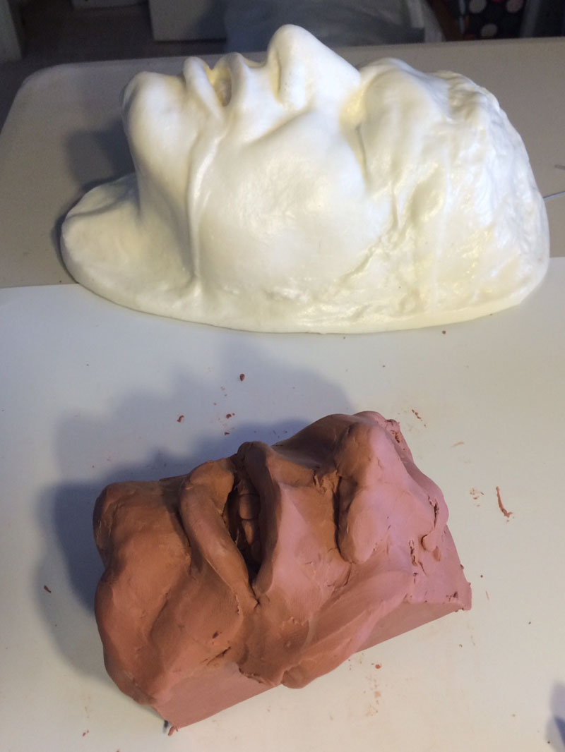

Here is a comparison shot from above and from the side:
Believe it or not, even without the nose and mouth, proportionally, the newer progress is more in line with the actual cast Han.
I finished building up the clay on the head and hair, careful to add just a bit too much so that I have something to cut and shape away. I also put a nose on and started to slowly build up the upper lip just where it connects to the nose:
And one more comparison shot from above. It's not a good comparison with the camera so close to the table, but the basic shapes are coming together much more in comparison to the sculpt just before I ran out of clay last time.
I am considering spray painting the Han cast a darker color to draw out the details. What color do you think I should paint it for that? What brings out the best detail? Gray?
Thanks for looking.
Sym-Cha
A flat gray is what is usuallly used for a base coat ... see the maquettes they did for ROTJ in the Art of ROTJ book ... that should pop some more details. It is good to practise your skills ... but why are you attempting to create a new head sculpt for HIC, since you already have a well done casting?
