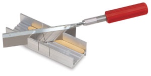

Bubbles I always use a hobby razor saw, they come with little miter boxes and I use them to cut plastics (T track, bubble strips, etc.)

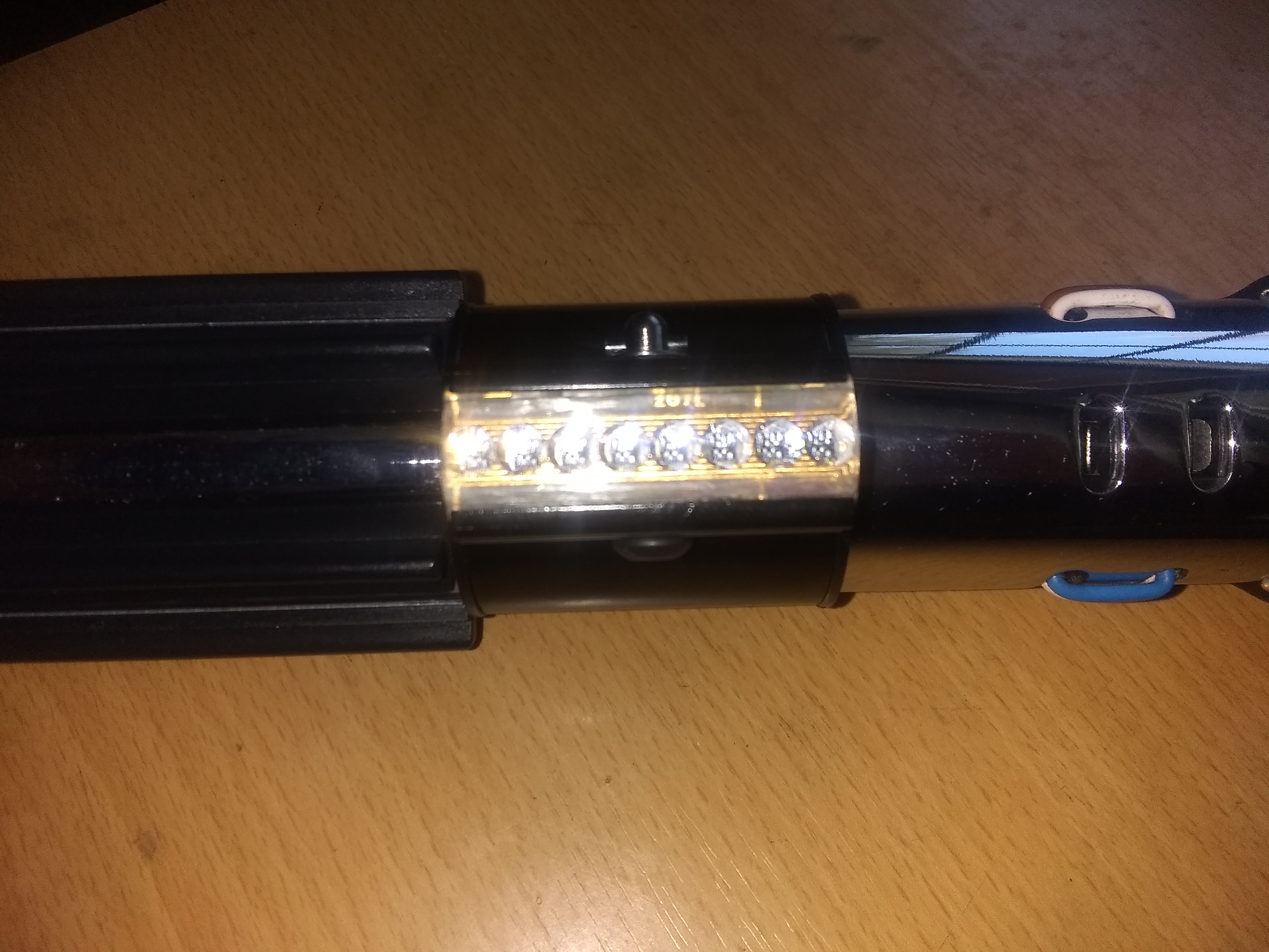

I came across a pretty rare 2005 Master replicas Darth Vader lightsaber. I think it was one of the early ones they produced that actually had a working clamp. It was in perfect condition, and an absolute steal for $100 on eBay. I just wanted a screen accurate hilt for display. It is a budget build, otherwise I would have gone with a Romans hilt.
I pulled off the cheap plastic wires, and added movie accurate colored wires. The fun part was adding the accurate bubble strip and clamp card. A quick shout-out to Halliwax for his advice on how to cut the bubble strip and card. The hobby saw worked perfectly! After trimming and sanding the card so it would fit in the clamp, there was one more little detail I wanted to add. The movie props has part of the screw threads exposed on one side of the clamp. Instead of replacing the post with the pressure pin, I simply grabbed a screw that was the right diameter, and cut off about a quarter of an inch. I glued it to the other side of the clamp to make it look like it was the other end of the post. The last thing I am going to do is add some weathering to the hilt. Right now it is a little too shiny and new.

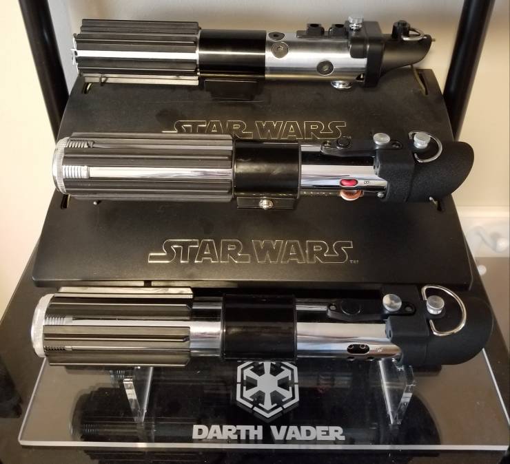

My OT lightsaber collection is nearly complete!
