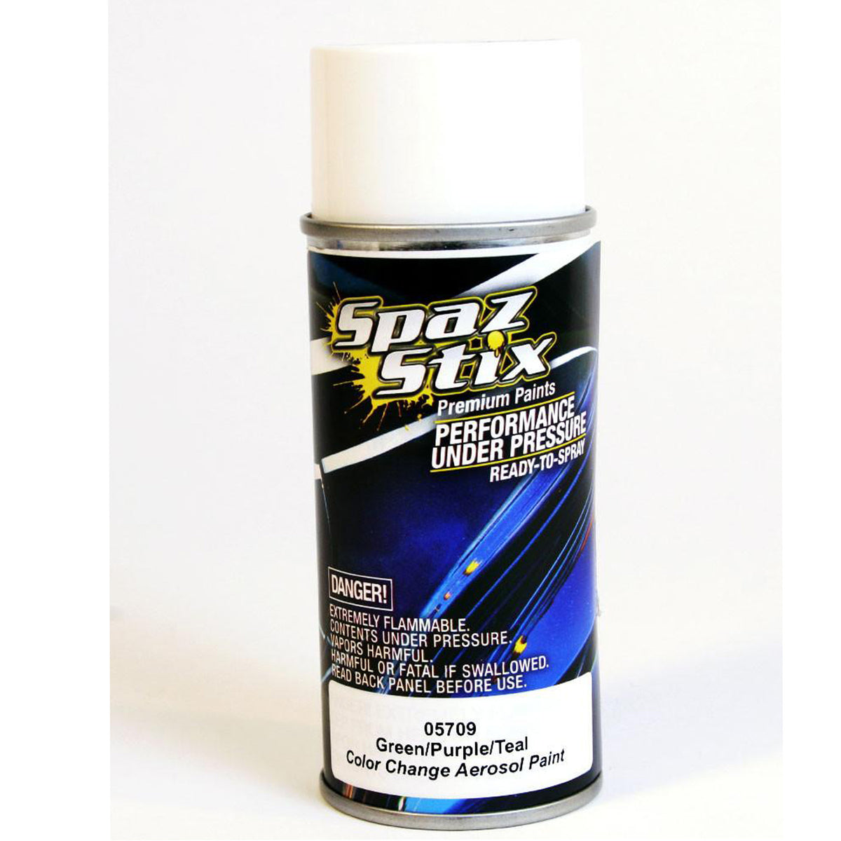

Spaz Stix makes a rattle can version of their green/purple/teal color shift paint. Never tested but I know some people use the airbrush version for goblin helmets.
