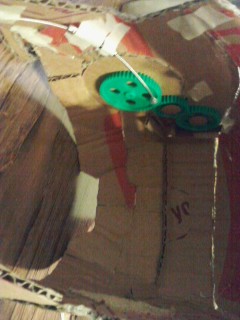

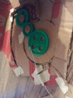

I temporarily mounted the gears onto the helmet (that is why it looks sloppy); I changed the original design a little to use less gears.
I couldn't mount both sides because I didn't have enough of these little things seen in the first picture.
( I just put them together like in picture two with the cardboard and the gear in the middle)

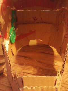

The third picture shows how they fit in the helmet, I used bike brake cable for the part that moves the jaw.

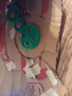

The fourth picture shows how it moves the pieces when the gear on the ear is turned forward.

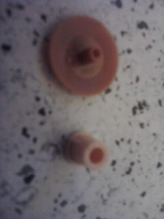

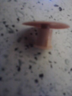

And the other two are just to show how little room they take up in the helmet.
I apologize for the bad quality.
Do any of you guys know what those little things in the first picture are called?

Im still not digesting how you are going to be 'spinnging the ear piece.. & moving it in/out from the helmet?
I can see the gears working on rotating the ear pieces around....and mating to a gear for the faceplate as well..
(kinda fuzzy on how pulling the line will open the jaw too..and make it move back as well? (springs?))

With the jaw and the top of the helmet movement the gear by the ear doesnt need to make a full rotation so I connected one end of the cable to the gear and one end to the jaw, when you turn the gear forward the cable gets pushed dropping the jaw; then backward would pull it closed. Its like opening and closing a baby/dog gate you are really just rotating the handle.

I love you guys' ideas! Helps me think. Little update, I made a cover the gears (I'll post a picture later today)

Looks weird posting 3 times in a row, but since people have been viewing the thread I'll post an update-ish... I got the gears on the other side set up and it works perfectly, but I cant find anymore of those thingamahoos I used to mount them to the helmet (I used drill bits to make sure it worked)
