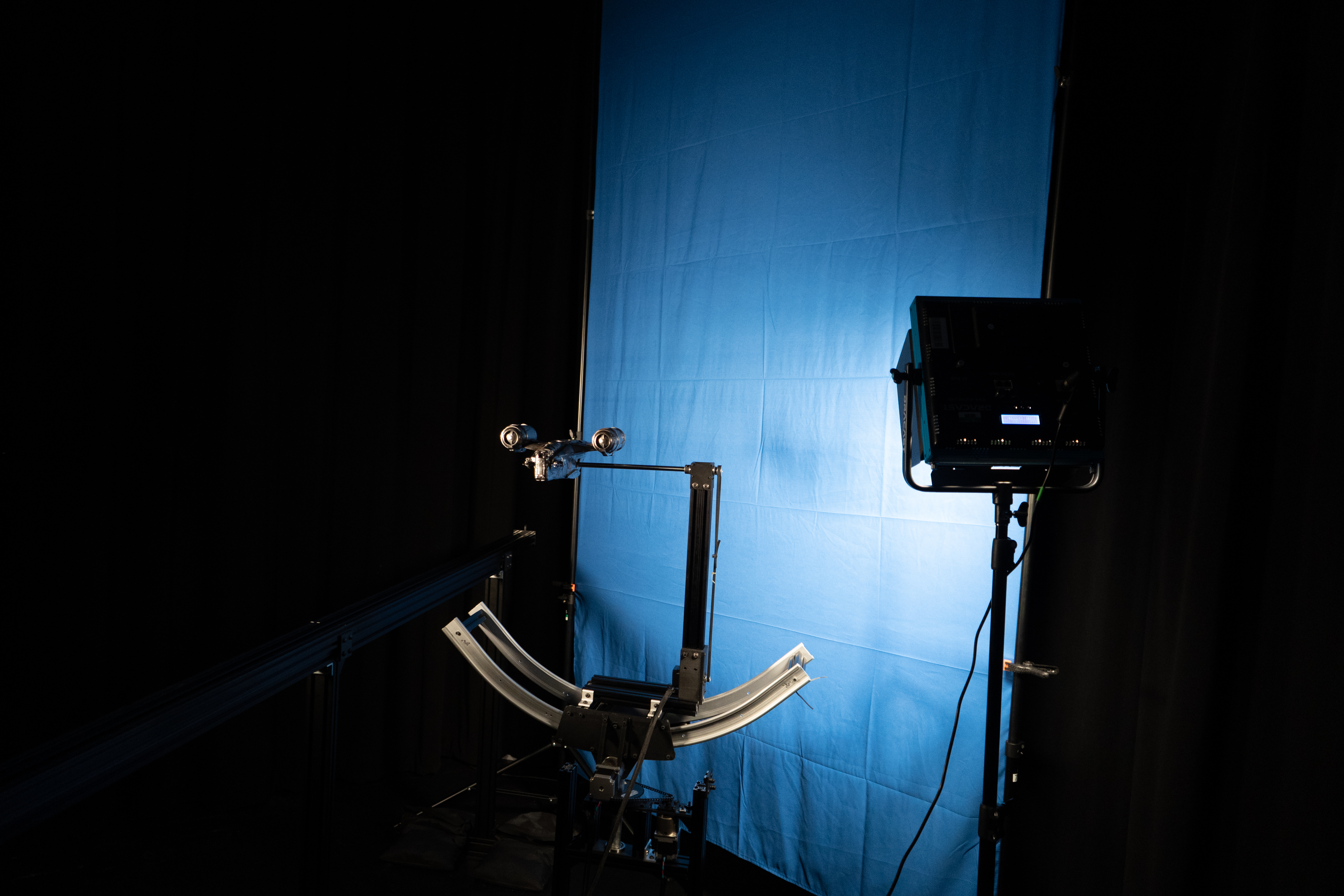

I am very happy to announce that the motion-control rig, a recreation of John Knoll, John Goodson & the team at ILM's work, had its first-ever shoot day! Here are some images of the shoot. My good friend Kyle helped me out throughout the shoot and took the photos. I'll be sure to share some completed shots:

As promised, here is a video of all the shots I filmed.
As a disclaimer, I wasn't able to add a starfield. When trying to get the model in complete focus, I brought the aperture to the smallest iris size which caused the least amount of light to leak into the sensor. As such, keying the model proved too difficult. I think I generally need more experience with the camera, but for next time, I will definitely experiment with the lighting setup.
Additionally, if you guys have any recommendations to improve the shots, please let me know!
