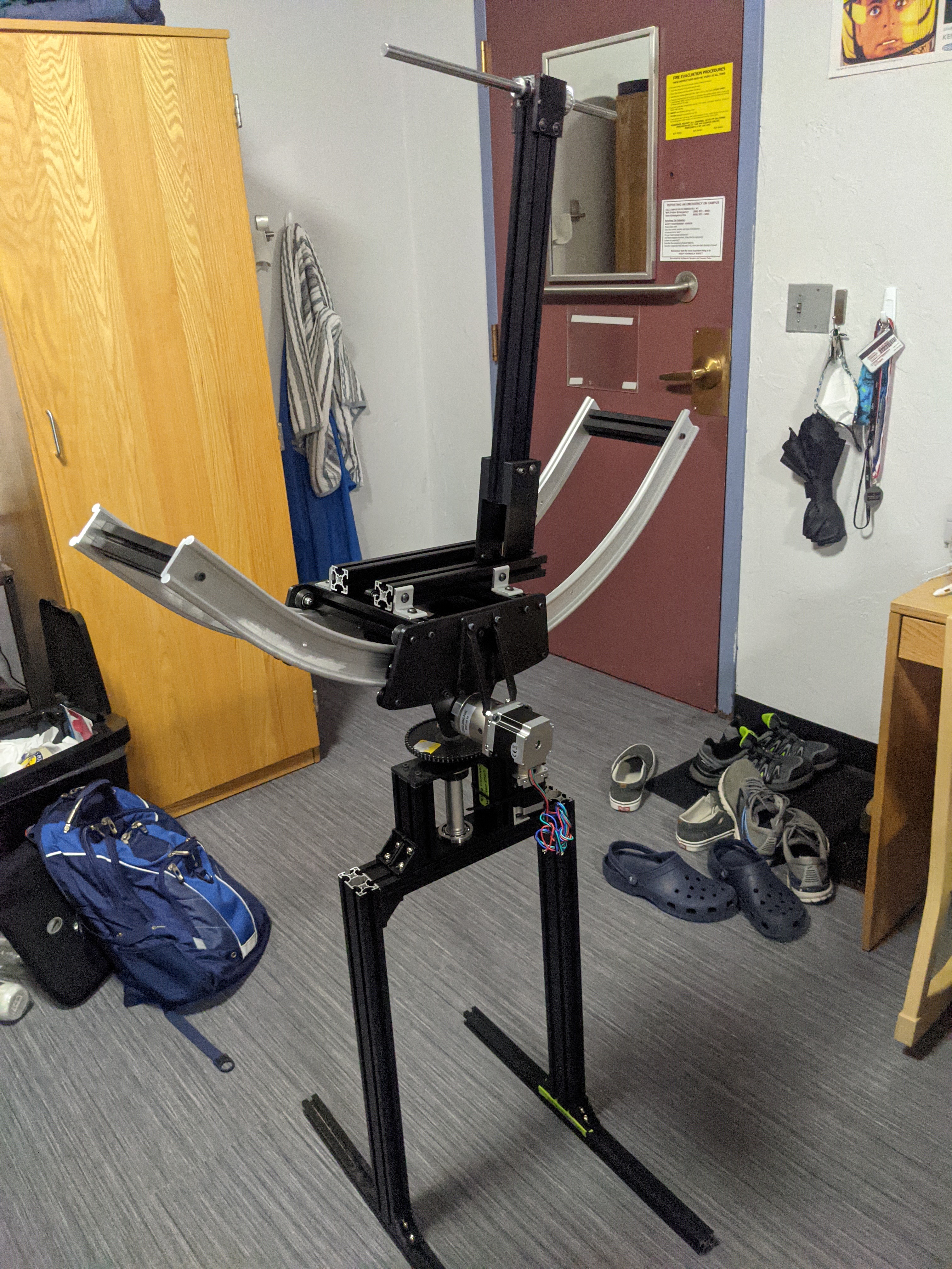

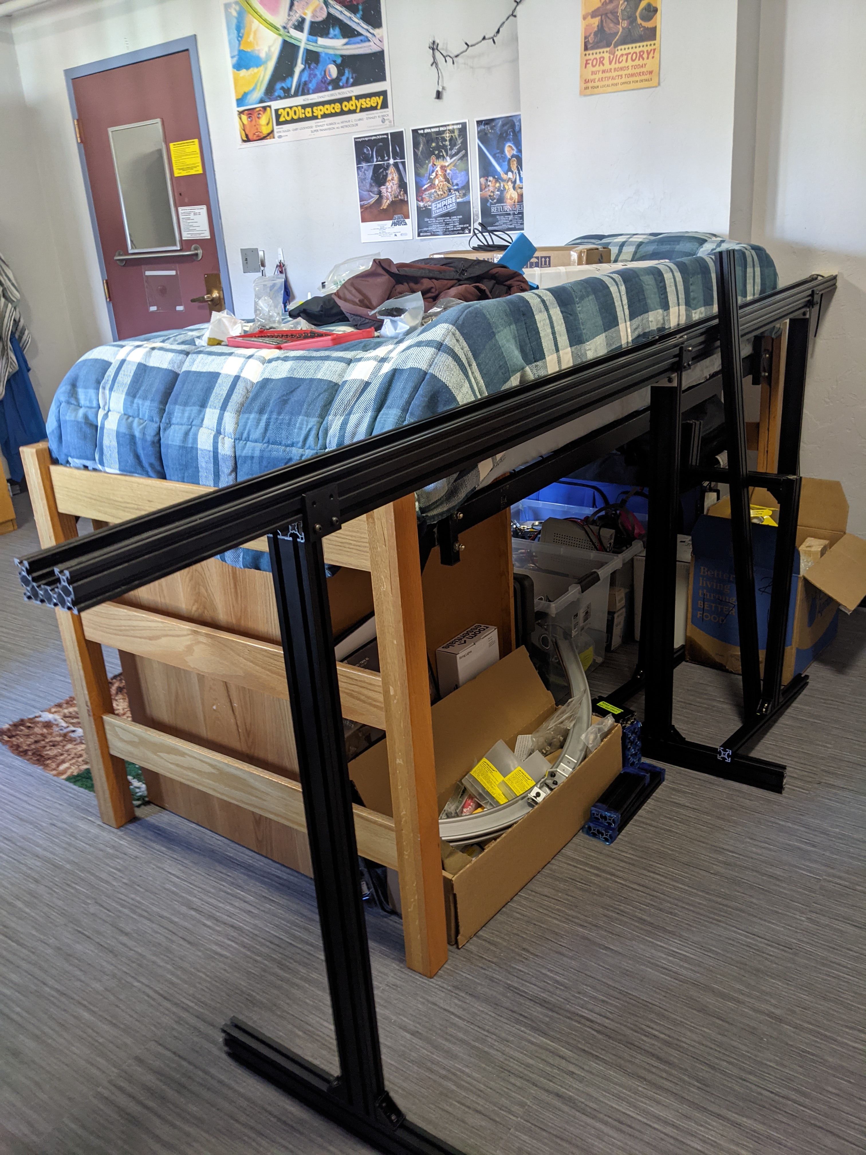

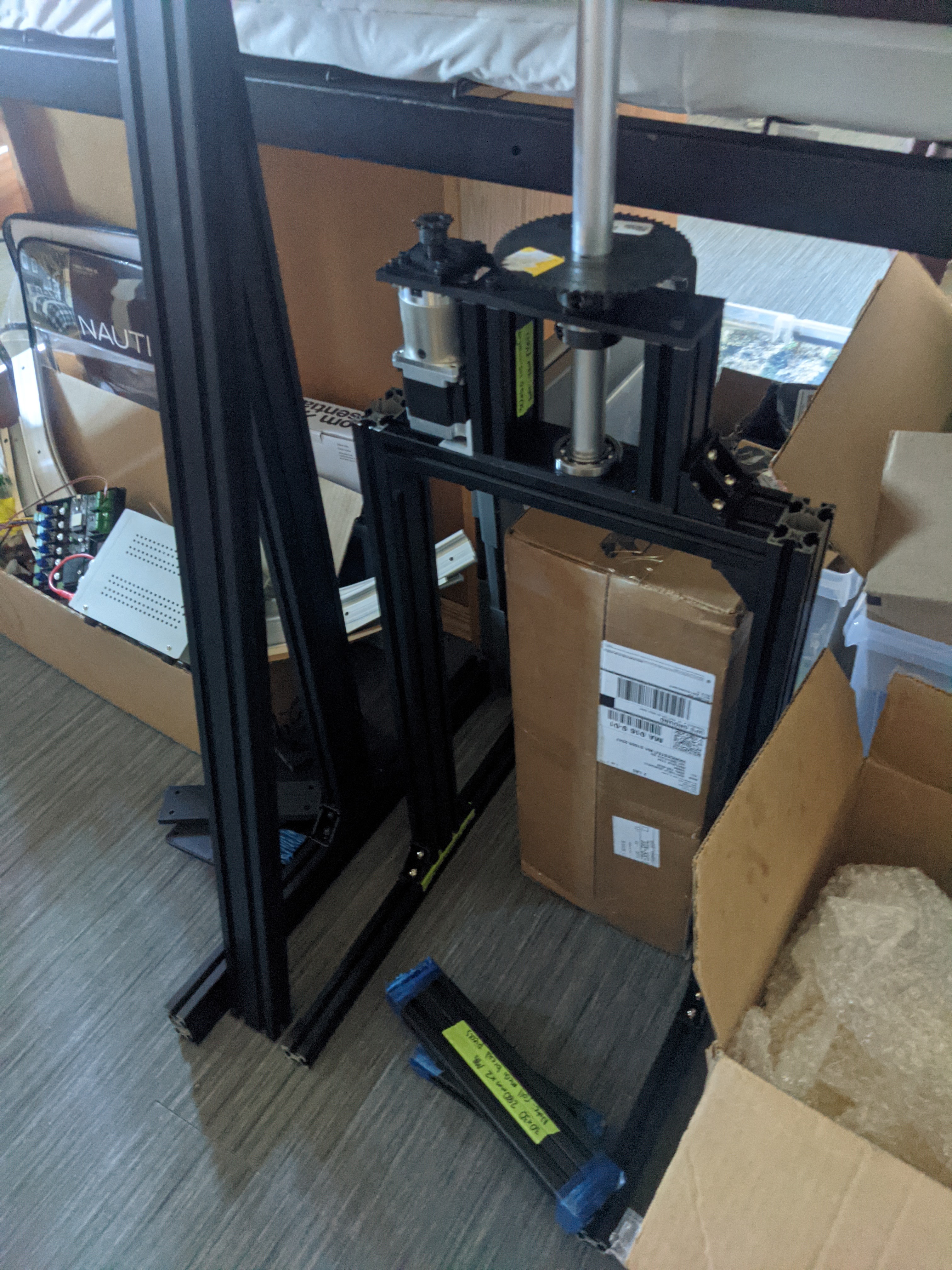

More recently, I have received all of my parts including the 80-20 & quarter moon rails & started assembling it all! Of course, I ran into some small problems, that being the 80/20 I purchased doesn't have any inside threading on the faces, so I had to quickly CAD a profile with an M5 hole to sit flush against the inside. Otherwise, here are some images of my progress!
The linear rail is 3 meters in order to have enough room for longer camera shots. The miniature rig is taking a bit longer since a large portion of it requires 3D printed parts. Here is an image of the quarter moons!

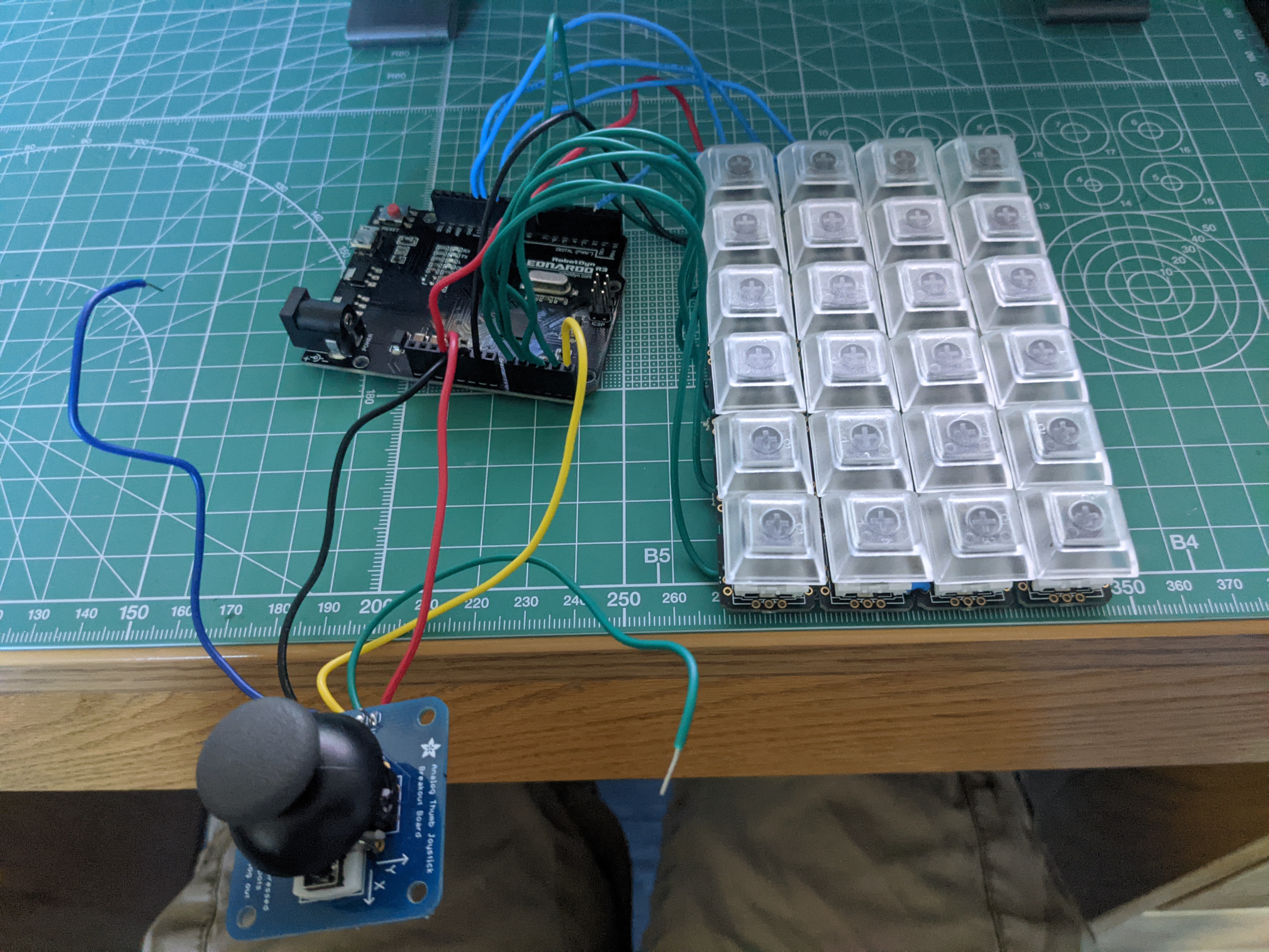

On the electronic and coding side of things, I've made great progress on the Jog box, which is the numpad & joystick that will handle moving the rigs and a blender simulation at the same time. The real rig will move so I can actually see where it is going, while the blender simulation is there for me to program keyframes and revise the movement curves. Once all the revisions are done, I can export that scene in blender as a gcode file using a nifty python script I found online.

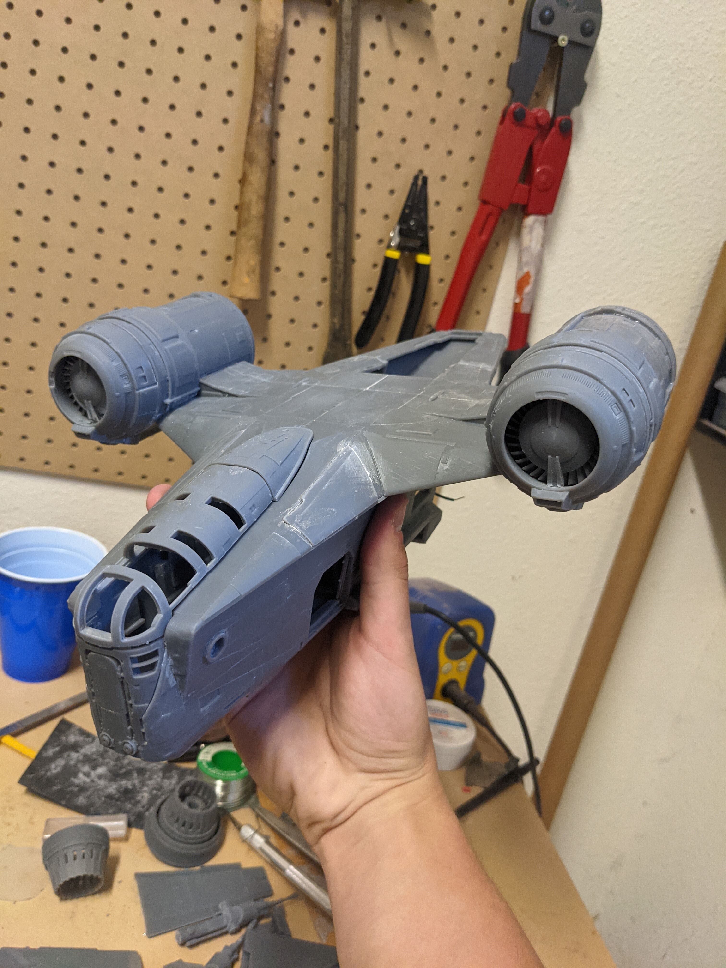

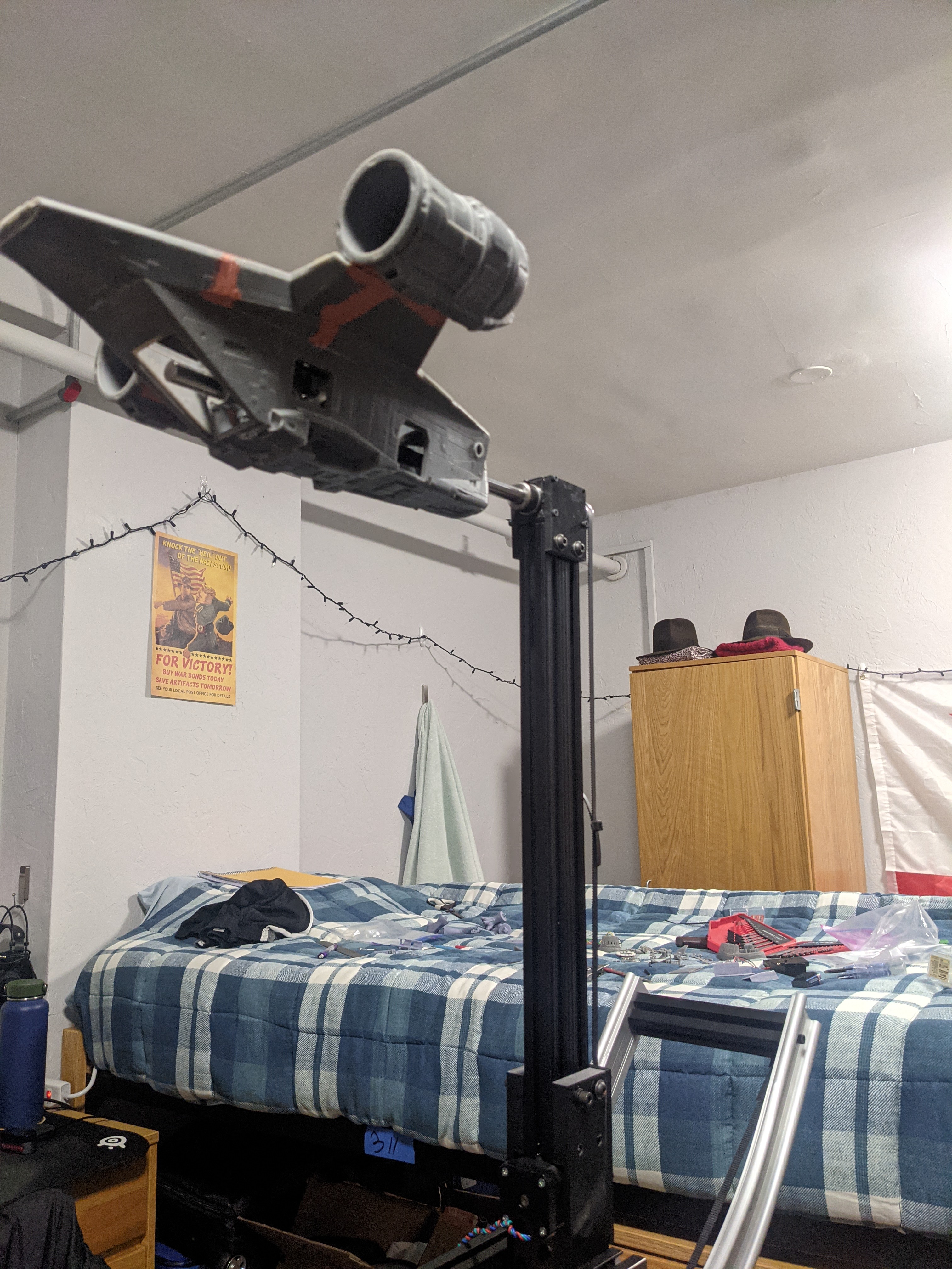

Just another quick update. I was able to position the internal clamping rig on my razor rest miniature, so now I can position it on the roll rod. I do have to slightly sand off the side walls to allow side clamping, but I should be fine.
The miniature rig works surprisingly well. There is a bit off wobble happening, which is primarily due to the parts being 3D printed instead of being machined out of aluminum. I'm thinking to string up some weights on either side of the quarter rails to ease the wobble.

I was curious why the motion in the Yaw axis became so coarse when you reduced the jog speed to 1. I was expecting to see it to get get slower but stay relatively smooth.
For a moment I thought you had directly mounted the motor to the Yaw axis, but I realised you have a reduction belt drive like the other axis.
Understanding its a work in progress. And seriously that aside, well done.

Good eye! So the coarseness of the yaw motor moving at 1 is not an error, as it is primarily the nature of jogging. The use of jogging for this rig is purely to position the axis and set keyframes. The actual motion will be programmed through standard gcode, so the movements will appear much smoother.

I did notice some wobble and backlash on your camera rig though when you were testing it. My only suggestion I can make there is, go large. Make your lasysue bearings or needle ring bearings as wide a diameter as possible. It increases ther... umm... solidness! Yeah thats the word :D
You might also want to consider gearing down the stepper motors for the camera rig as well... And make sure you got 0.9' steppers as well, to get the best smooth motion. Unless speed is your goal. With stop motion filming speed isnt important, accuracy is.

That sounds awesome! Please keep me updated on your progress when you start your build. In terms of the stepper motors, I can't really change them at this current stage, but I will let you know I am using the exact same ones that John Knoll used in his rig, so I'm pretty confident with their smoothness. The wobble/backlash you mention does in fact need to be addressed. The main cause of that is the 3D printed brackets. Because there is some inherent flex, some parts are cantilevering some of my mechanisms. My current way to reduce this issue is to use zip ties, but I think I might have to machine some of the brackets in aluminum to eliminate the flexing. There's also an inherent issue with the o-drive (the linear motion of the camera). Because the linear rail is 3 meters, I have to extend a belt that long, which is a pain since you need to make sure it's ultra-tight. Unfortunately, I'm definitely going to need to re-tension the belt, but I'm not sure what solution to use to make it permanent and super-taut. Another slight issue is the roll mount where the camera is positioned. Because the camera is a bit heavy, it's tilting the roll rod ever so slightly. But I took a look at John Knoll's rig used in the show and observed some similar leaning. The current rod is 3D printed, so I am planning on replacing it with an aluminum one, but I doubt it will make a difference.
