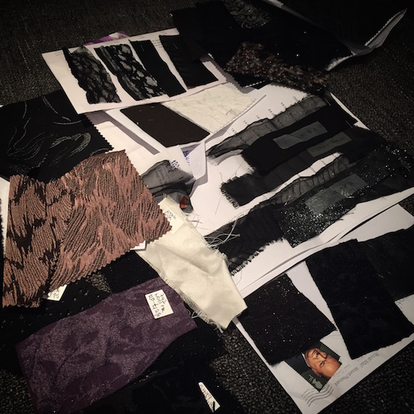

All the samples I got to far. I mainly searched for brocades and jacquards. I would like a more sturdy and heavy fabric. Preferable I don't want an all black fabric. A mix with dark blue/red/purple/burgundy would work nice. Most are voted out already. I really like the coffee jacquard which I'll dye black in the weekend to see how it turns out. It has the same sort of texture as the original dress (not the same design of course). Both front and back are very interesting. Most fabrics are too shiny, like a lining fabric or to glittery.
I saw the real costume (dress she wears at the end, not the one show here) in Planet Hollywood in NYC. It was very interesting to see. Too bad I couldn't get good pictures due to lighting and the plexiglas box. The fabric has different 'levels'. There is the main black layer with glittery black details on top, it almost looks like small seed beads and then there is the burgundy fabric with is sort of a wave pattern.

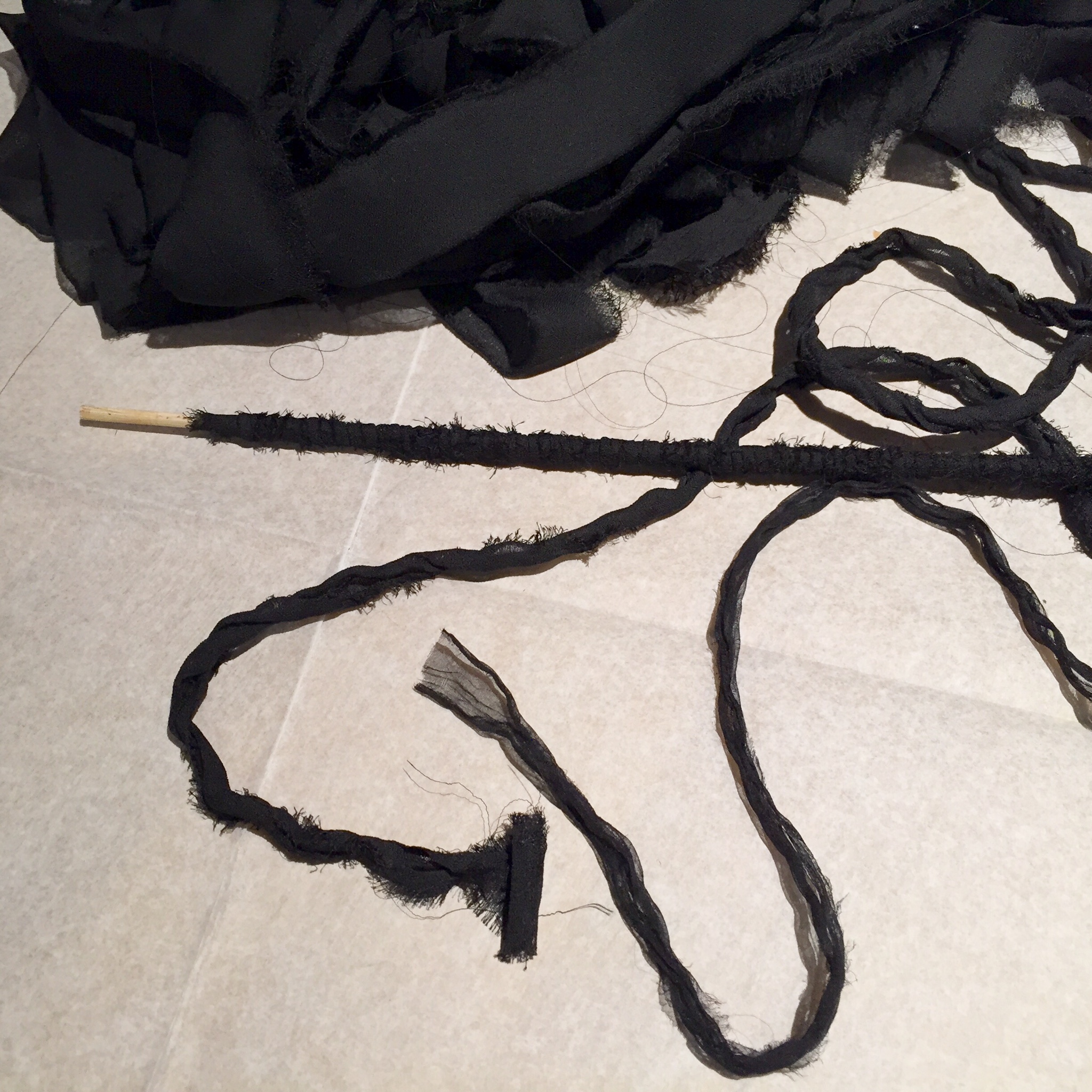

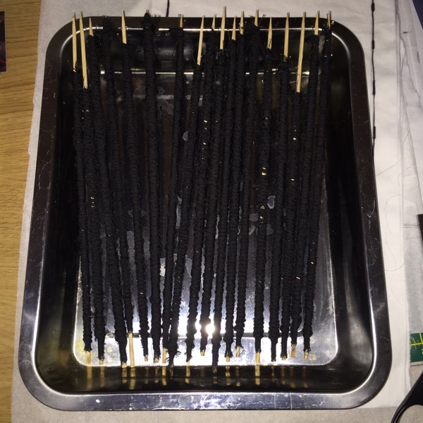

Furthermore I have been testing different styles for the tattered details on the sleeves and tail, with the below as a result.
I first twist the fabric quite tight, then wrap it around a skewer and then I wet it and dry it in the oven.
When taken off the skewer I straighten the fabric slightly. I will cut the ends in pointy triangular shapes.
The lower right piece is the silk chiffon and the rest is all crepe georgette.

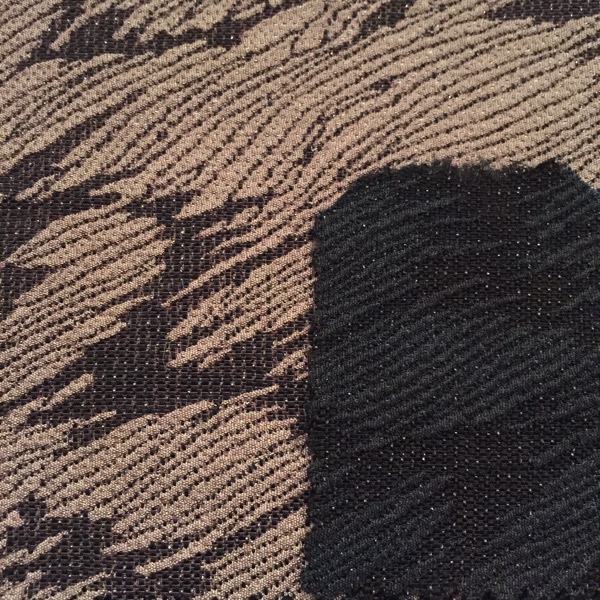

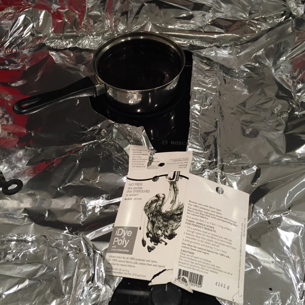

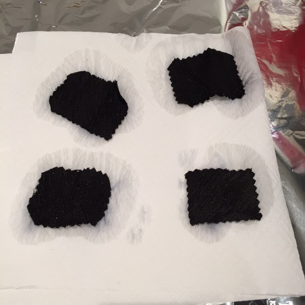

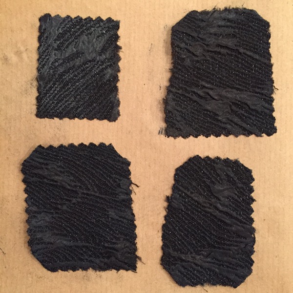

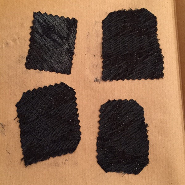

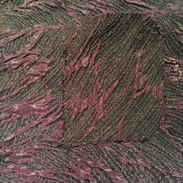

The fabric dye came in and so I could test what would happen. Unfortunately I can't create a nice two tone effect like the actual dress, however with this texture being small I think there would be too much going on if I did create two tones.
I did a 5, 20, 30 & 45 minutes test. I did the 5 purely because I saw how dark it was after 20 minutes. Though 5 minutes gave a stained result. I am going with 20 minutes. I used Black iDye Poly from Jacquard. It works well, however I think due to the small amount of water I used, it took long for the remains to wash out. Thankfully the lurex is still sparkling, as I didn't know what would happen to it. Depending on how it looks when you see a bigger piece of fabric, I think I will use the backside of the fabric.
I also created all polyester crepe georgette skewers as I did above and heat-set them in the oven (about 150 degrees Celsius) for about 1,5 hours. I tested the one I made earlier (heat-set on just below 100 degrees Celsius in the oven) and washed it under the tap with hot water. It held the shape very well.

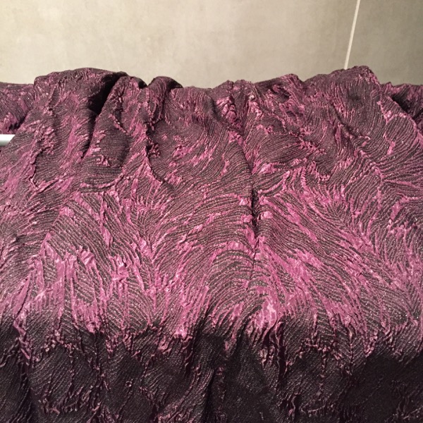

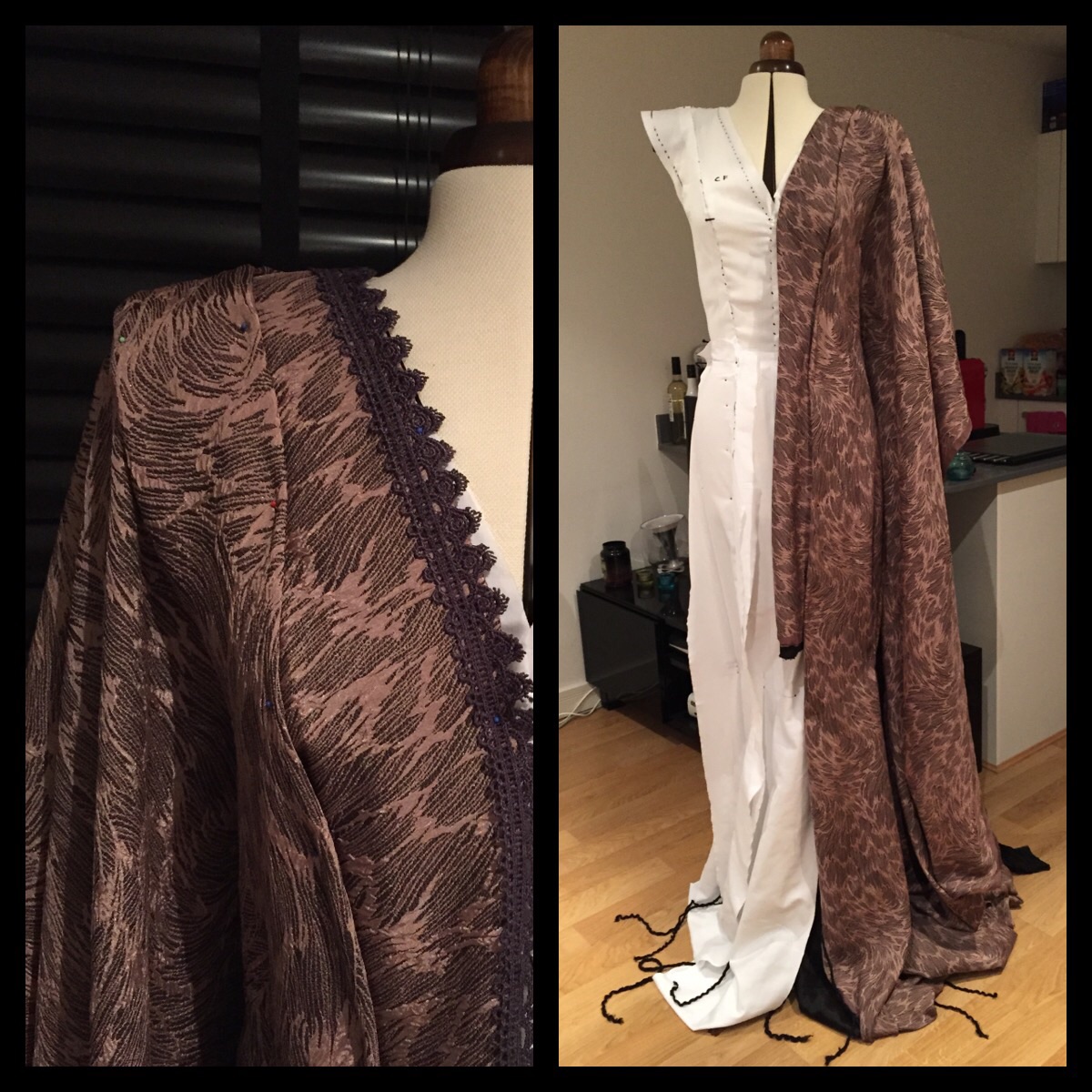

The fabric came in! I think I will actually use the right side of the fabric. Overall it gives a nicer look but maybe after dying I'll change my mind again. I did a quick drape on the dress form to get an idea. I put the lining under it all and added the tattered crepe georgette to see what the total picture would look like.
So now it's a matter of:
* test dye
* finish the pattern
* dye the fabric & lace
* sew!

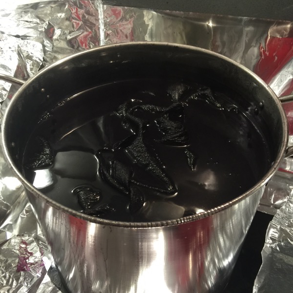

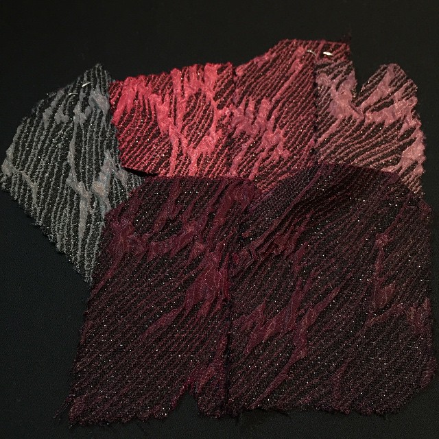

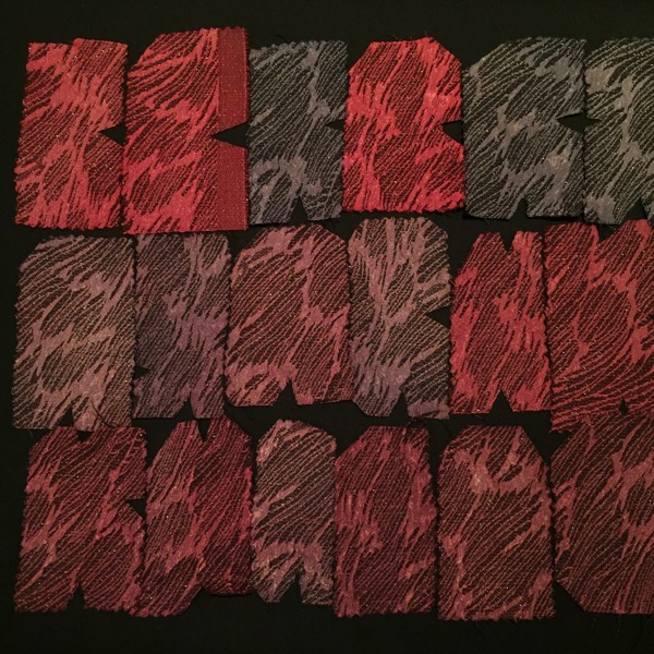

I did a test of 18 swatches with iDye Poly colours black & crimson. I first calculated how much dye and water I should use. The first test I used the whole dye pack which was far too much for a few swatches. I also used different timings, first one colour than the other and also a mix of both at the end. Some results are quite alike, some very different.
The darker layer of the fabric is actually black anyway, so it just dyes the lighter colour. Due to the weave it makes the black look more like a brown shade.
I will mix both colours in the dye bath as this gives a nice dark red colour to the lighter threads. The last 3 in the picture are done within 1 bath using both colours. I will mix some more black then red and dye it longer. When it dries up, the result becomes lighter than you think it will be. This is still too light..
I dyed the lace black with Dylon hand wash dye Velvet Black as well.

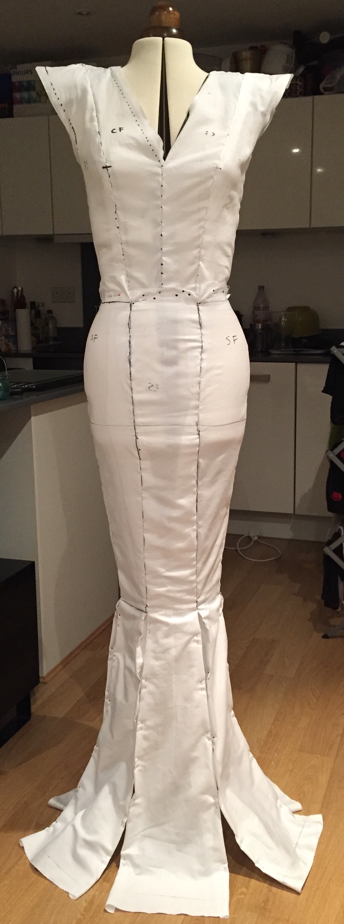

Nearly finished the pattern. I will adjust the neck line a bit, slightly lower (cut down to Venuzuela!) and curved rather than straight down from the shoulder. And I need to make the sleeves which I'll keep till I finish the top.
I didn't cut the excess, so mainly around the knees it pulls a bit.
Quite happy so far!

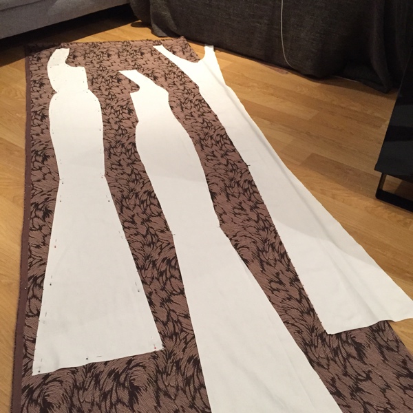

My knees are killing me after being on the floor all day. Took the day off to work on Morticia.

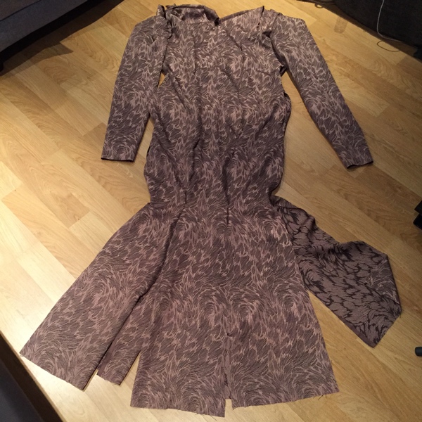

I redid the pattern with the bodice and dress attached with minor changes.
I cut the fabric with extra seam allowance in case the fabric does shrink when I dye it.
Only for the front I sorted out what piece of the design I wanted in the middle and for the back it will match in the centre seam.
I pinned it all together with safety pins for the dye bath so if there will be colour difference, it won't show much.
Looks very baggy I know :)

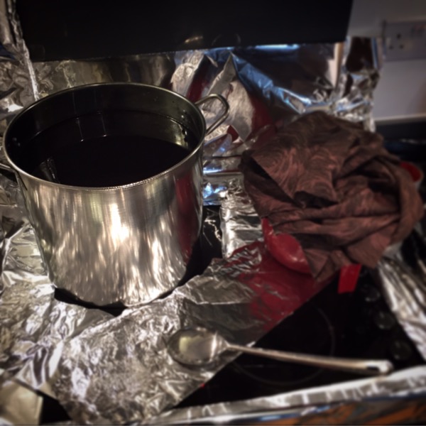

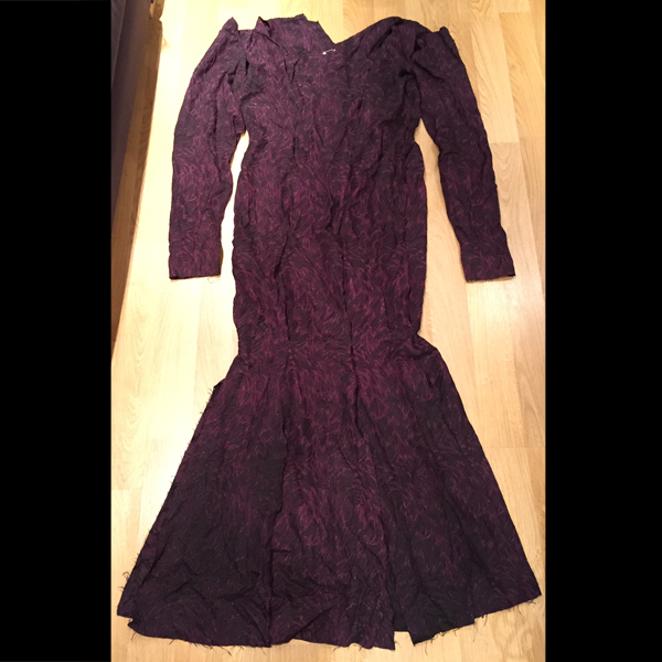

Not sure what went wrong but I guess it's quite a precise thing to get the same dye result again. I did measure the same as for the sample.
Turned out a bit too light and too purple. The light makes it look different. I'll first sew the shell and then dye it again with just some black and the left over crimson.
The dye did leave some spots, which are accumulated bits of the dye and will come out by washing it. So after the last dye I will machine was it, to make sure all excess dye is gone.

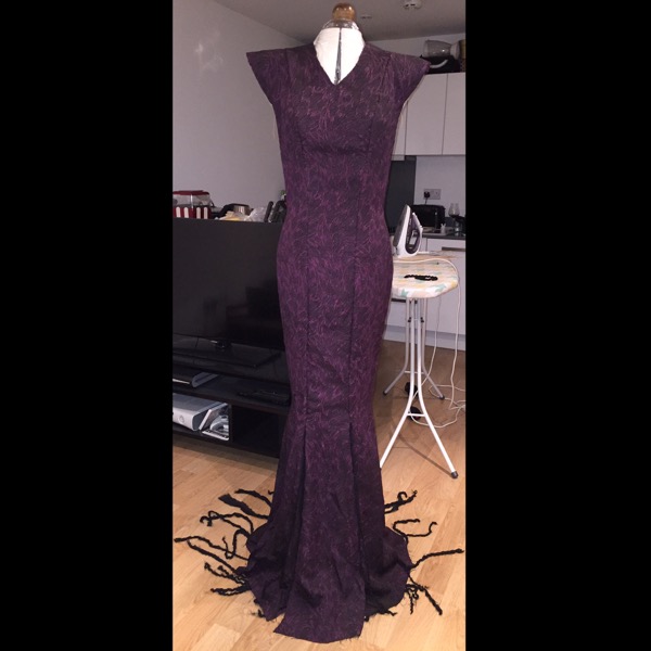

Re: Morticia Addams - Addams Family WIP

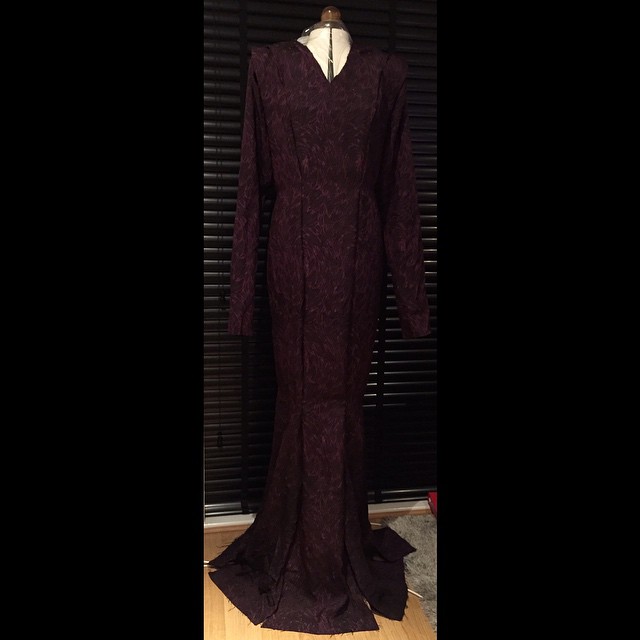

Not an update. Just a quick pic after I ironed and pinned it, thrown onto the dress form. Saturday I will trace the actual pattern onto the fabric and sew the shell together. And with a bit of luck I can dye the dress slightly darker with a bit more of hint of crimson as well.
I'm slightly doubting to leave the tail end unfinished, like the sleeve ends. I quite like the fraying detail.

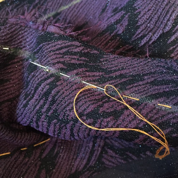

Basted together. Not happy with the bust area as it's a bit saggy, so I will redo that before sewing on the machine.
I also made the inside layer of black georgette to cover the legs when the dress opens as you walk. For the 'hem' of this layer I created the same effect as before with wrapping the fabric around skewers.
I will add the loose ones in between the slits so the move when you walk (same as in the movie).

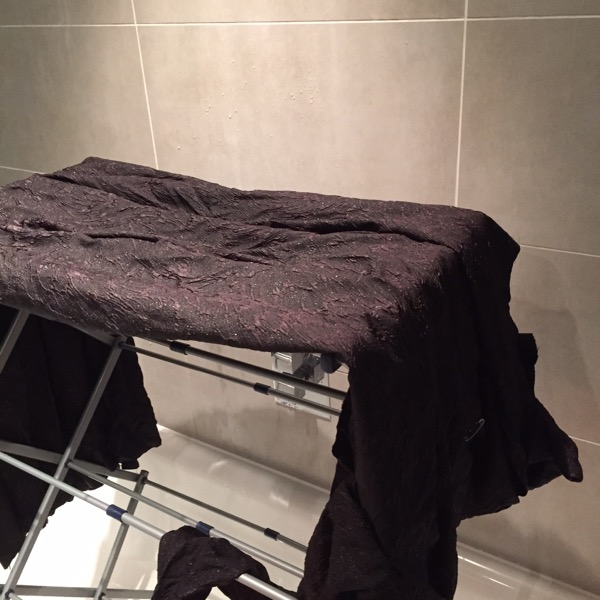

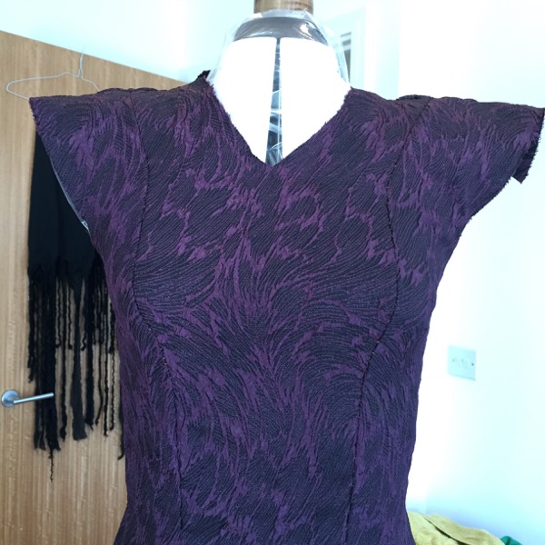

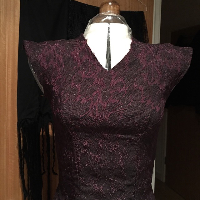

I redid the middle part from the bodice and it looks much better.

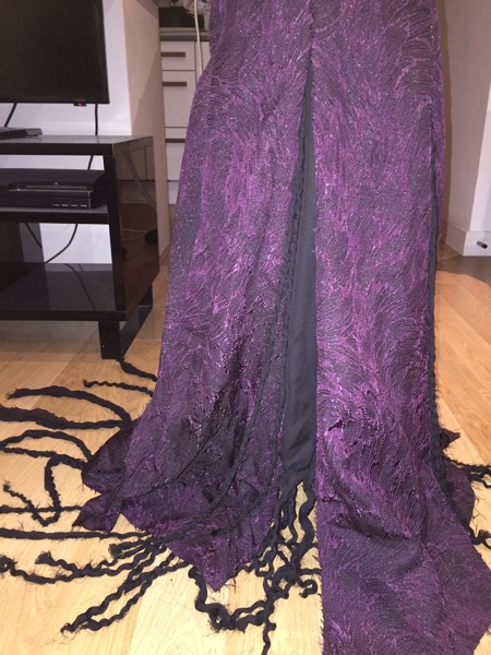

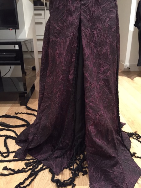

Dying did work as good as I hoped for. I am not sure what the problem was. I think it wasn't got enough so after washing and drying I dyed it again. It became slightly darker, but still not as dark. However I will leave it like it is.
I sewed the dress except the sleeves, shoulders and back. I tried to wash out some staines. Feels like I am waisting a lot of time on washing and drying.
Before (very bright) After
