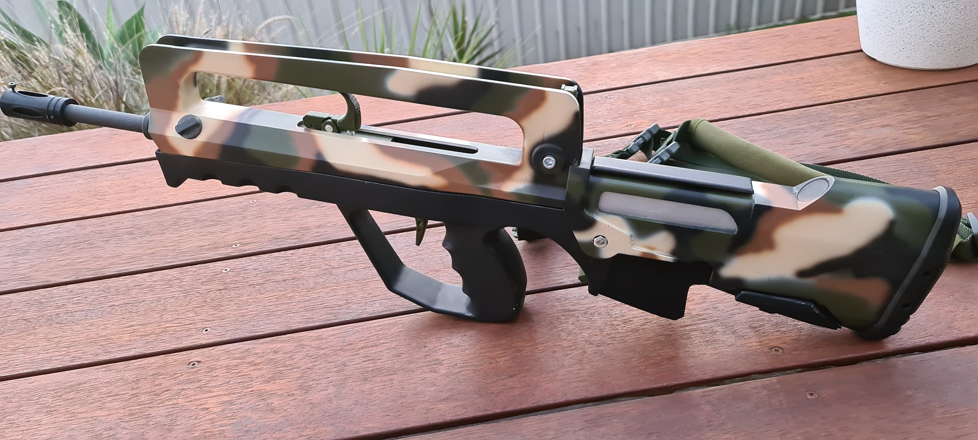

Having discovered gelblasters recently (like airsoft but with soft gel balls - orbees). I have been building custom blasters, as the types you can get are quite limited.
Here is a FAMAS G2 I designed and use out at events

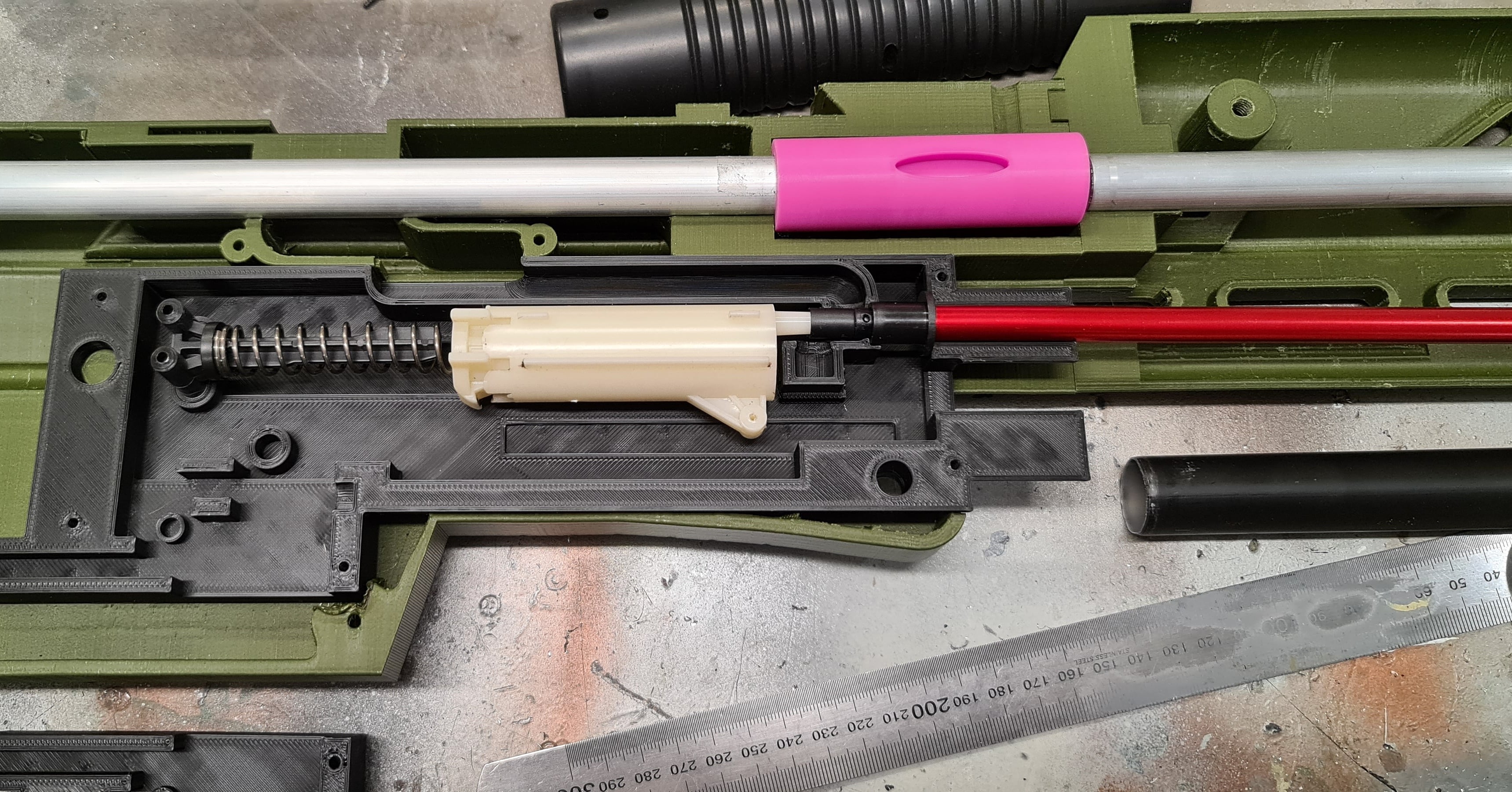

Instead of making a static prop of one I thought id base it on a gelblaster shotgun and electric gearbox.

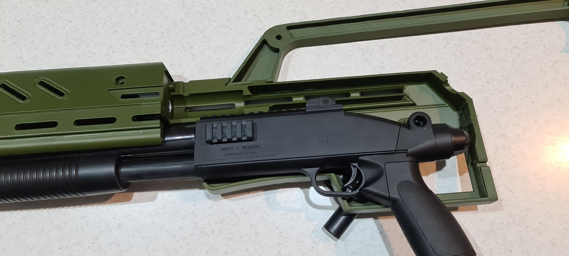

This is the shotgun i picked up for it.

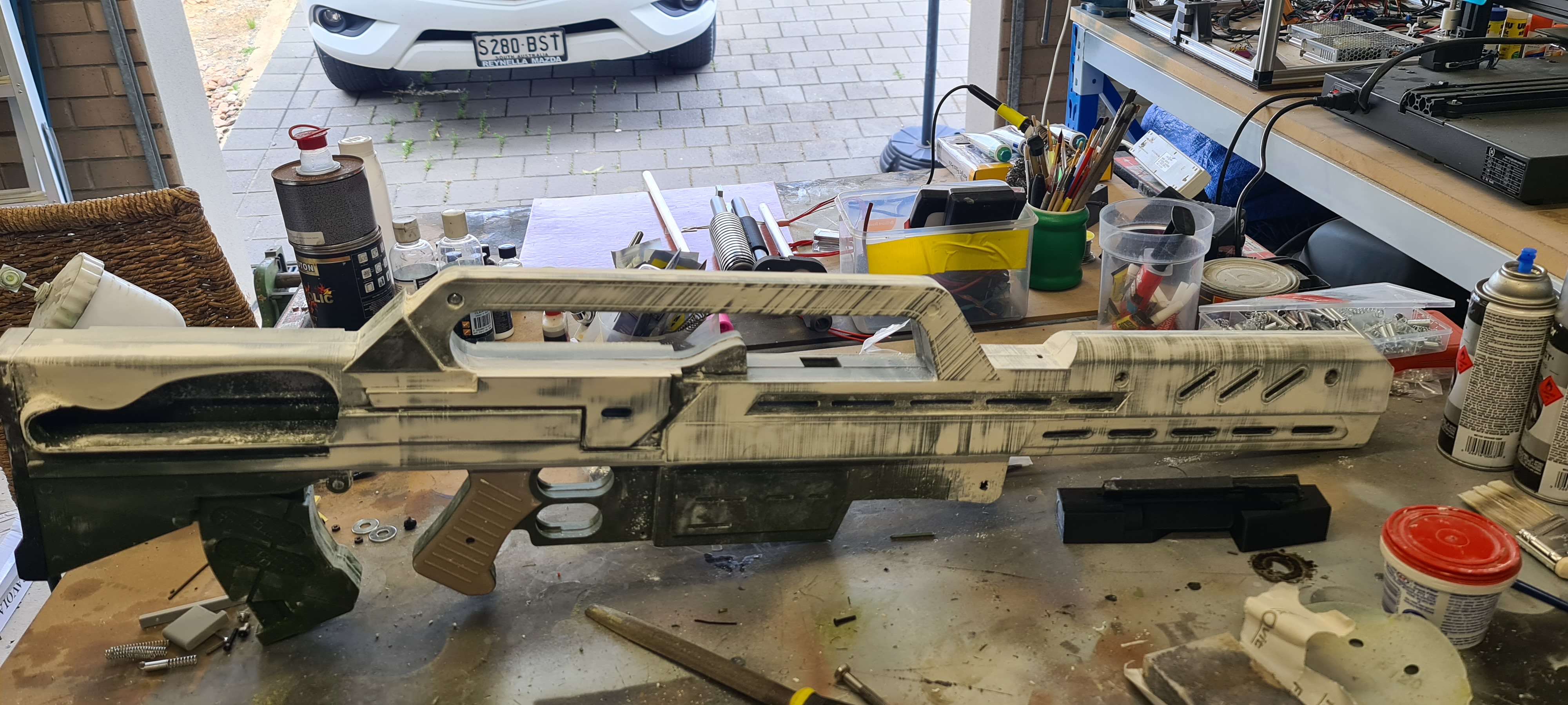

Well how things change. Our police department has just outlawed gel blasters in our State and they now require a gun licence and gun safe to own one. Ok......so i dont have a gun safe or license and not wanting to scrap this build, i went back to the deaign and redid the reciever and shotgun to be static only.

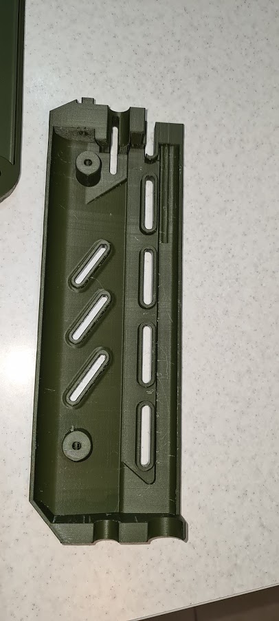

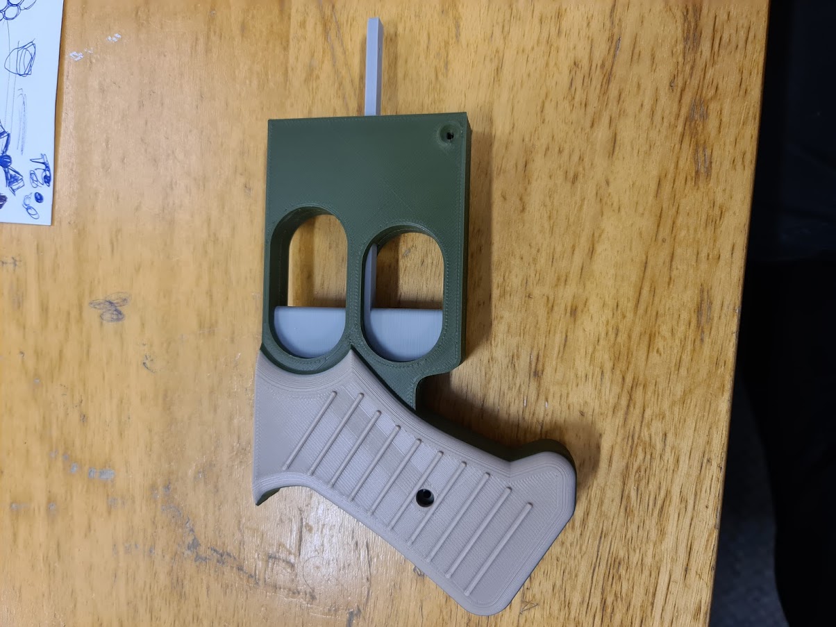

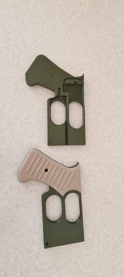

Designed up the ruger 14 reciever and printed out.
Reprinted the reciever, bolted and glued all the parts together. Temp bolt up of the halves for first round of post processing .
