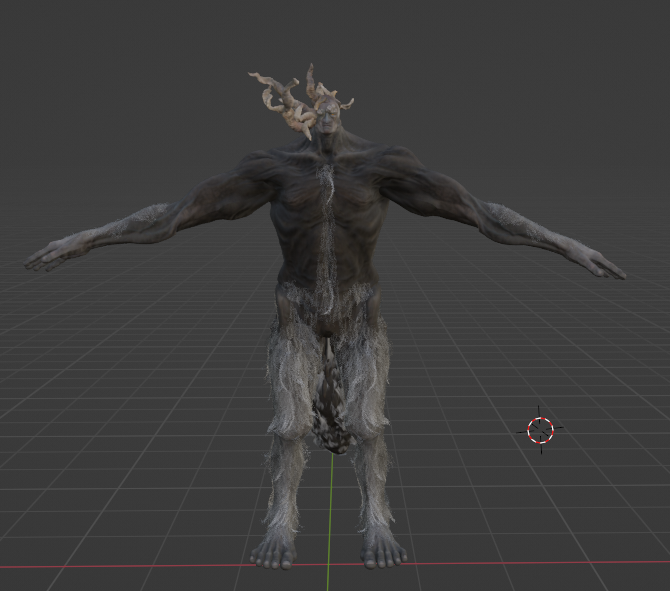

And this is what the in-game model's face looks like in blender with all the hair geometry removed:

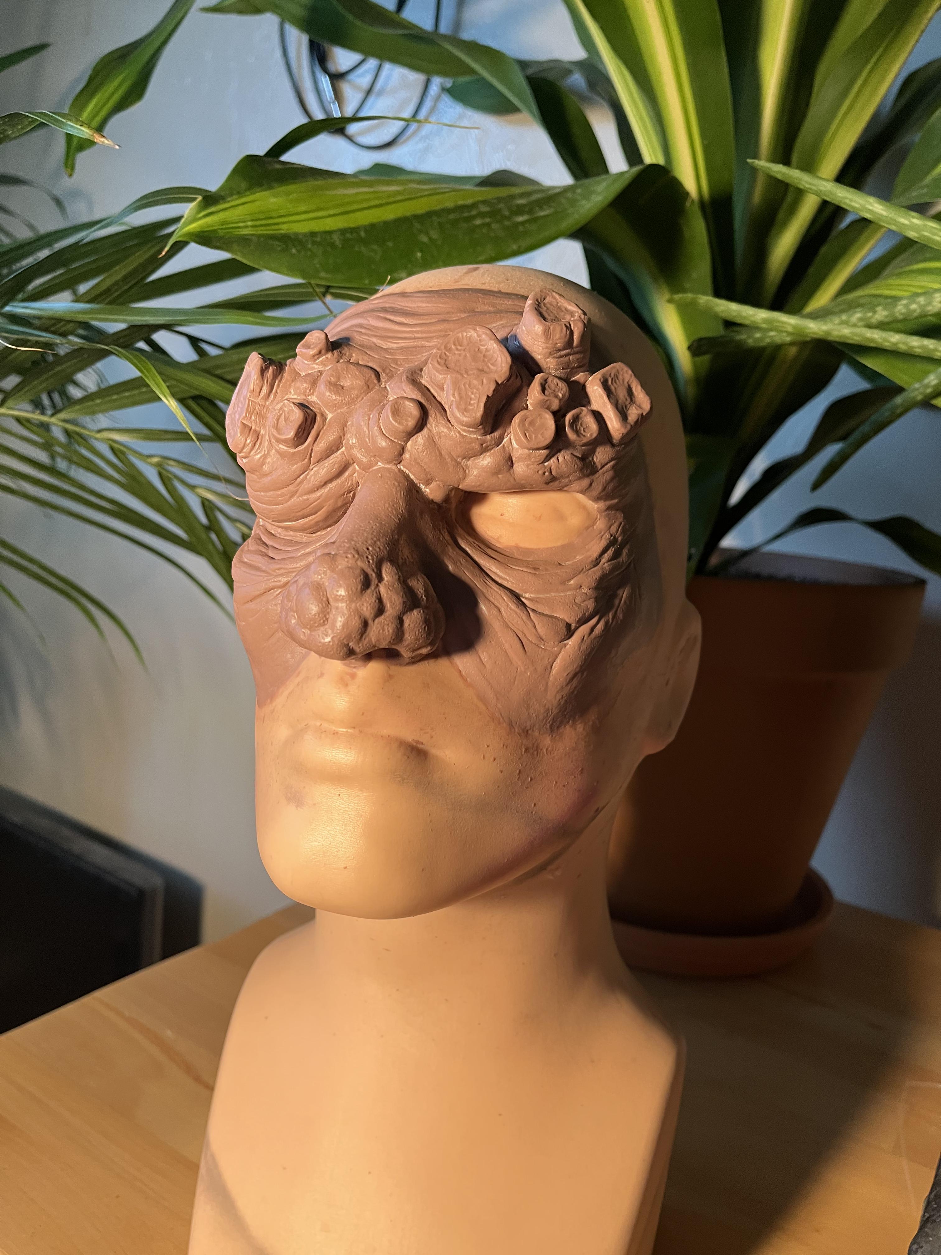

So ultimately, I figured the best course of action was to make a mask that only covered about 1/2 to 2/3 of the face to allow for the placement of ventilated facial hair on swiss lace on the lower cheeks. This was also going to be more helpful when it came to fitting as I don't have a life-cast of my face. I actually sculpt on a very generic facial armature, and I was worried about maintaining facial proportions that would still fit me if I ended up sculpting a prosthetic that extended to the lips.
Started blocking out the shape with monster clay, and just refined the form more and more adding details as I went.
This was the final sculpt:
