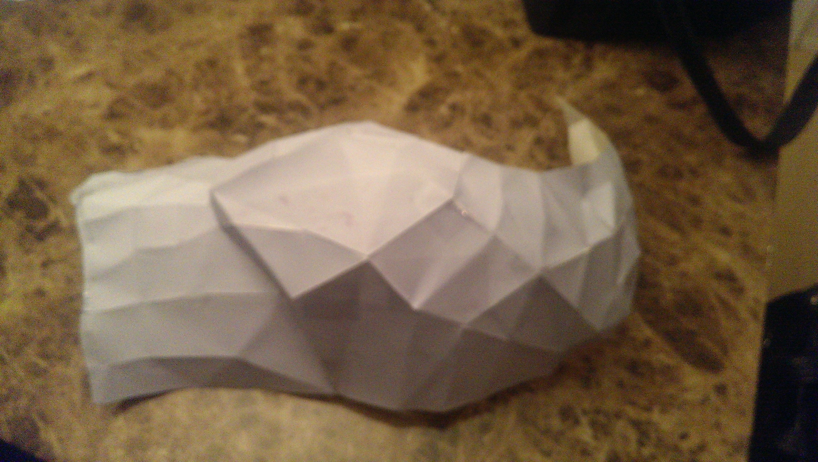

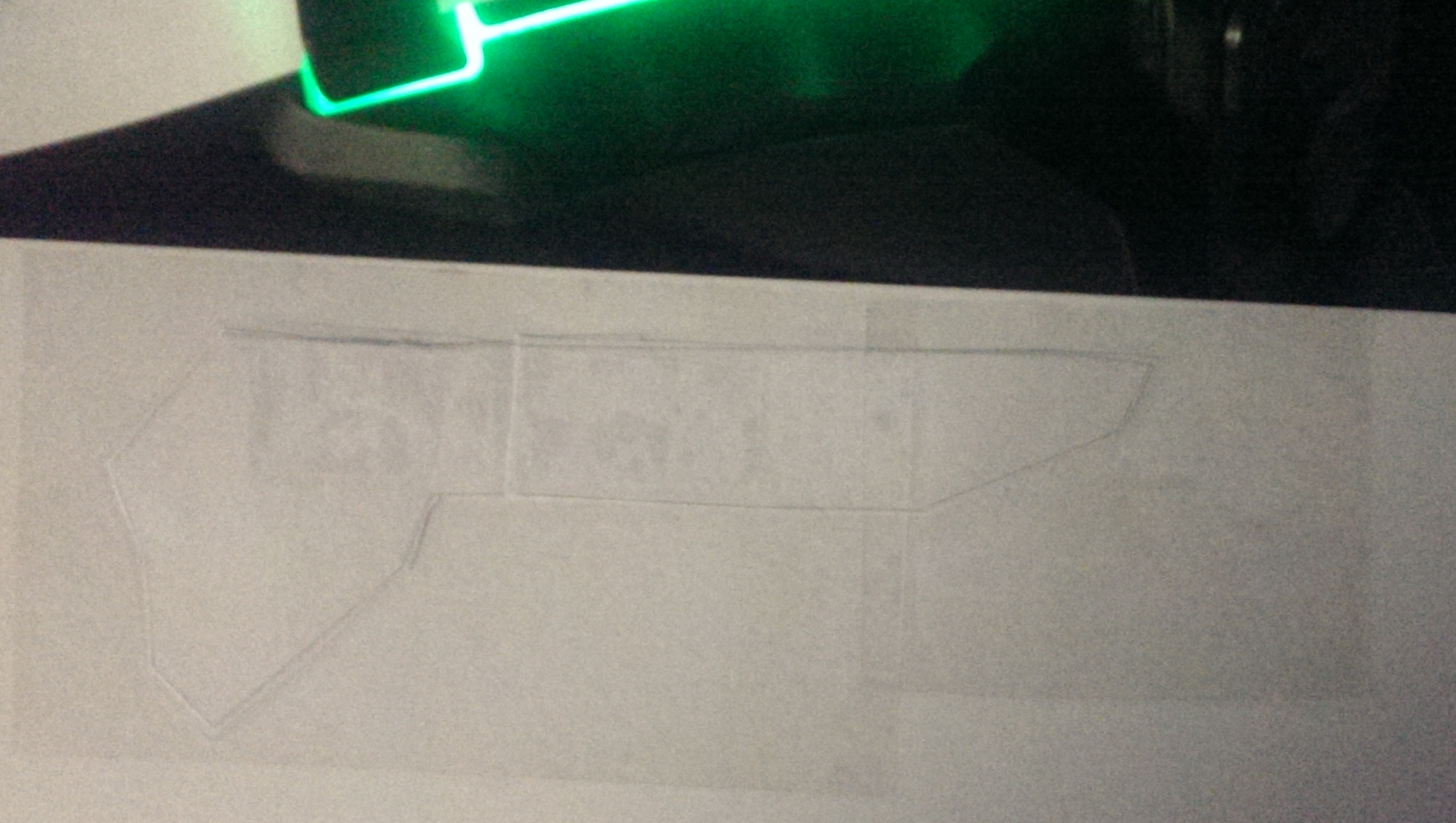

I have now begun the arduous task of assembling the chest armor out of PEP and transferring it to card stock in order to be coated in resin for the mold.

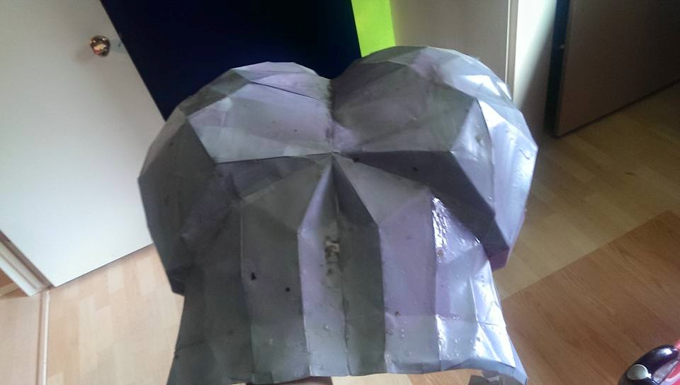

After a few failed attempts. I'm finally making headway with the Pep armor. I should be finished the back of it by the end of today.

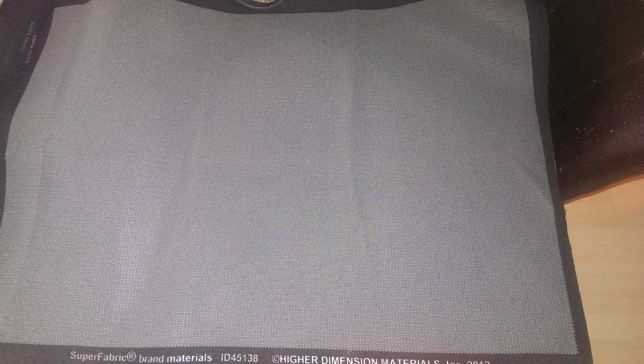

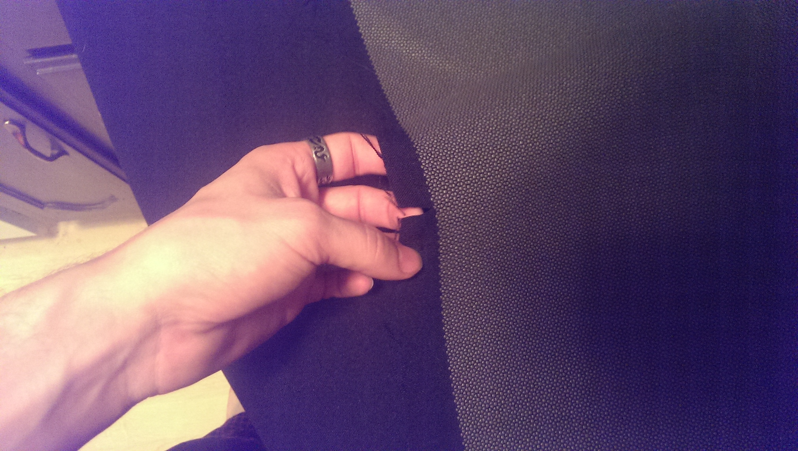

The Superfabric came today, and HOLY ****. I was expecting a few sheets of it maybe a square foot's worth. I got considerably more. First picture is just a close up of one of the sheets. The fabric itself is very heavy duty fabric, stretchy enough to bend and flex, but heavy duty. Surprisingly soft as well, so against the skin it would not cause any irritation.
I tried to cut just the fabric itself with a sharp kitchen knife. To no avail. Scissors were needed to cut through the actual fabric, but once it reached the ceramic plates it was all but impossible. My actual high end kitchen shears cut through the ceramic plates, but those are meant to cut through bone so I'm not surprised. I used a really sharp knife and tried to cut through the plates. It did not go through at all. I tried to stab it as well and it did not go through. Below are pictures.
These are just the samples they sent me. There are lots of different patterns, colours and density of the ceramic plates. They even advertise some that are so small and so closely packed that a hypodermic needle can't penetrate it. I feel as though that would make it difficult to sew through so I wouldn't recommend that at all. With how much they sent me in the sample, I don't even think I need to order any to sew into the costume as I'm only using it for a few areas, but I will buy some in the future. This stuff is amazing.

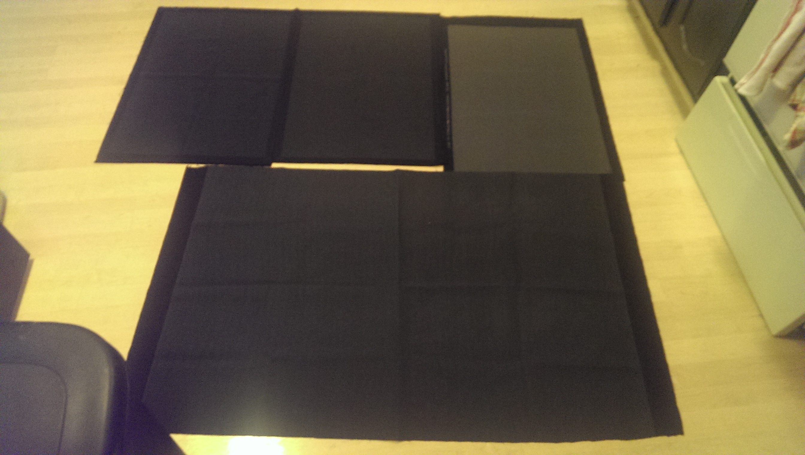

The yards of Cordura I ordered came in today. That stuff is fantastic. Based on my estimates I should have enough for 3 costumes, which means tons of room for trial and error.

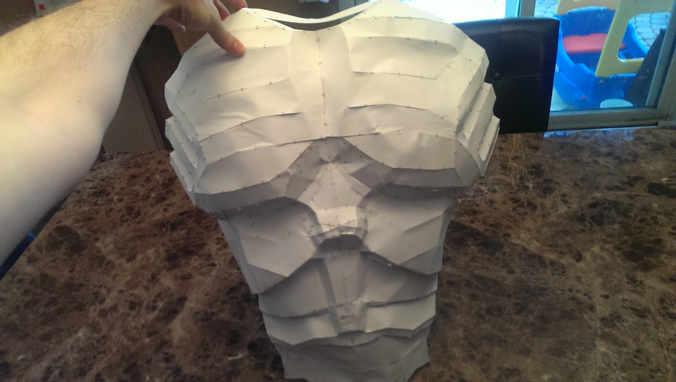

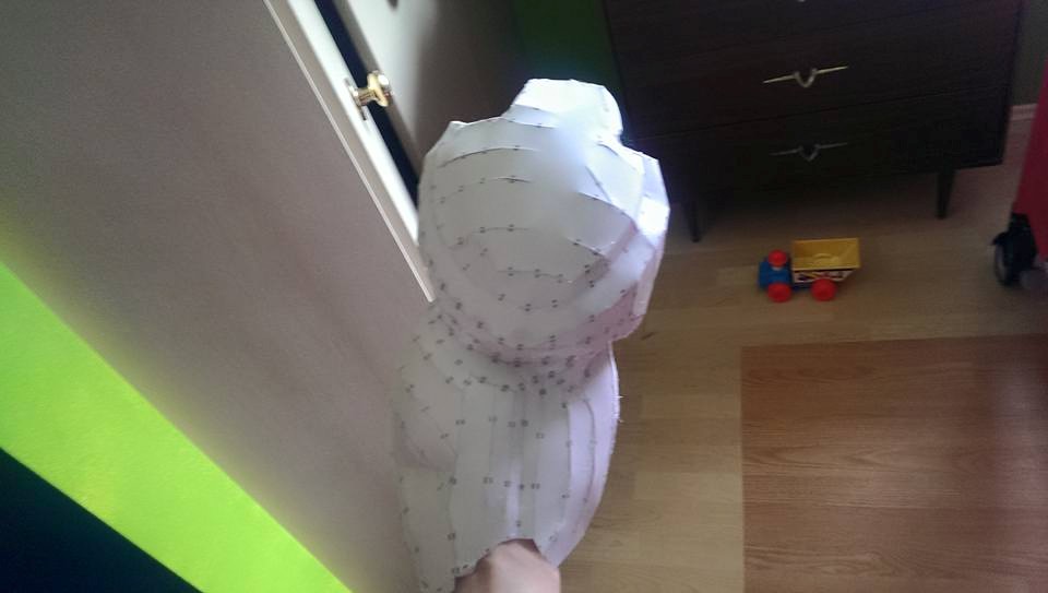

Front chest piece finished in CardStock. It's going to be altered once it's been resined and bondo'd up to make it my own. I used the Desert Storm Batman Pep files since they were fairly close to what I wanted to do.
Some more pieces have been finished and I'm making good progress. Some of my resin went bad and I only noticed after I started coating the piece so I have to coat it again, but other than that it's going well.
