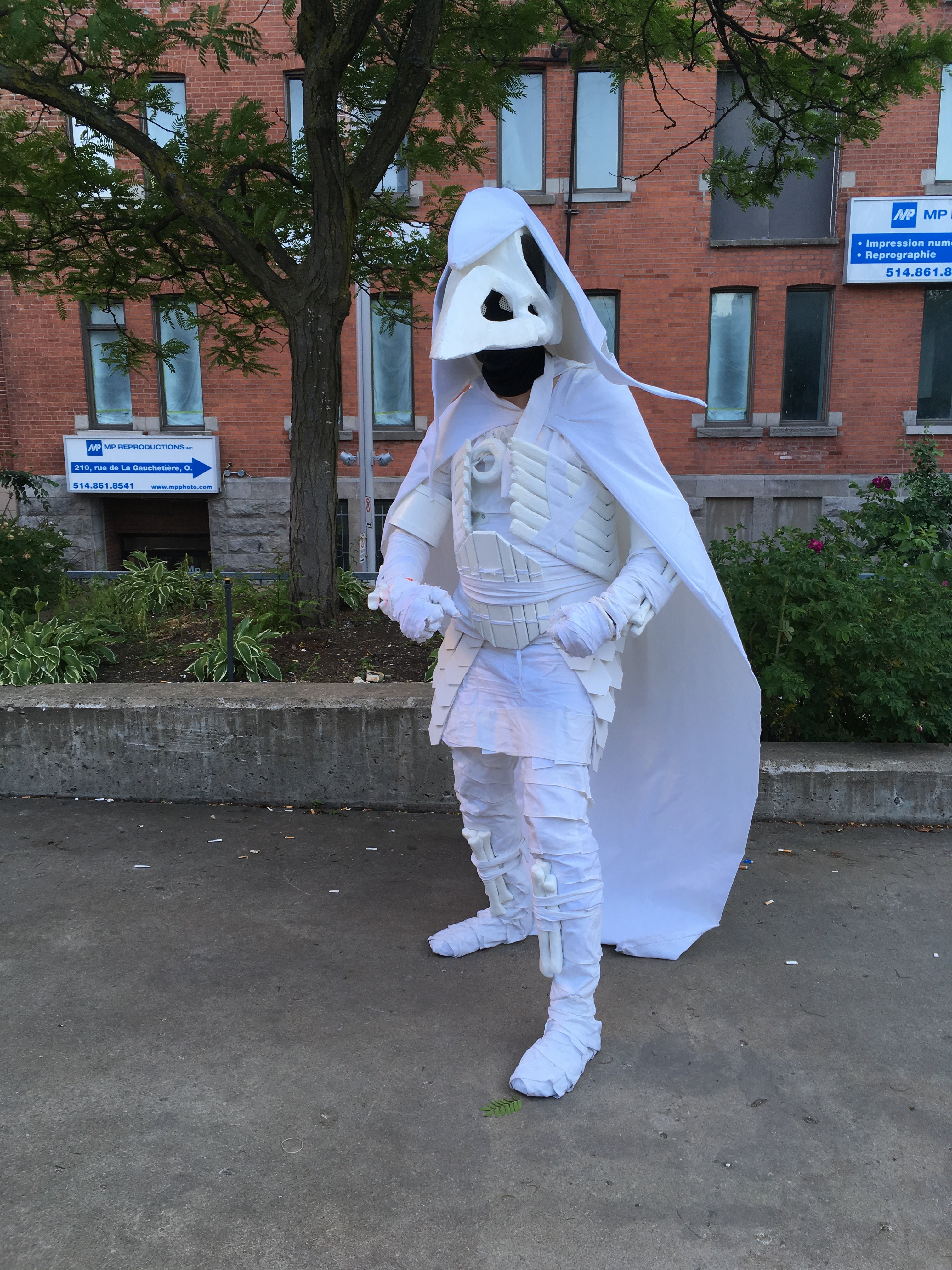

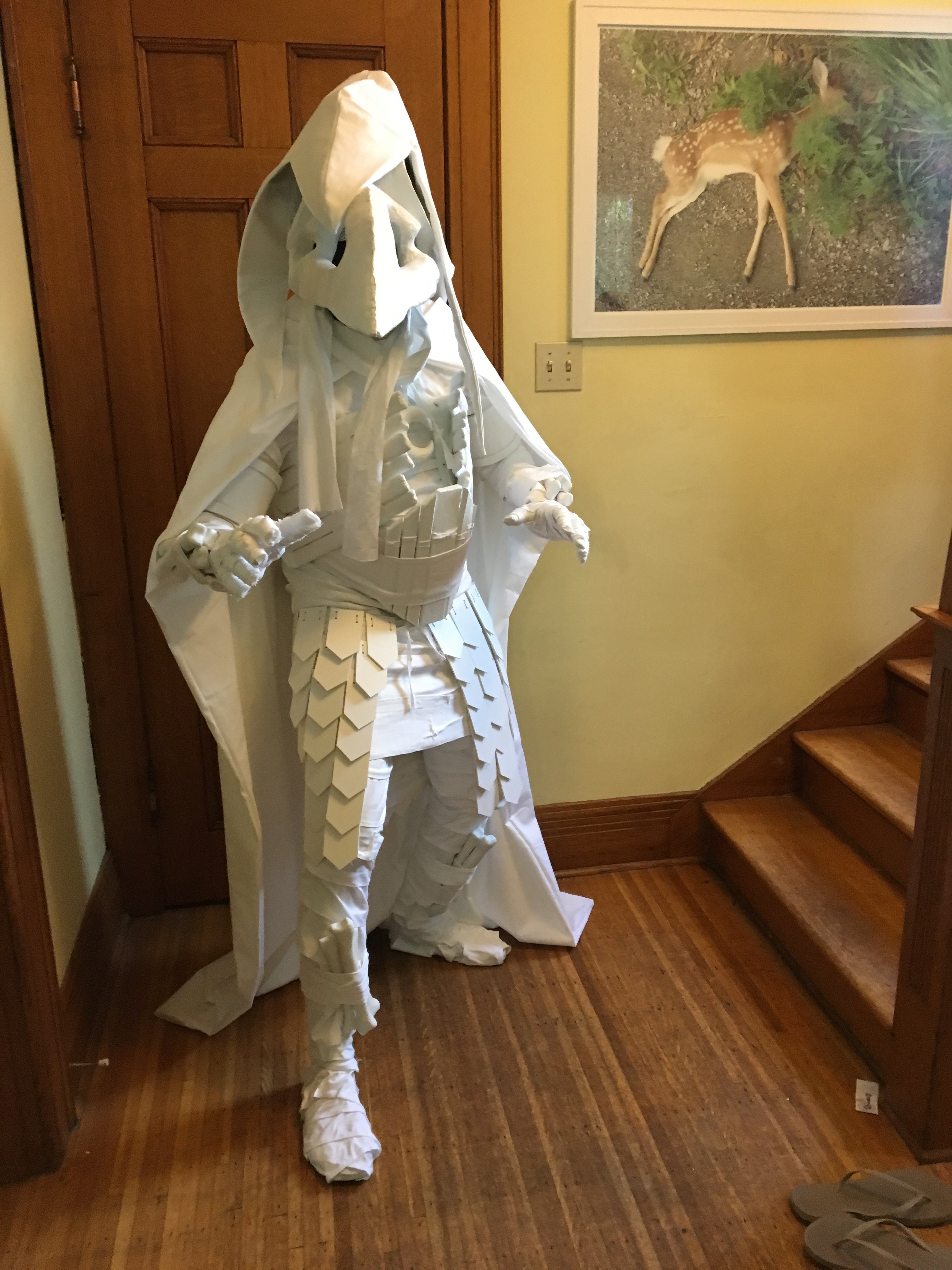

I created a cosplay of Moon Knight, wearing his “magic Egyptian armor” as seen in the 2014 volume of Moon Knight, issue 3.

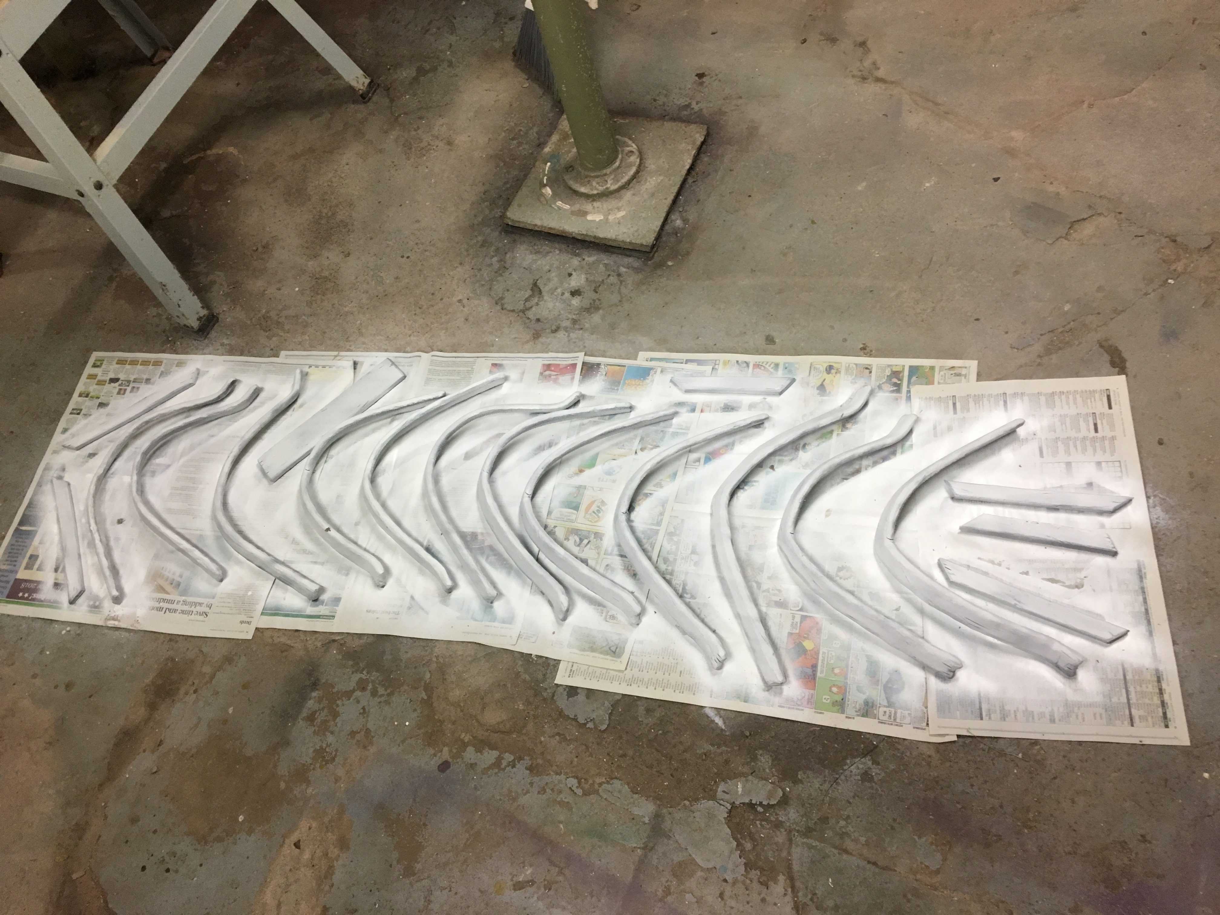

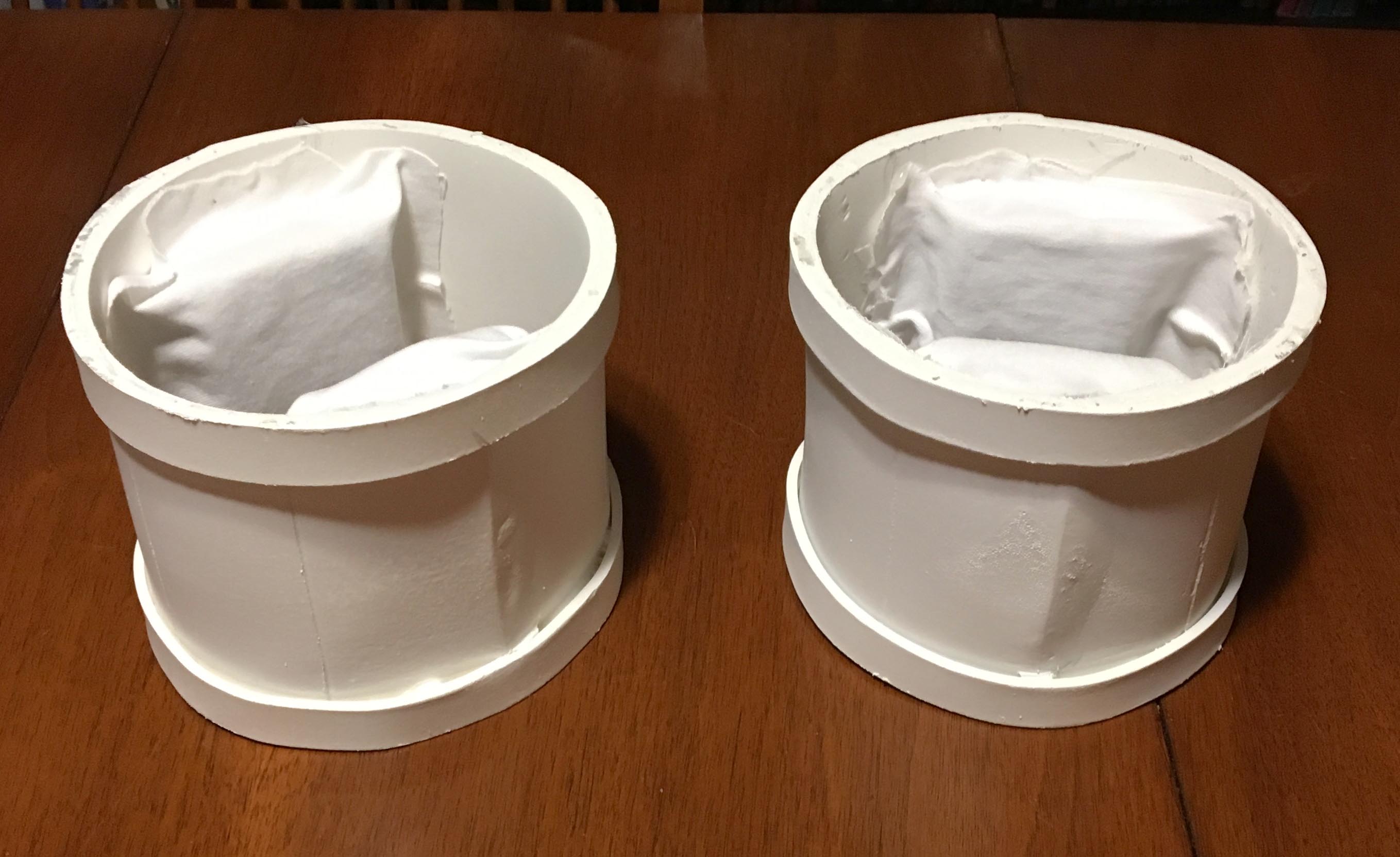

Bicep rings. These are made of heat-bent Sintra. I used a Dremel to make the vertical score lines. They ended up being slightly too large, so I padded them by gluing some foam, covered by the same fabric used in the rest of the costume, inside. They’re spray painted. The Sintra color was fine, but I needed to fix some bumps and holes with Bondo, so I painted them.
Forearm and calf bones, and wraps. He has a set of three humerus-style bones strapped onto each of his forearms and calves. These bones are clearly too small for human bones, so I decided to just sculpt them myself instead of trying to exactly replicate some real kind of bone. I used a single sheet of insulation foam and cut out a basic bone shape using a bandsaw. Then I sculpted them using a Dremel, and sanded them. Then I coated them with multiple layers of glue, then spray rubber dip, and finally spray paint. This is the priming/painting process I used throughout the costume unless otherwise noted. The use of both glue and rubber dip is because I have found that spray rubber dip and SOME spray paints will chemically eat away at insulation foam, leaving a hugely pitted surface. The glue protects the foam from the spray dip or spray paint. I also like using both glue and rubber dip in order to not only make it smoother, but also stronger. My experience so far is that with multiple coats of both, the insulation foam does not break or get indentations as long as it is not actively smacked around.
Seen with black rubber dip, below:

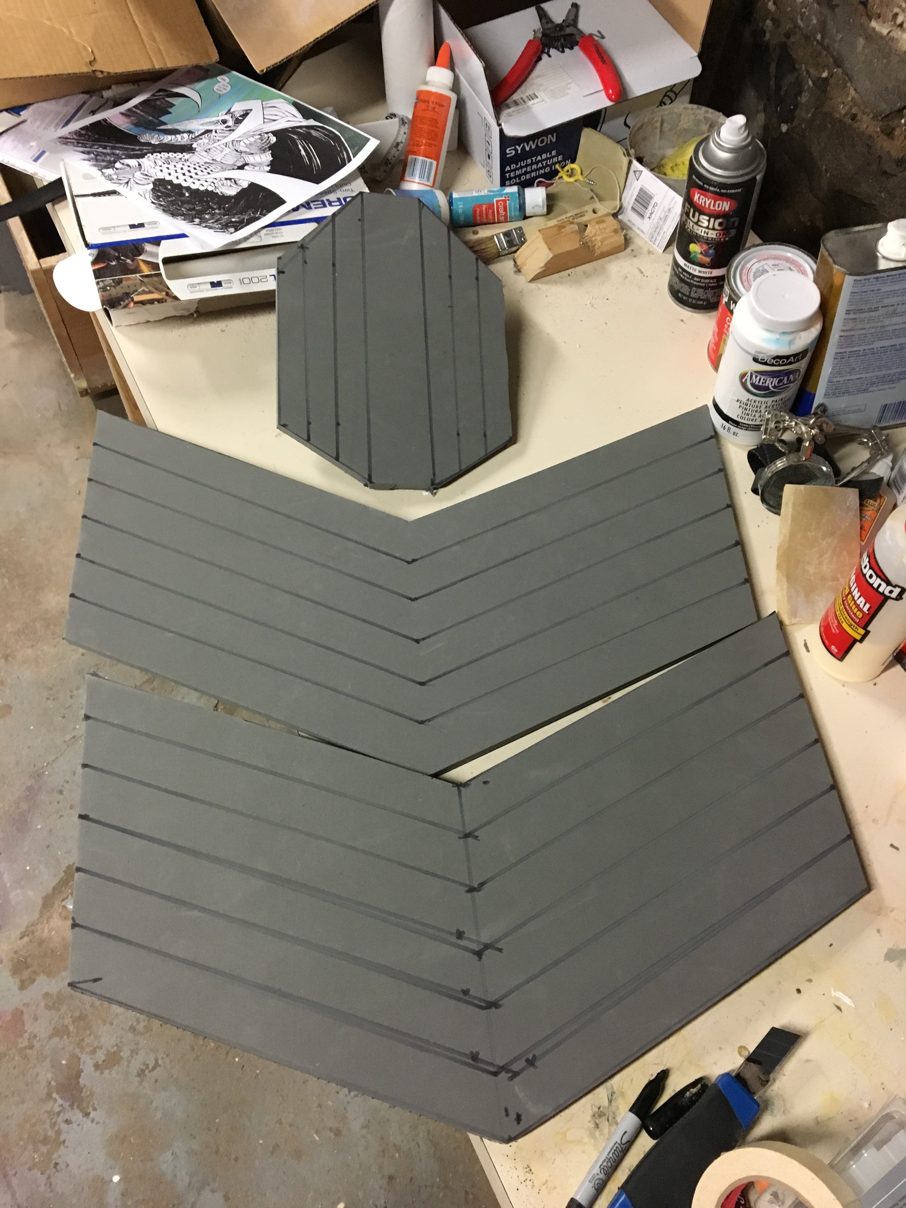

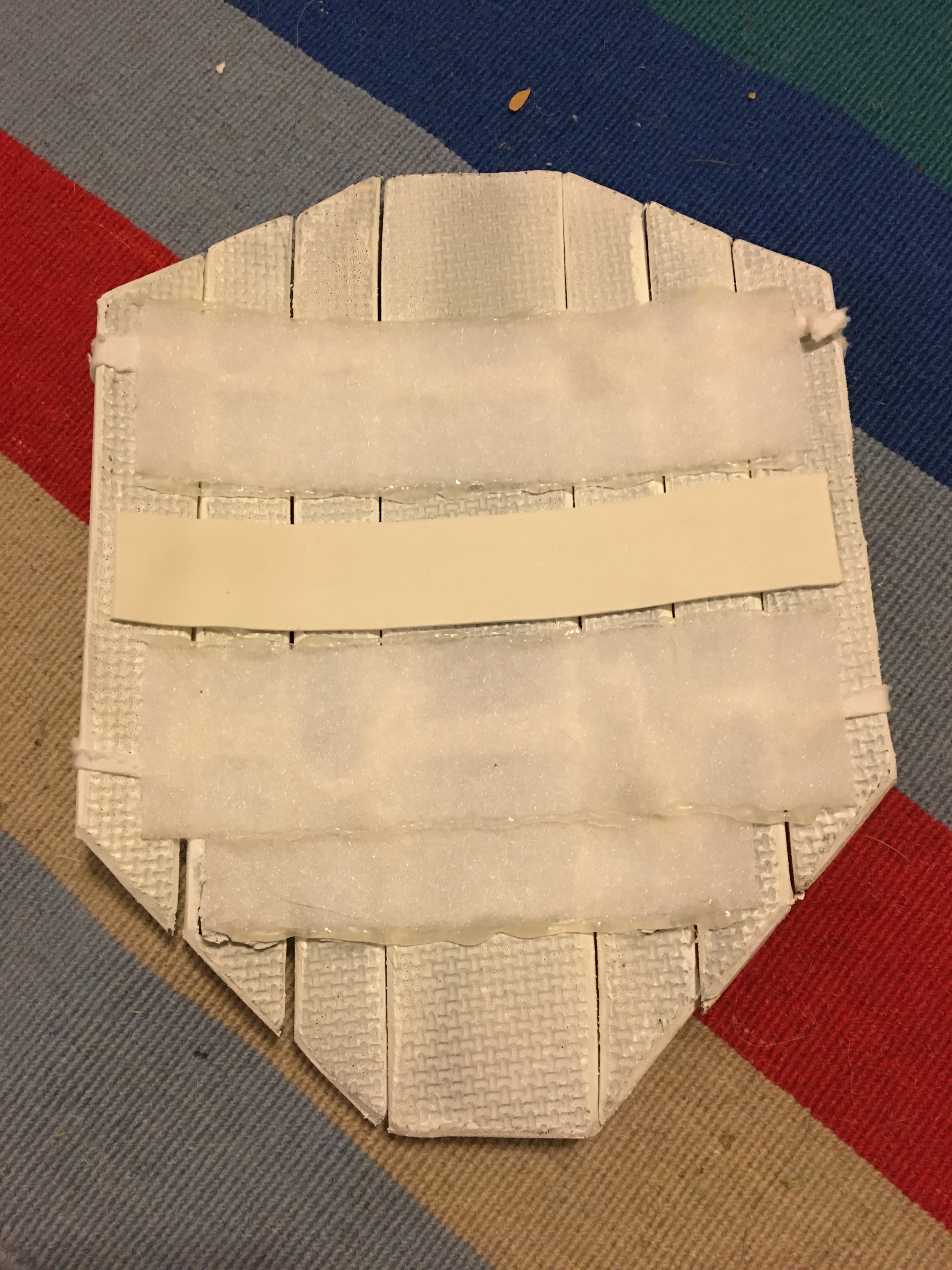

Rib armor. These are made of floor mat foam (one layer). I cut them out individually, shaped them with a dremel, and glued/rubber dipped them as above, although in this case I hand-painted them with acrylics instead of spray paint since the ribs bend while being worn, and I didn’t want the paint to crack. This seemed to work, I haven’t hand-painted flexible foam before.
Then I attached them to each other at the back using a craftfoam hinge that’s glued on the inside. (This is not visible in general, but especially because of the cape.) They are then tied together using a couple fabric straps, as seen in the costume. But then I also put some more craftfoam strips glued on the inside to really hold them firm. The tips are heat-bent outward slightly to mimic the drawing, although perhaps a bit more than they need to be. I attached them to the shirt with Velcro; it is now pulling off the back of the foam so that needs to be fixed, but generally speaking it worked. I have added more Velcro to better fix the curve over multiple wearings. I was shockingly happy with how they came out, I have not used floor-mat foam much.
Front and then back:

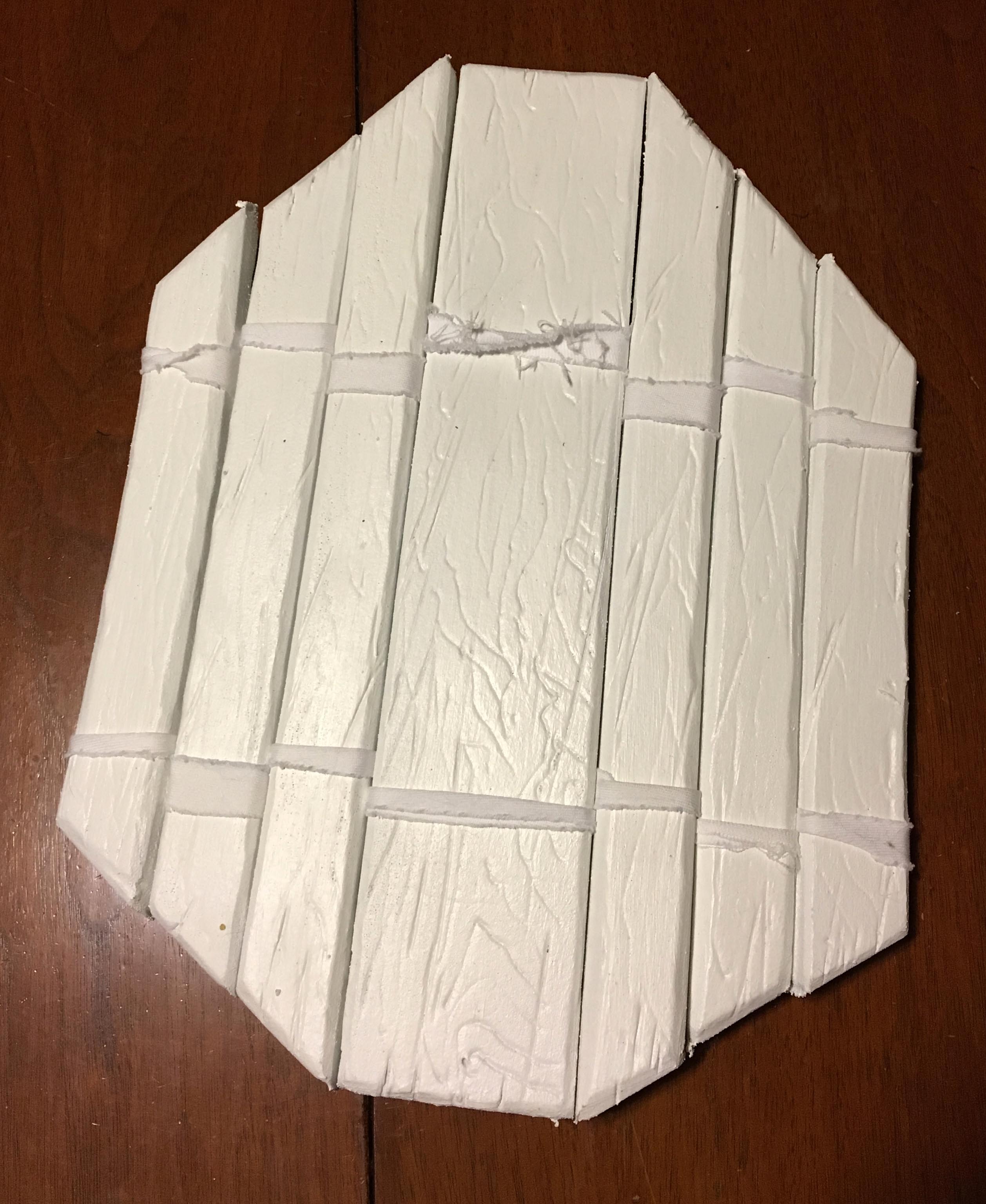

Abdomen armor. The same as above—floor mat foam, hand-painted—but this is supposed to be wood, so I carved wood grain into it. It attaches to the costume via Velcro (which worked fine here), but it is also held in place with the belt.

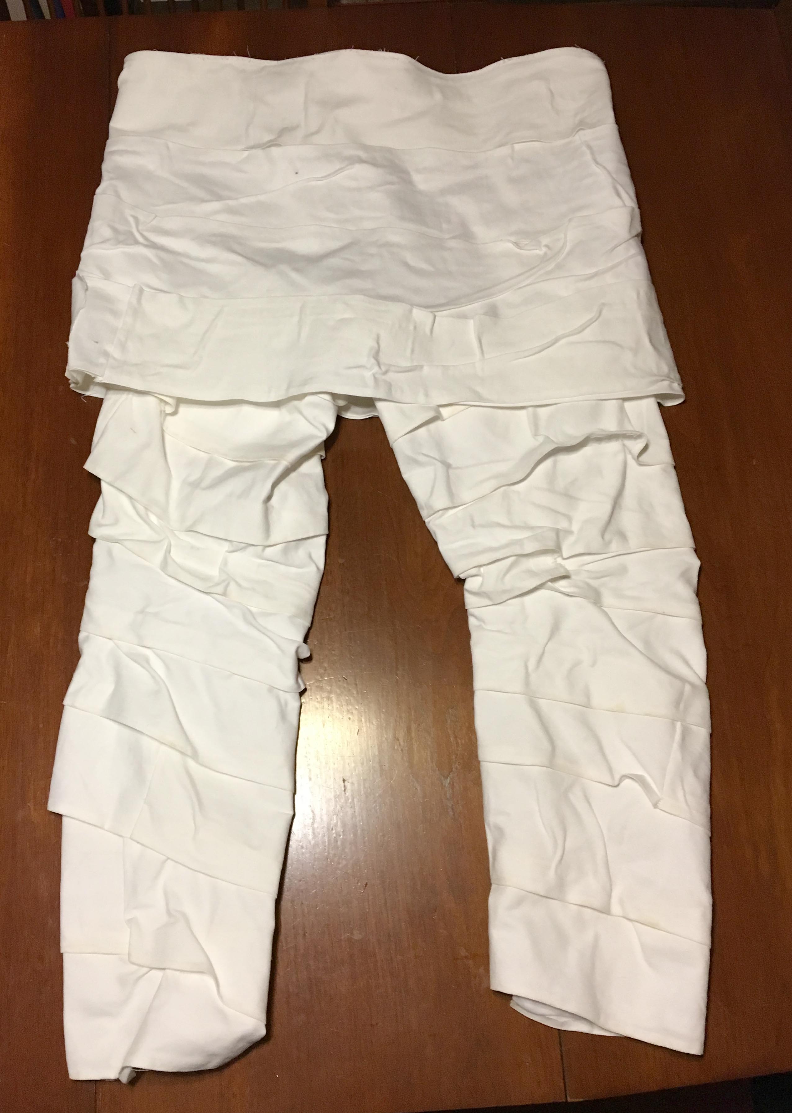

Pants and “under-skirt.” I made these separately and eventually decided to attach them (at my wife’s advice) by sewing them at the top. I used a pajama pattern for the pants that I have used before, using some white stretch fabric. Then I covered it with white strips, which are glued to the pants. I wasn’t quite sure how to do this; I ended up just putting on the pants and glued the strips on while I was wearing them, and let them dry before taking the pants off. The strips, incidentally, have the edges wrapped over and glued down so the edges are clean, not ragged. I didn’t both putting strips over crotch, so as to retain my mobility; that area is covered by the under-skirt and is not visible.
The underskirt is also made of fabric, and then has strips glued on top. It is sewn to the pants at the top. The whole thing is held up by belt-loops which are sewn into the pants. I put the (real) belt in through the loops while the skirt is pulled up over my belly, then pull the skirt down over the belt, so you can’t see it at all. It works very well to hold it up.

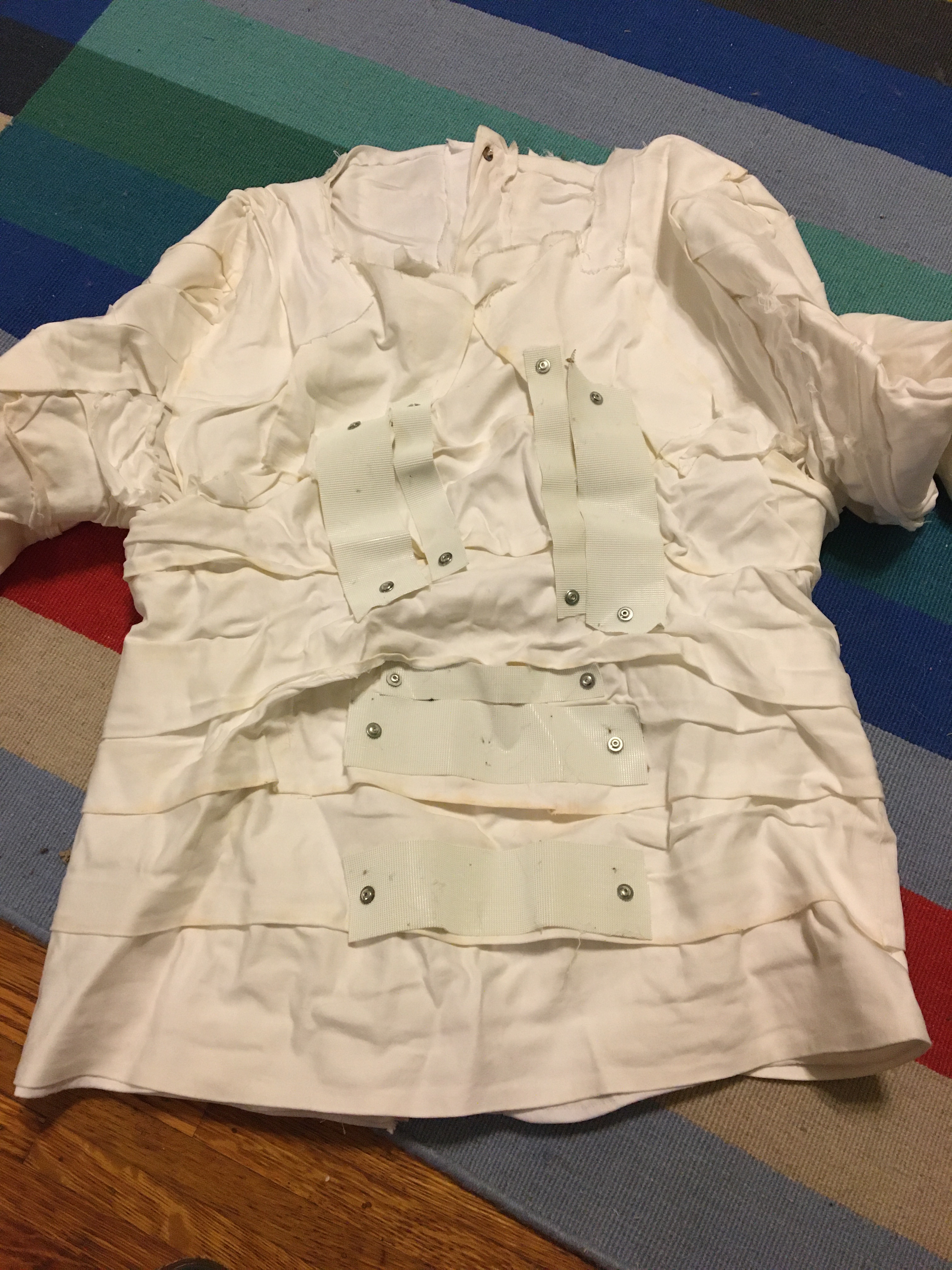

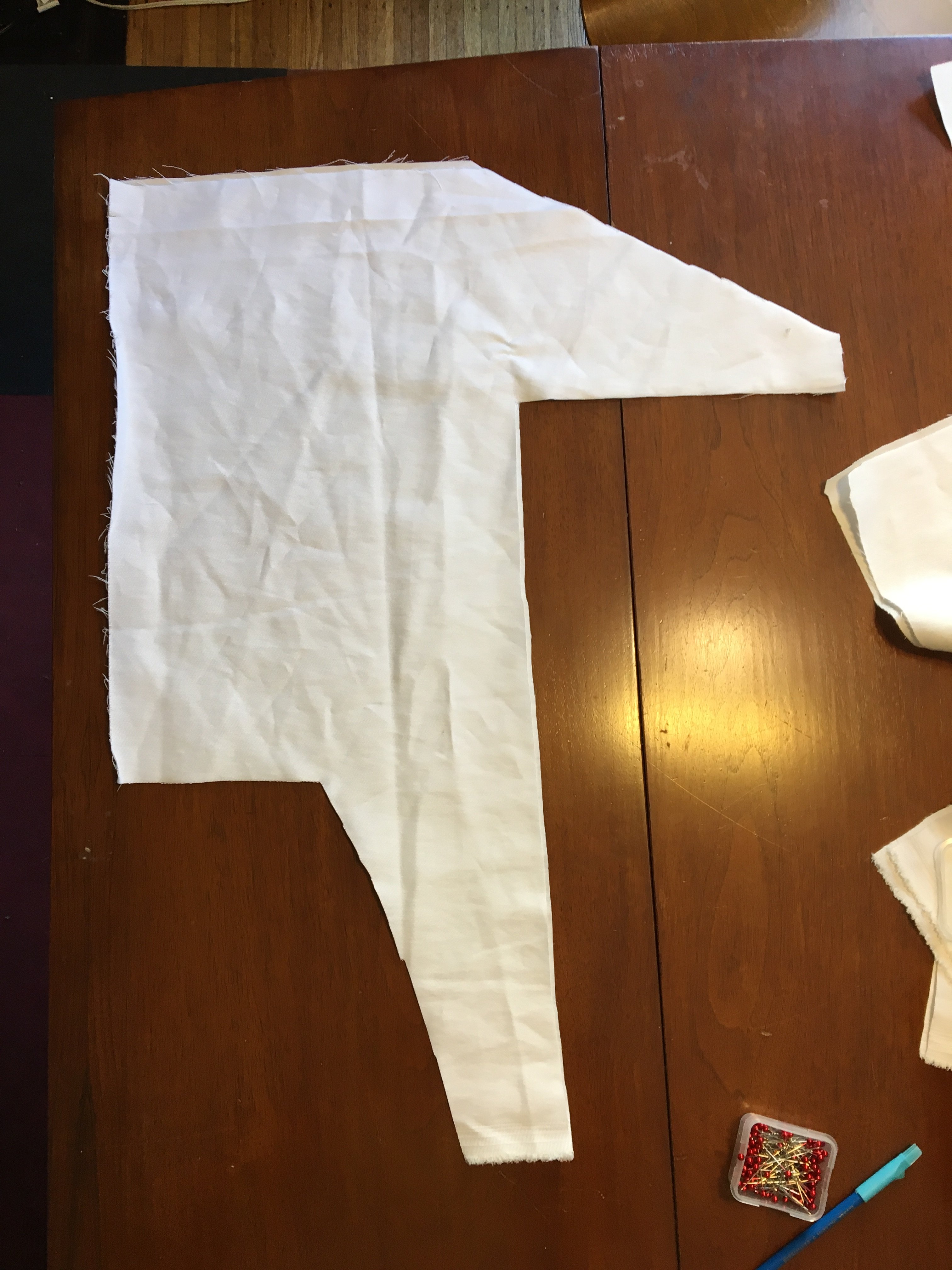

Shirt. The shirt is basically the same construction as the pants—stretch fabric with denim straps on top, based on a pattern. The pattern is a front-closing shirt; I modified it so it closes in the back instead of the front, using Velcro. It has Velcro strips riveted on to hold the rib and ab armor. I glued the strips on while I was wearing it, as with the pants, to make sure the shirt still fit correctly after they were on.

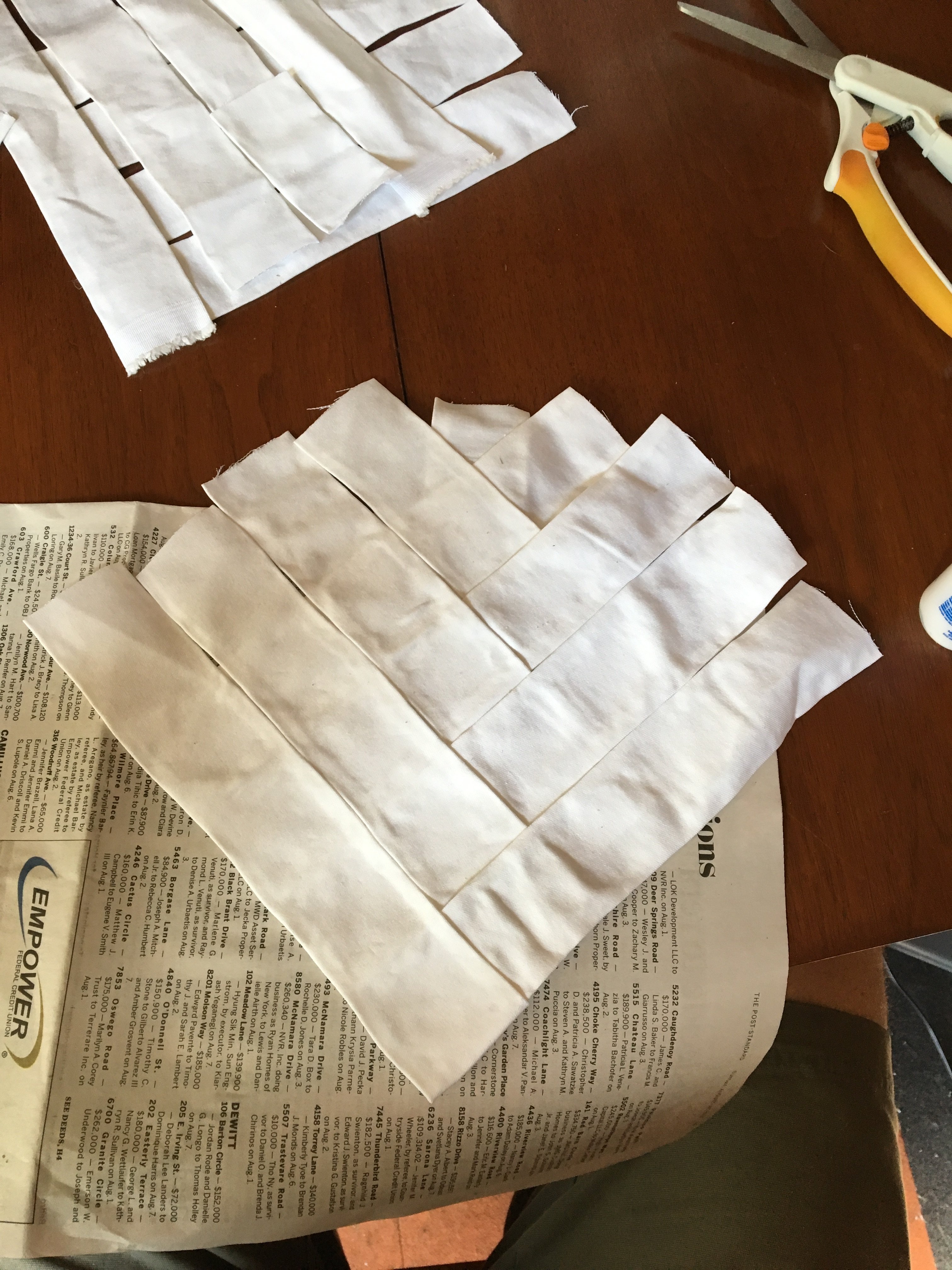

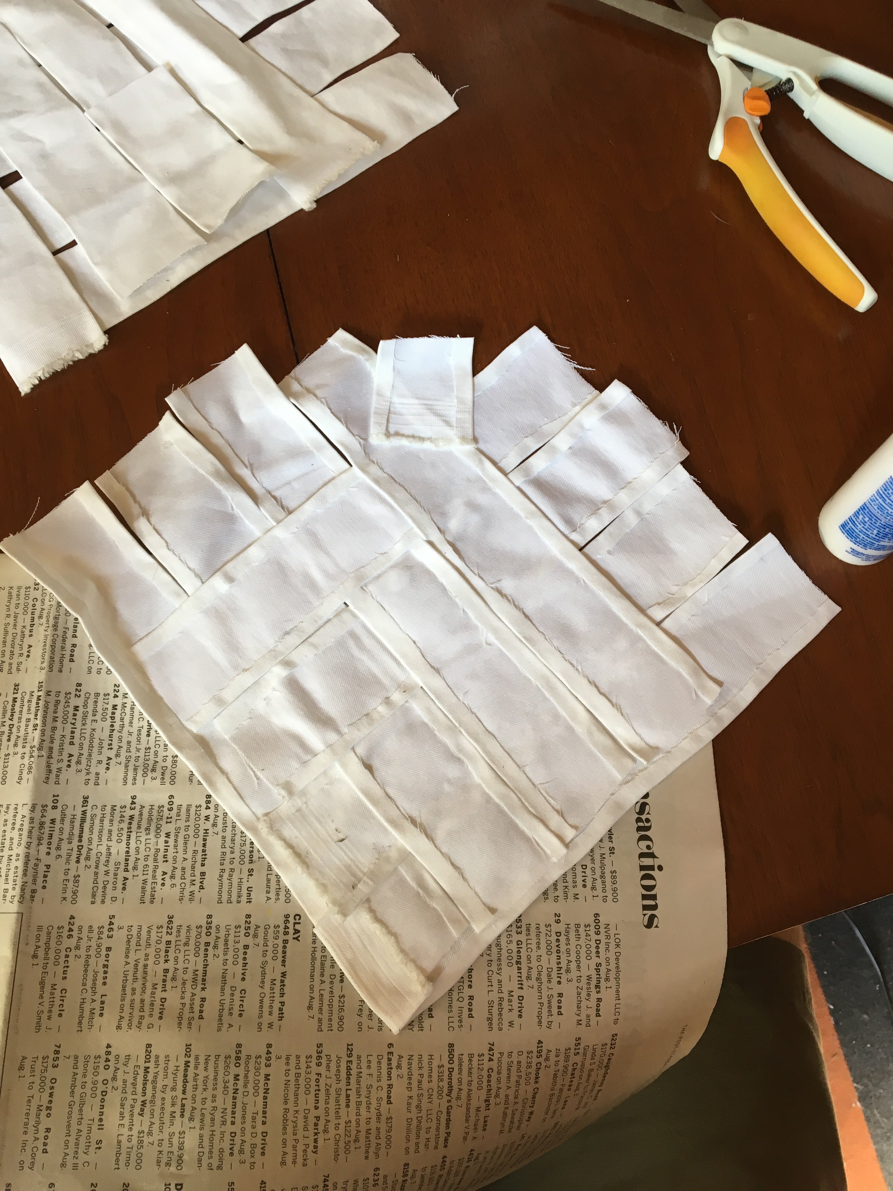

The shoulders have a different strip-pattern that’s woven together, as in the comic. I made these woven sections separately and glued them on.

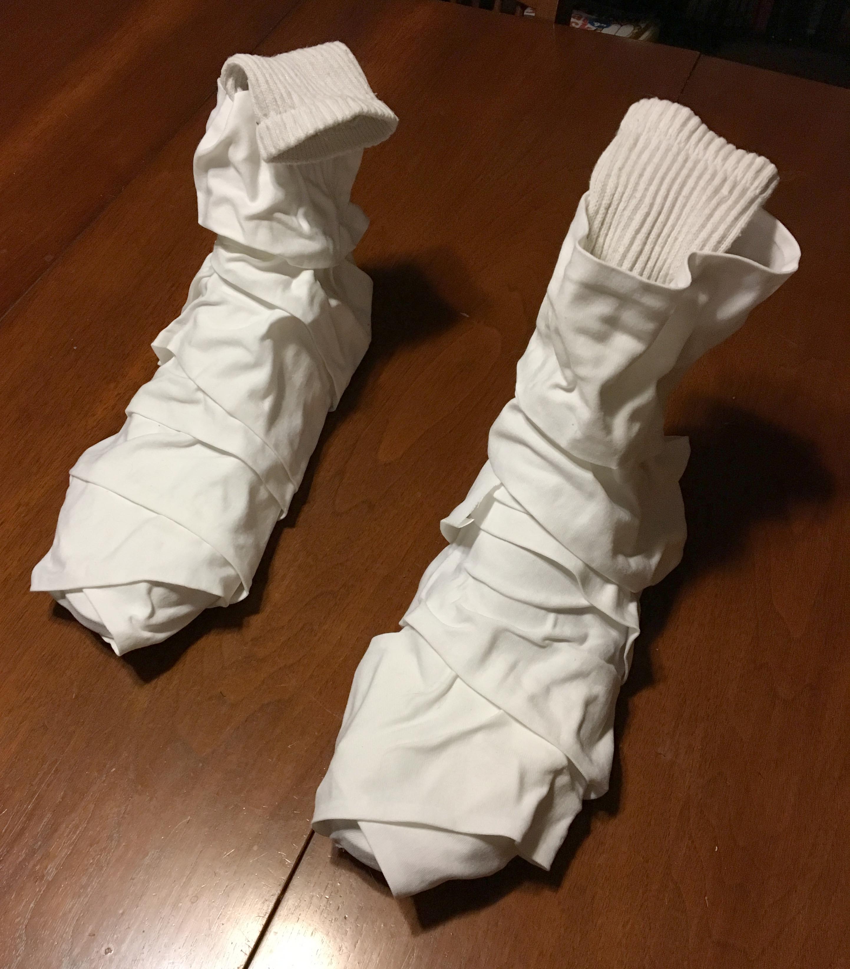

Shoes. I took flip flops, and glued a pair of socks to them using contact cement. I sliced the tip of the socks open to accommodate the flip-flop strap at the front. Then, you guessed it, I put them on and glued the wrappings on top. They go up high enough so the legs of the pants just go down over them. You can’t see the seam between pants and socks/shows unless you look very closely (this is true of the gloves too). Also the forearm/calf bones and their strappings help cover this up.
I have found that flip-flops, water shoes, and slippers work really nicely for cosplay shoe/boot bases. They’re comfortable, and are easy to slip your foot into while they are attached to some larger sock/calf structure.

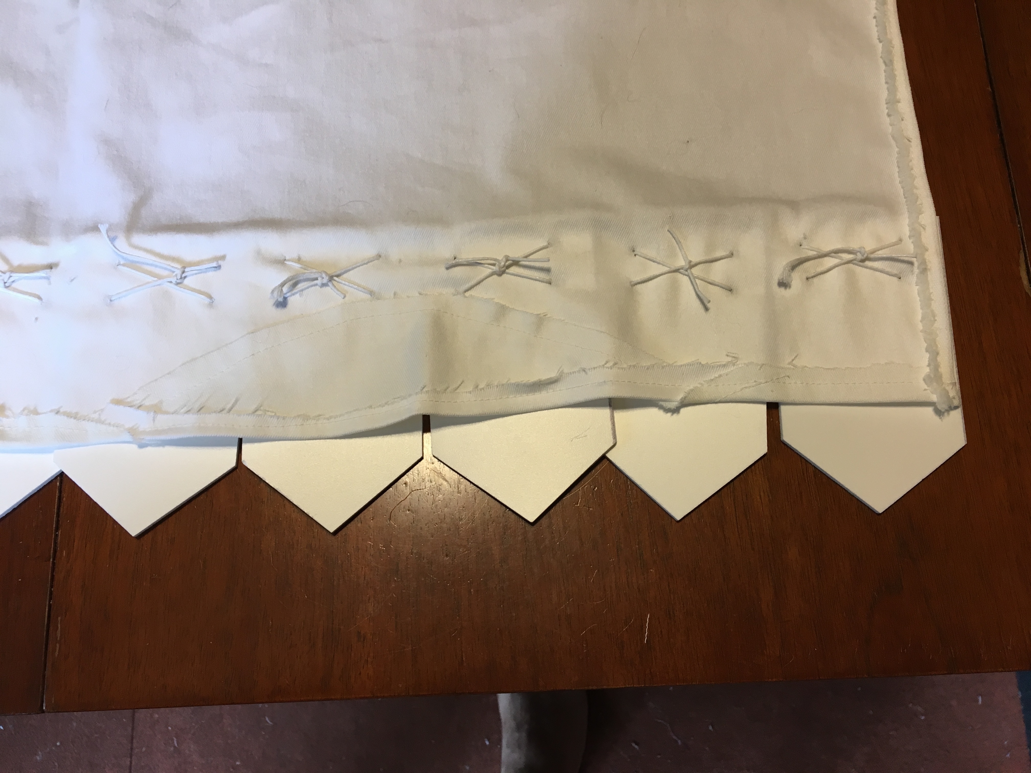

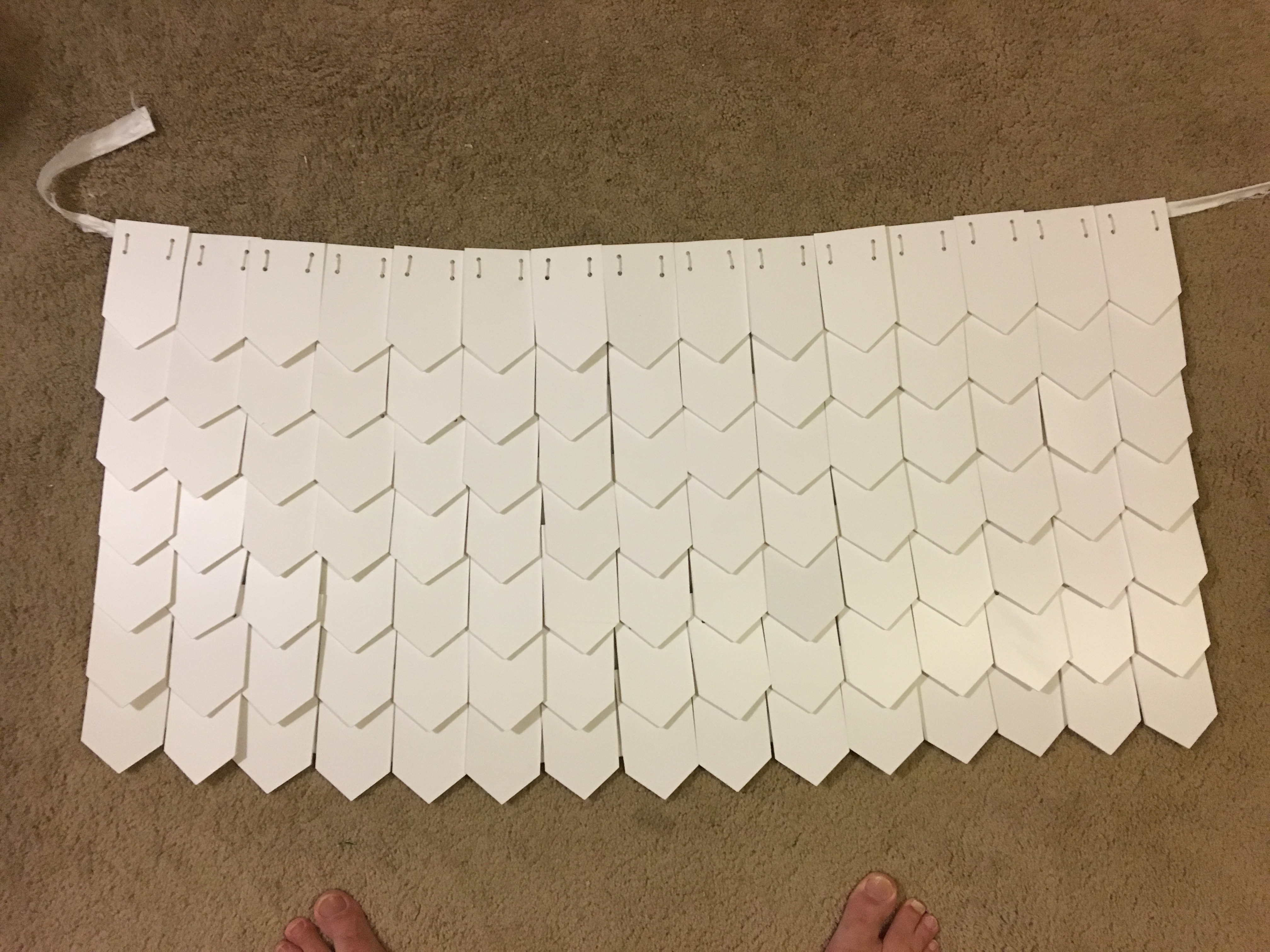

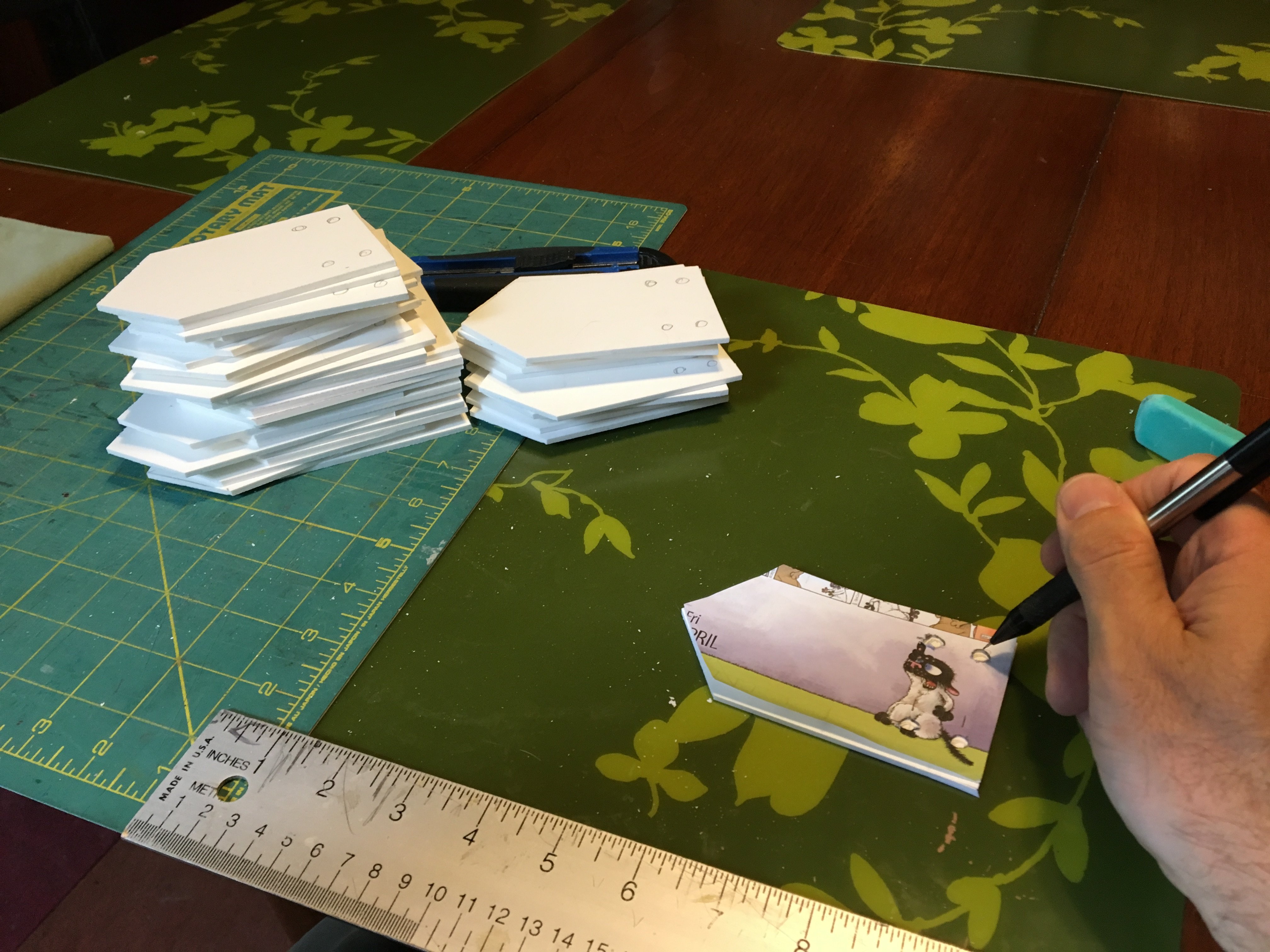

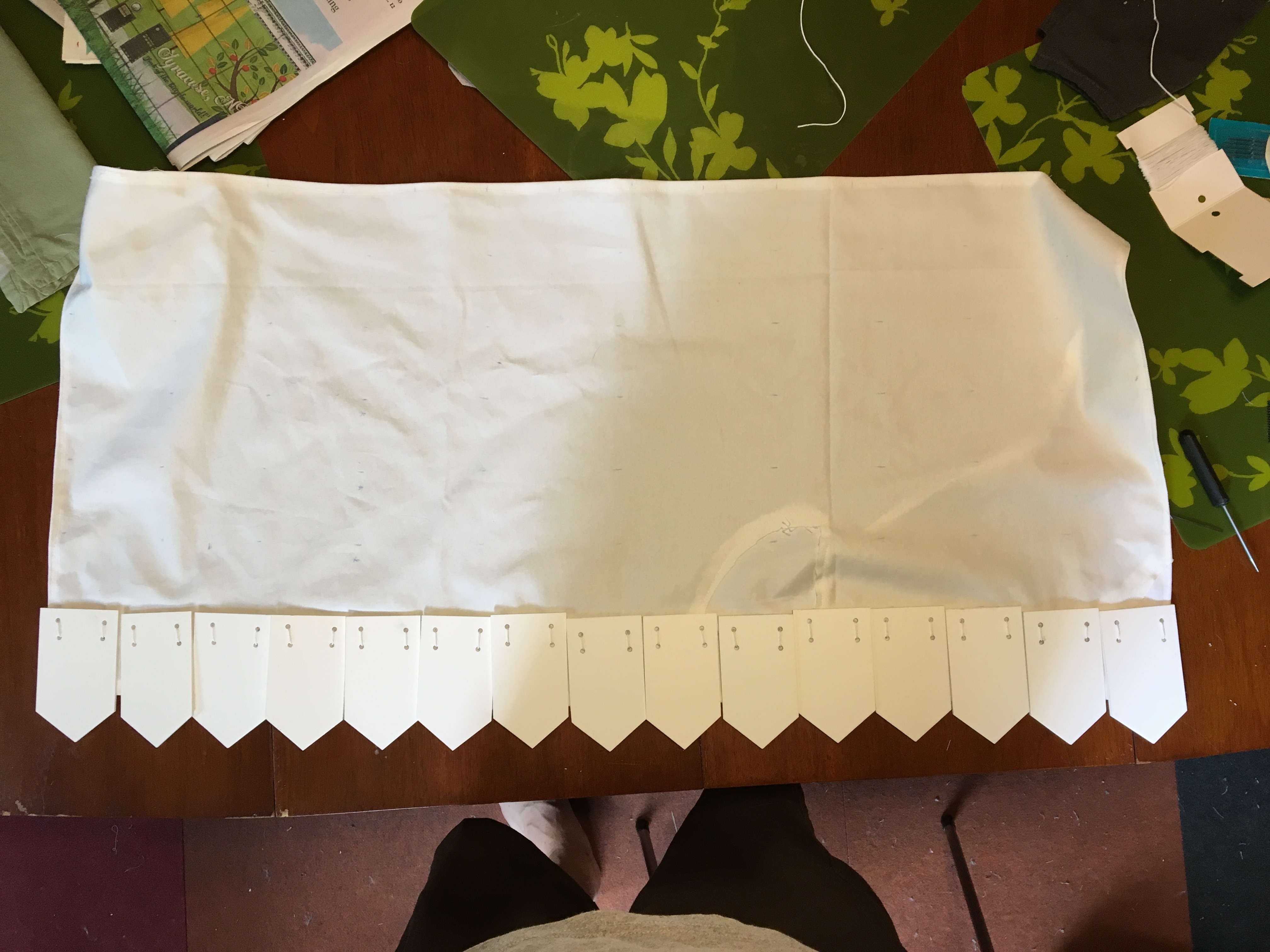

Scale mail skirt. This took some research. I looked at how a variety of costumers have attached scale mail, and ended up doing a slight variation (although I’m sure other people have also done it this way before). I made a fabric skirt backing (different from the “under-skirt”).

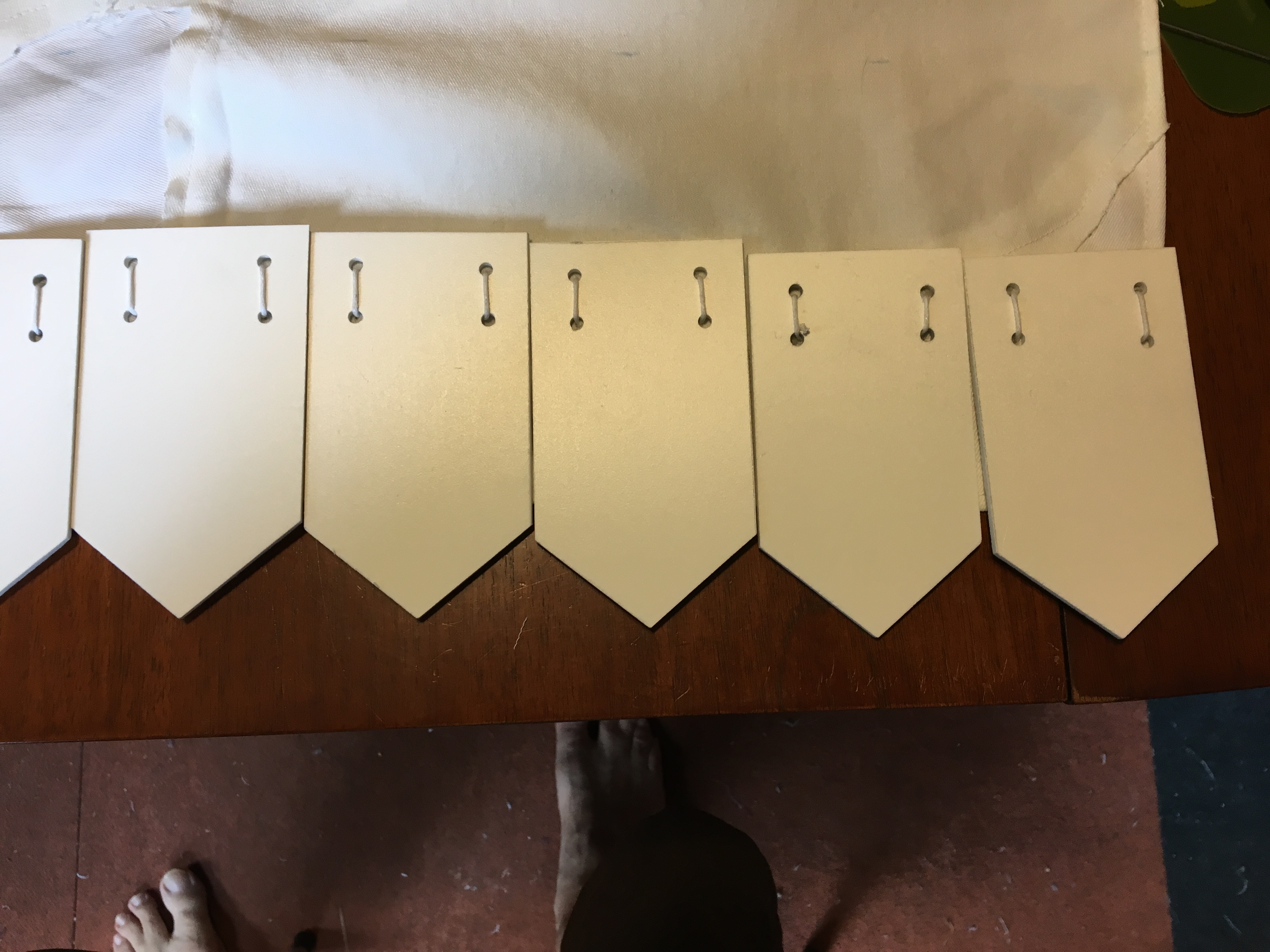

I cut out 100+ scales based on how many rows you could see in the original art. They’re made of un-painted Sintra. I drilled four holes in the scales using a drill press and a jig to get the holes spaced evenly.
They’re tied to the cloth skirt backing using white cord, and when I ran out of that, normal string. I tied them in a criss-cross pattern, so the front shows two vertical lines of cord, and the back shows an X. This held them in pretty tight in place, and allows excellent flexibility and mobility. Again, I saw a lot of methods for tying the scales together, this seemed like the best option for my situation.
I can sit with the scales, especially with the cape underneath my butt to help smooth them flat as I sit. I thought it would be a good idea to sew them all individually to the backing cloth skirt, instead of linking them together, in case any of the string broke.

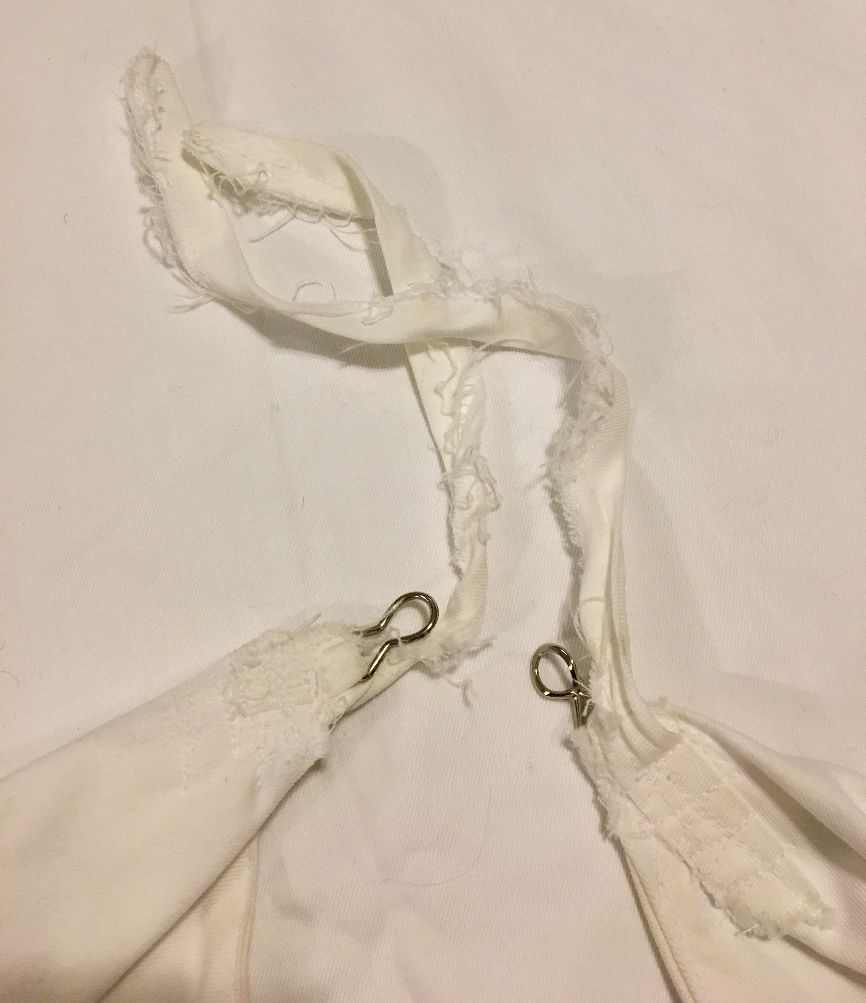

The whole thing is hand-tied in the front with a fabric tie. However, the fabric stretches over time, so it got looser as I wore it the first couple times. I now made a set of suspenders that go under the shirt and attach to this scalemail skirt via some latches so it won’t fall down.

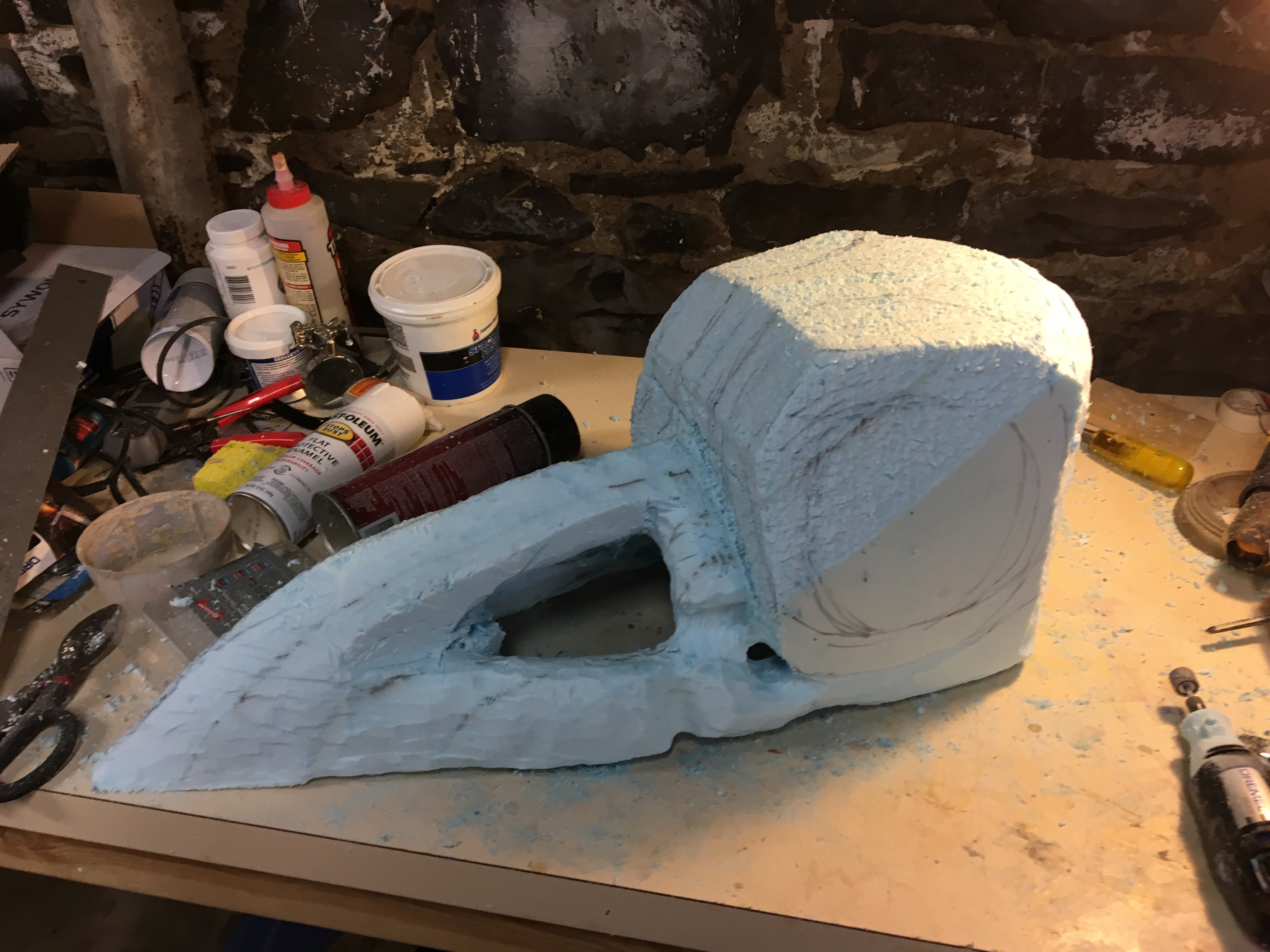

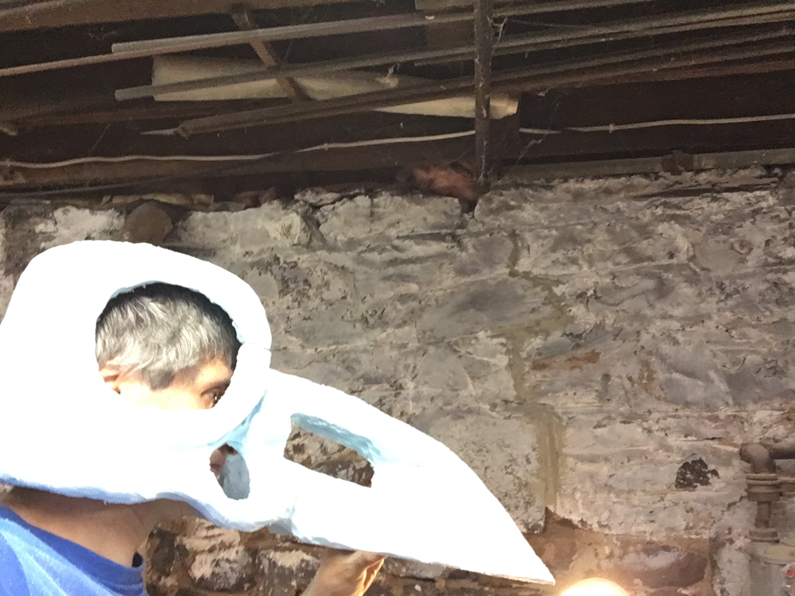

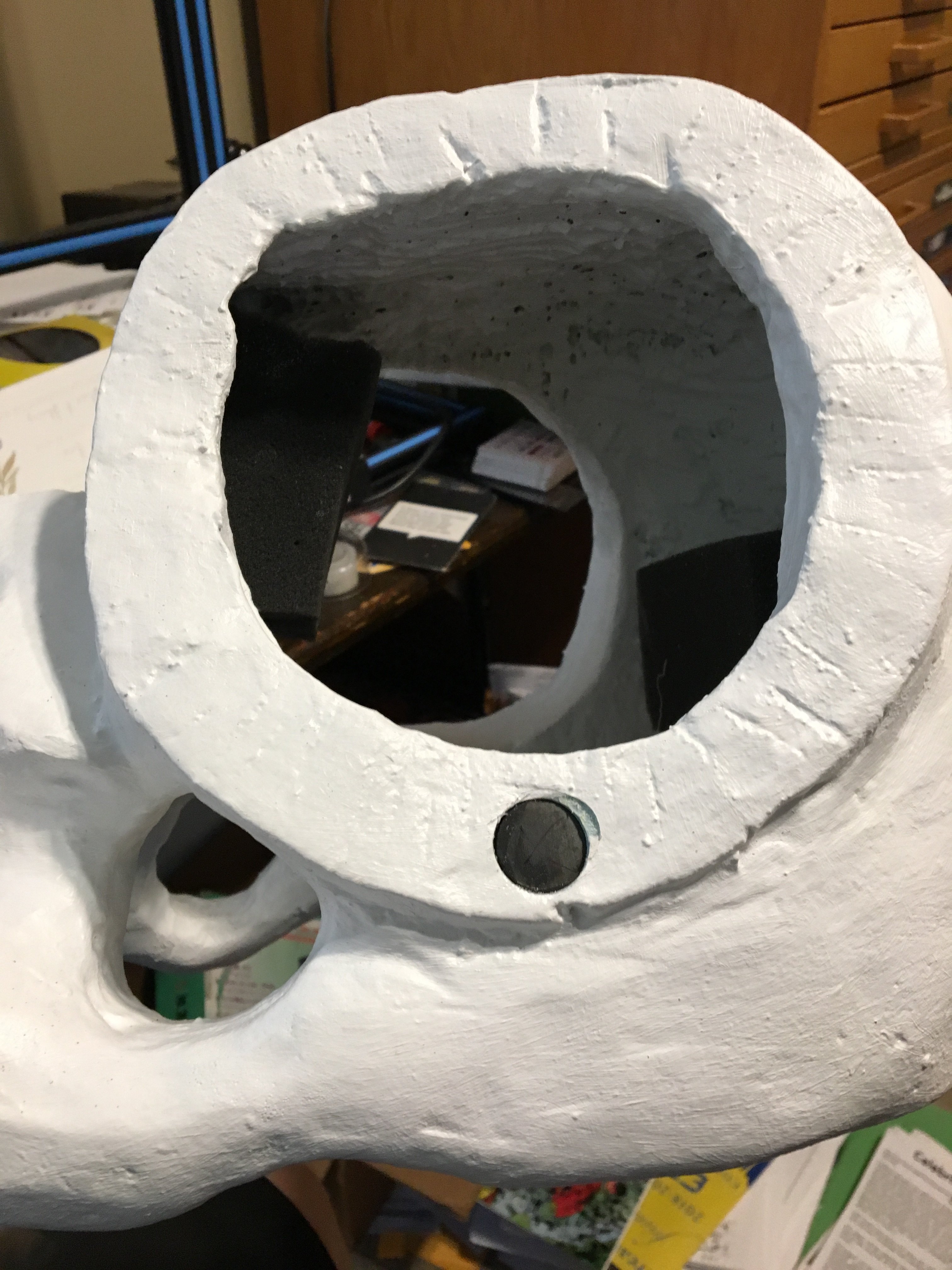

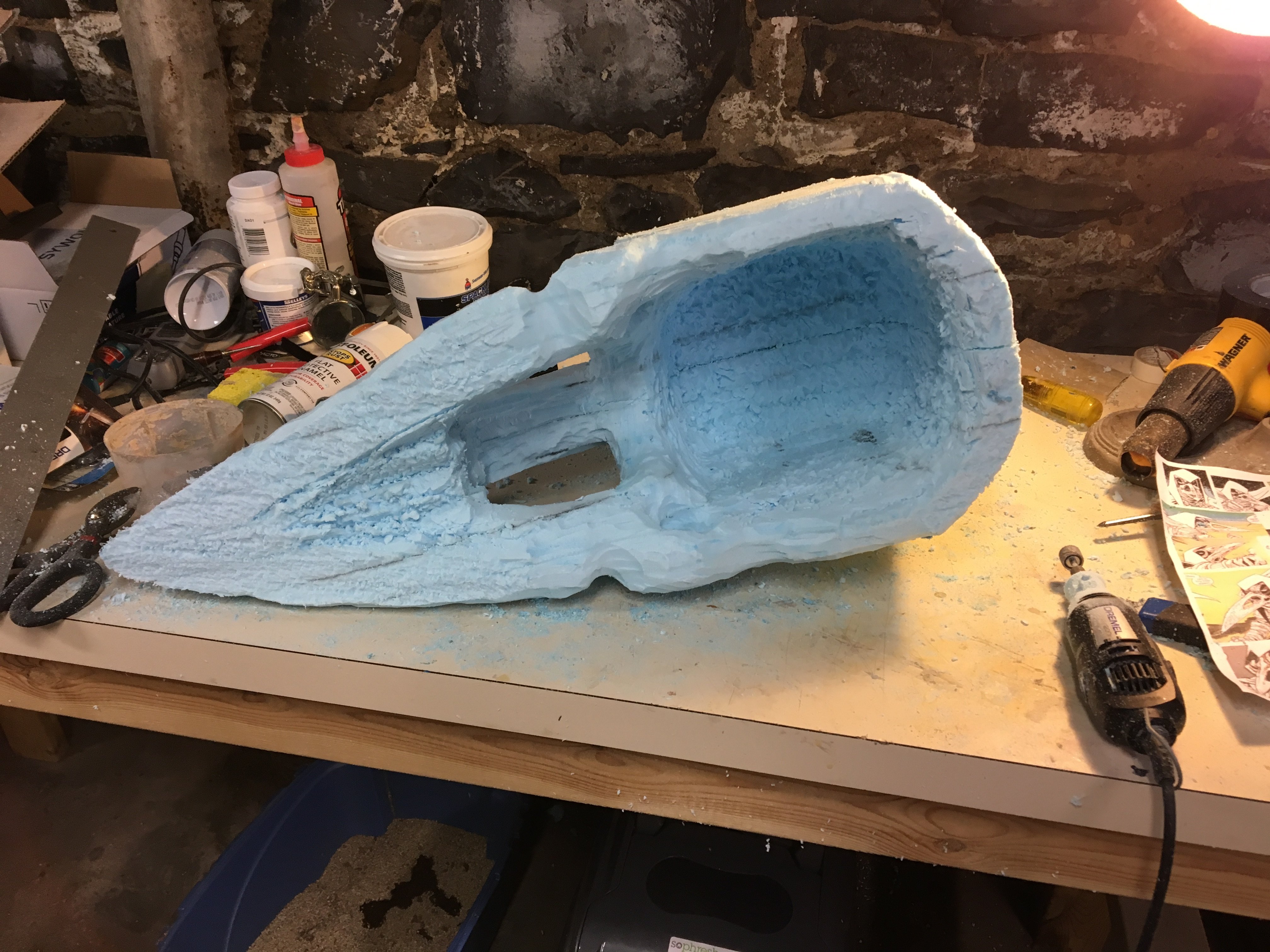

Bird skull mask. This is made of 10 layers of insulation foam, vertically glued together. I cut the big chunks off with a hand saw, then dremeled it to down to shape. This was a challenge, as it was hard to be sure of exactly what measurements I’d need for the hole for my head, and the shape of the skull is pretty complicated. It is a little big in some spots; the head hole is a little too big front-to-back, and the beak should be a little less high and wide. Also, I was super-annoyed to realize that you could see the lines between the foam layers, even under many layers of glue and rubber dip (mostly in the back). I have largely fixed this with spackle and more priming/painting, but not as much as I would like.
The one built-in issue is that the eye holes are not really in the right place, based on the original design. A bird’s eyes look out to the sides, but we humans see from the front. In the comics, it’s just sort of drawn from an angle so you can see his eye, but really you wouldn’t be able to from that angle. In some drawings they angle the skull’s eye hole so it would be easier to see out of. But even then they place his own eye where it wouldn’t be; if you angled the hole enough to see, there wouldn’t be hardly any skull forehead and it would look really weird. So I made the eye holes more or less like what they’d look like in a real bird. Lucky for me, the nose holes are in a pretty good place, so I could see out of those! That wasn’t really intentional, but it worked. Again, even with all the problems, I was pretty happy with the result. I haven’t sculpted anything remotely of that complexity before, and it definitely worked as a signature visual piece.

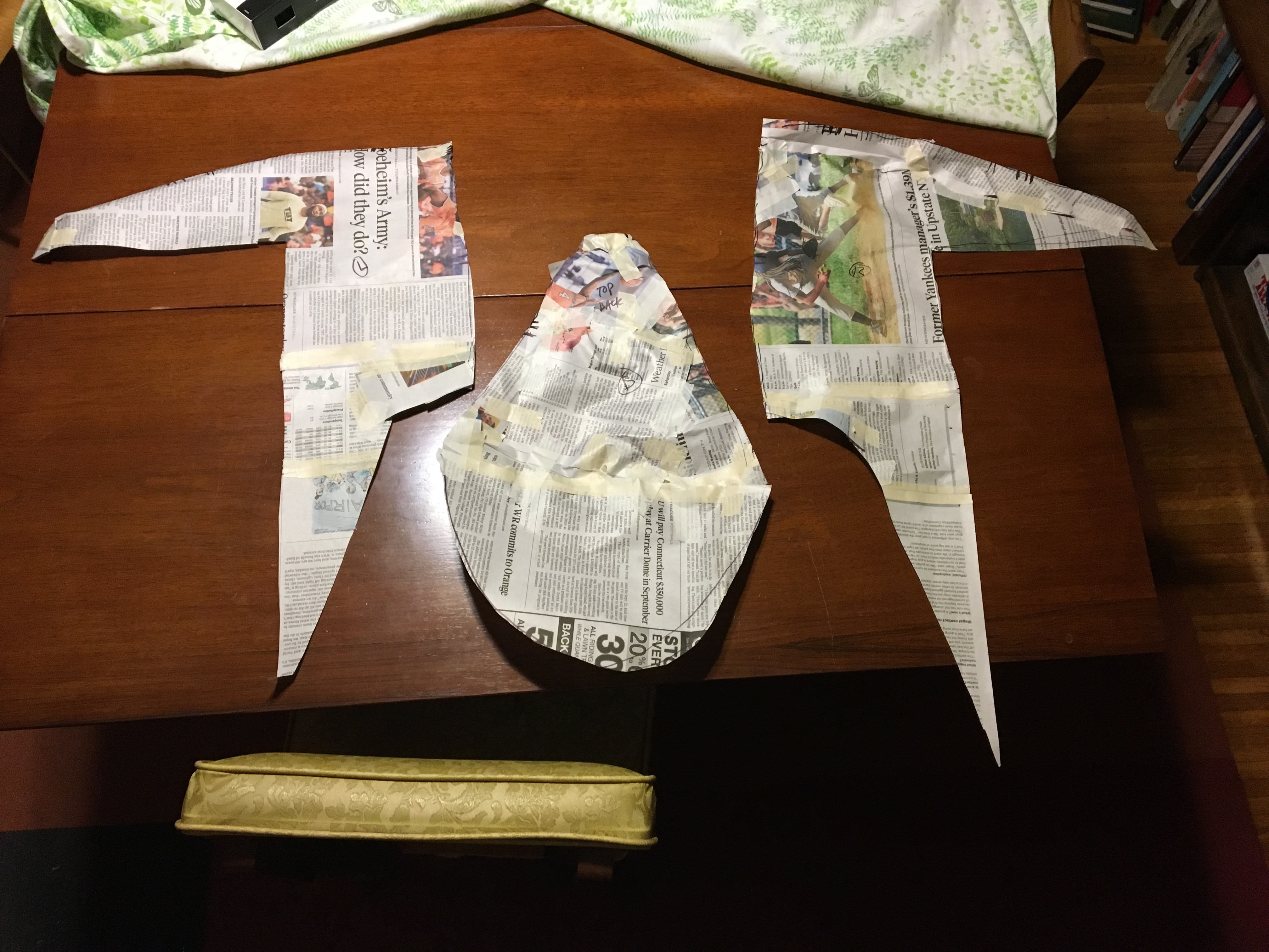

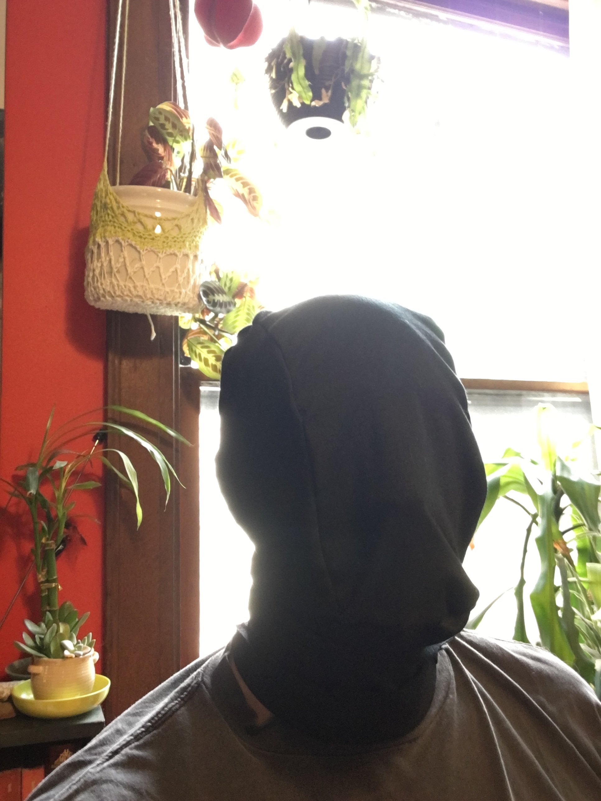

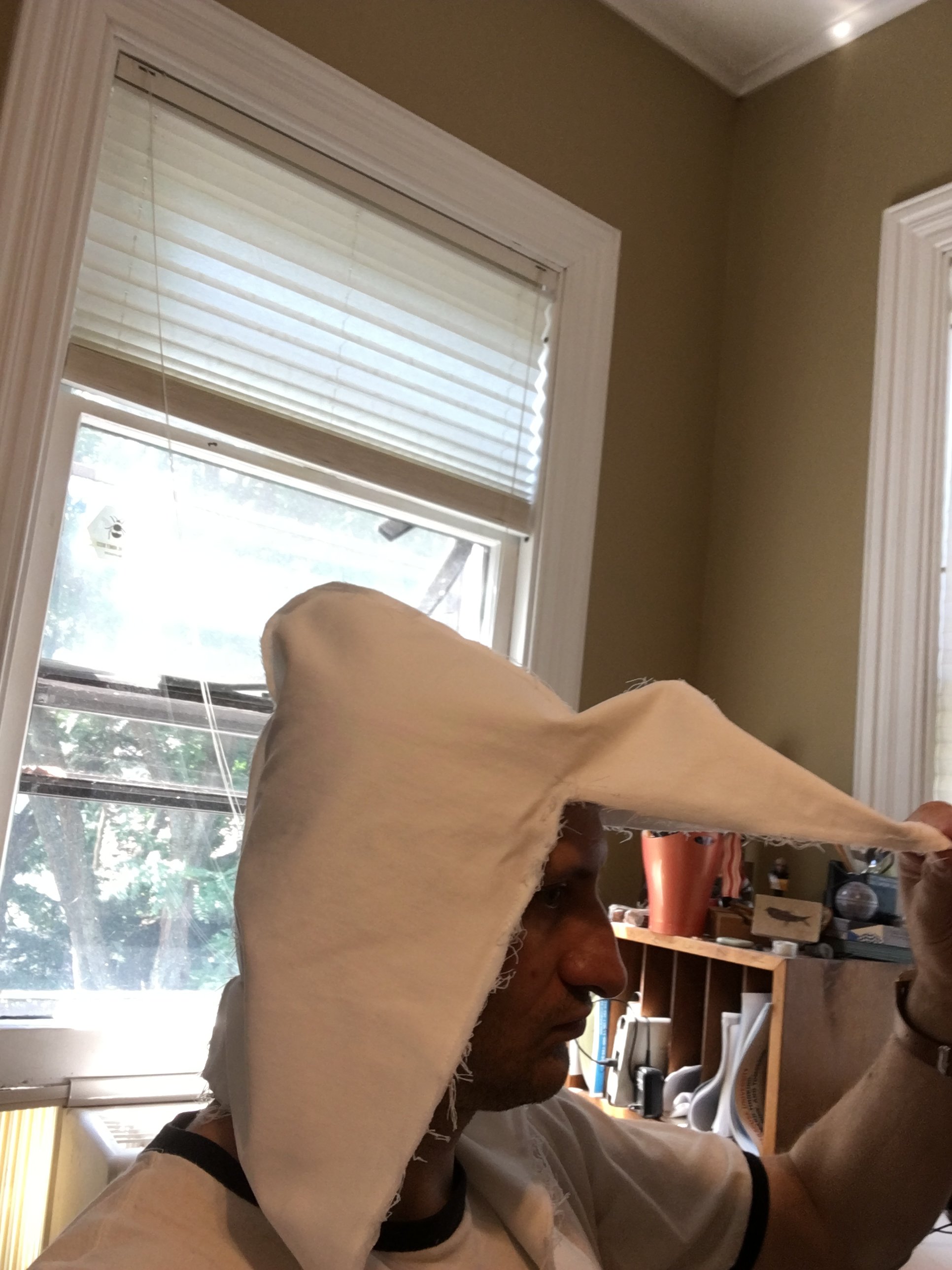

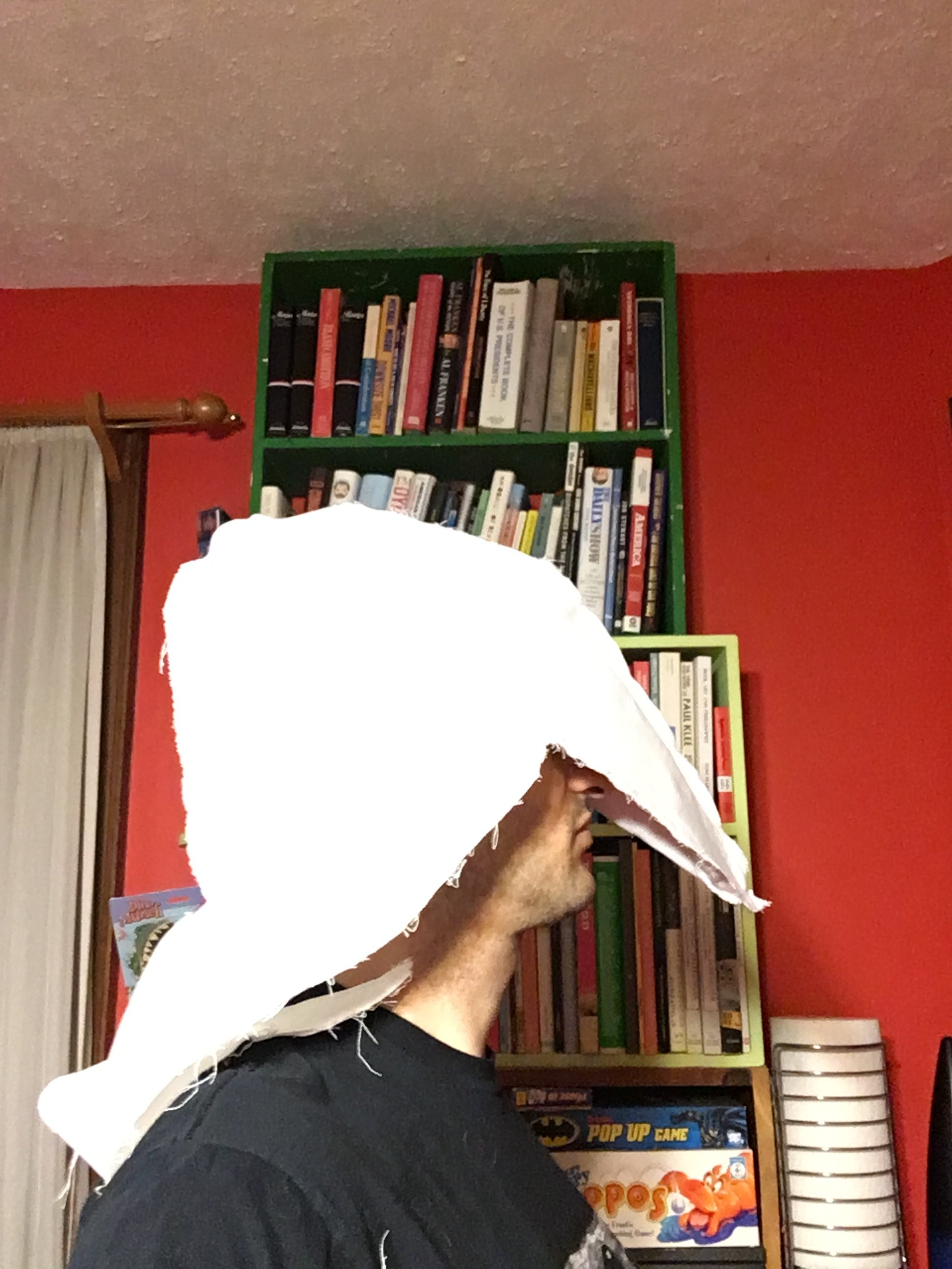

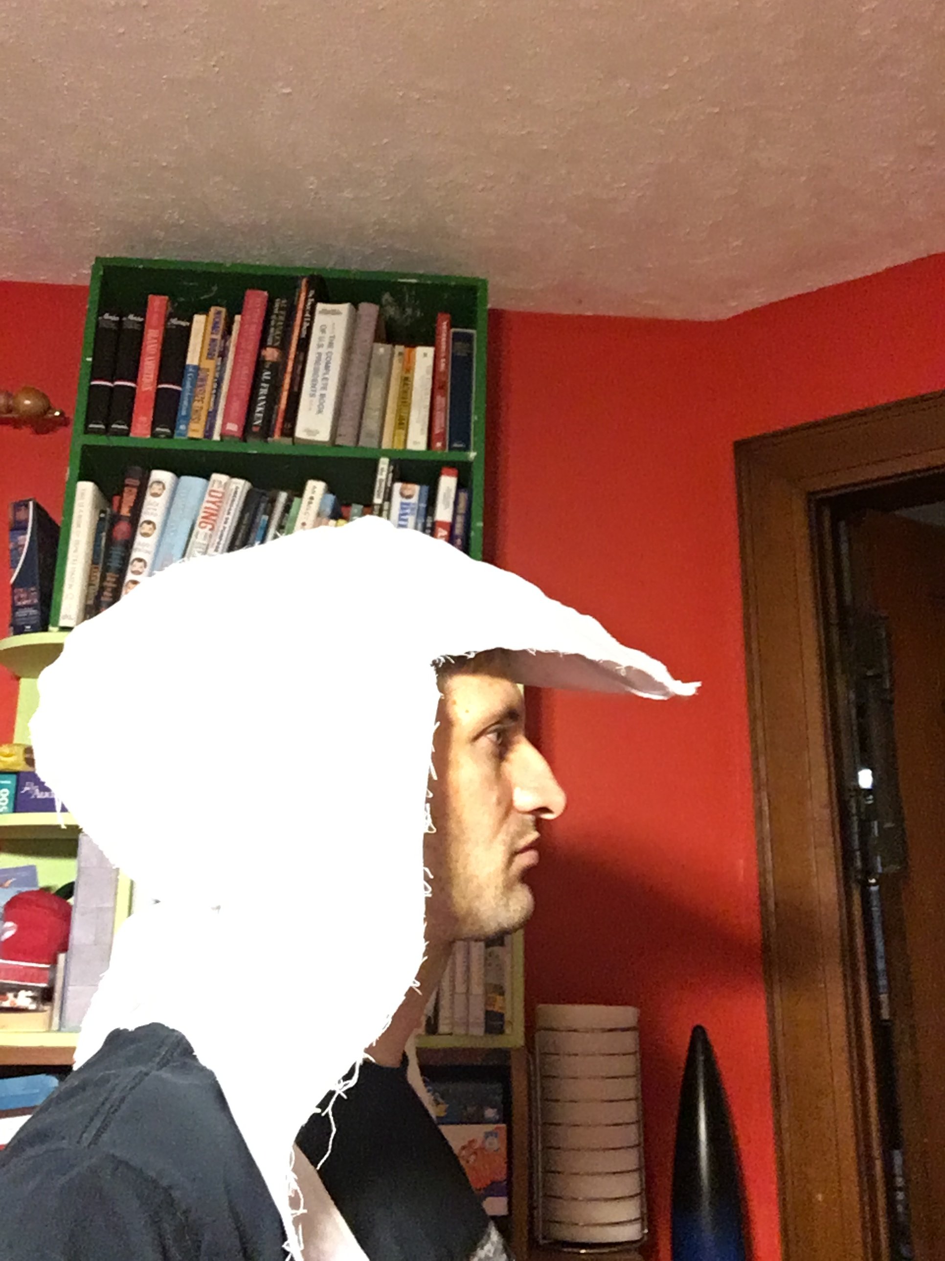

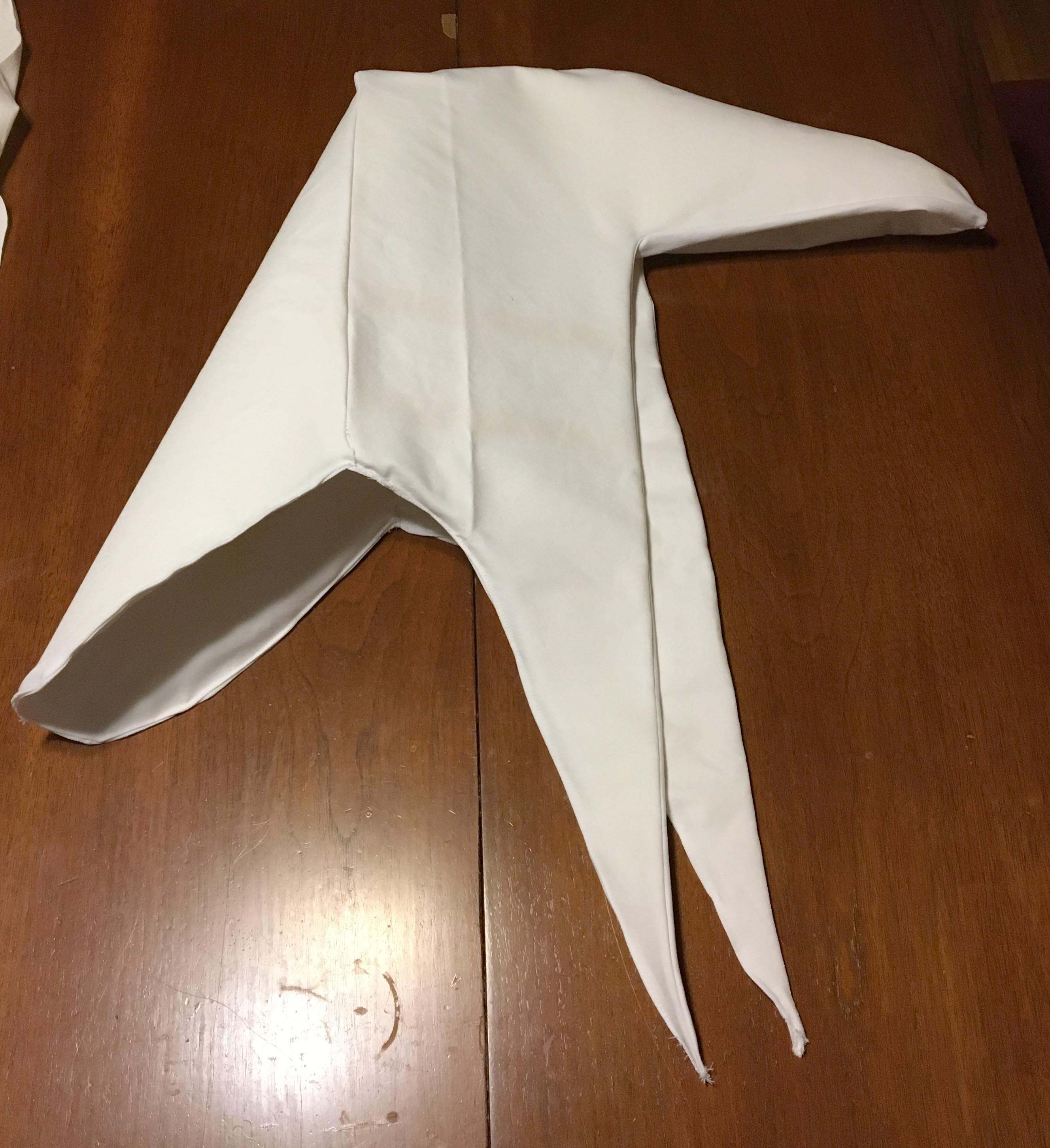

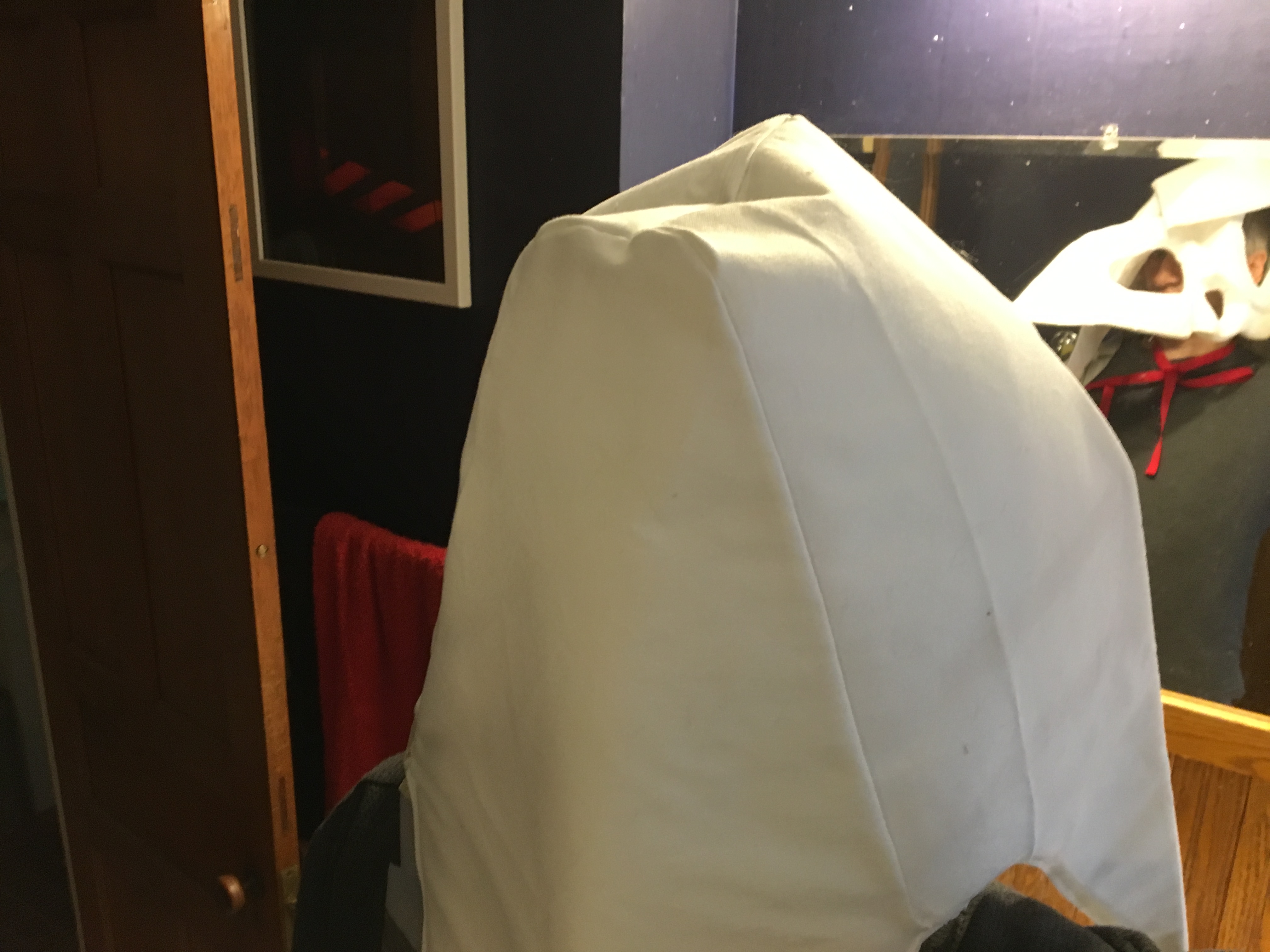

Hood.
The hood is not attached to the cape. I made a couple versions to figure out how to get the shape I wanted at the peak. It also has a firm “beak” look—i.e. the front is pointy. I kept the front stiff by putting craft foam in-between the two layers of fabric.
After a few times wearing it, I added two magnets inside, one on each side, so they attach to the skull (which also has magnets). This keeps the hood from shifting too much when I turn my head. It’s hard to tell how well the hood is sitting on the skull while I’m wearing it, so this was necessary.
This is actually the third version of the hood, each made to fit the skull better. I originally made it before I made the skull (I know, genius move), so even though I intentionally gave it multiple extra inches beyond my head, it was still too small.
I put wire in the tails of the hood so they can be shaped a bit for a more dynamic look.
Below: patterning the hood shape, and then trial and error in fitting as I try to get the pointy-ness of the hood correct.

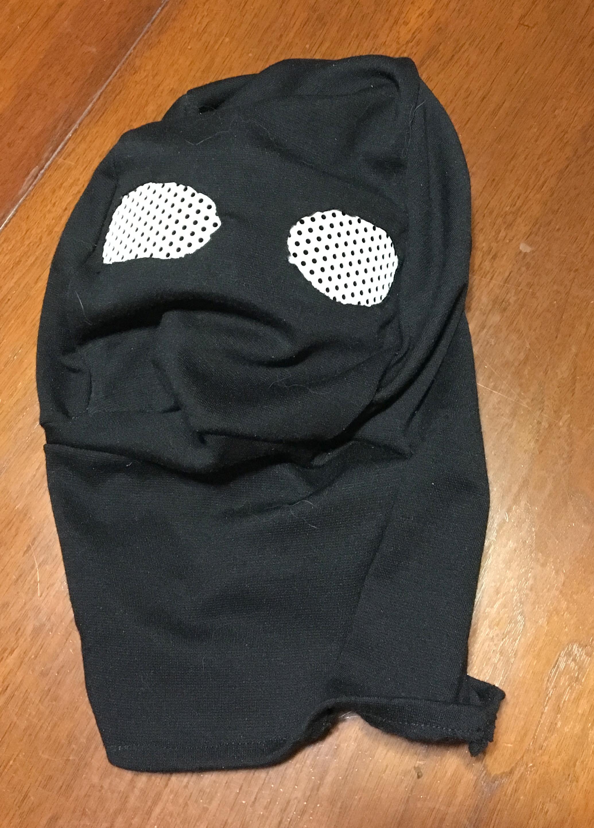

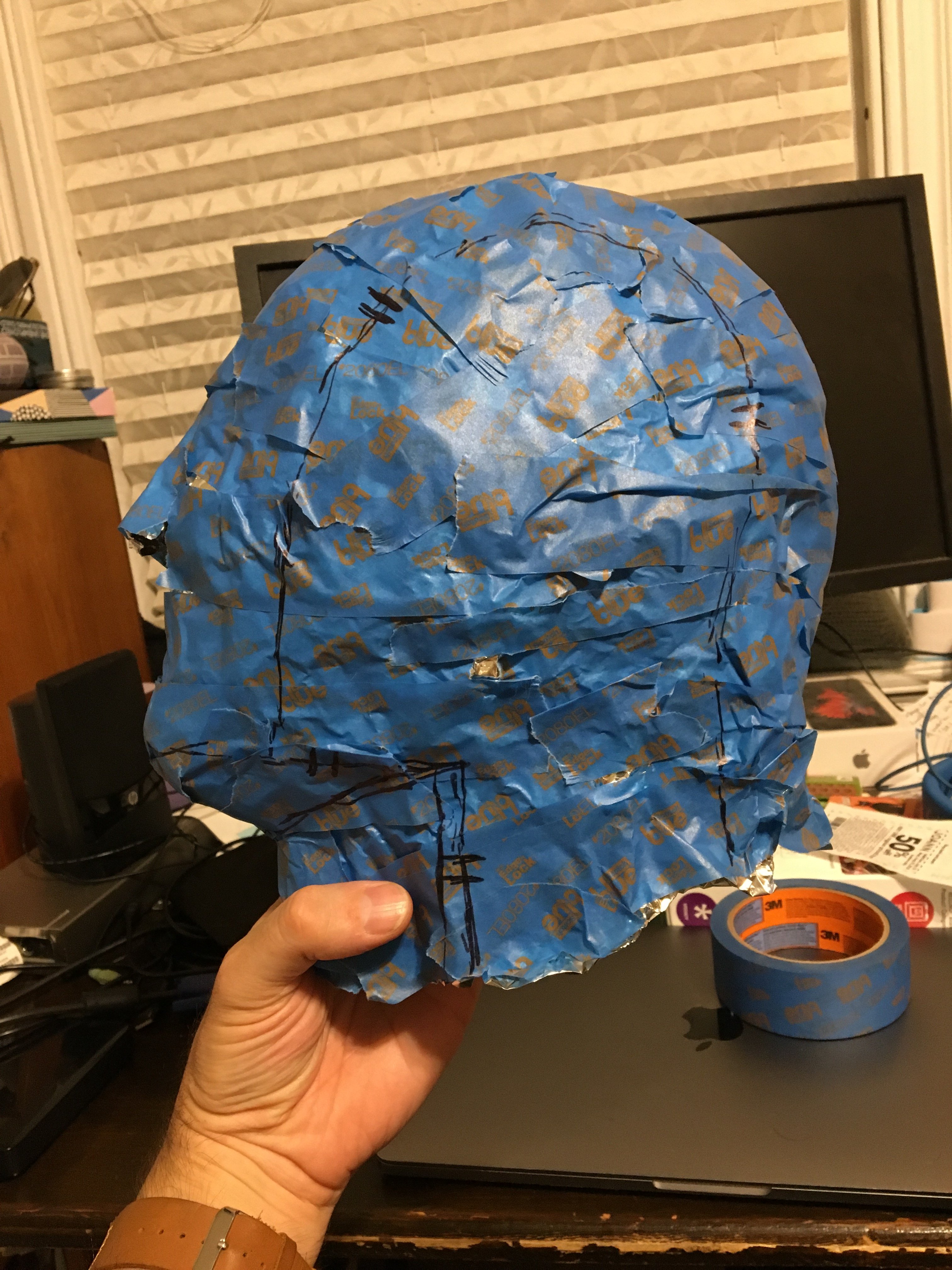

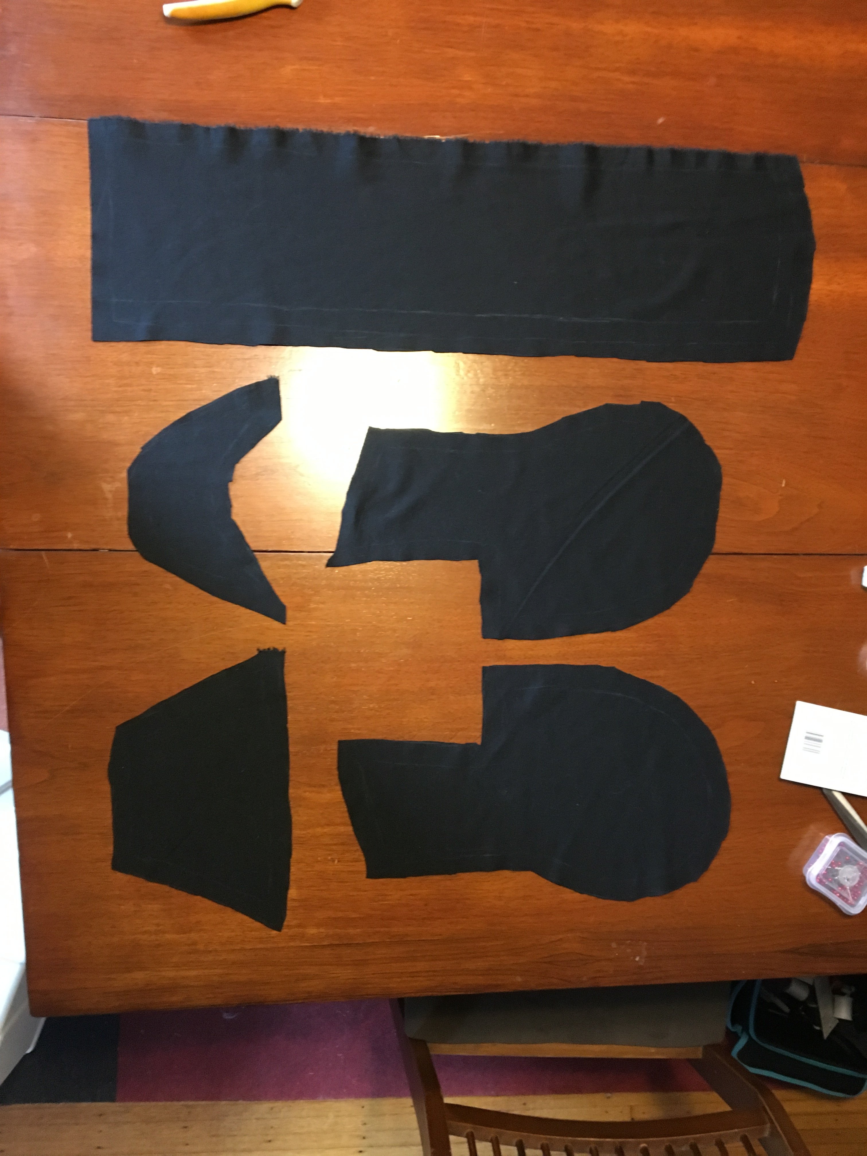

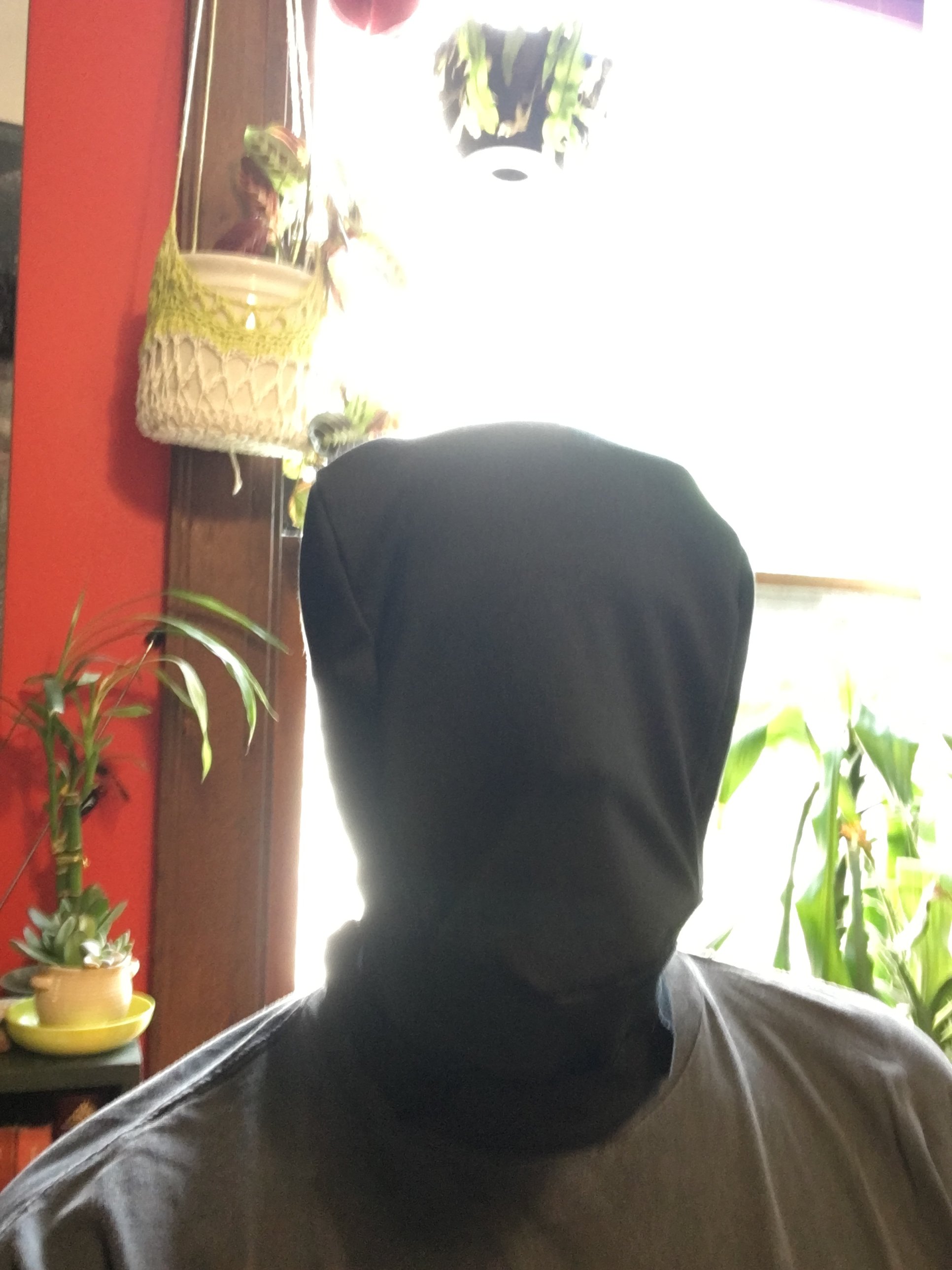

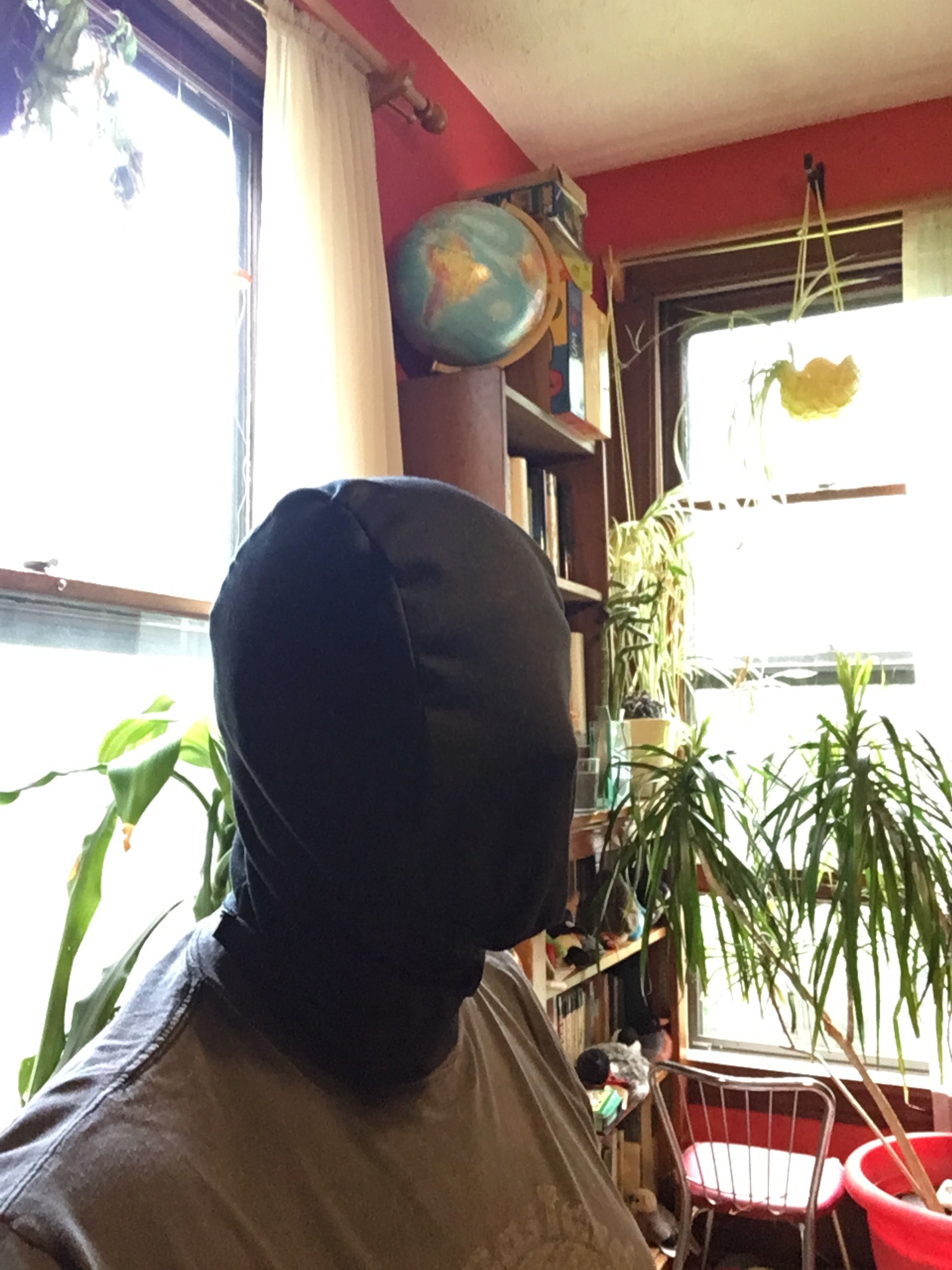

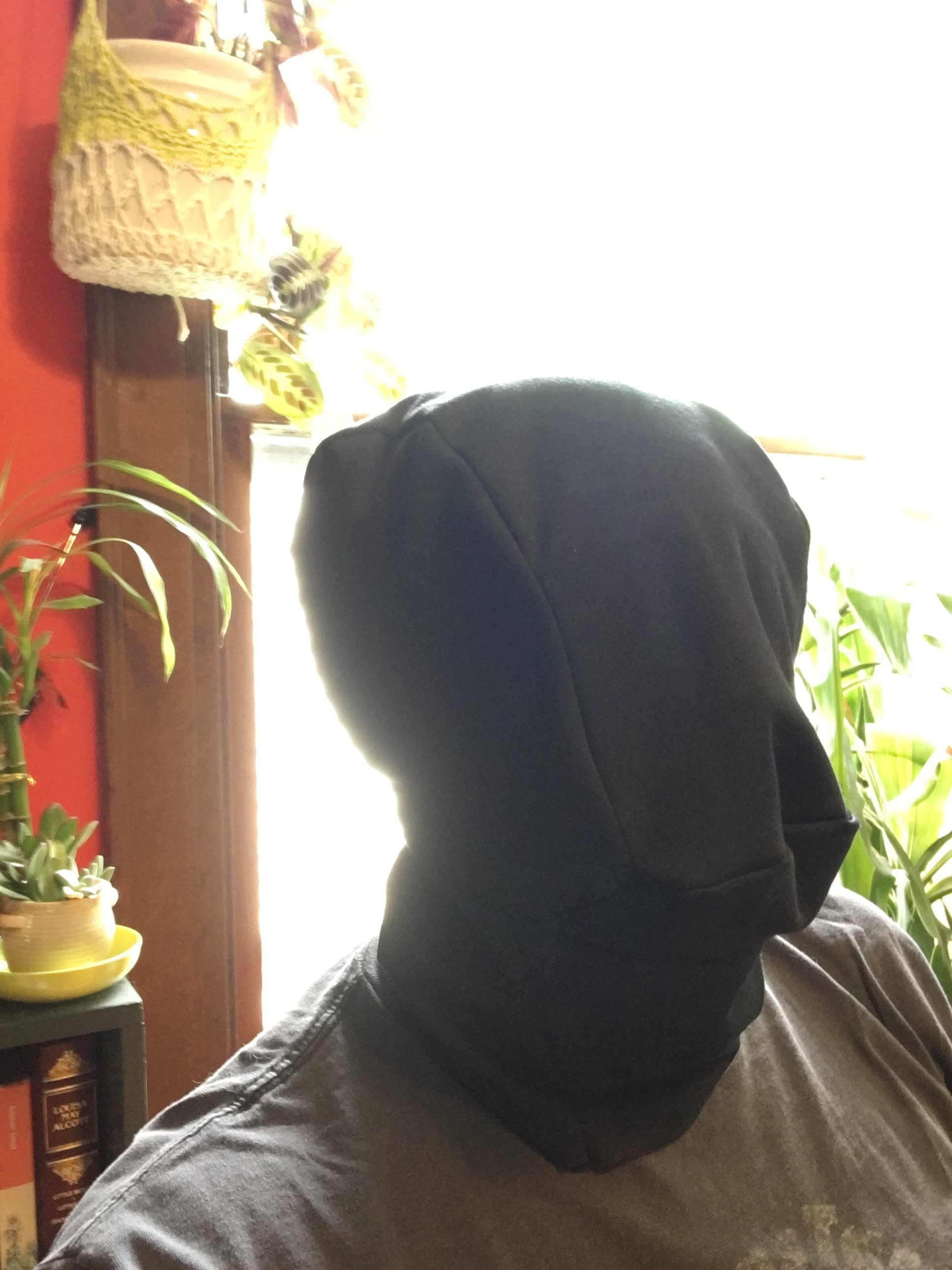

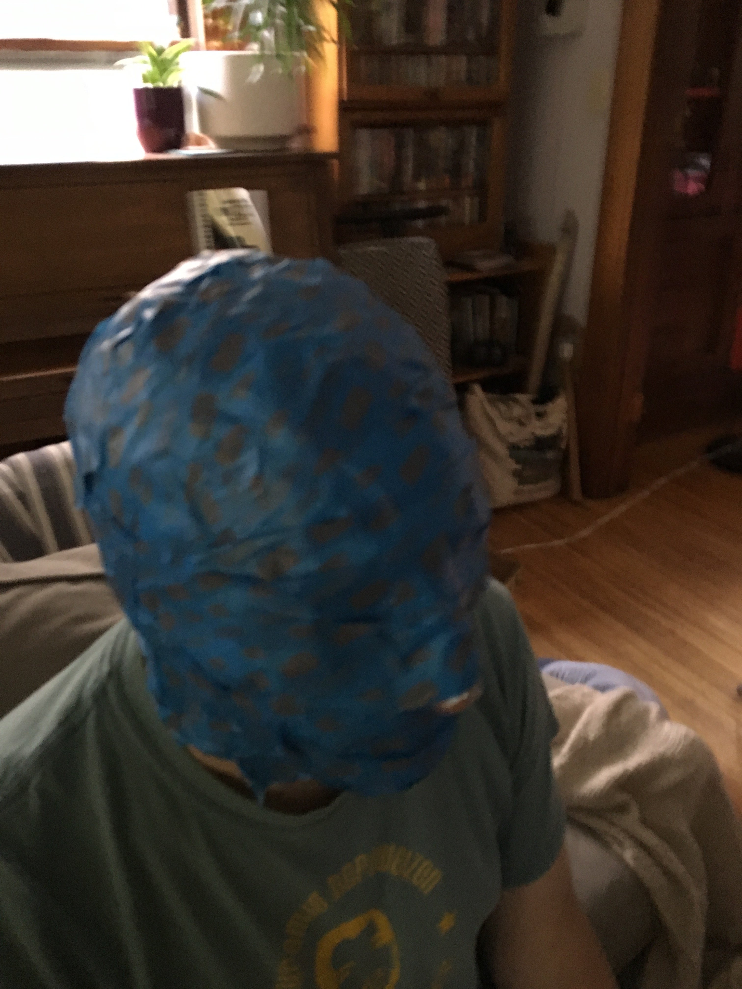

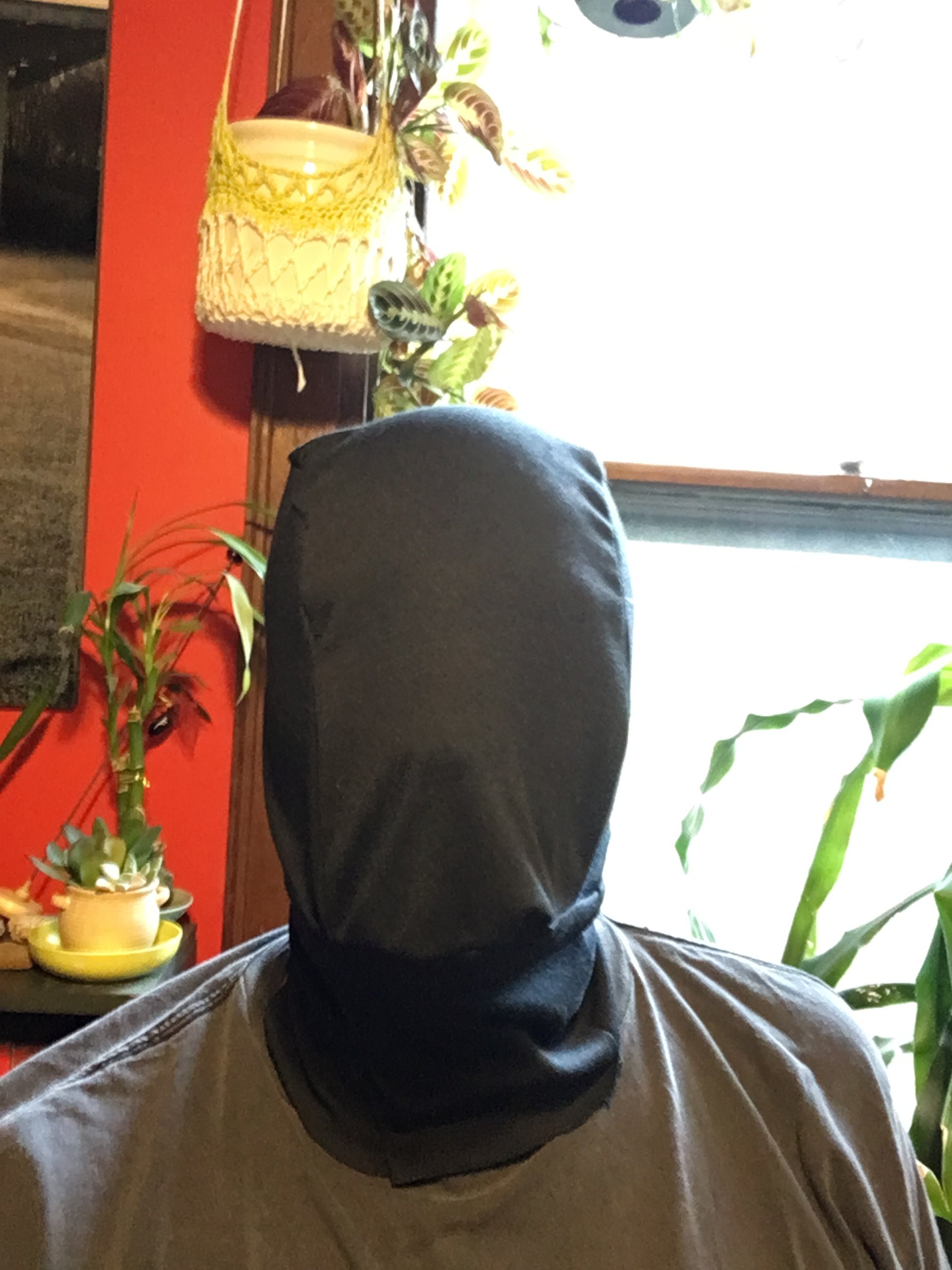

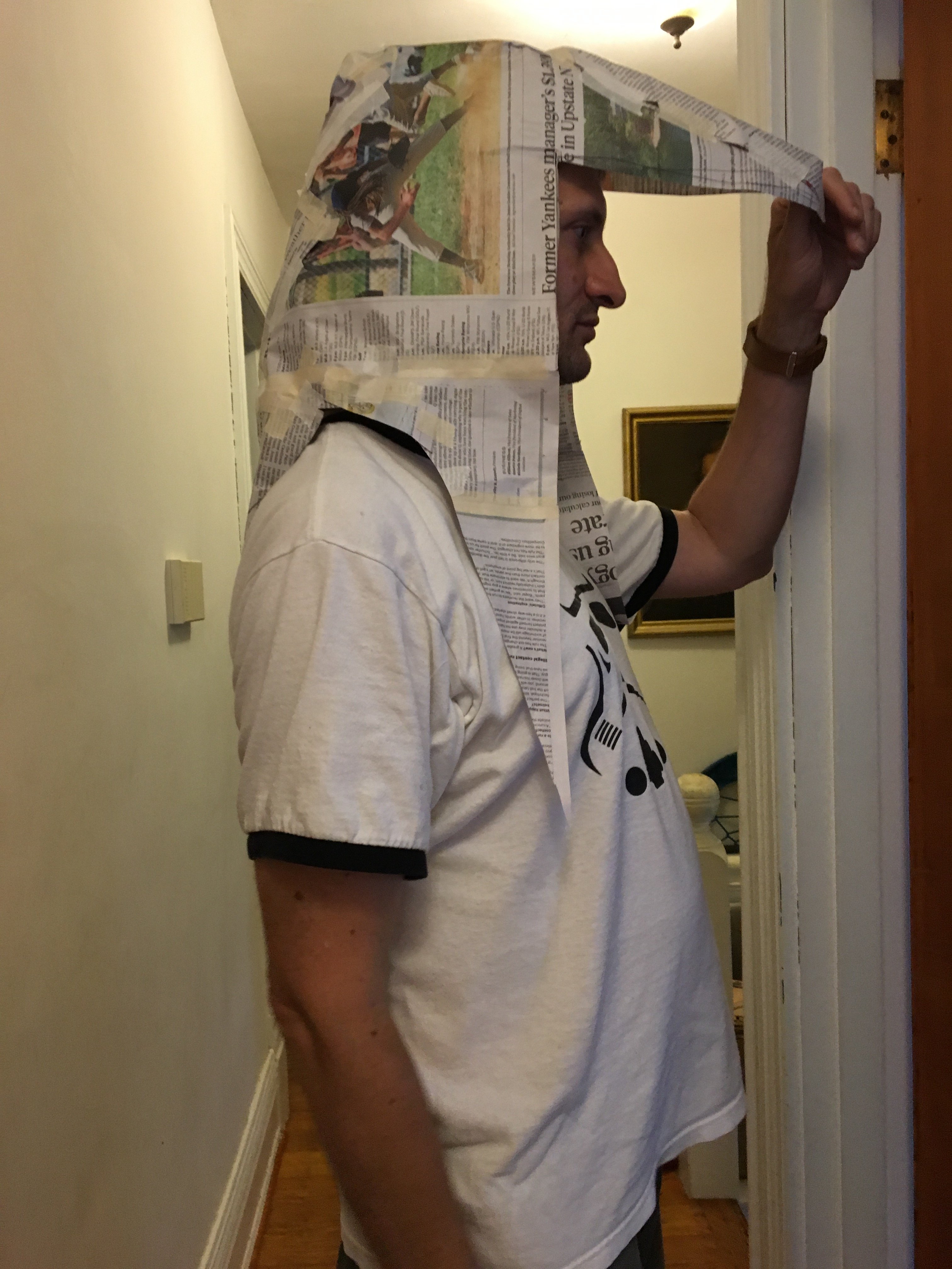

Black mask.

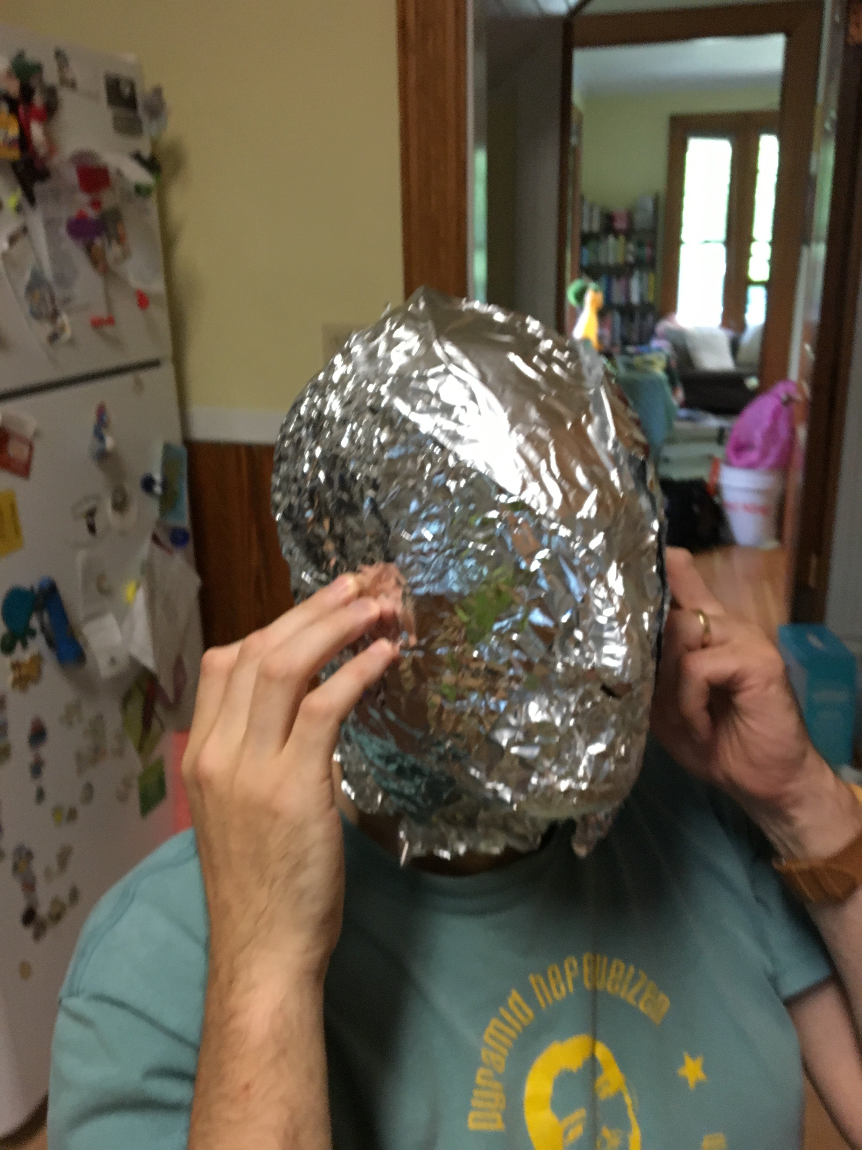

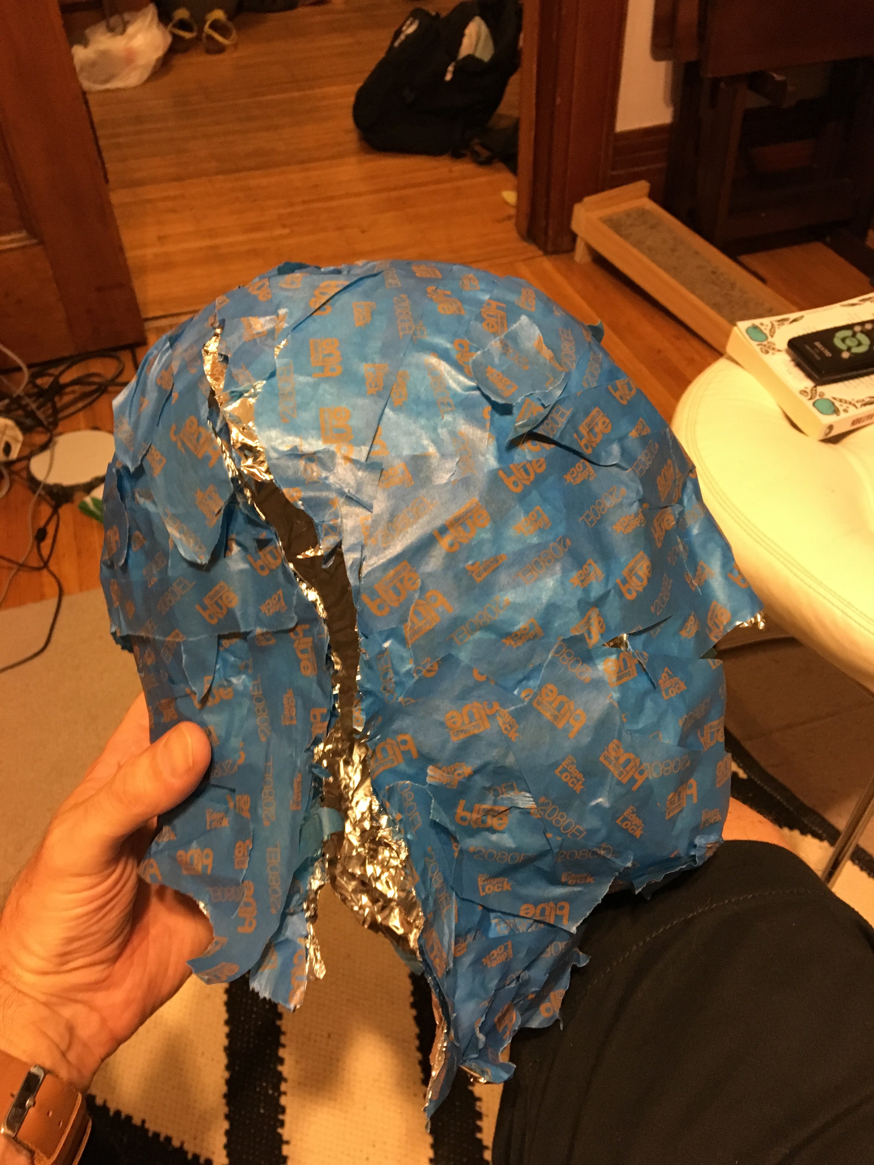

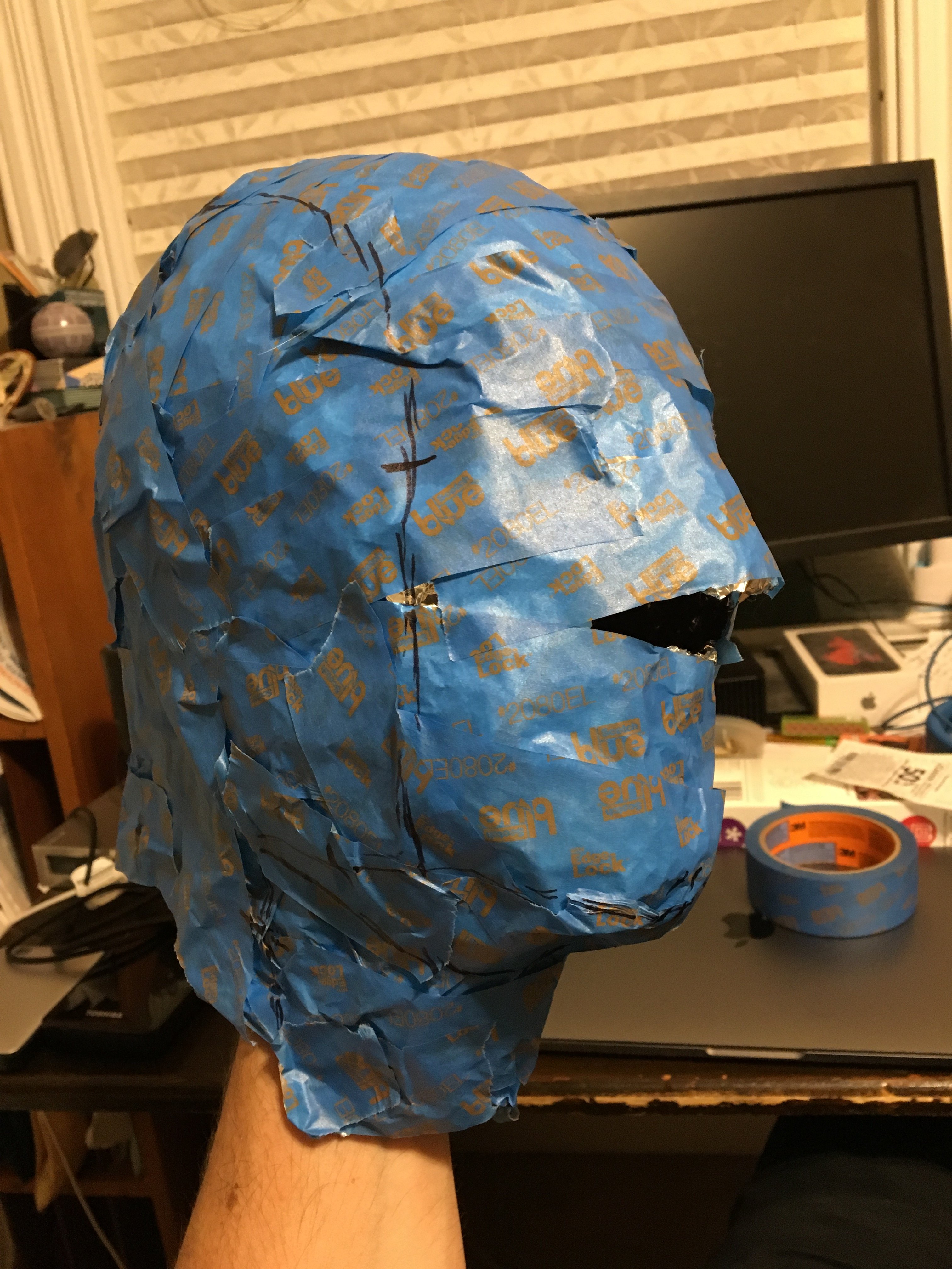

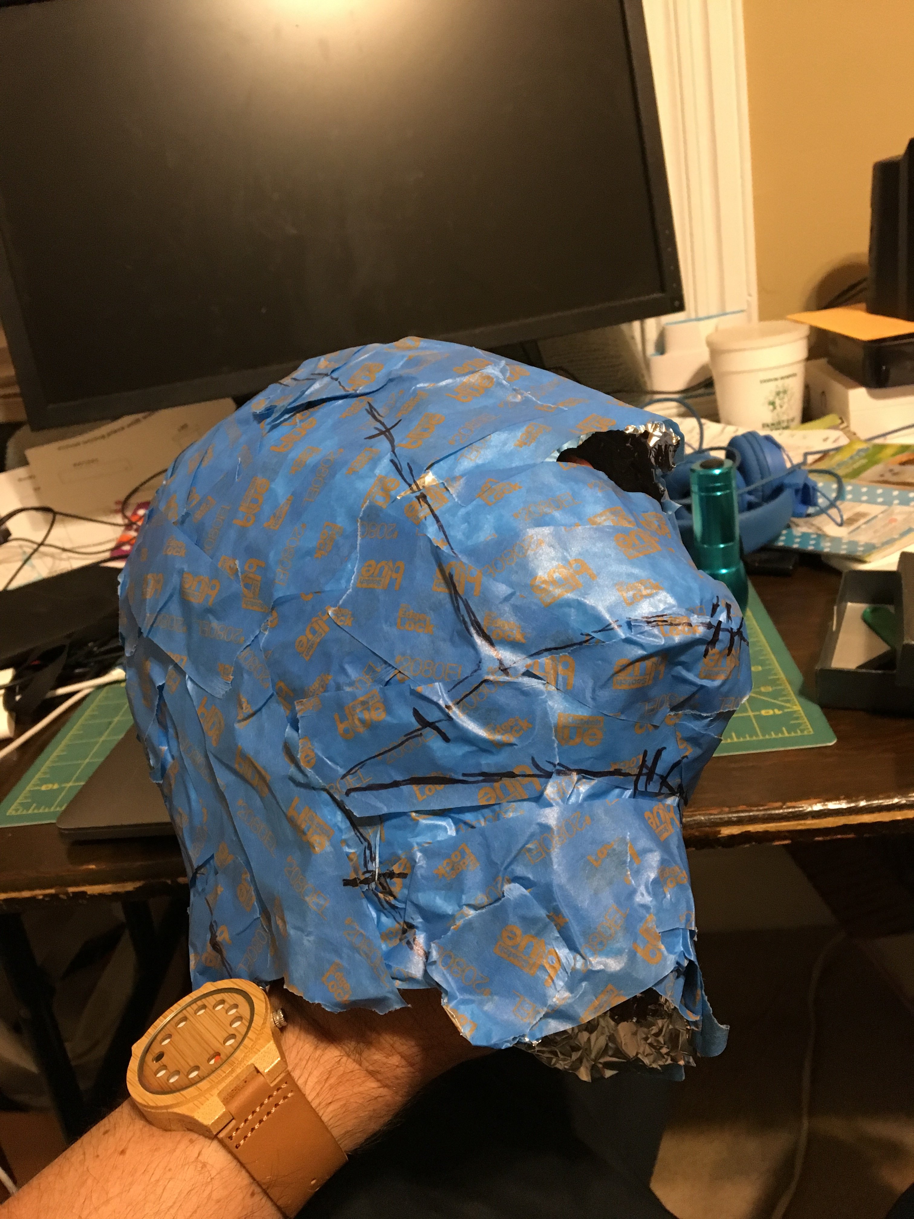

Yet another challenge! First, the shape. It was hard for me to find a good full-mask pattern. I ended up making a pattern by covering my head in tin foil, then covering that in tape, then cutting it apart and spreading the pieces flat.
Sewing it, I kind of screwed up in a variety of parts and it was really annoying, but ultimately I got the shape right. Here you can see that despite the precision I tried to achieve with the tape-and-foil mask, I basically ended up with a shapeless bag, and to shape it and pull it in multiple times. Also, the neck could be longer.

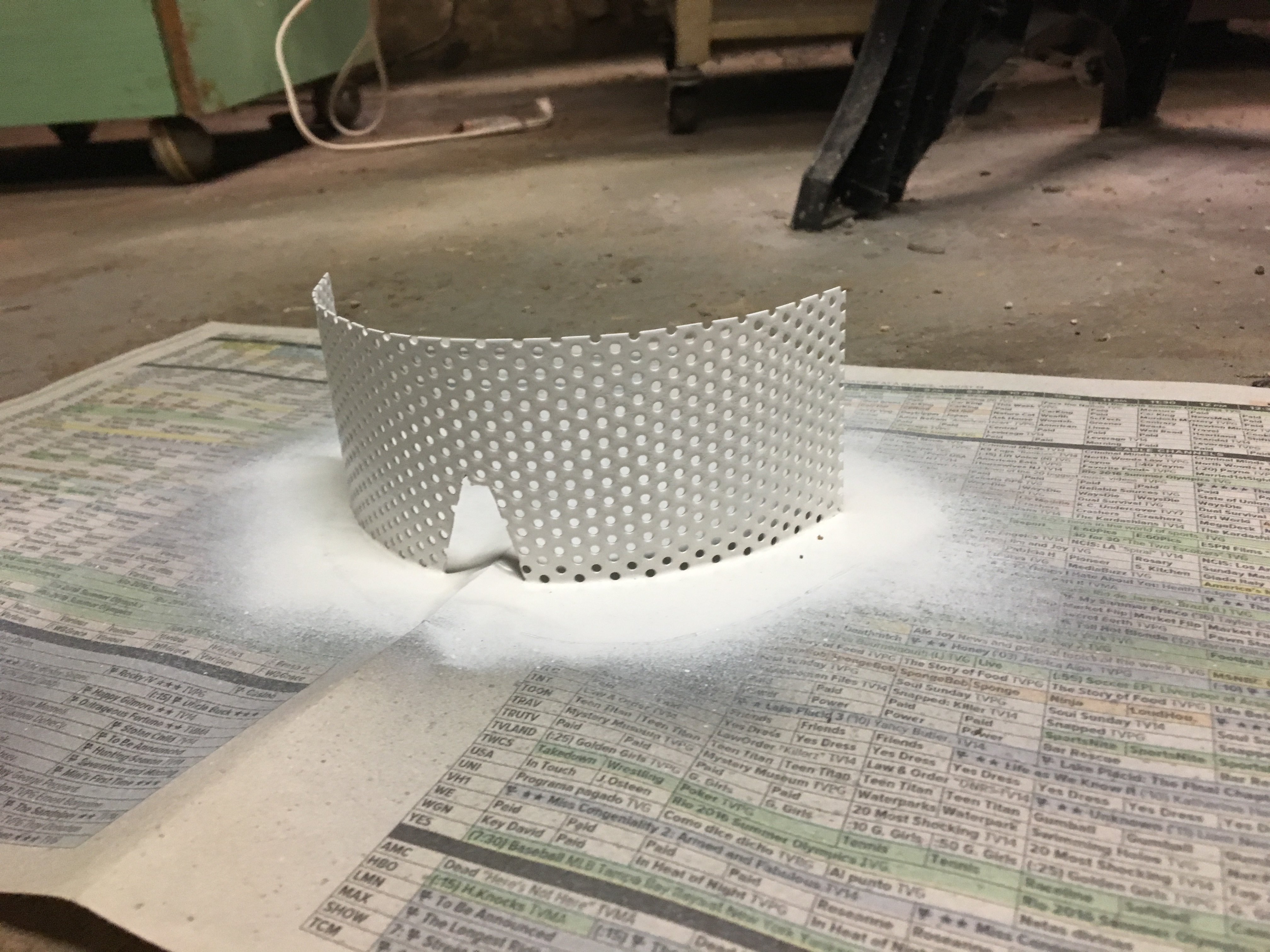

The eyes were another problem—how to make the eyes opaque white on the outside but be able to see through them easily? After researching how people did the eyes on Spider-man and Deadpool, I got some sheet metal with small holes pre-drilled. I cut the metal in a rectangular shape, minus a triangle hole for the nose, then painted it white. It worked very well—I could see out easily, and they looked white from the exterior. Then I cut out the eye holes from the mask and glued the metal in place to the fabric (a little to the side, annoyingly, but it worked out).

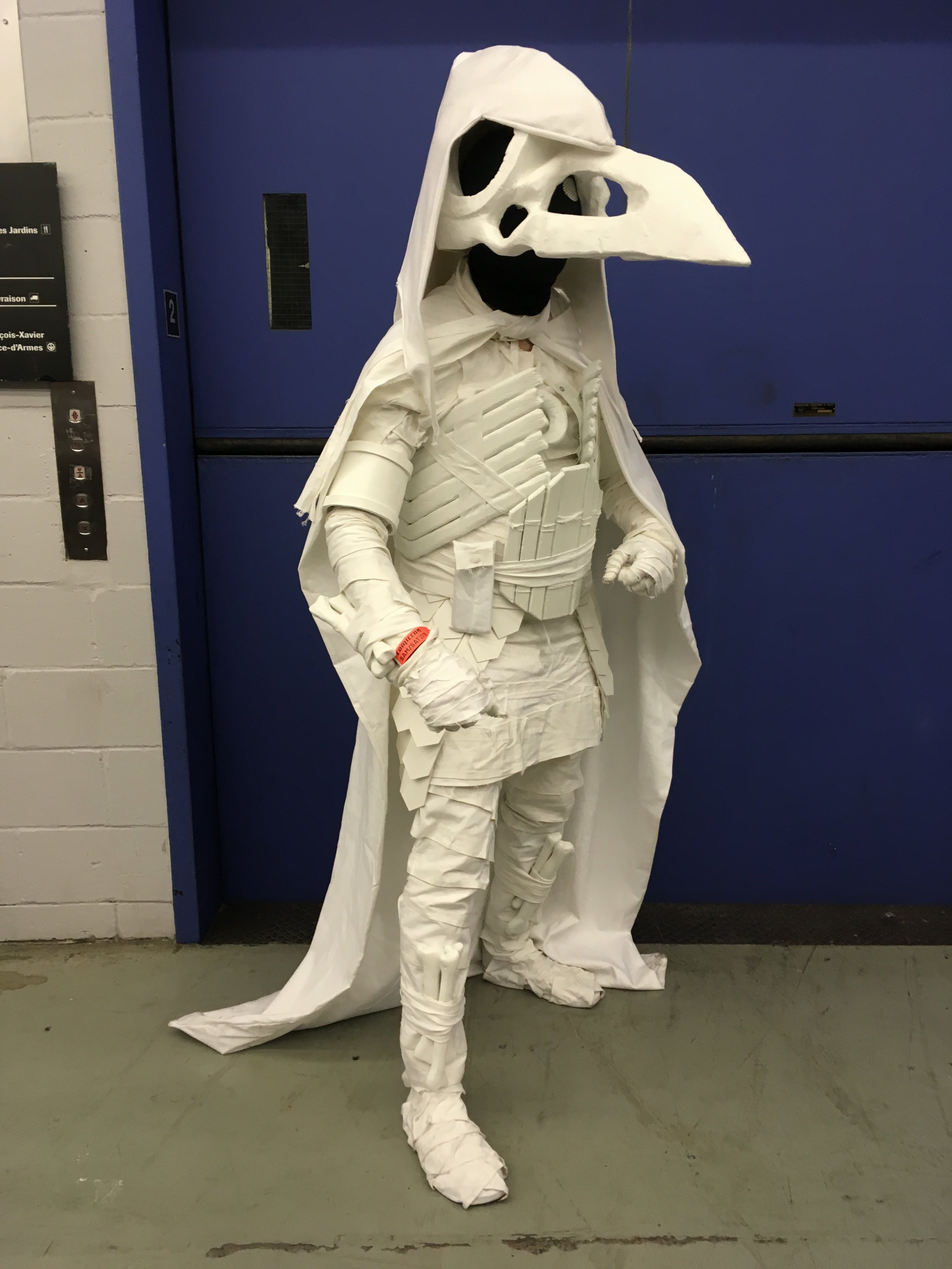

I have worn it at DragonCon, New York Comic Con, and the Montreal Comic Con, and have been happily surprised at how many people actually recognized the version of the character, which only appeared in one issue, and then once again later in a dream sequence. (Some people thought I was actually Khonshu, Moon Knight’s god, who has the same head, but he wears a business suit.) The coolest part was that I met Declan Shalvey, the artist who designed the costume, at NYCC. He was very enthusiastic and positive about the costume and took this photo.
I have a couple minor irritations. The skull looks a little large on my body, but it’s basically the size it has to be to fit my head, and then keep the rest of its own proportionality. And the different whites in the costume (the fabric and the paint) can look quite different under different lights. Basically, in sunlit photos, one looks white and one looks cream. But in indoor lighting (and I think to the eye in sunlight) the whites look the same.
Below: two pics in indoor lighting, then two pics outdoors in sunlight.
I hope you enjoyed this. I am quite proud to have brought this to life and to have expanded my capacity as a maker in several ways. Any thoughts or advice are very welcome.
