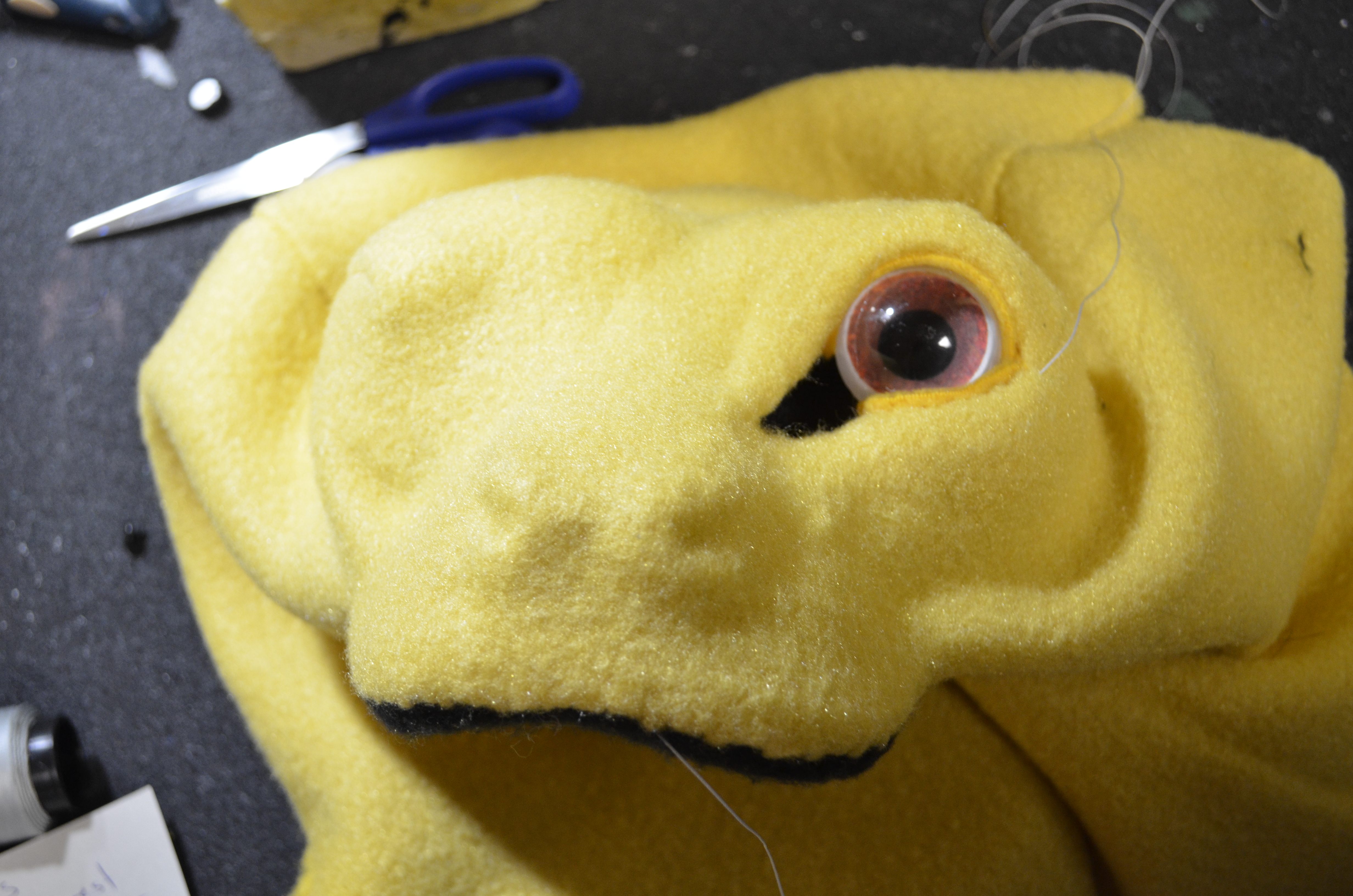

I cleaned up the resin sculpt and covered it with Antron fleece from Puppet pelts and NFT hair from Hairymann's closet, then gave him an airbrush to add some depth to his face and blend the hair and fleece.

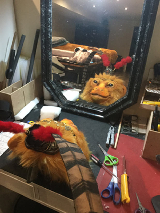

Traditionally, Wukong is often represented in Peking opera with a large pheasant headdress/crown. I decided to add one to make a classic silhouette. I did not think I could find long enough pheasant feathers (nor would they be very durable), so I decided to make my own.
I cut 14 gauge wire to the desired length I wanted, then used some cotton twill to make the feather. I used e 77 spray glue and folded the fabric over the wire twice to make a thick and sturdy fabric base with the wire as the core. The fabric was then cut to make a more feather looking shape
The feathers were painted with a tan spray paint, then hand painted with tulip fabric paint to get the distinctive V chevron shape of the pheasant feather.
I cut some triangles of red faux fur and folded them over the bottom edge of the wire, then used scissors to trim the fur to further accentuate the shape.
The crown was made with foam and coated in Worbla. I painted the crown with black and gold dry brushing, then painted the gems with a red acrylic. the edges were finished with some trim similar to that used on Wukong's boots. Holes were drilled into the crown and the wires from the home made feathers were installed and epoxied into place.
A Tee nut was installed in the head where a screw could be put through the crown and attach to the head.

I decided Wukong was a little wide-eyed for my liking, so I used a 2 part epoxy putty to make some larger eyelids. The eyelids were painted to match the fur and the head was further painted to give him a more cheeky expression. I found his head was also a little large in test photos, so I trimmed his fur down a bit further to make his head a little smaller and his hair a little less wild.
