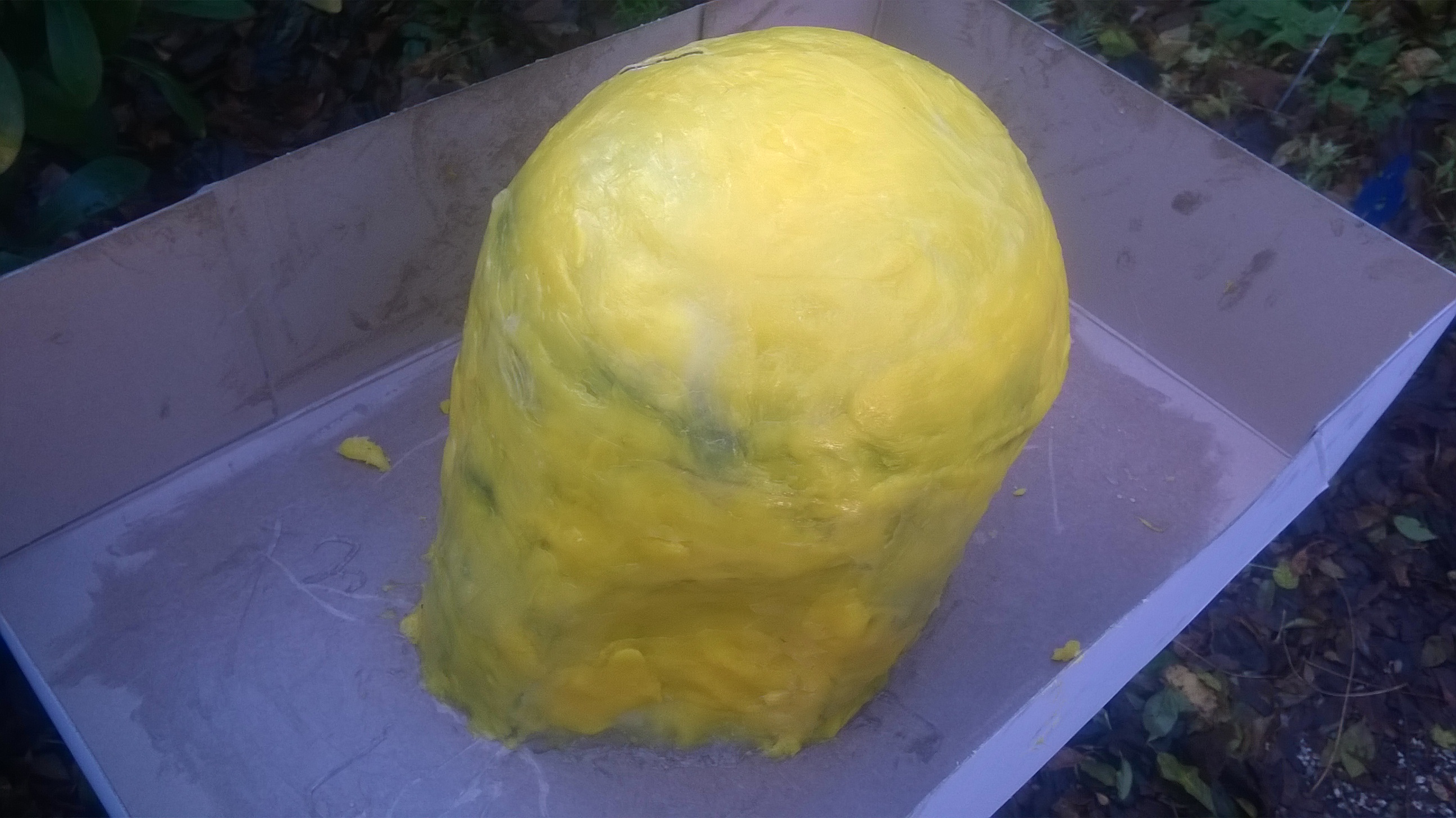

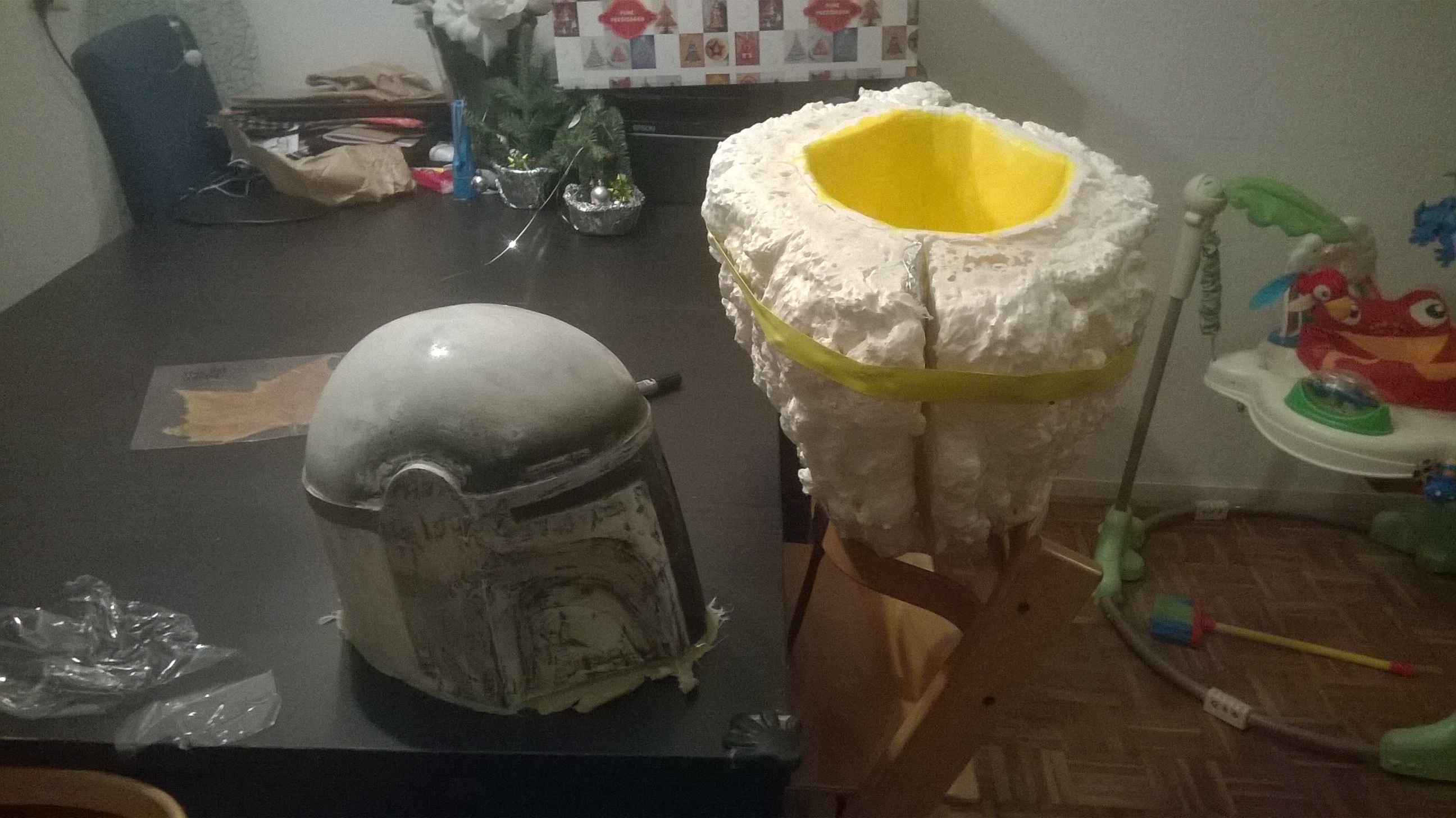

First pic is of the mold ready with the Mohawk on, ready for the mother mold.

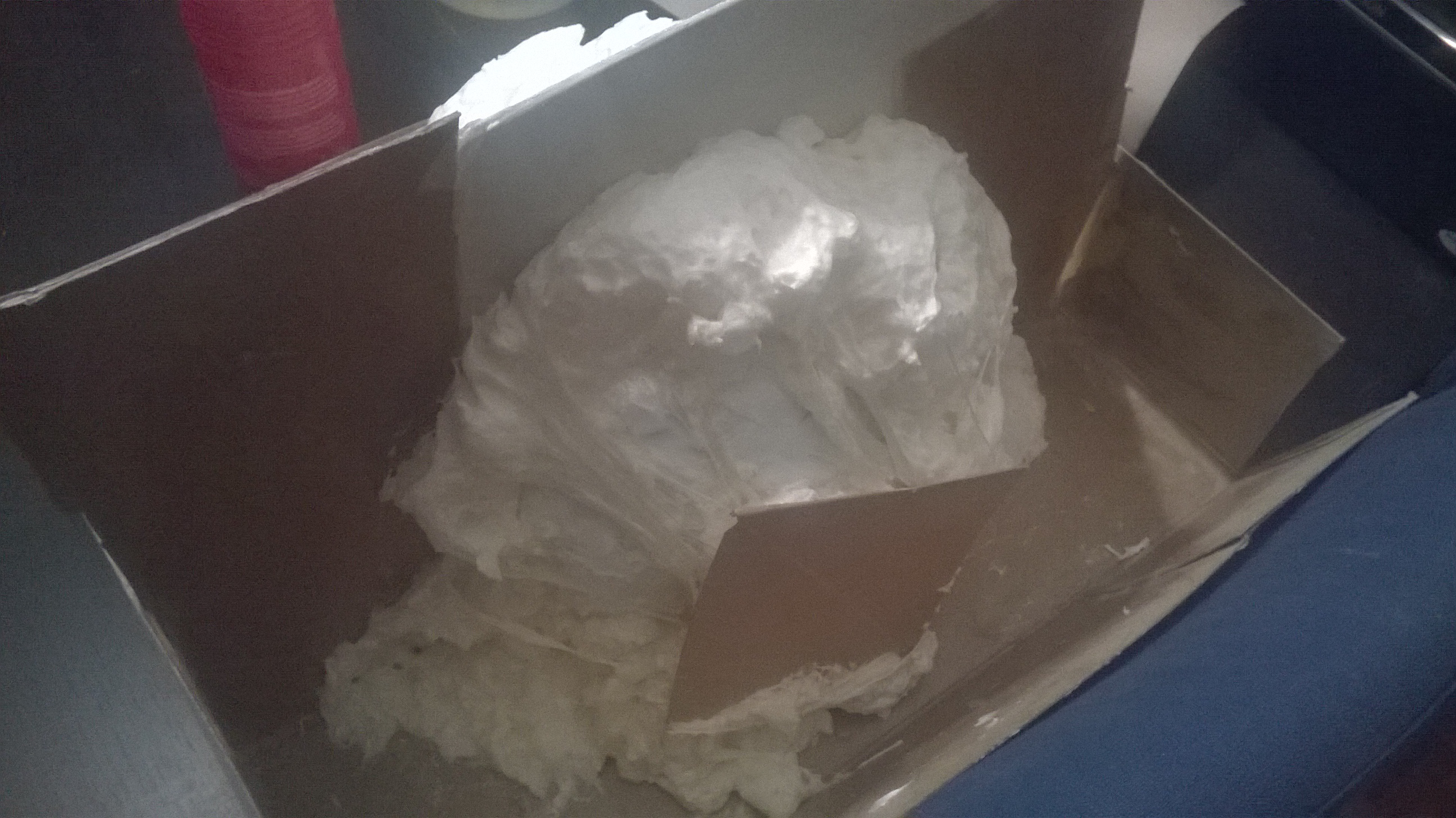

Second pic is is my first attempt making the the mother mold using expandable foam. I ****ed up this part. When I bought the foam I forgot to check if the spray nossel was complete, it wasn't. So I had to improvise spraying it on. It didn't work as I intended. I hope I used enough Vaseline so I can get it of for a second try.
I will be buying new foam tomorrow after work but ain't sure when i have the time to make the mother mold a second time. Probably somewhere next week.

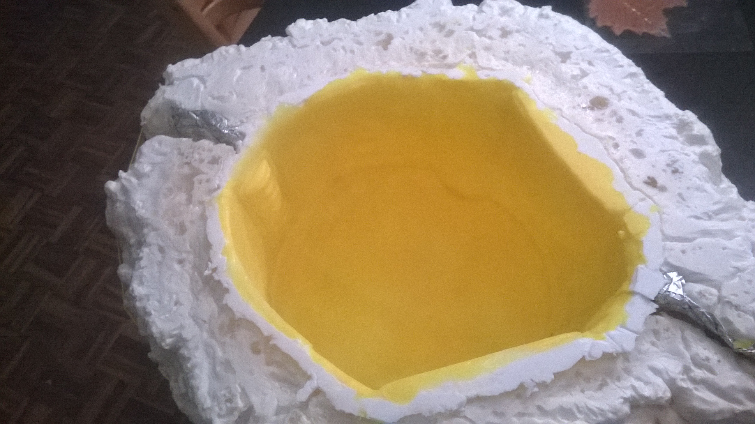

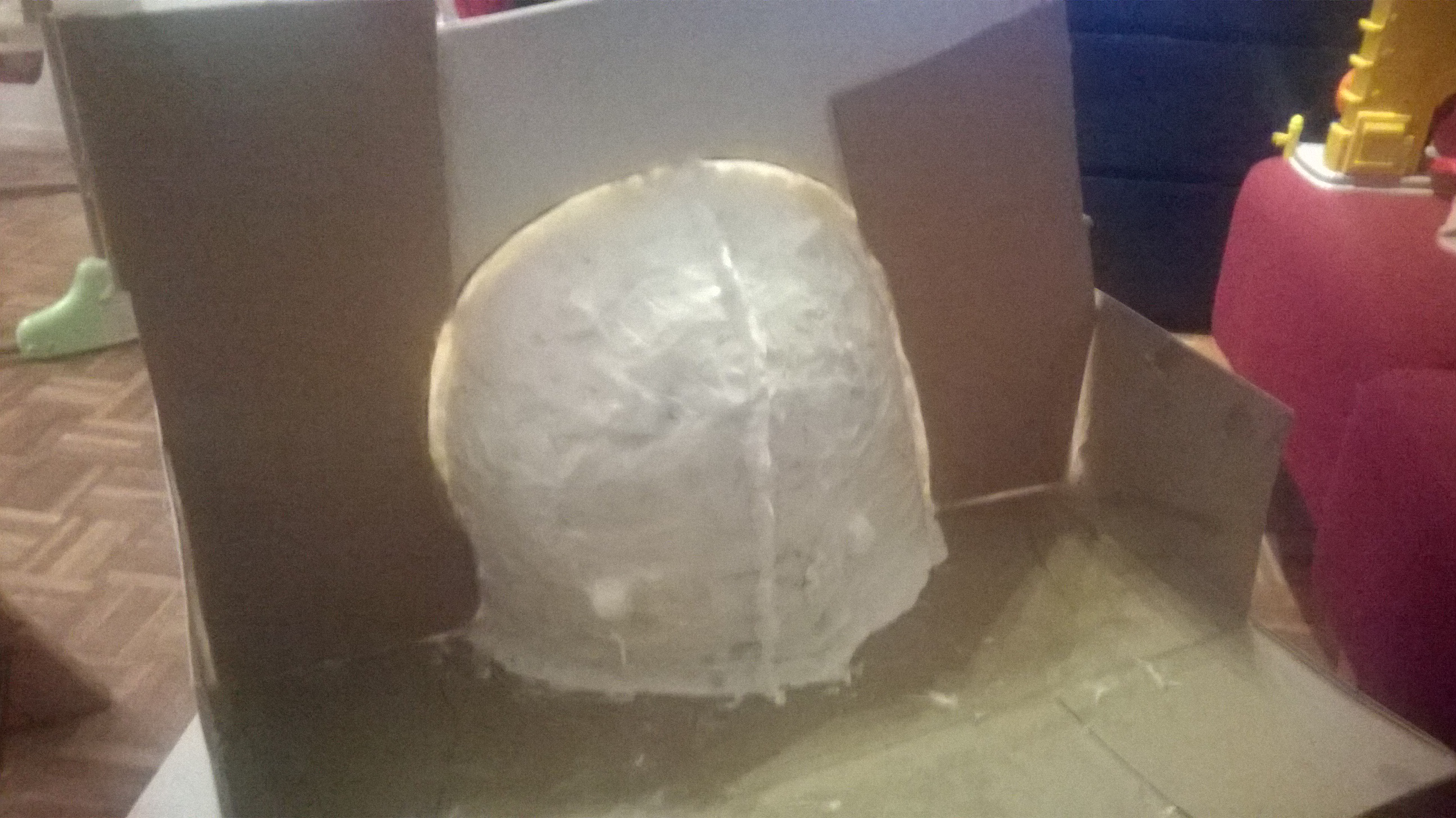

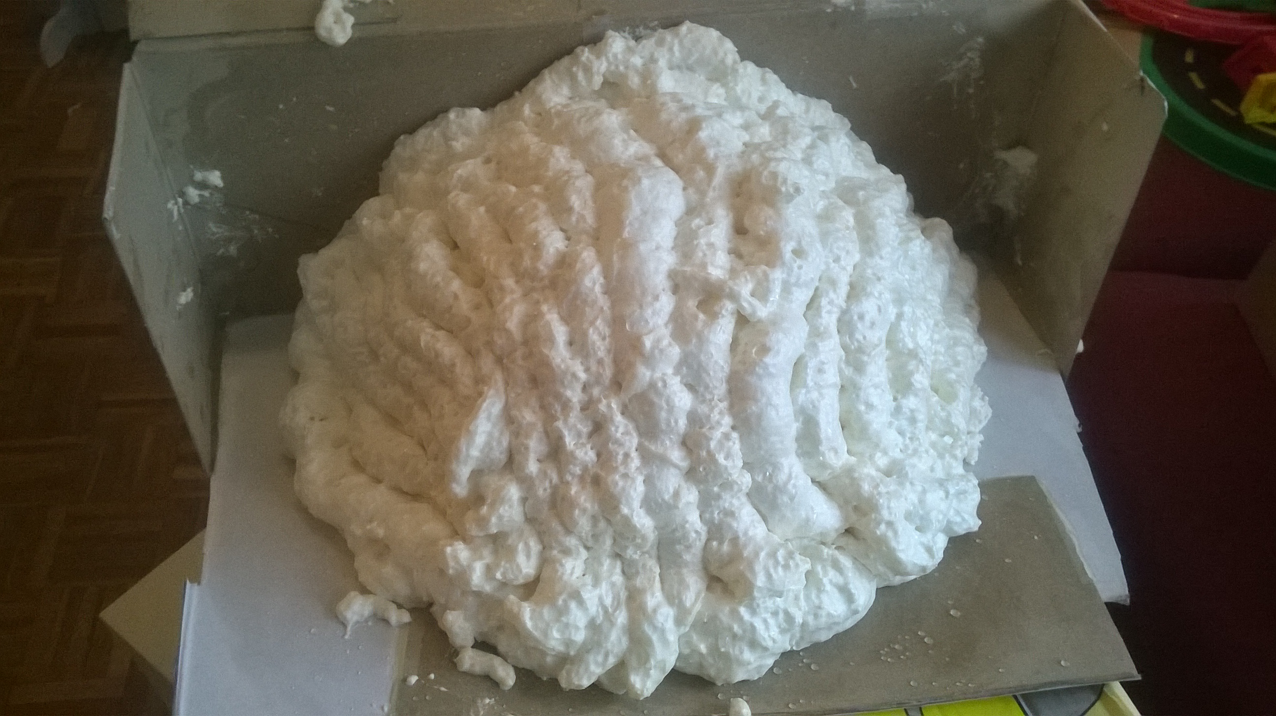

Second attempt at the mother mold. This time I'm going to make the different sides one at a time instead as the two at once. This allows me to position the mold on its side so the foam won't slide of as I did the last time.
Learning from my own mistakes is quite fun. I learned a lot about using expandable foam for a mother mold. The foam follows the glove mold quite good and the mold becomes quite rigid when dry.

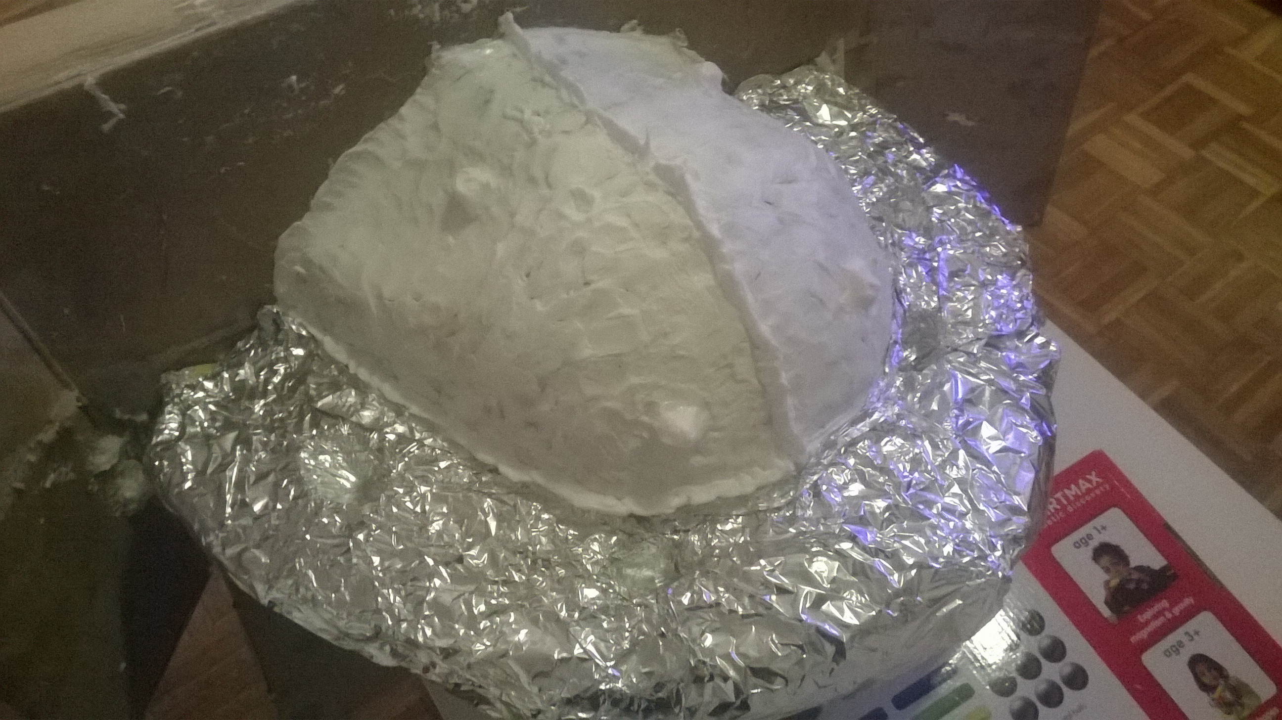

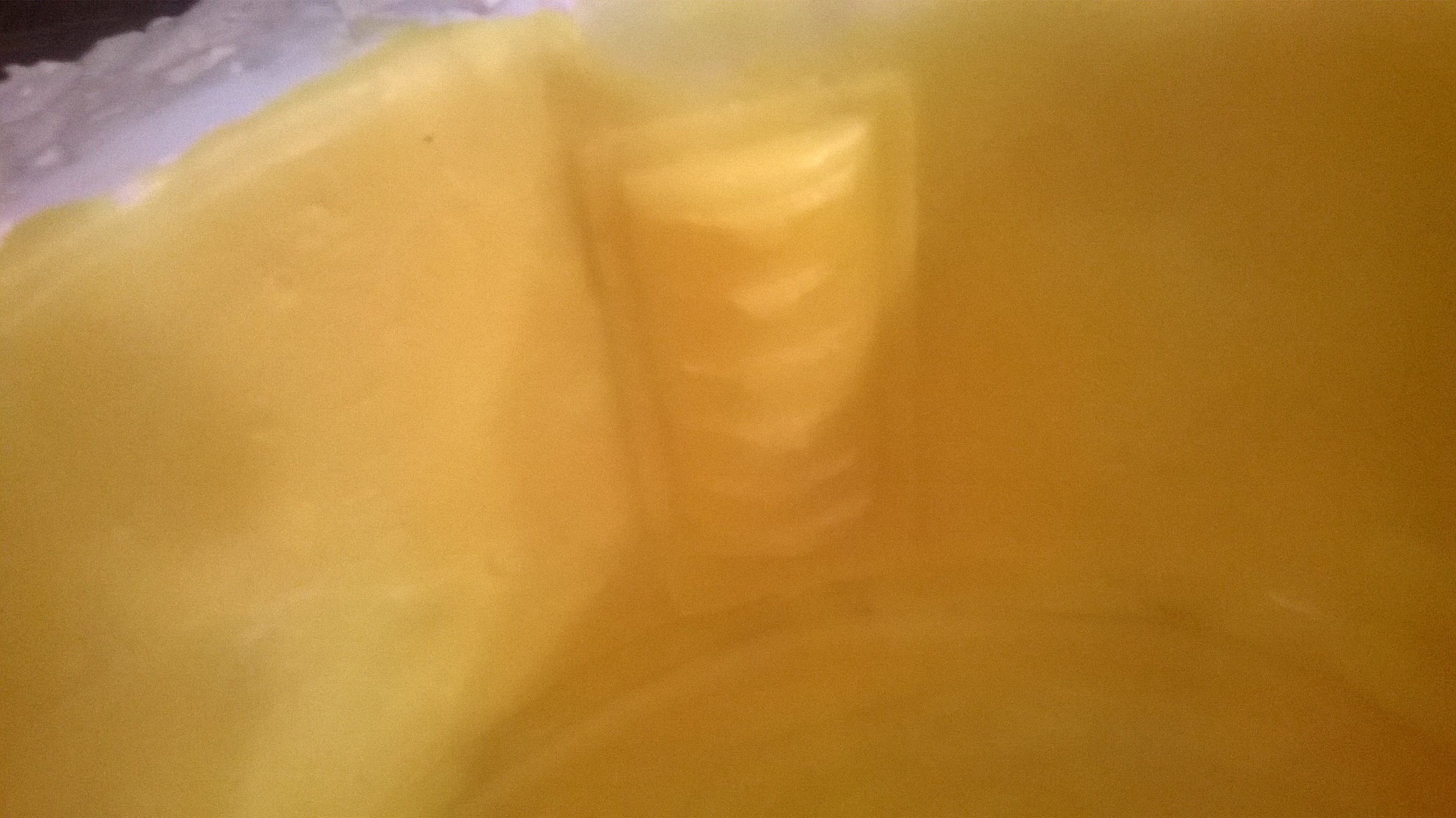

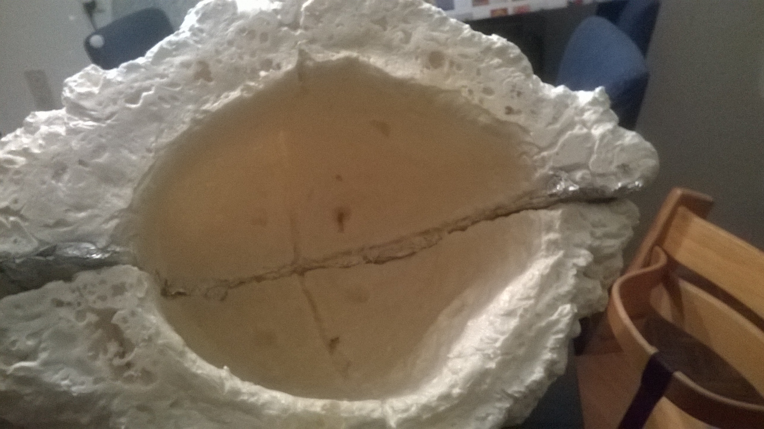

First pic is one finished side of the mother mold. I used aluminum foil as a barrier to make the second side. I couldn't use the "mowhawk" I put on the sleeve mold because the expanding foam didn't cure straight. I used the opportunity to cut some keyholes in side one.
The third pic is the second side drying.
Taking the mother mold of was really easy. I used lots of vaseline on the sleeve mold and the cardboard box I used as a base.
The second side of the mother mold warped a little, bit luckily not to bad. The fit together good enough to hold the sleeve mold right.
The last few pics show the sleeve mold in the mother mold and a detail pic of the key slot.

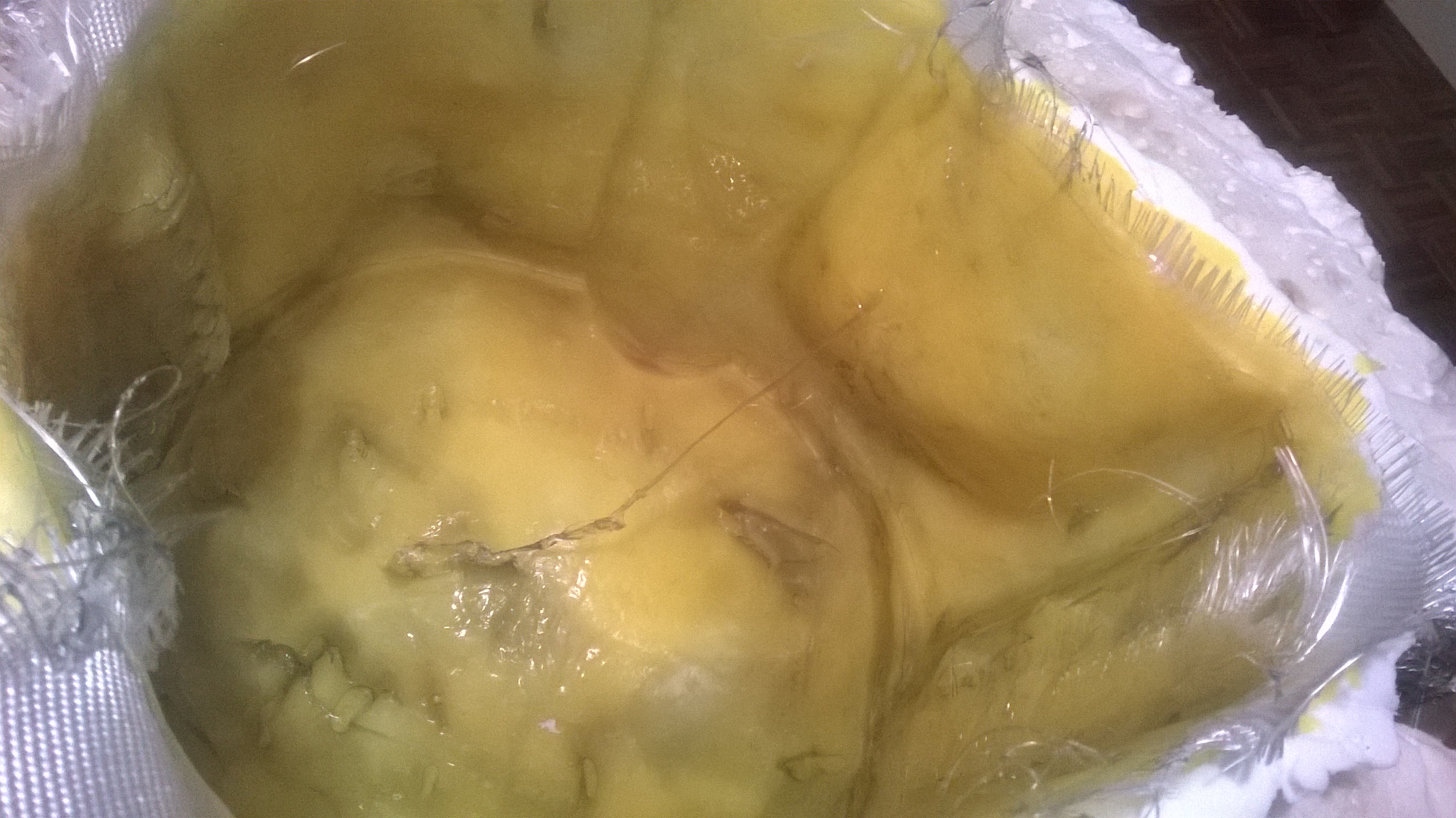

This was also the first time I've seen the inside of the sleeve mold. It really isn't perfect. The imperfections in helmet I molded can't be seen but there are new imperfections within the silicone. But the are easier sanded of the cast than filled.
All in all I'm pretty proud of my first ever mold. It isn't perfect, not in a long shot, but good enough for a cast or three.

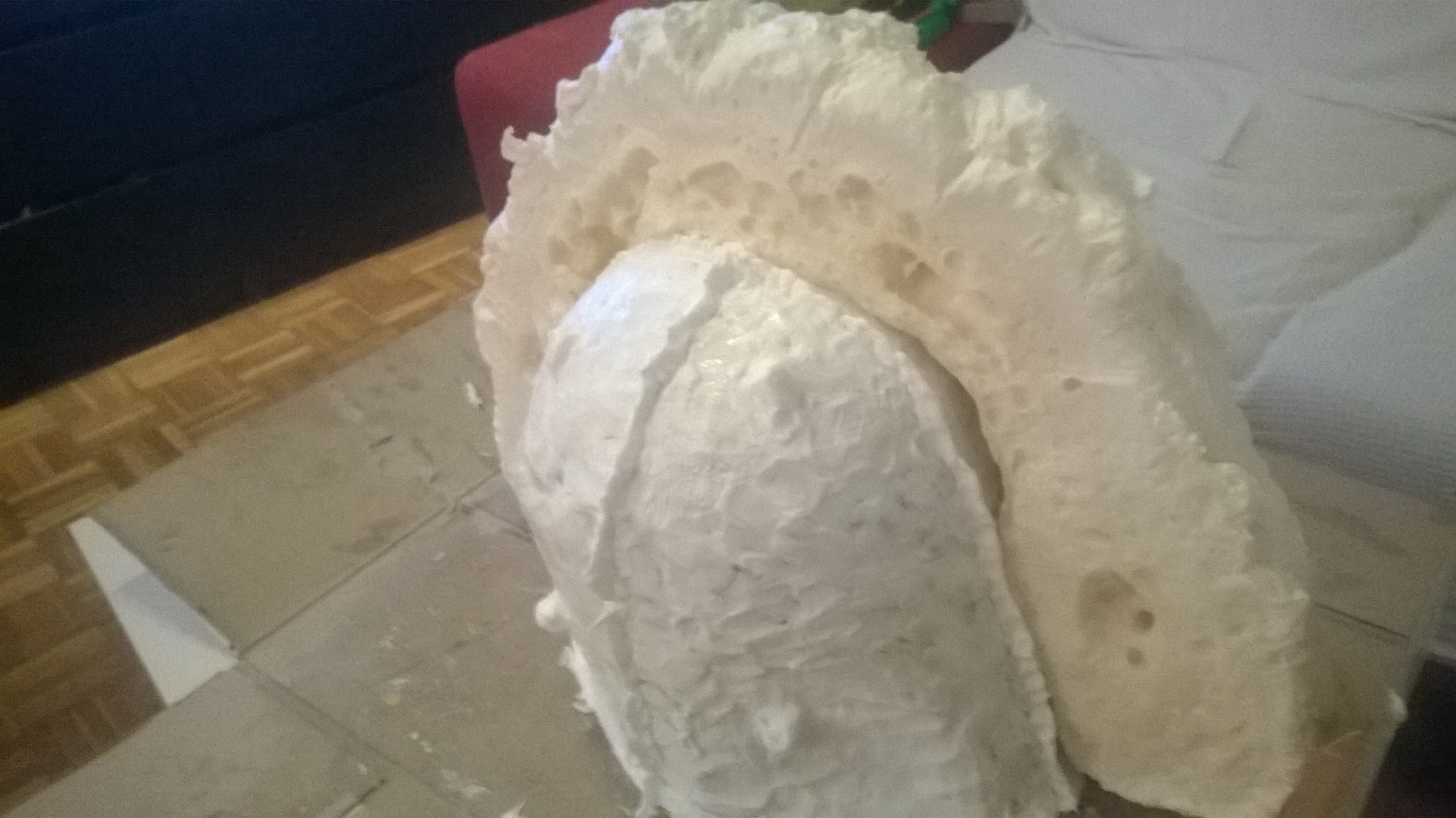

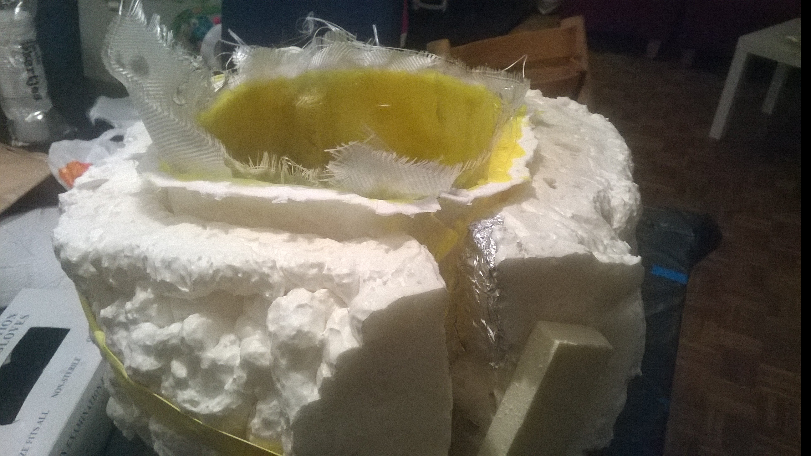

Another update, you shouldn't use expanding foam for a mother mold, it shrinks. It shrinks a lot as you can see from the pictures. I'm making a fiberglass mold just to see how it turns out but I think I need too make a mother mold from fiberglass because the mother mold I have now will probably no work as intended. The sleeve mold warped in using the mother mold I got now and I had to use pieces of xps foam to resize the mother mold to get a decent shape.
I've got two layers of fiberglass in and am waiting to see how it turns out.
