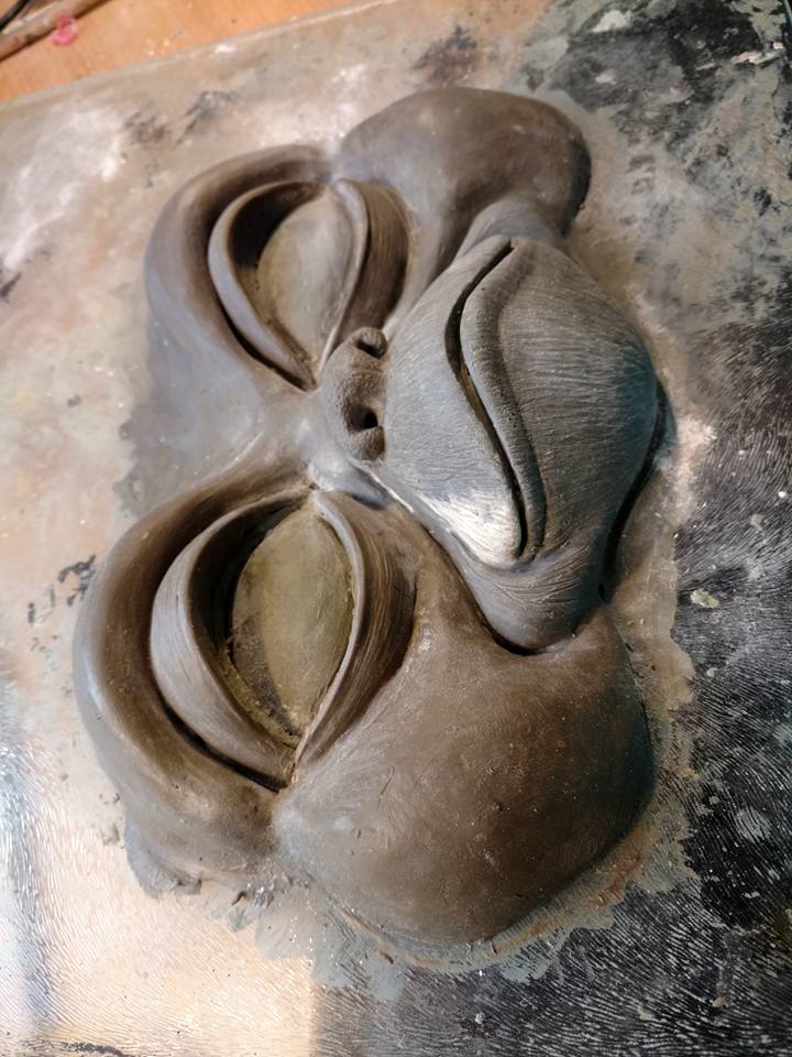

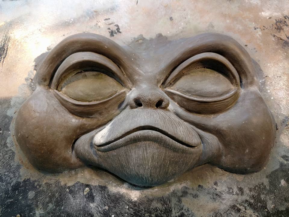

Currently in the blocking out/rough phase of the face. I thought Gizmo would be easier but he's proving to be quite tricky and probably will be more of a challenge than the Gremlins. Shapes are still changing. I've also added the brow and cheeks even though these will be hidden under fur. These forms will allow the hair to fall and lie the same way as the original Gizmo's fur. This is the area where I will have to do a lot of hand laying and flocking. I will be swapping the eyes for solid blanks that I will paint up.

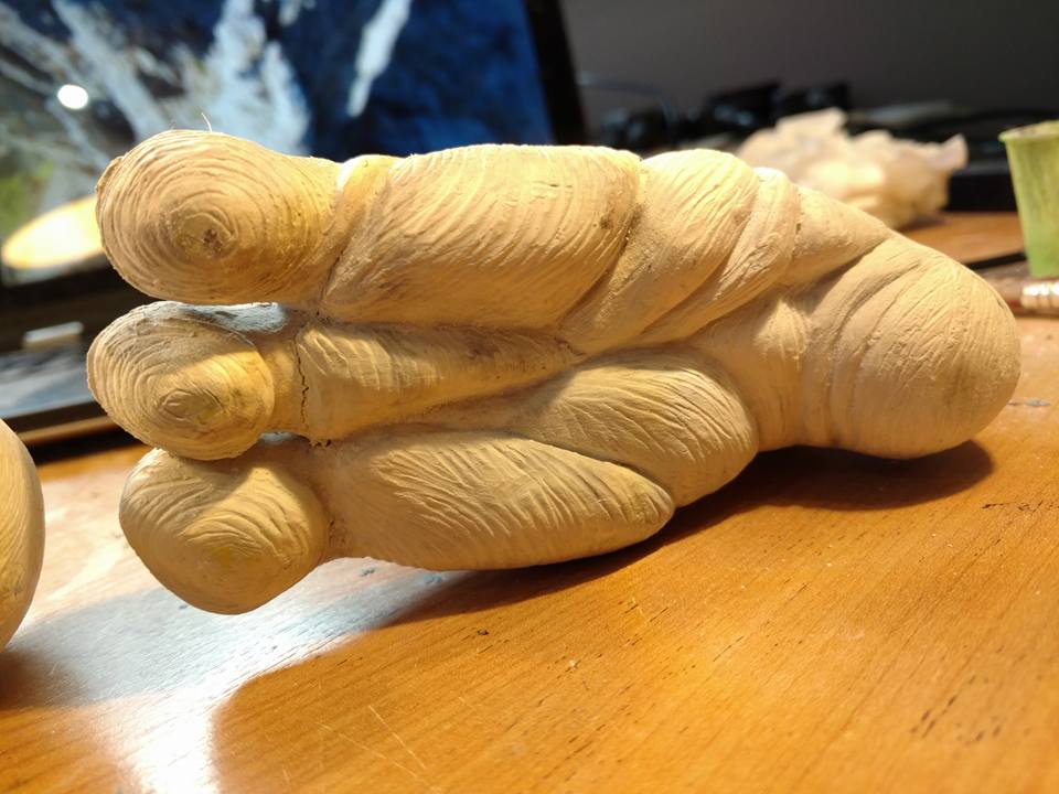

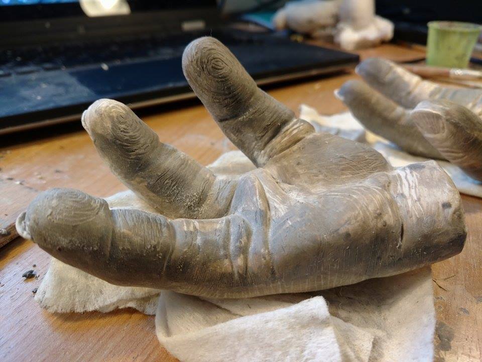

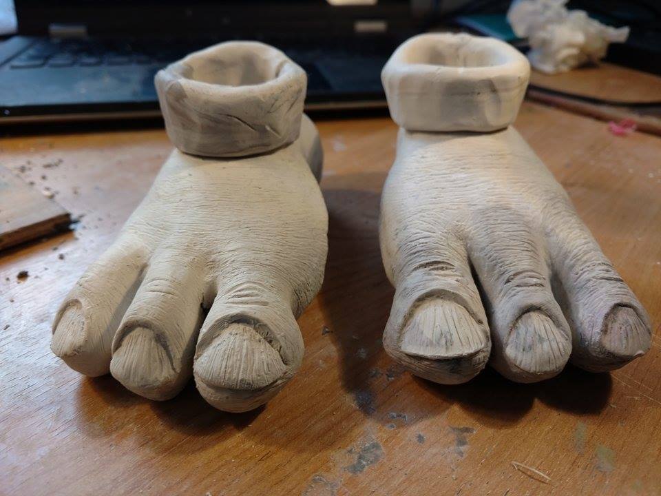

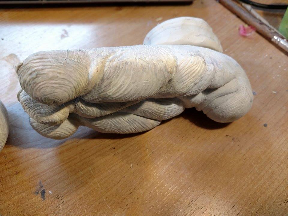

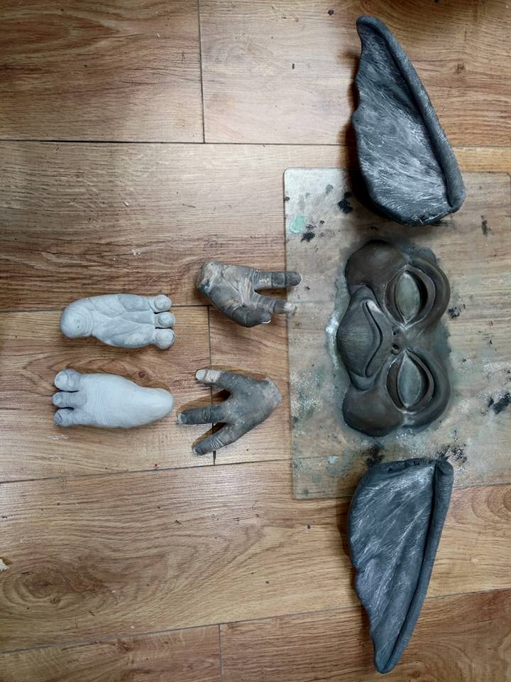

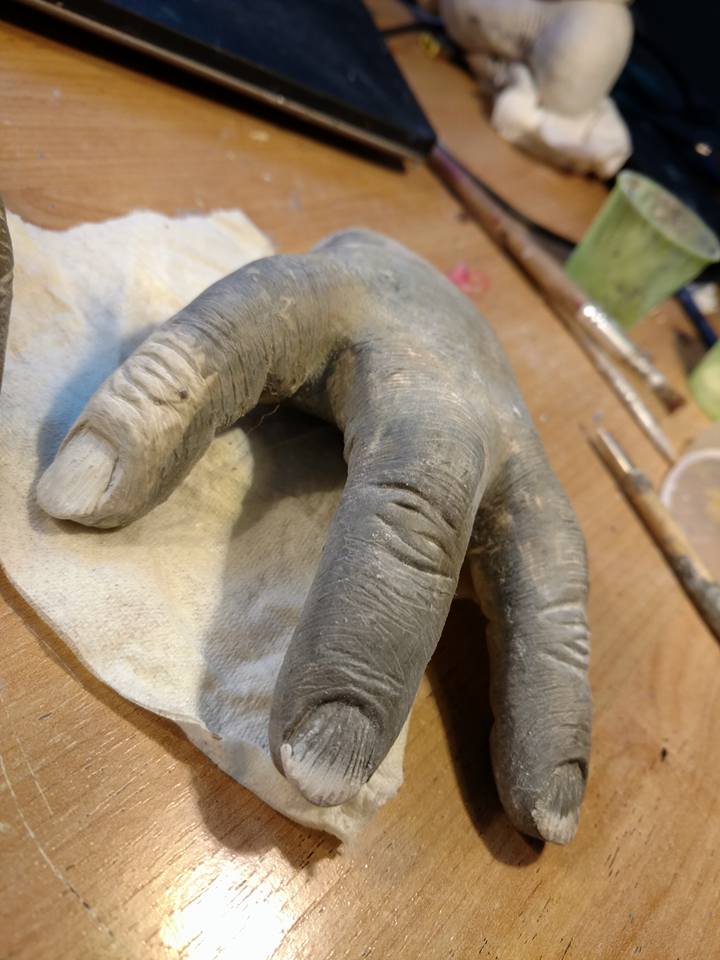

So the sculpts have been completed now I found some time between work and what not. I also purchased some great detail tools from Kens Tools or PS Composites (UK supplier) to help with the smaller details on hands and feet.

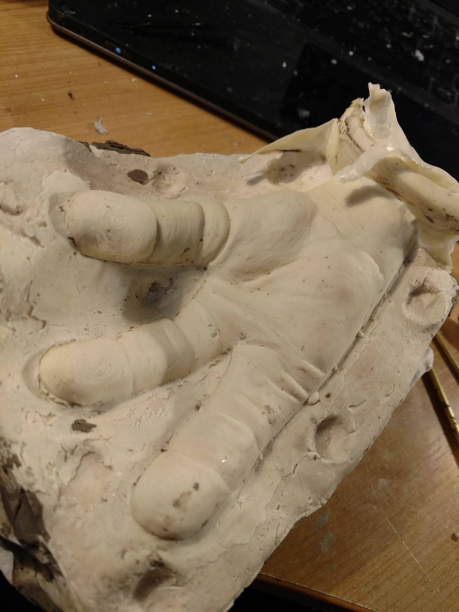

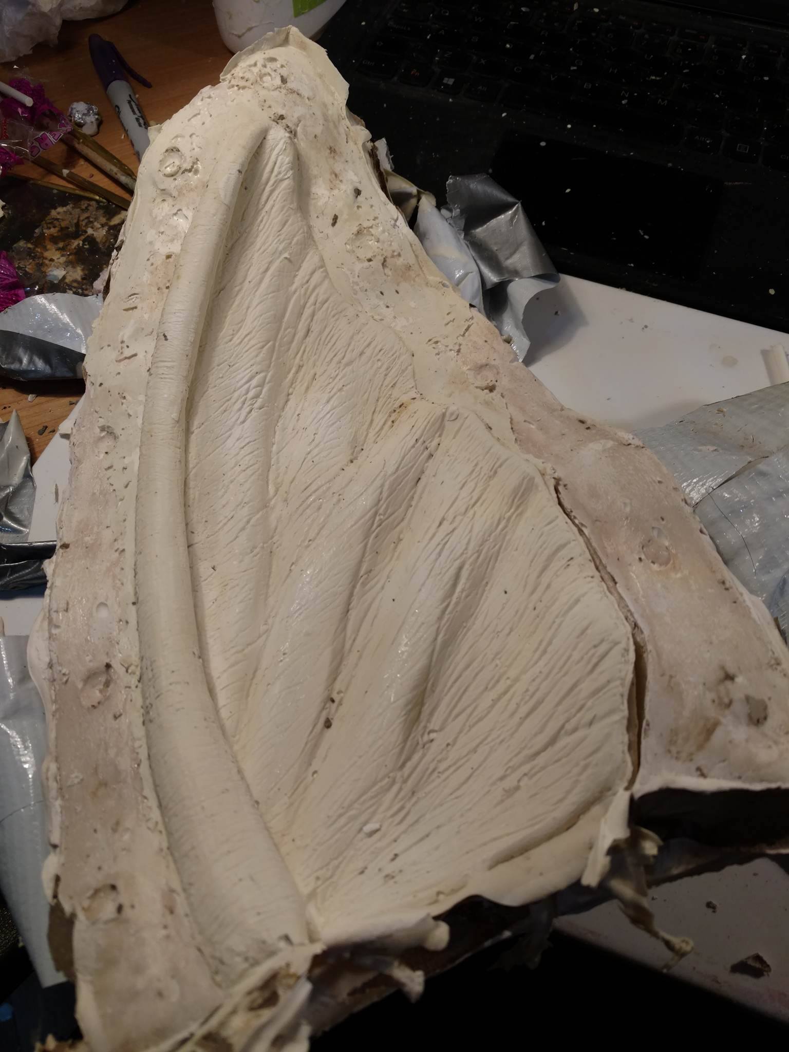

All parts have been mostly moulded in Herculite Plaster. I am doing one in silicone and another in Latex hence the selection of the Herculite for the moulding material. I'm just waiting for the other half of the ear to set and will then mould the last bits.
I ordered the eye blanks which arrived today. Just waiting on the brown fur. The moulds have latex in and eagerly waiting to see how it will turn out.
Next I have to paint Gizmo's eyes, hoping to start tomorrow, and work out the net and proportions for his foam body. I am also looking for images for Gizmo's box that once his is complete he will also live in. If anyone knows of some great links for ref pics, would be much appreciated otherwise I'll be watching Gremlins for my homework tomorrow.

UPDATE:

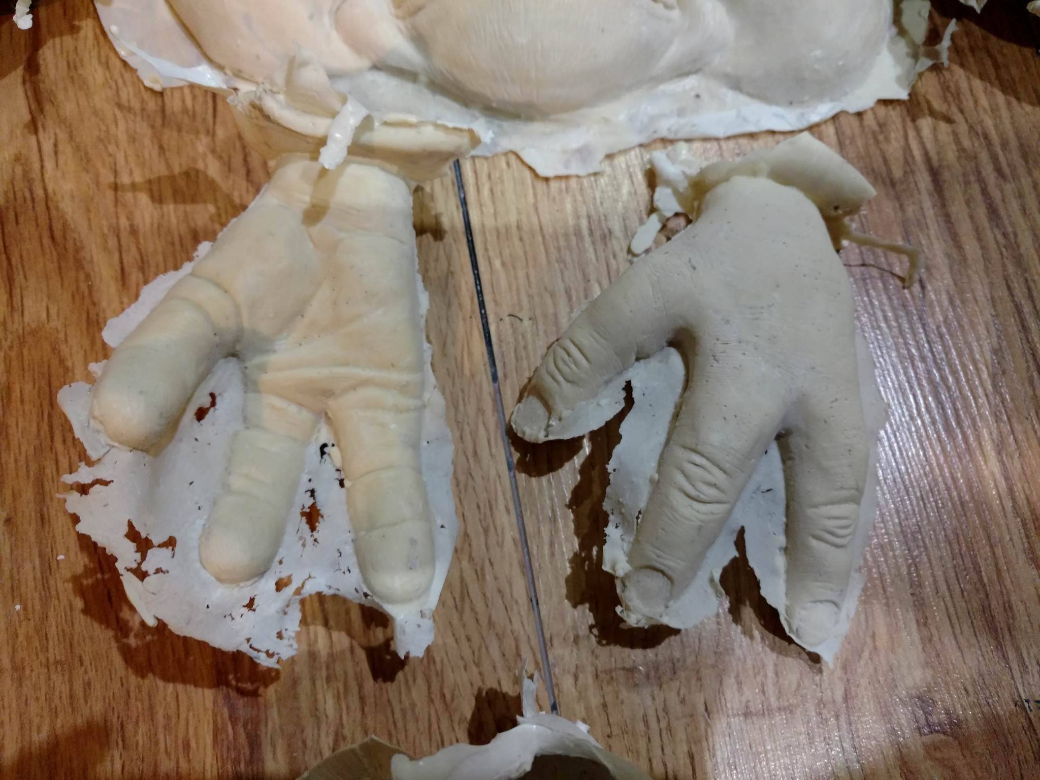

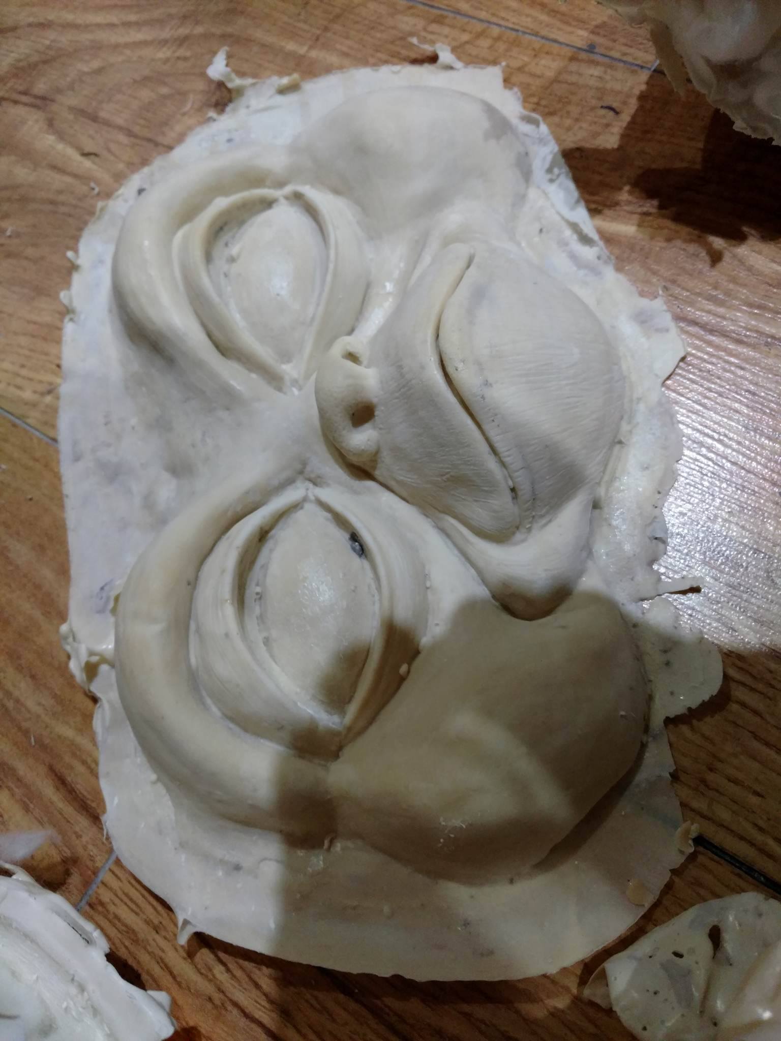

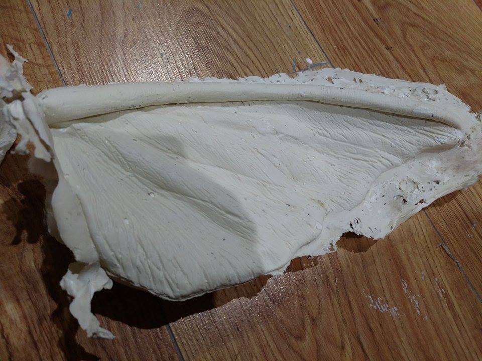

Latex pieces are finally out of the mould! Took ages to dry. The ears were slightly wet inside as I believe this was down to the wet english weather, don't normally have a problem in the summer.
Any tips on helping the 2 part moulds dry faster? Even at room temp they're taking days to dry.
12318422_10153792900869533_1284978477_o.jpg12299717_10153792901309533_353375687_o.jpg
slipped out the moulds well, not too many air bubbles.
12318131_10153792900004533_1985560354_o.jpg12312183_10153792899569533_543170624_n.jpg12311713_10153792900579533_52018318_o.jpg12297793_10153792900179533_1556670117_o.jpg
Now to seam and fill up the lil tiny air bubbles here and there. Will also be doing a silicone copy of Gizmo too, so next step is to mix up the silicone and put in the moulds.
