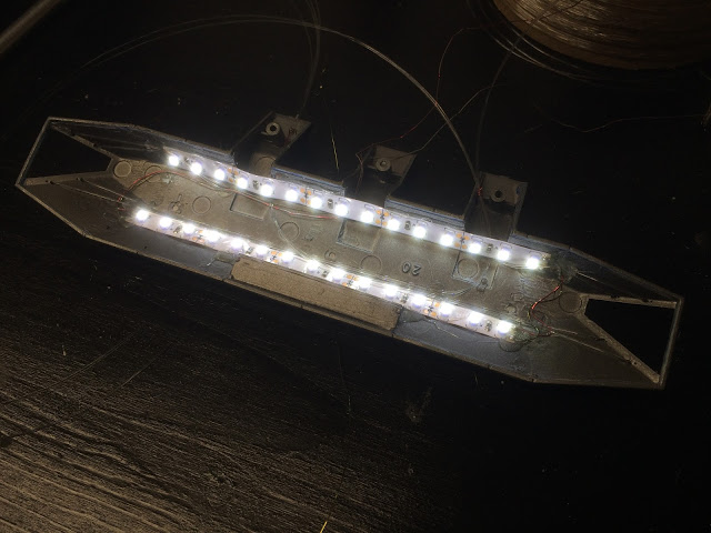

The upper landing bay strip LED layout
Good light coverage once assembled

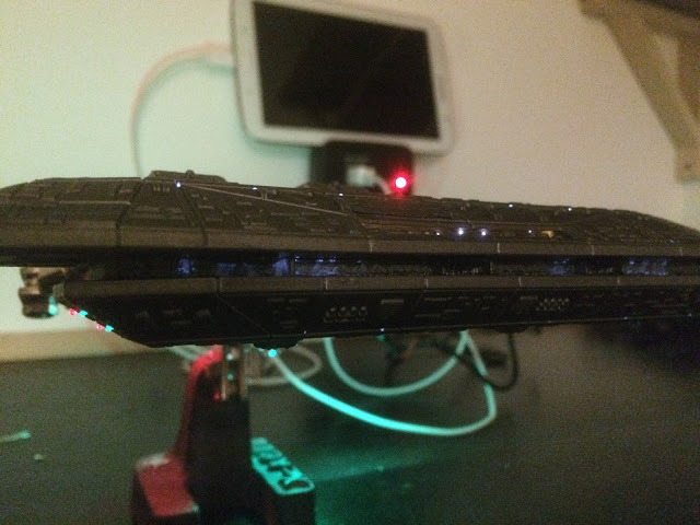

The ambient light transmits well through the hull opening I drilled

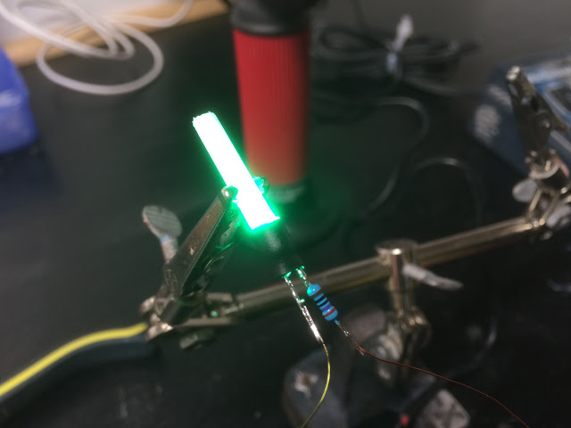

I added fiber optic lighting for the flight pod approach lights.
I used 3mm coloured LED's (green/red).
The LED's were placed inside a 1/8th inch (ID) styrene tube and locked in place with heat shrink tube.
The fiber optic strands were .5mm and were secured inside the styrene tube with 5 minute, 2 part epoxy
If I were to do this build again I'd use a mich higher resistor value. The light is good but is too bright to be 'in scale'

Before final assembly the LED tape had to be added, as well as the fiber optic strands to allow for landing light illumination.
The Paragrafix landing bay photoetch is engineered to allow for LED tape to be placed above it in the flight pods. I used 2 strips in the upped flight pod and 1 strip in the lower.
