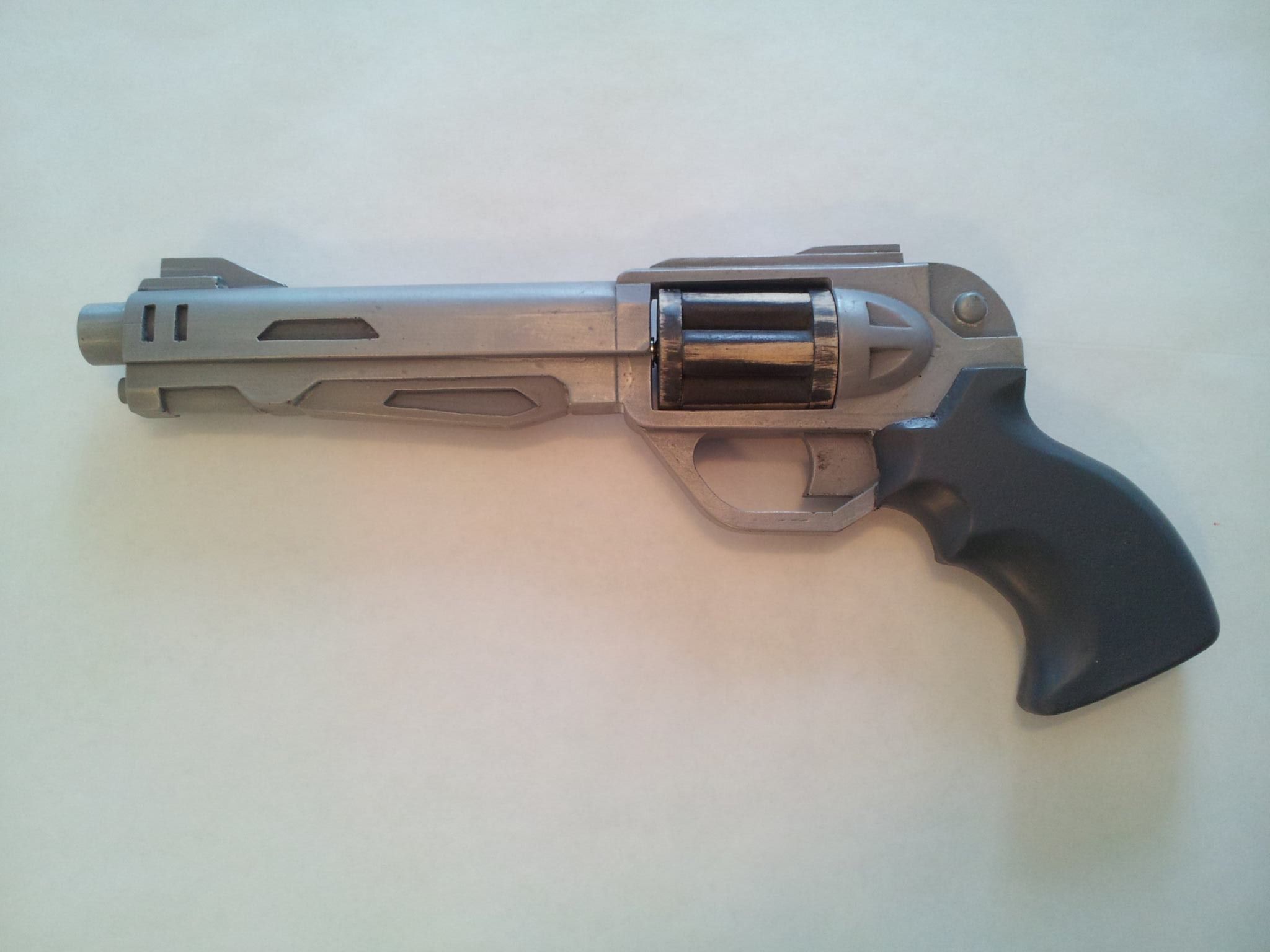

Here is a prop I made for an independent film studio for an upcoming web series. It was inspired by the Jakob's Bloody Justice revolver from Borderlands 2, with several modifications. The master was made from MDF, styrene, PVC, and Apoxie Sculpt. The mold was made from Smooth-On's Mold Max 30 and the casting was made with Smooth Cast 300 with aluminum powder mixed in. The handle was coated with gray Plasti Dip.

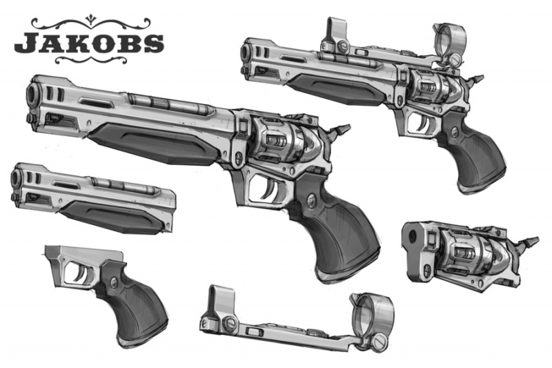

Concept art from 2K.
My prop
My prop
