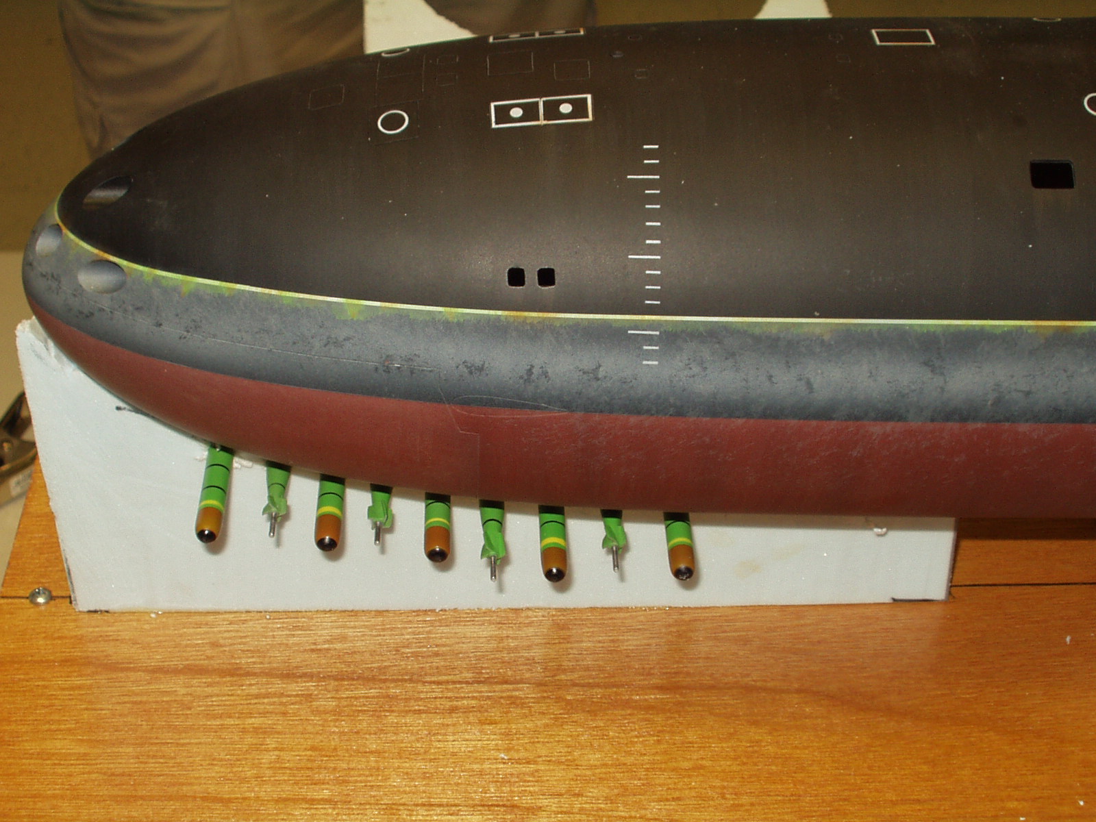

Taz, you mentioned salt. That is a different 'chipping' masking technique where you use rock or sea salt (whichever grain size is appropriate), applied to a (water) moistened undercoat then tweaked by knocking off where you don't want the chips, then letting it dry before painting the top coat. The salt can then be brushed off to expose the 'chip' color undercoat.
The hairspray technique, as I understand it, is where the undercoat is sprayed with the hair spray, allowed to dry, then overcoated with the top color. Because the hairspray impedes adhesion of the top coat it is possible to selectively 'abrade' (rub) areas to create 'real' chips - as compared to the salting technique, which is a masking method.
Obviously, given the variables in chemistry involved, either of these techniques should be tested using the specific paints & materials to be used - before attempting on a model. Besides ensuring there are no adverse effects, it allows for a bit of practice & validation of the results.
Attached is an image of a Typhoon class Soviet sub RC model, by master modeler David Meriman, that shows a combination of 'salt' chipping and a similar "tooth-paste spattering" masking technique. The toothpaste (applied by dragging a finger across a 'loaded' toothbrush to 'flick' it onto the model) again acts like a masking agent but provides for a more subtle effect than the salt masking.
Regards, Robert

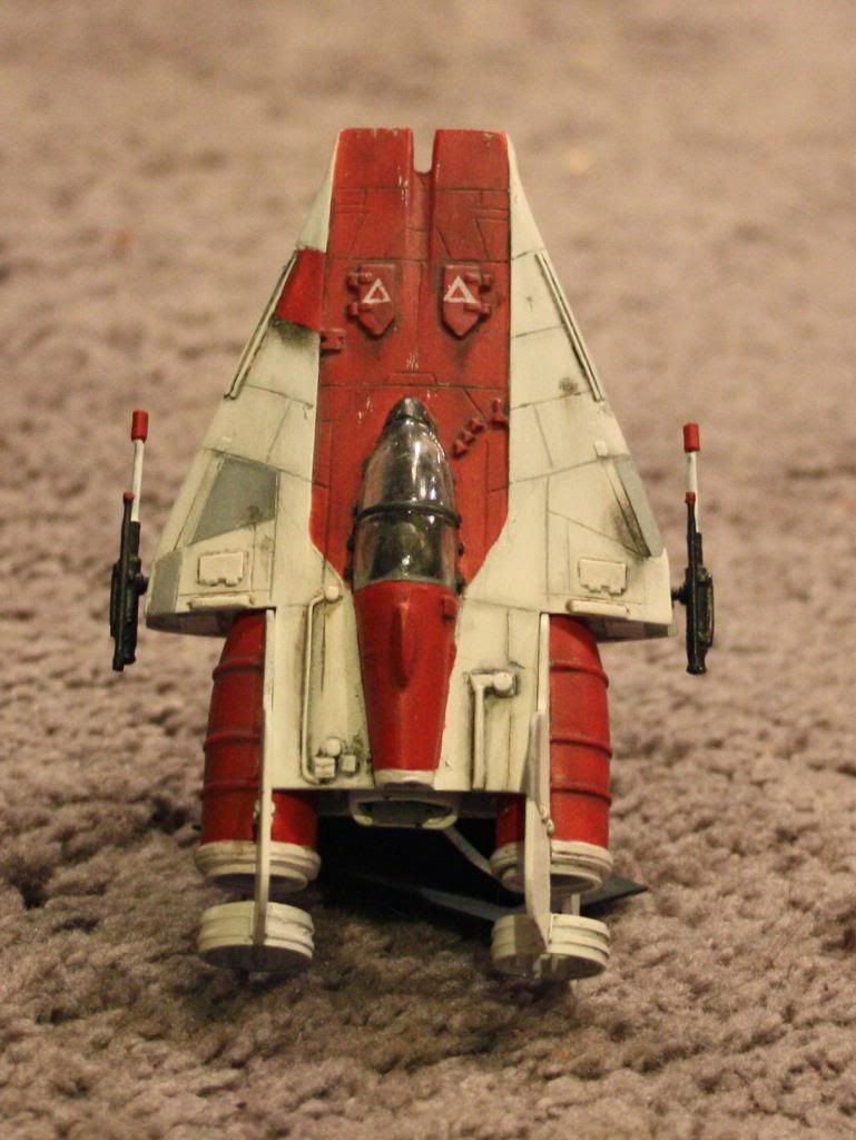

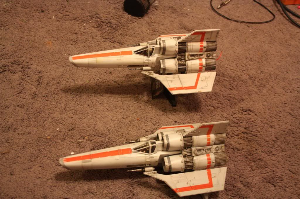

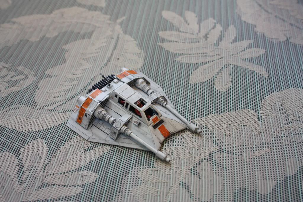

1. If I am lighting it, then yes paint the inside. Actually I find metallic colors over a black base really help light block. I've also used electrical tape and tin foil to light block. Best thing to do is dry fit the lights, and see how much leakage your dealing with and where
2. I often skip the airbrush to do markings. I tend to break it out for cases where I can't find a good color straight out of the can, or I need varying shades of a color in large areas and want a nice smooth transition. However, when it comes to the stripe markings on an X-wing or the panels on the falcon, I will just mask it off and paint it with a regular brush. Especially on smaller scale models where you don't have typically have large flat areas. It helps to use good brushes and paint. I typically use P3 paints for example since they brush on very nicely and cover in just one layer many times. They can be found at most gaming stores that sell Warmachine and Privateer Press stuff. I also add in any chipping etc while it's drying since using an xacto blade or pin. it is really easy to do so and the paint hasn't really adhered to the base yet.
These are all things I painted using colors straight out of a spray can for the base colors, then hand brush painted the markings, and weathered with oils/pastels

Thank you for the input, blakeh! That gives me confidence I can do this with a brush without it looking like a tragedy, lol. You do some really nice work! thanks for sharing those pics...can you tell me more about what pastels I should buy for weathering?
