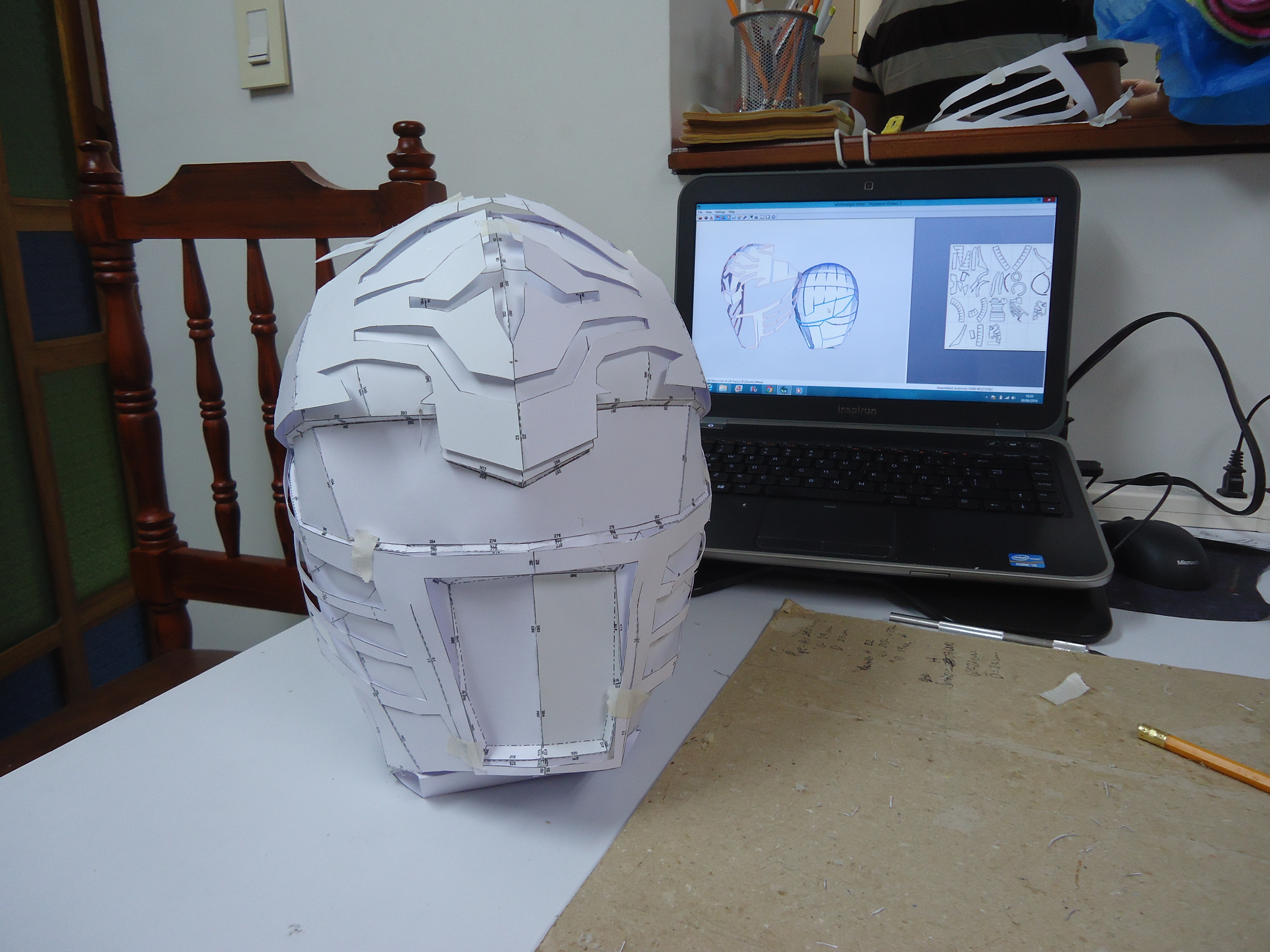

Well, the first thing that I had to build was the helmet -- of course! -- so I looked for some free PDO files on websites and posts/threads (like this), but I only got the one from eyeofsauron, which is really good by the way!!.... but this version is similar to the one that Tommy wore in the first MMPR movie... anyways.. I said " I'll give it a shot and if I have to change it, then I'll do it -- that's why you use bodyfiller hahahaha"...but to be honest, I ended up looking for another file! (after 20 days of hard work) -- So, I got a really good one from PROPZONE...this version is pretty close to the tv show one...
This is eyeofsauron's file. I used rondo (body filler + polyester resin) on the inside, and wood filler on the outside. (I didn't take any picture while I was coating the inside with rondo).

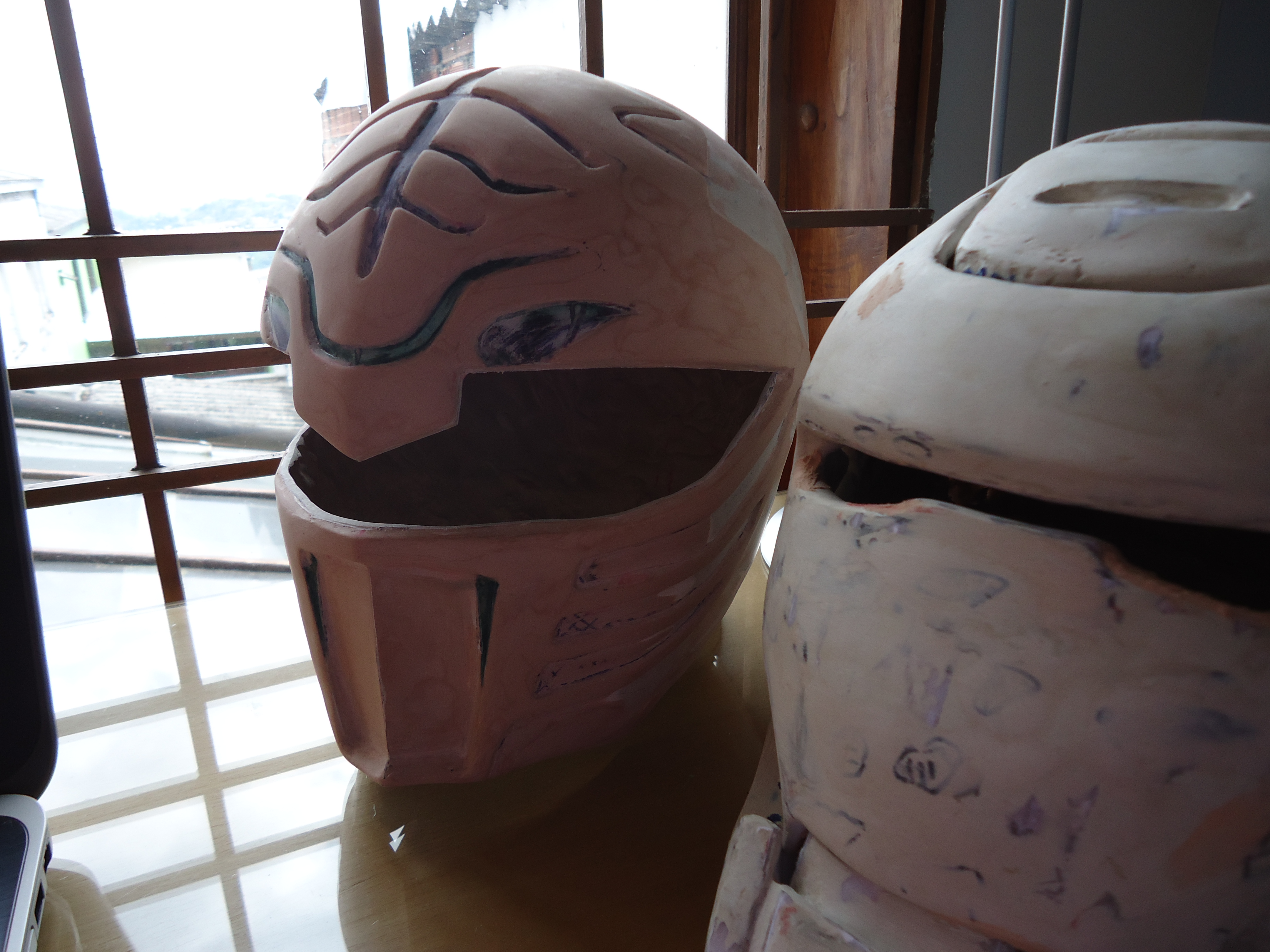

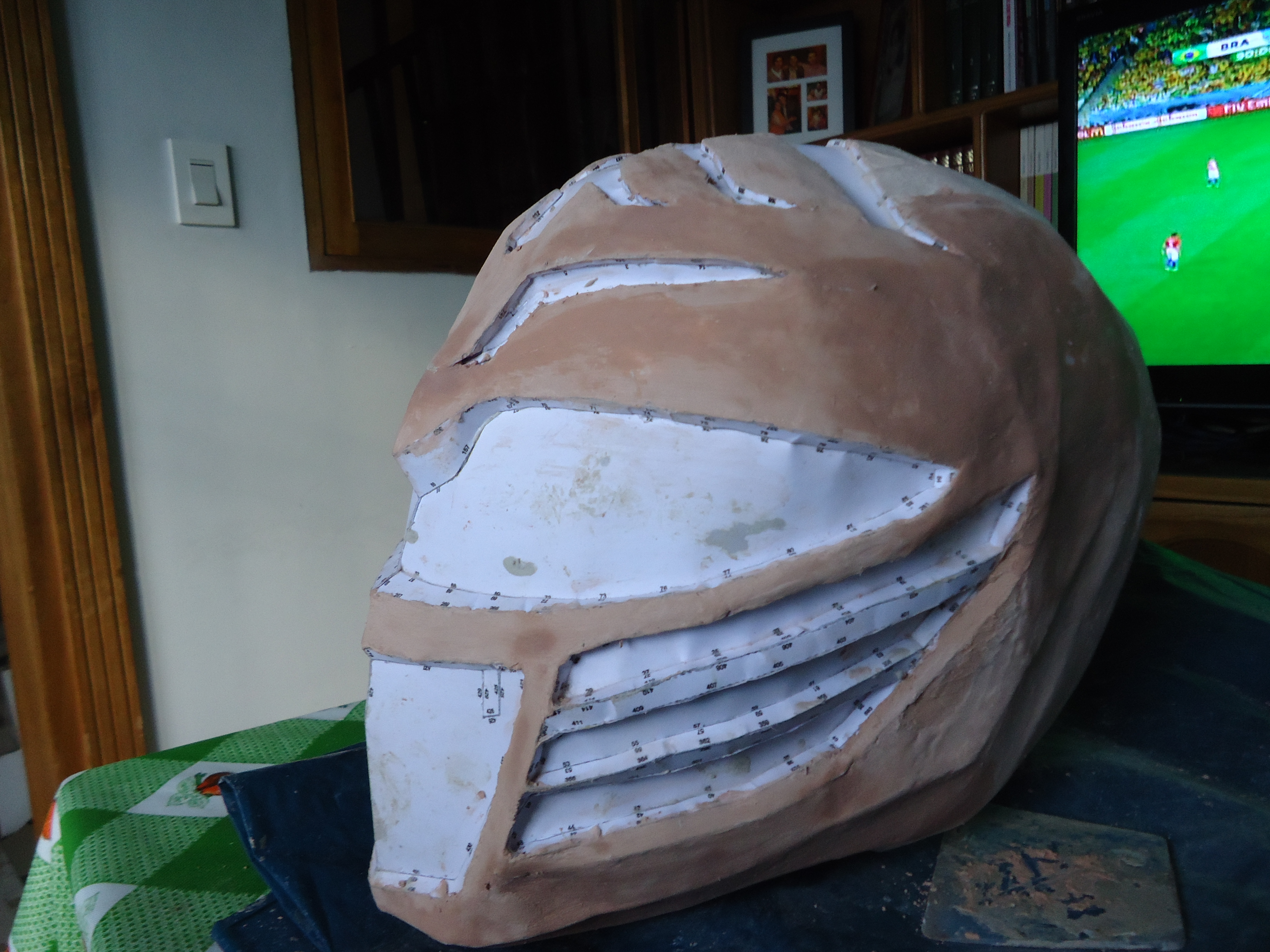

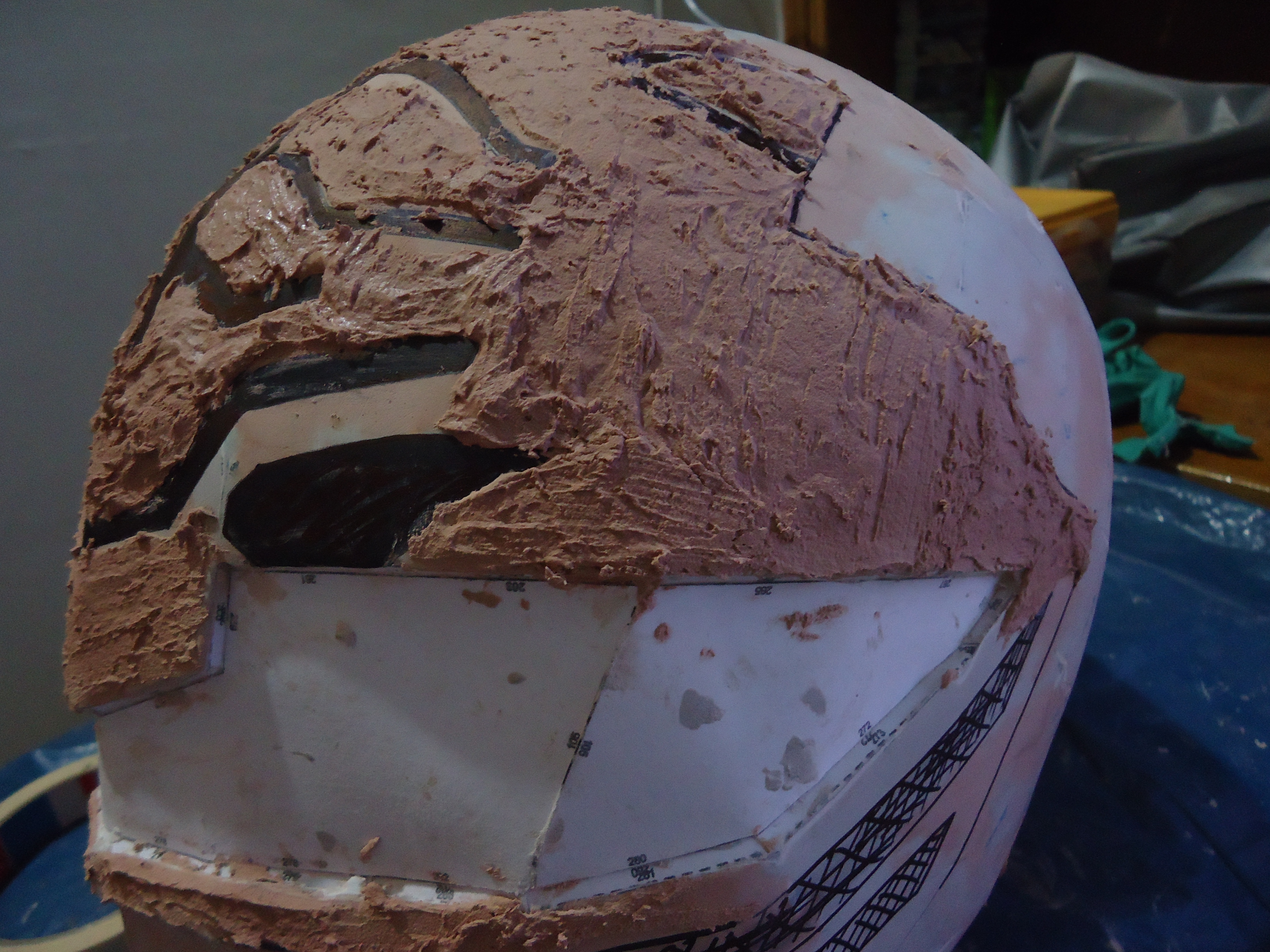

At this stage, I noticed the helmet wasn't the version I wanted so I started to add wood filler like a maniac :p and try to sculpt it... Wrong decision!! I'll keep the photos for myself hahaha.
Same weekend, I started again and like I said, I got another file from www.propzone.be ..... and once I finished my helmet, I felt so motivated!!! hell yeah! ... I only spent 6 hours building it. Once again, I used rondo (inside) but I put some bondo on the outside because I had to save time and catch up on another things. ;) Things that you're gonna know anyway!!! hahaha ----- Ok, I'm building the 6 MMPR helmets!!! ... That's why I have to hurry up! ....:)
I also used wood filler on the outside to cover some imperfections and obtain the shape that I wanted.

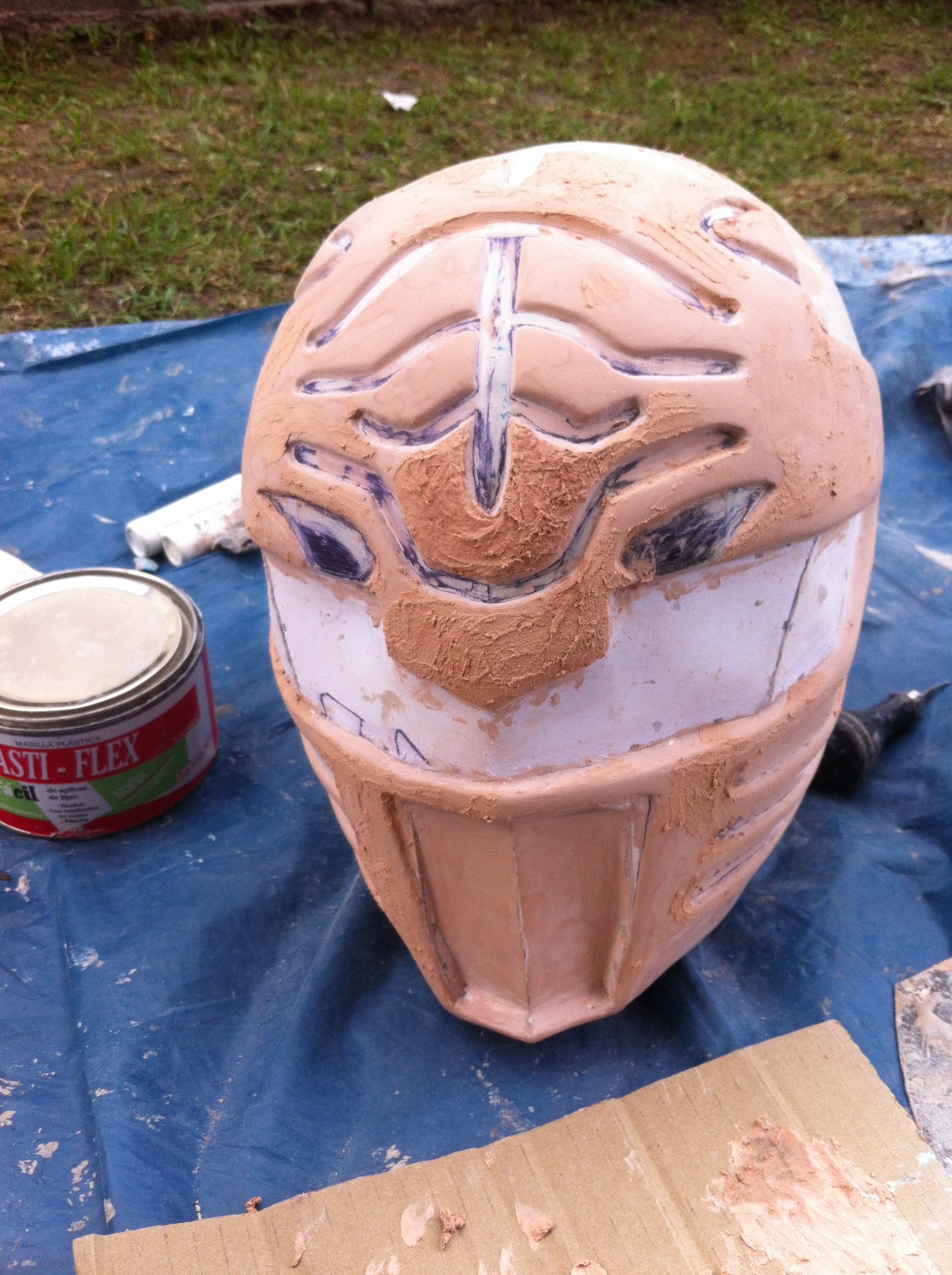

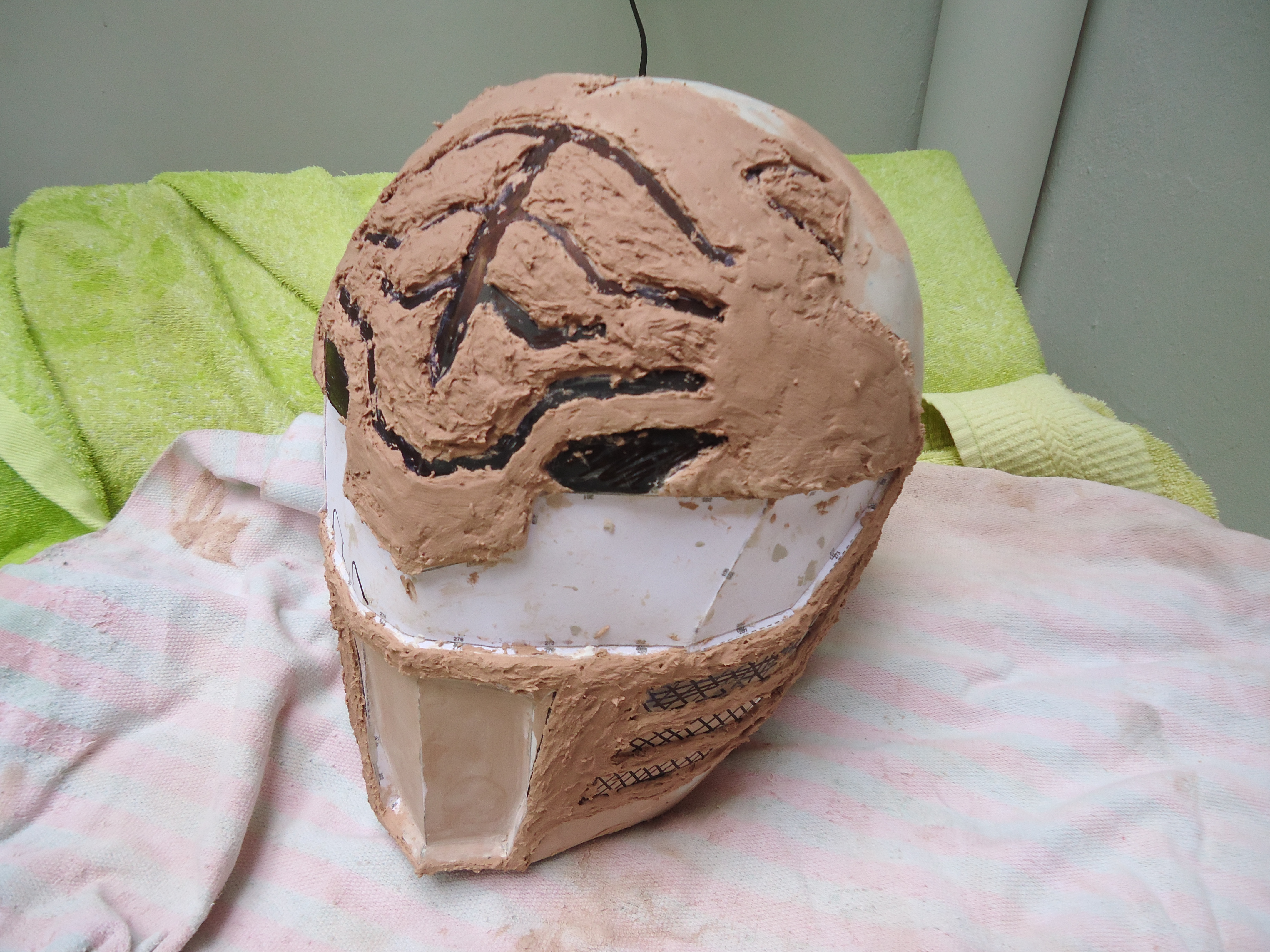

After this, I drew and fixed the tiger pattern over the helmet.
Now it's ready to be filled with wood filler.

So, after drawing all the tiger pattern, I decided to add some wood filler... It worked so good...because u can use a blade to cut or add more details...It's awesome...
After doing that, I sanded it down...added more filler, sanded it down again, added more filler...etc etc....
This is what I got.

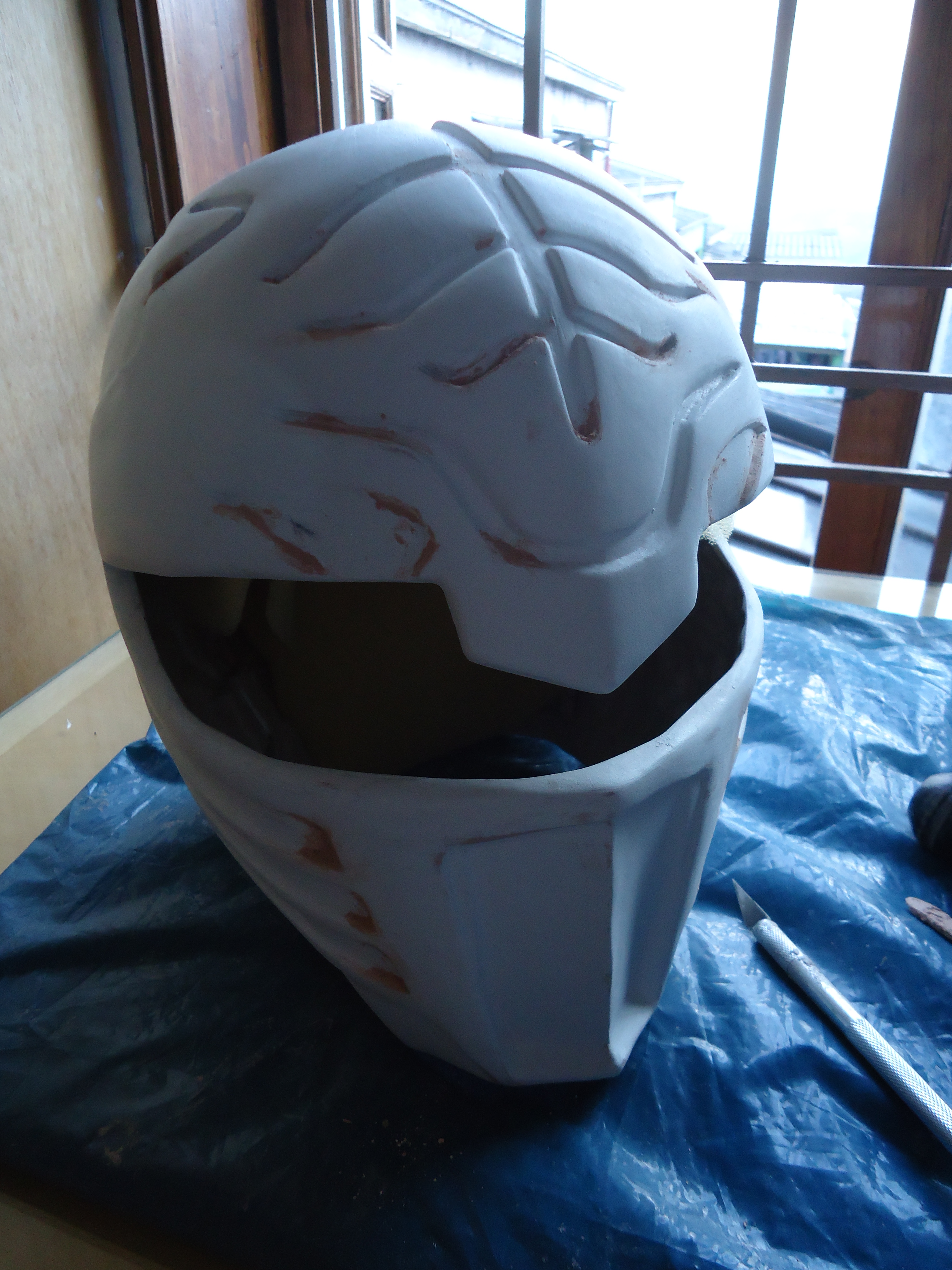

After some corrections, I coated my helmet for first time..., then I cut it in a half...and started fixing some bumps and holes (again)...
This is what I got...
more sanding and 2nd coat of primer...

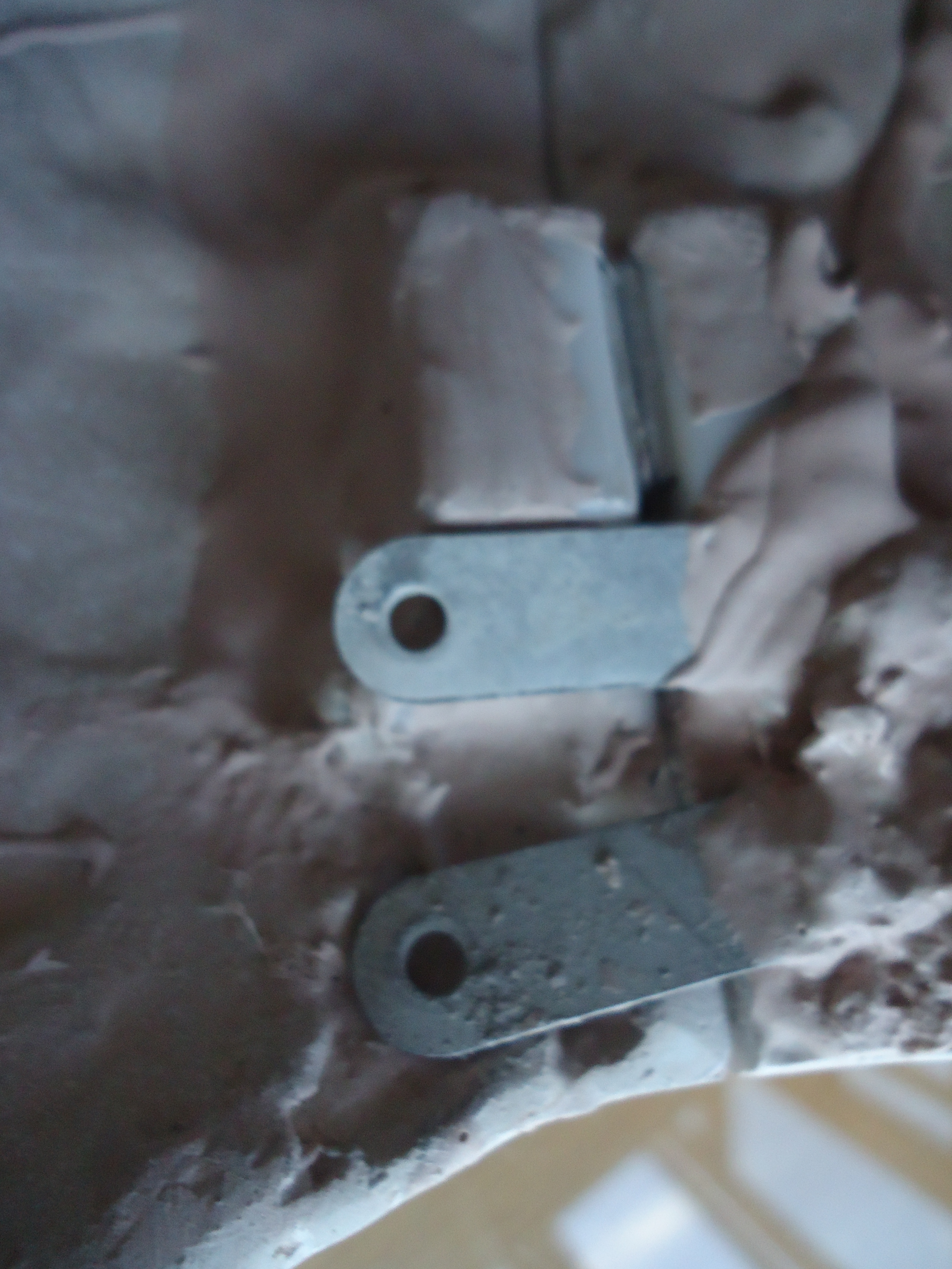

After this, I used rondo to set the magnets and some metallic guides....These guides will avoid the magnets to slide... I had to cut them a little bit with my dremel.... they were too long and I couldn't close my helmet easily.
DSC01730.JPG DSC01729.JPG there are more photos about this part, but they're kind of boring.. hahahha :)

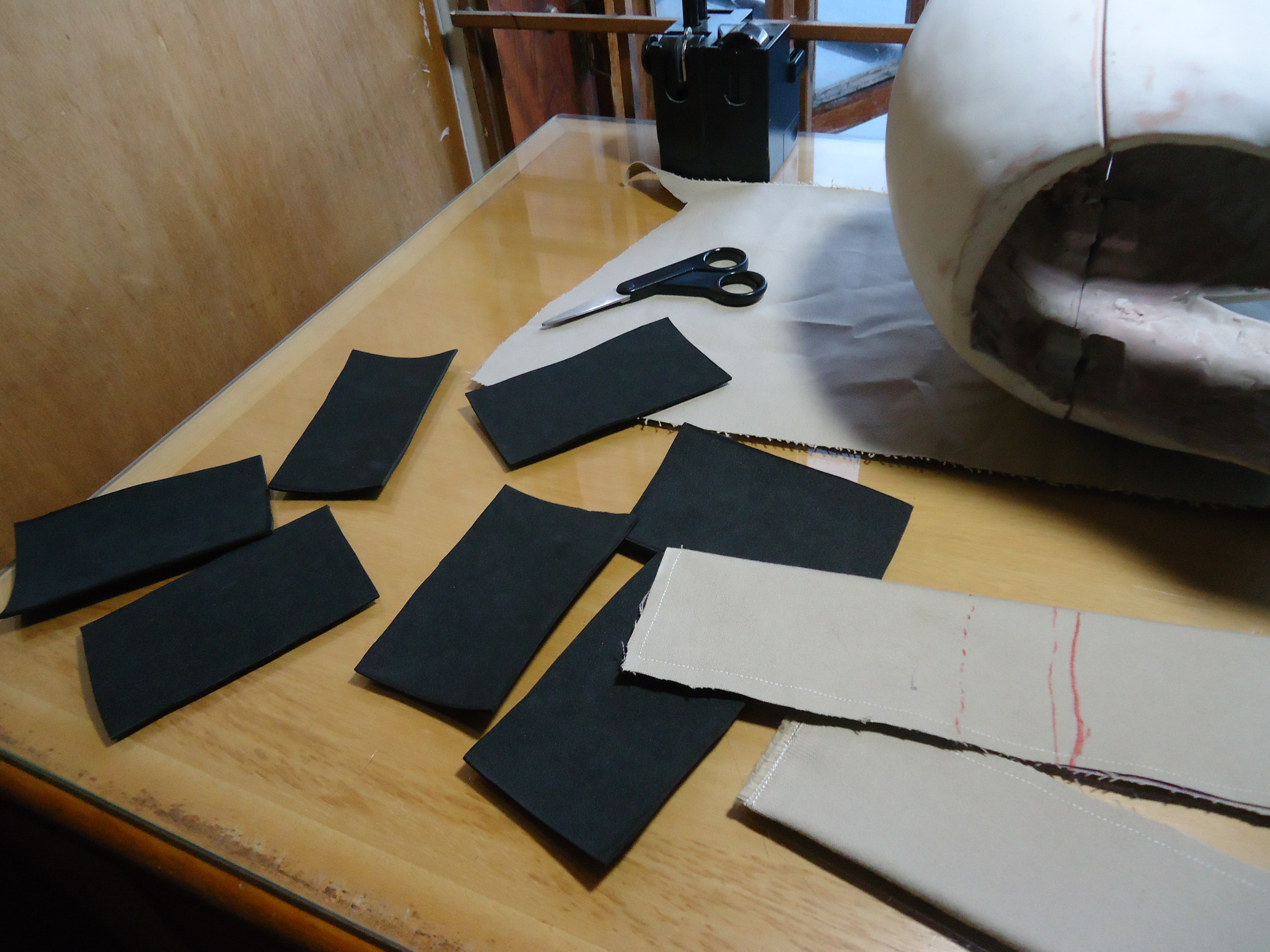

I used some eva foam and "Dril" fabric to replace the hinge from the top of the helmet.... They work good and they're cheaper! ;) ... Look!!
Notice that I made a "sandwich" with the parts ... hahahha :p...(eva foam + fabric + eva foam). This will help to glue them to the interior rondo surface...

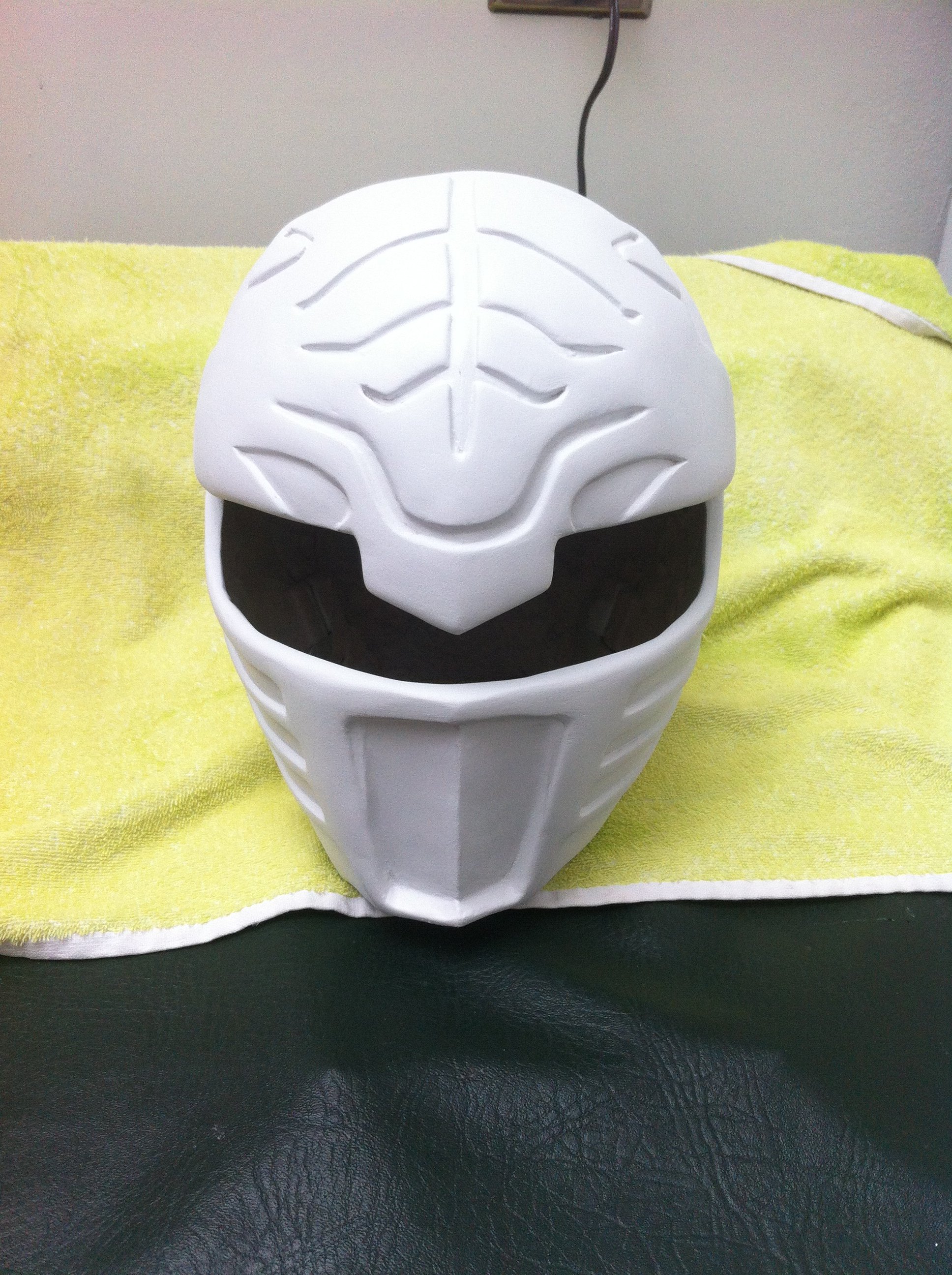

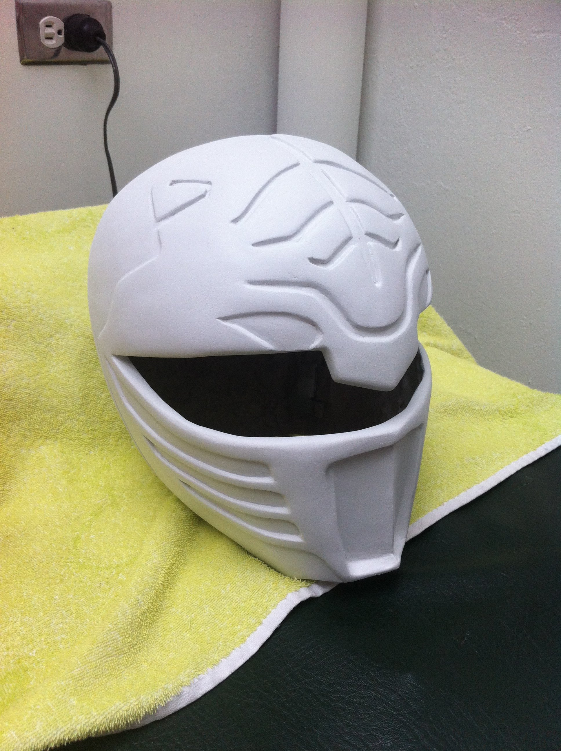

Ok,
Here's my helmet after a third and last coat of primer :)
by the way, I've been using the Rust Oleum Clean metal primer ;)

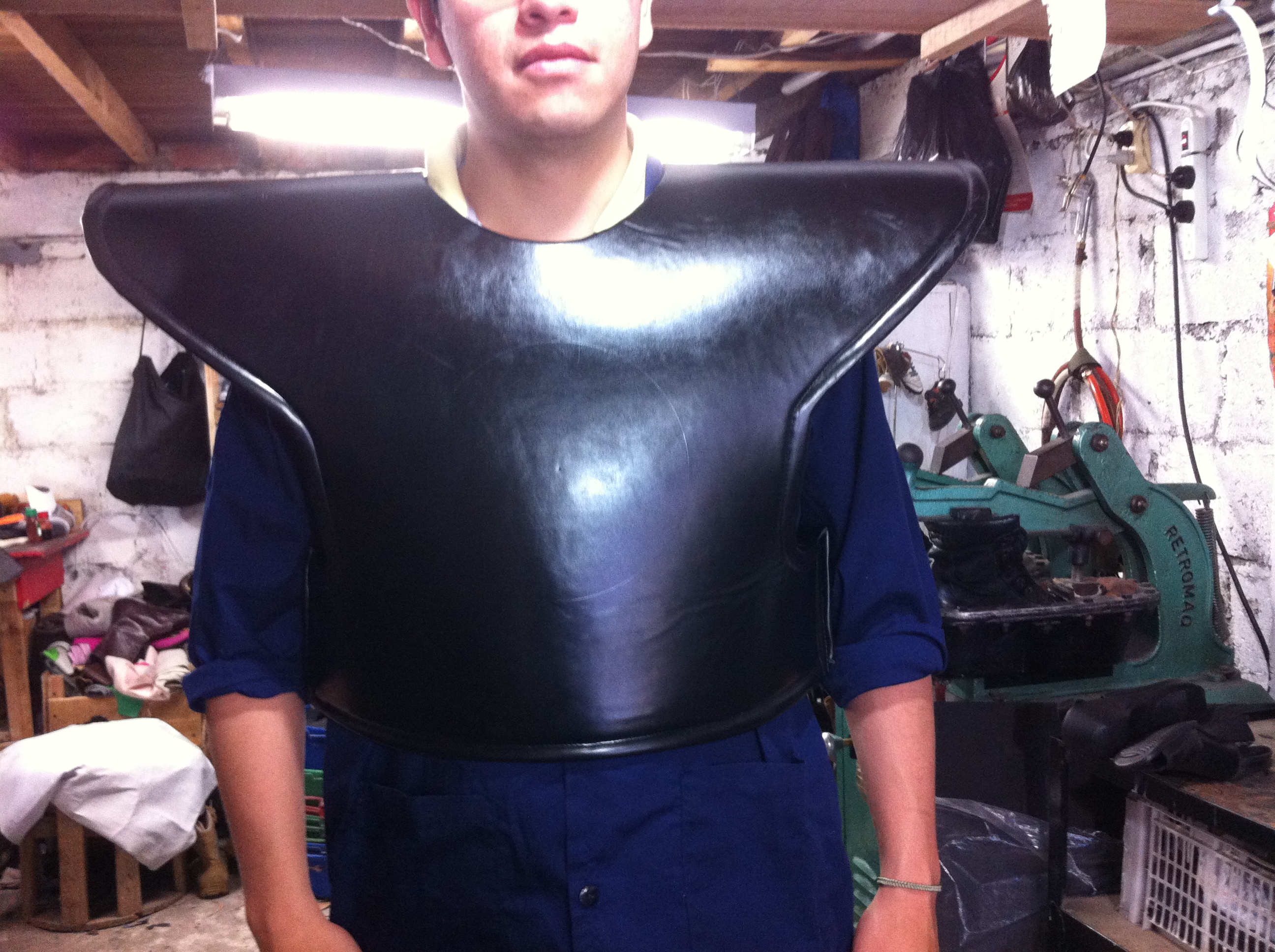

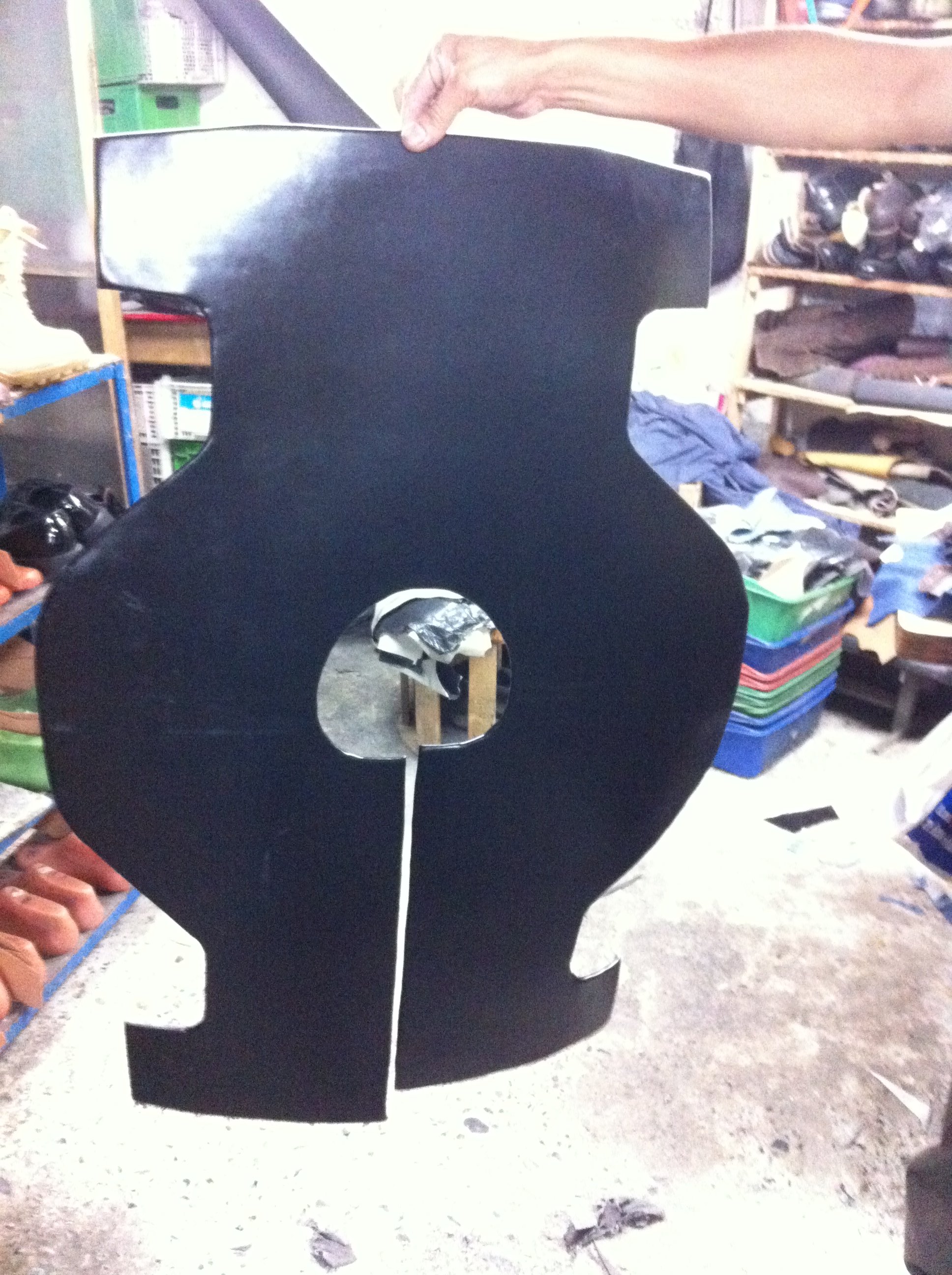

I believe the shield is tricky… the details, the curves, the pattern, etc… :cry but it isn't impossible!!! ;)
I used EVA foam (6mm). It’s flexible,light and pretty comfortable!!
I used my measures for this. I didn’t get any template at all

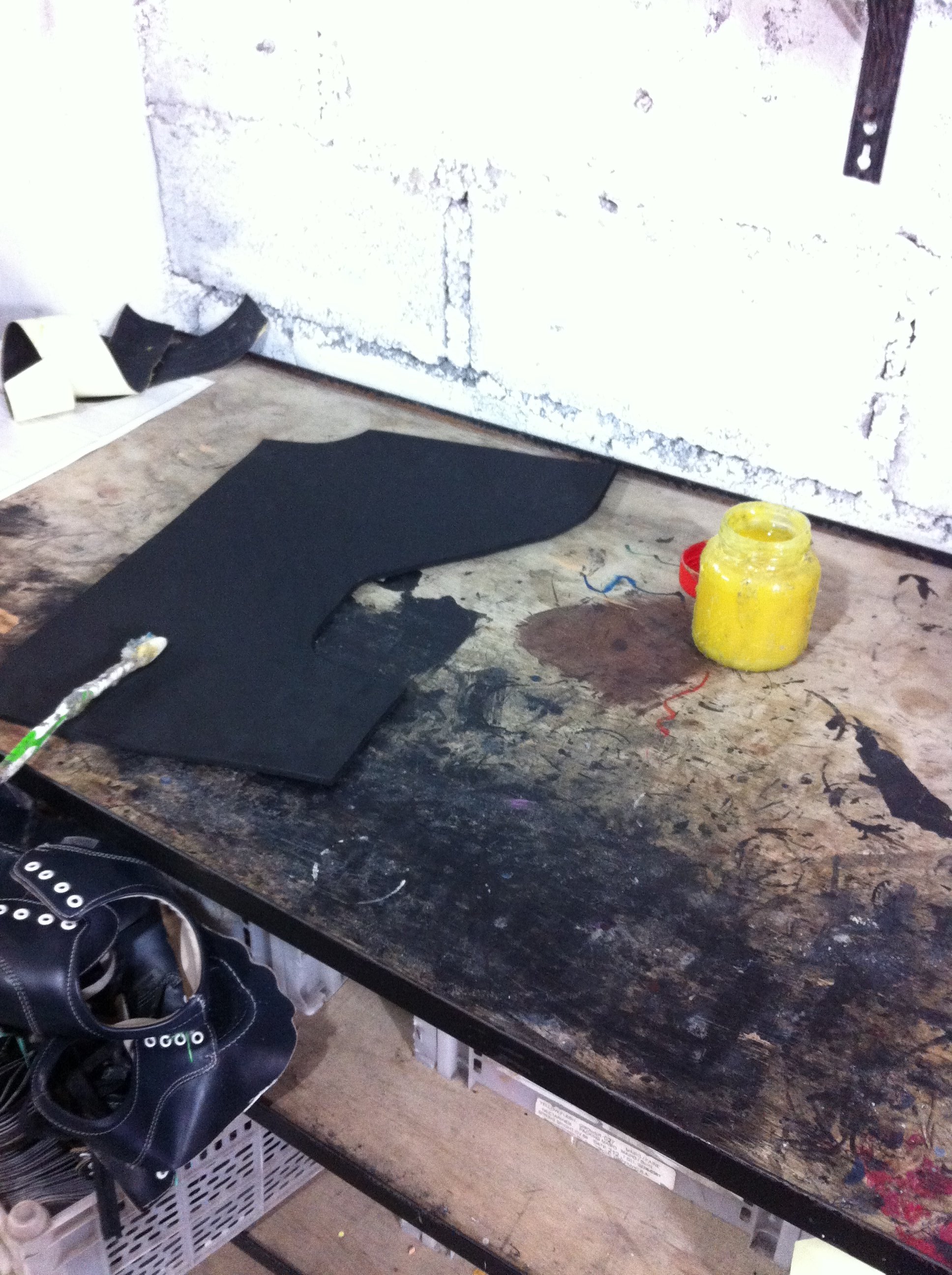

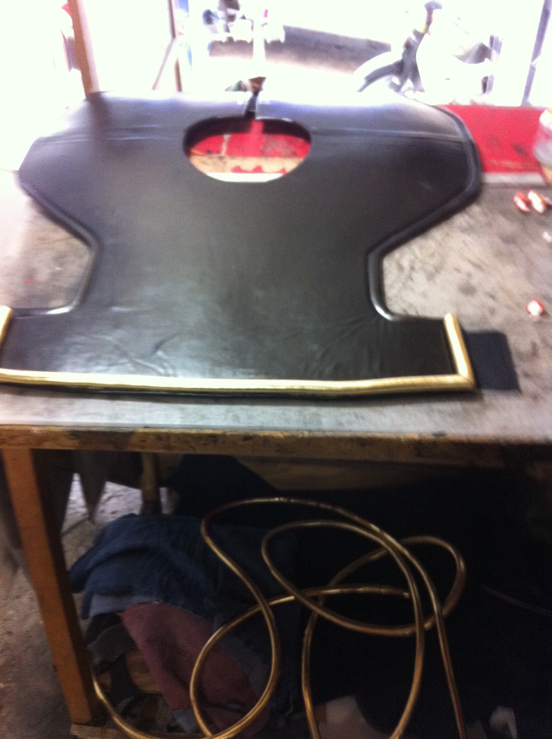

I covered the part that will be facing my chest with black "Dril" fabric. I used contact cement.
Then, I glued the 3 pieces together with more contact cement but I also added some fabric strips.
I drew all the shield pattern over black leatherette, cut it and glued it all. (this is the part that wil be facing outwards)

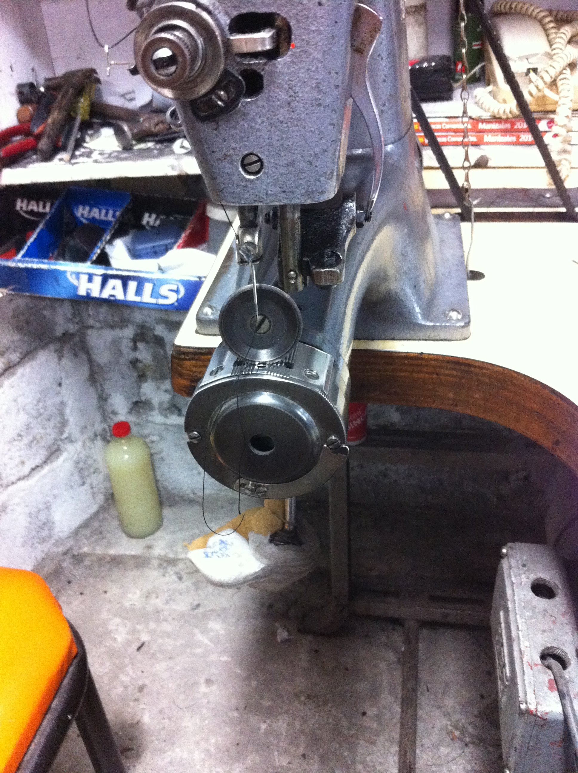

Since I wanted this shield to last a couple of events and conventions, then I had to use a sewing machine to make it durable!! :) This way, neither the fabric nor the foam will separate.
I also put some velcro strips, and there you have it!

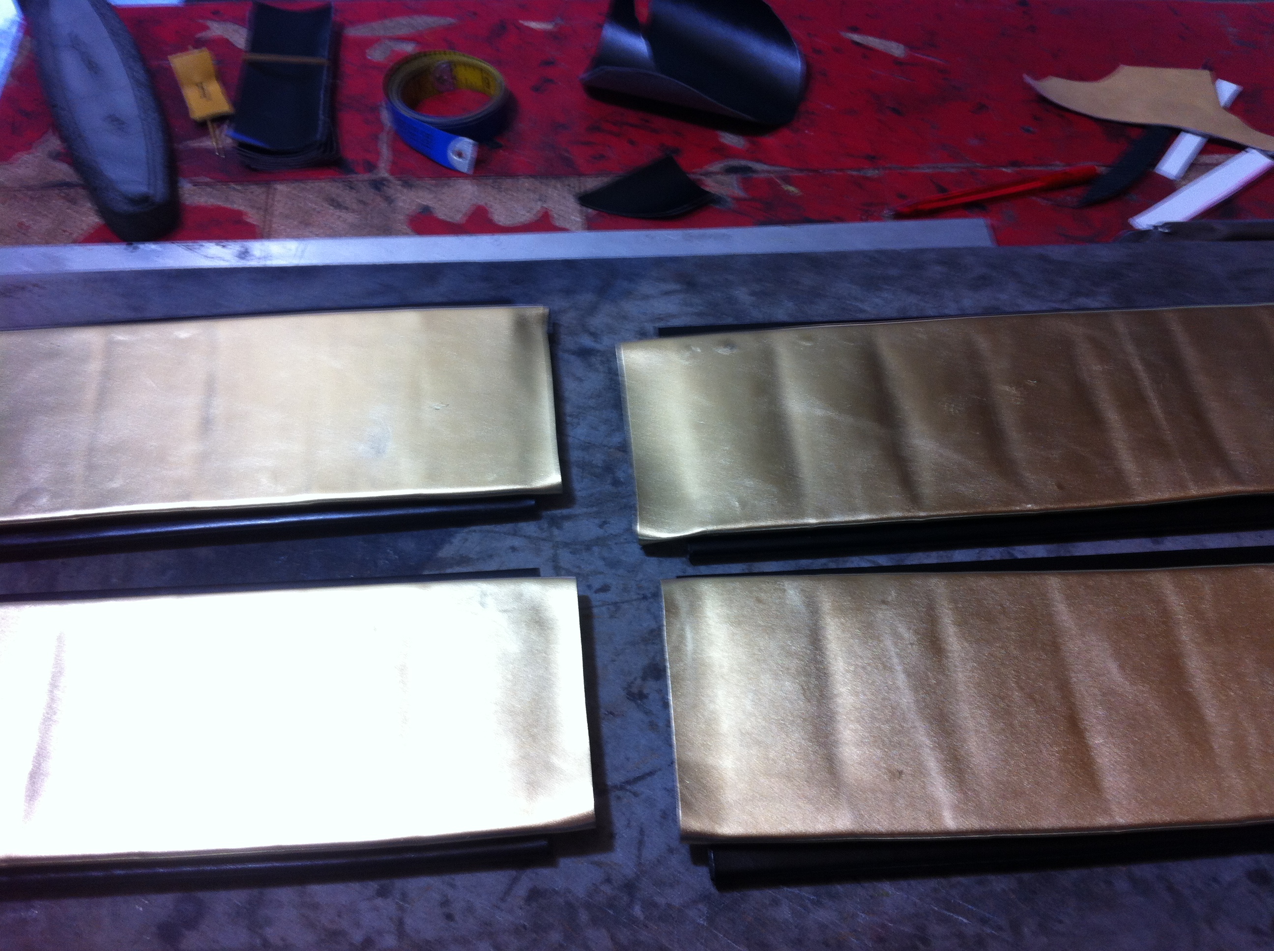

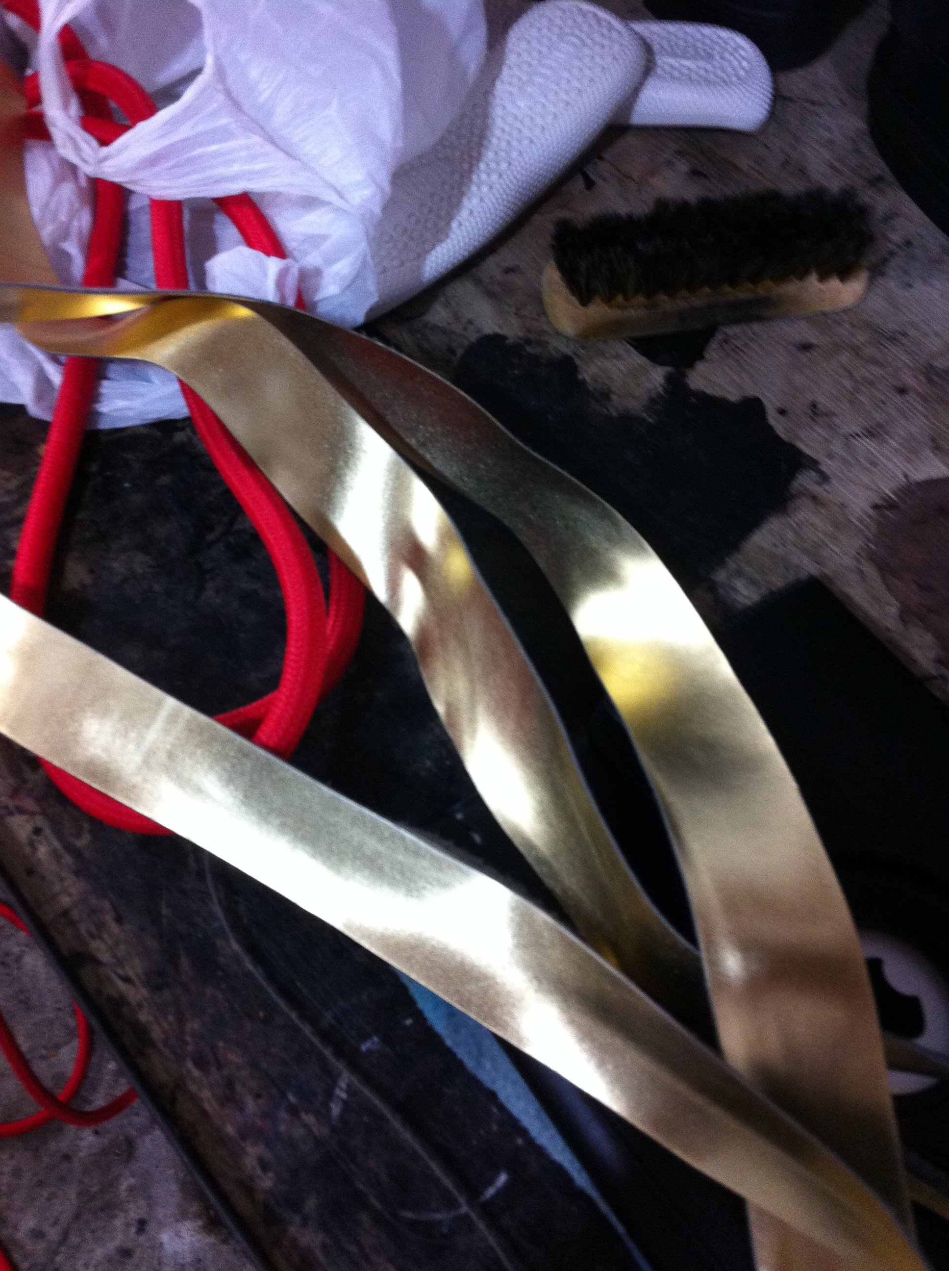

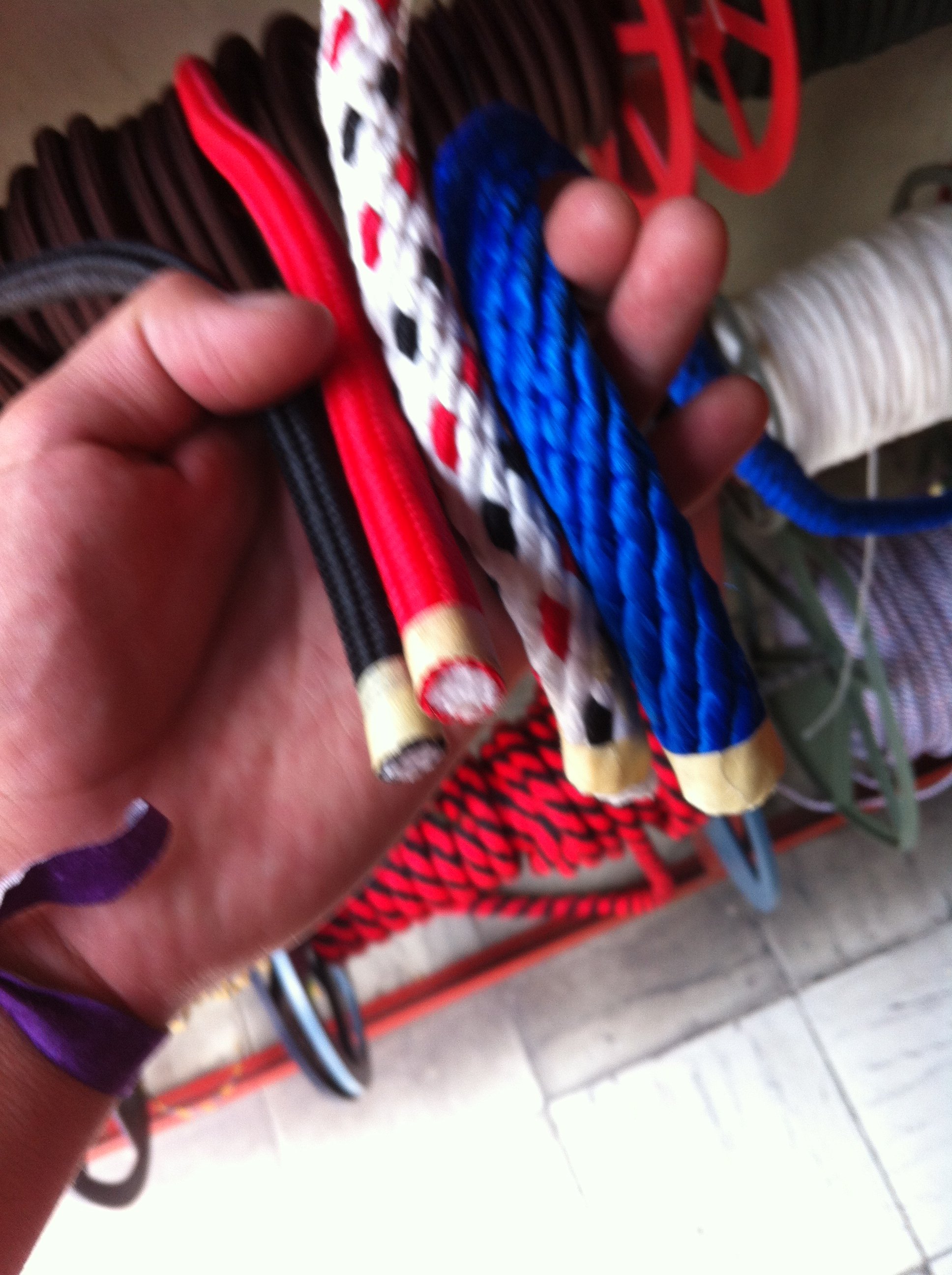

I had a lot of options for the cord, but I went with the red one (it was nicer and solid). Covered it with Golden fabric leatherette. (almost 10 mts)

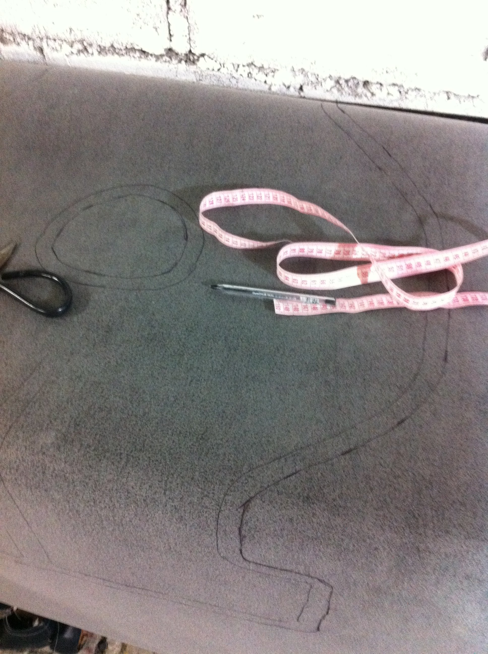

I drew the arms and legs patterns, cut them, and covered them with fabric & leatherette.

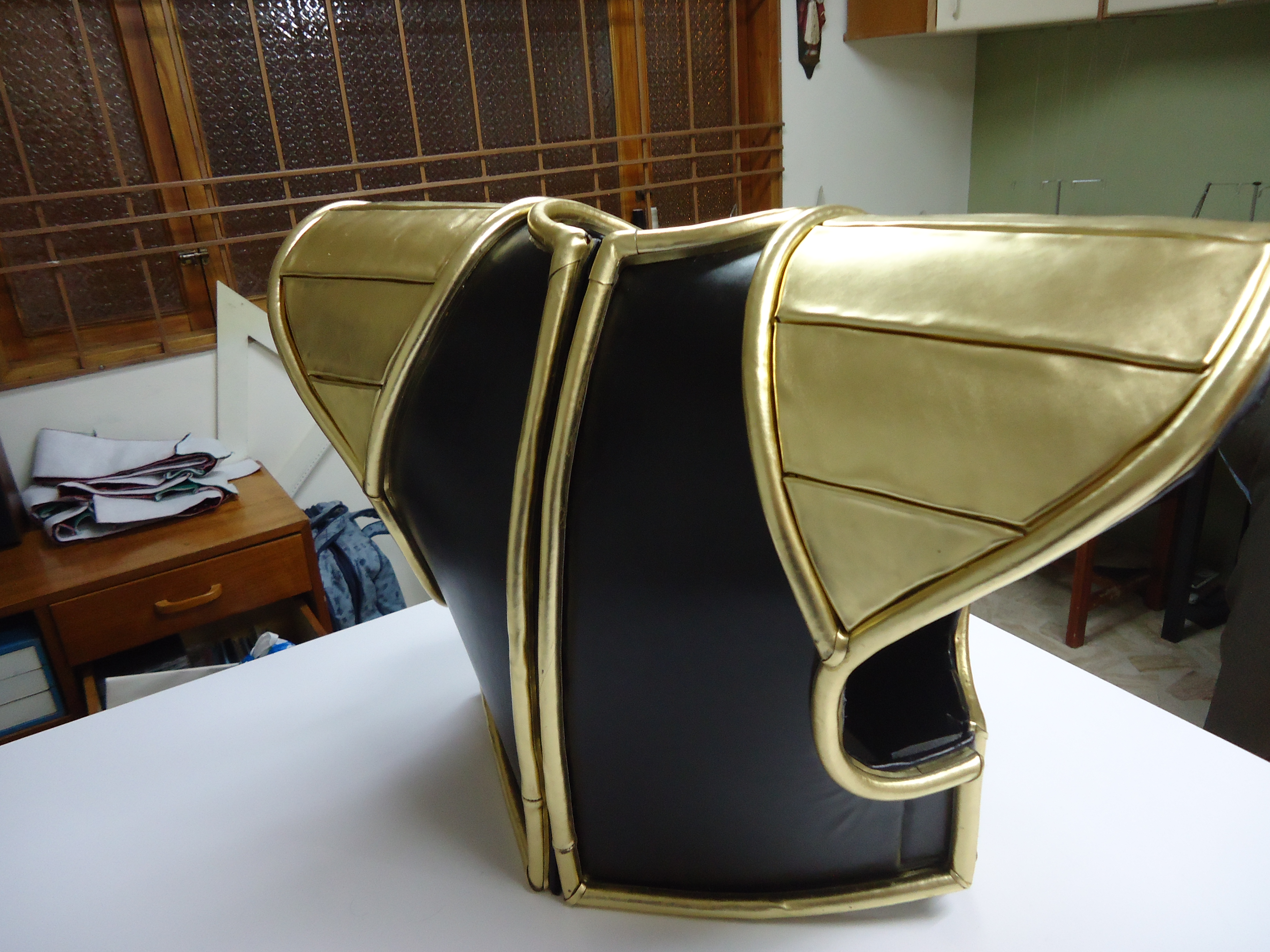

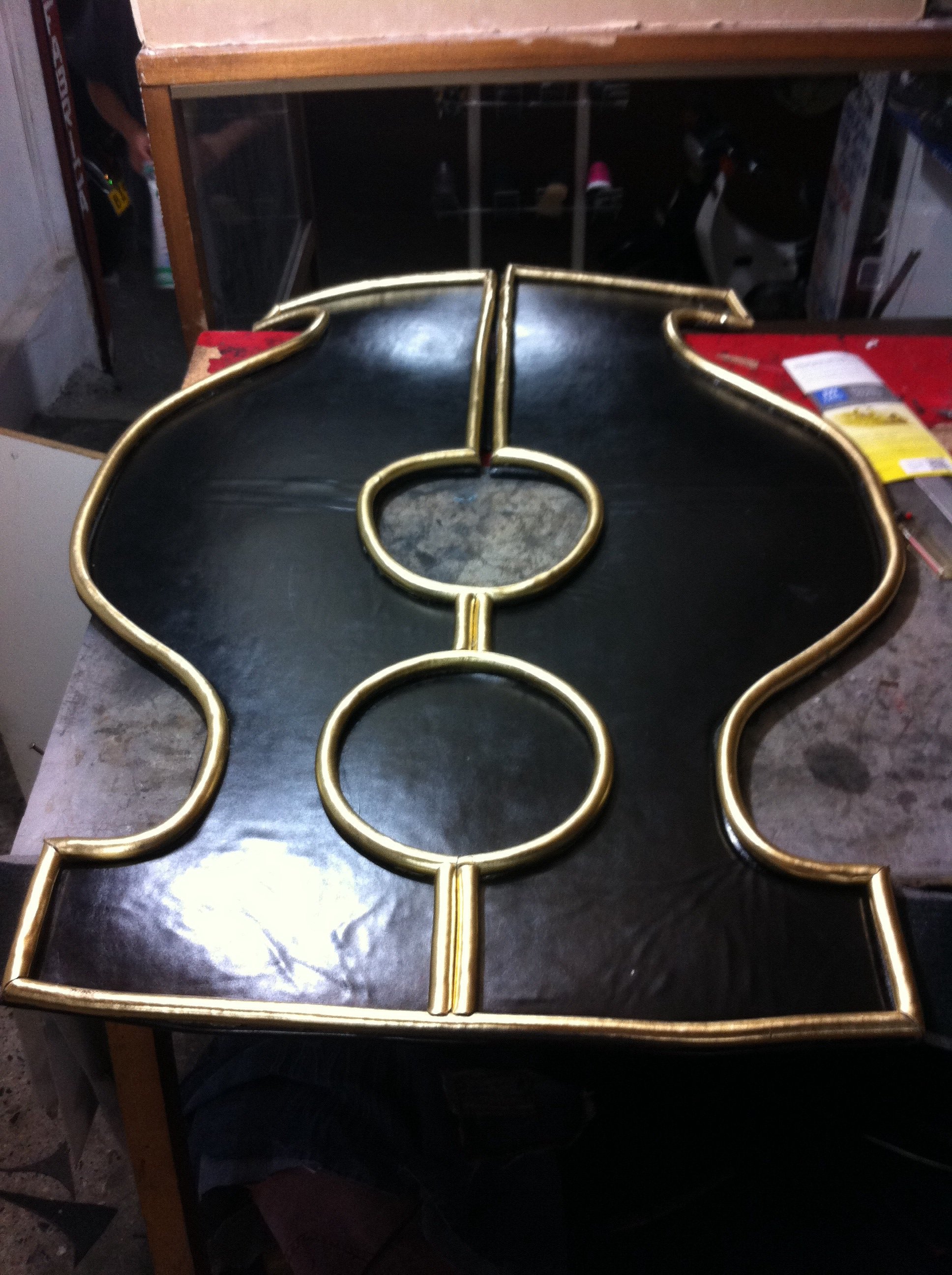

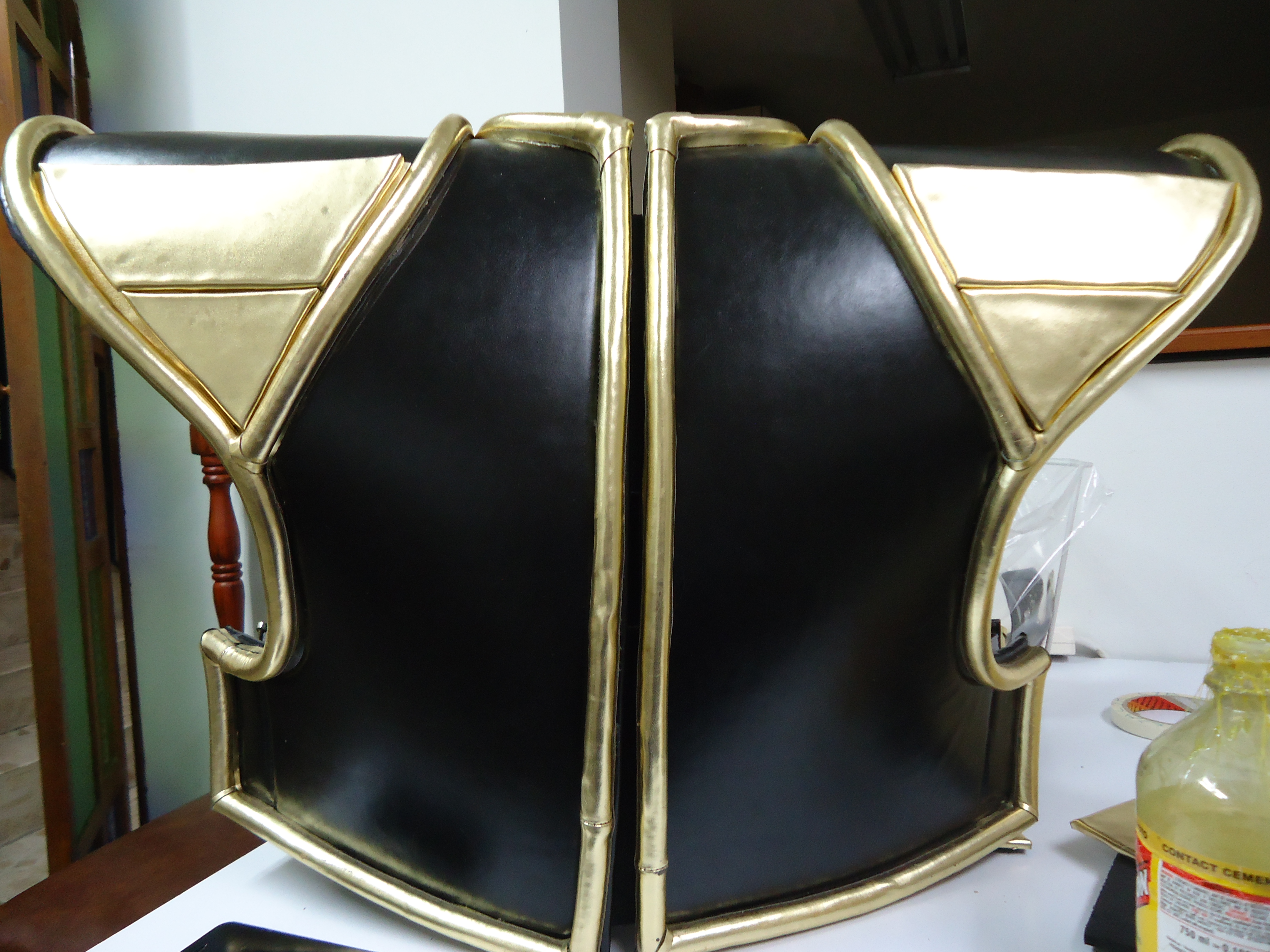

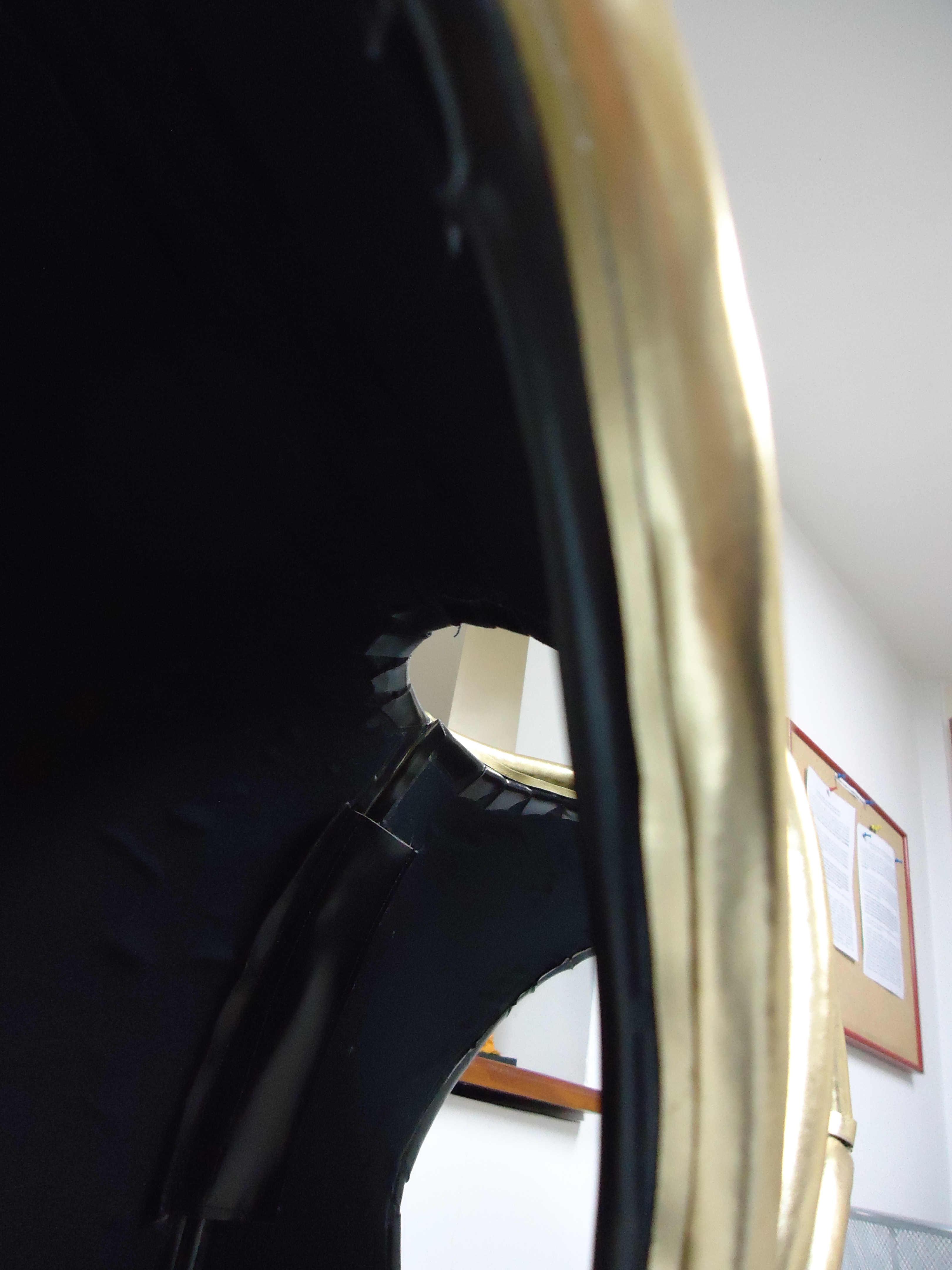

oh, by the way...I had to cover all the glue imperfections and ugly pieces with a thin strip of golden fabric...
This took a lot of time... because I also covered all the joints.. Now they look really good! :)
I'm proud of them... hahaha.. you can take a look...

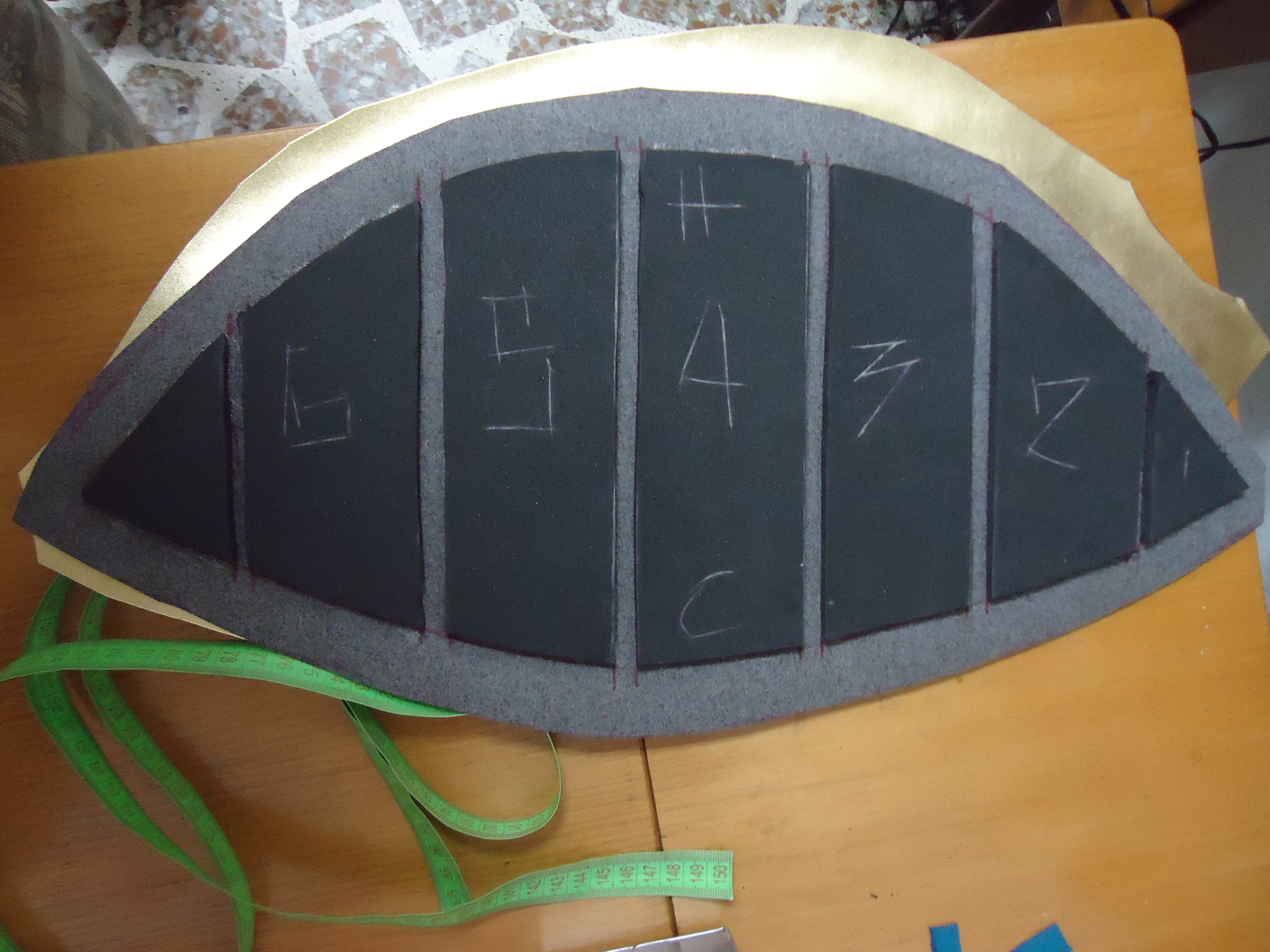

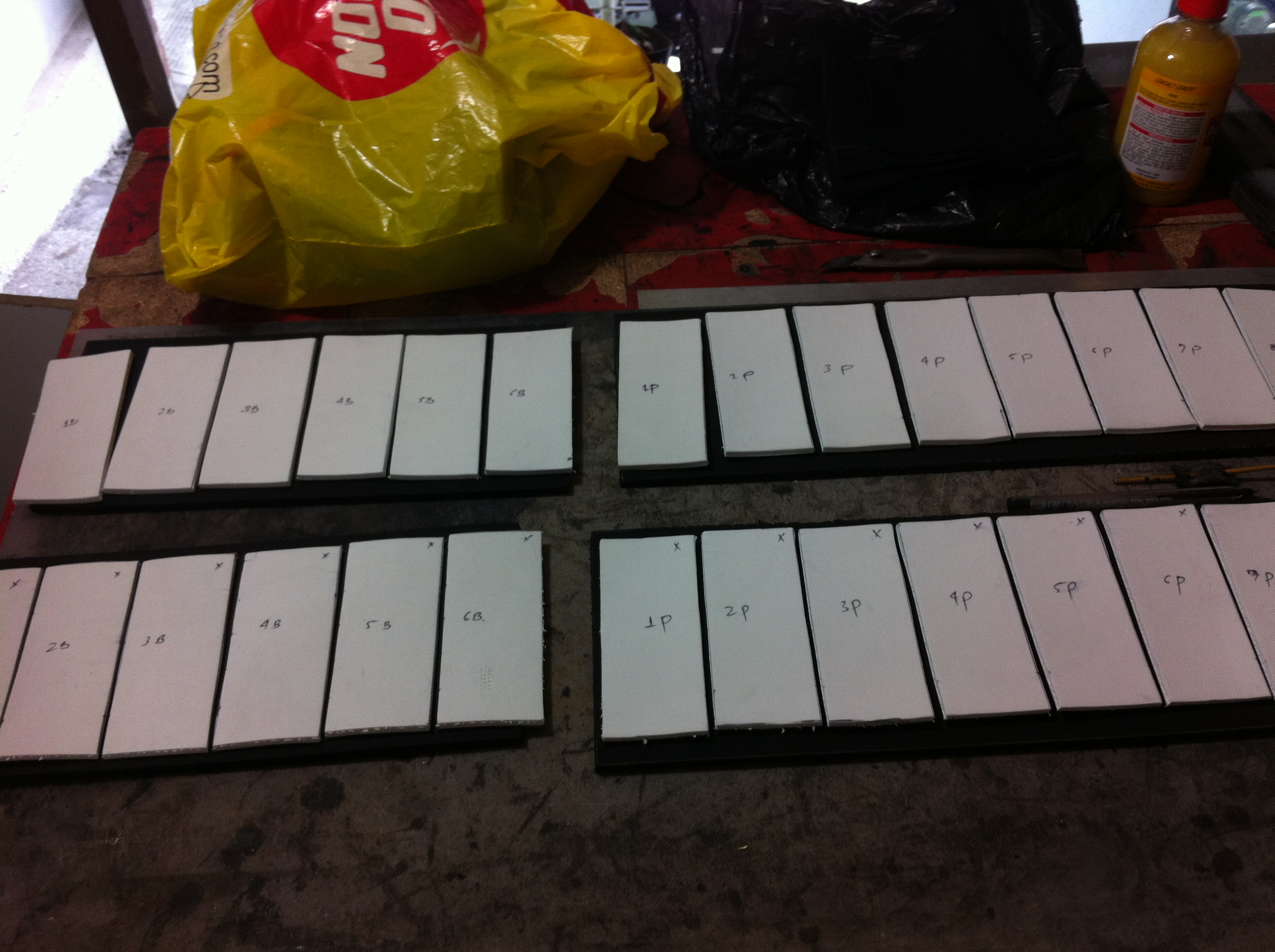

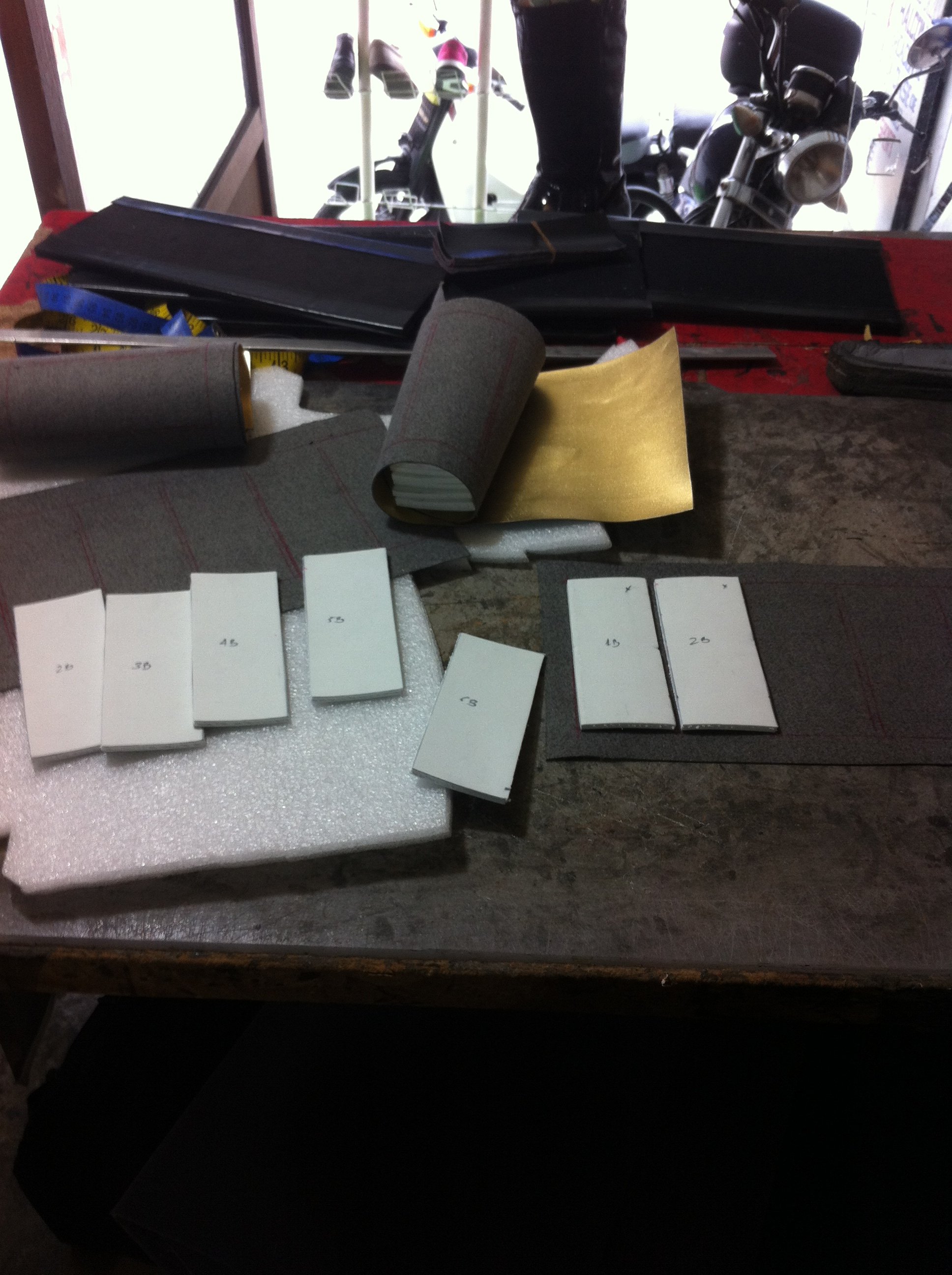

I built my shoulder templates and drew them over eva foam (6mm), cut them into pieces...
put some numbers and started to cover them...This was pretty boring... :/... I don't know why, but the leatherette got peeled easily.. I had to do this 2 and even 3 times... :(
I also had a problem with the size...they were too small (pretty weird!... The template was ok)

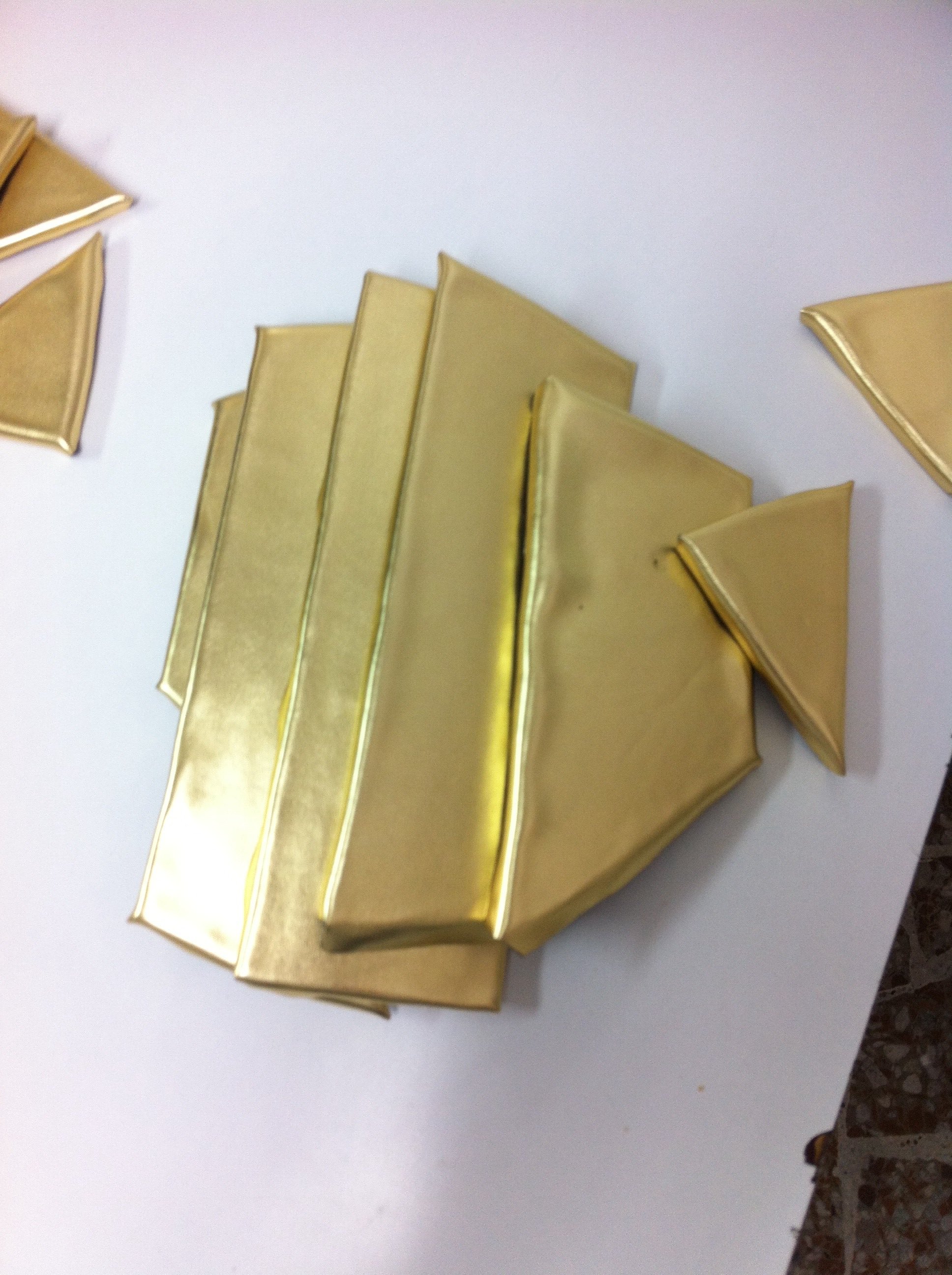

I glued some fabric (leatherette) strips to cover the spaces between the shoulder parts... this way, everything would look gold instead of black.. ;)
see?
gluing pieces...
gluing again....
last piece....:D

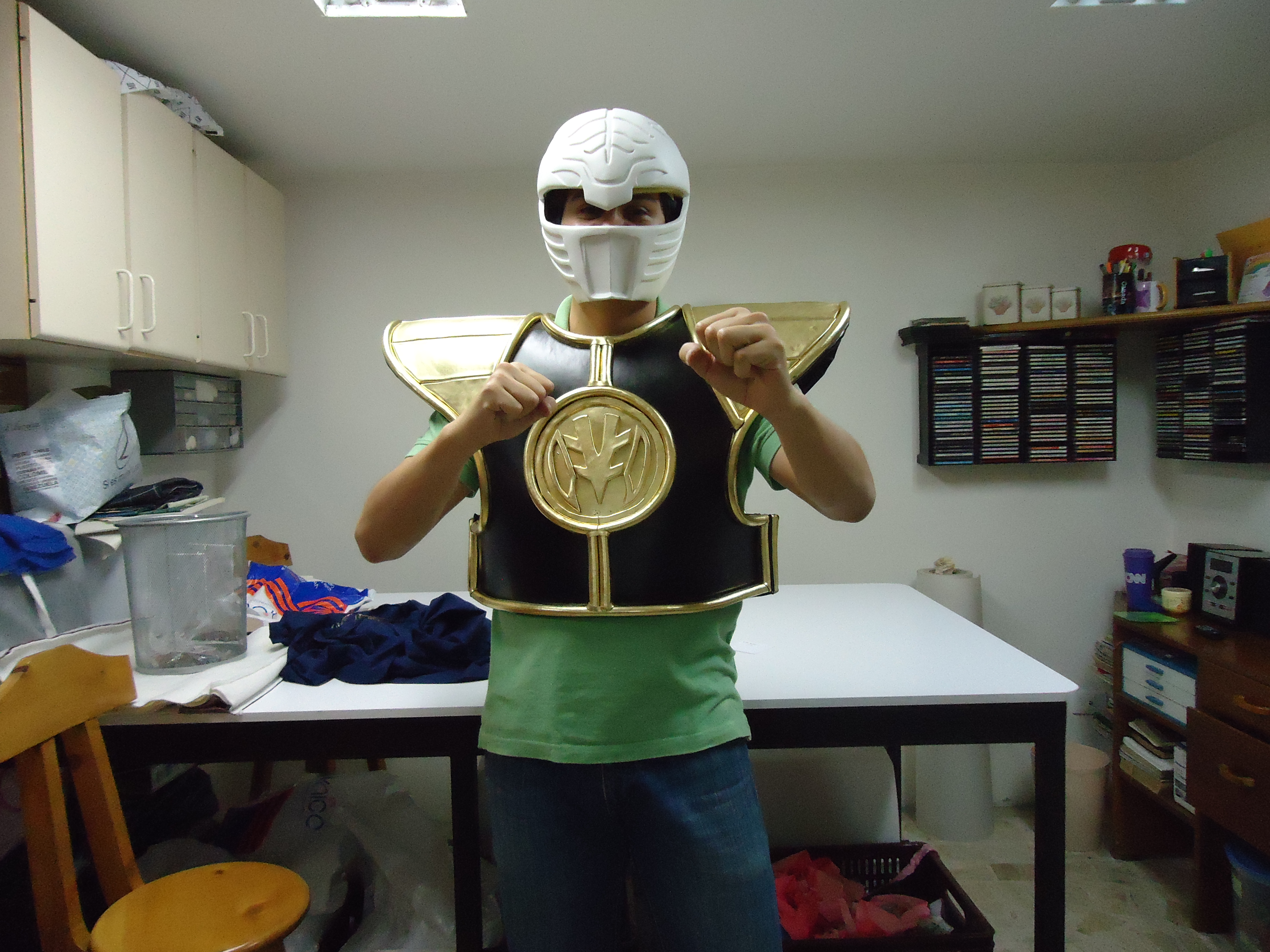

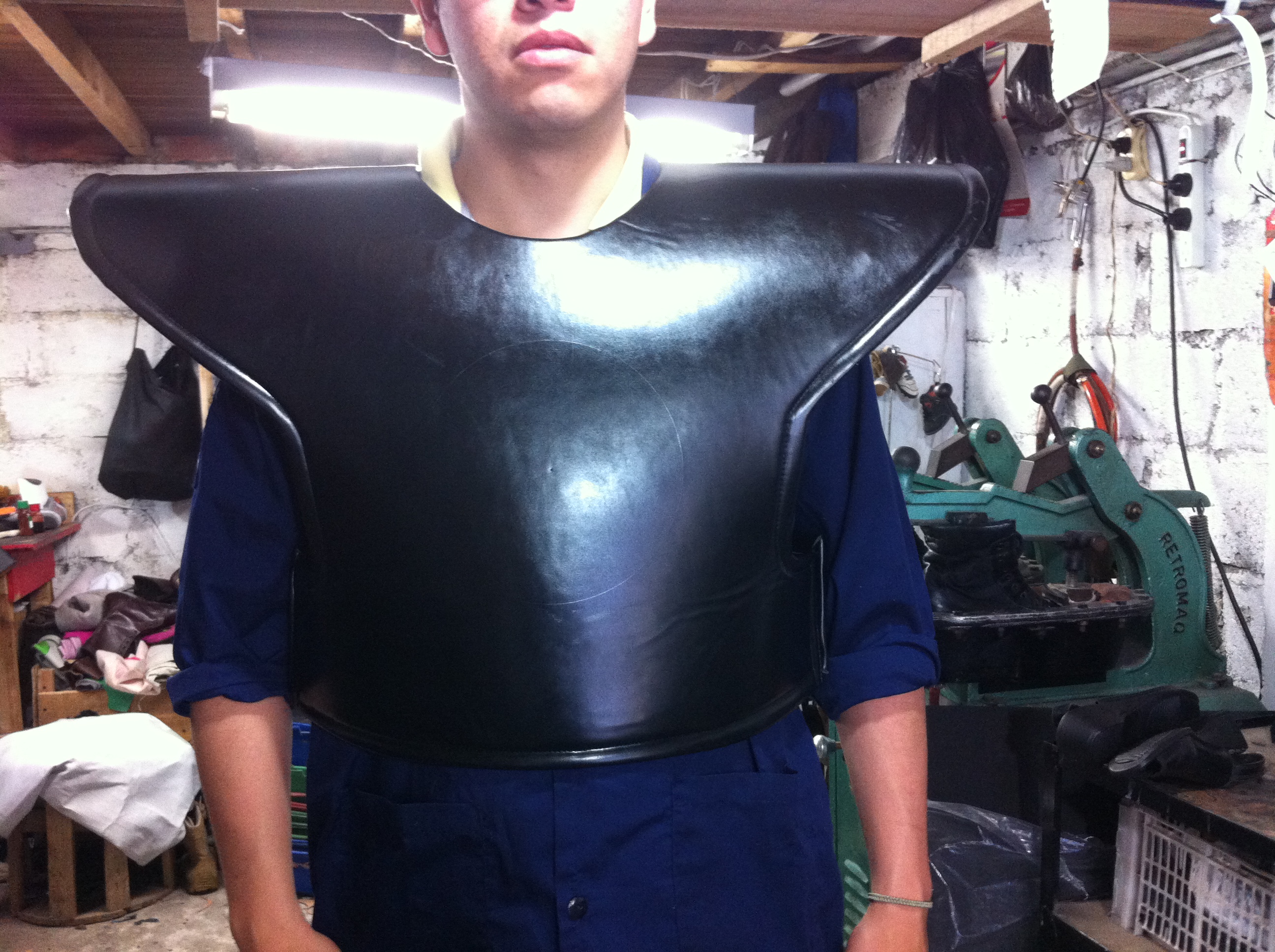

Finally, my homemade White ranger shield....
