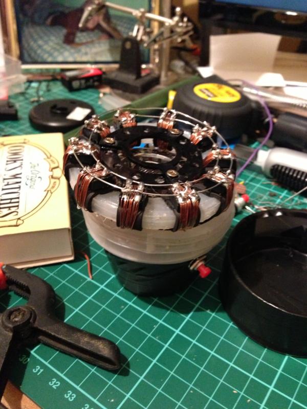

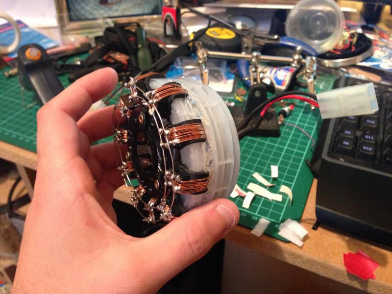

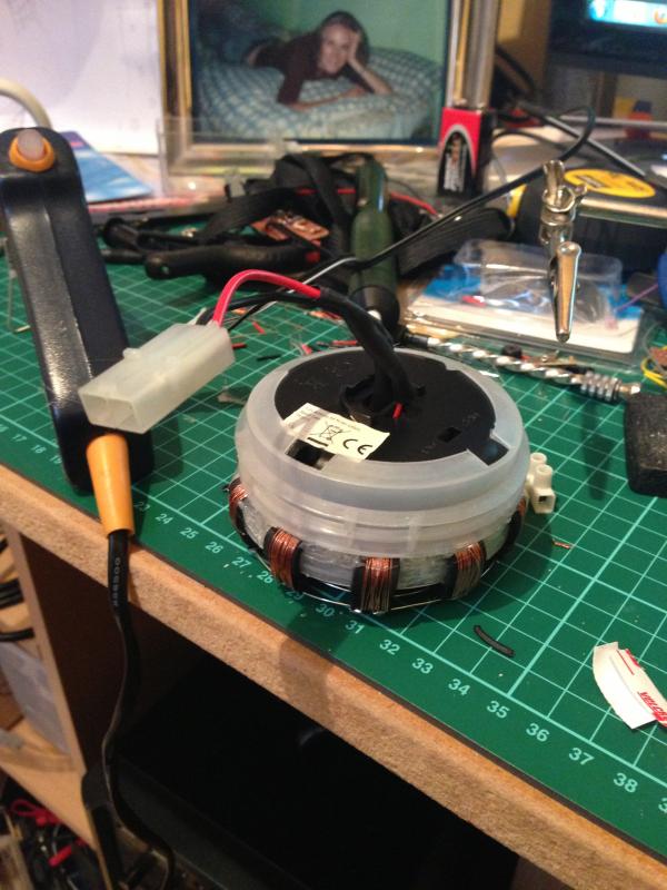

Started off with pringles lids, circular cut out the centre, filled with glue
The circular piece in the center is the inside of some water / plumbing connections I had lying around

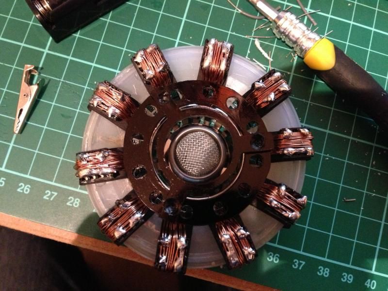

I bought a splatter sheild from the 99p shop to supply the mesh and added that to the centre. I also tried to use some chip holders around the edge to make it easier to solder onto (They weren't that helpful in the end but look cool I think)
As I wanted to stop the light coming through I used some foam strips under the chip holders, this also gave me something to sit the chips on while I wound the copper wire
