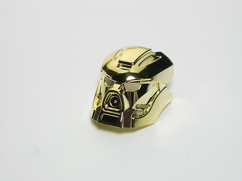

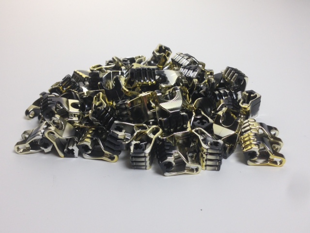

Hello, I am trying to get a gold mirrored chrome look that resembles the posted image. I have molotow liquid chrome and a gloss black base by Alclad. However, I do not know what to spray over the chrome to get the gold effect that I want. Or should I go another rout to get this effect.
You'd want to use a clear coat tinted gold (orangy-yellow) over the silver to turn it gold.
I haven't tried that with Molotow, so you'll have to experiment.
The picture looks like a vacuum-metalized part, which is tough to match for reflectivity. However, the same clear coat method is used to make vacuum-metalized parts look like gold or bronze or whatever.
I believe them to be airbrushed, because of this picture of the byproduct of the chroming. This part was being sold and the person who was making them did not want to give out the information on how to make them. They stopped selling these in 2018, You can see that the hands have a black base, chrome, and some type of gold coating, made a candy?
I found two one with gloss and one without gloss.

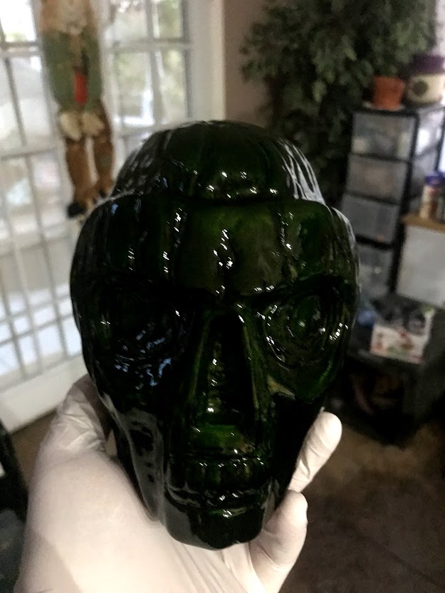

If I use just molotow liquid on the parts, it becomes dull like silver paint. So, it was recommended that I spray them with a glossy black to prime them for the molotow, however the glossy black loses it gloss and becomes dull. I cannot get a shiny enough base coat on my parts; It was recommended at the store to get a highly shiny clear gloss, something that looks wet. So I did some research and on one video it said that a super wet look can be done with 2k Auto clear coat however I can’t find anything that looks like and acts like that on amazon or in or local hobby store.

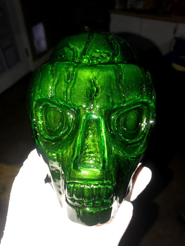

While this piece isn't using the Molotow Chrome, it is using that Finish 2K clear coat. This is 24 hours after spraying it with my airbrush (I had to go really slow as the 2K is thicker than the airbrush is really designed for). As you can see, it has that wet look because it self levels and gives that very smooth layer needed.

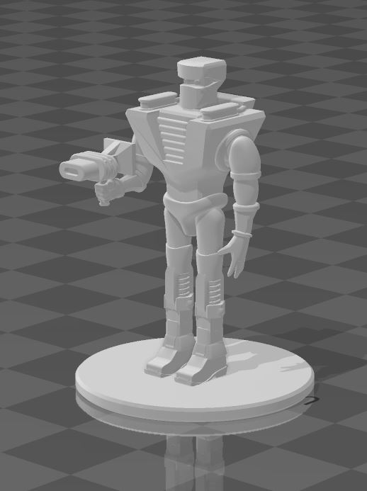

Here is a video on a statue I did about a month ago using Molotow over that black high gloss I just posted a link to, then aqua gloss, and then that Finish 2K clear coat.
If you look at his legs, they have that 98% chrome mirror finish like the real deal. The rest of him is slightly foggy compared to that because I don't have an air compressor anymore that's strong enough for the paint gun I have, so I had to do this using my airbrush and, well, the overspray dried areas faster and toned the mirror effect down.
Heh - that's a neat Bionicle mask. Haven't seen that one in gold before.
Assuming you're trying to replicate that mask specifically, I'm fairly certain you can get custom chromed Lego parts at a few places for a decent cost. (This site and this site come to mind) I'm not 100% sure if they both do gold or what it'll run you, but that might be an option if other methods fail to get a good result for you.

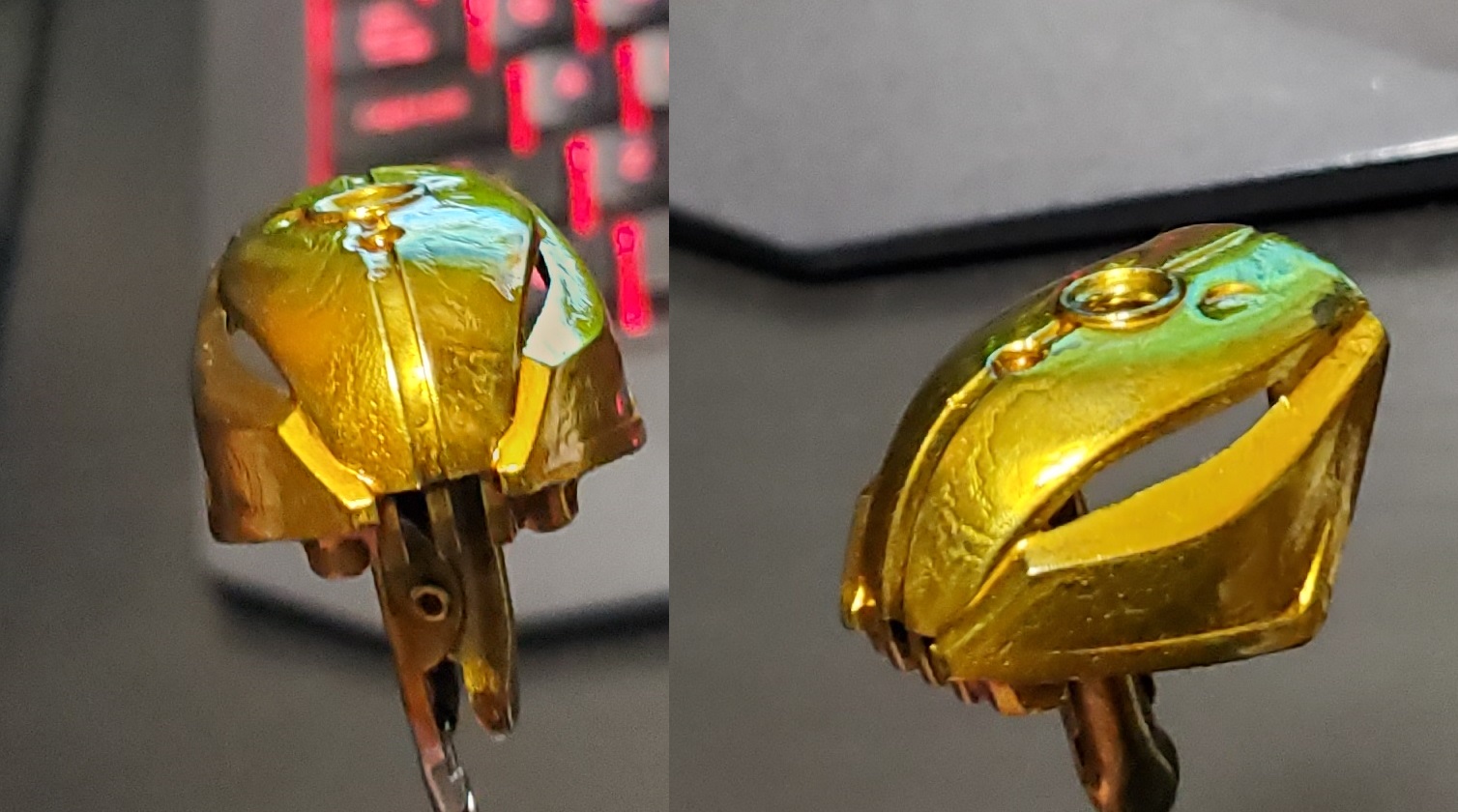

I was able to get it to work on another part, by just coating the new part in a water-based polyurethane, so that it was smooth and glossy. Then I sprayed molotow at the lowest air presser that would allow it to flow from my brush and let it rest for 3 days and then used a tamiya clear yellow. Even the panthers on the piece are intact as well.
