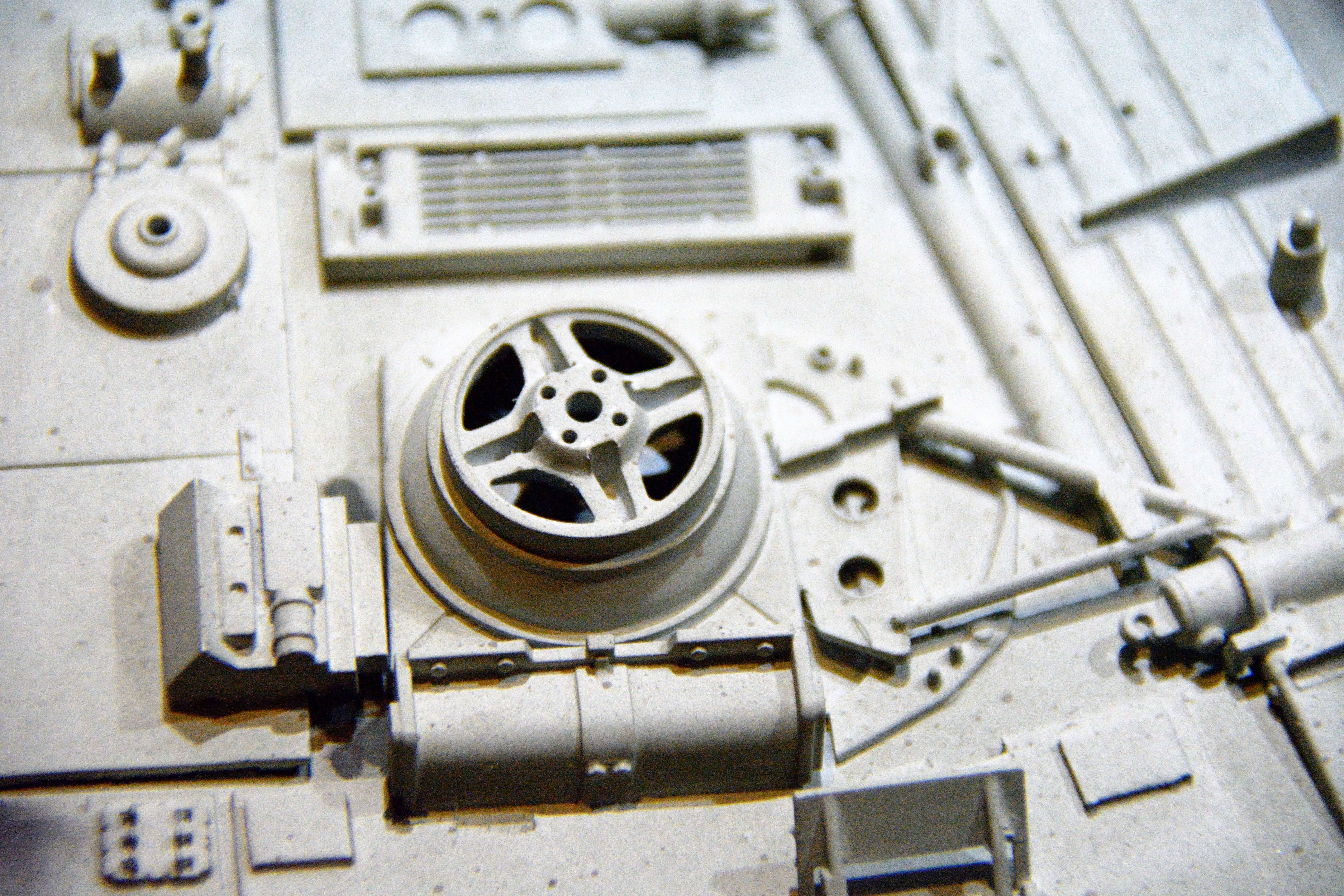

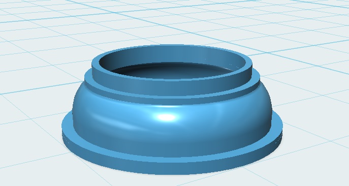

View attachment 542218View attachment 542225
It's the start of a McLaren wheel hub for the Falcon engine deck. It's a little wonky - didn't quite get the curvature right. But it's a start.
And yeah, I've got questions now. Is 123D Design really decent software or should I be looking for something else? Preferably free. The main problem I had was being able to measure specific areas of the individual parts once grouped. Or any part for that matter. Am I missing something in 123D or does it just not do that kind of stuff? If someone can recommend better freeware that would be awesome. I just went with what Shapeways said would be a good start. I haven't figured out how I'm going to do the spokes. There are a lot of concave cuts that's going to take a little more know-how than I picked up in every instructional video I could find. And I'm really not sure how I'm going to get the spokes into the hub. Trying to mesh parts with parts in 123D has been cutting voids instead of meshing. Maybe I'm missing something.
If there is another thread where questions like these are more appropriate, please let me know and I'll gladly take them there. Any positive or helpful feedback appreciated.

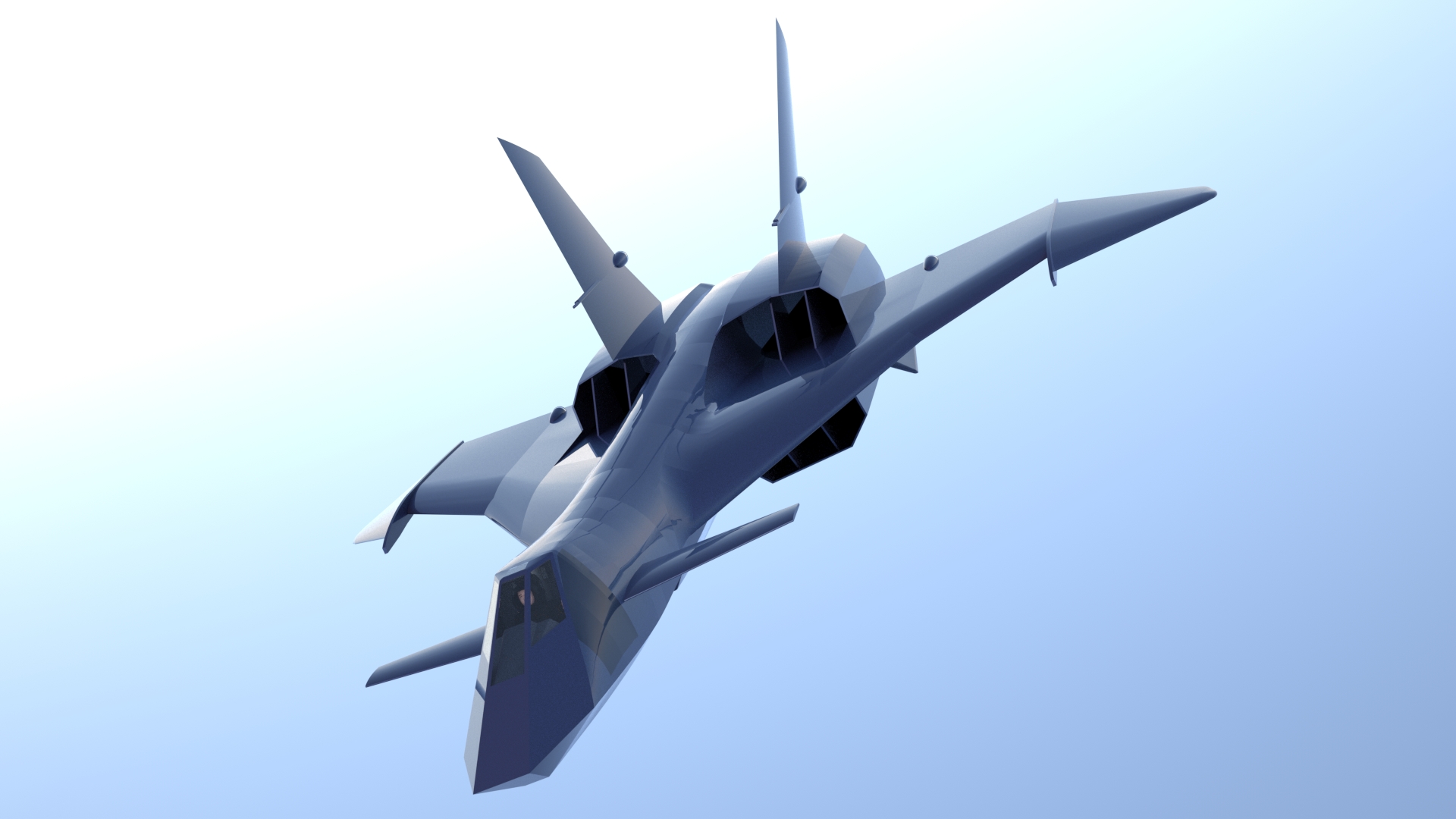

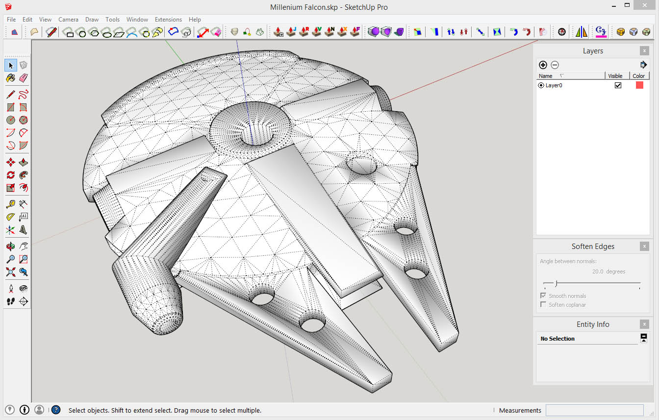

Screen shot of my setup, all the tool icons across the top row are free plugins bar one which was $10 I think. Standard toolbar on the left.
BTW that is the accurate ML 5 foot digital model the guys have done on here imported into Sketchup.
This is what you can get after a few hundred hours work!

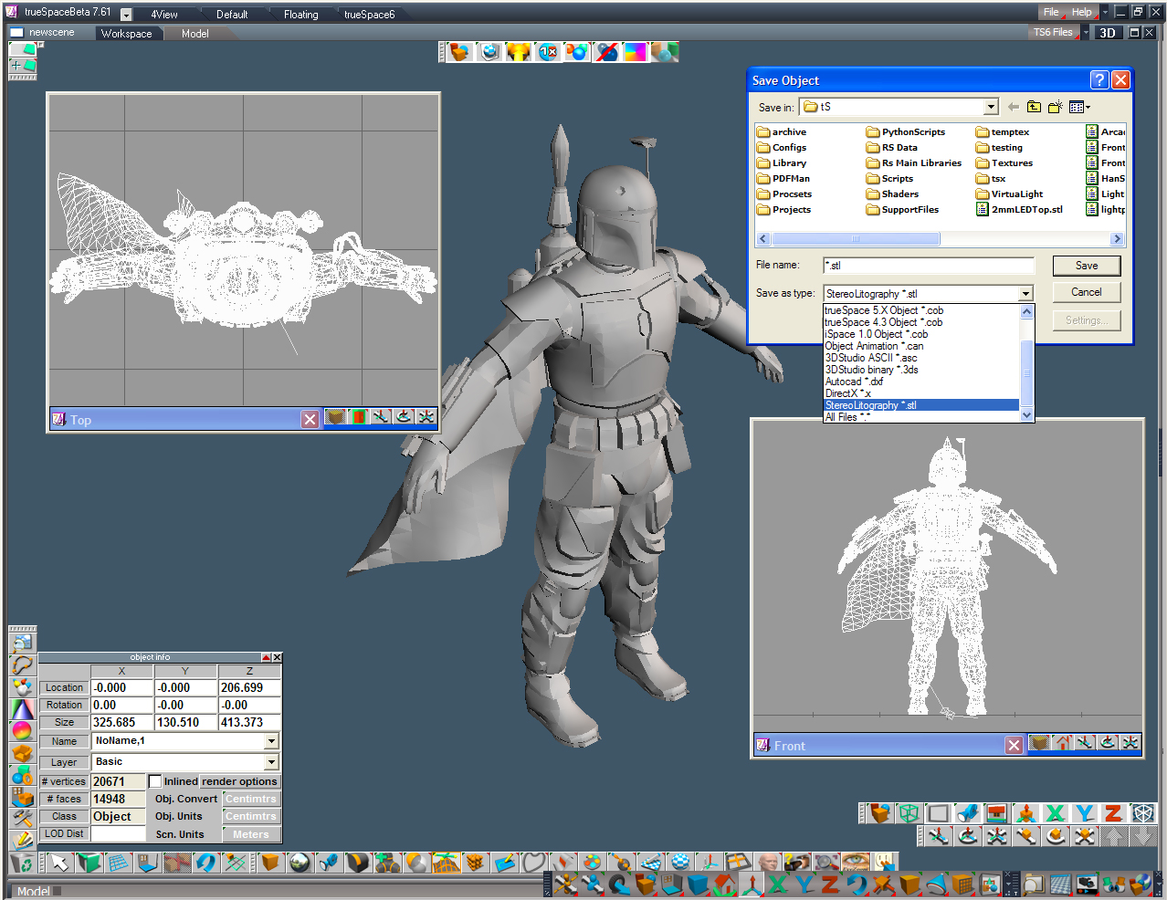

Just thought you guys might wanna know a little more info about good programs to use for 3D creating and modeling. Personally I use Truespace... it's completely Free and has alot of powerful tools. Recently SW just started allowing .STL (Sterolithography) files for uploading objects... but it does alot more... DXF, 3DS, DirectX. Most of which can be exported out to. Then there are a few online free converters that can be used as well... one I use is here: http://www.greentoken.de/onlineconv/ ... it will allow you to upload to a variety of formats and it will convert to a variety of formats compatible with printing. Here's a screen shot of TS in action while I've been working on a new figure (it's almost ready):
Now... every 3D program has it's good and bad points. Truespace is no exception to that. The reason why I use it is because it's extremely easy to understand and model in. I can crank out a full model rather quickly in it but I've been using it since version 2.0 back in the 90's. They were bought by Microsoft to compete with Google Sketchup but dropped. However, it would released as a free download and is currently at 7.61beta and has been stuck there for awhile now. It has a pretty large userbase and a great onlien community to help out. The community forum and the direct download for this program is here: http://www.united3dartists.com/forum/viewtopic.php?f=4&t=4328
Like I said it's a totally free program, there are a ton of extra plugins that make life alot easier too. Alot of these programs liek Blender, 3D Studio, and Maya I have personally found seriously difficult to understand. Sure there are alot of video tutorials but not many that are easy to follow and learn from. TS has a very intuitive interface and I've personally found it exceptional in creating new models. In any event, if you're trying to figure stuff out and wanting to get into 3D modeling and printing, I recommend it highly!
Never heard of Truespace - downloading it now though.
Blender is complicated, the interface covers everything even though you might only need 10% of it so it looks mind bogglingly complex. Does have some useful plug ins for importing game character models though.
Would be interested in seeing your workflow and plugins. When I was doing it I was having to do 4 or 5 step conversions to get a clean model.
Well first off... here's my workflow in TS to create a model for printing:
1) Set my World Units to Millimeter
2) Create my Model
3) If multiobject, use PoyCombine plugin to make a single object
4) Save Object as STL
5) Upload STL to SW and choose MM import
Viola... Printable piece
Sometimes however, I have also done the following:
4) Save Object as DXF
5) Convert DXF to OBJ file using online converter
6) Upload OBJ to SW and use MM import
One thing I'm still trying to get a good workflow on is holes... If you've got a hole or a recess in your model, SW will automatically fill it. I've fixed it a few times but don't have an actual method yet.

Sketchup without the add-on tools is best at boxy non organic forms, why something like 80% of architects use it now apparently. It's still not as flexible for organic shapes like Blender, Rhino3d etc. but for engineering/spacecraft stuff I think it works very well.
A few things I learnt the hard way and can drive you mad early on. When you start a model go to Window > Model Info > Units and set the precision and whether you want to enable length snapping. Precision is logical if you are building something small you probably want 0.000mm (or similar in inches) and length snapping can be useful until you get to really small moves and it won't let you if it's on or it jumps.
Also in the model info page under components you can adjust the visibility of similar (cloned) components and the rest of the model when editing.
Also under Window > Styles then the Edit tab you can set the front and back (inside) colour of the faces, it defaults to white and pale grey, which can be hard to distinguish so change one to something more obvious, I usually go for red as the back colour so it stands out.
Under Window > Preferences > General you can choose if and how often it creates an auto-save file, handy but can cause it to crash when you are in the exact moment of moving a large piece of geometry, usually you are ok just restarting and it prompts the auto-save is newer, but it can generate the same mid move which can be annoying, so you have to go back to the previous manual save. So as a simple rule save often under revision files names 01, 02, 03 etc so you can always go back if you or it screws up!
While we are talking components a quick and easy explanation. If you just want a part(s) not to interact with other geometry and move as one select them > right click and choose make group. This way they can cross other parts without merging or making new geometry you don't want. By default Sketchup wants things to be joined together.
Making a component takes it a stage further as you can make a "master" named component then clone it. The copies will then all change when you change the master, you can stop this behaviour by right clicking the copy and choosing make unique. Found this really handy when building tailfins of the Firefox as you can keep the master level to edit the profile while the "clones" can be rotated to the correct angle.
Note about groups and components, you can apply a colour to the selected group or component as sort of a master override independent of individual faces, but it has driven me mad in the past trying to get rid of it so try and go into a group or component (double-click on it) then select and color inside. If you want to colour sections use layers and the color by layer override in the Layers window.
There is also an option to colour edges by X, Y, Z direction which I can't find by at the moment, but I know it's there!
Selecting parts is something I learnt quite late on and was a godsend when I did. If you create a selection box by clicking and moving the mouse right and down (so starting the box with the top left corner) it selects only parts that fall completely in that box.
If you start a selection box by clicking and moving the mouse left and up (so starting the box with the bottom right corner) it selects everything that touches that box.
These can be combined with holding down shift while selecting will do an addition or subtraction selection based on what you have already selected, selecting arrow shows a + and - symbol. Holding down Control forces adding selections and Shift + Control forces de-selection, again the pointer arrow shows a - or + symbol respectively.
When moving, and this one drove me mad because I misunderstood it, you only have to tap the left, right or up arrow keys to lock the movement in the X,Y or Z direction, don't hold it down like I did at first and couldn't understand why it behaved like it was possessed!
Circles and arc are created with 24 and 12 segments by default, so if you are creating one where the resolution might be visible when printed increase it right clicking to get Entity info or just have the windows visible all the time by selecting it from the Window menu.
A point about this is if you extrude a circle it auto-softens the segment lines so it looks smooth, if you want to see more what your printed model will look like you need to unsoften the edges, most direct way is from the Soften Edges window, select edges, untick Smooth normals and then lower the angle between normals slider. To you wan the fully smoothed look so all hidden geometry edges disappear even on flat segmented surfaces you have to tick Soften Coplanar.

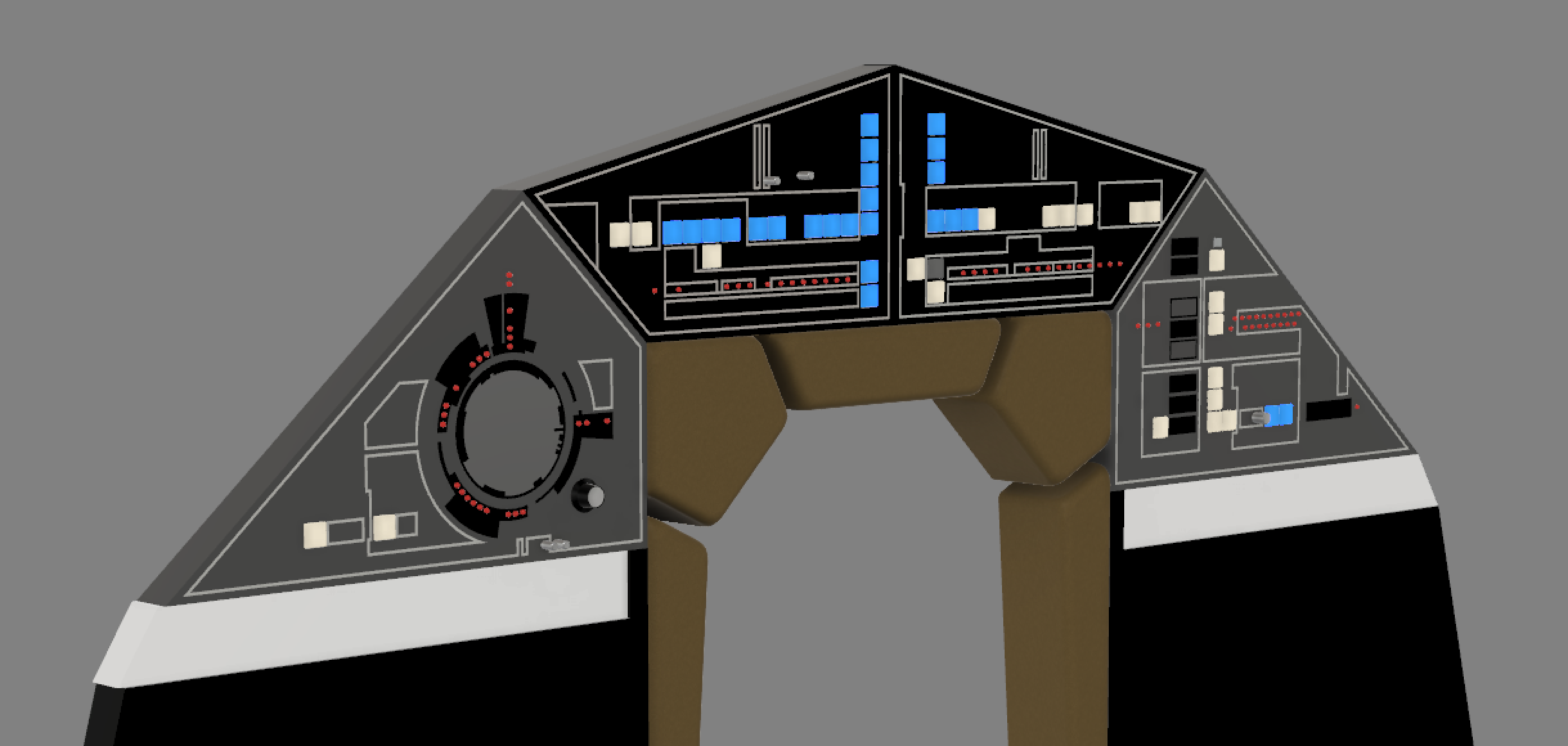

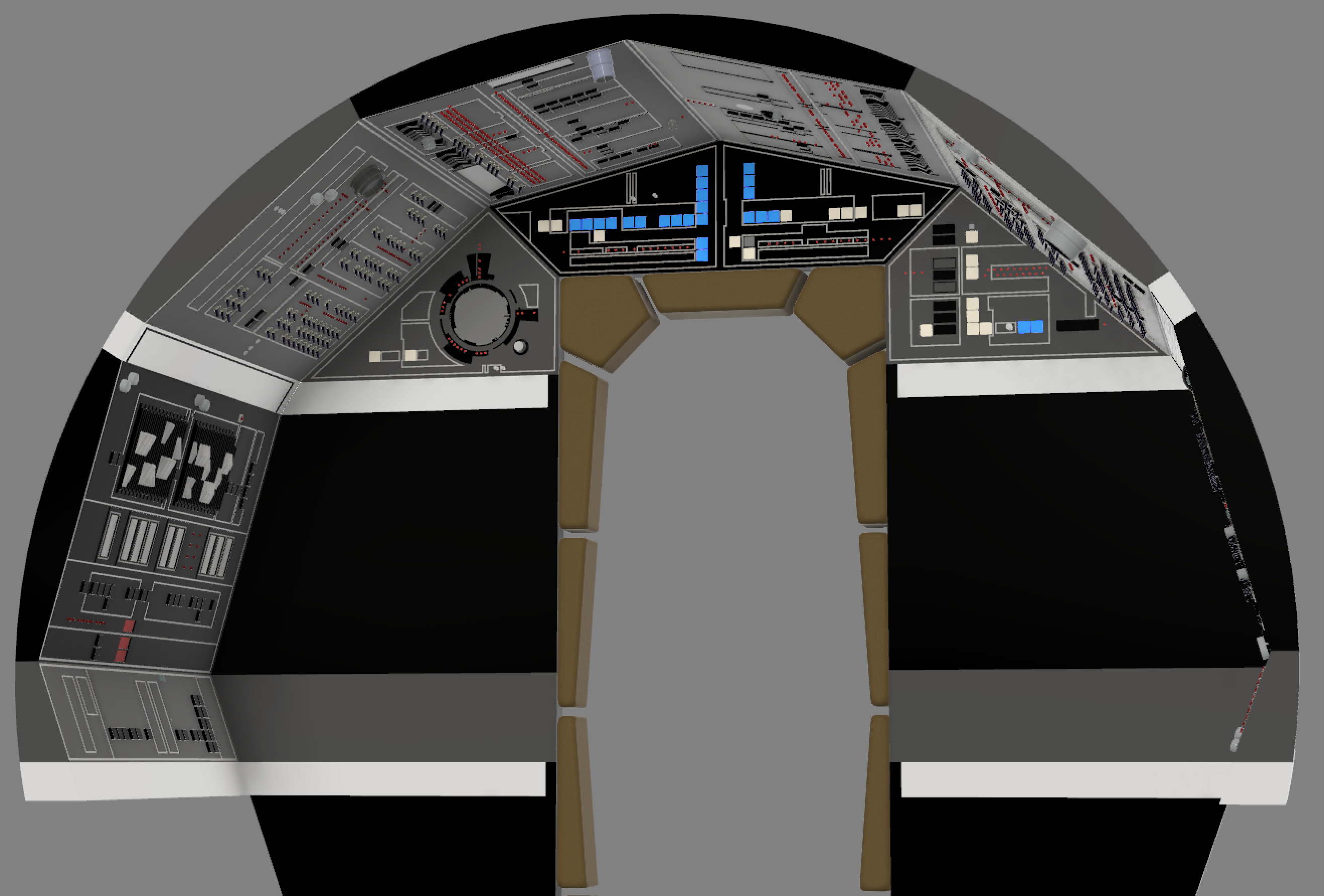

Been busy over the past week getting back into cockpit modeling. I'm trying to stay accurate to the ANH version - although this certainly remains more of an idealized interpretation which pulls proportions from ESB but the layout of ANH. Confused? I've personally never liked the crooked, smashed cockpit of ANH. It's like the ANH cockpit had it not been hacked-up before filming...
J.
I'm kind of a fan of the chopped up cockpit, but replicating it is tough. It really looks more I'm the one who made a bad model, rather than the production team. Seem to remember some thread on here about replicating poorly made or jacked up props exactly, and how it kind of doesn't work sometimes. As I was referencing the cockpit, I noticed while switch between two screencaps of the same shot (escape from mos eisley) that the jacked up cockpit corner kind of floats around during the shot, I guess as the crew physically shifts the set piece for explosions.
yours is looking good!
