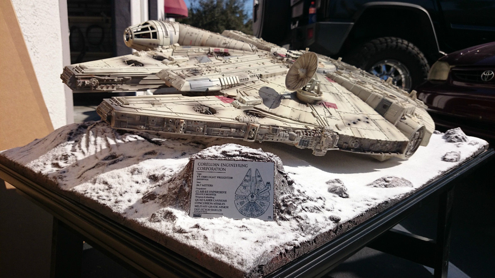

So i'm currently working on the Millennium Falcon Hasbro Conversion - and while I'm waiting for parts from shape ways to get here, I thought it'd be a good time to start working on some kind of base for the falcon. I've seen a few really cool ones online that were made for the MR Millennium Falcon, which ironically also happens to be relatively the same size as the Hasbro Conversion. I'll go ahead and add them to the attachments.
Hoth Base Diorama
Hoth Base Diorama (2)
Hoth Base Diorama (3)

My main questions to you guys are;
1. Which one would be the easiest to make?
and 2. What would be your thoughts on how to go about making it?
