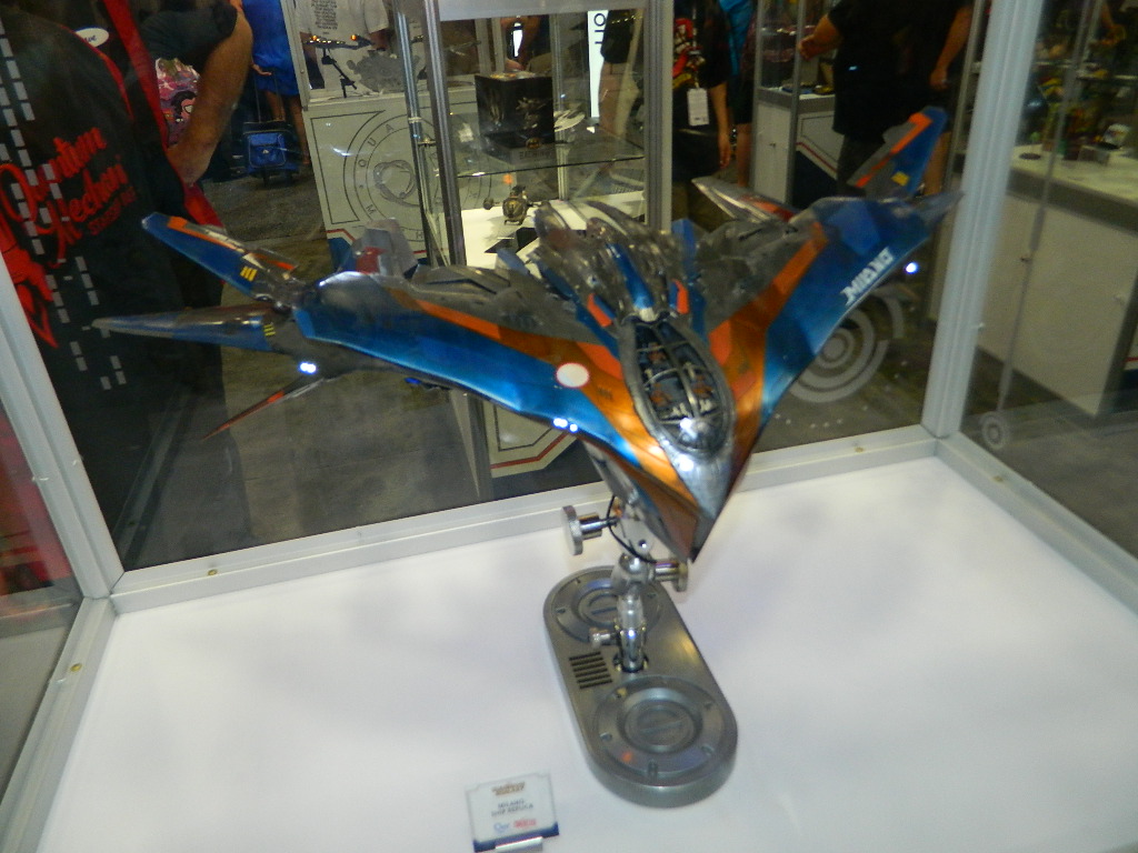

Thank you. I’d love to find someone that could 3-d print one just like this. This is the image that started my search. :). Appreciate the reply.

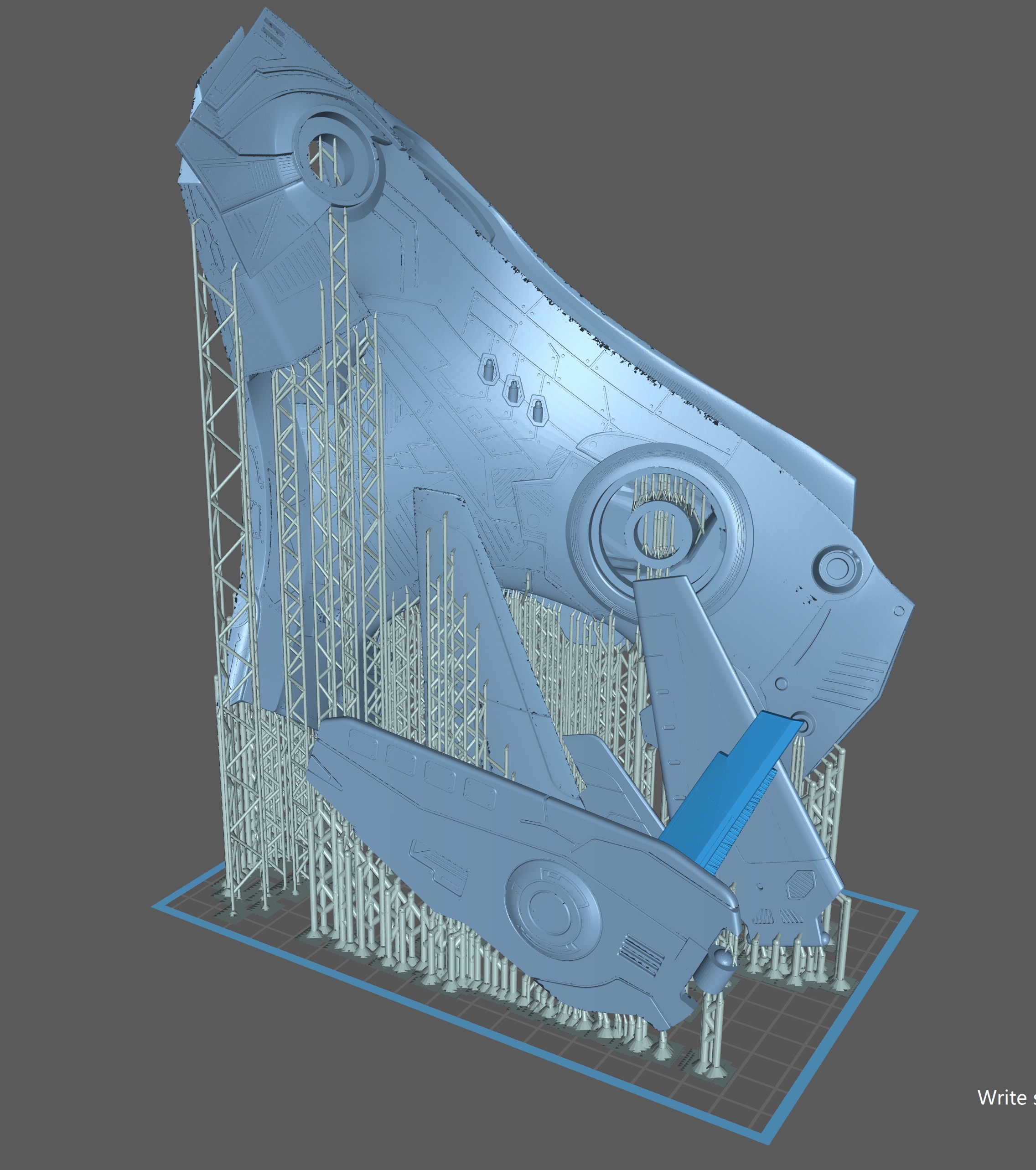

Maybe, I am printing 1 set at the moment, that will take 30 Hours, and that is just 1/3 of the parts.
I am trying to print the largest part as big as possible, to make the complete model big. Just the 2 main body parts are 36cm wide :)
We'll see how the parts come out and how much resin I need to print everything.
Some parts need to be printed in clear material.
I also had to repair some areas, they were not optimal for resin printing, even though the files say they are, with inclusions in the model that would seal uncured resin.

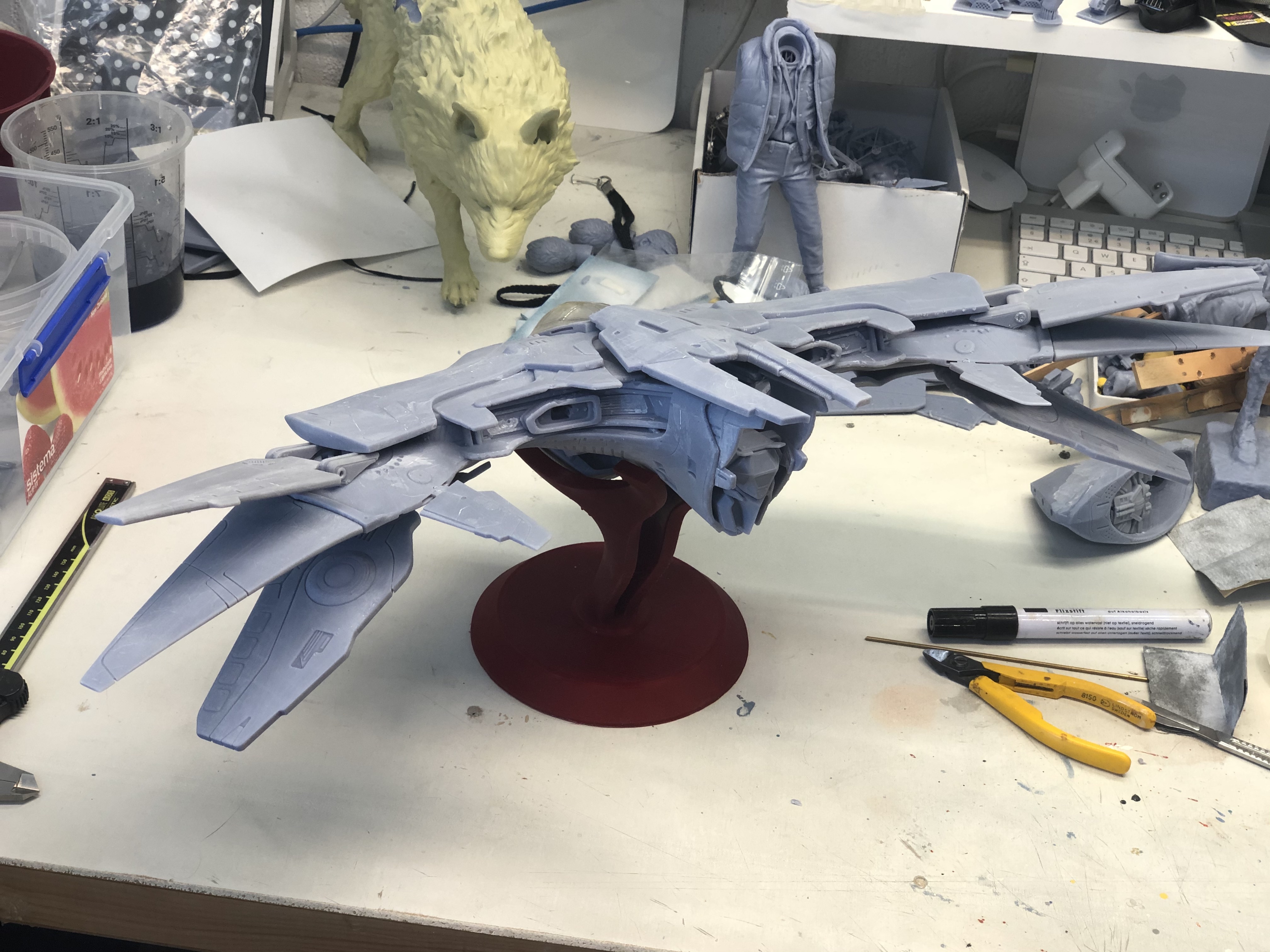

One side of the main body printed pretty good, I have 1 wobble line that probably can be sanded away.
I reckon the scale after I enlarged the parts is around 1/87 scale.
Does anybody know a good reference for the decals or where I can have them made ?

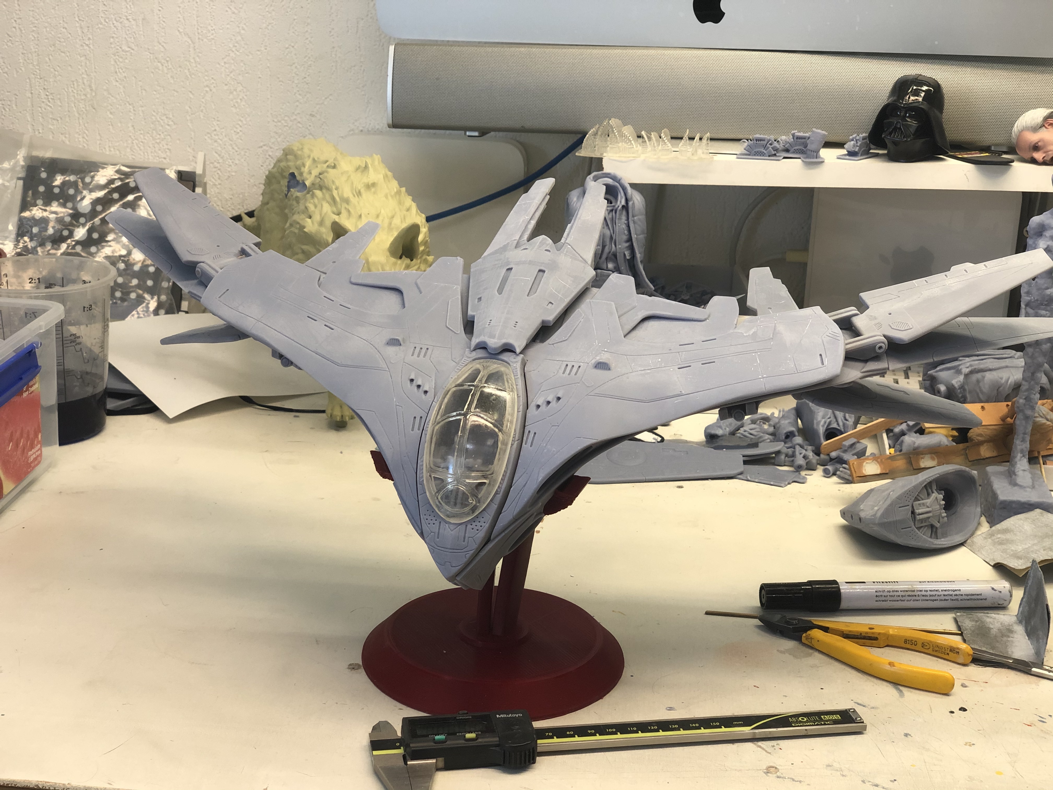

Current state of the Milano, all the wings are fitted, with some some sanding, the top wings are printed with the hinges attached, as they would probably fall down otherwise.
I am also experimenting with a transparent printed cockpit shell, as the small separate windows are very hard to print , with some clear lacquer it becomes pretty clear.
Printed the stand that came with the files, just for assembly and testing, this will be a wall mounted model when it is finished.
Next will be adjusting some details, as they were very simplified on the model, will be drawing and printing them in the next few days :)
