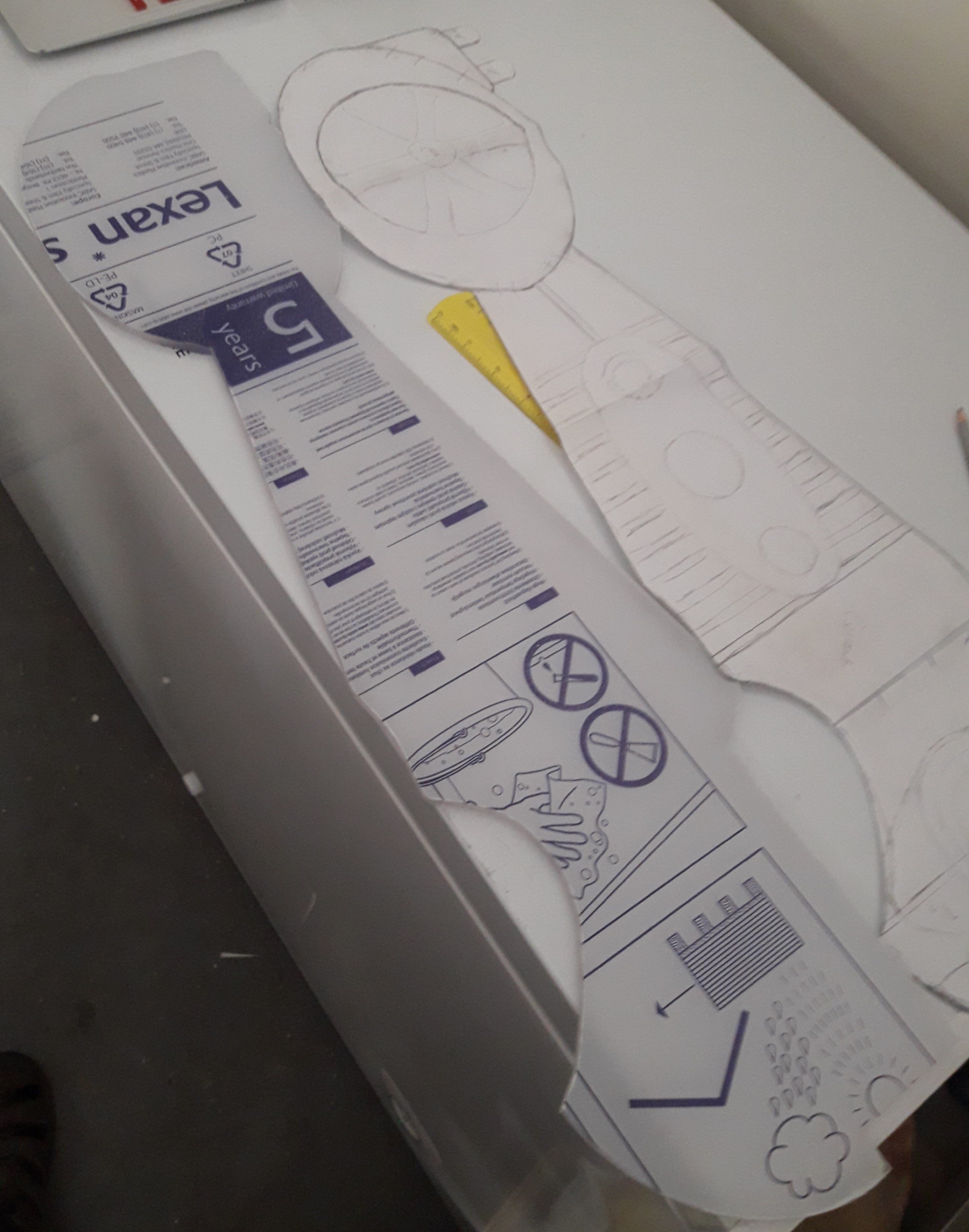

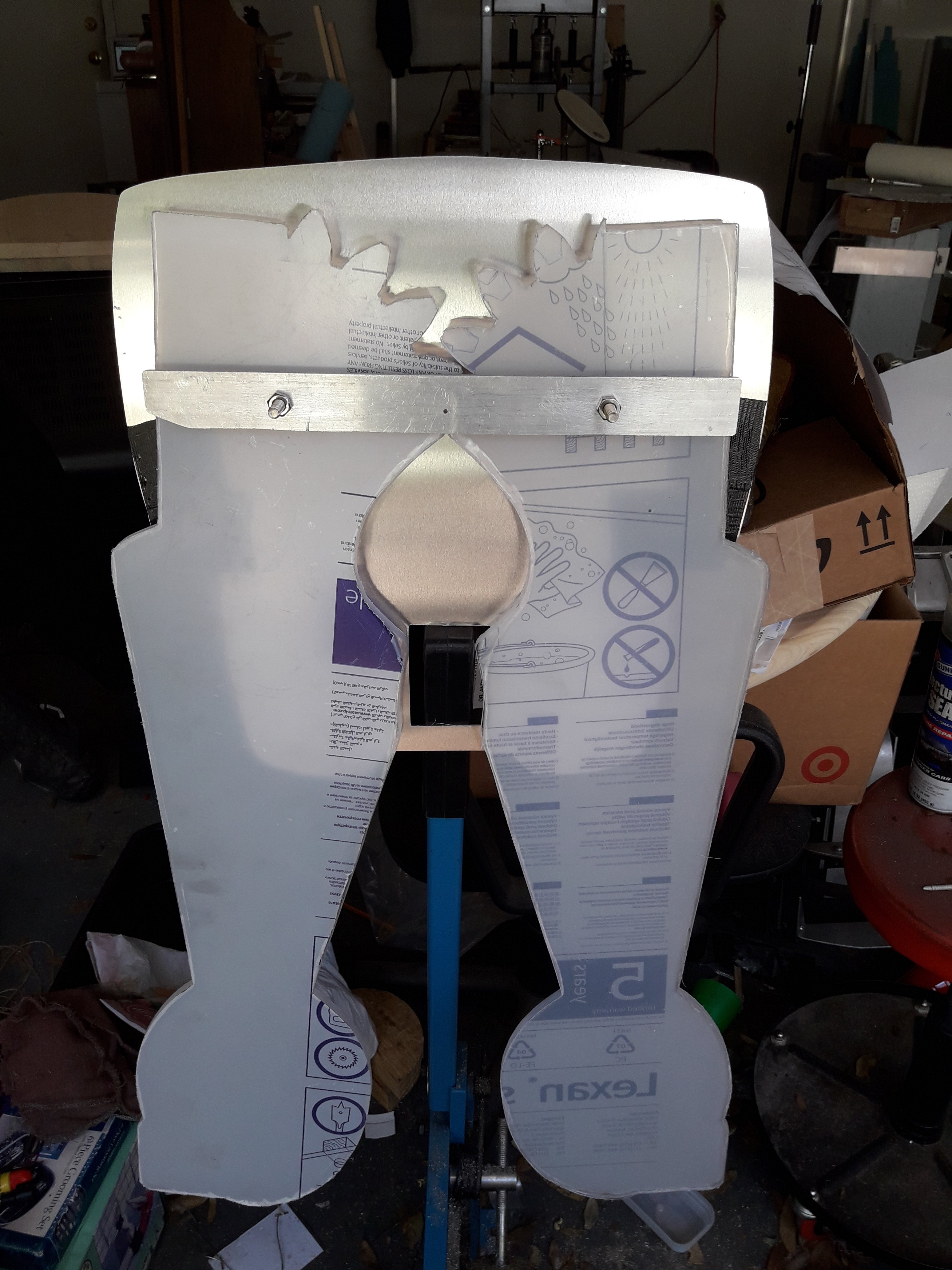

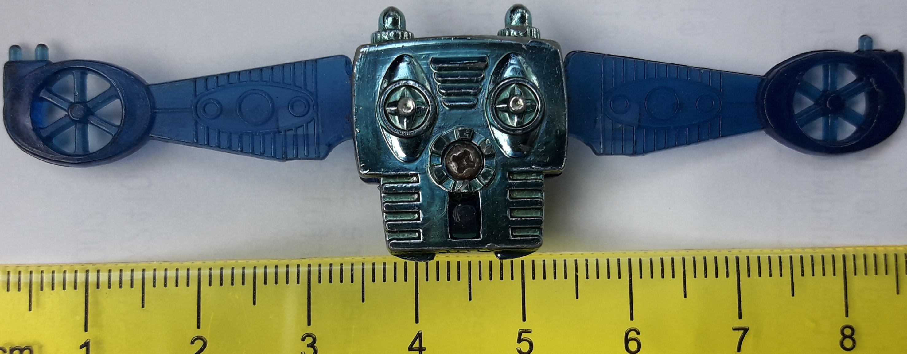

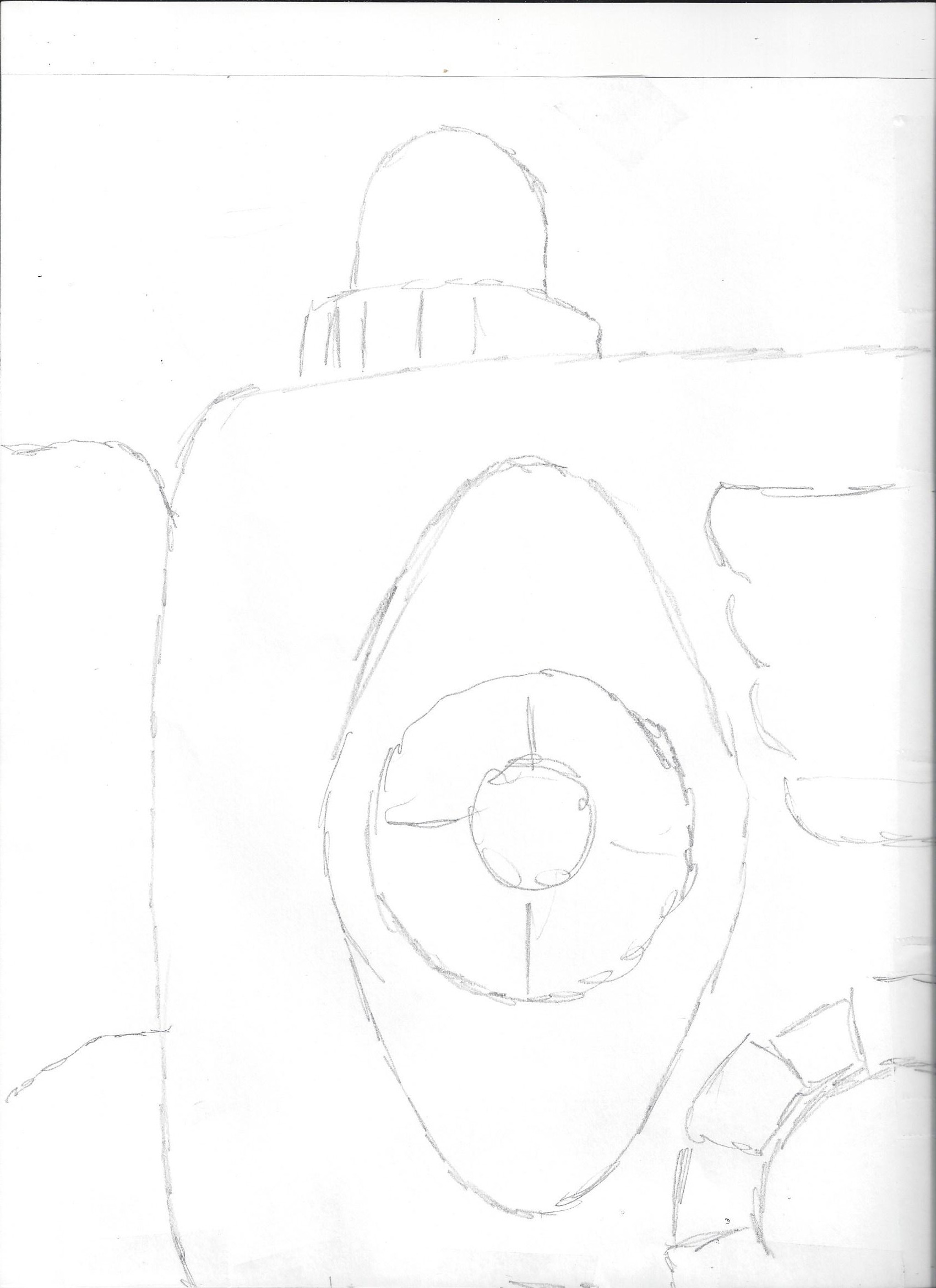

So, I got a micronauts glider pack. Took picks, use the height of the micronaut vs the size of the pack to figure out correct proportion for avg person.
Then put it on a tv, made it correct size and drew the outline and some details. The bottom of the pack just mirror image and overlap to line up.
PacktopLeft.jpg packtopRight.jpg WIng1 001.jpg Wing2 001.jpg WIng3 001.jpg Packbase 001.jpg
Anyone want to clean this up?

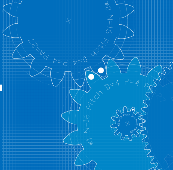

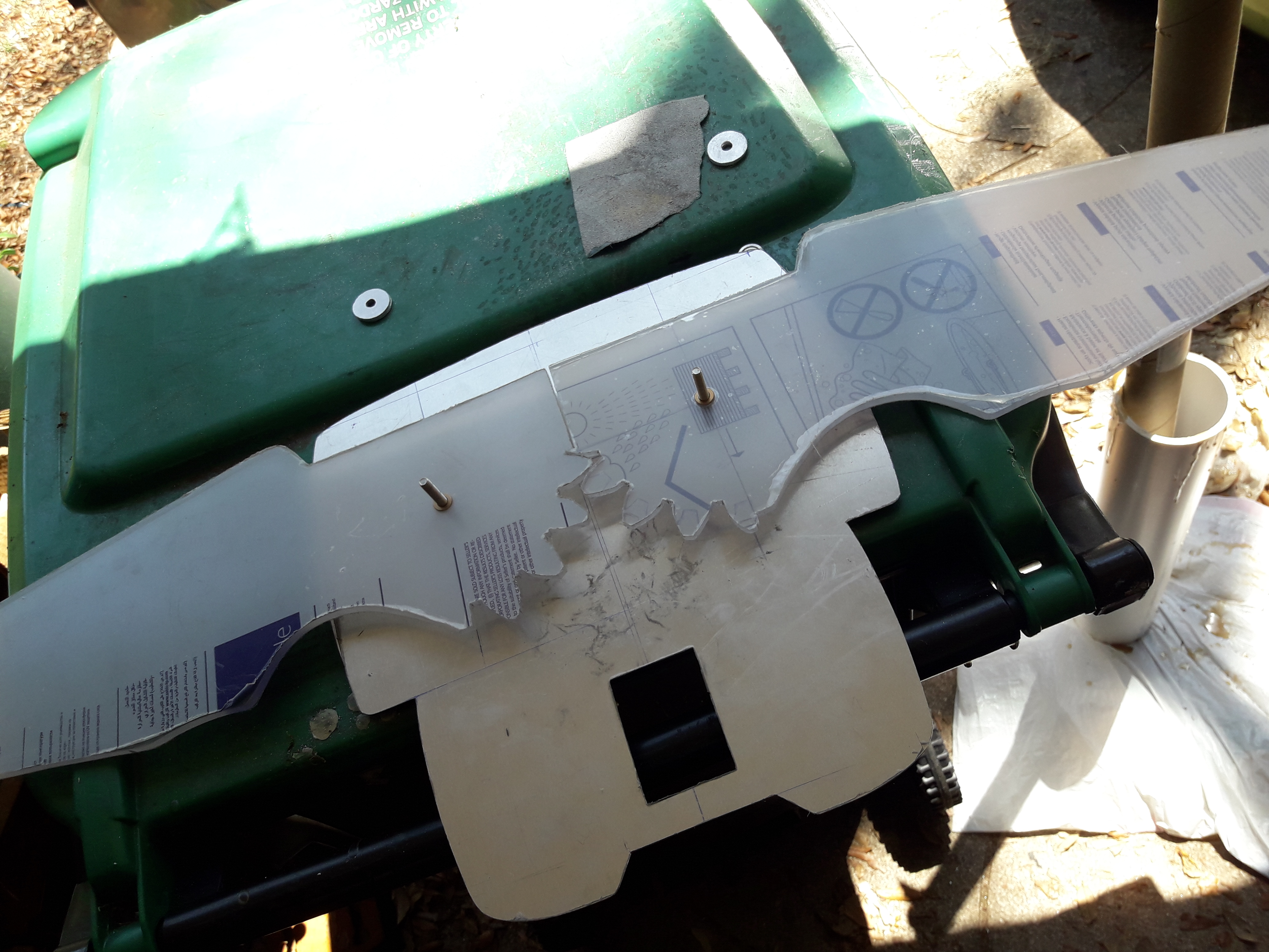

So, whoever made the "GearGenerator" website, THANK YOU!!!
WHy?
GearAligned.png 6 and 5/8 inches distance between gear centers...magnify on computer screen and trace out to cut out

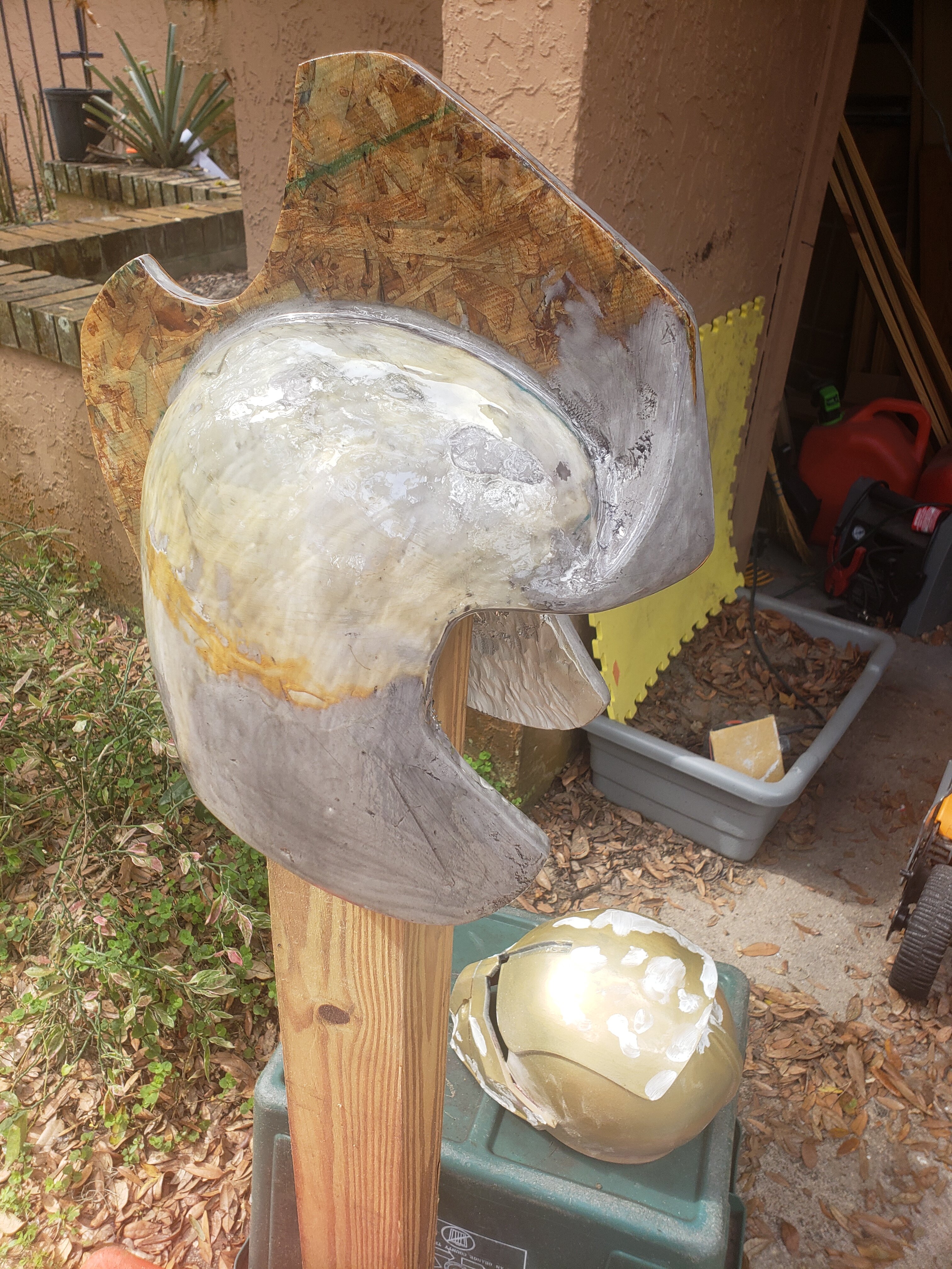

So, any good advice on sculpting sculpey helmets? I started with aluminum, resined it, and now making outet layer outa sculpey. How do you get a smooth, round look?
Should I shout these questions to sound more like Robin Leech?
I will be using paint on mold stuff, for the helmet.
JPH
Using Smooth-on rebound 25. Does Sculpey need to be sprayed with release agent? Will release agent mess up the sculpey? What is the speed of an unlaiden swallow?

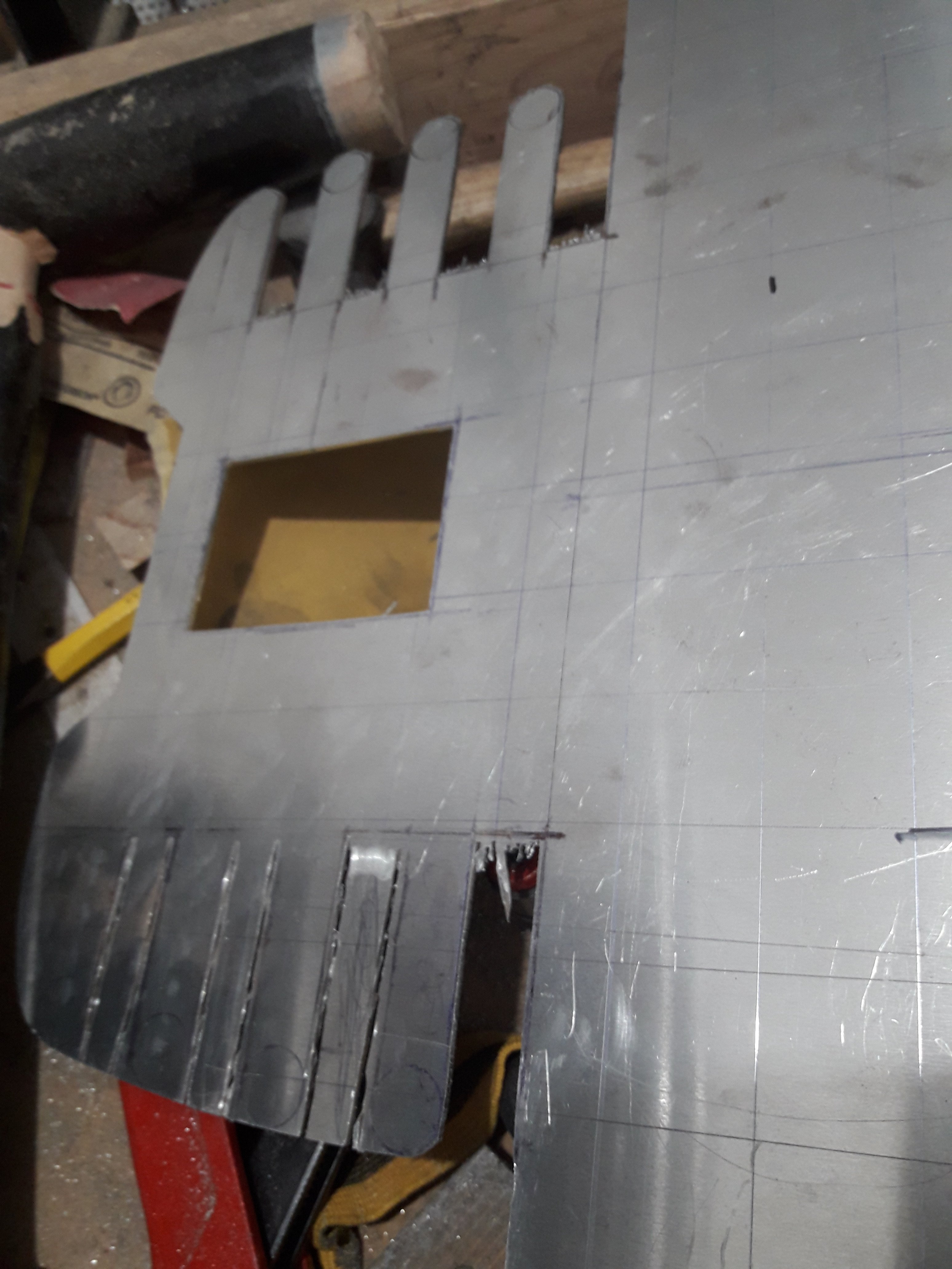

JPH
Meanwhile, the helmet it soakin in silicone 20180508_134305.jpg I will sand out the roughness after casted-ed 20180508_151626.jpg

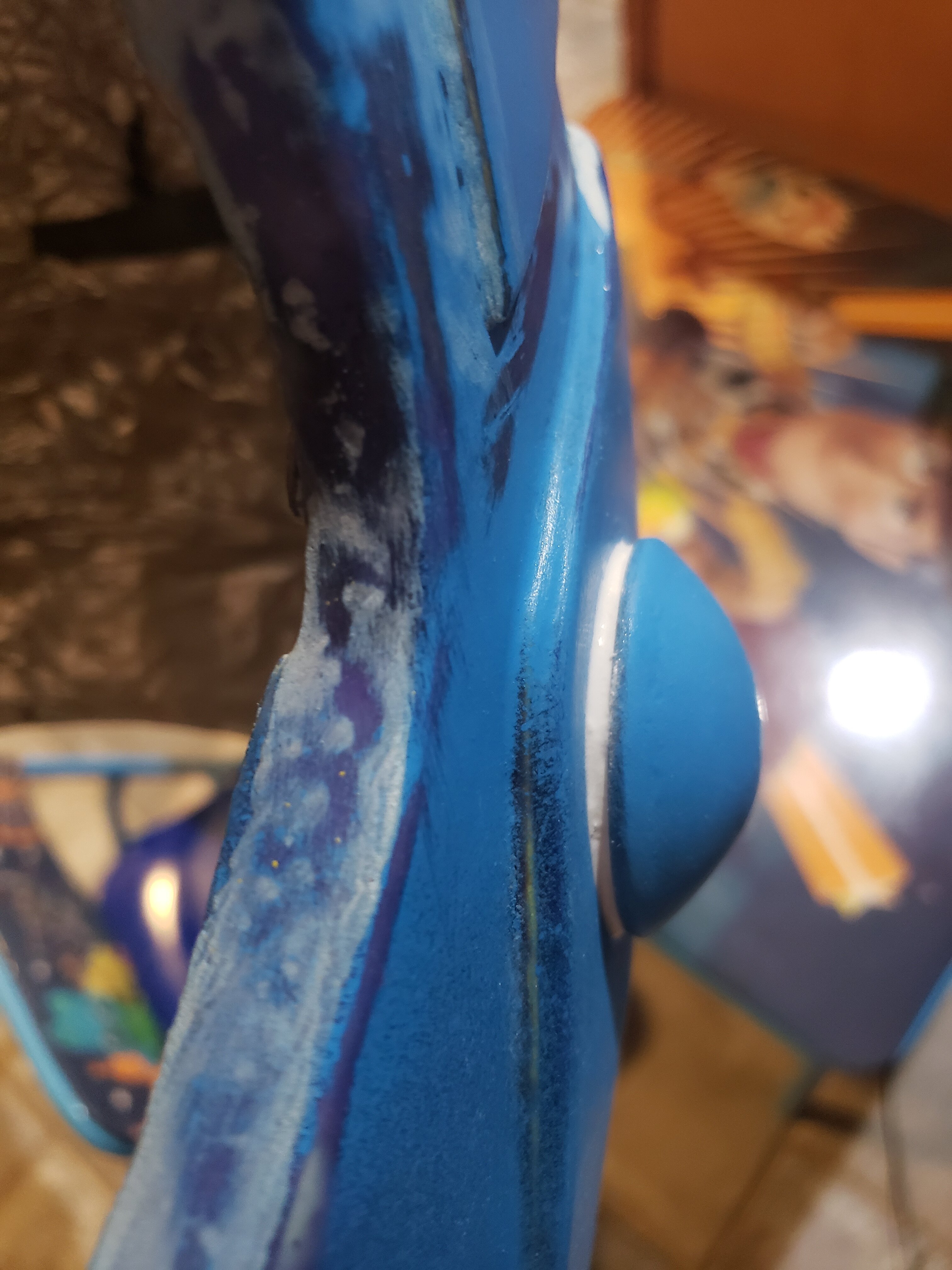

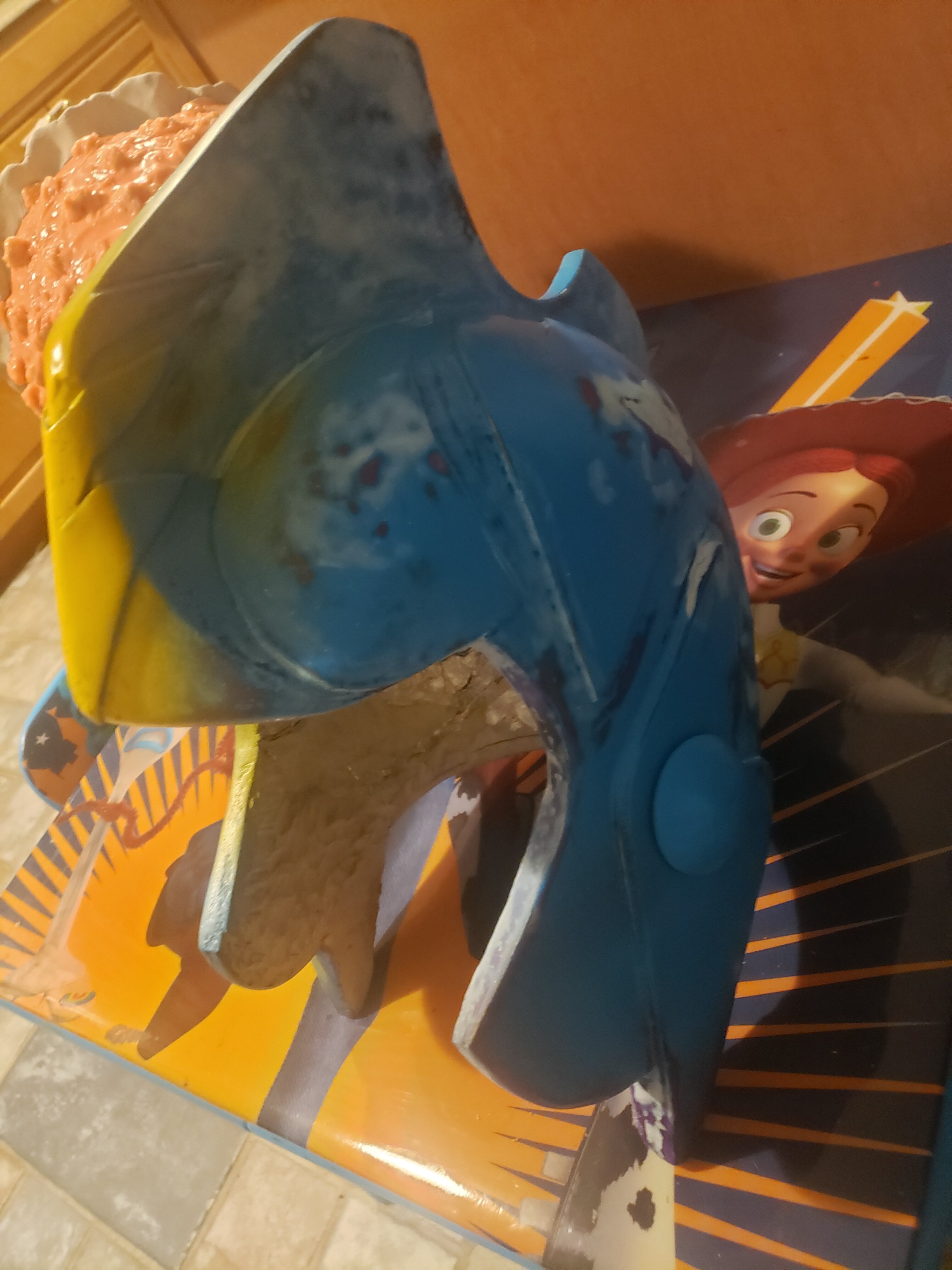

Coated helmet with e-poxy.
Let it flat-ten out the dents
Let is cure out of the rainstorm
Have to add details and vents

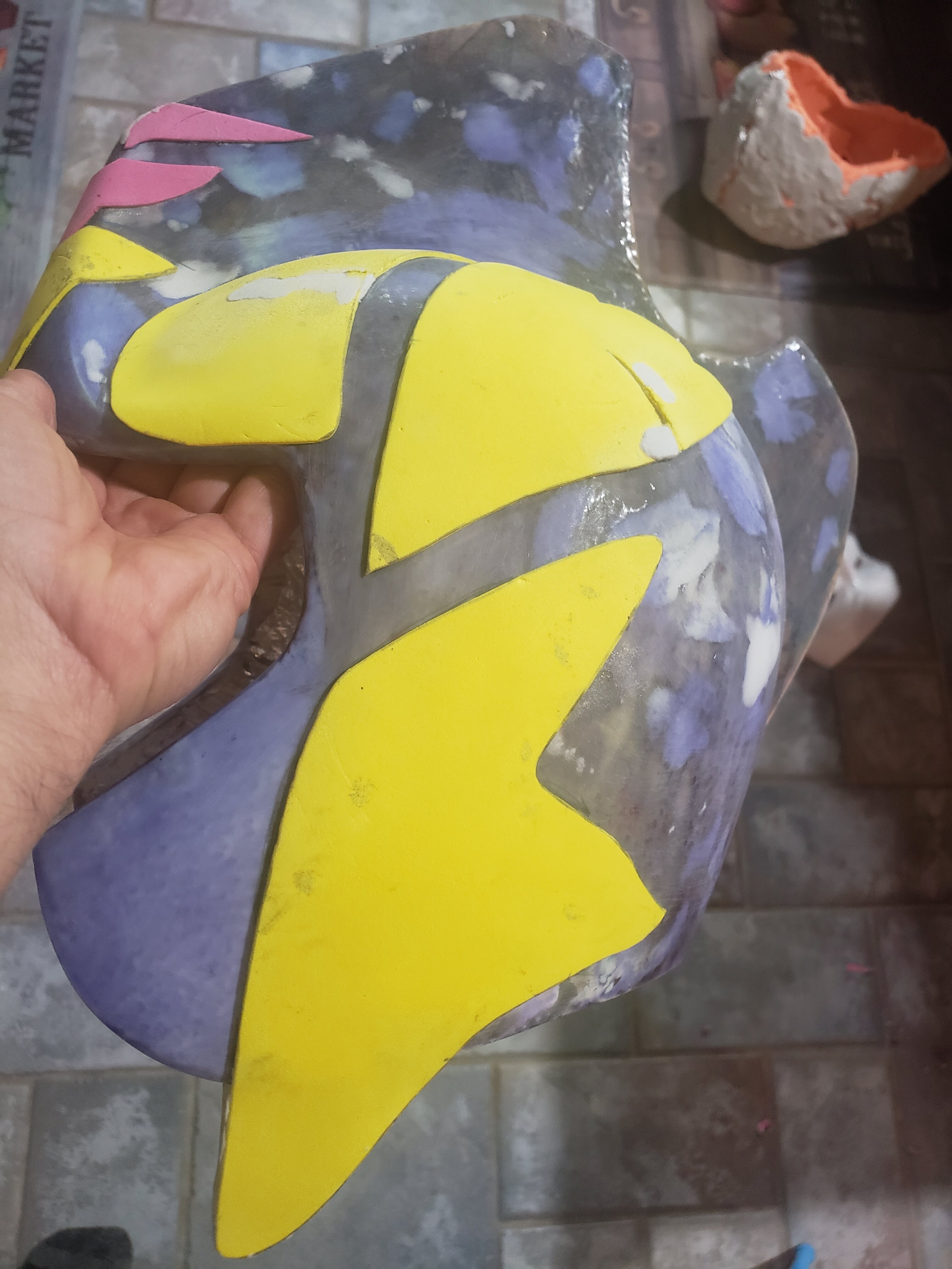

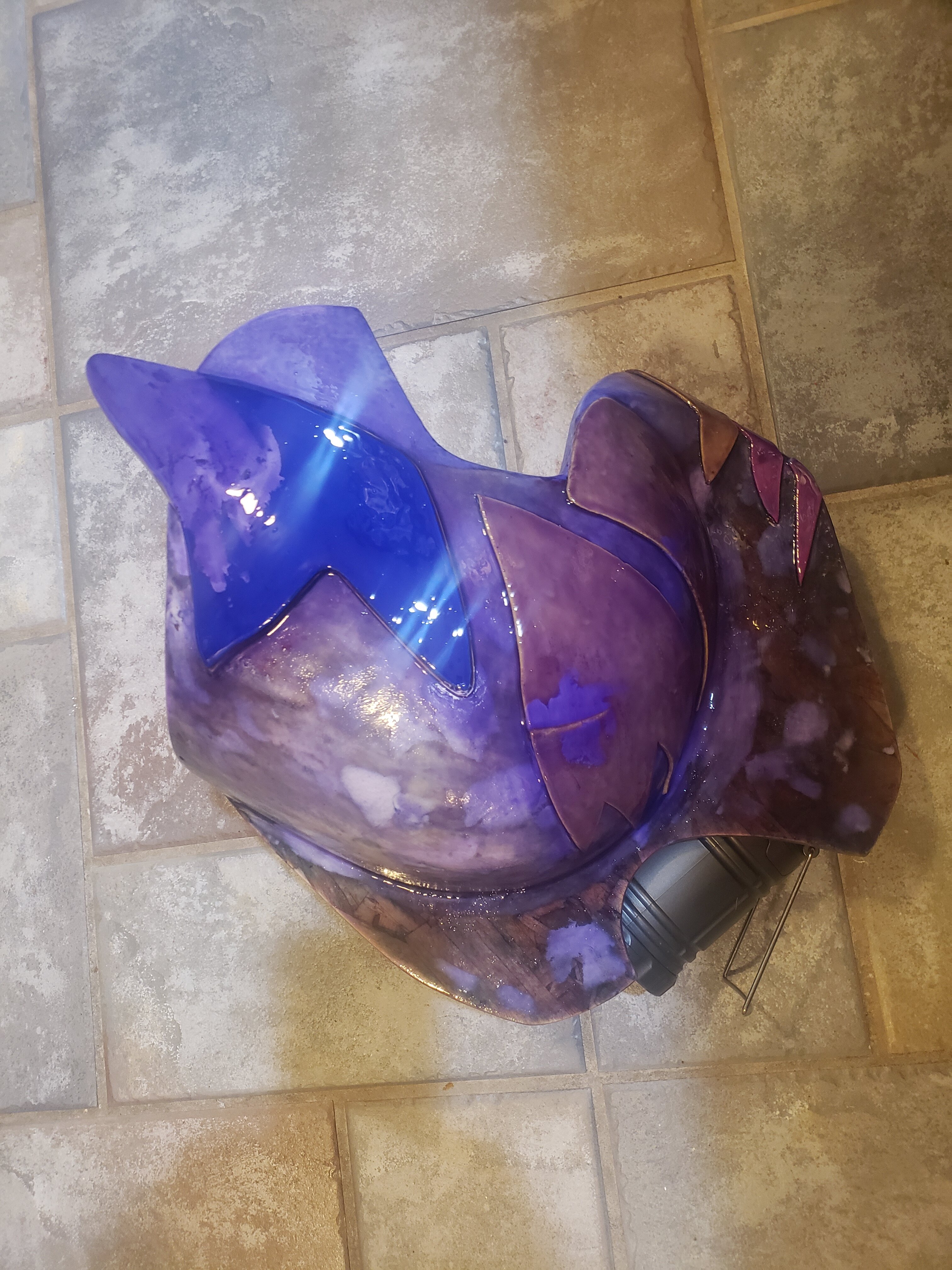

JPH
If you look close up on space glider helmets there are some designs. So, I guestimated them out of 1/8 inch foam. Since I have to make them 3D, I will add MORE FreeForm Air and then sand flat and coat with XTC.
I guess I could have stopped at the mohawk piece, but after taking some macro pics of the helmet, I went for it.
NOTE: the micronaut's head has a thick, hard layer of wavy hair, so going from toy dimensions to human head calls for some inaccuracies.

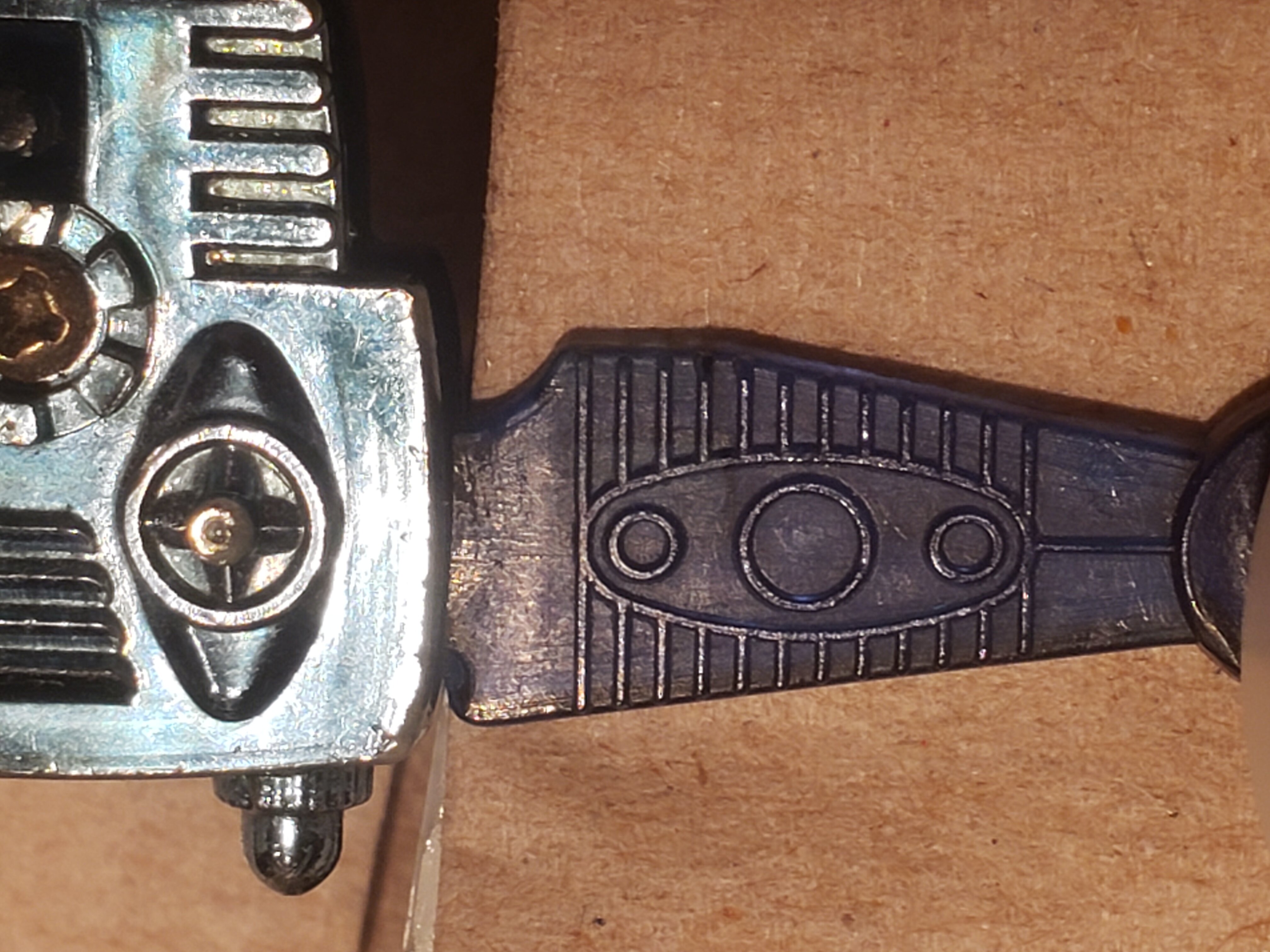

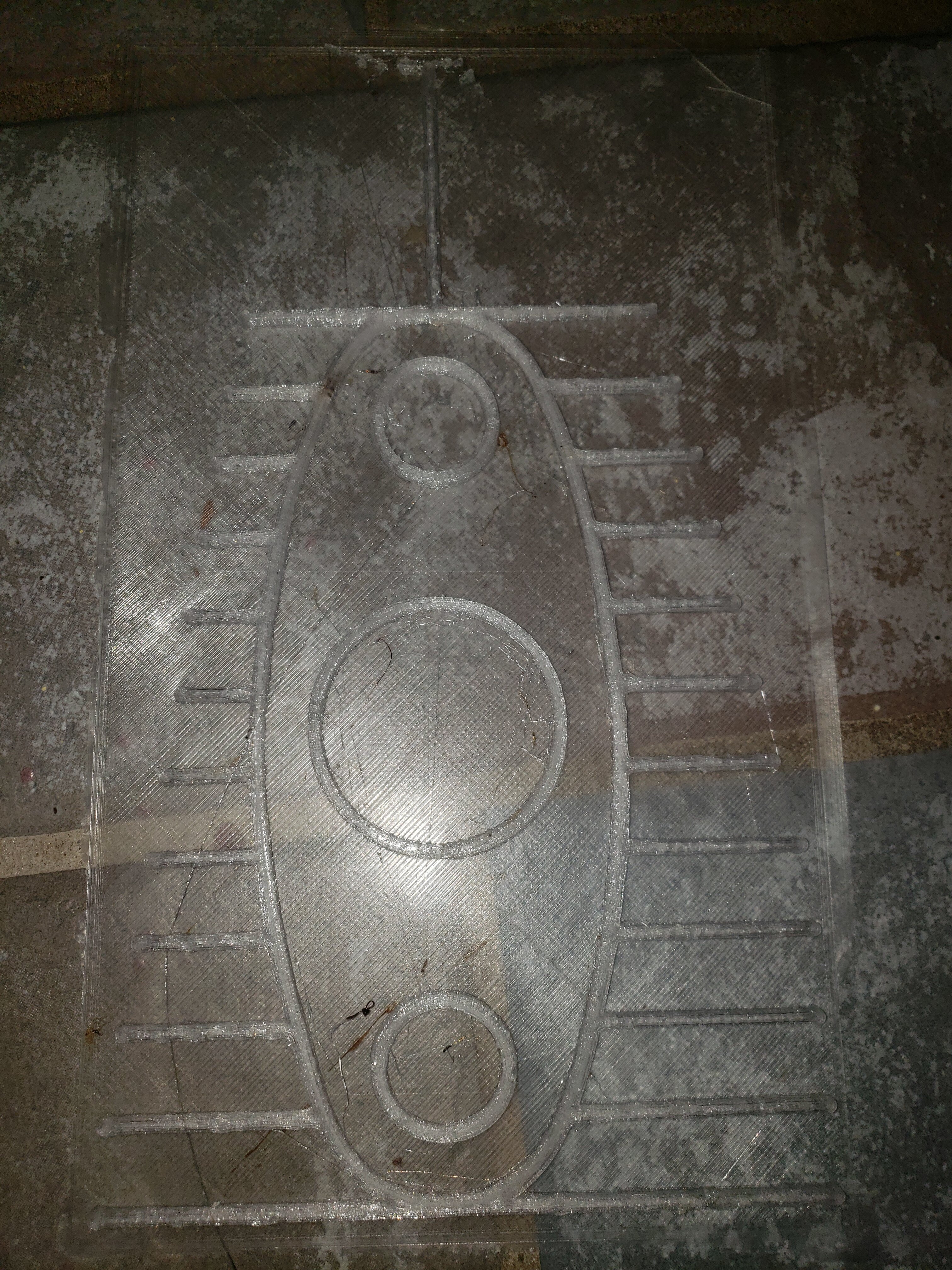

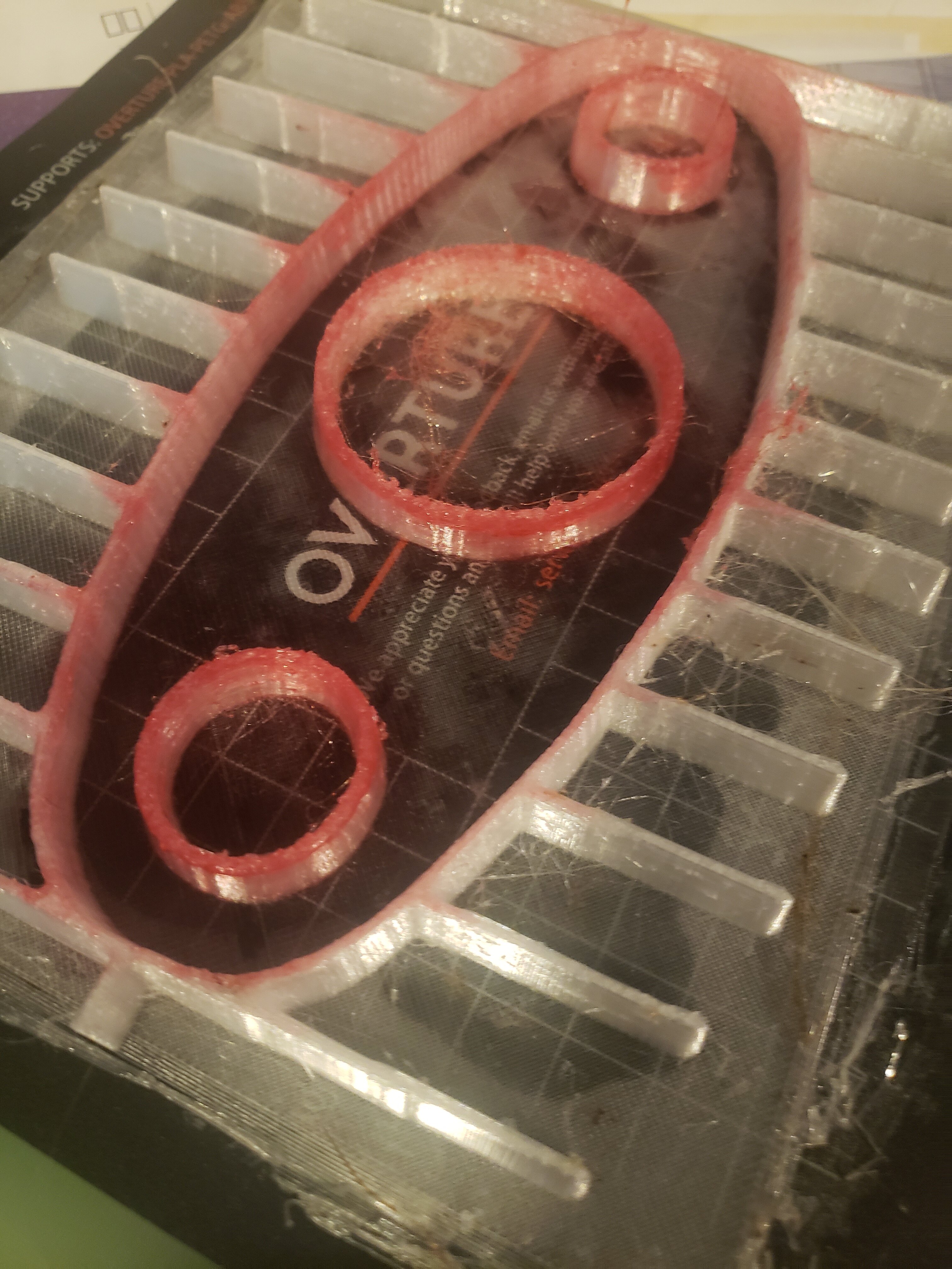

3D printers are fun.
Take wing details, make them black and white. Turn into a 3D file, where black is higher.
Viola!
Wing details can now be printed and used to make molds, or even applied directly.
Oh! I feel resourceful and lazy at the same time

JPH

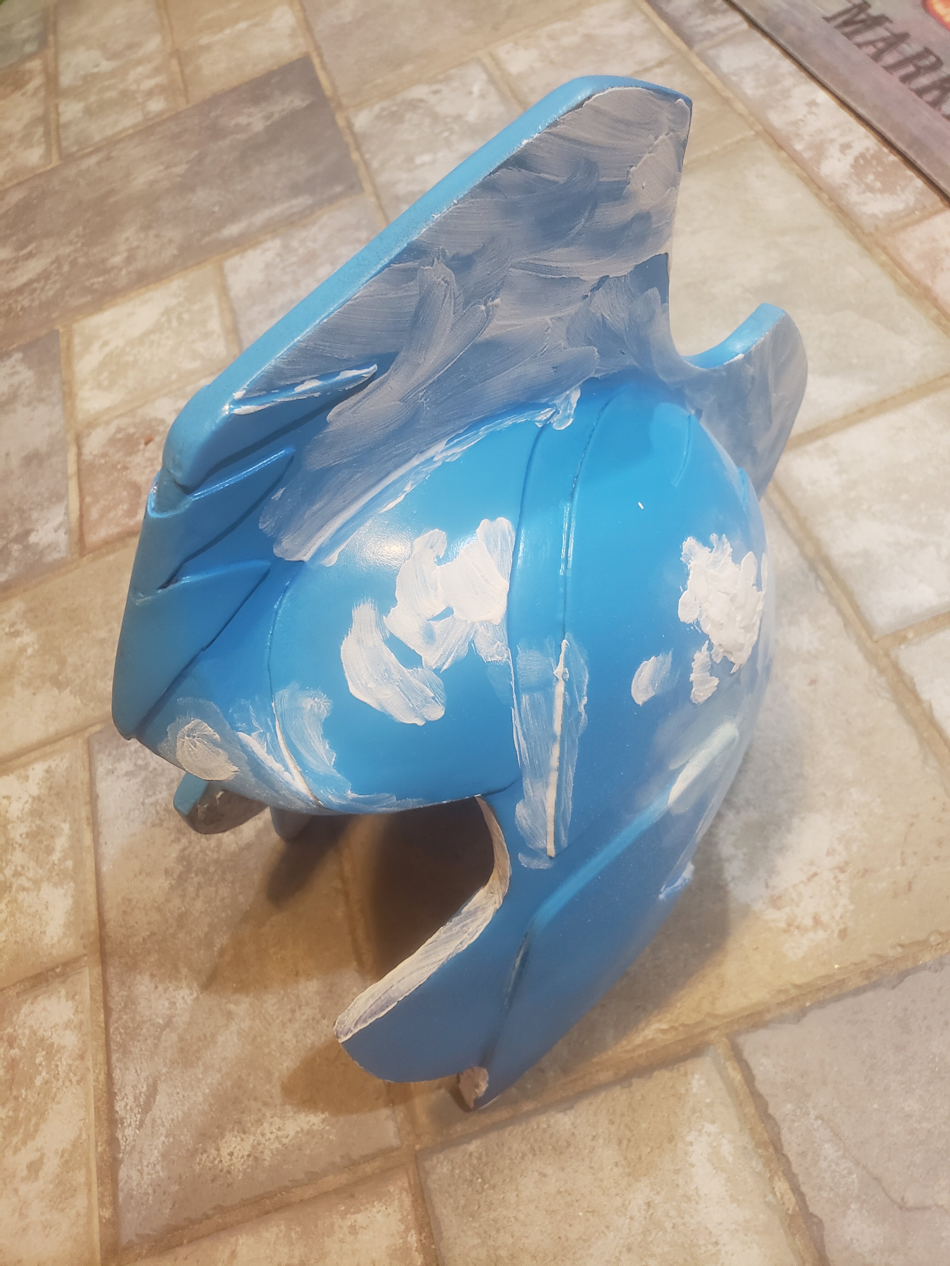

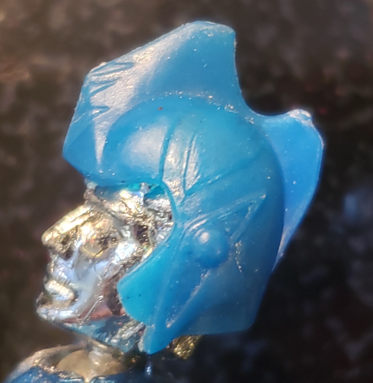

the helmet is still, "coat with XTC, sand, repeat. Debating how far to go with details...
